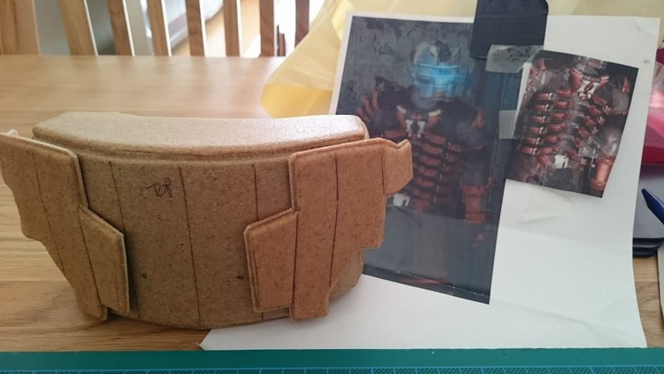

Once I had a helmet it was time to start on the torso. I decided to use EVA foam to create the ribs.
EVA painted with rubber paint to give a bobbled metal look. Then painted in Copper B32. The added to a black vest. EVA foam belt created too.

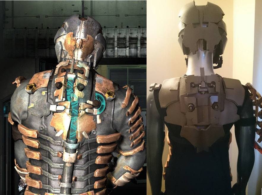

Time to look at the hard bit now..... the RIG.
So I started with card, then fiberglass. I used Worbla to strengthen the EVA then used DVD boxes, pen lids, foam, glue, paper and plastic tubing to get the shape. I used a GoPro chest harness to hold it on my back
#watchthisdeadspace

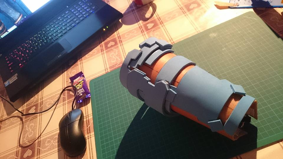

Right Arm Gard -
EVA clamps, Worbla frame and pleather strap. I have used magnets to hold this onto my arm.

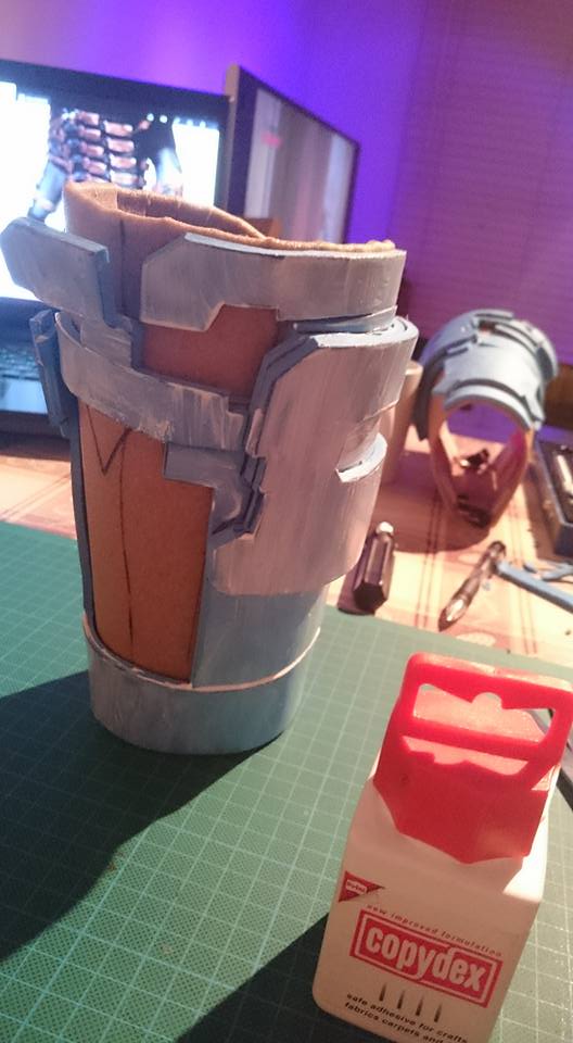

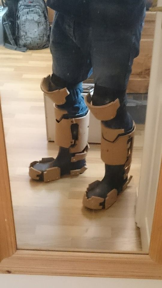

Knee time!! #watchthisdeadspace slowly getting there. Almost got the first layer of the suit done. Then I go over it again adding details, then again to add paint. Then it will be time to get the lights working correctly. Will he be ready for May London mcm 2016?
12565621_1125183147506594_4556030645948796204_n.jpg 12573891_1125183170839925_6696105924463844494_n.jpg
Boots and knees 'selfie'
They move well and are comfortable but strategy heavy. #watchthisdeadspace

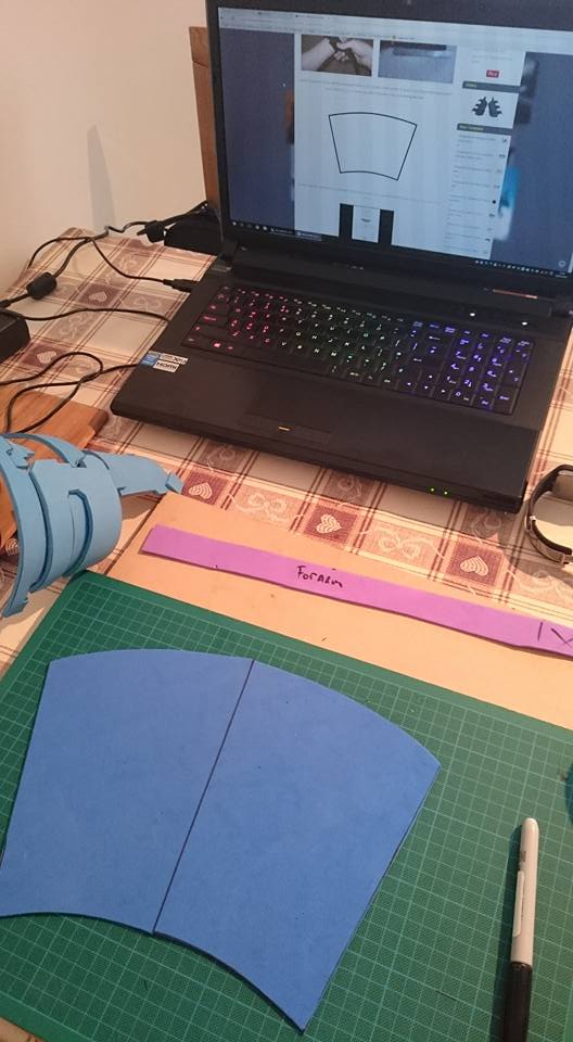

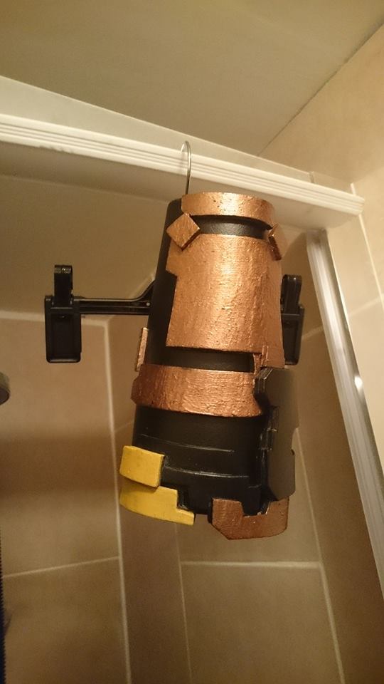

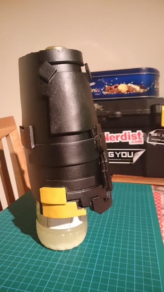

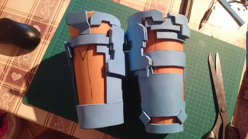

Added first layer of paint to lower arms. I'm happy with that so far. I will go over the full costume when it's all painted
Here is the ref I used -
#watchthisdeadspace

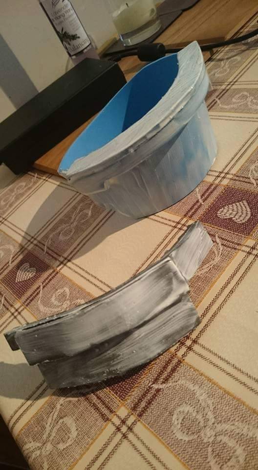

So today I did some little bits... Added lights to boots... undercoat added to left arm parts...
Made some sponge rings and painted one up to see if the paint will take. If this works the four rings will be added to the legs this week.
And the left shoulder is done (See below)
If only all parts were that easy!
