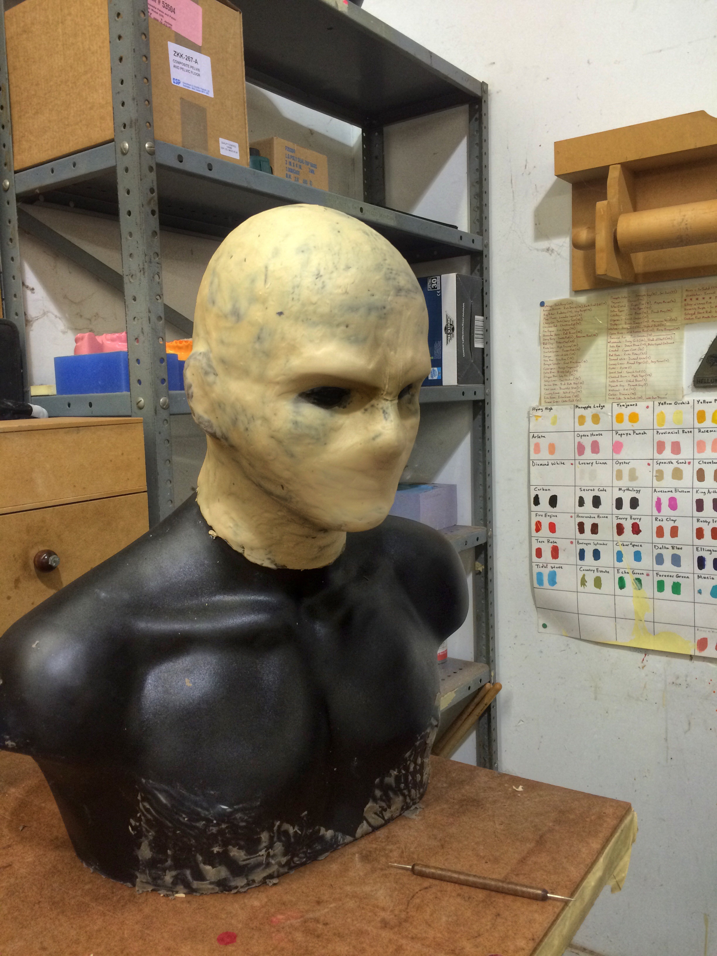

I've been wanting to do this for awhile, and I finally built a core to sculpt off of a couple weeks ago so I figured I'd go for it. I'm not very far along yet, I've only been able to put in 30 minutes to an hour each day over the course of the past week, but I'm happy with the progress. My plan is to add a hidden zipper in the back, but we'll see how things end up.
I didn't have enough of the more rigid clay and had to lay a much softer clay on top, so I ended up making a junk mold and doing most of my sculpting/clean up on a Smoothcast model. Lots of bondo, Apoxy, and sanding later... I'm happy with his expression and how smooth everything is, so the next step will be to carve out the black areas of his mask and add the seams. After that I'll texture with paint and hopefully be molding soon.

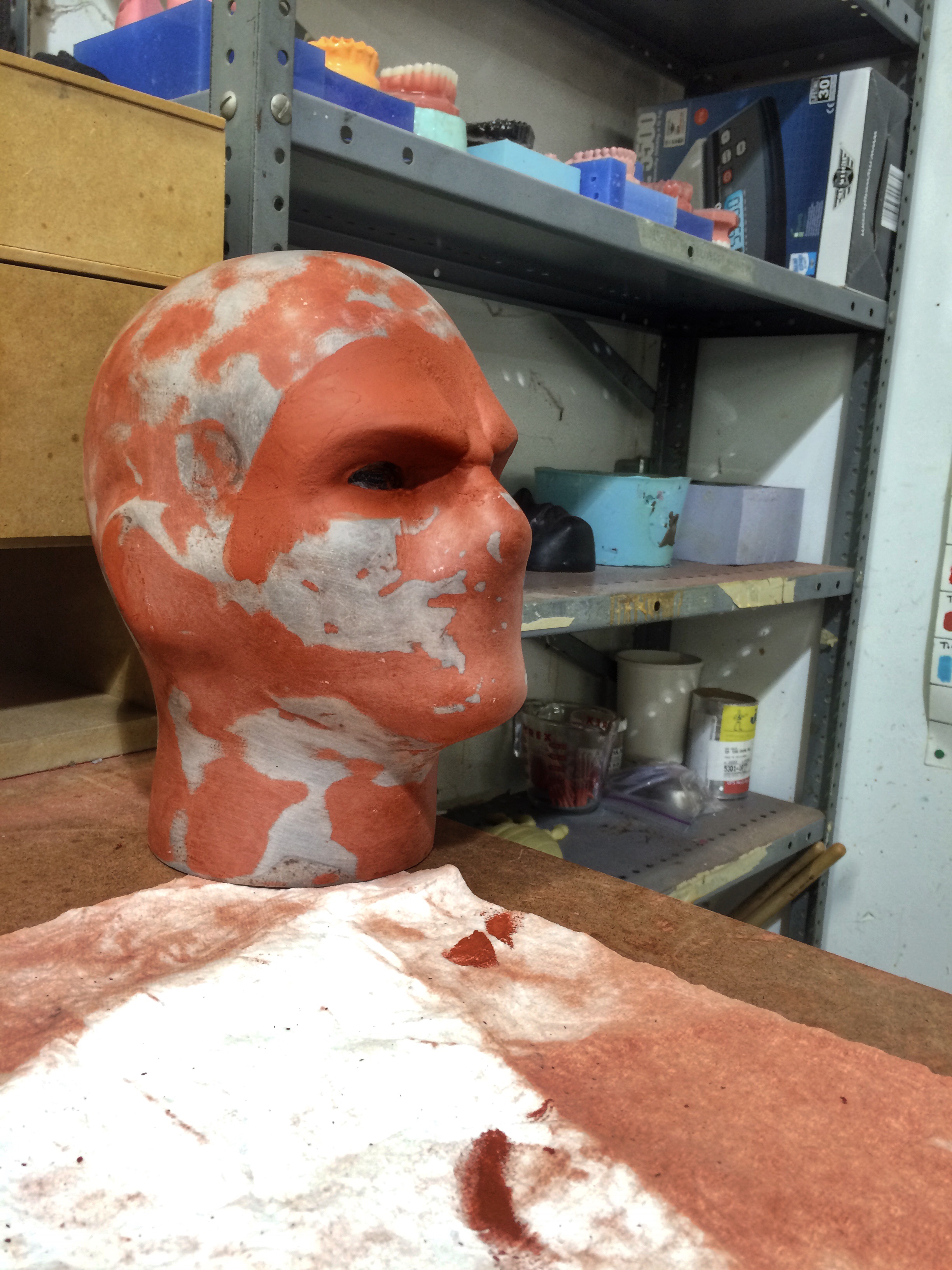

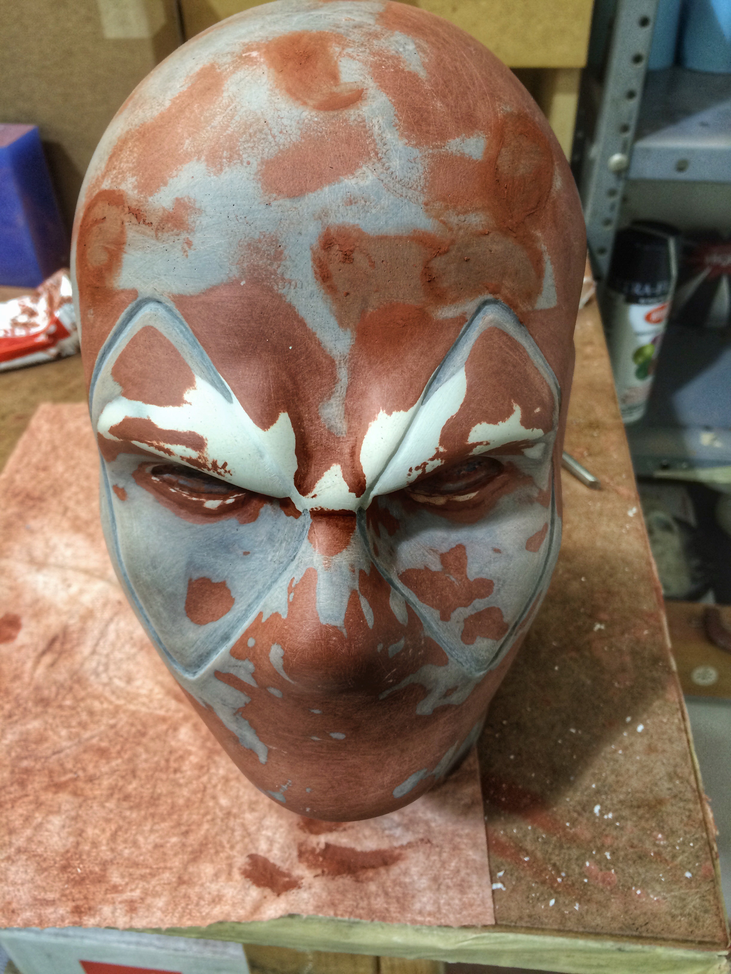

After psyching myself up for most of the morning, I took a chisel to my master and started carving out the black areas. I still need to smooth some spots out, but progress!
Looks great. Can't wait to see final product. Sculpting is a skill I have attempted to learn. I'm always impressed by the talent on the rpf
Alright, got the other side done. Just need to smooth out a few areas, patch a few more holes and add the seams that run from the tops and bottoms of the black parts, then paintimage.jpg.

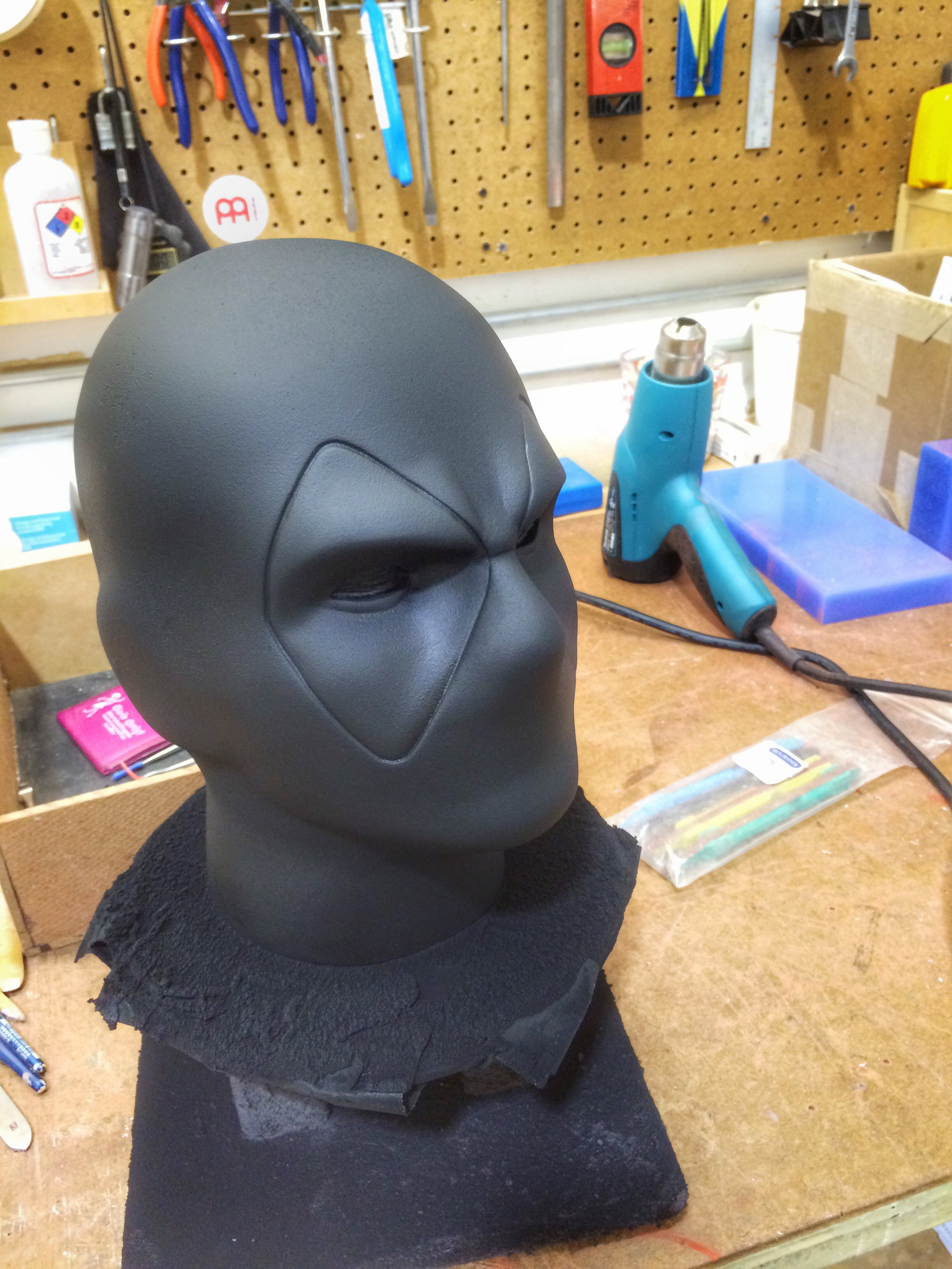

Still need to add the seams, but I decided to go ahead and lay down a couple layers of paint to see how far along I really was.
This is looking great!
Is this going to be a display piece only, or are you going to be looking into how to make it breathable to be able to wear it?
Either way, good work!
Thank you! Yes, I intend to wear this. I sculpted it a little oversized so that it wouldn't be tight against my face, and I'm considering hiding some pinholes in the seam lines for air to get in and out. Though I'm sure there will be plenty of trial and error.

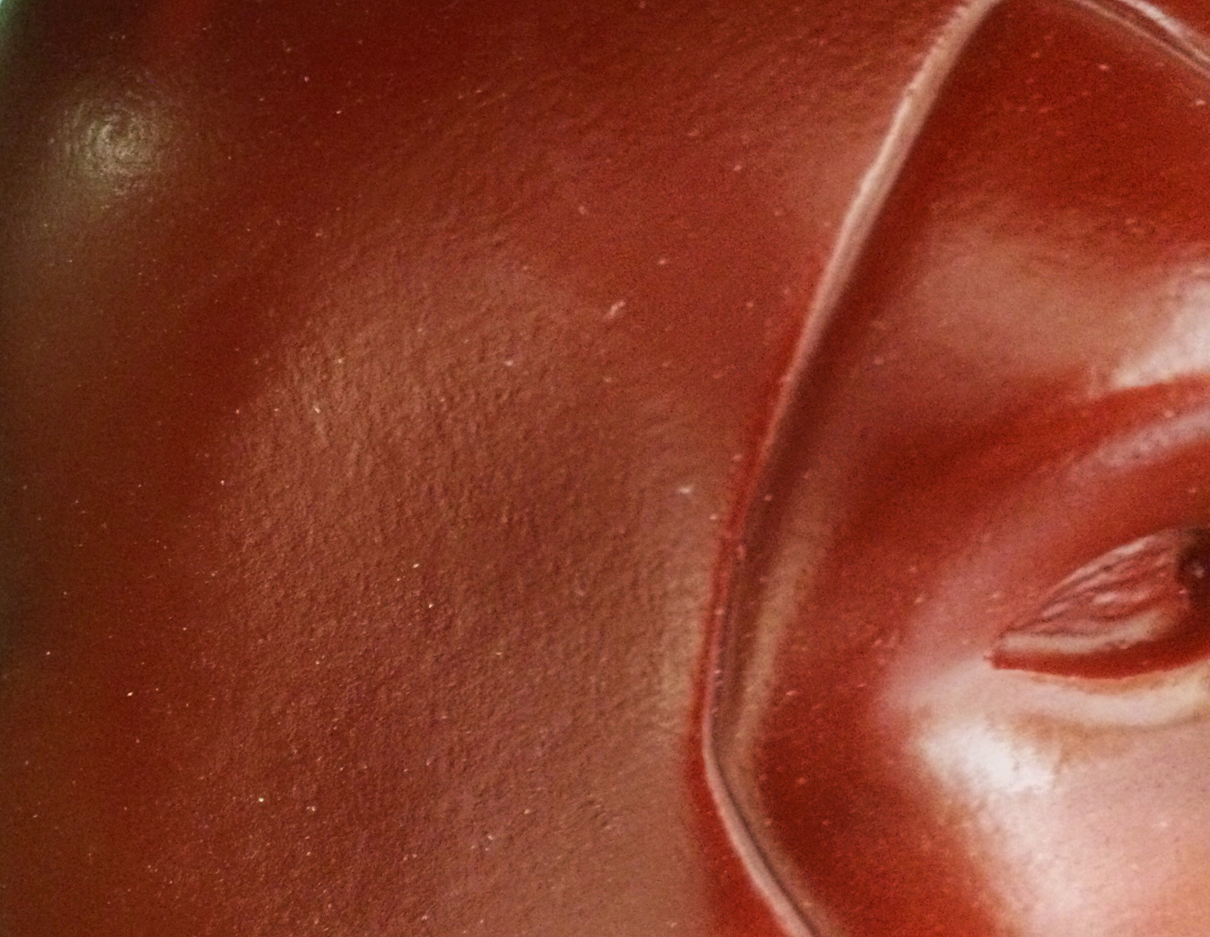

Haven't touched this guy in three days, so not a huge update here, but I ended up redoing the texture this morning. Not quite as "sharp" now.

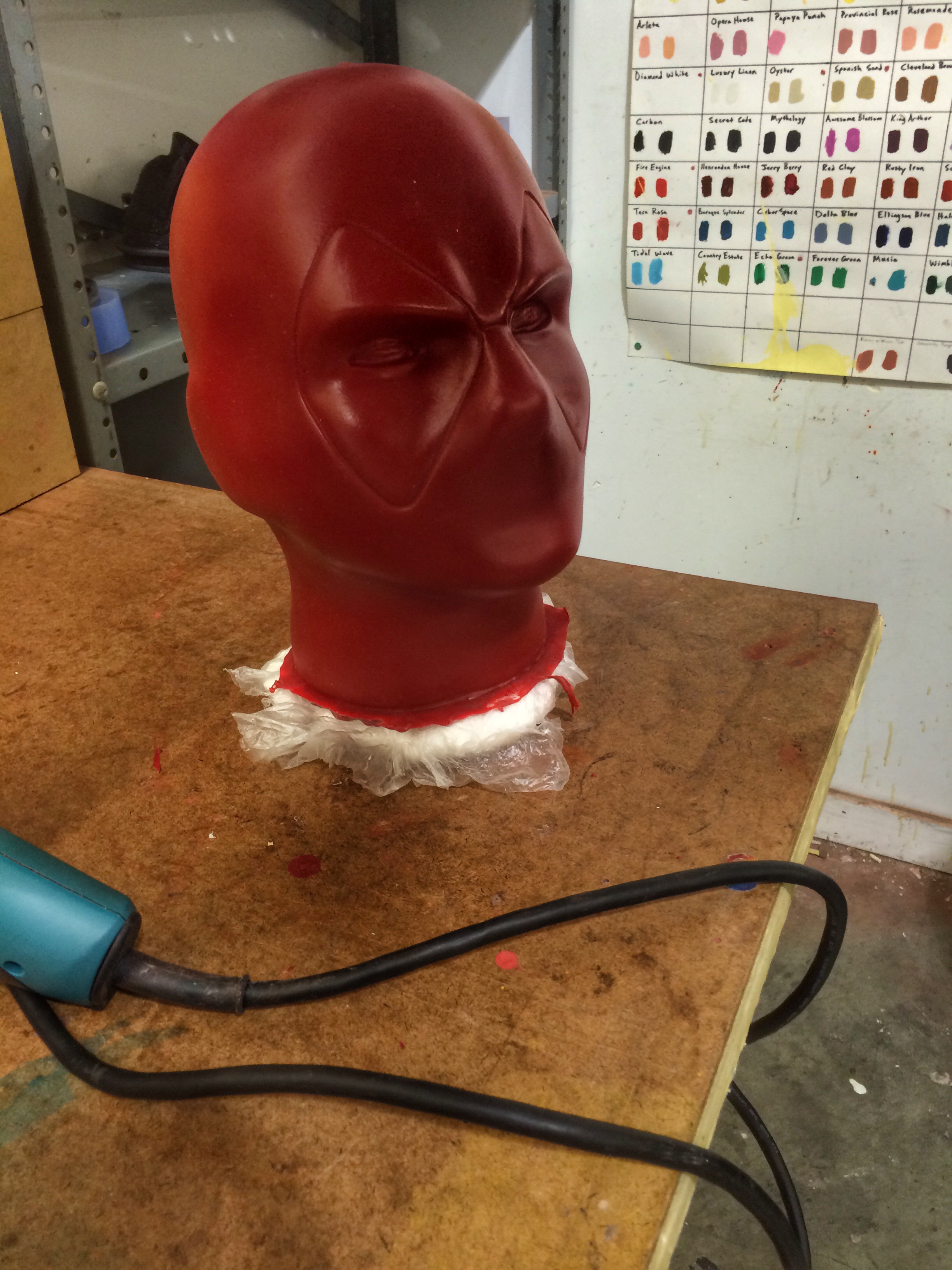

Alright, still needs to be cleaned/trimmed/painted, but here he is fresh out of the mold! The texture is a bit more subtle than I had hoped, I might go back and "dry brush" some urethane to the outside to build the texture back up.
Also, testing out some grommets on a scrap piece of urethane. Leaning towards lacing up the back instead of a zipper like I had originally planned.
