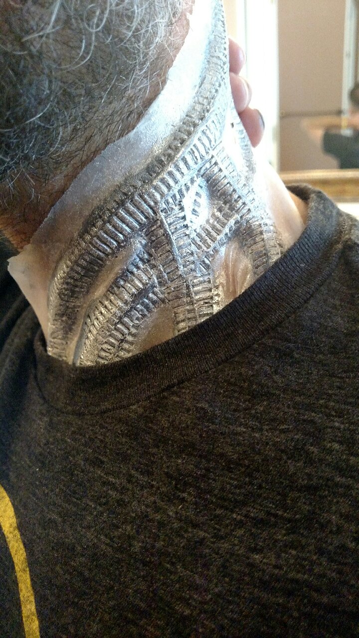

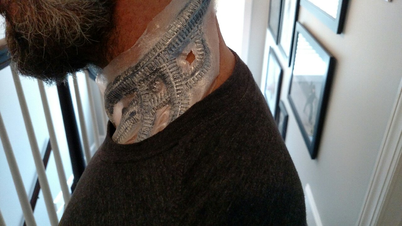

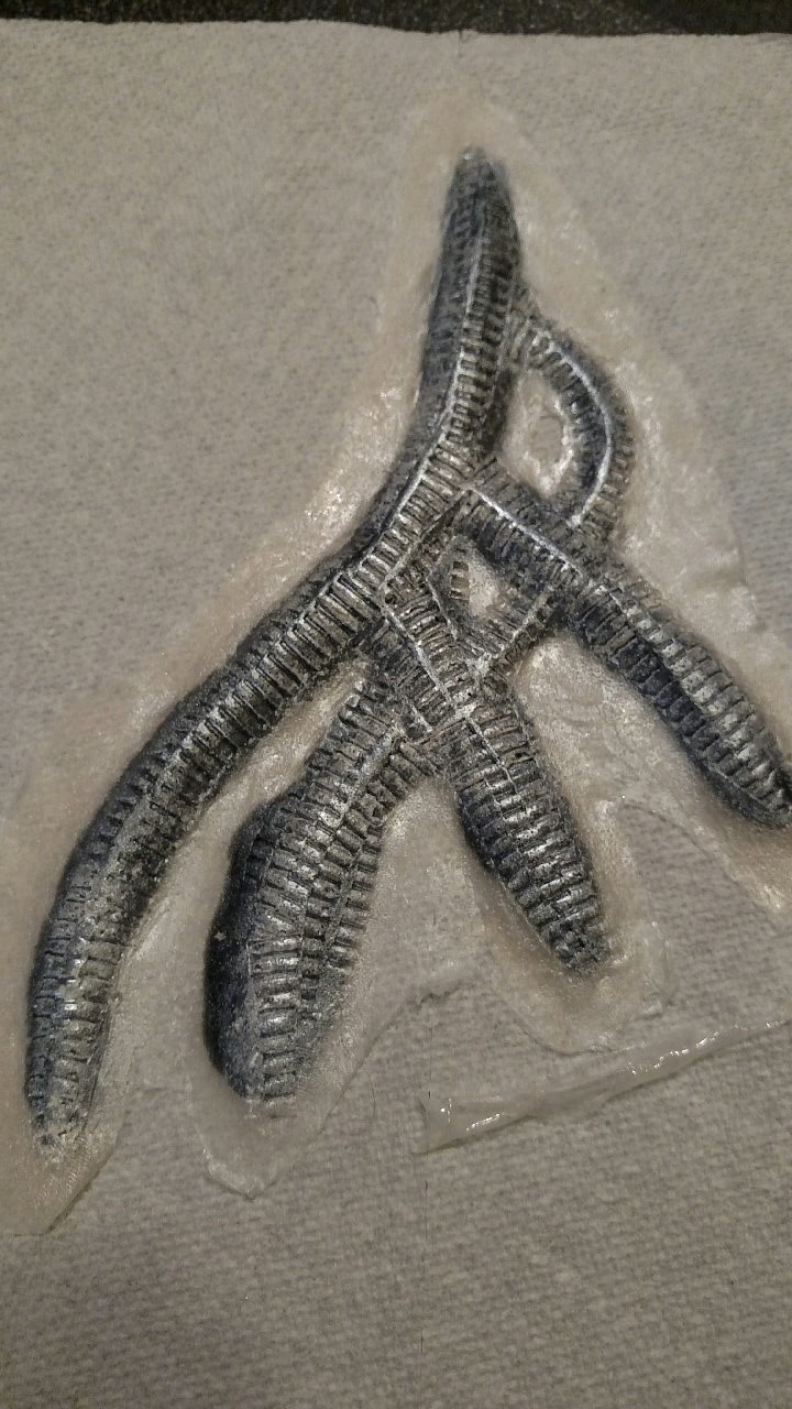

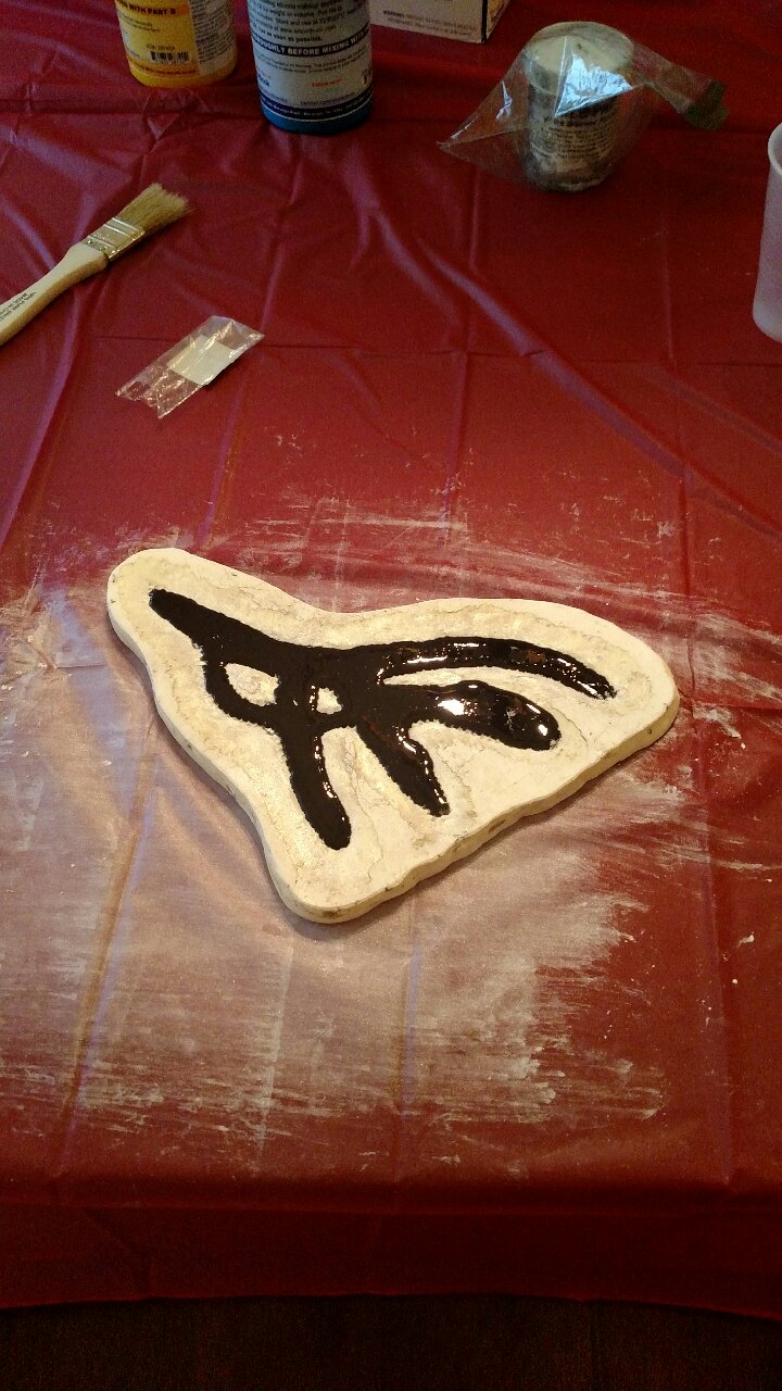

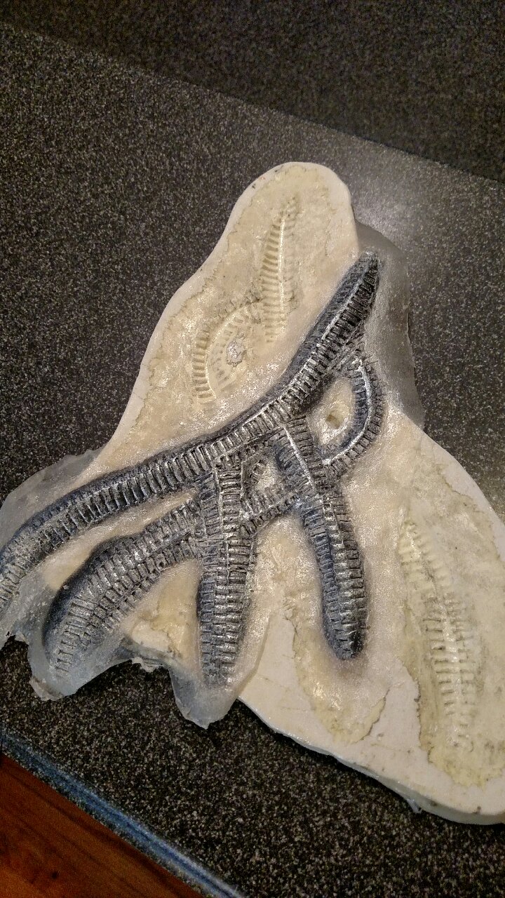

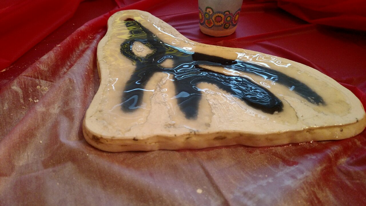

I want to do the "cables" on the neck

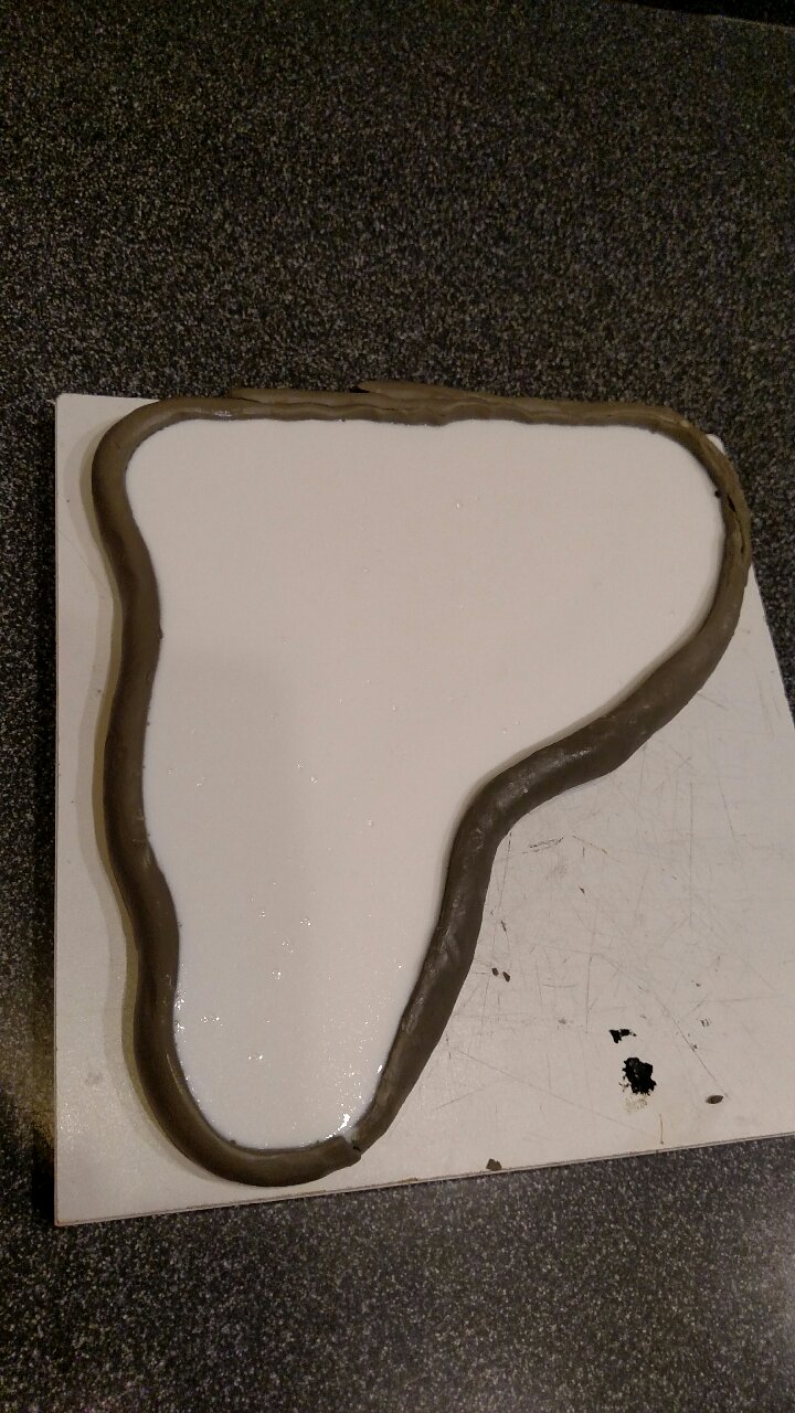

measured up where I wanted it and patterned it.

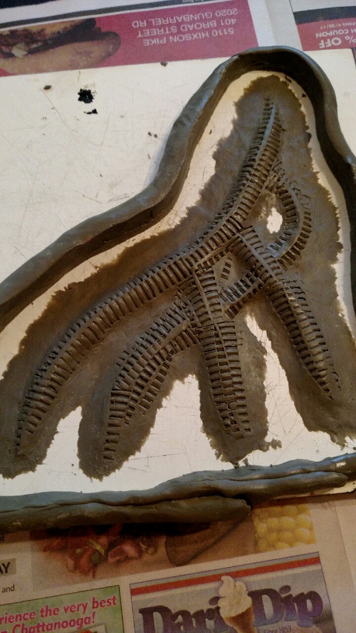

sculpted it in clay
Molded it in smoothcast 300
then cast it in dragon skin fx pro platinum silicone.
Let it cure up and I have piece that I think will be doable .
IMG_20171104_105854307.jpgIMG_20171104_105949296.jpgIMG_20171104_110232924.jpgIMG_20171104_110756664.jpg
It needs some trimming and will be smoothed out when stuck on and blended with some makeup ,but I am thrilled with my first pull on this one.

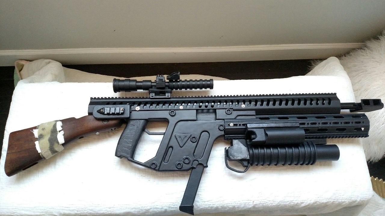

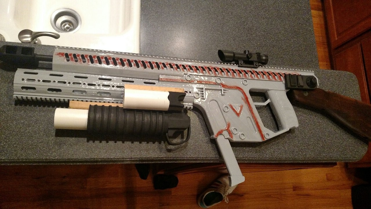

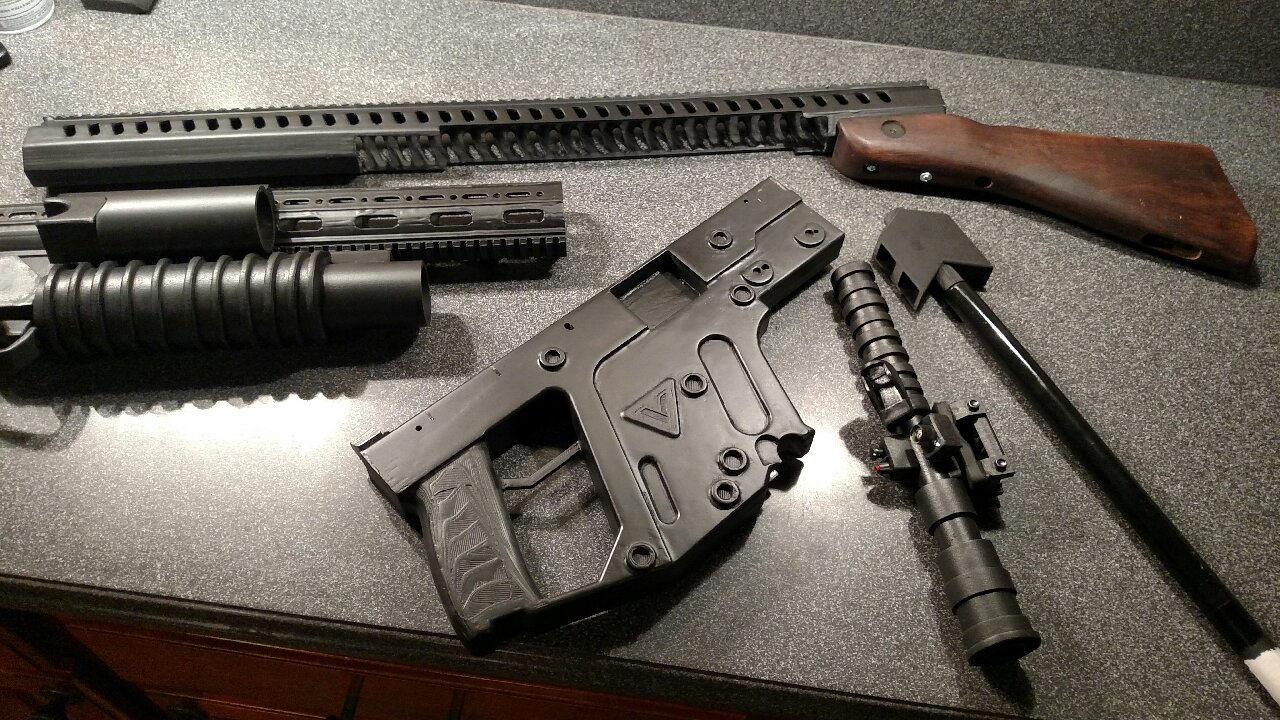

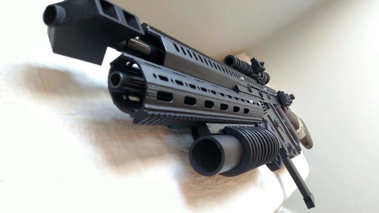

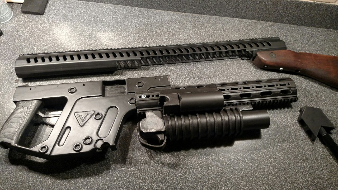

the halves of the vector are epoxied together
bondo applied and sanded
coated in xtc 3d. (nice and shiney)
now a lot of sanding on the xtx 3d to get it ready to prime, and sand some more.....
This is made of plastic almost entirely and is getting some heft to it., I cant imagine how heavy the real one, soulinertia, and zombies is.....
30lbs unloaded when I was done building it. :) That’s when I told the prop master..... “you may want to keep Brolin’s a__ in the gym a tad longer”. Lol

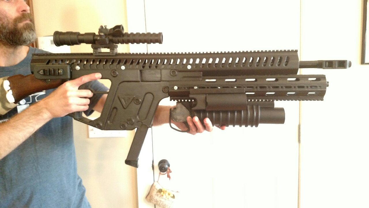

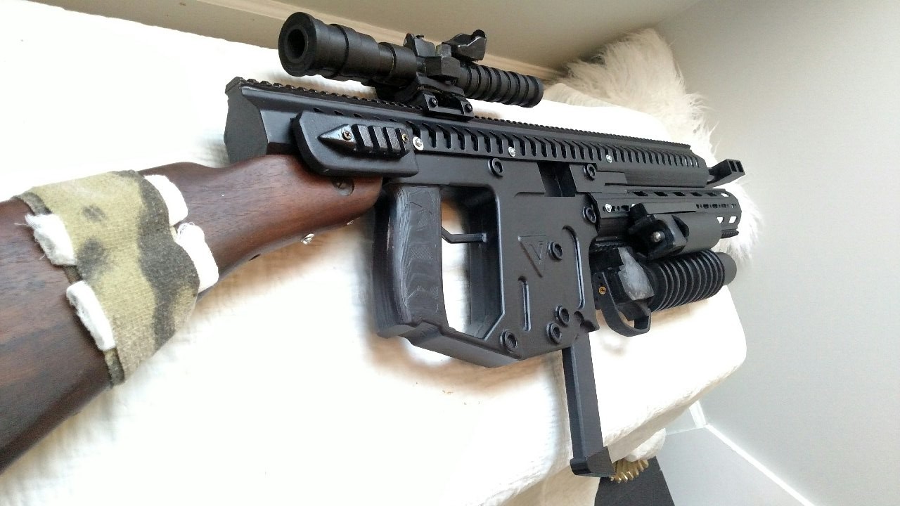

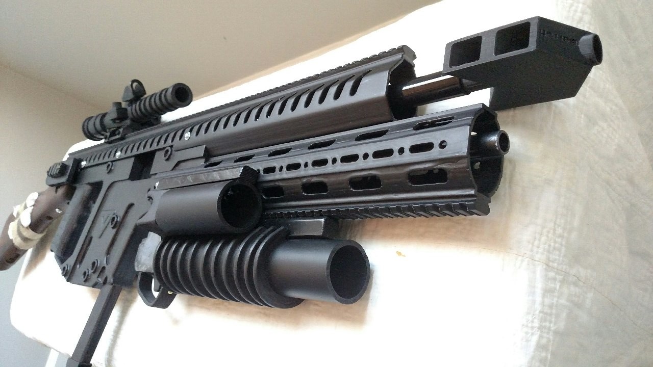

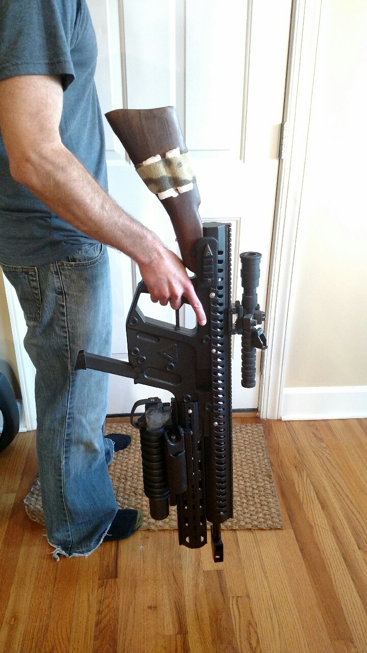

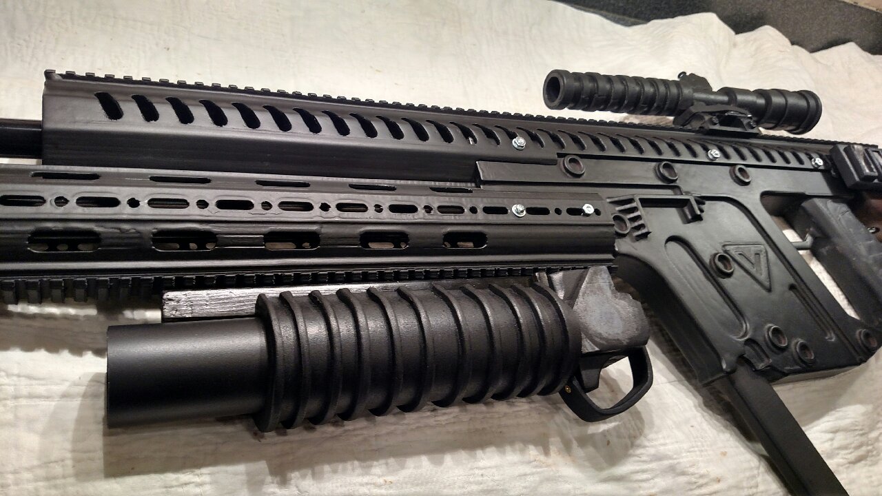

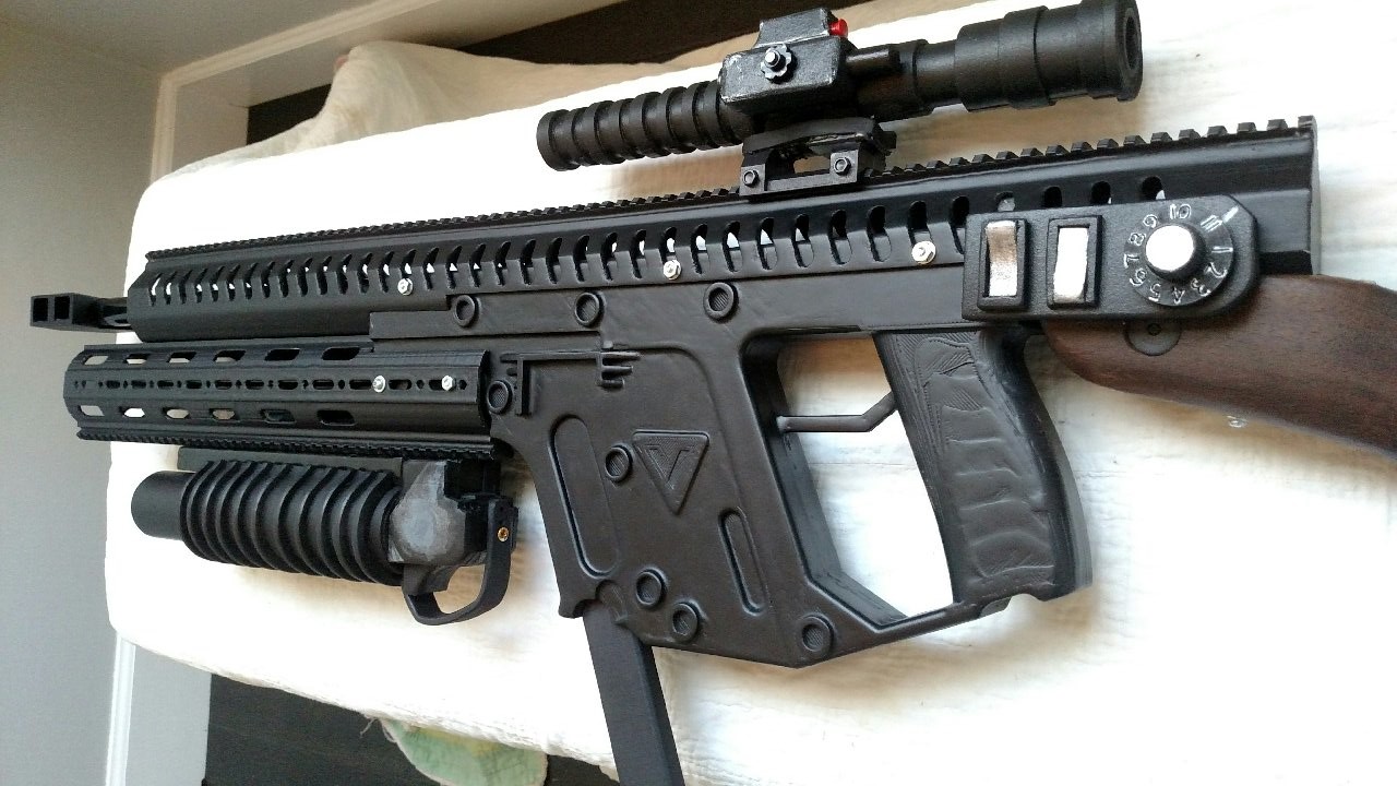

Finally had some time to put it together. Had to drill some holes to put screws in to lock the rails on and the launcher.
it came in right at 43 inches long and the final weight when I get the flashlight figured out will be between 8 and 10 lbs.Its a little front heavy as well.
Krank it to 11 knob 3 d printed , the piece it sets on is foam velcroed into place. picatinny rail and the piece its on is all foam velcroed on.
I cant imagine hauling the real thing around this thing is a beast.

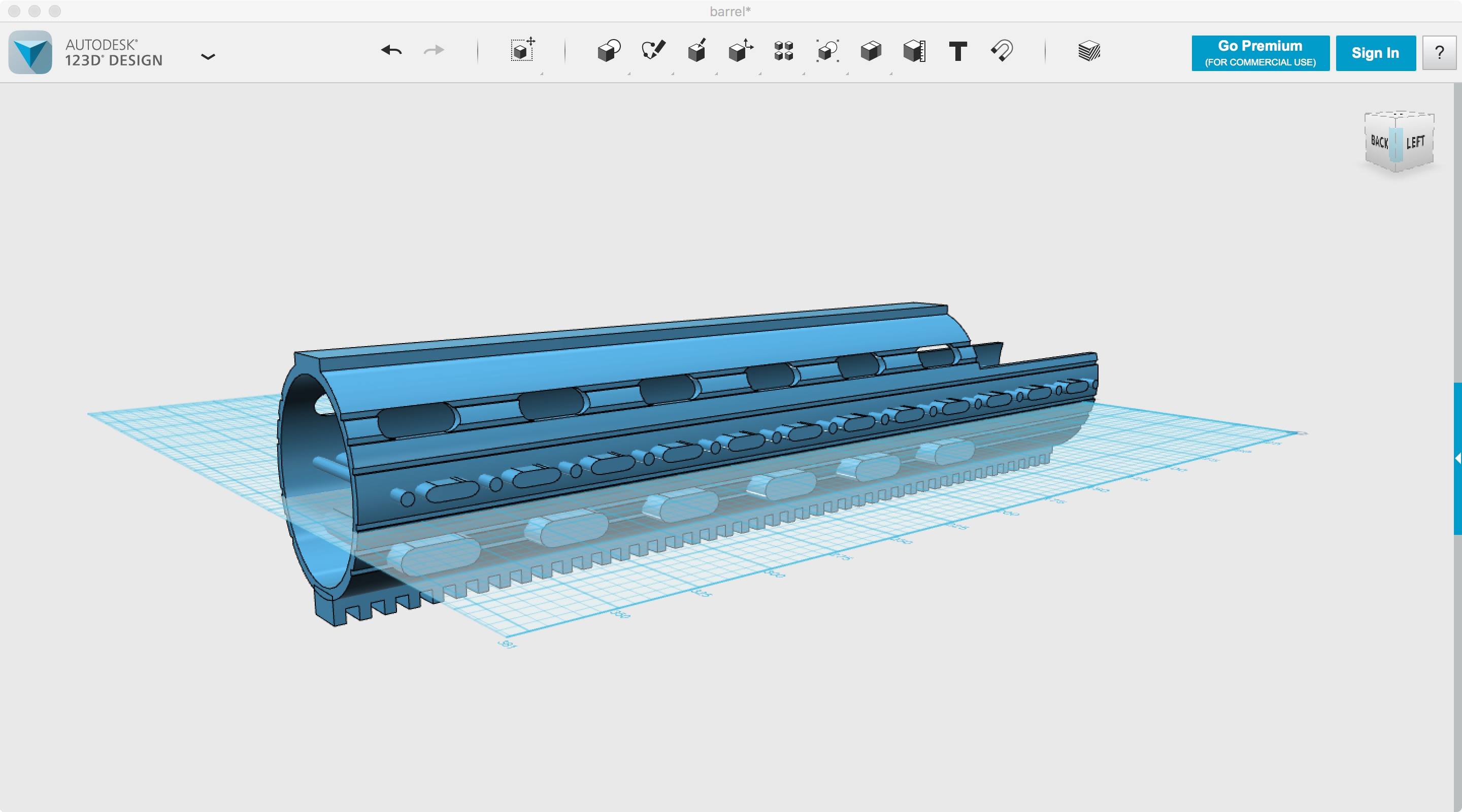

30-40 hours I believe for print time.
Any suggestions on how to mold this ginormouse thing?
I can figure out the base vector, but the rails .... I am not even sure it's possible?

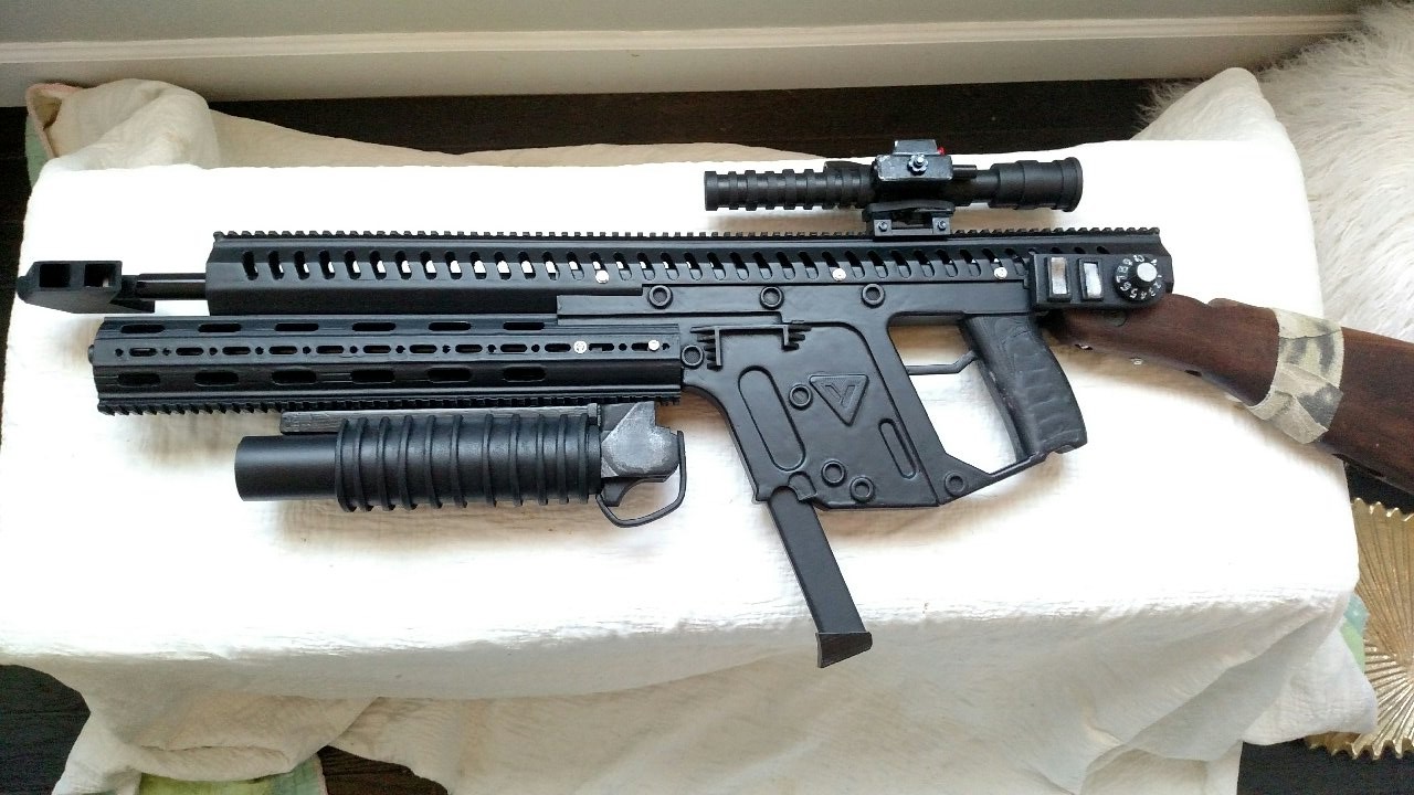

Got the BFG done and now I am finishing up a few details.

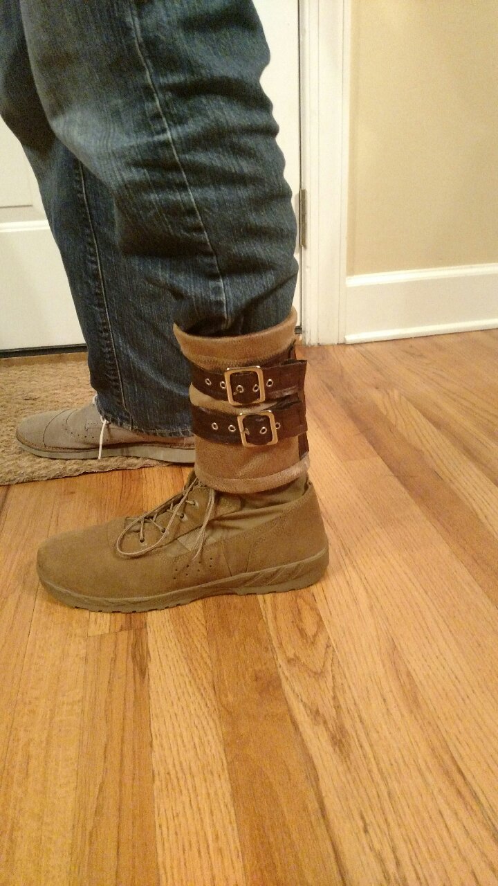

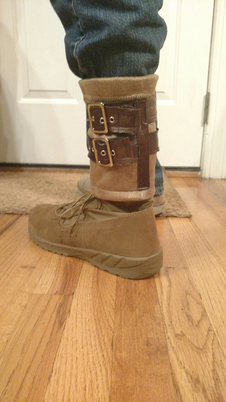

This is my attempt at the boots and buckles
The boots are some rocky lightweight military boots in coyote brown.
not the accurate boots but close.
thougt about just making the straps but needed the boots to be taller so I made the whole "gaiter" set up.

But on the BFG there seems to be another turn it to 11 dial and switch panel on a different part of the gun.
Is this a second switch panel or did it move (transform?)
it is near his right knee. in line with the trigger of the launcher.
