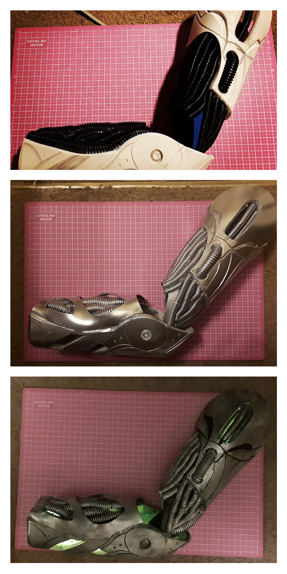

Took a duct tape cast of my sister's arm, made the patterns and cut out the EVA foam. Used plastic wire looms (1/4" and 1/2") cut in half and glued in place for the cables:
Scored the lines with a blade and hit the whole thing with a heat gun. Rivets are made with Dremel.
Coated it in 6 layers of PVA glue/water mixture, then sanded it with 1200 grit and 3000 grit sandpaper:
Spray painted with Rust-Oleum Metallic Finish Bright Coat Chrome (2 coats):

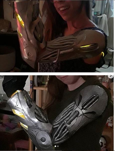

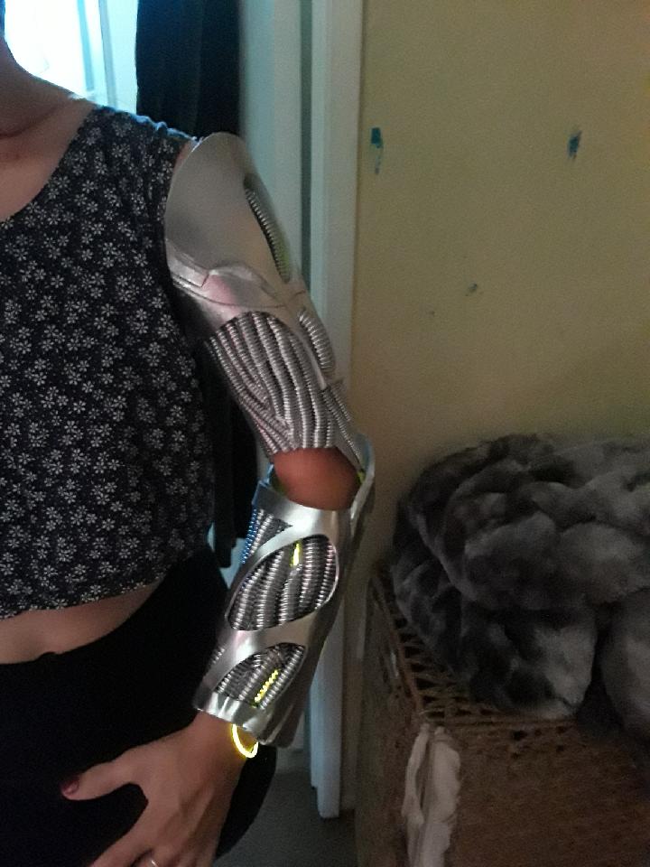

And strung some Yellow EL wire inside and linked the shoulder/bicep to the elbow with some elastic on the inside, then fit tested yesterday, and this is where I'm at:
It fits my sister perfectly! Great movement. And she says it's comfortable.
Not quite finished. Still need to weather it.

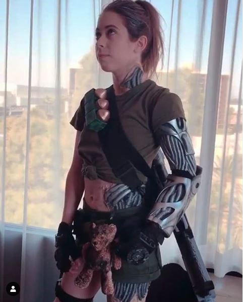

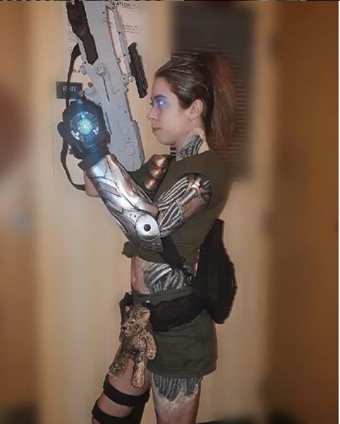

Wearenotlinear
Okay. Forgot to show the finished product on this one too!
Here it is:
1031211
1031212
1031213
1031214
