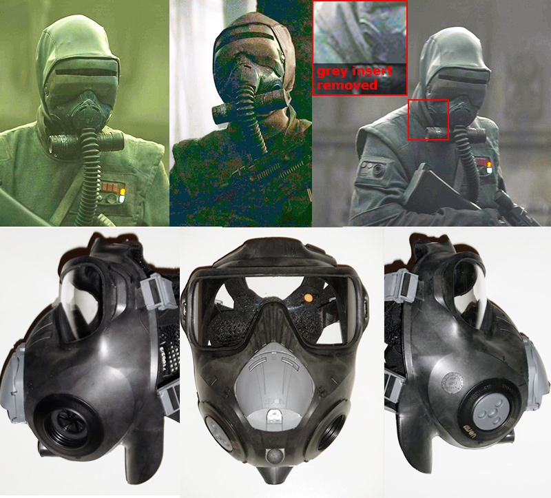

Mask Base: Identified
As presented by Parts of Star Wars two weeks ago
"AVON PC50 Twin Port Respirator" (similar but not identical to the cheaper M50 mask)
I advise to chose either the tinted glasses or something hiding the face regardless the attached visor - no glasses however
prevent fogging
Major difference to the M50 (and why that one disqualifies) is the distinct sharp edges at the cheeks, the snout part
as well as the rims with threads inwards lining the two ports at the sides as well as the missing neck seal at the front.
This is damn expensive as a single item and to get it imported so I would be very thankful
if someone can hint me to a place where I could find a second hand one.

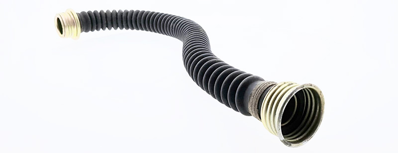

Hose: Identified sort of
These are probably the standard hoses we find everywhere and usually are of russian origin or other former eastern bloc powers.
In that case the mask attachment flange got stripped off and somehow attached/squeesze to the snout piece of the mask and
the rear end stuffed into the "gas maks bag" (maybe fixed with filter?!).
However it might also be another type of similar hoses from other gas masks and other countries.
I personally think though these are real sleek rubber ones and not the those with texture or rubberised fabric which we find a lot
these days. About 36mm diamter and 500mm length.
The russian hoses seem to feature the correct ribbing opposed to the more tight ribbing of the M50 hoses
of the US gasmask for example.

Visor: Unknown
Not much to say yet. It has a distinct shape and it is not clear weathere the details in the cheek area are belonging to the
object or had been added.
So far I have looked for welding stuff but as the vision slits have been cut I am not too sure about it.
The vision ports do vary with some being larger in height than others. Might be a stunt hero thing as well.
Maybe it is a crafted item solely for this purpose as well.
Note the indention in the cheek frameing the "bolt" and "strap" where they are fixed in the cheek area.
In the nose area there seem to be two indentions (like nostrils) as well.
Most scenes give away the ghost shape of the part underneath the hood.

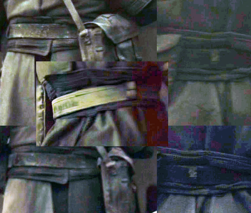

Belt: Unknown
Bright tan or medium green (webbing?) belt with what seems to be outward folded/rimmed edged top and bottom.
Features a loop or something at the rear.
Quite difficult to tell as clear shots are scarce and lighting/blending fools you everywhere.
Using editing software I was able to restore some of the lighting in some shots but only to a certain degree and to match
actual colors is quite difficult.
I am hoping for the illustrated guide to Mandalorian Season 1/2 in june or BTS material to settle this problem.
Sash/Belt/Cummerbund: Unknown
A kind of geen or grey scrim fabric. The same material seems to be used for Lang's (chief of Elsbeth's guard)
more pronounced red cummerbund.
The sash of the guards seems to close at the back (probably with velcro).
Belt Buckle: Unknown
Fabricated from greebles/found parts (?).
Detailed shots are scarce but it allows for replication to some extend. some shots allow for speculation of the existence
of hero and stunt buckles due to some appearing less detailed. Might be illusive as well.
prevent fogging

Belt: Unknown
