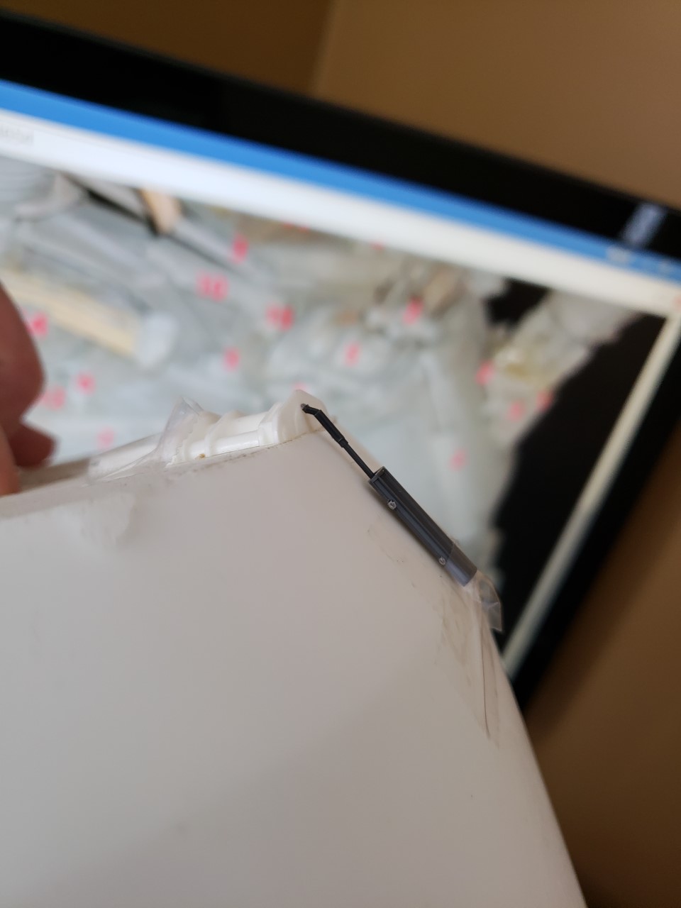

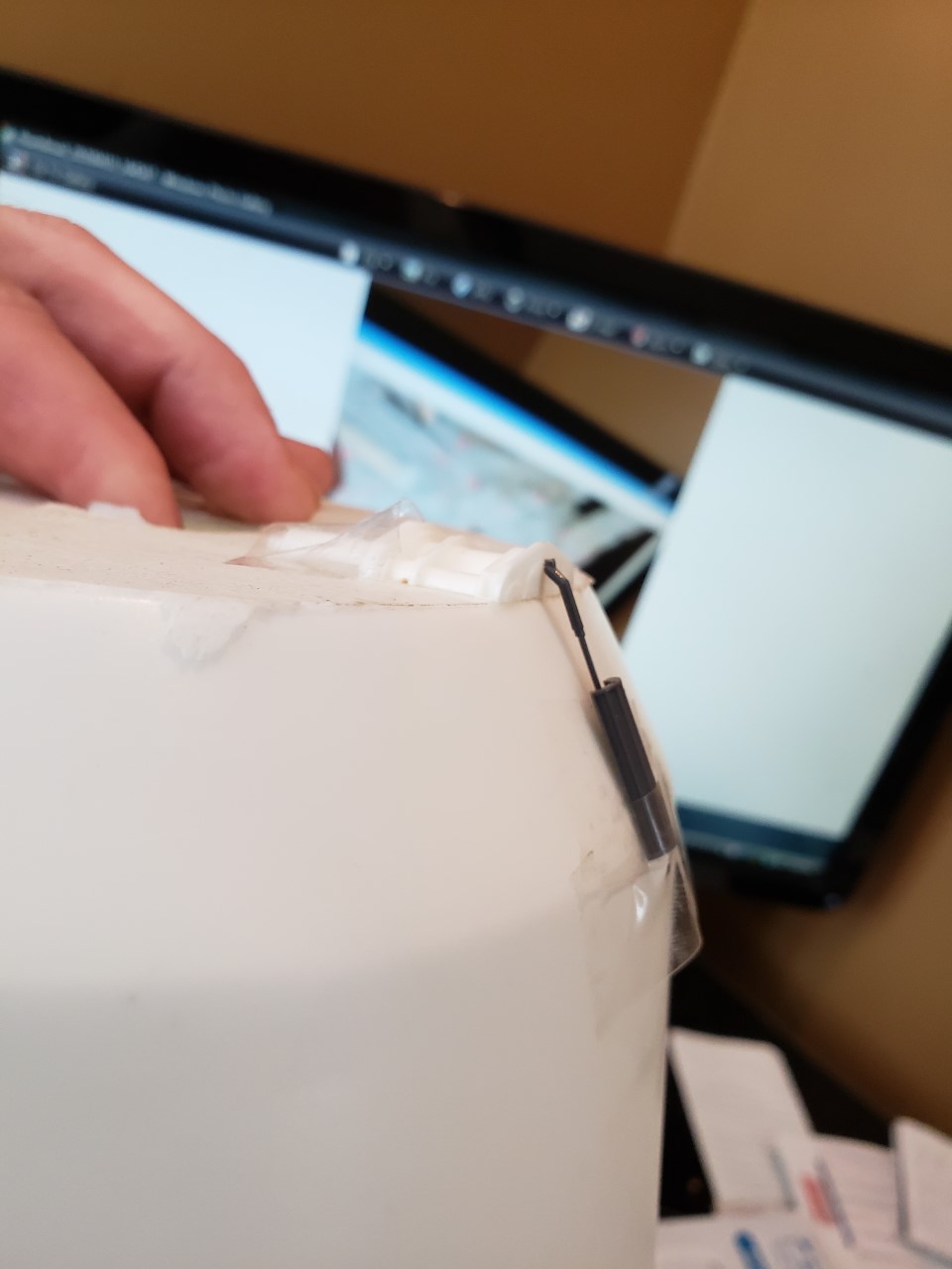

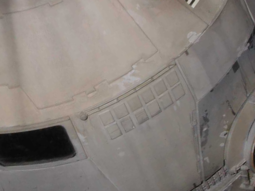

So what do you think.8rad part C40,41?
If you look close you can see the ridge on the ref pic.
Oh man - I think you're right! That sure does look like it. It would make sense too, lots of 8Rad parts on the rear end.
Dan
(ETA - Darn, I'll just have to live with mine without that addition - not sure I can strip away the parts I have there now without ruining or breaking things.)

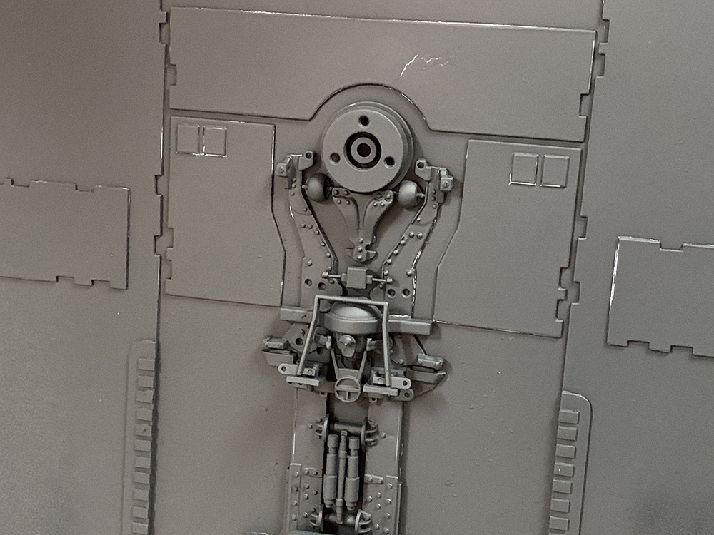

Starting in on my practice piece to get used to putting on the primer. t2sides recommended the black primer he used on his Falcon so I'm going with that. I'm glad I did this test on the practice piece first, because my first coat of the primer out of the can resulted in a pretty poor result. I was so worried about 'flooding' the detail with too thick a coat that I erred too far in the other direction by lightly 'dusting' on very light coats. The problem with that is that it leaves a dry, 'dusty velvet' texture across the model. After cleaning that up by 'buffing' the piece as clean as I could with dry paper towel I tried a few other options, including spraying some primer into a catch cup and then using that, thinned, through my airbrush. That worked a bit better, but can still leave the dry, 'dusty velvet' texture to some degree if you are again too timid with laying on the primer.
After a bit of trial and error I think I've gotten the feel for the right amount to coat on - just enough to leave a bit of wet shine to the surface. It then dries back rather nicely to a smooth surface.
Here I went just a tad too heavy and left a few minor drying cracks in a few places (and there are some dust specks left from the paper towel buffing stage), but I think I now have a feel for the right coat level. So, I'm glad I build this practice piece - it is serving its purpose very nicely, allowing me to make mistakes here first while learning, hopefully, how to do it right when I get to the actual escape pod model.

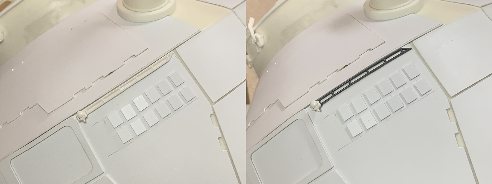

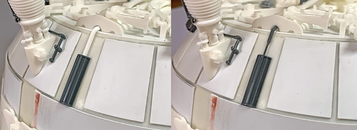

I had originally put the little U-Boat railing greeblies on upside down relative to what is on the original ILM model. I was looking at images of someone else's build in addition to the reference images of the original and for that particular detail the other person's build had it upside down. Every other detail on that one is absolutely wonderful but it led me astray for mine, so I corrected that today with parts from an actual donor kit. Here is one of those greeblies on the original ILM model and my fix:

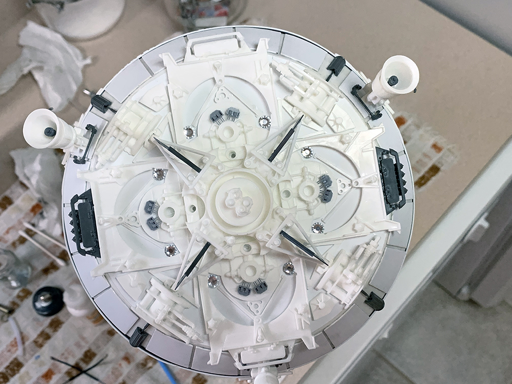

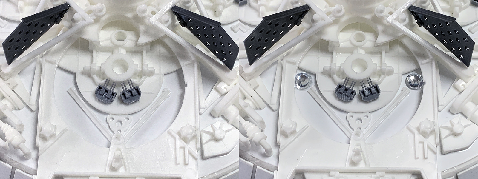

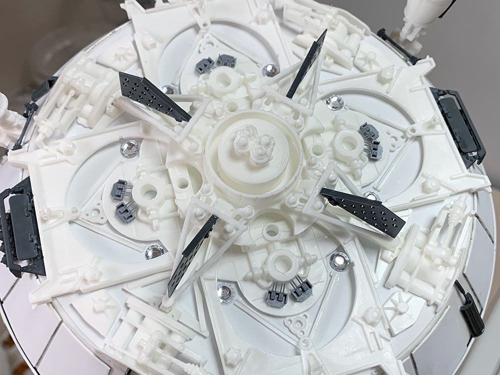

And then I wanted to get the little faceted jewel bits onto the rear end:

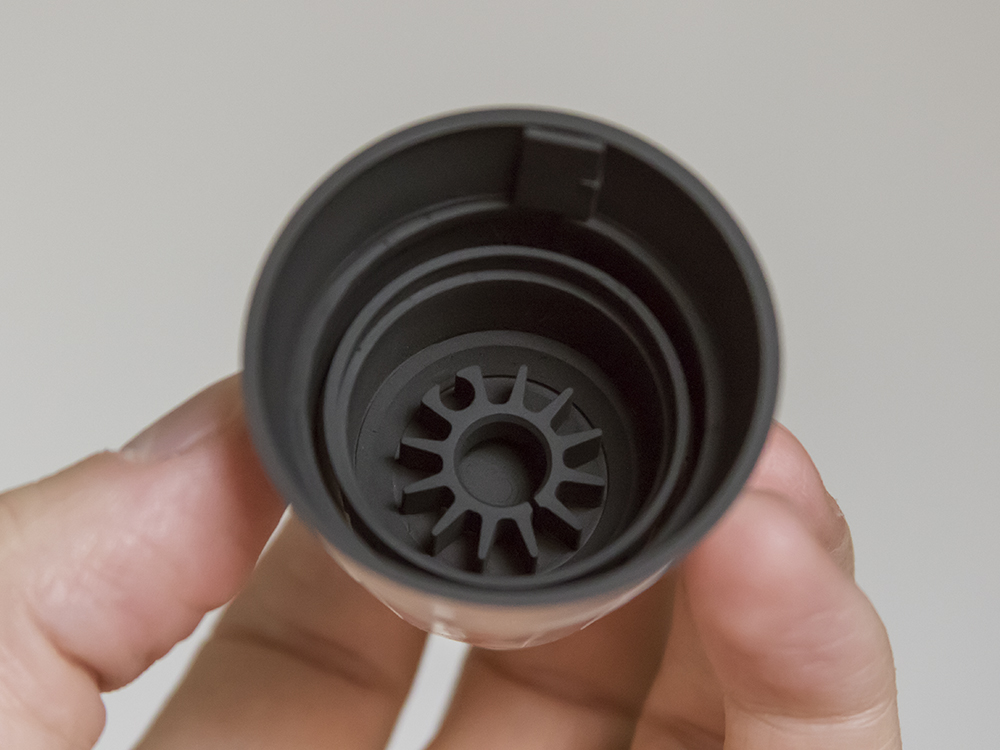

As long as I had the airbrush out for another job I decided to give the inside of the main engine nozzles a shot of primer.
