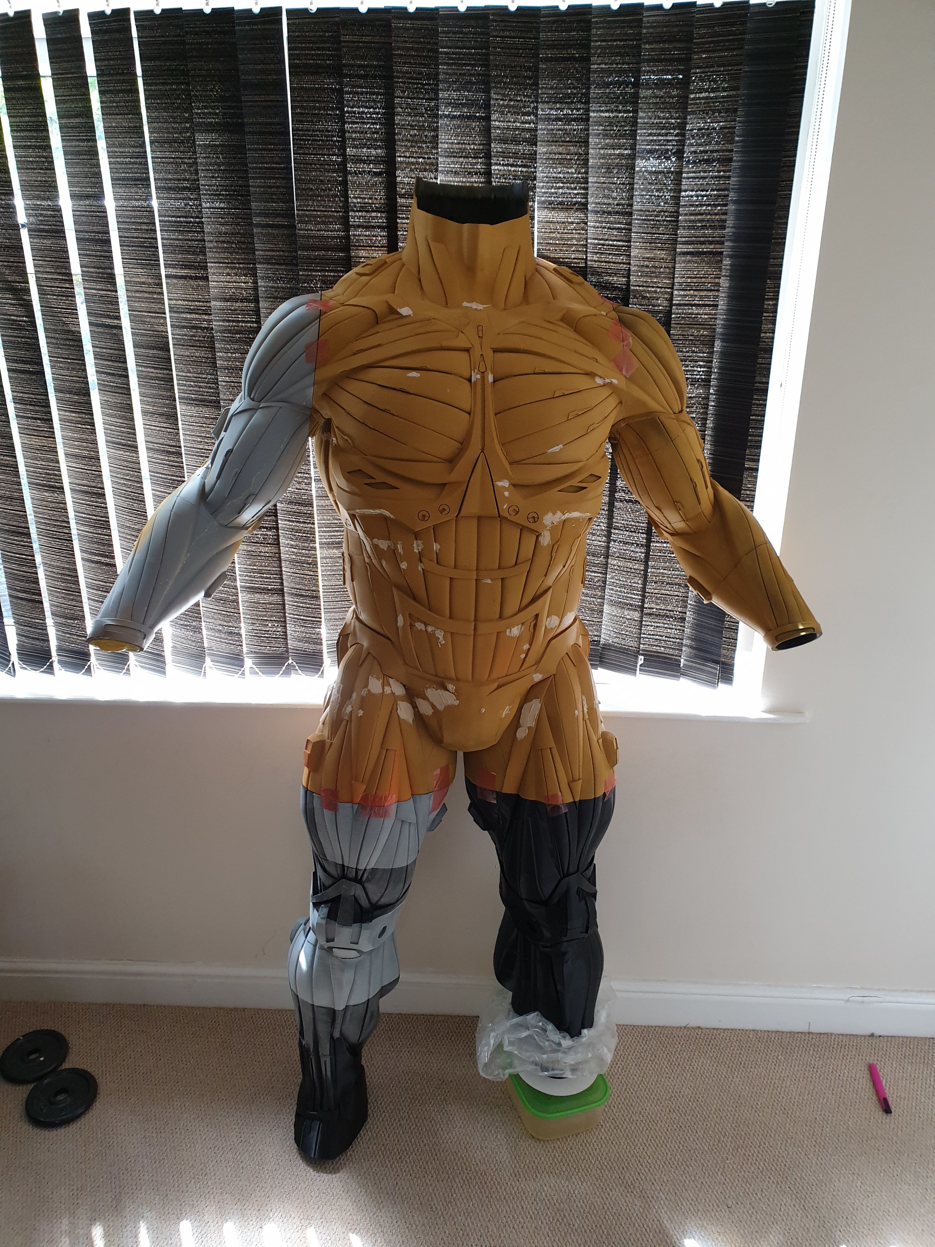

Costume is 3d printed in 95% - need boots only.
I made 4 latex casts of arm and soon will start making mould of torso.
I am happy about using body filler . You do not have to use it with 3d printed parts because later I will make clay copies and this will be very easy to just smooth and fix using tools and clay. You can see one arm is with big gaps and line because I will fix it later when will make it from clay
I am not sure where I will put all this parts to be honest. I need to make mould for 3d printed , then make clay cast and another mould using plaster. Basically will have like 3 full size costumes in pieces + copies from latex.

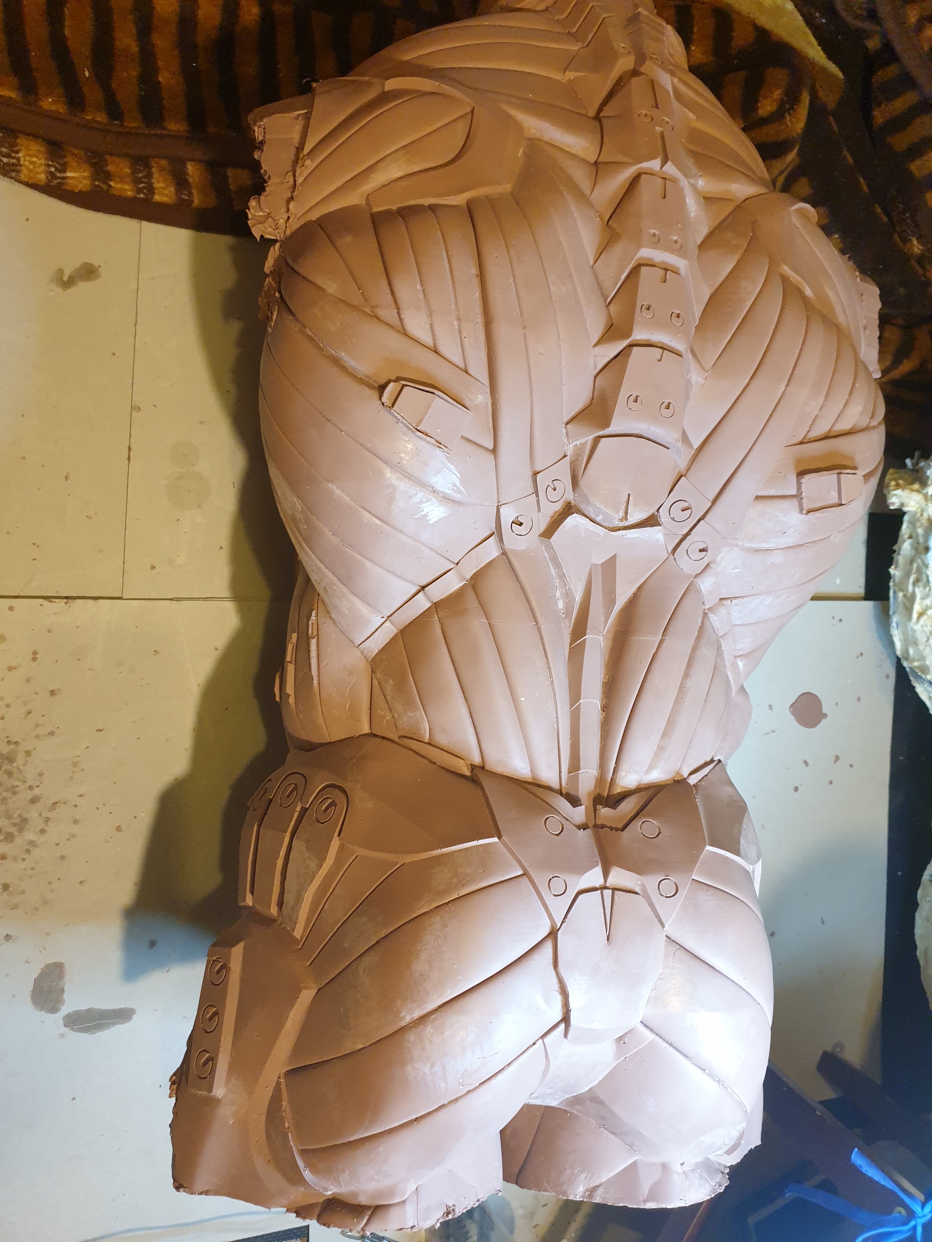

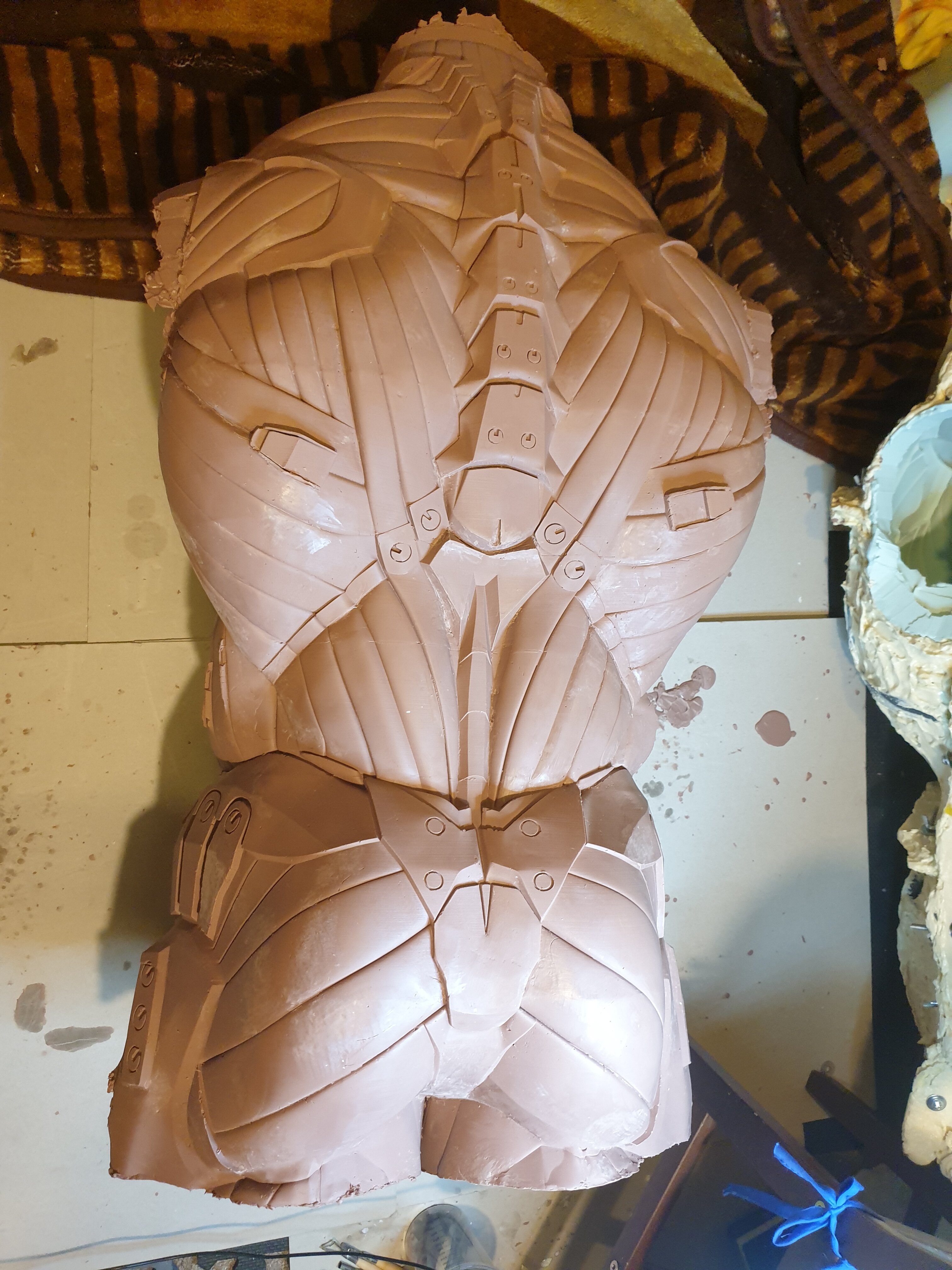

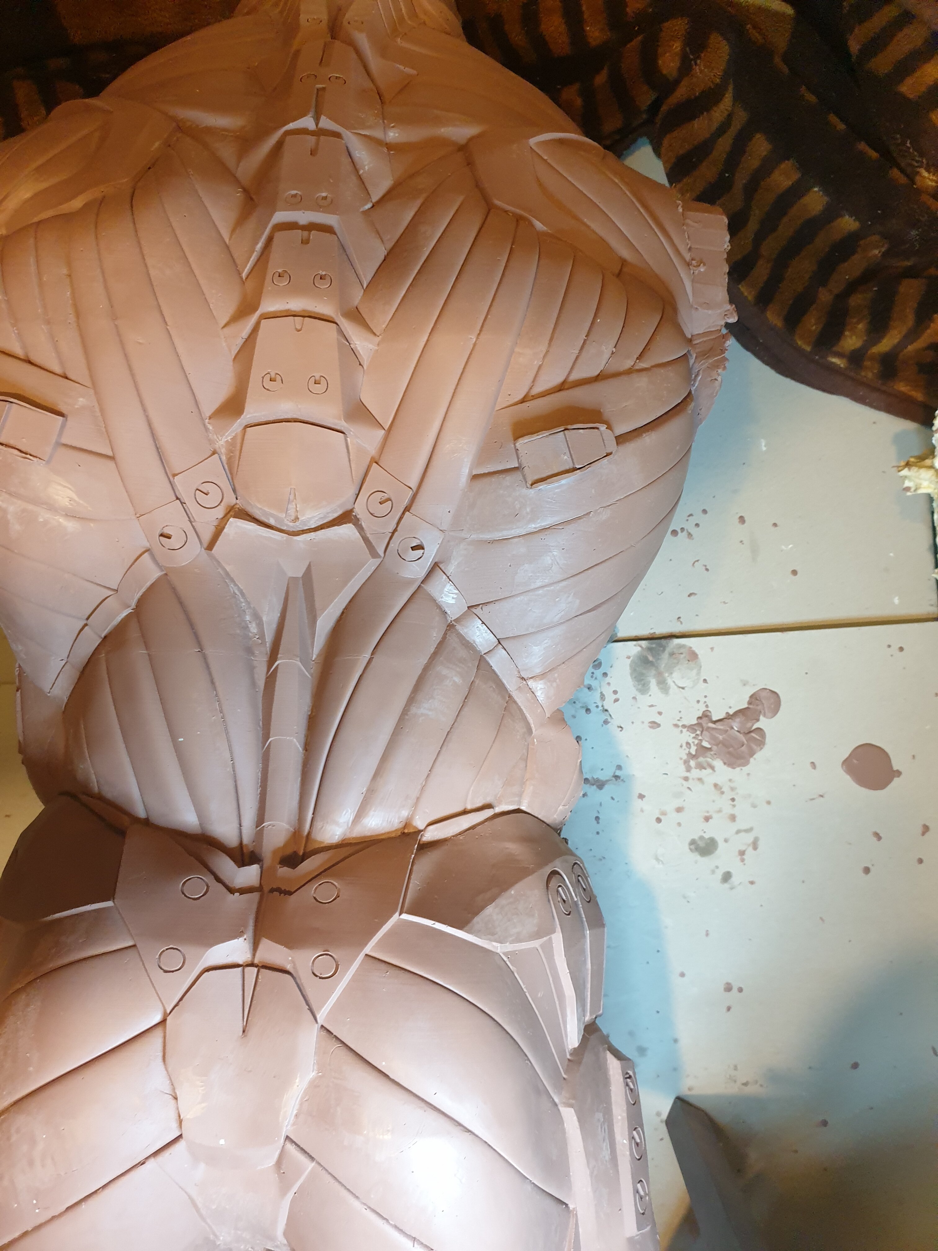

I made second back piece using almost all Monster Clay -around 15-20 kg.
Most of bigger holes and broken pieces are fixed and will start plaster mold tomorrow .
