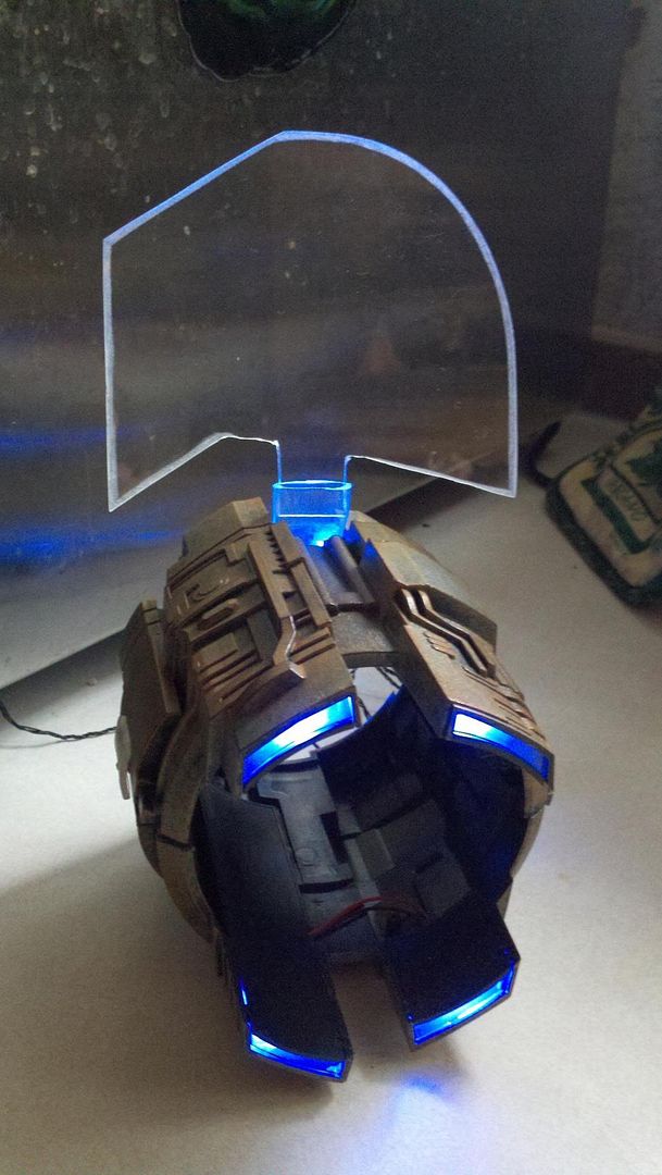

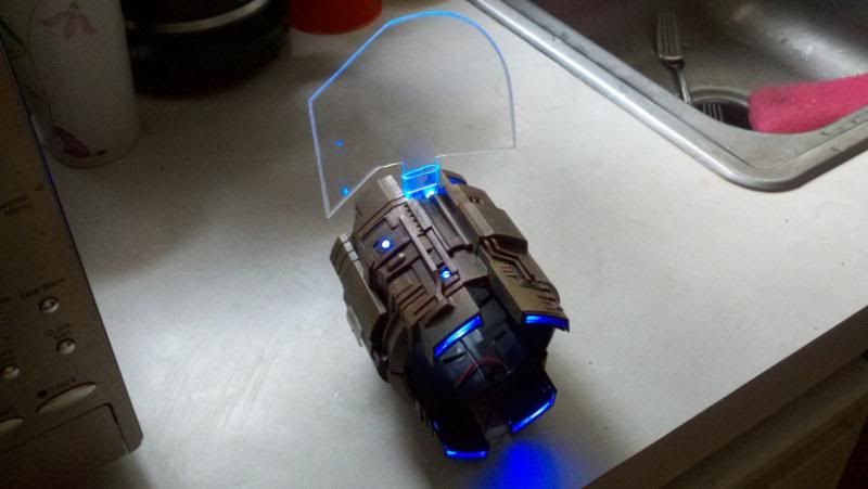

This is a test to see if the lights look decent.
and a test of the entire thing together

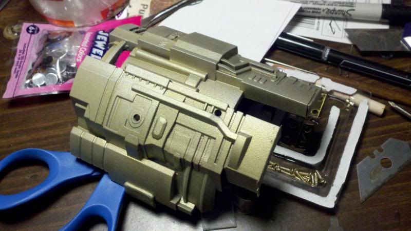

A later test with the led holes drilled, and most in place, just taped in for now.
Base rattlecan color coat.. Brass, with a light dusting of flat aluminum.
