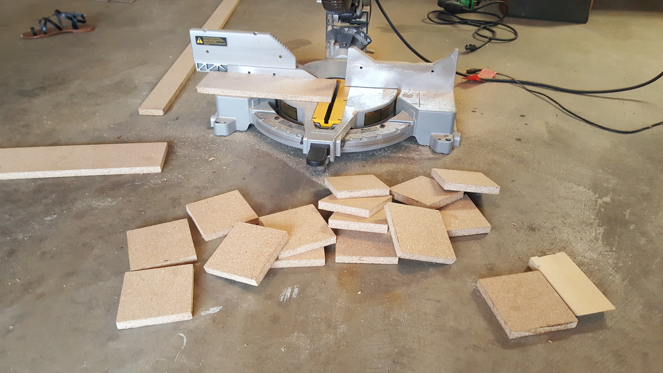

Do you know what the measurments of your wooden base are? 20160803_190435.jpg20160803_190435.jpg

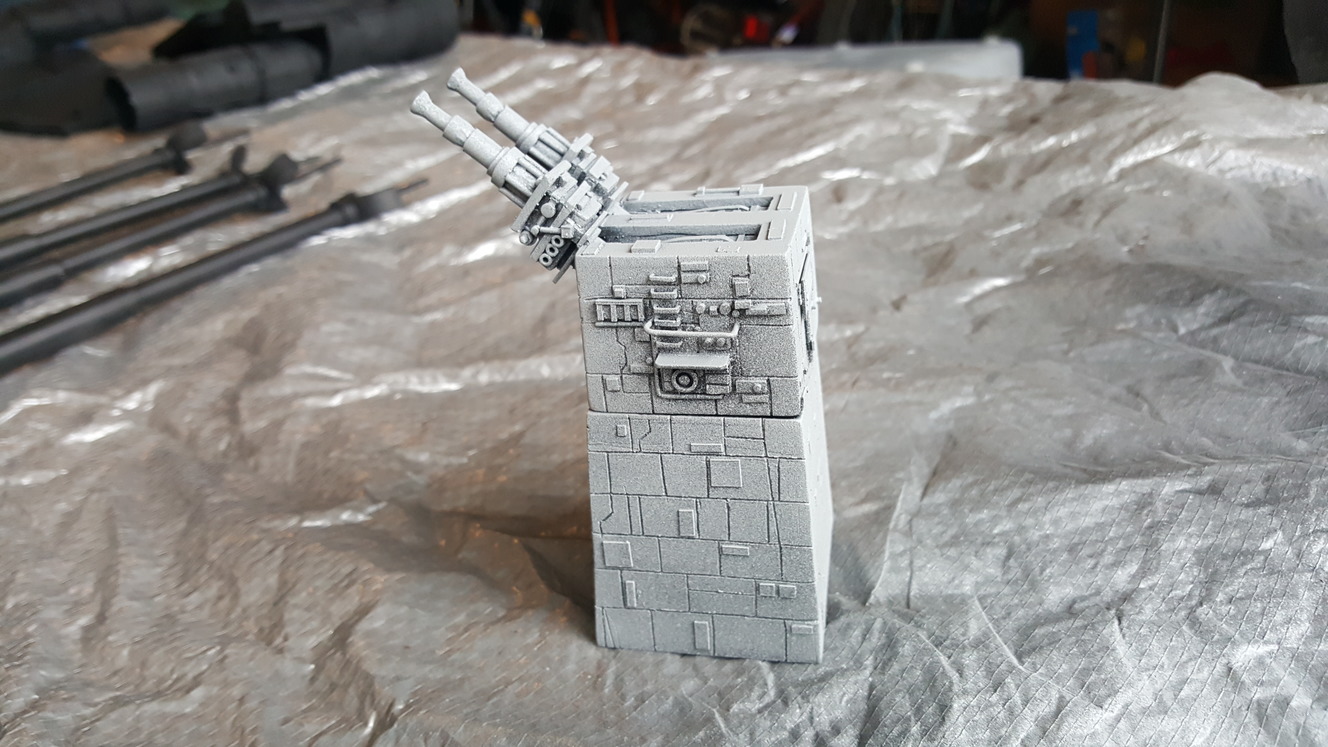

Do you know what the measurments of your gun tower are ?20161103_165716_001.jpg
Last question what are the measurmments of each square block are ?20160921_181156.jpg

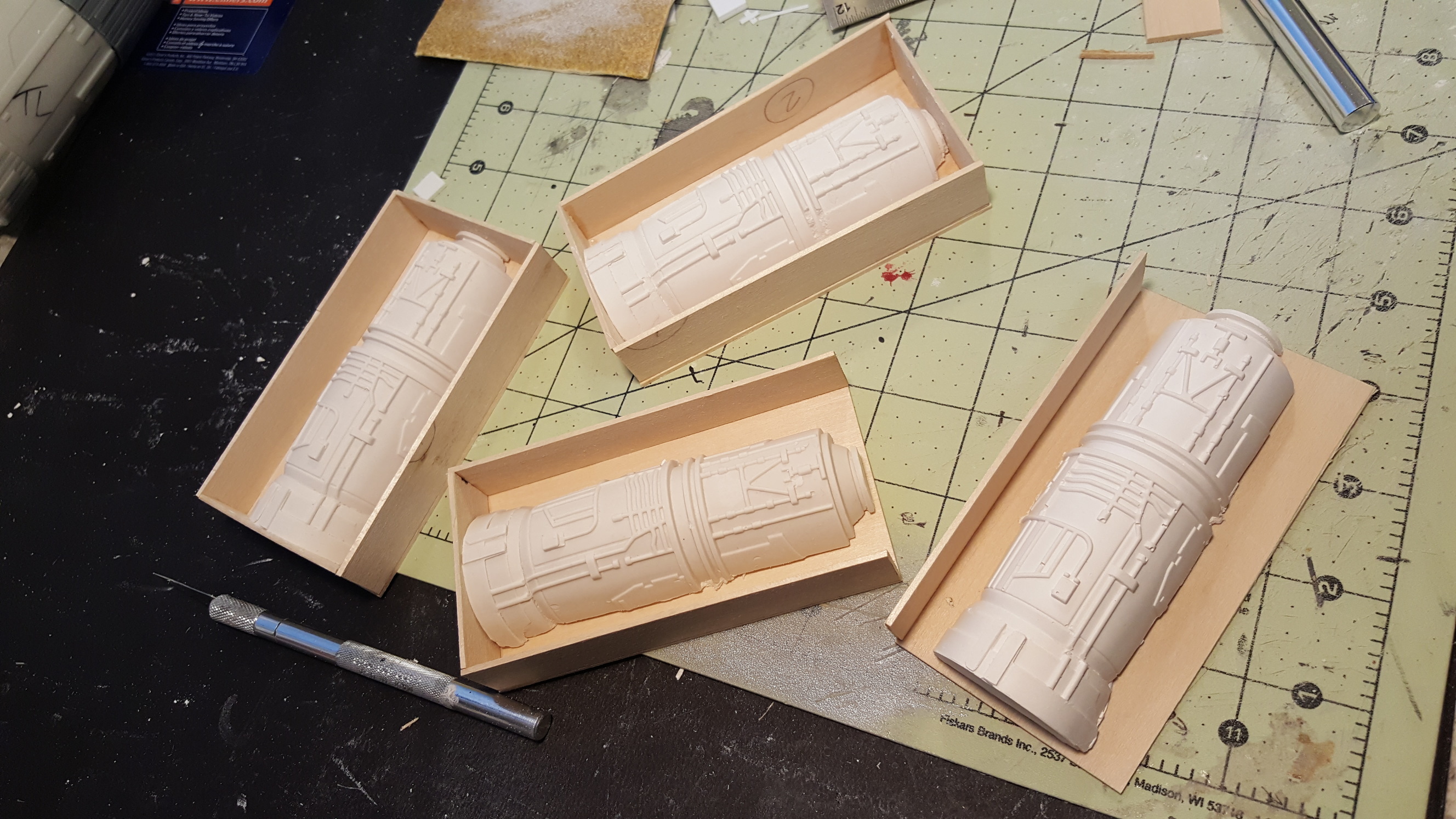

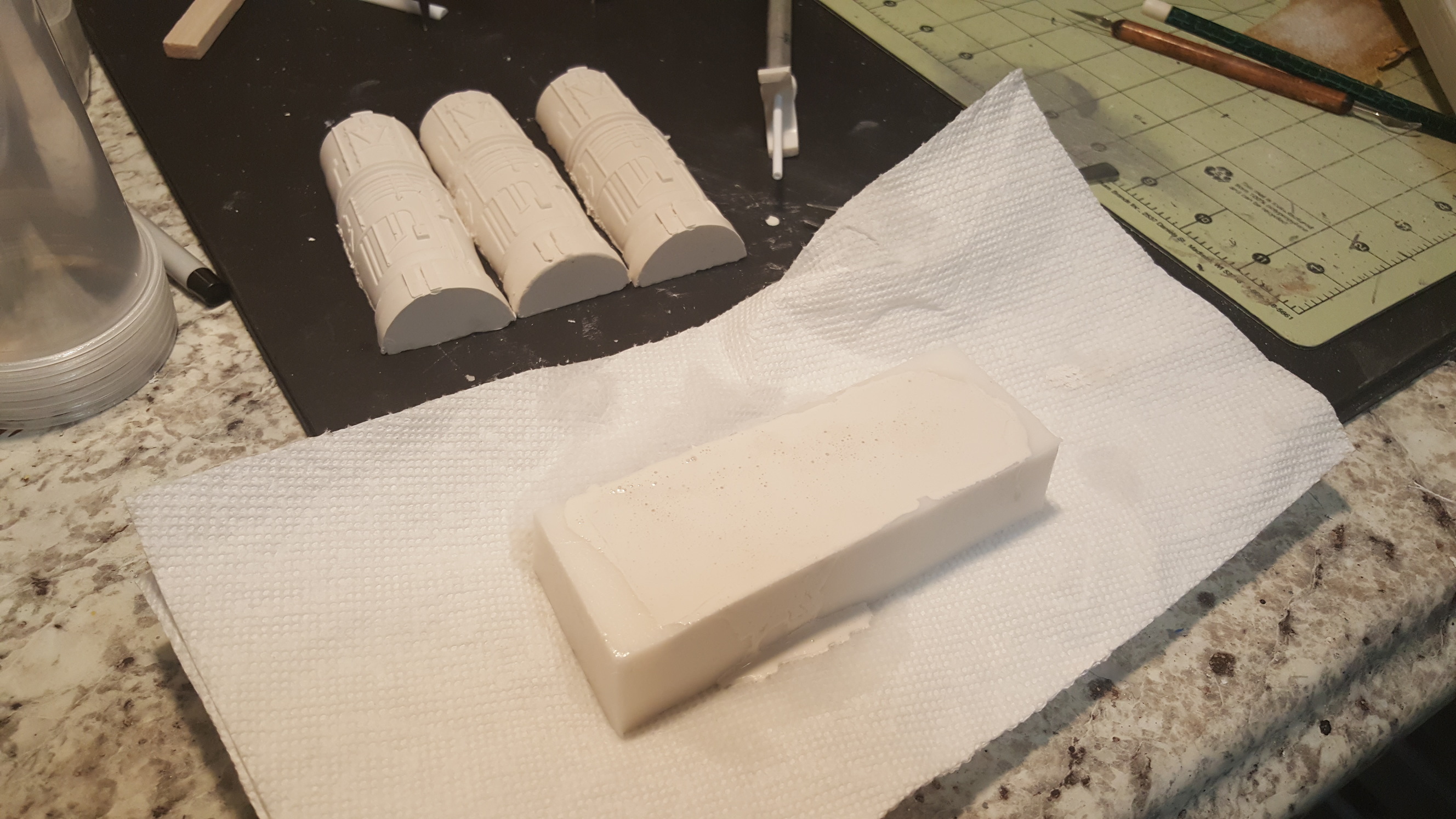

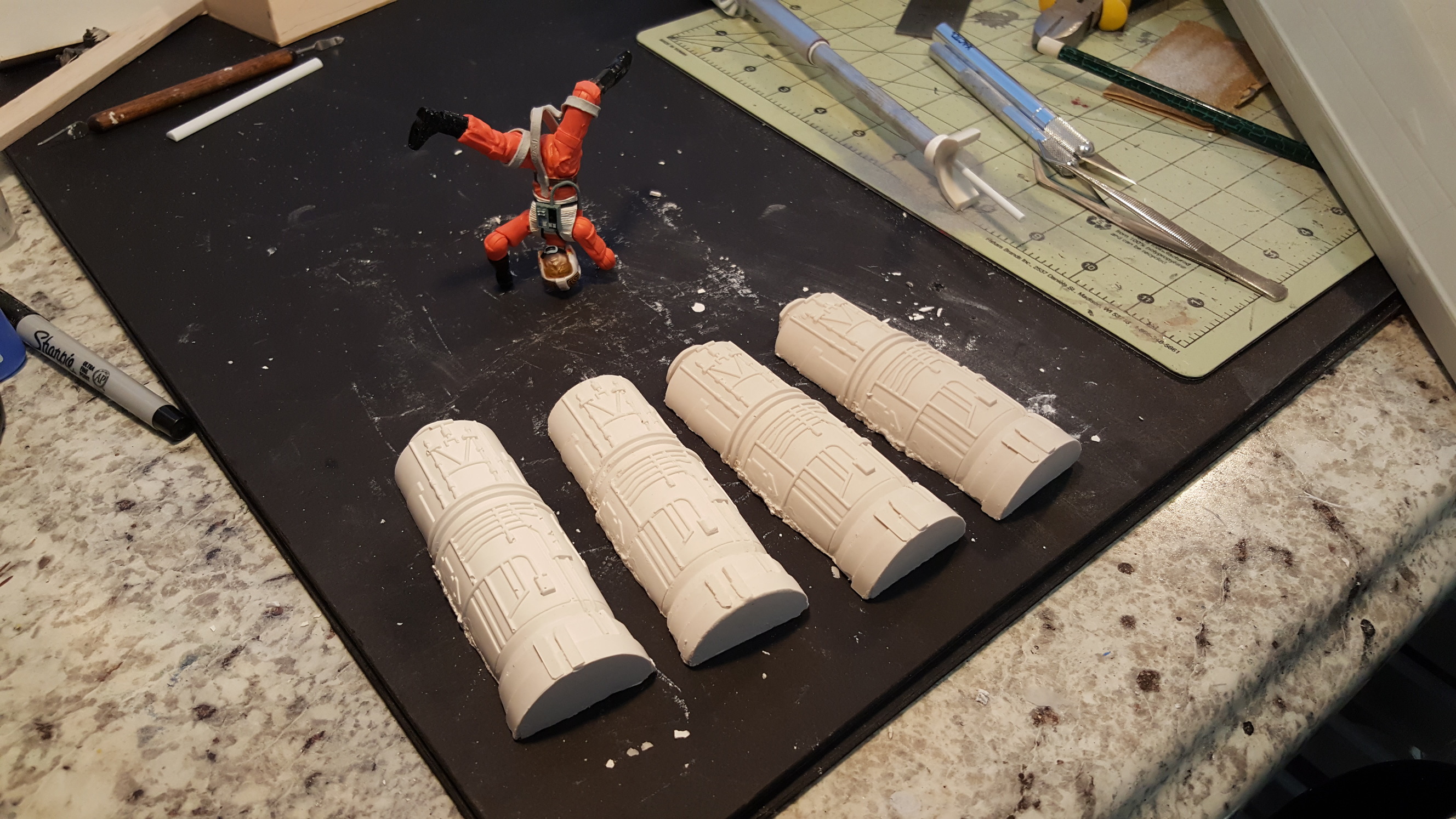

I finished casting the internal engines
View attachment 619652 View attachment 619653

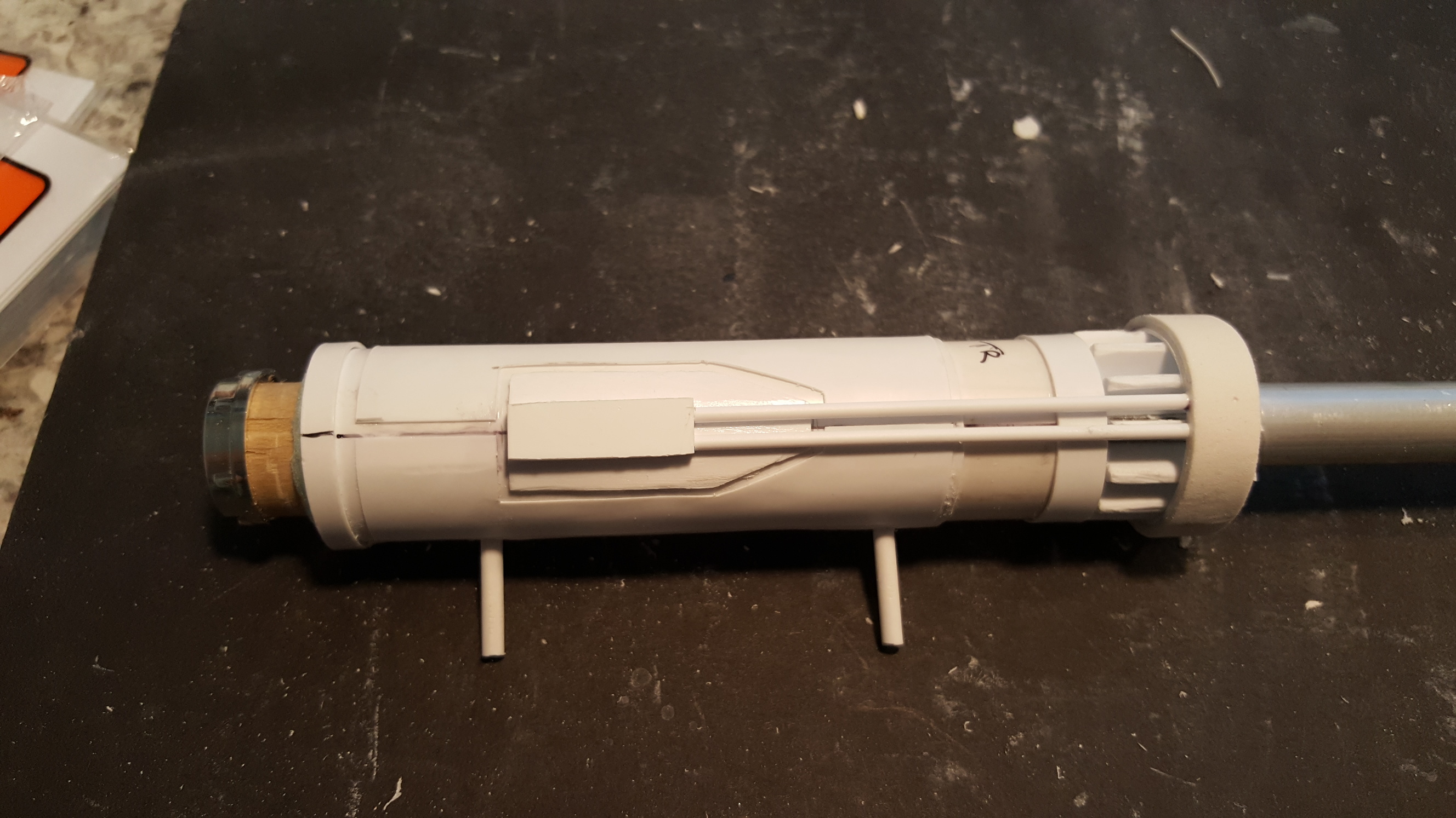

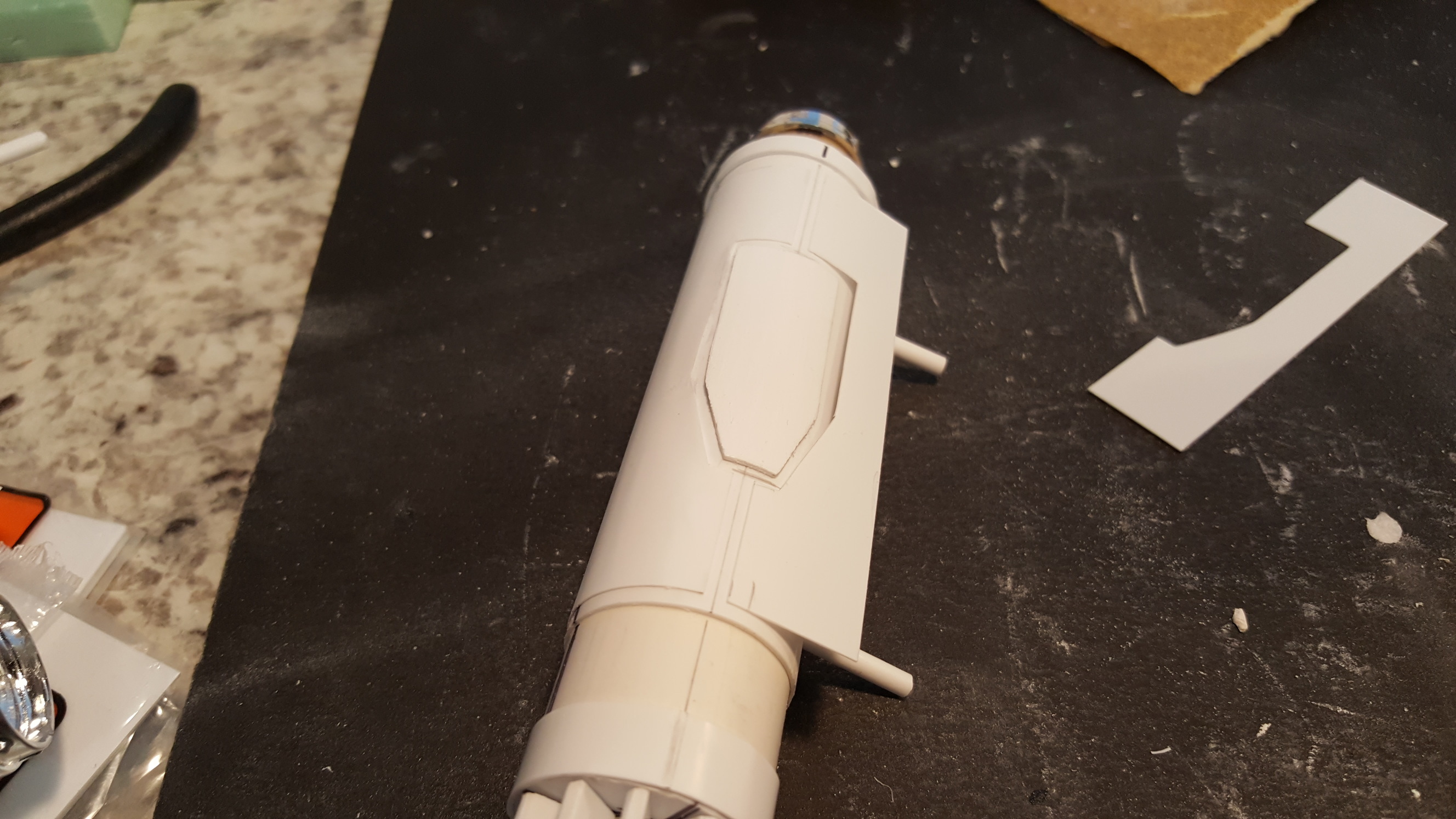

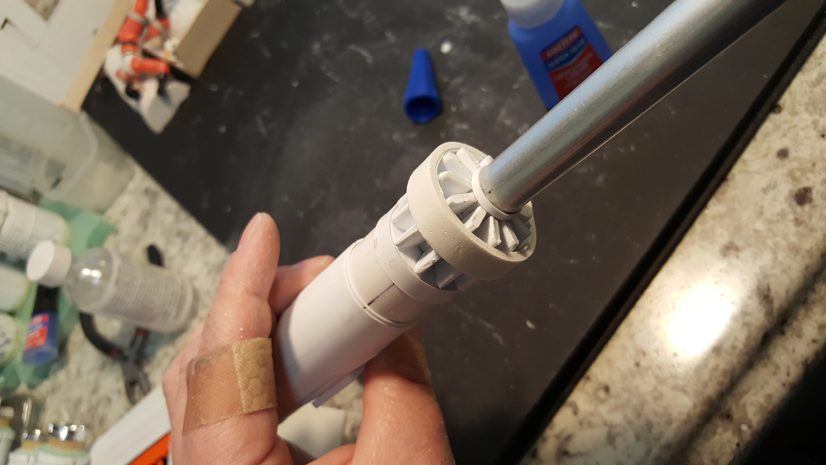

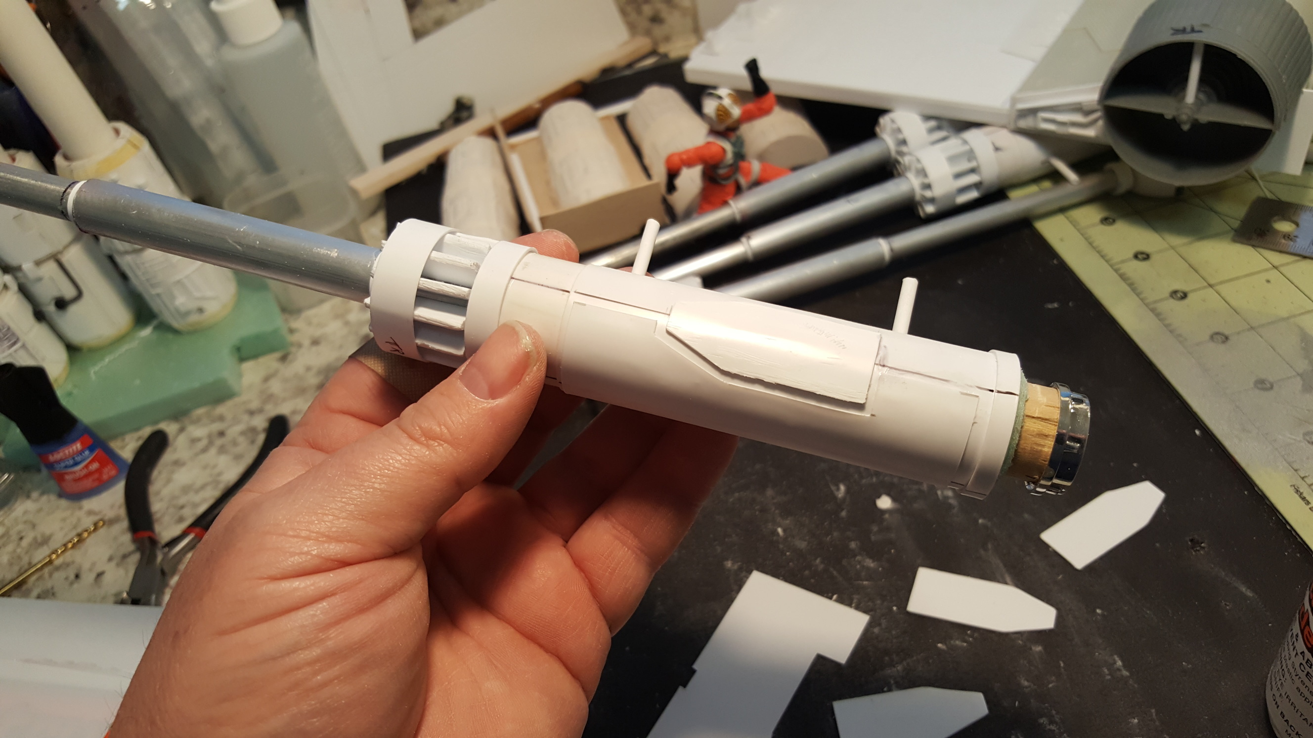

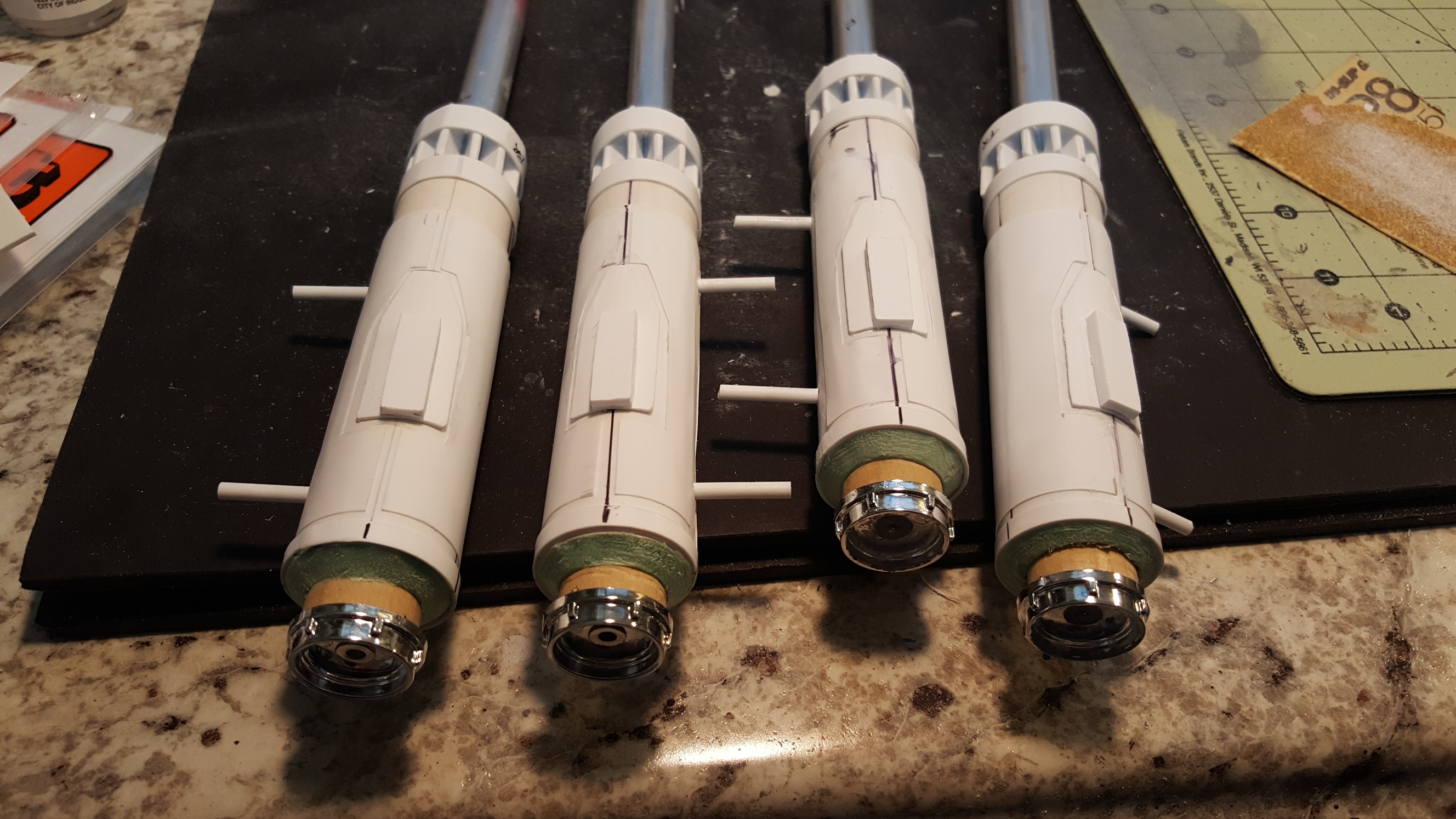

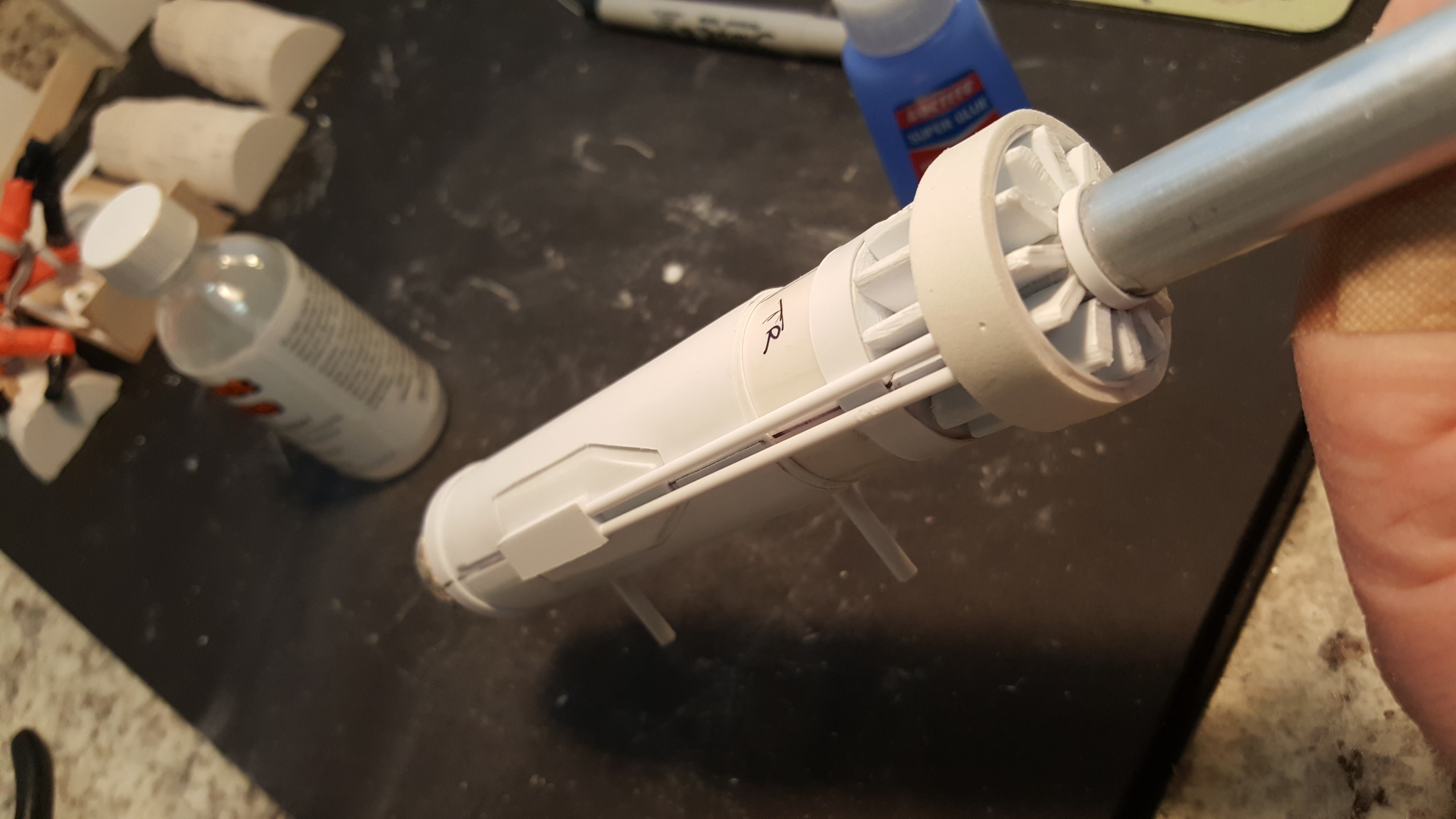

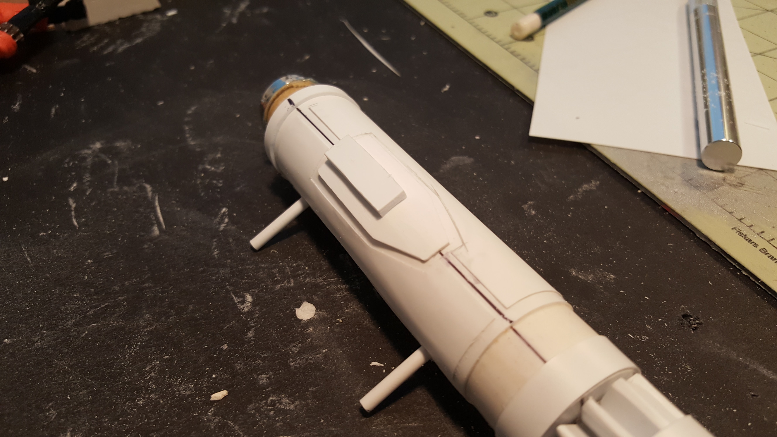

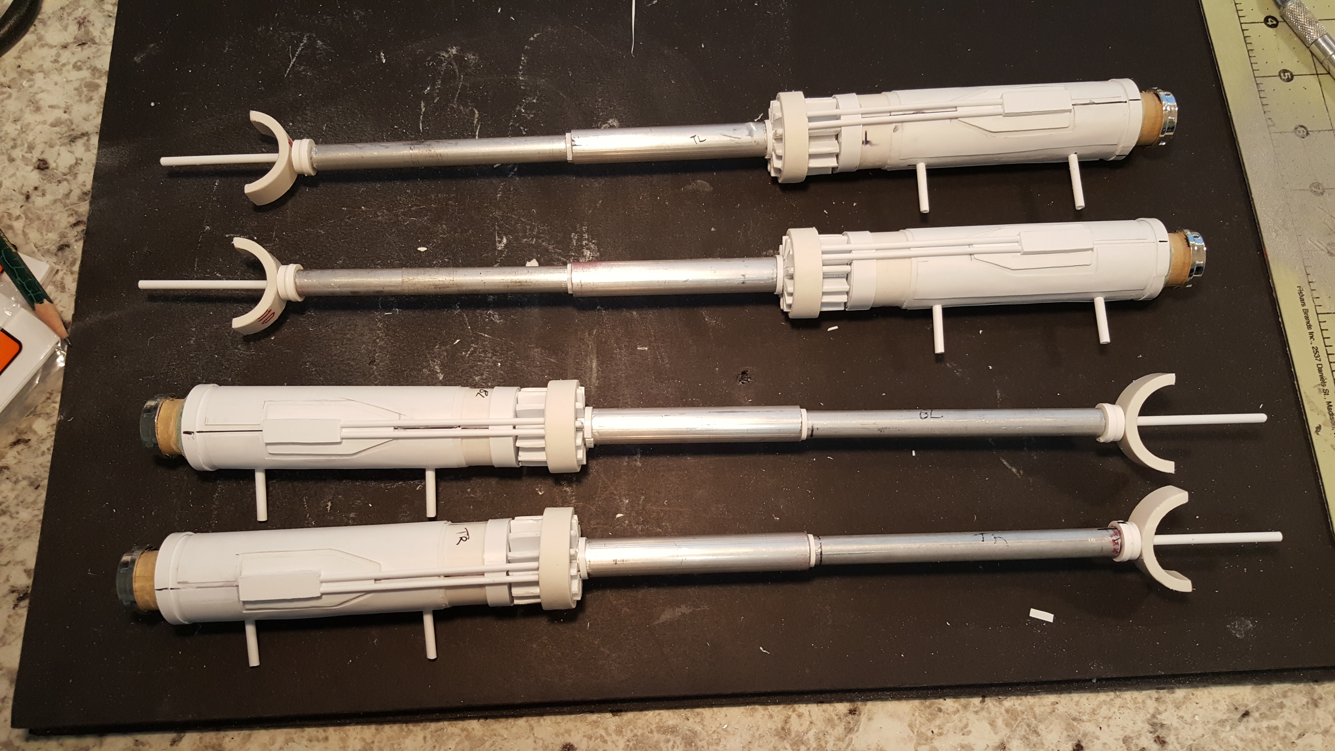

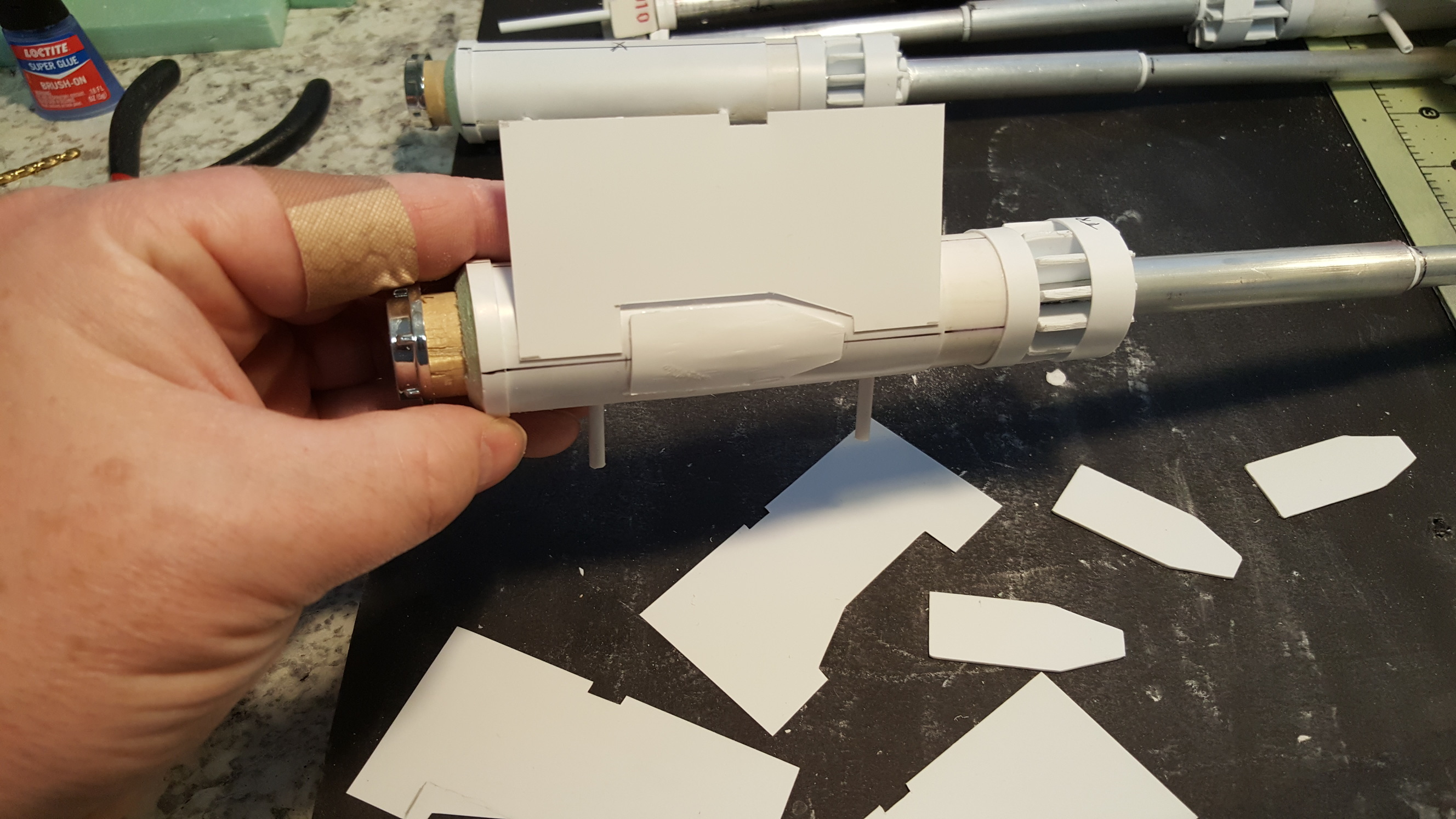

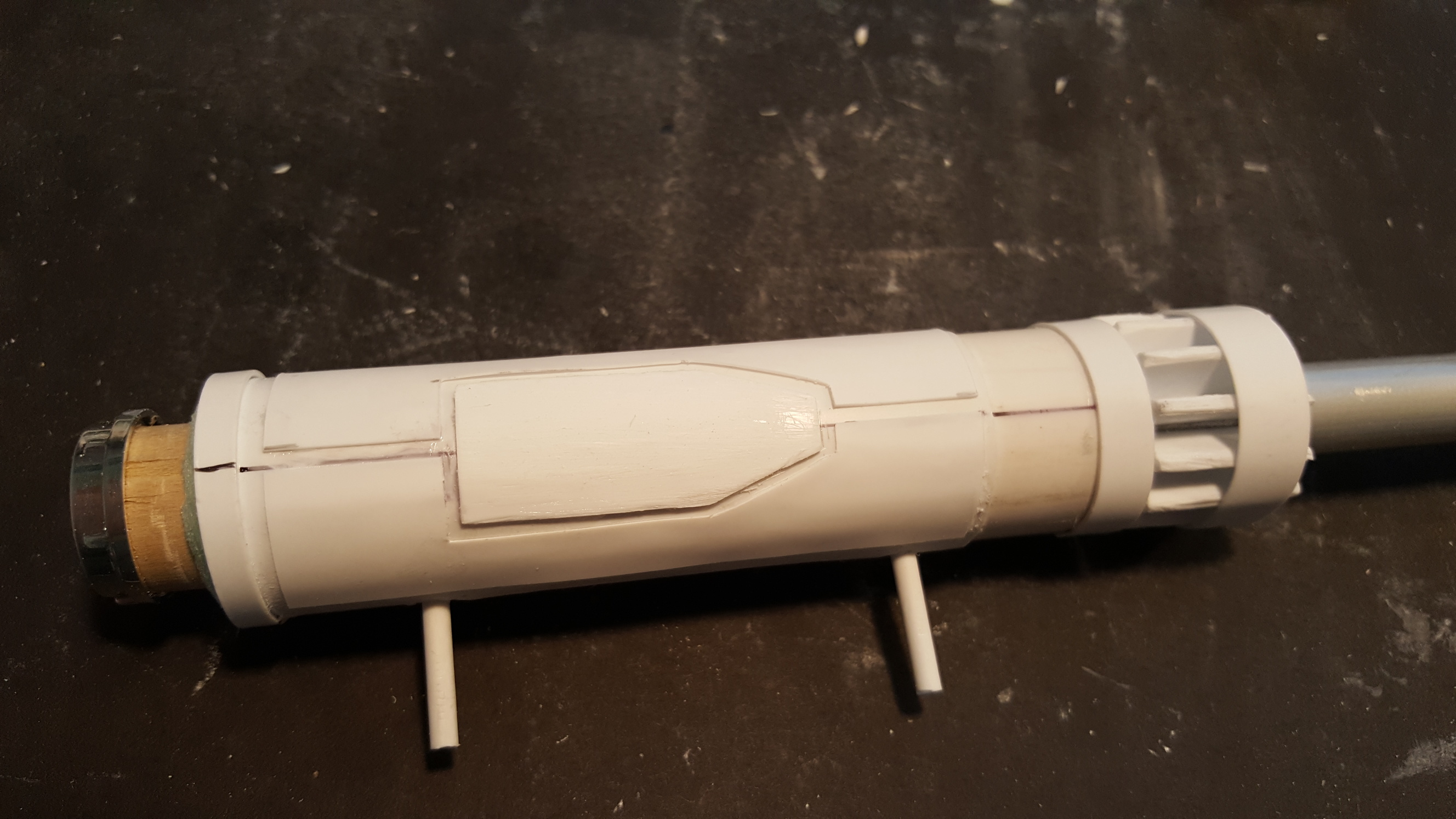

Then turned my attention to the lasers. Styrene sheets cut to install the paneling on each laser body.
View attachment 619654 View attachment 619655 View attachment 619656 View attachment 619661
View attachment 619662 View attachment 619665

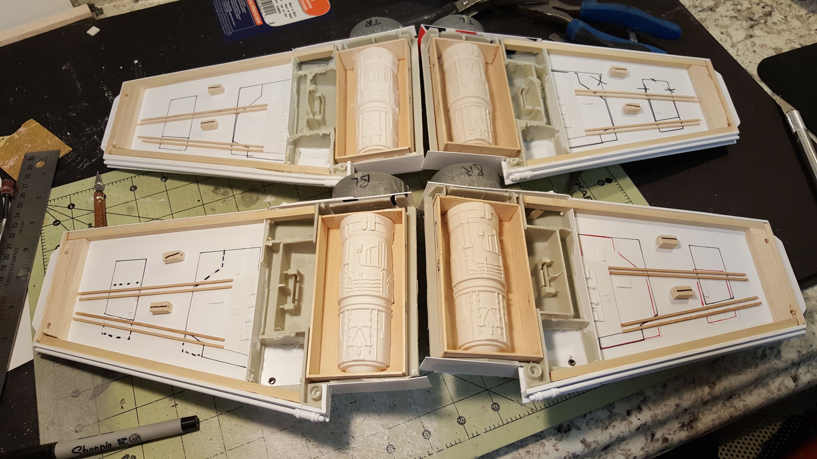

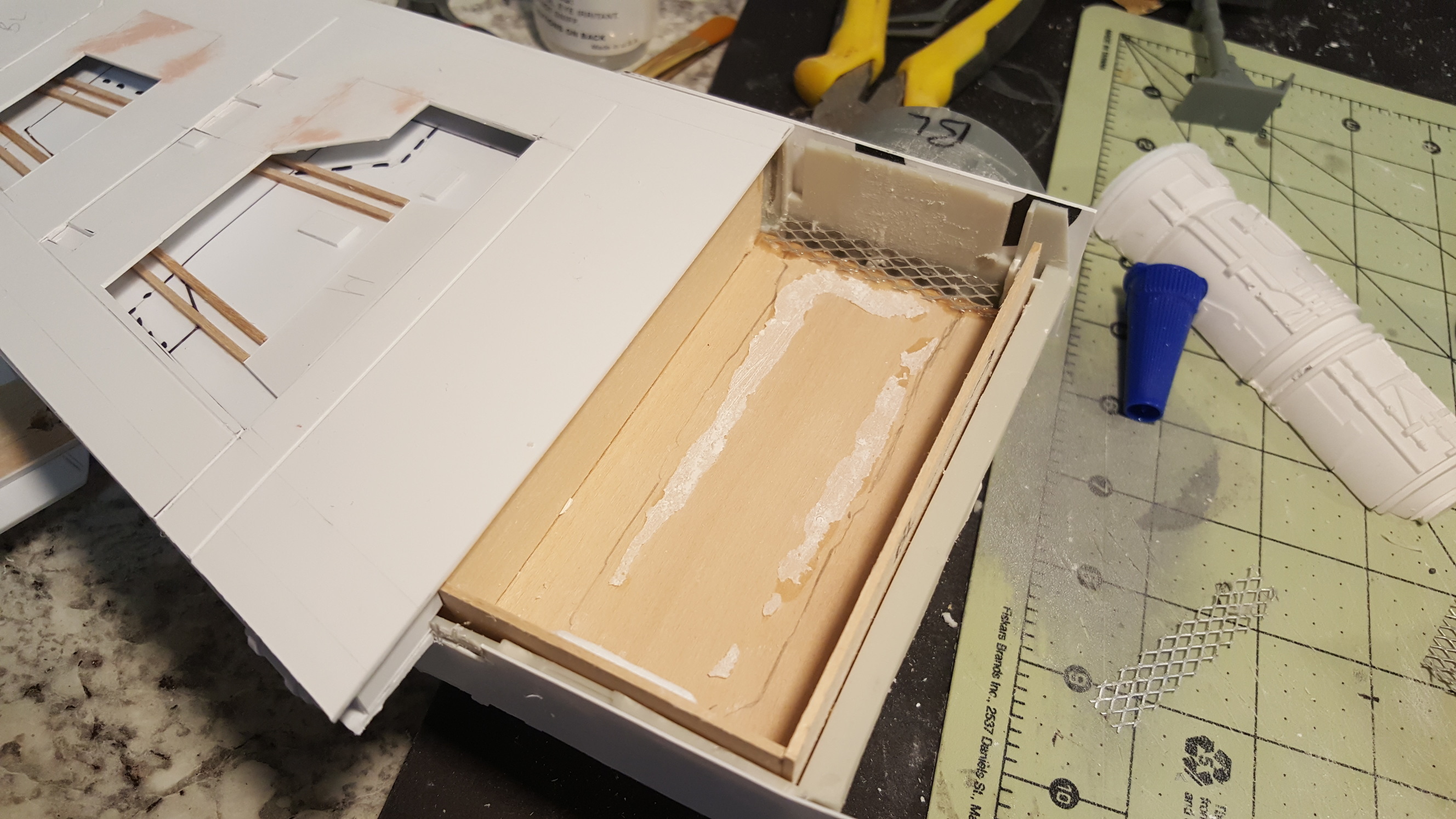

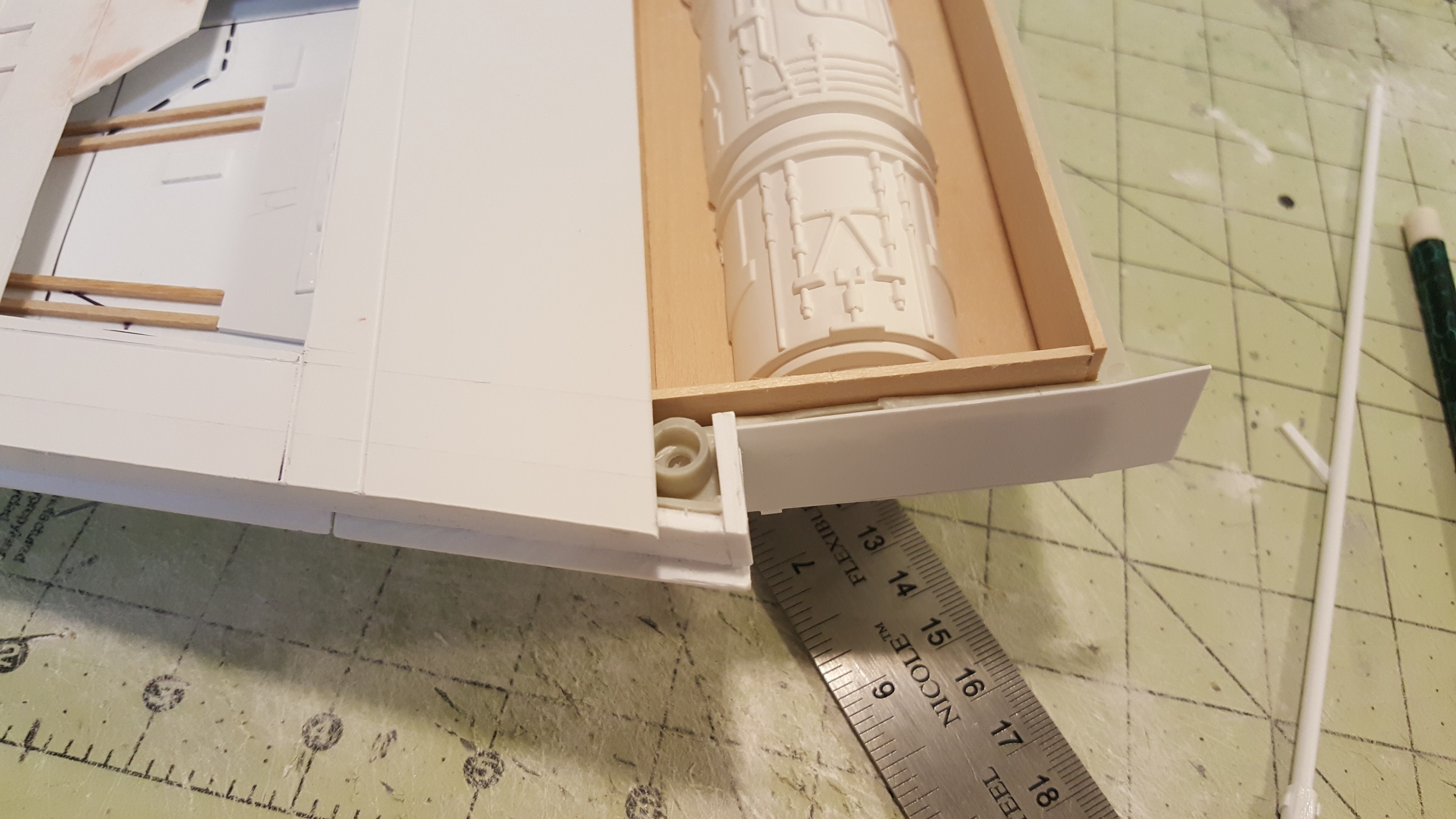

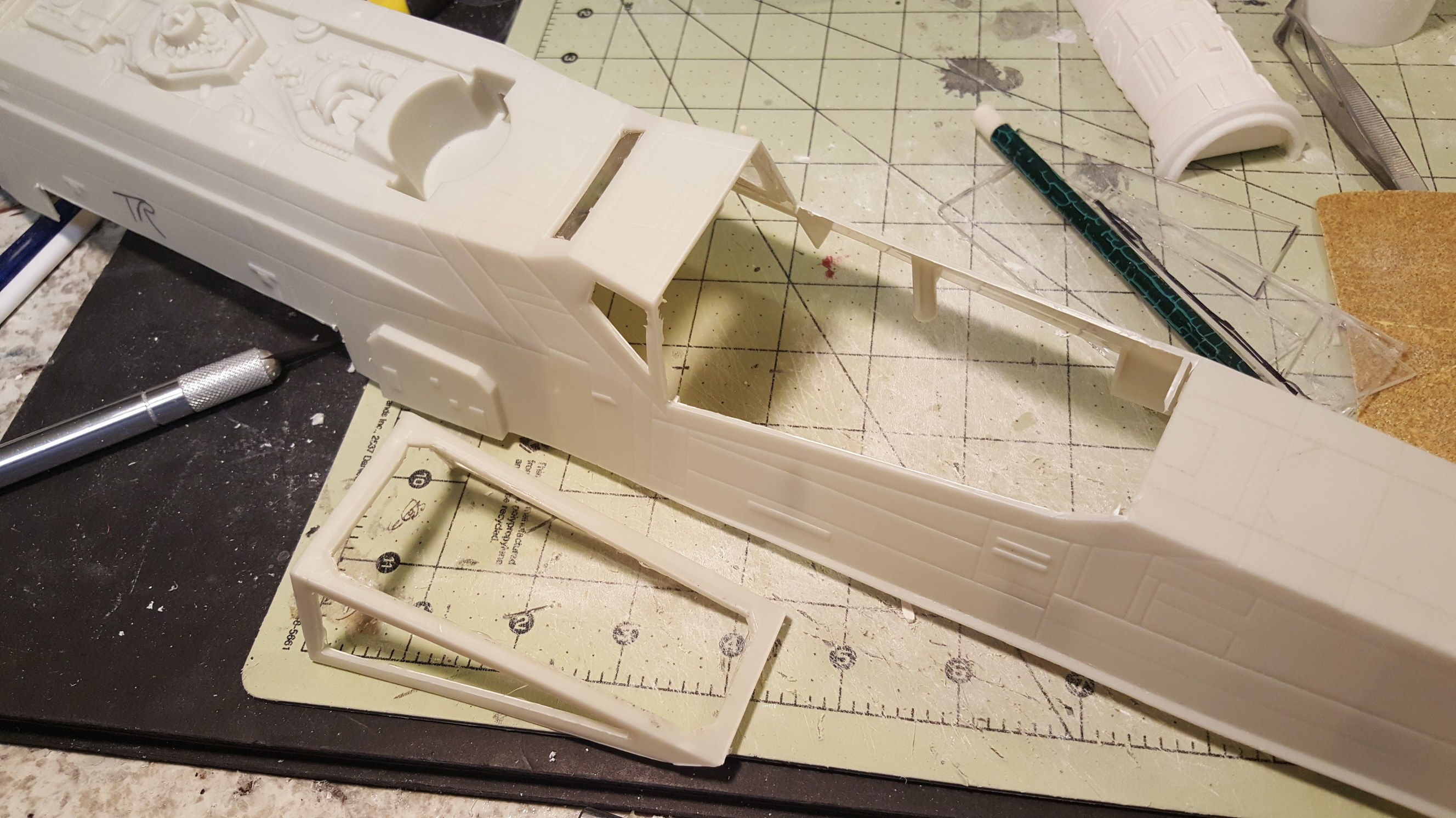

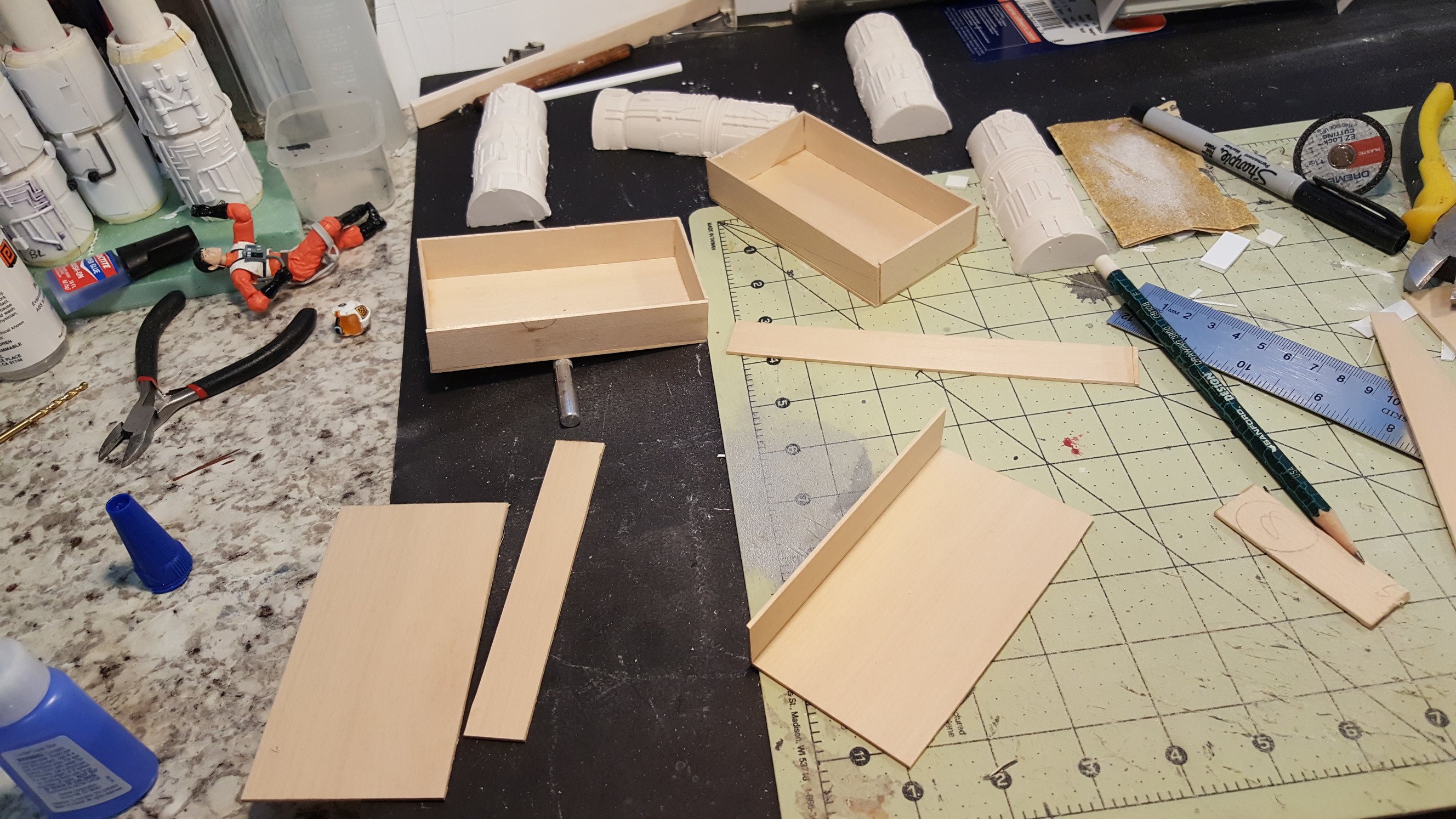

I'm going to show you another one of my screw ups. So I started building out the internal engine compartments from the left over balsa wood from my original wings so they wouldn't go to waste....BIG mistake....lol. You'll notice that the tops of each bay have a wide section of the toy that needs to be cut out. I also noticed that when I put the panels on, it covered up a lot of the bay and needed to be trimmed.....start over
View attachment 619672 View attachment 619673 View attachment 619674 View attachment 619676
I cut back the panel to reveal the tip of the wing that needed to be removed to line up with the engine compartment. I then cut even more of the toy frame off at the top.
View attachment 619677 View attachment 619678

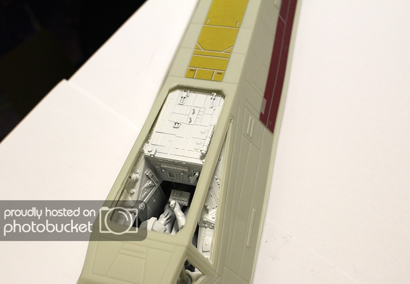

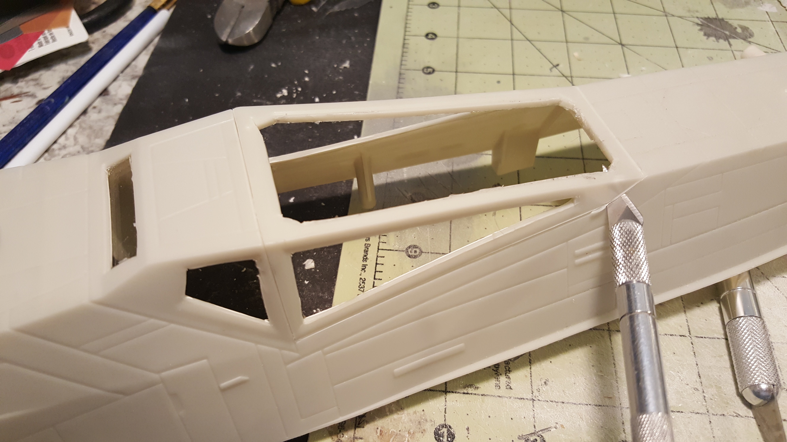

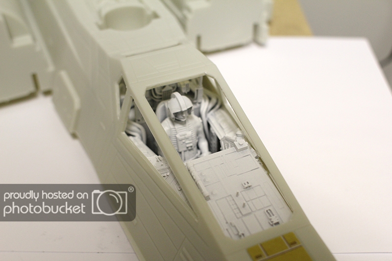

Since I was worn out on that part, I needed something new to rejuvenate me.... probably the most exiting part of my build right here. I will rebuild the cockpit hatch later.
View attachment 619679 View attachment 619680

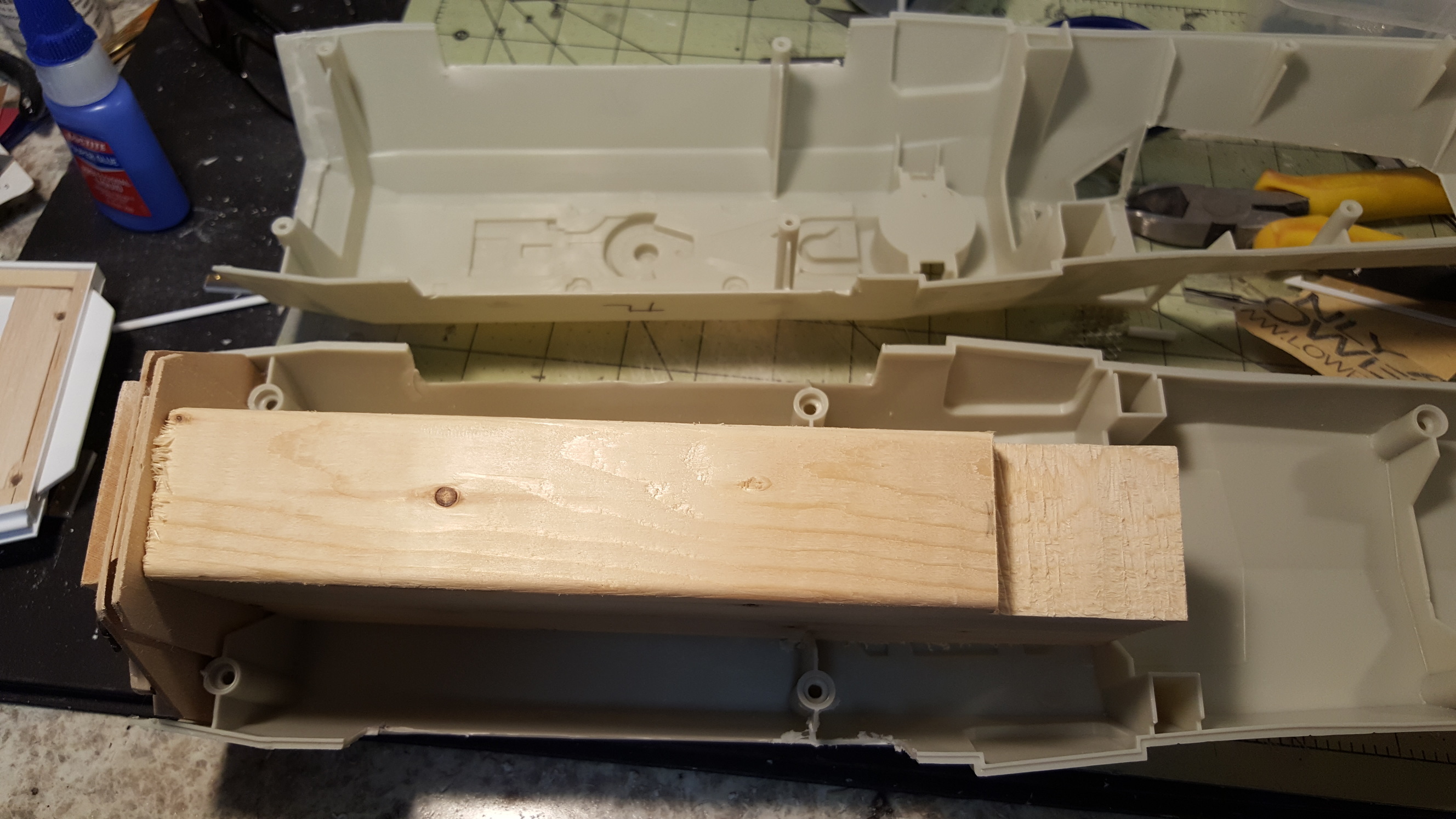

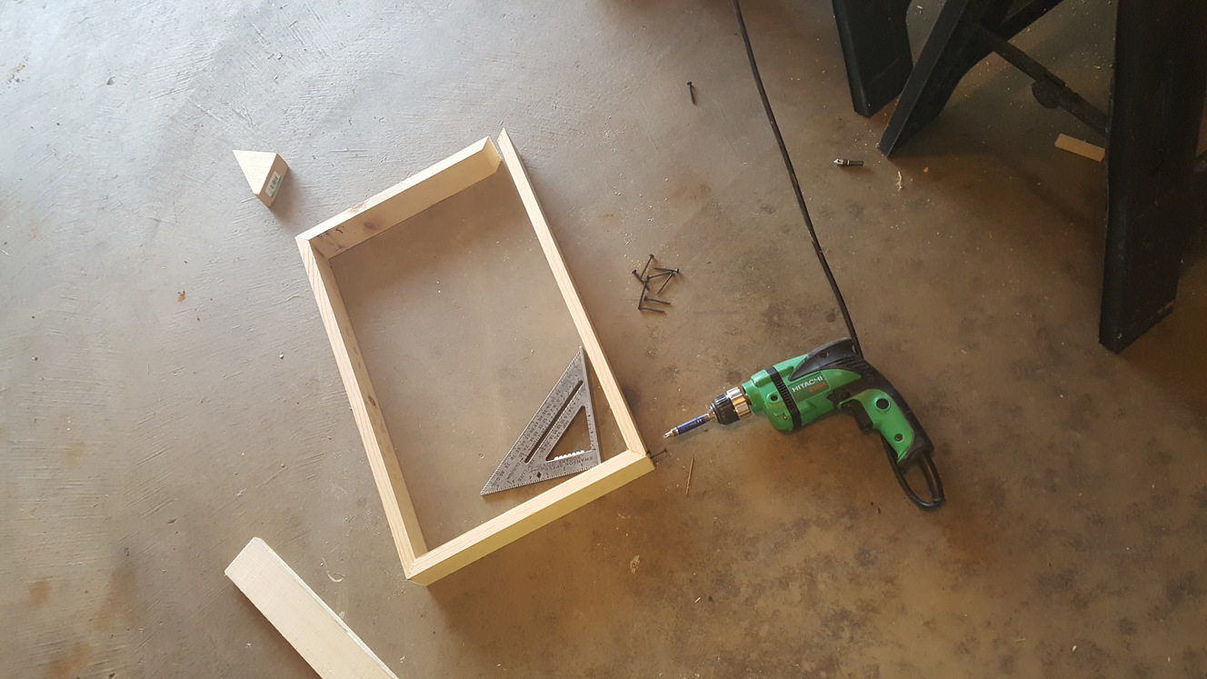

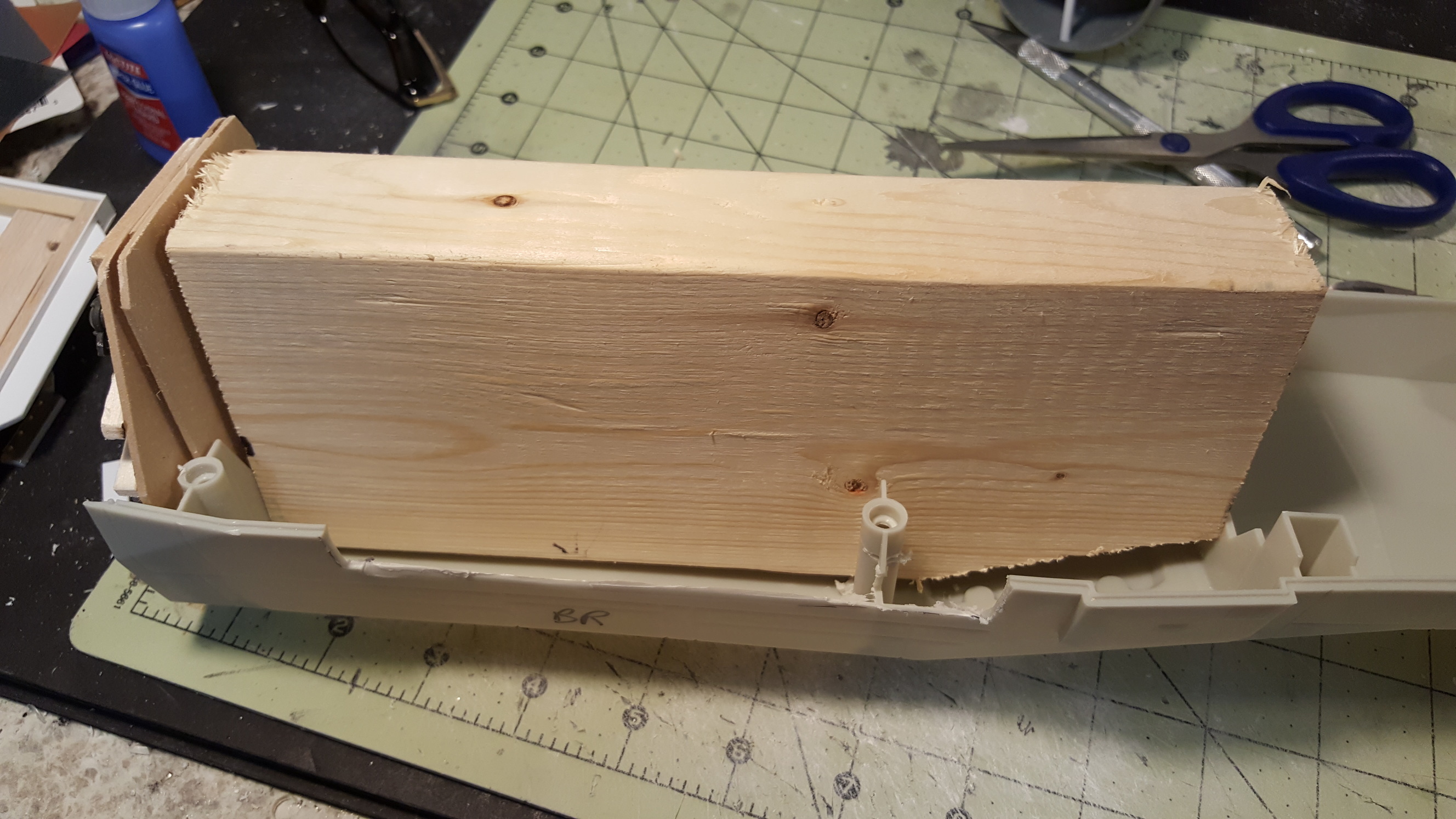

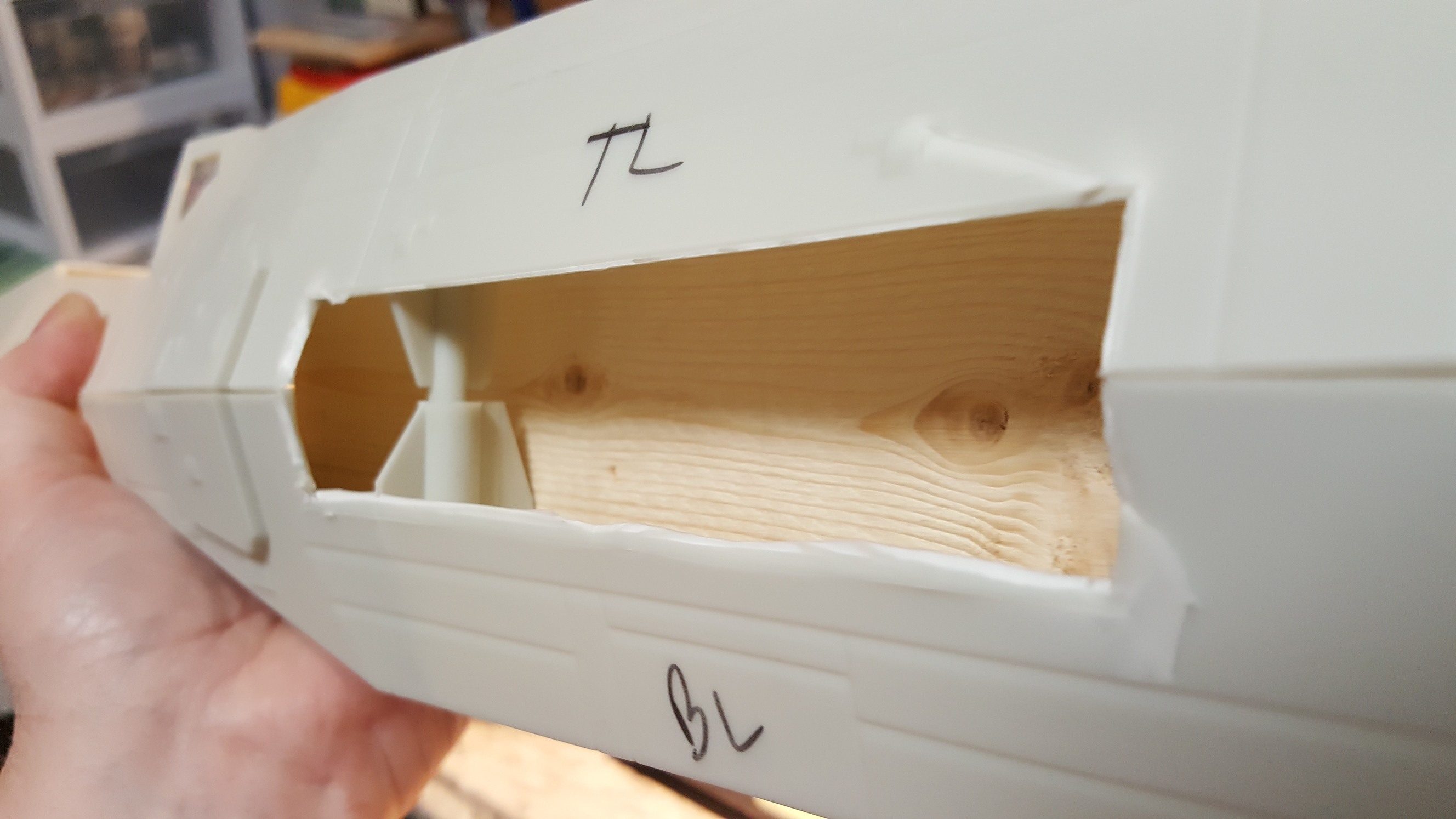

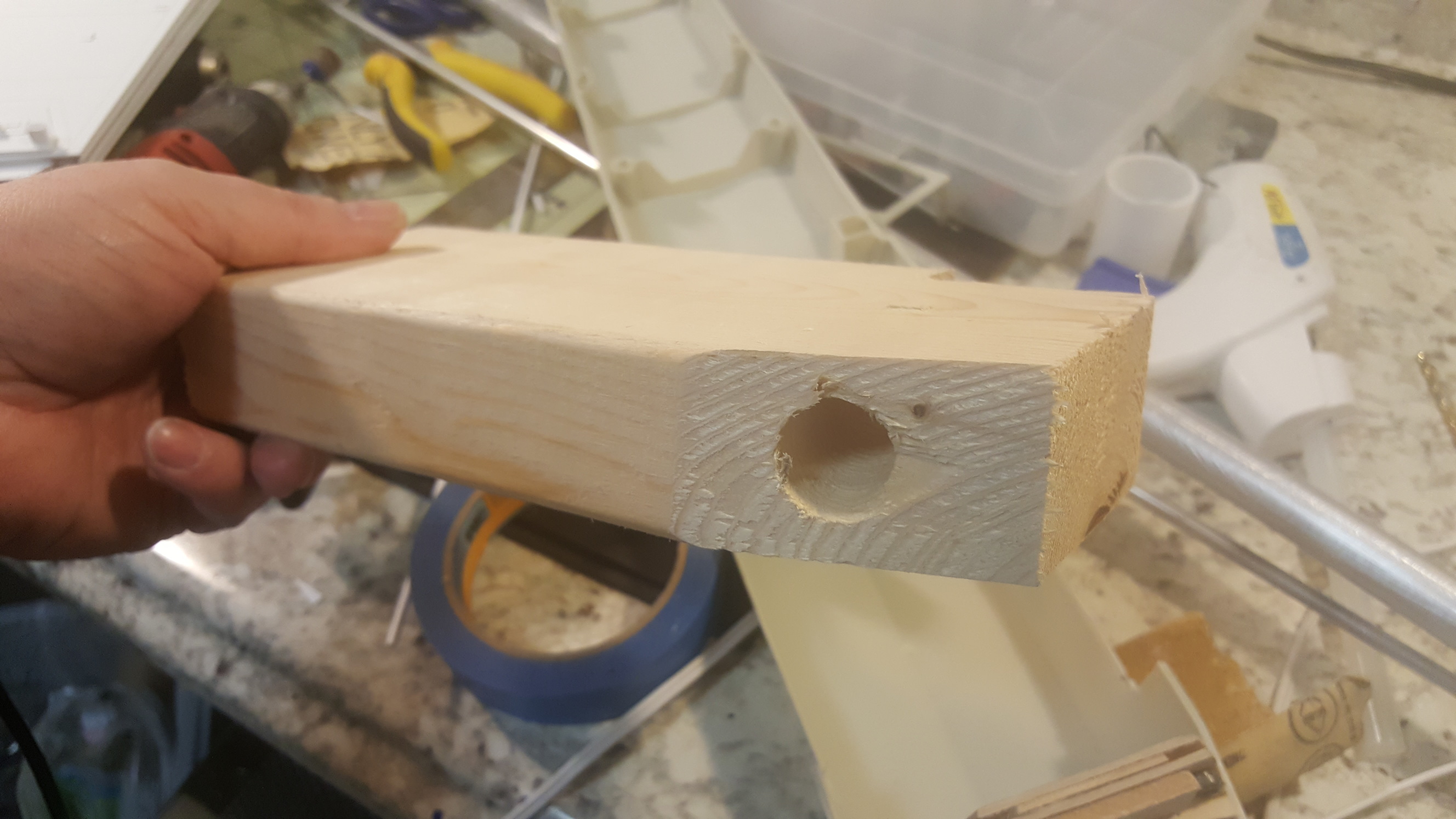

As I moved forward, I thought I'd better decide on how I'm going to display this x-wing when it's done. I settled on a table top presentation so you could actually see the details that I've been working on. If it was hanging from the ceiling, why hide all the work I've done ?
I cut a 2X4 and notched to fit inside the fuselage. I then drilled a hole in the bottom for maximum support.
View attachment 619681 View attachment 619682 View attachment 619683 View attachment 619684
