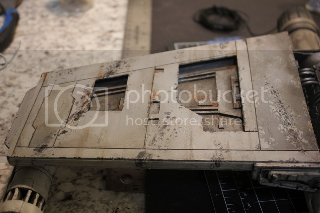

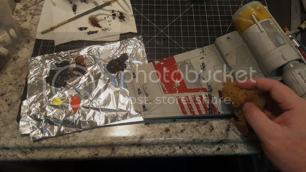

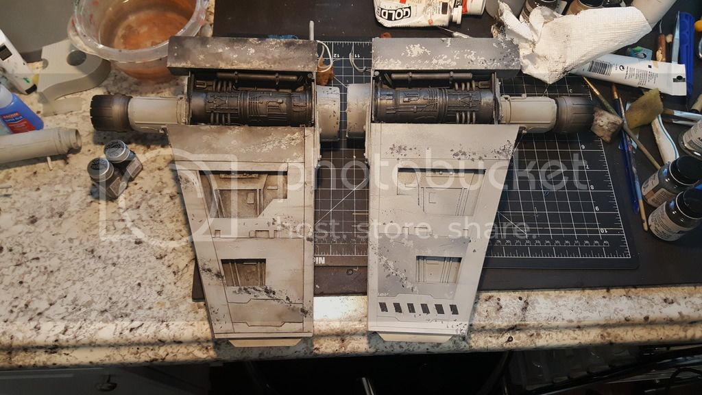

I mixed some black, brown and white and used a dry natural sponge to replicate some battle damage.
Then turned my attention back to the dreaded WASH ! I experimented a little as I went and felt a lot better with the process...obviously towards the end
Fast forward to one wing washed.
Here we have the side by side comparison so far.....plenty more detail to come.

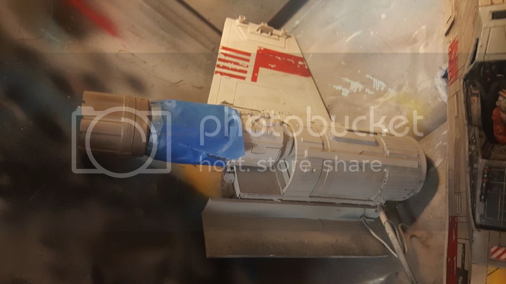

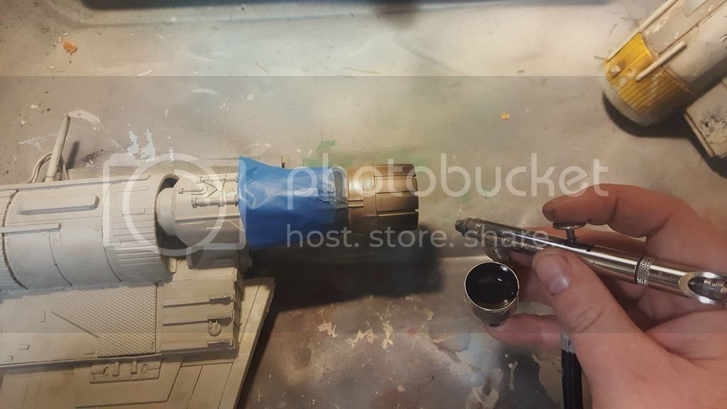

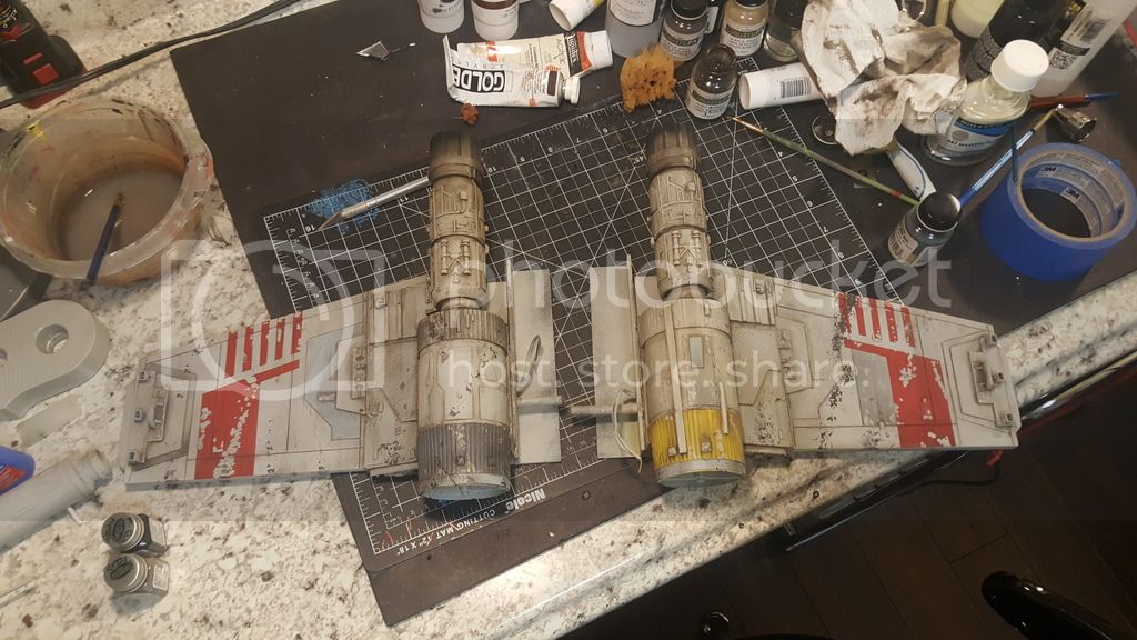

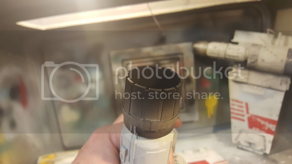

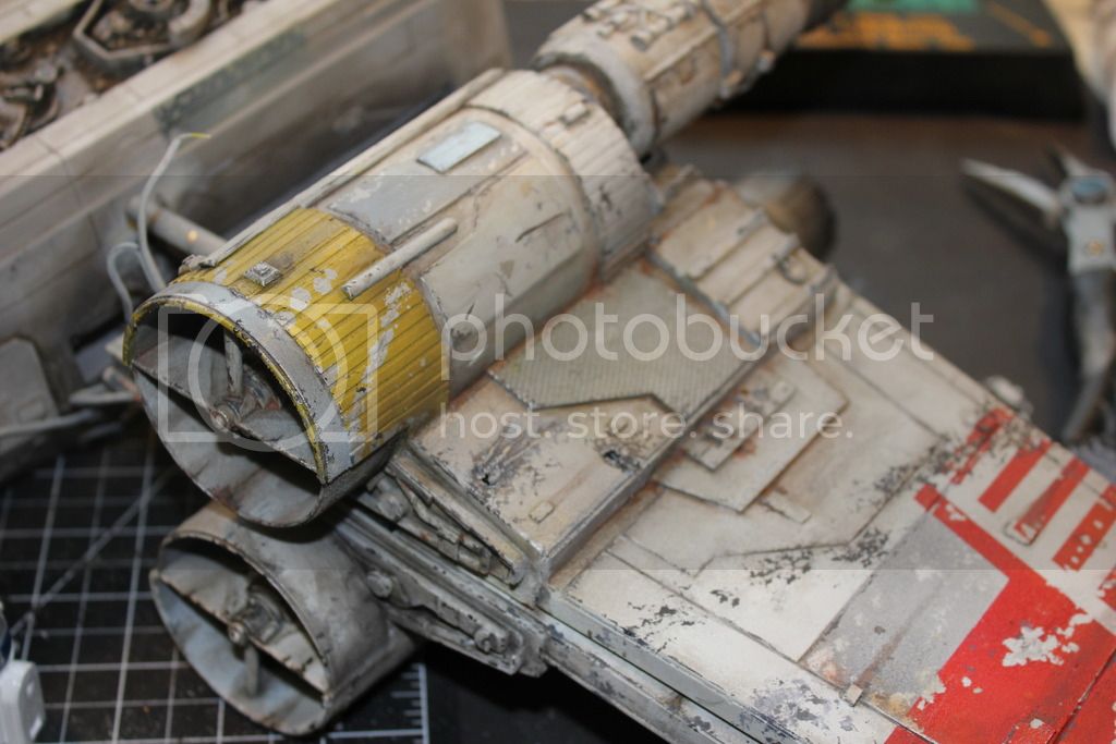

For the nozzles on the engines, I mixed airbrush paint. Metallic Silver, Brown, Black, and White. it has just the slightest reflective property.
Then I airbrushed a Black and Dark Brown on the ends for the exhaust. I will refrain from using straight Black throughout this paint job. Black by itself will create "holes" and flatten your painting....thanks Art College :thumbsup
The usual suspects
Close up of the nozzle pre wash....

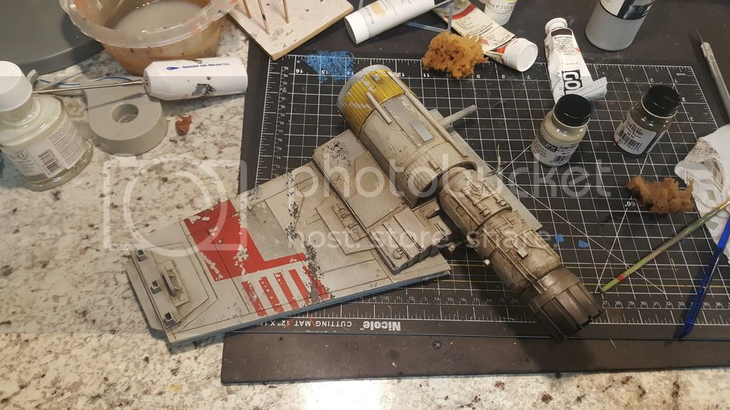

and the wing almost complete. Metal chipping and other various wear and tear to come....small details. It's in the DETAILS ! Lol
I used more wash on the engines than on the wing and I'm definitely going to do more there to darken and add life, but I haven't quite worked that out yet. I am open to suggestions !

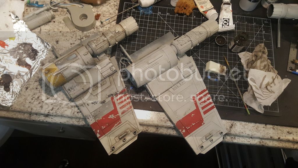

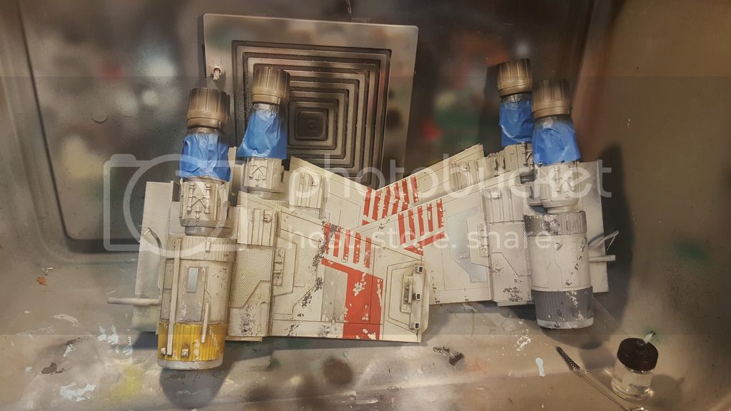

Upper wings

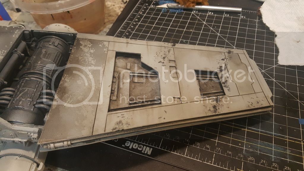

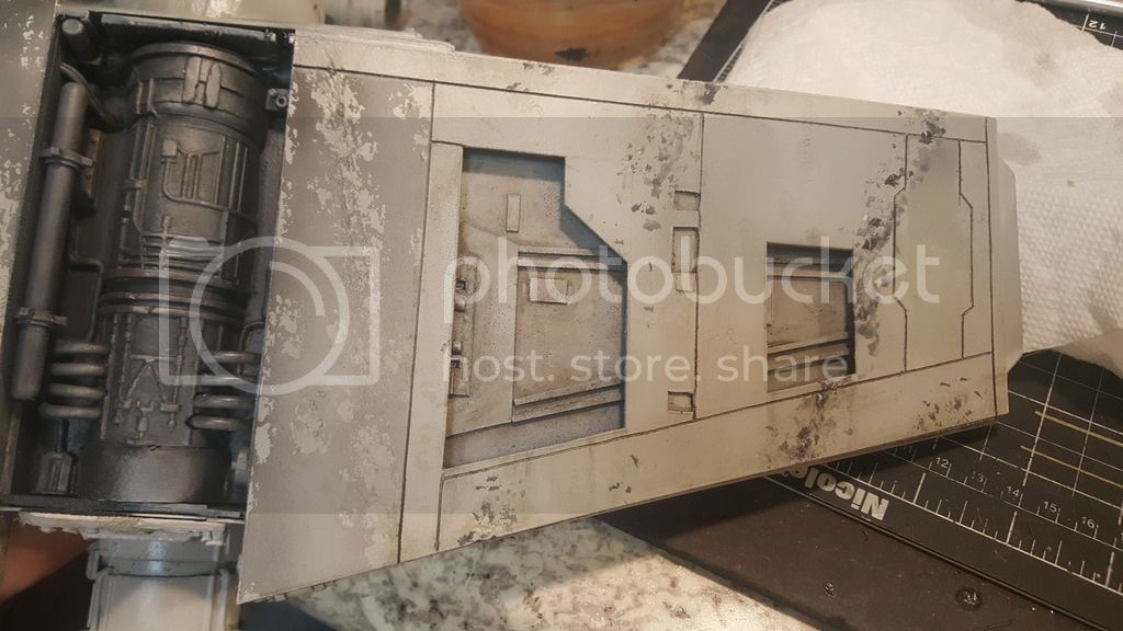

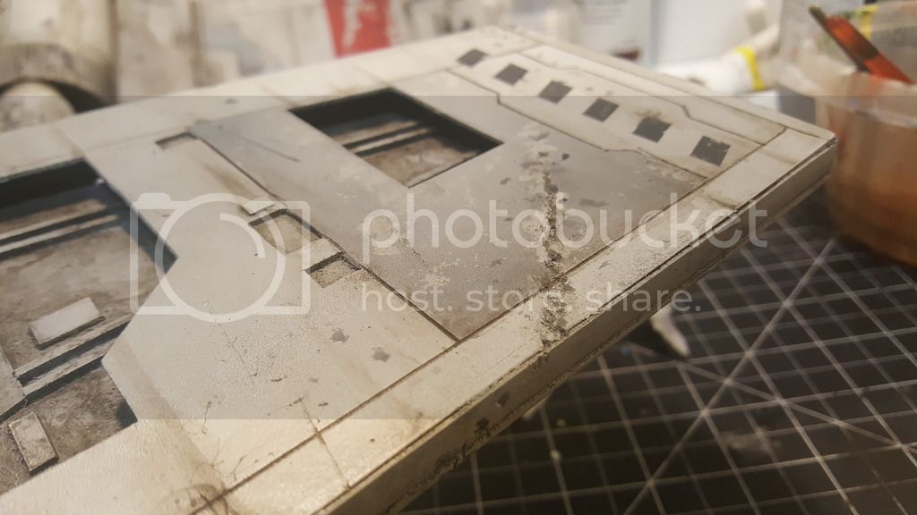

and now some work on the underbelly.....Acrylic sponge treatment again and wash
Inside the wings, I darkened my wash up to create depth and shadows.
Side by Side comparison. Although the picture gives it a brownish look, to the eye it's less noticeable in person.
Ok, wings are stacked and I'm on to the cannons....

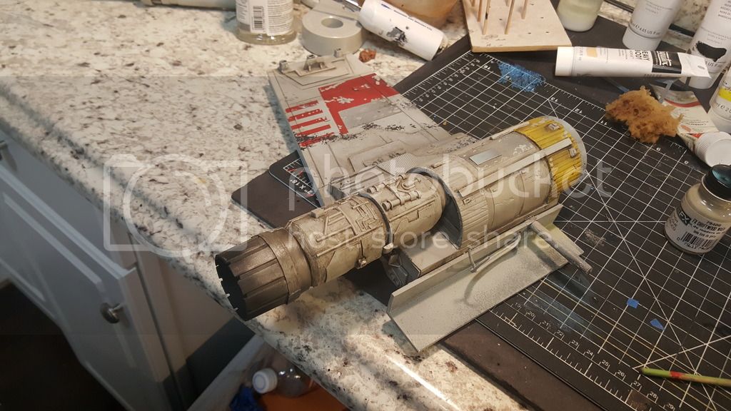

Part 2 of 2 Cannons / Washes and Paint

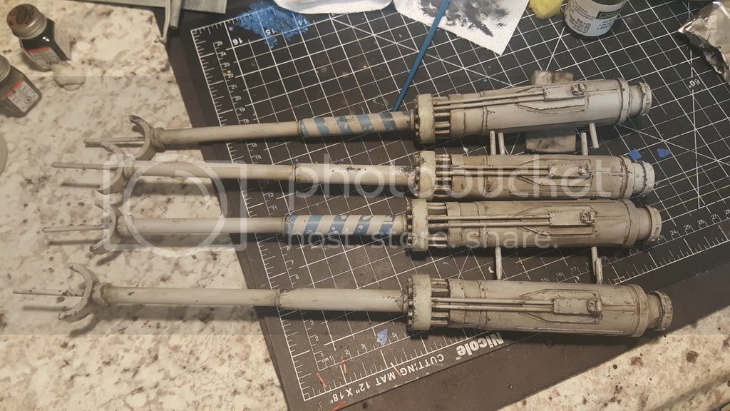

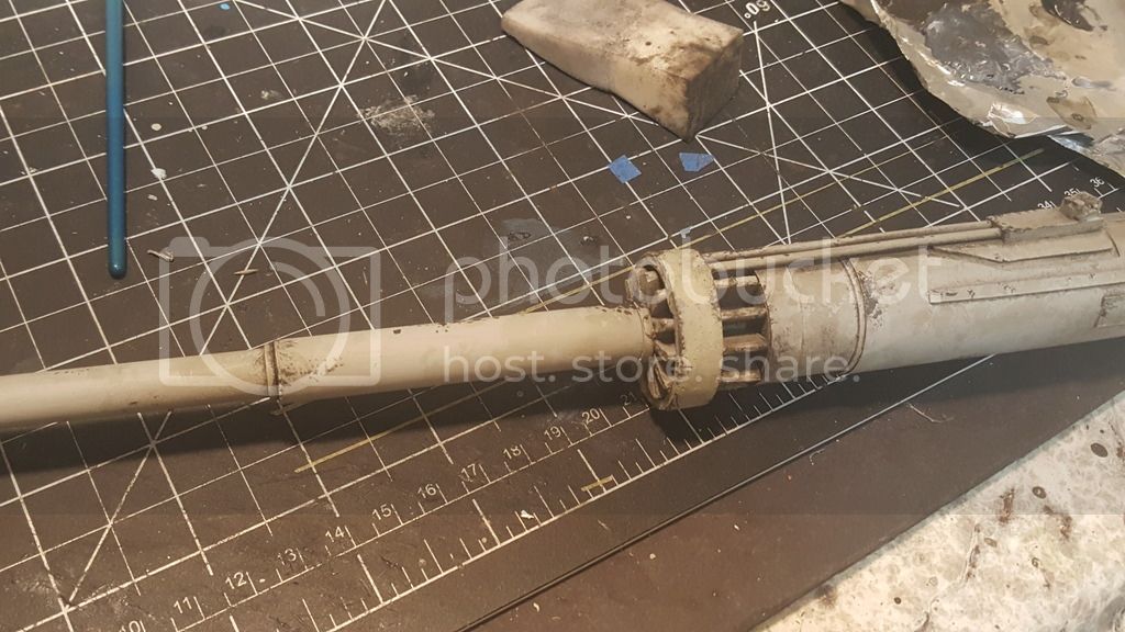

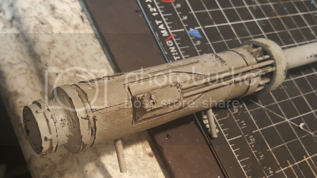

Here are the cannons completed for the most part.

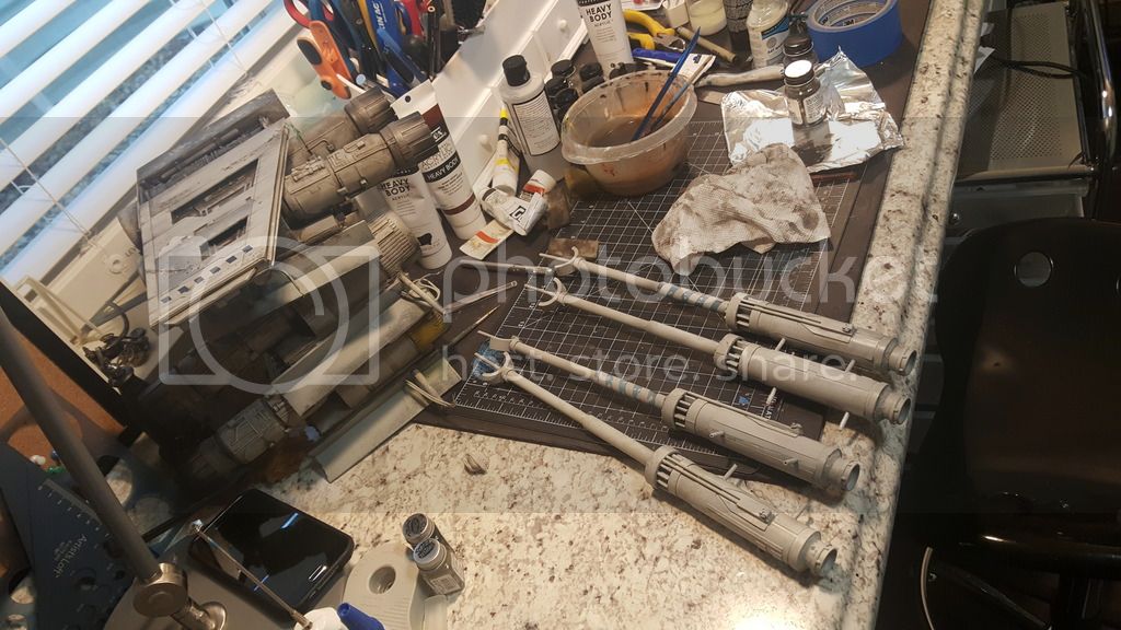

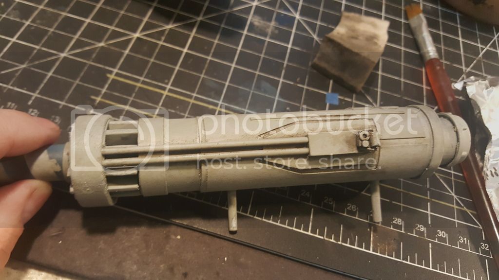

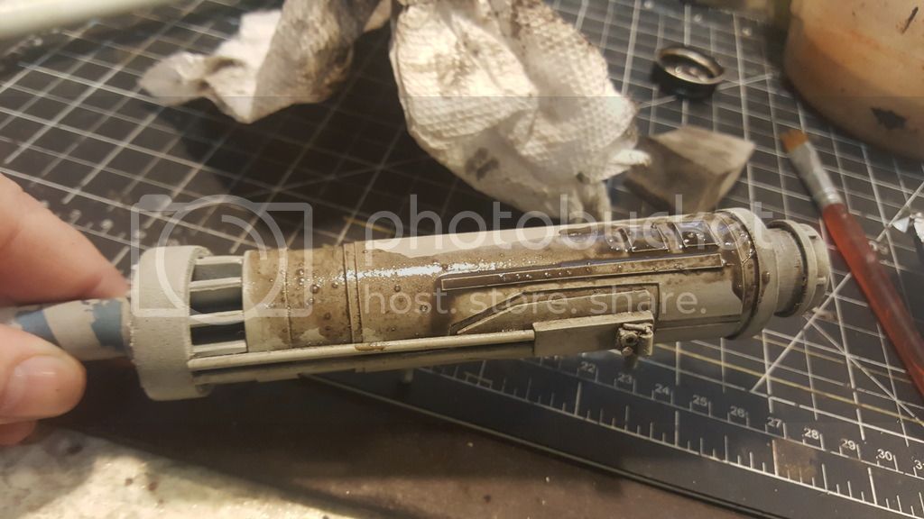

Started with the washes

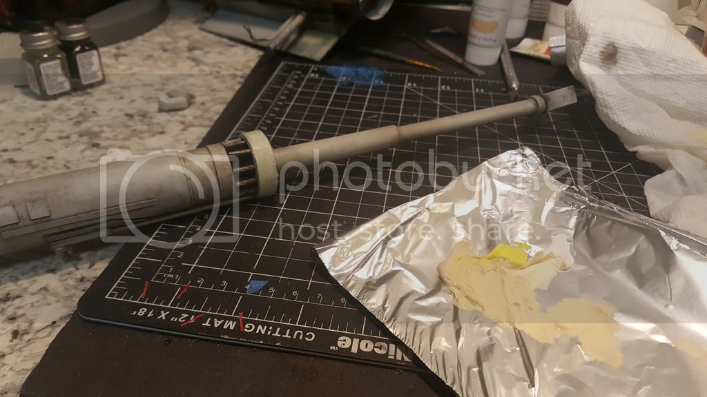

But after further inspection, I did decide to go back and repaint this area beige......
Let it dry

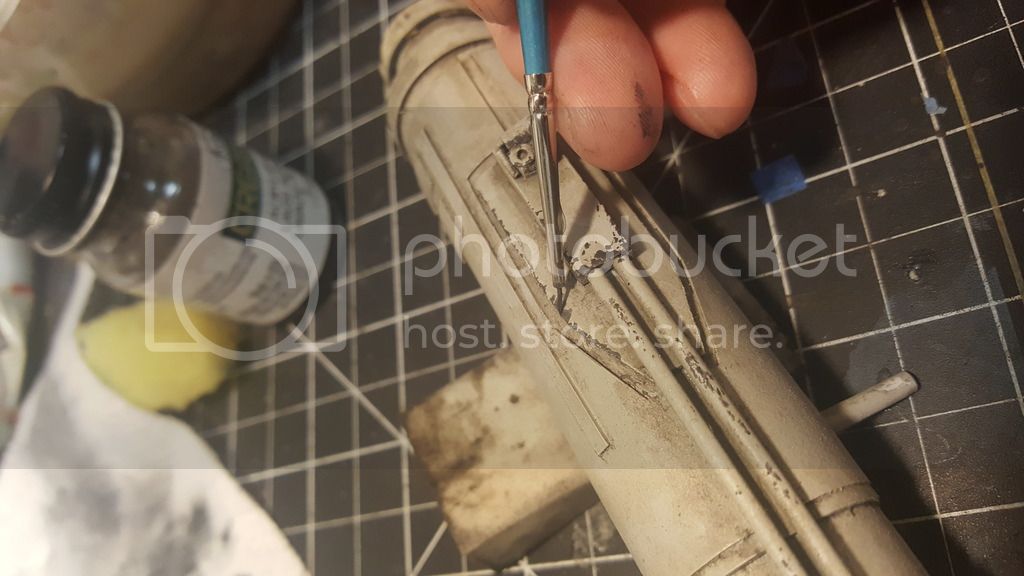

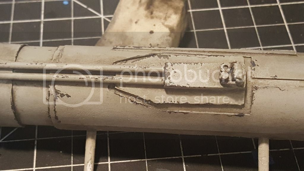

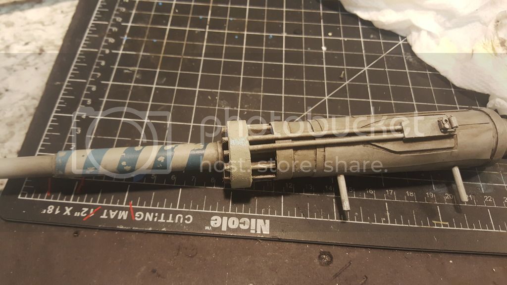

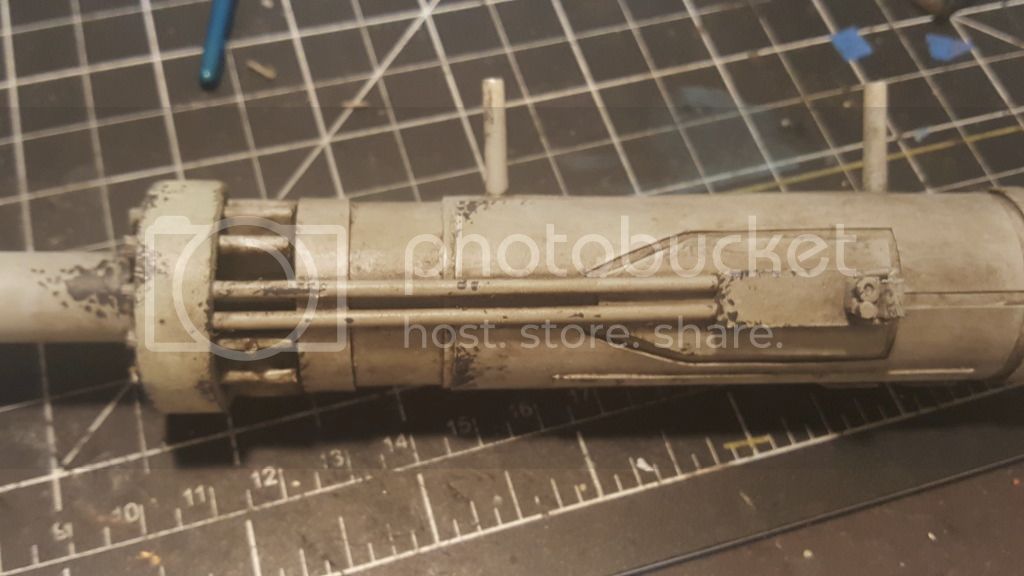

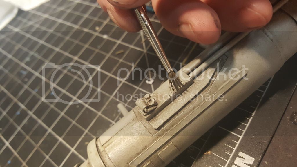

Finished washes and then mixed a dark grey with a little brown to create the paint chipping.

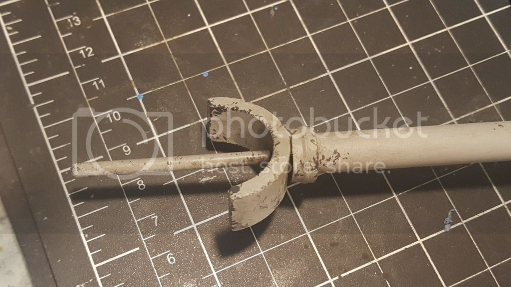

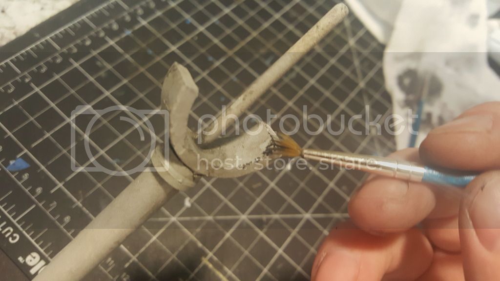

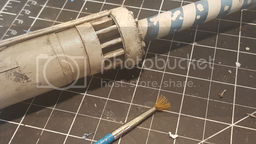

I used an old brush, smashed it to a fray to create 2 types of wear and tear. The first one is seen on the lower left of the body below, where you use a small amount of paint to start. Once applied to an area, completely dry the brush and then come back to the fresh paint to lightly spread it around and away from the center of the damaged area. this is mostly achieved by blotting.

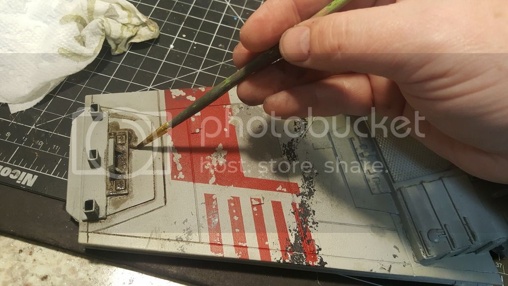

The second method, shown below, is to dab it directly to the edges where obvious chipping and damage would occur.
The trick is always trying not to over do it and add too much.....but sometimes it's just so fun, you have to force yourself to stop.

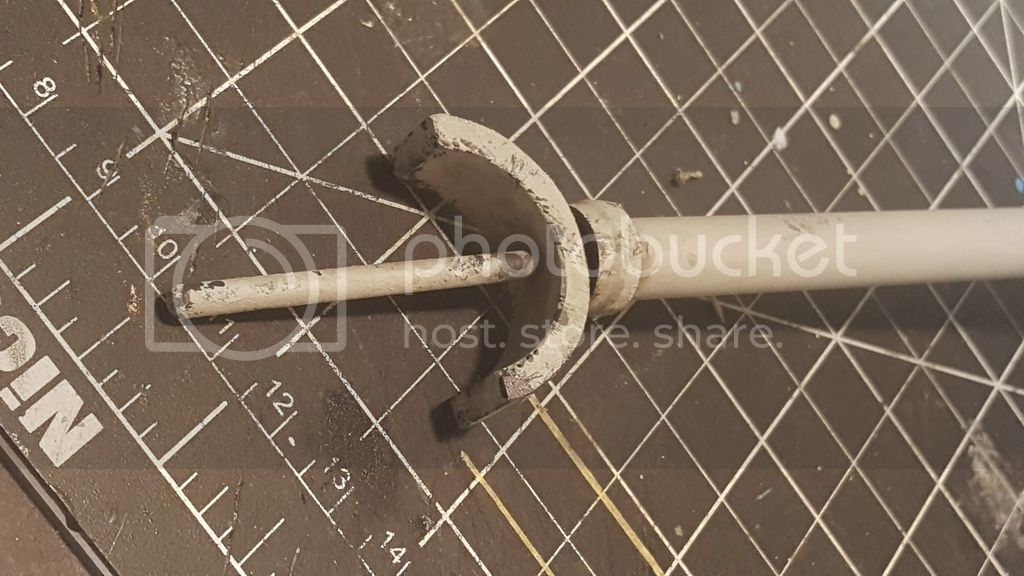

Applied the same painting techniques to the rest of each cannon
It's also a good idea to stand back from your work and visualize it from a greater or more accurate viewing distance to gauge what areas may need more work. I've found this to be true for any project where your working so close to achieve small details.
I've also found that varying the "damage" gives it more visual appeal rather than replicating the exact same technique, color, or design over the entire project.
I try to gently touch it once or twice and also vary the angle or the side of the brush I use. Again, so patterns aren't replicated.
Once I'm done with the frayed brush, I grab a small fine detail brush and touch up or add to specific areas the other brush was either too big for, or just for visual balance.

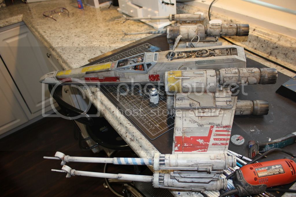

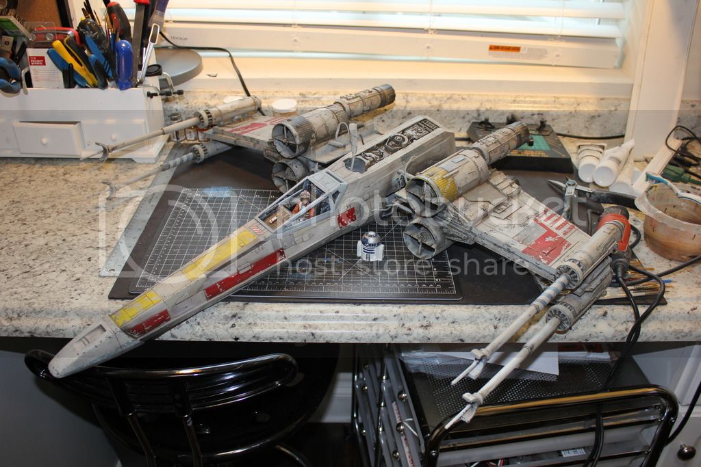

Real quick update:
Painting is coming along.
I've got a few more details to touch up and debate on.....then attach the wings and wire up for lights.
Loosely assembled
Can't wait to finally get the wings attached permanently !
Thanks for looking !
Cya soon
Re: Pcoz's Hasbro Hero Star Wars X-Wing Conversion

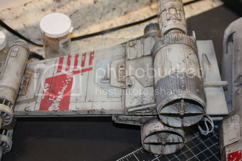

LOOKING FANTASTIC! I have really enjoyed watching this progress - thanks for sharing.
Looks great! Every close-up pic of the weathering I started thinking "nope, he's gone too far" but then when I look at the wider angle shots it all comes together nicely. I'm definitely used to thinking of things in smaller scales than this, where that much detail becomes clutter fast, but at this scale it really works. One thing I would say is that, while I really like what you did with the dark paint and brush on the cannons, you can definitely get a similar result by using steel wool or some sandpaper to expose the black primer. I'm sure you considered it and decided against, and I'd be interested in hearing what the thought process was. I'd also love to hear more about the initial stages of masking before spraying the base, as I think that came out fantastic and it's not a technique I've really seen before.

Haha, I may as well have written this because I felt exactly the same way you did !
Details: I was almost ready to repaint EVERYTHING because I thought it was way too much. Each area kind of "got away from me" with fine detail. Once I loosely assembled it, stood back, the details blended and it made sense. Obviously the larger scale needs more detail than the smaller X'Wings. Bullet dodged!
So the dark "paint chipping" on the cannons was actually an after thought because of my poor planning. Originally, since I really didn't see that kind of detail in any models, it escaped my paint planning stages. Normally I would use a chipping fluid and scratch the surface away to reveal the base color. Since I didn't prepare my layers properly to do that, I had to paint them instead.
Lastly, the base coat masking was an idea I just came up with to vary the tones. Instead of having just one solid base color, I wanted varying subtle "weathered" shades peaking through the finished paint job. I knew a lot of it would eventually be covered up. To me, the scale dictated this as well.
This is all fairly new to me so I'm also experimenting as I go with different processes, paints, techniques, etc. I have experience painting and drawing, so I'm hoping that will help me. At the end of the day, I'd like a unique large scale x-wing to adorn my basement. Mission almost accomplished...lol
