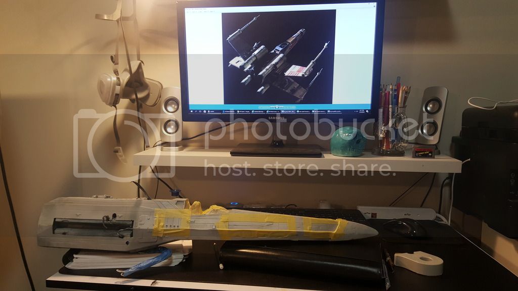

pcoz, both the base and the ship look great...so much detailing on both. how stable is your display...looking at it makes me worry its going to tip over, but i think its just the angle in some of the pics.
agreed. though gus has a great cockpit, which i snagged, I'd be interested in some resin casts / prints of the engines and the cannons for sure.
Thank you sir! I appreciate the kind words..... Yes, the base and display is solid as a rock. No worries there. My only concern may be the upper wings. There's just enough sag in them when I loosely assembled, that it might warrant some modification once I wire them and permanently fix the wings. Regardless, it's been a fantastic learning/ craft honing experience. It'll truly be one of a kind. I'm pretty excited to see it painted and lit up.

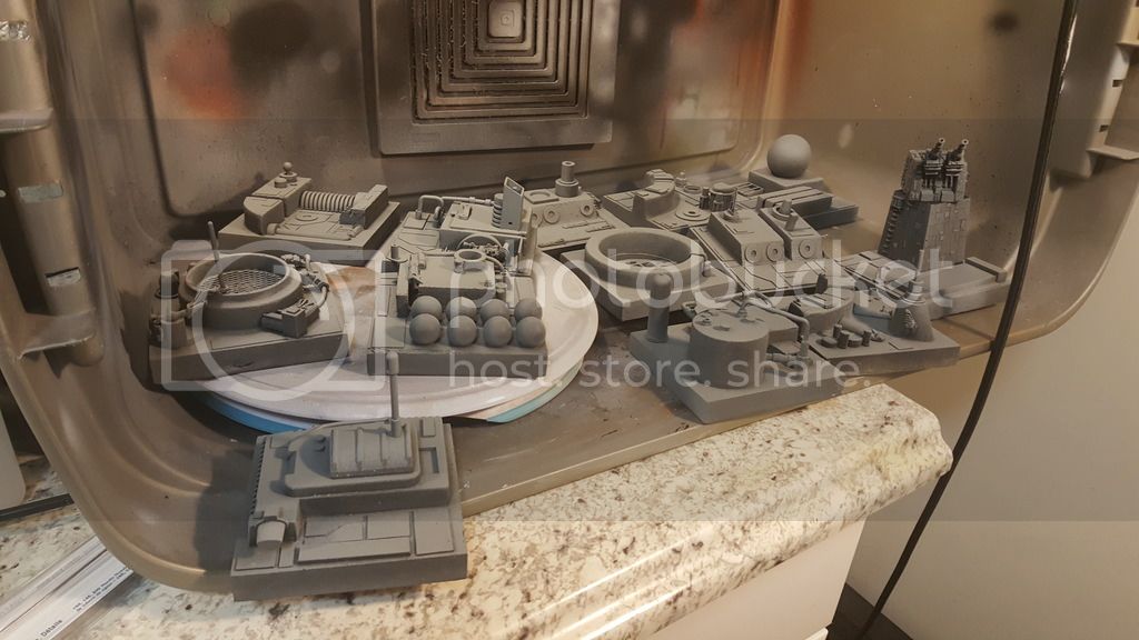

A quick update on some odds and ends before the start of X-wing exterior paint job.

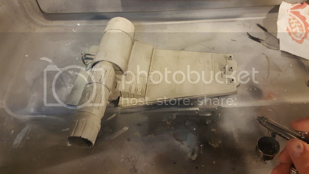

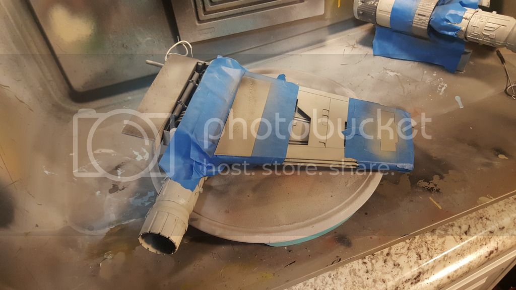

So now I'm painting 9 separate parts. 4 wings, 4 cannons and 1 fuselage. It makes it a whole lot easier to handle each part separately when doing detailed finish work.

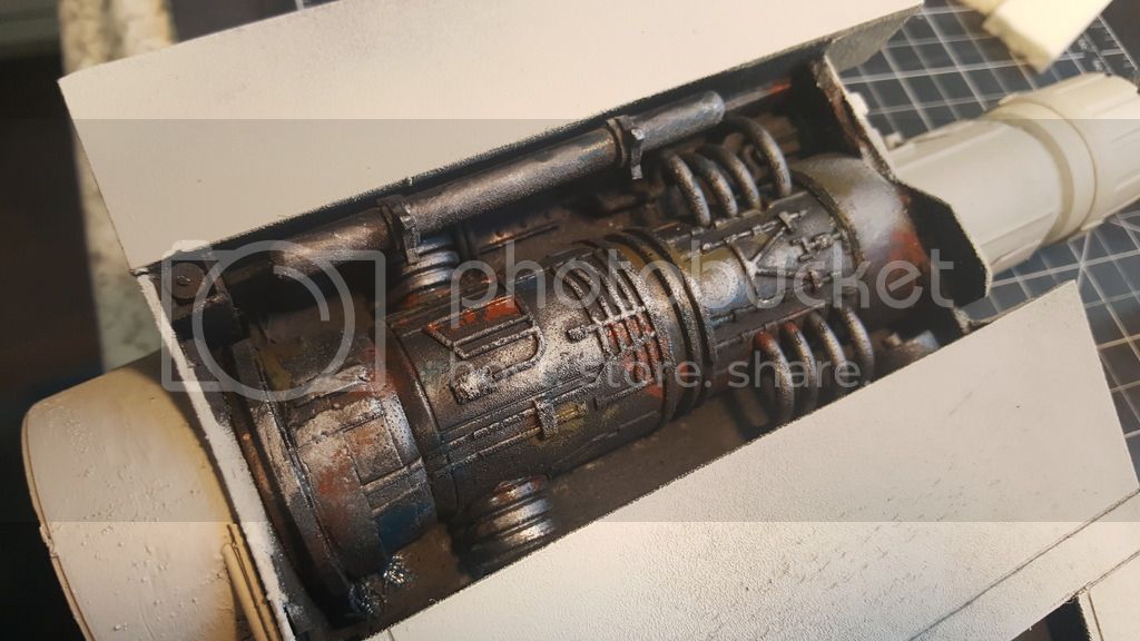

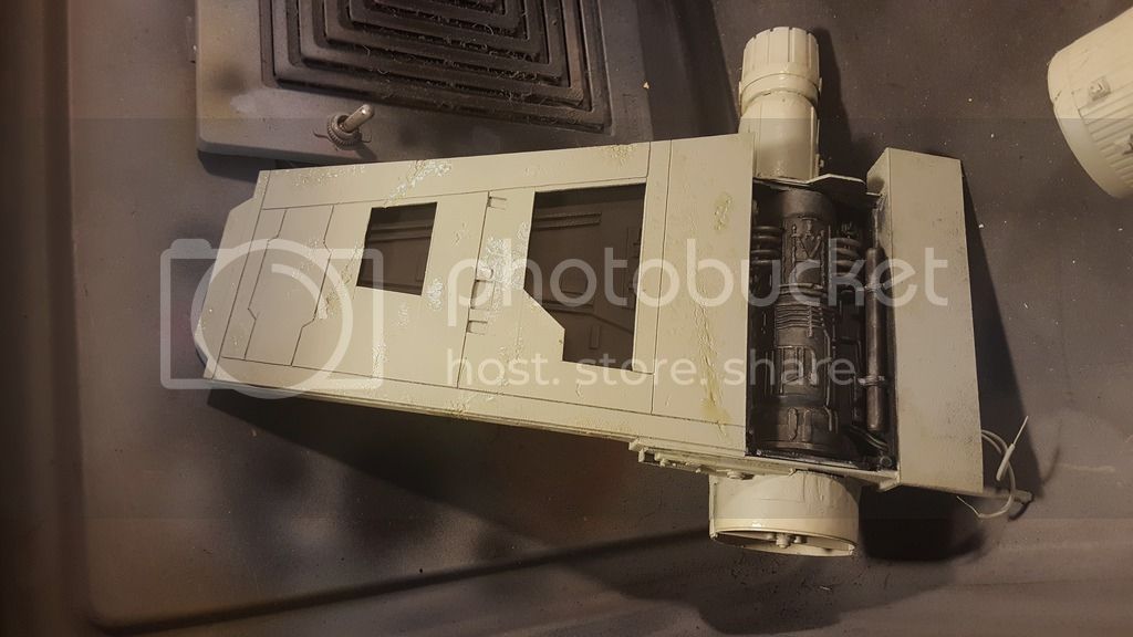

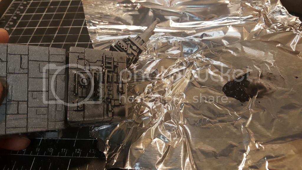

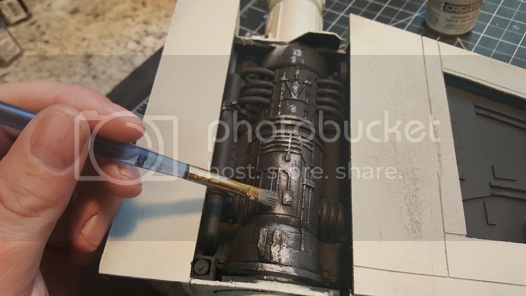

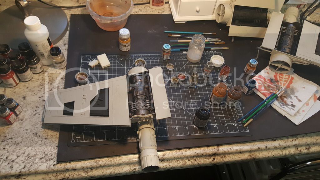

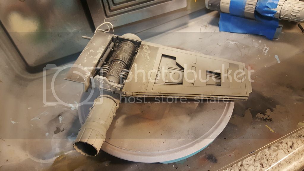

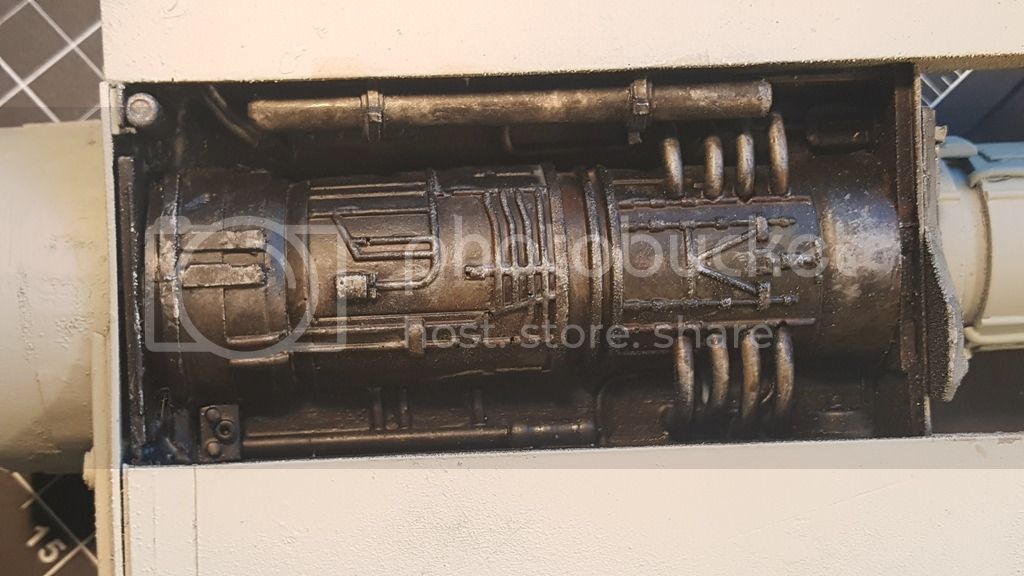

Started working on the engines. I wanted to give this a dirty make over but not too filthy that it looked like a rusted heap of...well, you know.
Used some silver to highlight the raised areas.
Then I came in with some washes, blended them in to add some color and depth. Also trying to be mindful of leaving the black base showing through.
Since the black is a flat black primer, I used enamels and enamel washes.

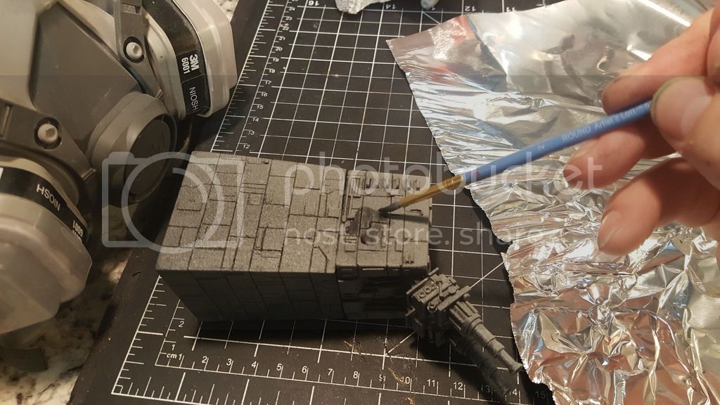

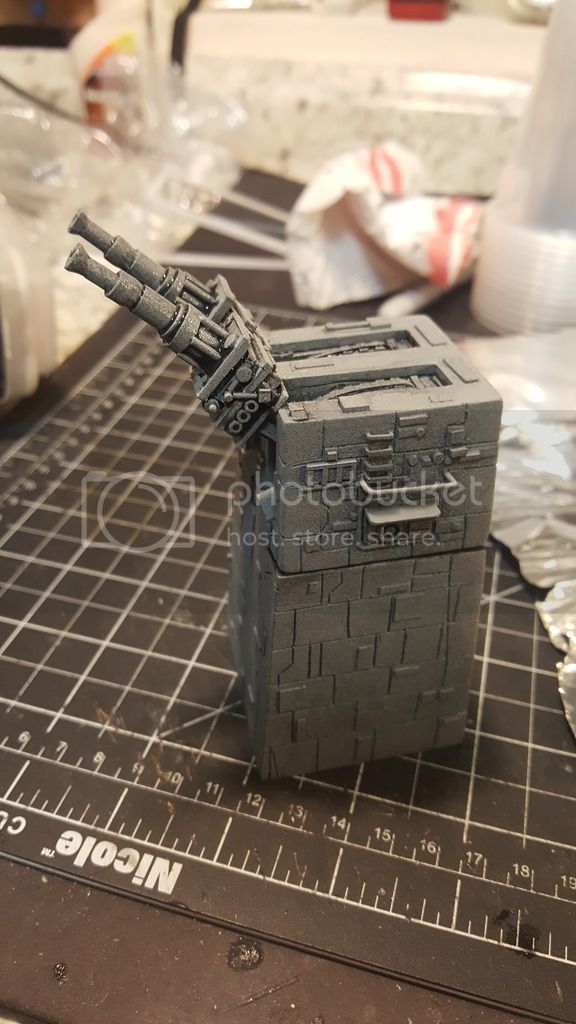

Black acrylic washes for the death star components.

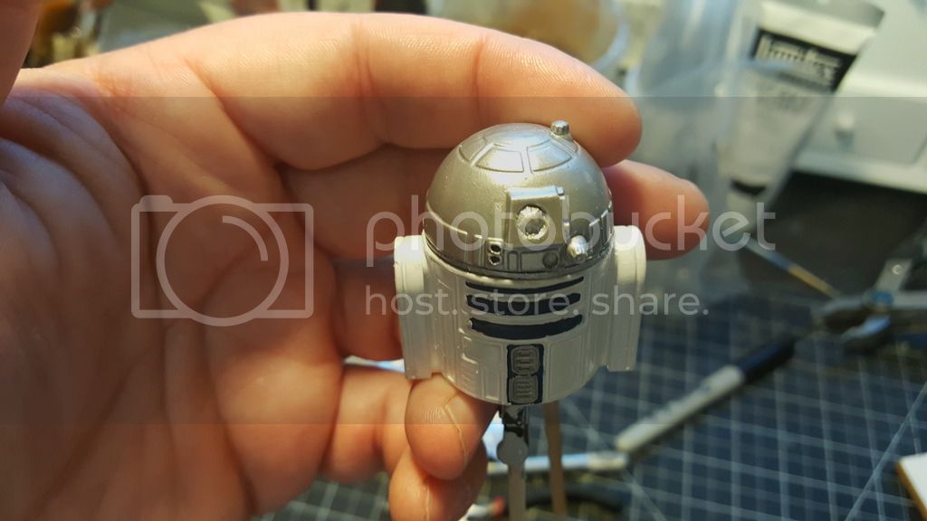

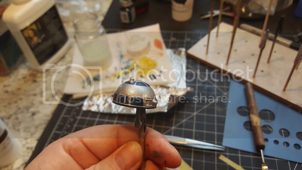

Figured I'd get a start on painting R2 while the other pieces were drying.
Came back to the death star surface pieces and gave them some light grey highlights. Later, I'll slightly weather and add some painted details.
Back soon with the X-Wing Paint Job !
Thanks for looking and I'm always open to suggestions !

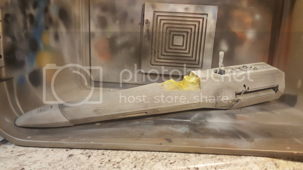

1. Bonding Primer (for plastic)
2. Black Primer (for light blocking)
3. Enamel Testors Light Aircraft Grey for base and smoothing (cured for 3 weeks)
4. Matte Clear Coat to prepare for acrylic and washes
5. Masking Fluid (pictured below) to add subtle texture
6. Mixed an airbrush color using, White, Black, Brown, Yellow to over coat.
7. Mask panels and paint various colors
8. Washes & weathering
9. SLIGHT airbrushing....NO BLACK ! Sorry, too many times I've seen these X-Wings look like they just lost a battle with a black rattle can....
10. Try not to screw this up !
Ok, let's go:

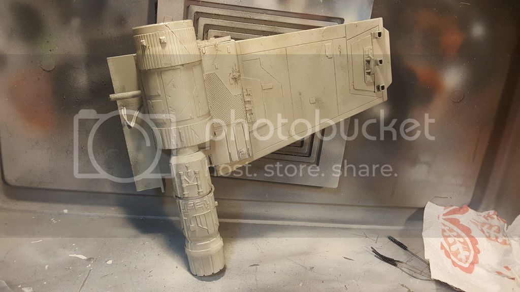

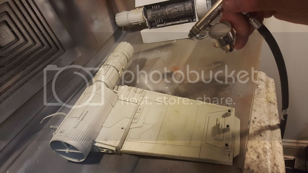

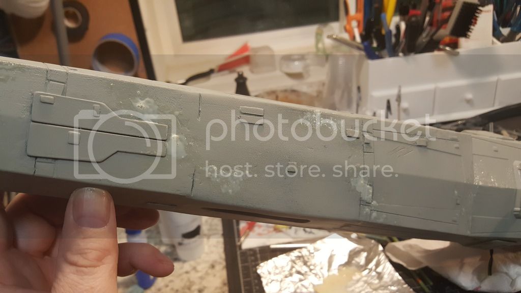

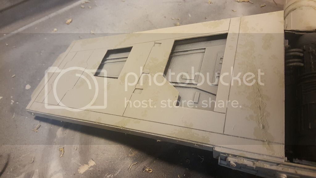

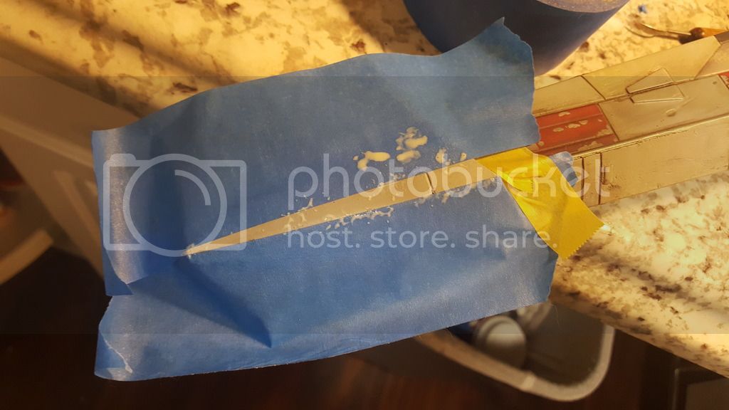

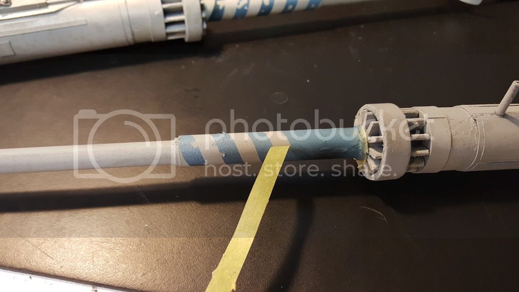

Adding masking fluid all over every part. I know a lot will get covered up with weathering and paint layers, but I want the depth.
Spraying the over coat.
And one of the most enjoyable things do do in my life is removing masking ! It did make a mess though...
Looks like a weird camo...but trust me :D

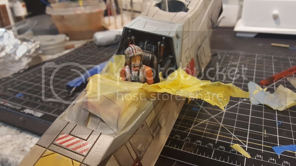

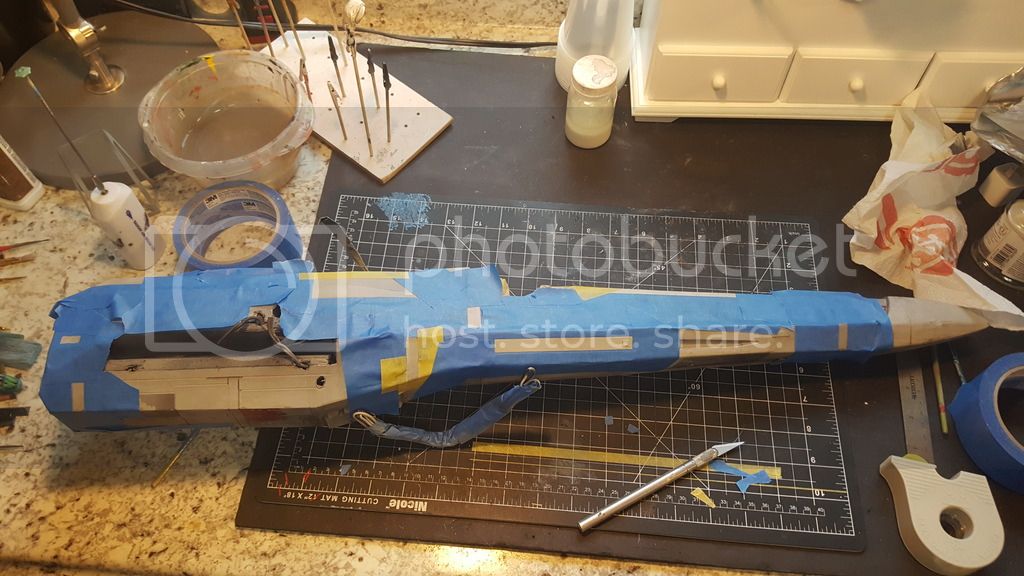

Starting to build up the fuselage...

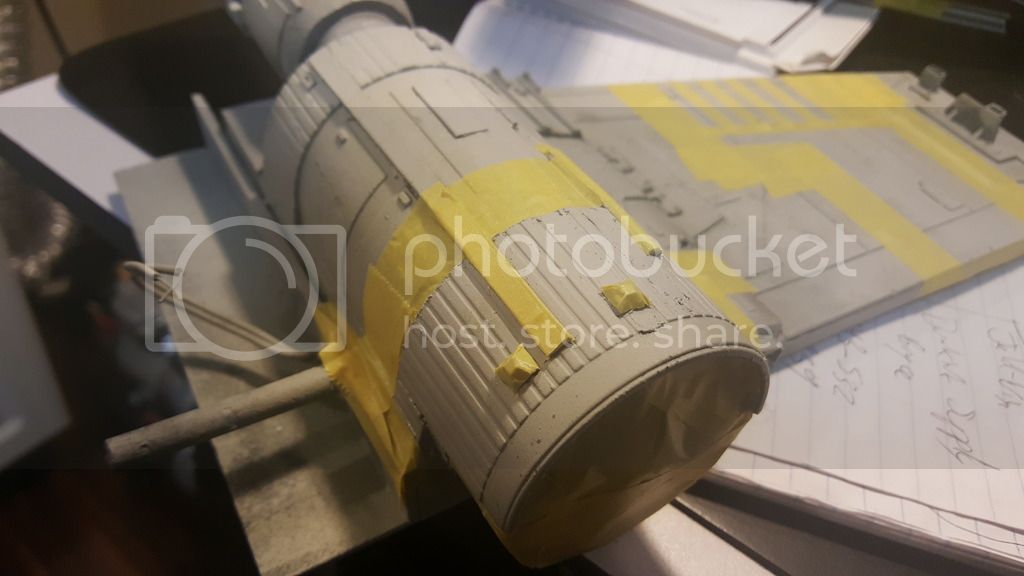

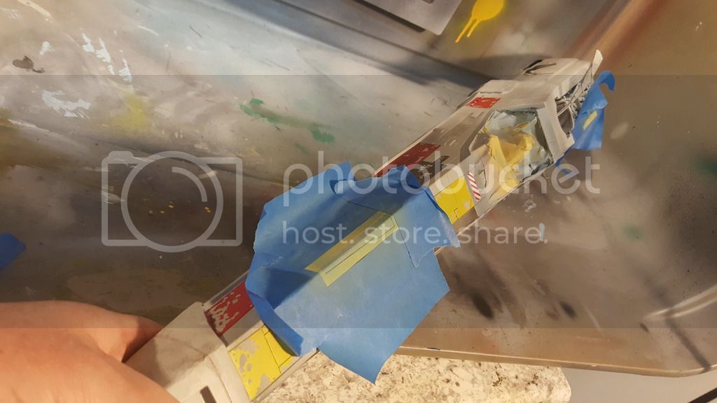

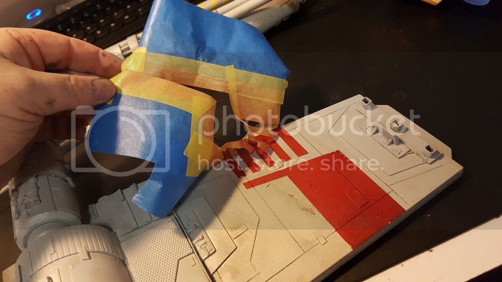

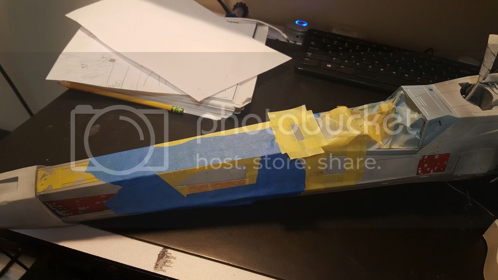

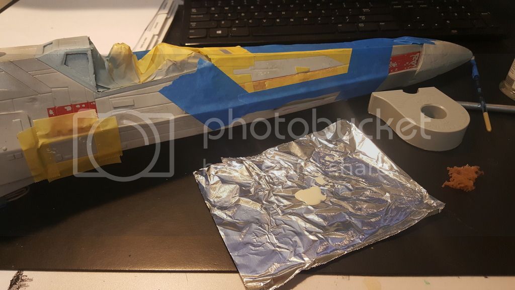

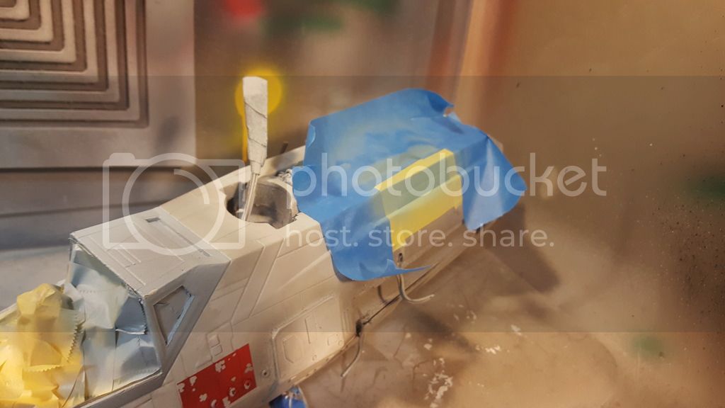

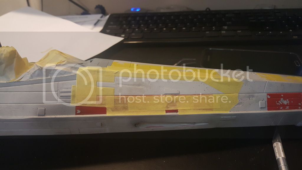

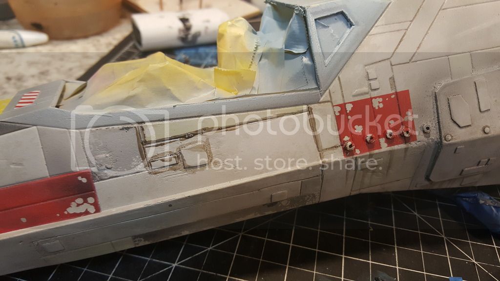

and then time to mask the markings....
even more masking.....
tape combine with fluid.
tried to use the fluid for some of battle damaged areas.

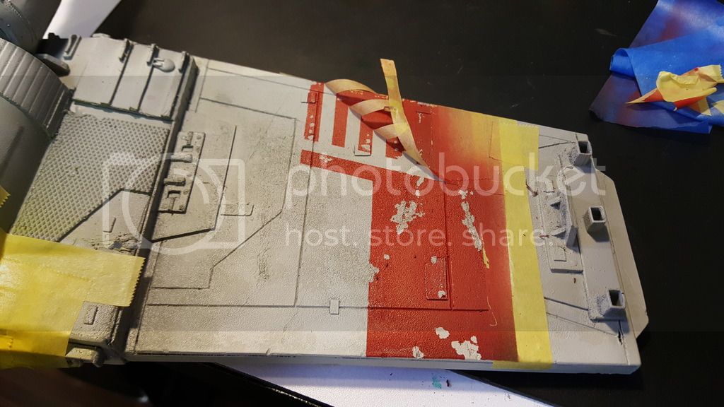

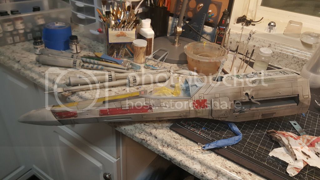

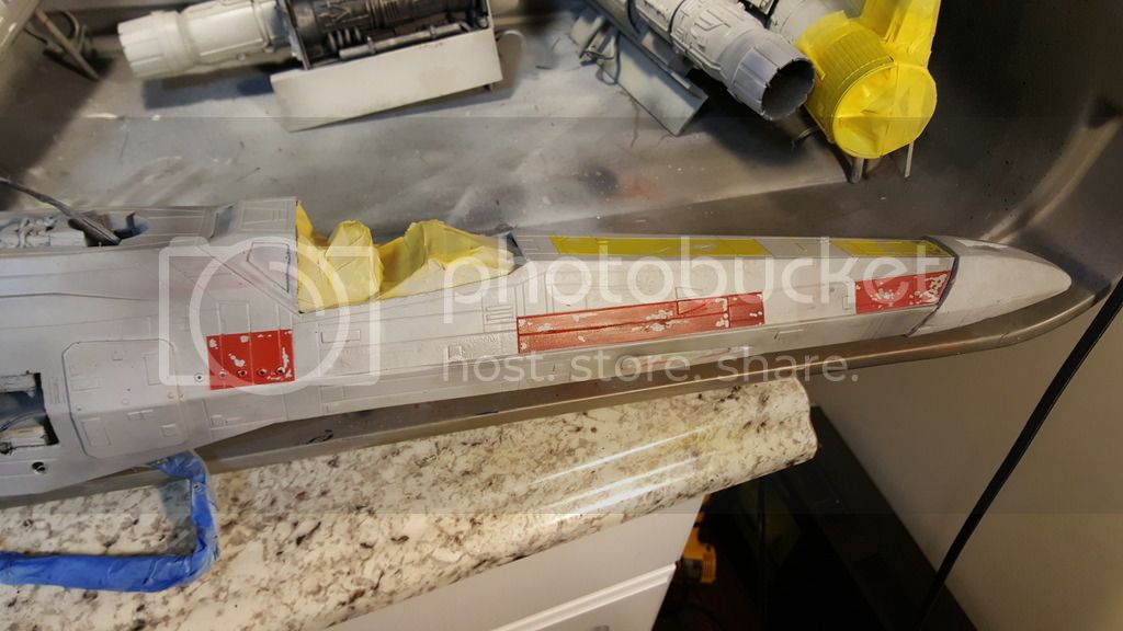

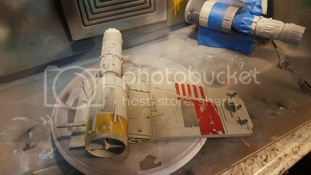

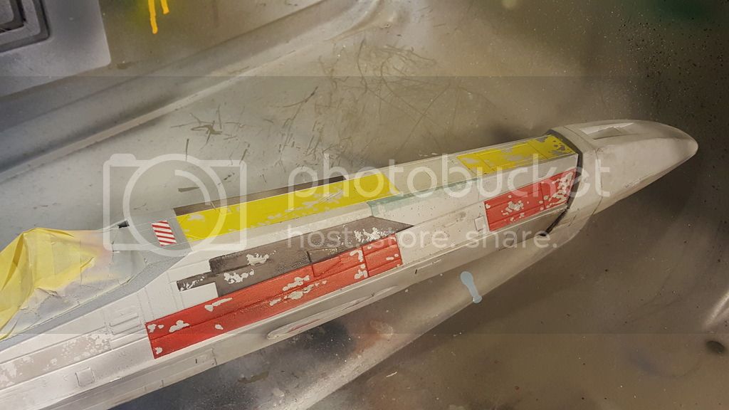

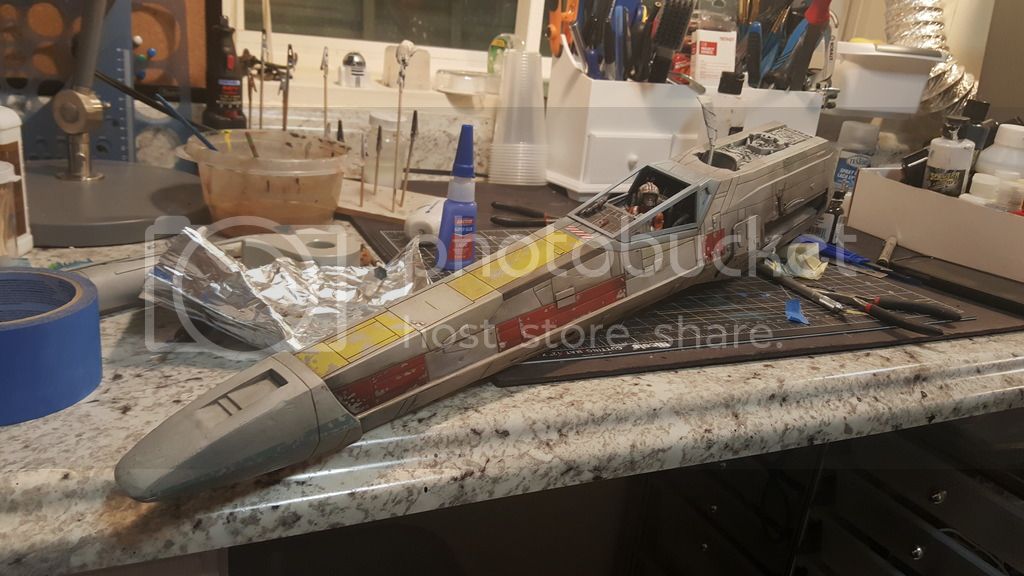

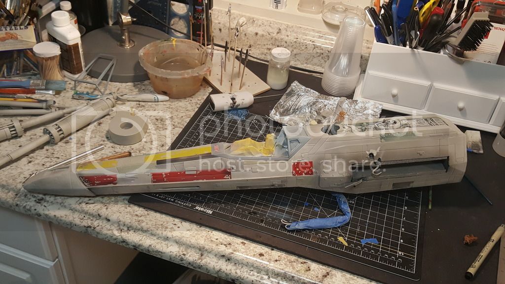

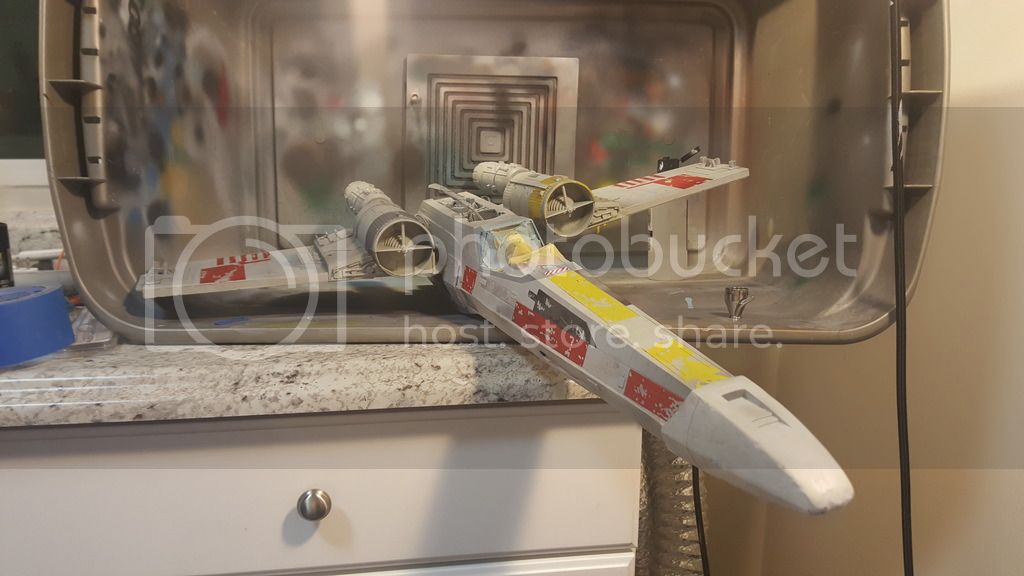

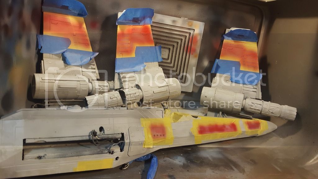

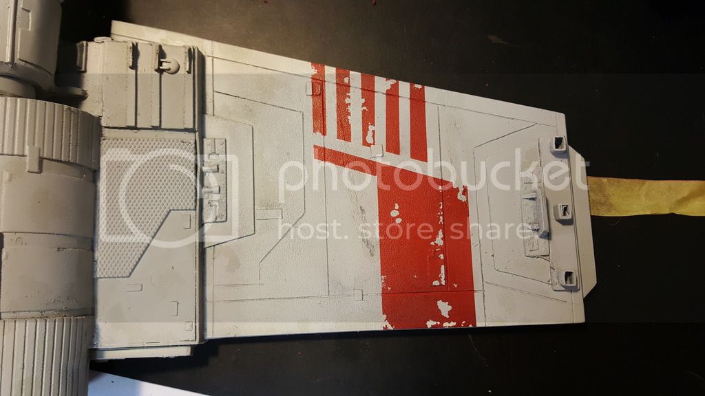

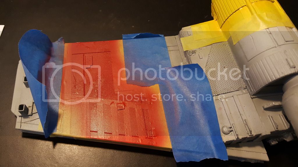

Ready for RED !!! I never thought I would get to this point.....so excited, lol

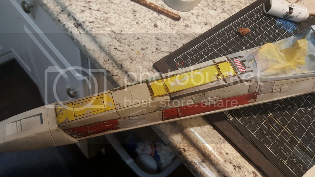

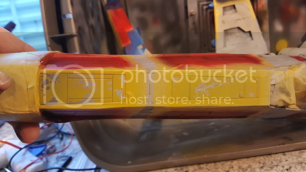

Masked for the yellow too....
rubbed off the masking fluid for the yellow.

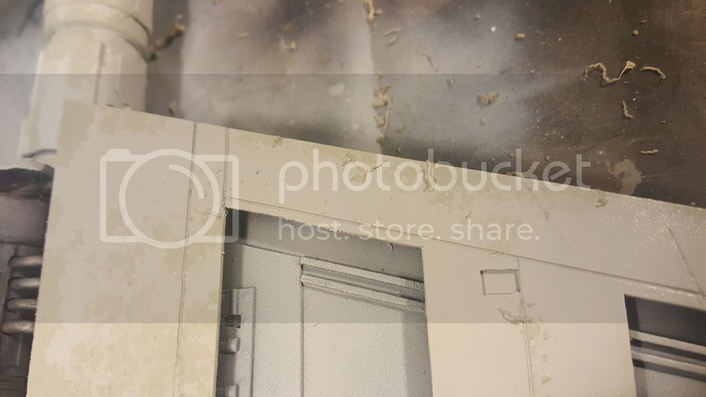

One of my first mistakes was not masking off a larger area to account for over spray, as you can see below. :facepalm Fortunately, I was able to use a little airbrush cleaner and remove it...phew !
Again, I cannot stress how enjoyable this part is....If there was a position for a professional masking remover, I'd be first to apply !

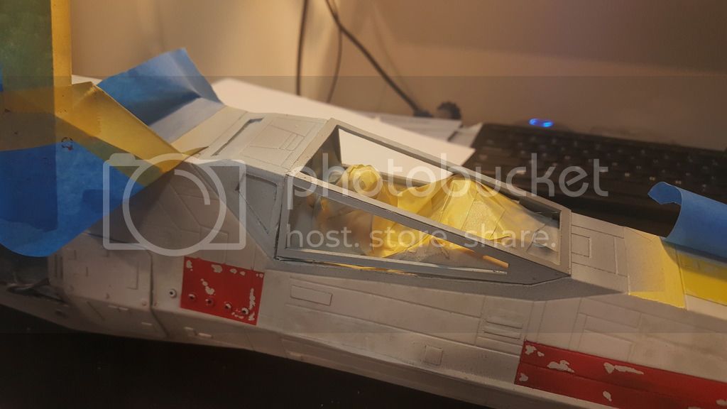

Trying to determine the color scheme of the panels even though my X-Wing is a mix between multiple sources.

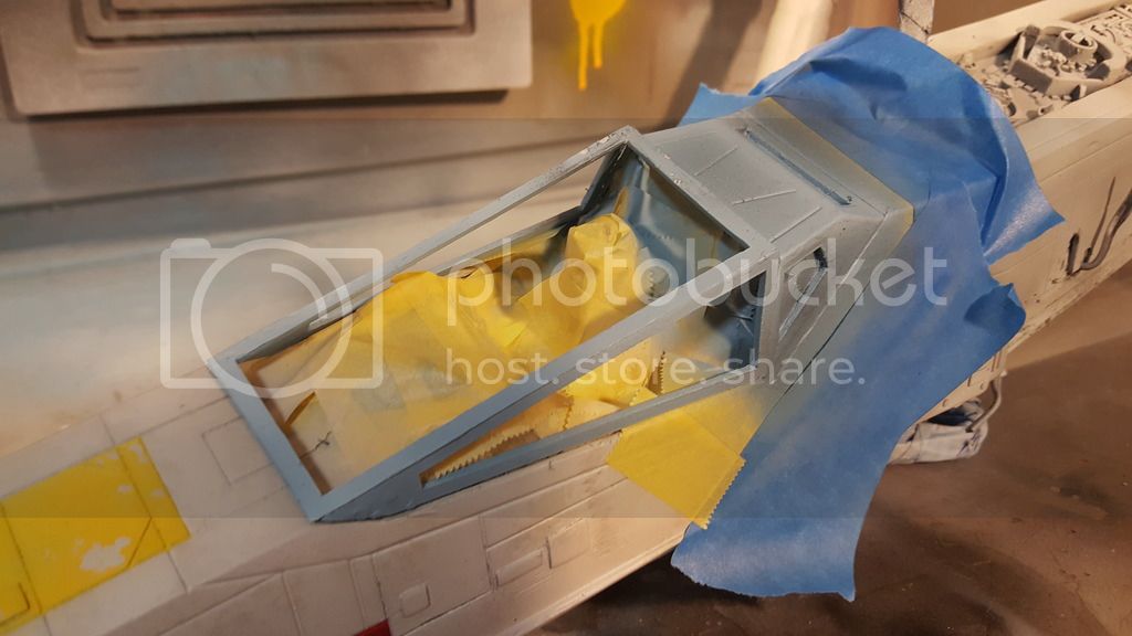

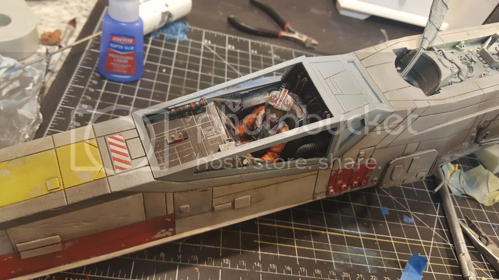

I mixed a blueish grey for the canopy and the cannons....

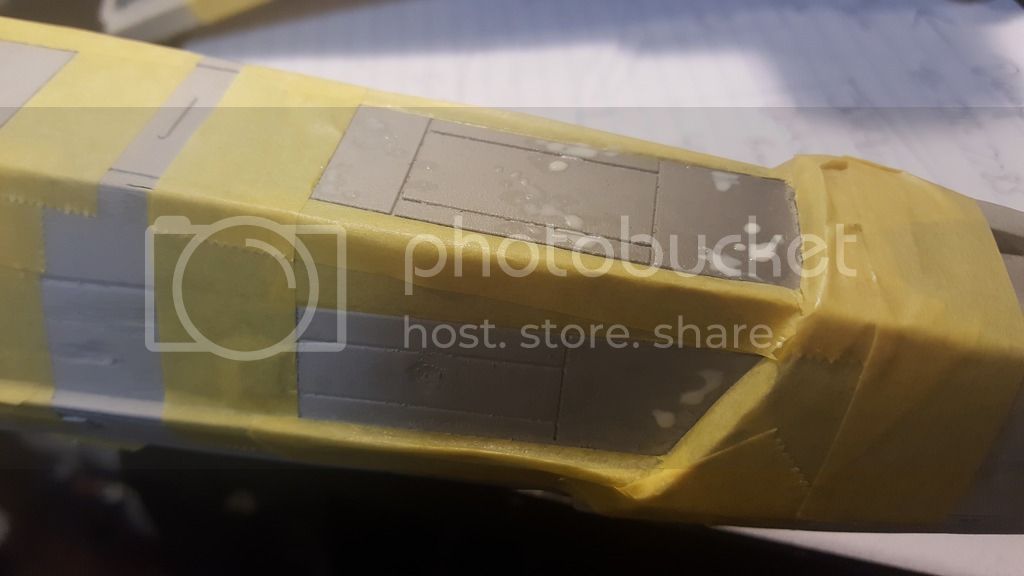

Now that I've got the main colors done, it's time to address the subtle color differences in the rest of the X-Wing.

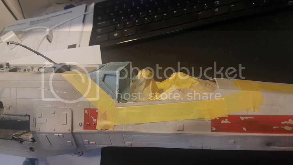

After looking at the original color of the canopy, I decided to repaint it and tone it down a little more into a lighter grey. As I was taping it off, I realized I missed the entire border around the opening.
Resprayed
Working on the panels
and of course some liquid masking for damage.

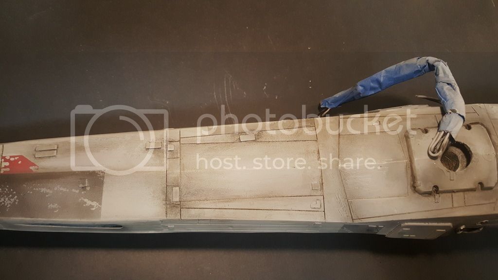

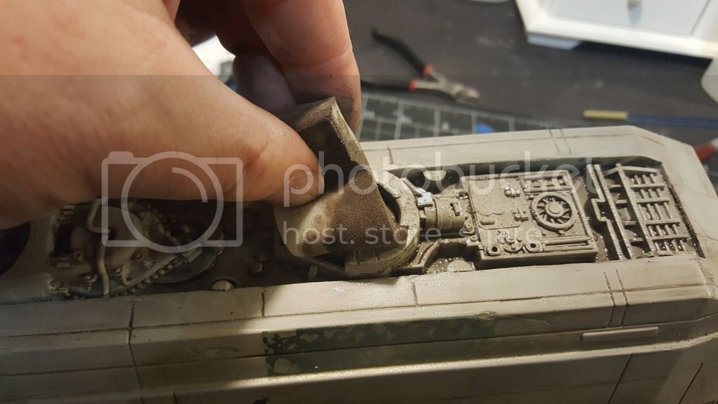

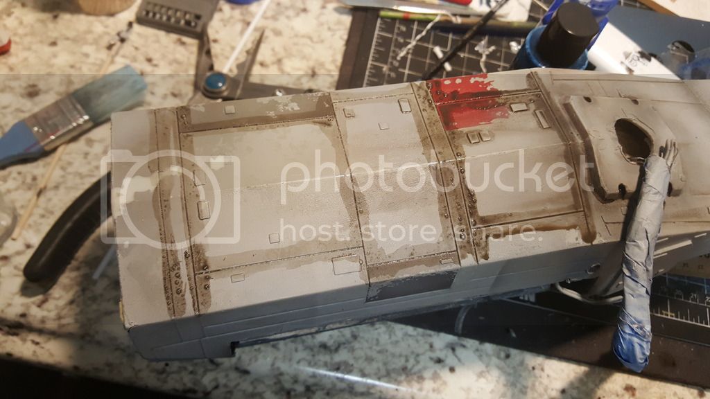

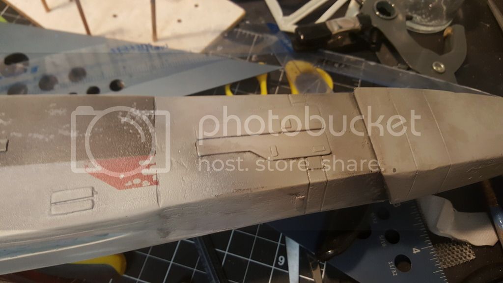

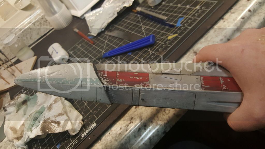

Now to turn my attention to weathering. Not a pro at this for sure, but I've researched a ton of techniques with acrylics, oils, chalk, and the use of all of them. I decided to give my acrylic wash a shot and see how it went.
So I want this X-wing to be worn, dirty, filthy, but not black as I said before. Applied some of the wash....
...let it dry a little and then blotted off with a paper towel. I also used a brush to push it around a little too.
Working on the bottom, so if I screwed it up, I could learn what to do before I address the top.
Pulled back a little of the wash with my fingers to create some streaking.

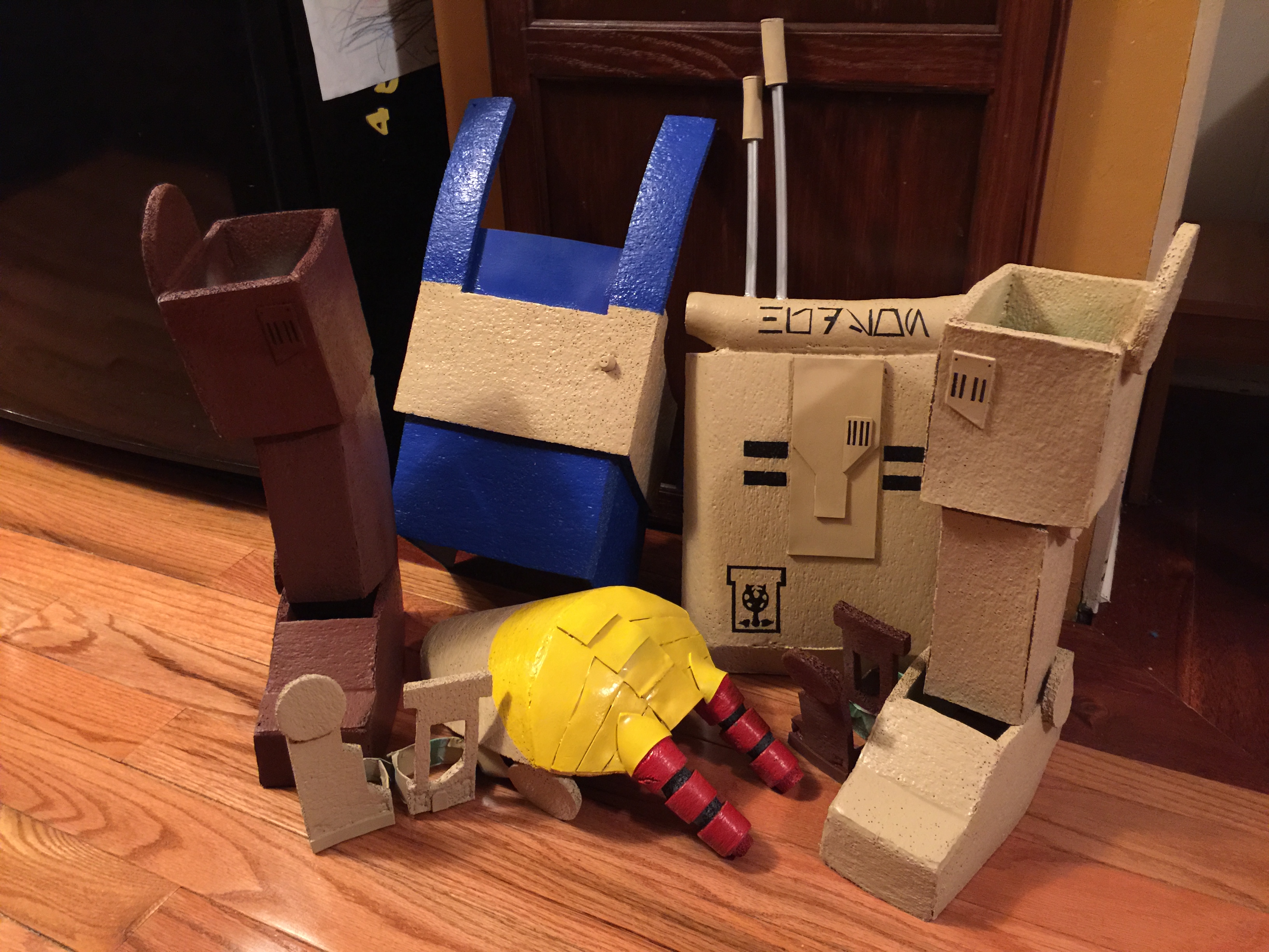

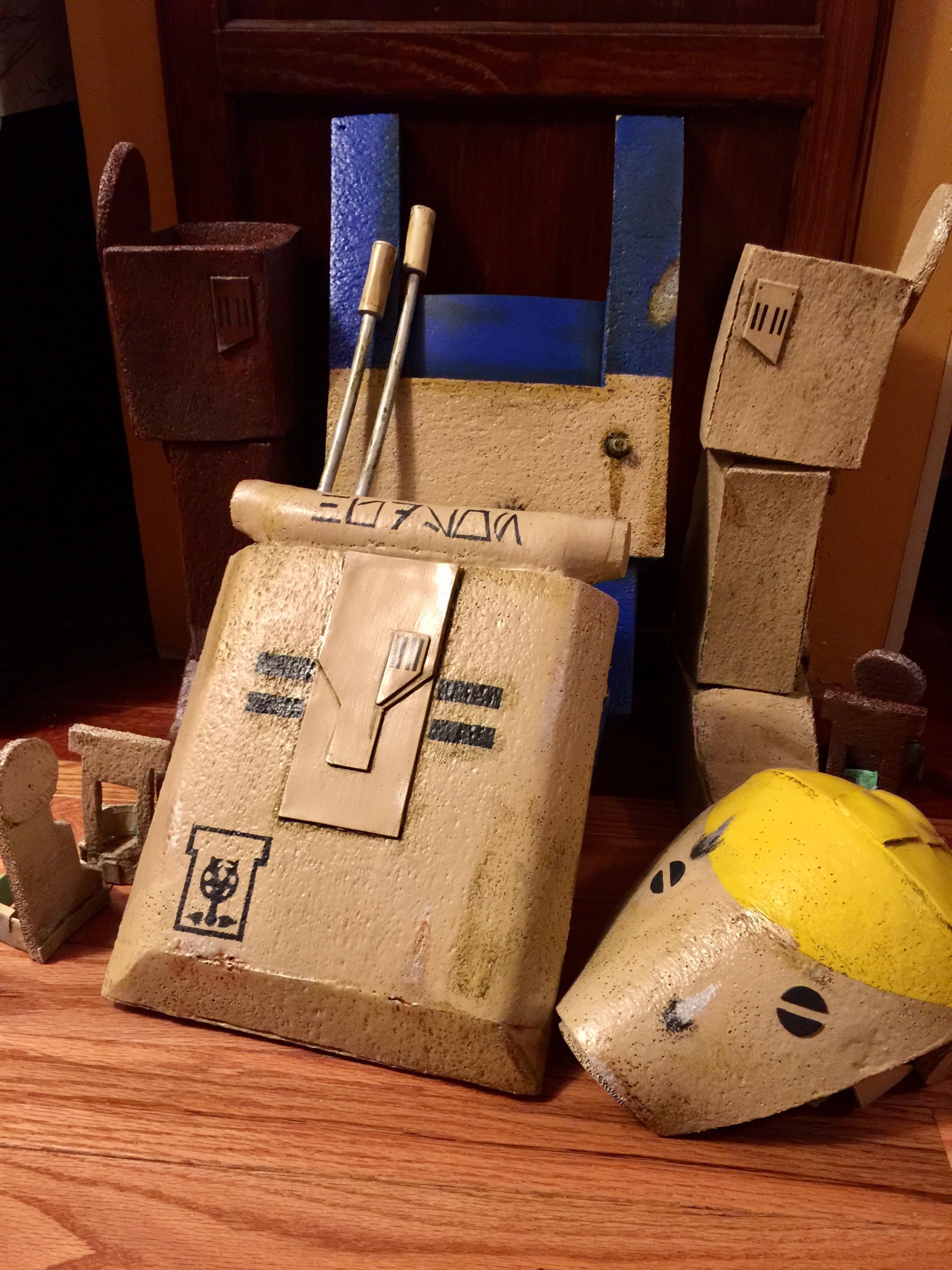

Weathering is always fun, and makes a real difference, not an X-wing but this was my sons battle droid costume from 2 years ago,
before weathering
And after
Re: Pcoz's Hasbro Hero Star Wars X-Wing Conversion
before weathering
And after
That's awesome !This will be my son's last year for dressing up for Halloween, so I want to do something EPIC!
The weathering is turning out really good!
Looking forward to the rest
Thank you sir ! I'm trying so hard not to over-do it!

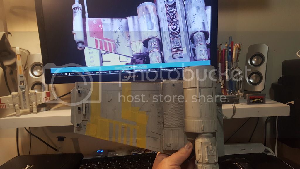

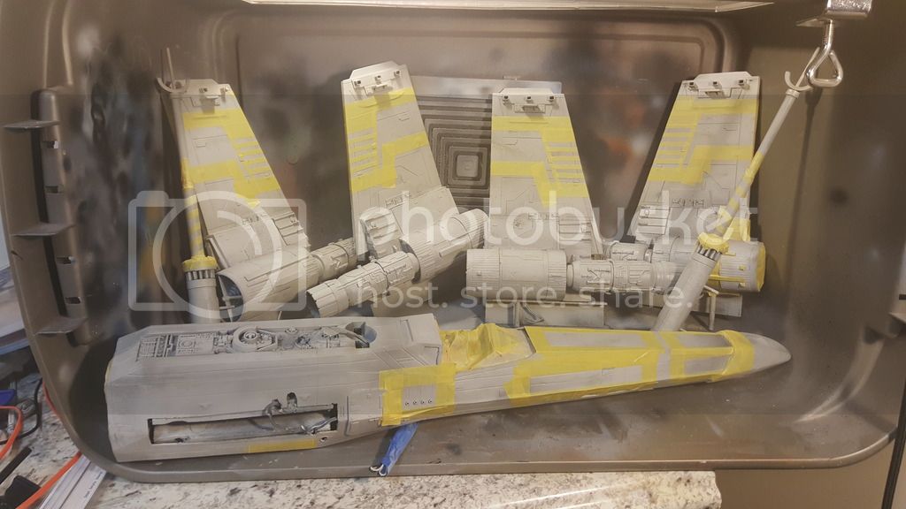

Hey guys.....Here's an update on some more painting and weathering.

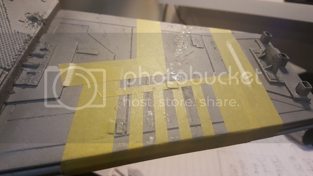

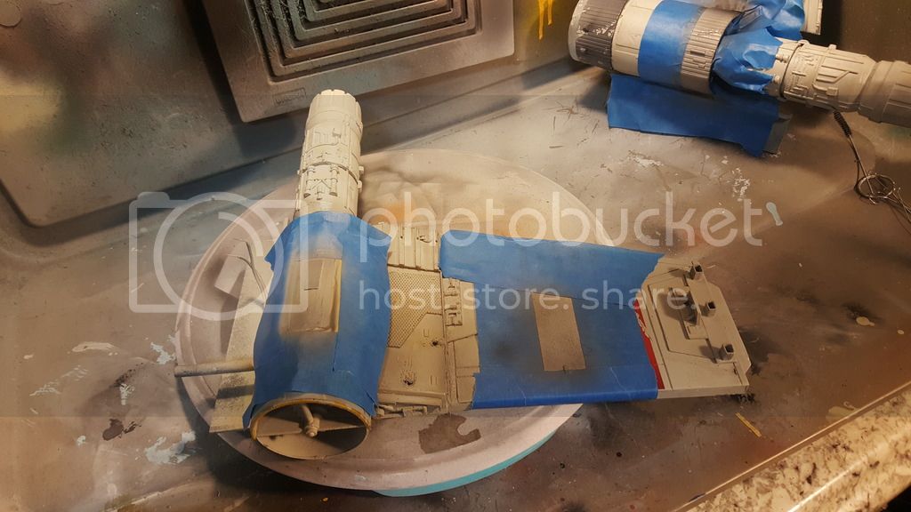

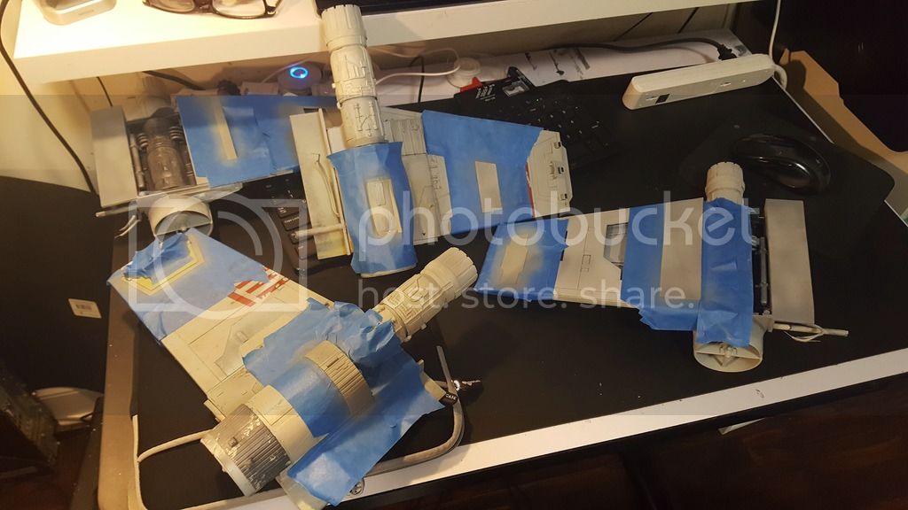

Continued to isolate various panels for paint. Again, making sure I had plenty of protection for over spray.
Trying to get as many panels taped at once to save a little time.
Just a quick coat of translucent grey on a few and tan on others....

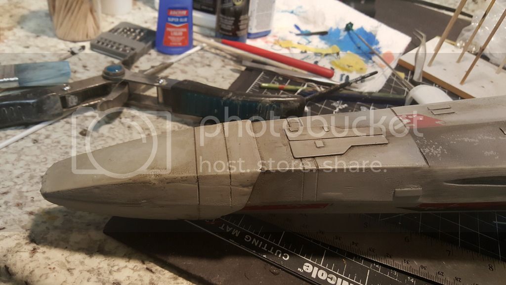

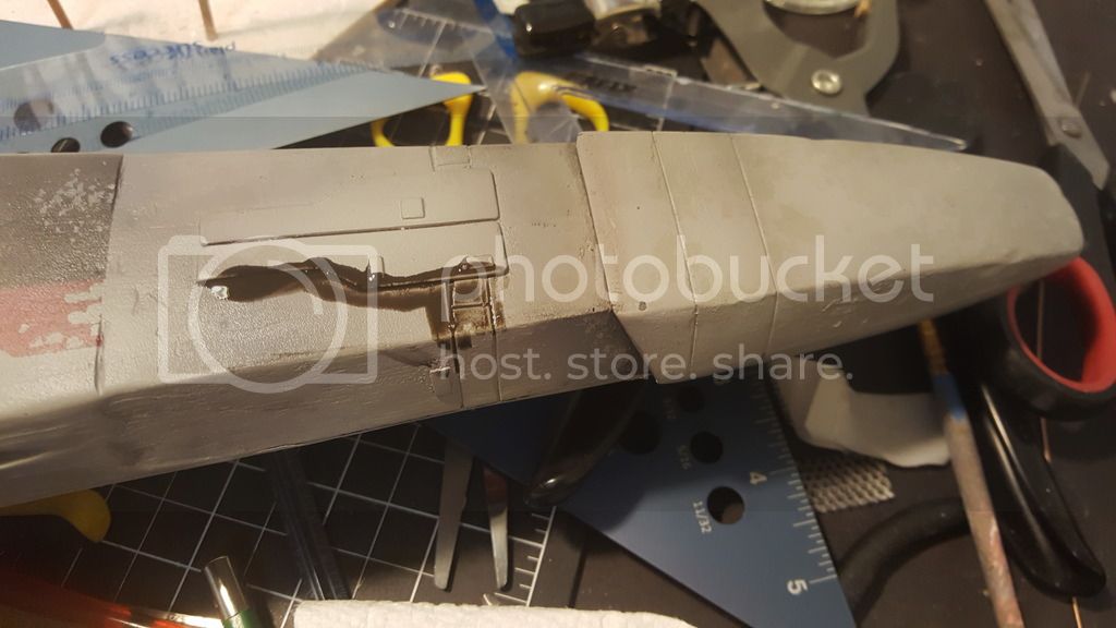

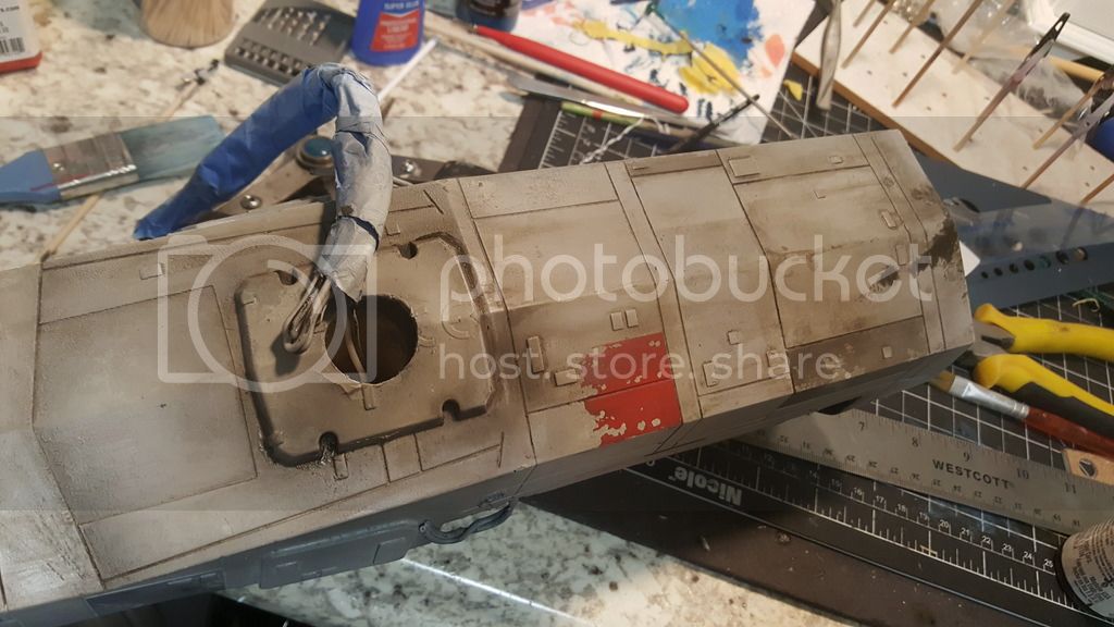

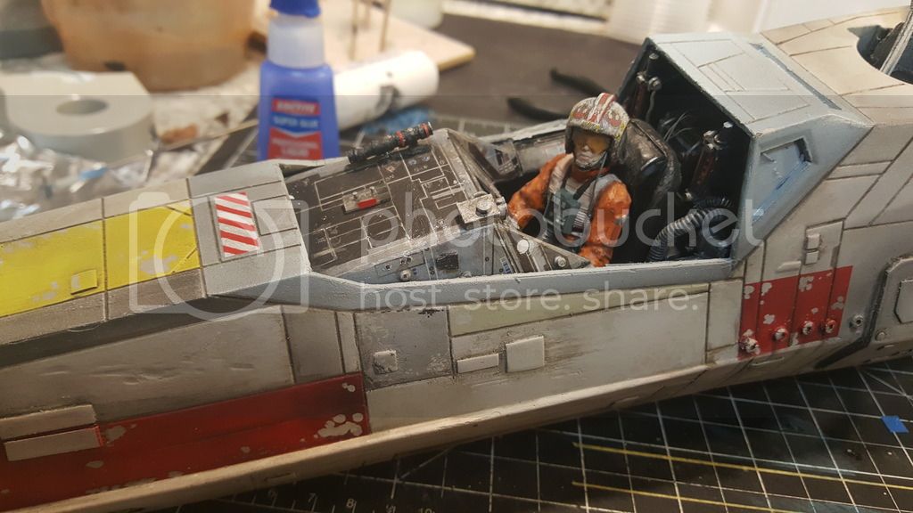

From here, I decided to start weathering the fuselage.

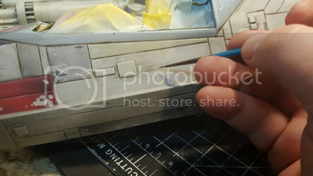

I was happy with the way the bottom turned out so I will continue the same process throughout. Instead of coating an entire section and wiping off the excess, I'm painting each area with the wash.
Filling in panel lines,removing extra wash and then painting the details.
Hand painting instead of airbrushing the streaks...

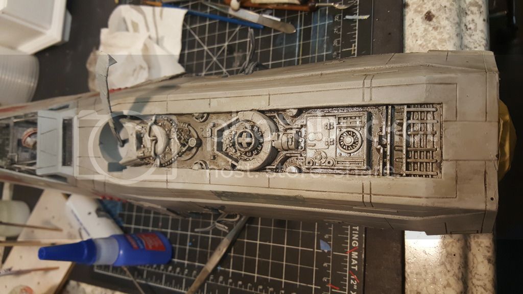

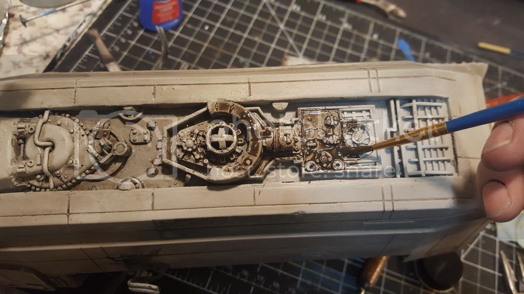

*Small update then back with the wings / cannons later.

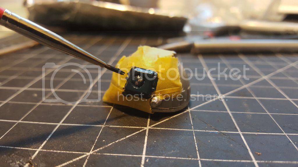

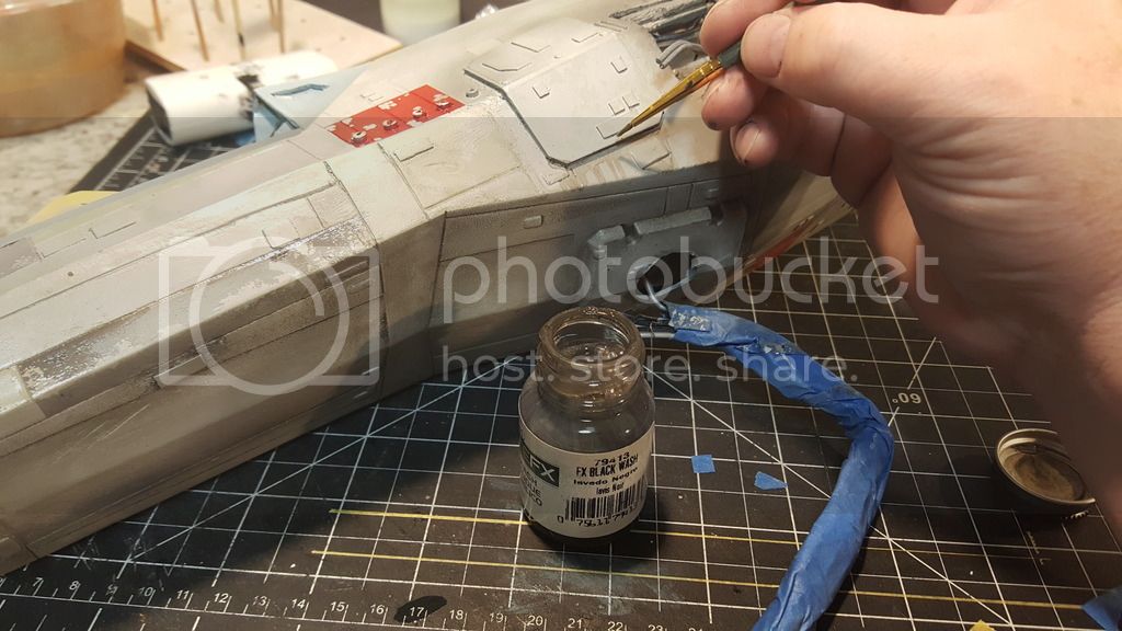

Started to turn my attention to the droid strip. Used the Black Acrylic Wash again (even though it's actually brownish) to get the small details a little more defined.
blotting the excess...
The butt plate needs a little repair and paint detail. More on that later.

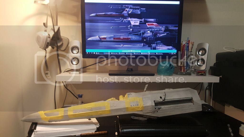

And a profile comparison to the Red 5. Although I am matching this closest to this model, my overall take on this X-wing comes from multiple sources. ILM Models, 4' X-Wing, Movie Stills, etc. Kind of a hybrid of sorts.
