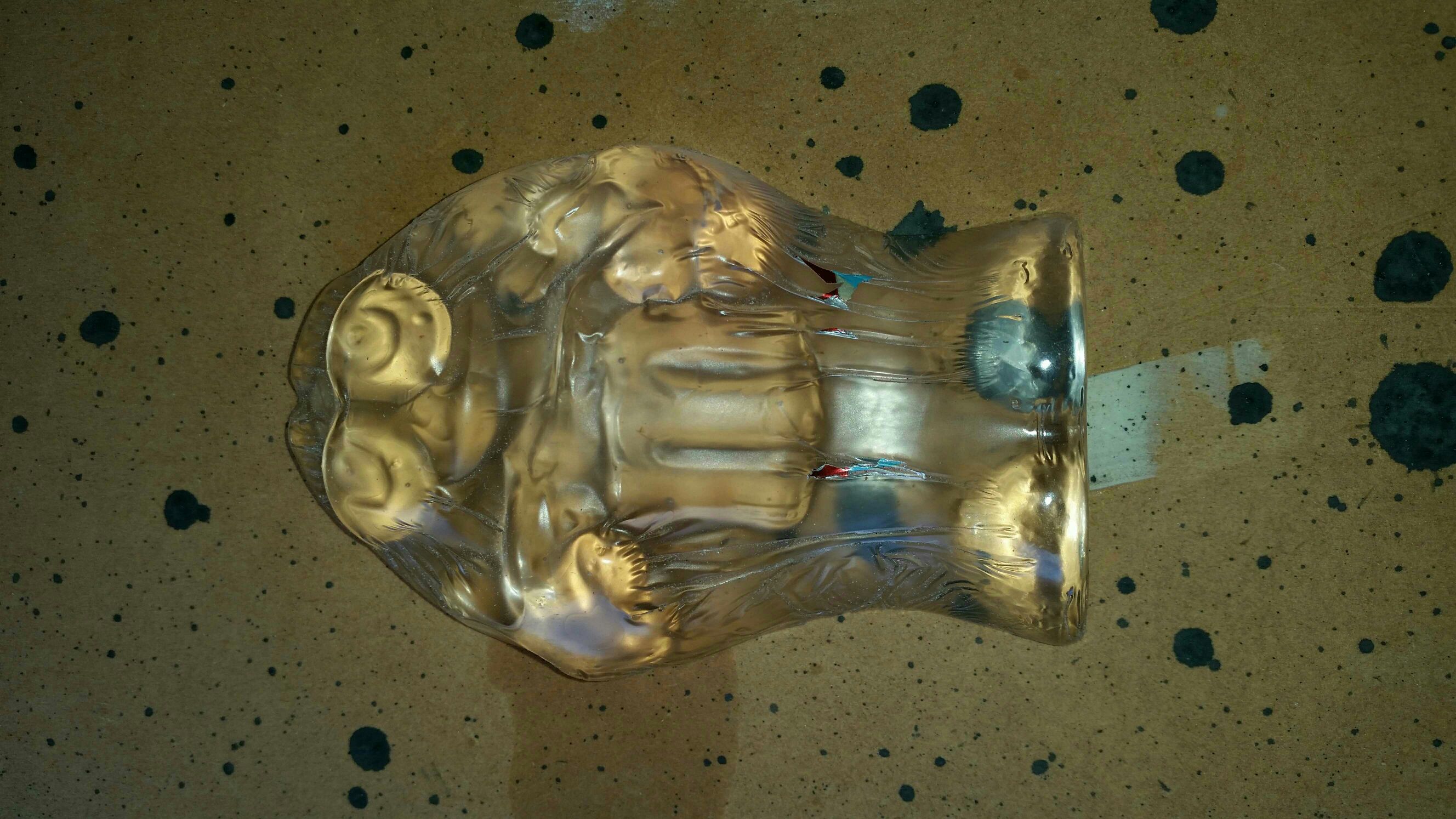

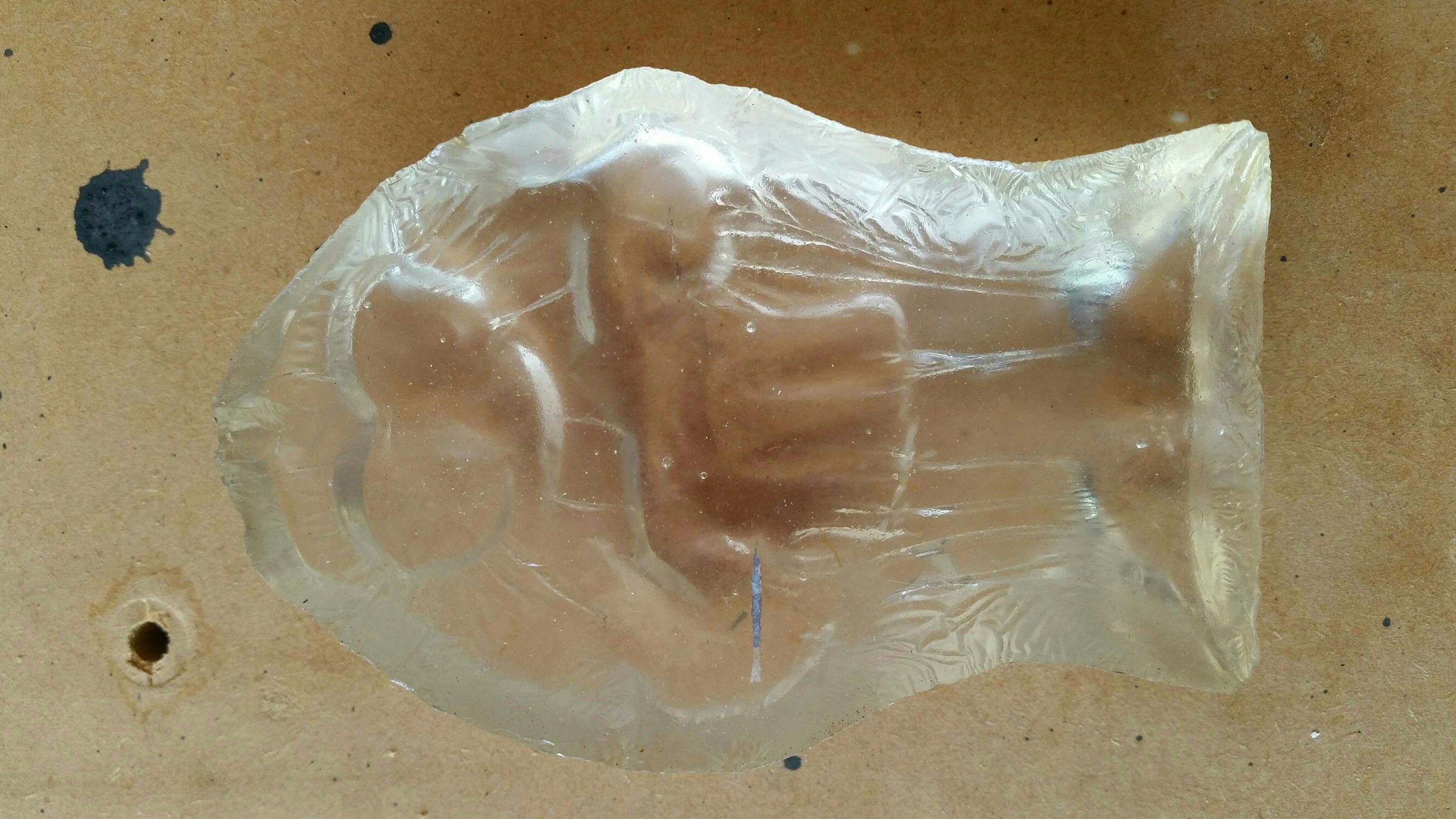

This is a cheap polyester resin. I did this pour back in 2006 when I could not get my then degassing chamber to work.
It is possible to mix and pour clear virtually bubble free but the results are very hit and miss. This part still has 6 bubbles. And this was done breaking all the rules. I let the resin stand so that it had no bubbles. I then slowly added the cat. I used a wooden stiring stick and never took it off the bottom of the pot. Once all the swirls were gone, I tipped it into the mold so it ran down the side. The mold in case was the foil wrapper of a big M&M.
I was attempting to make solid resin prisms back then and out 20 poured, just one came out bubble free.
So if you don't have a pressure pot, you really want to get a degassing system.
