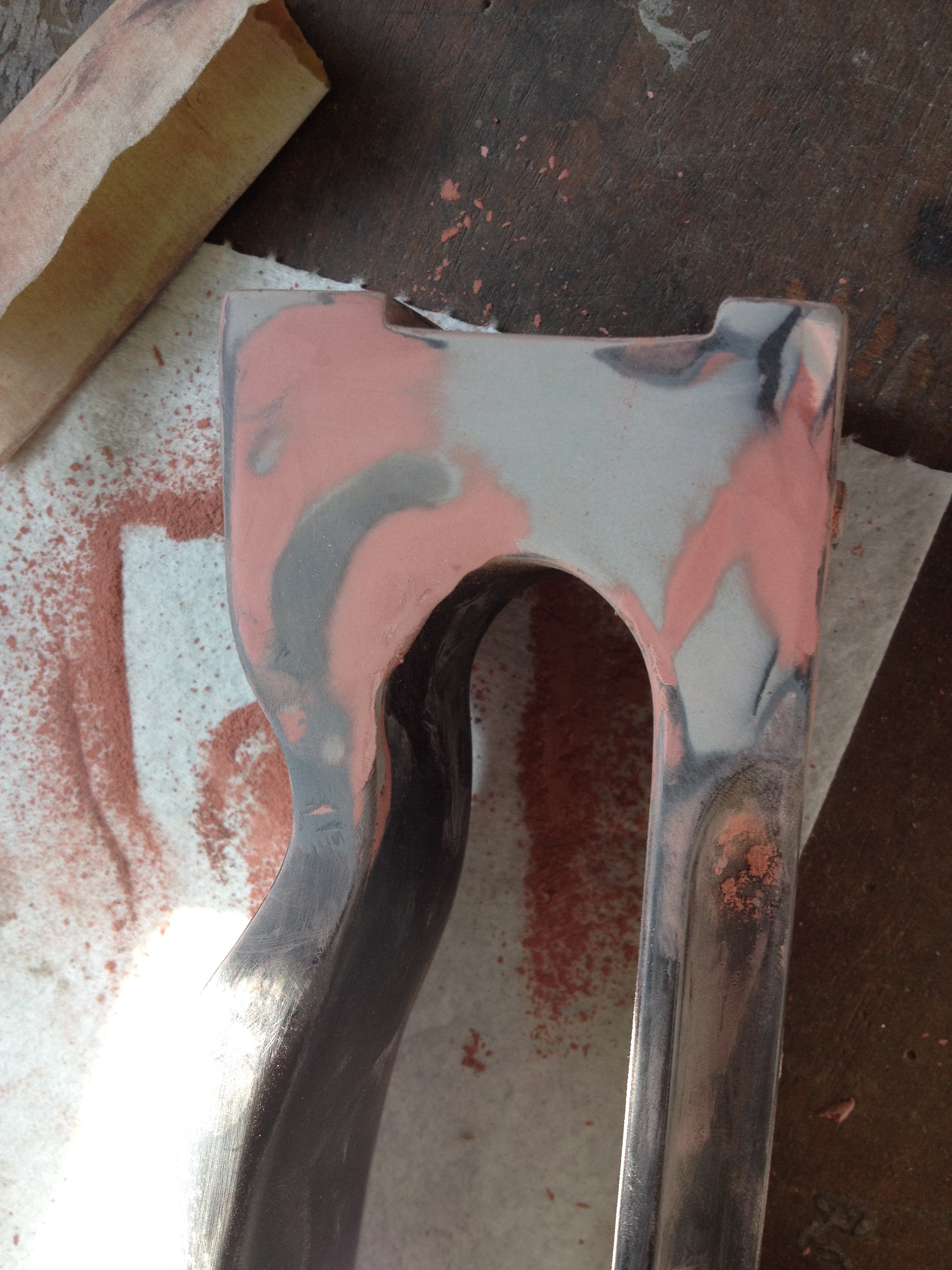

Yes several coats its very smooth. Needs more prep work with the filler i suppse.just have to keep at it.
Re: Chewbaccas bowcaster build

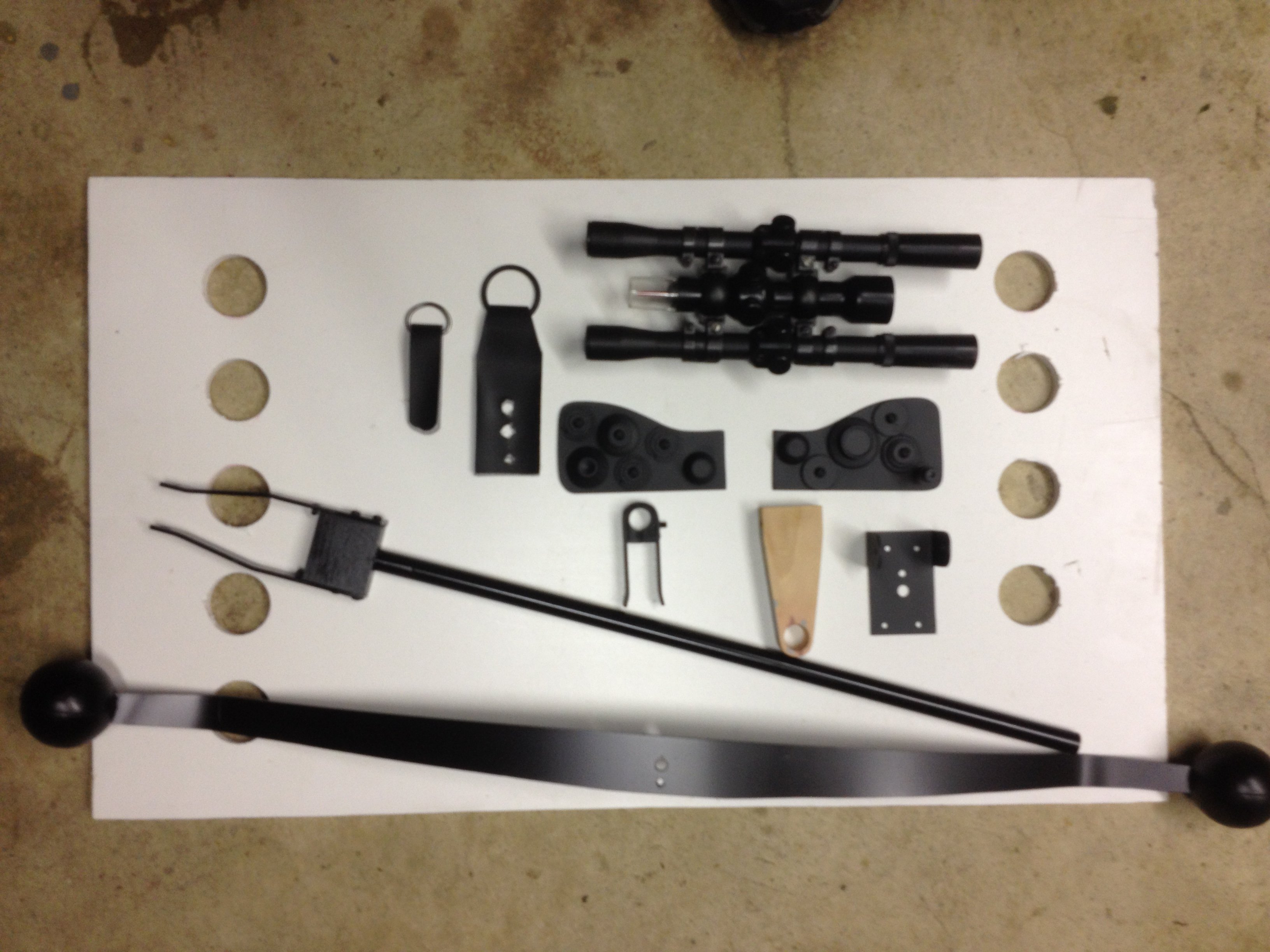

so mixed up some filler and applied it to the front of the bowcaster body on both sides to try to even it out. The other picture is all the parts i have made and most are painted. Used satin black on the pink balls and the bow. Everything else is painted flat black.

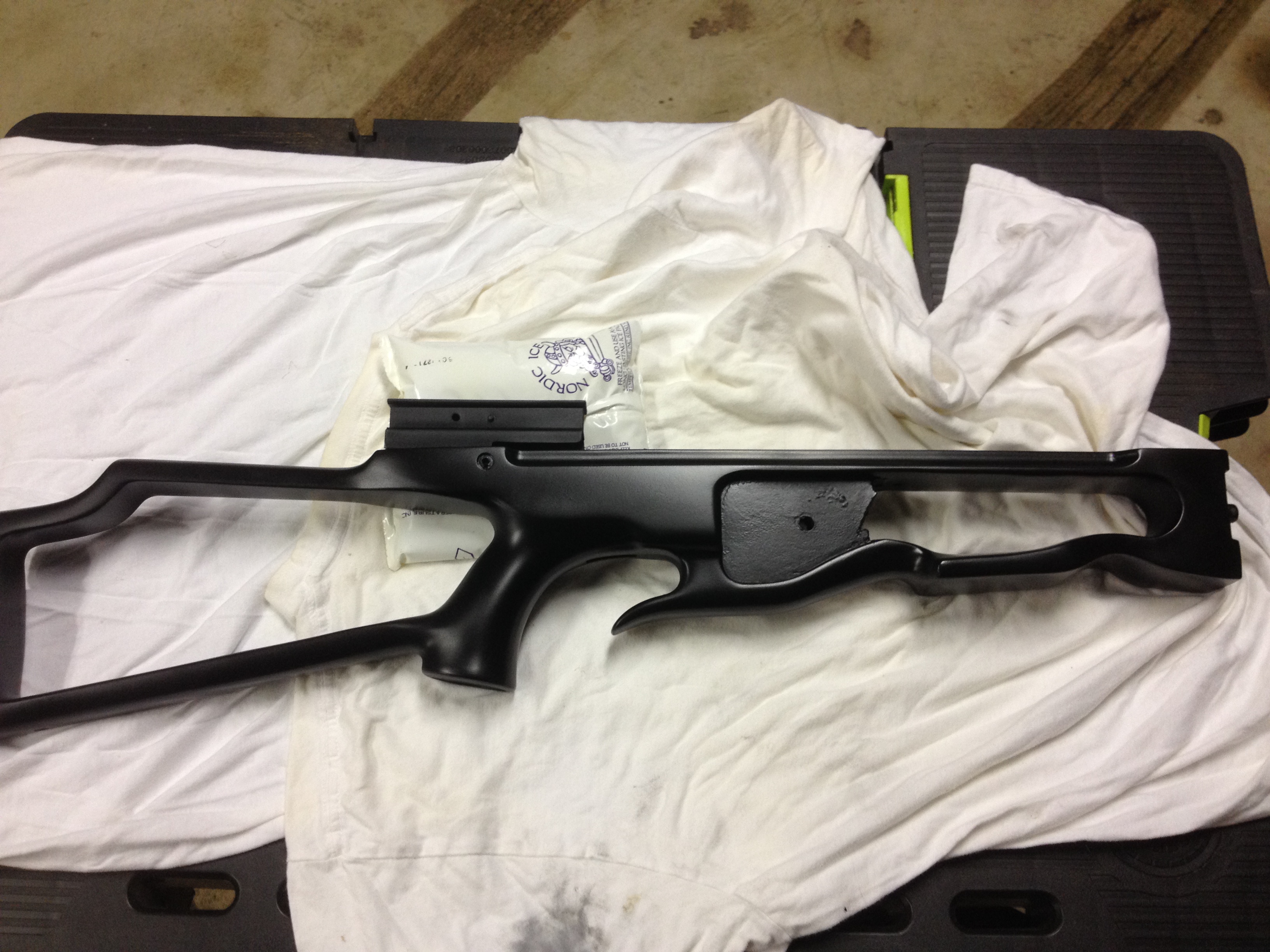

Hi all
painted my bowcaster frame...... AGAIN!!!!! Was looking real good....was till I dropped it! Every trouble spot popped out after. Most trouble Ive ever had building a prop. Im so mad at myself for this im thinking of shelving the entire project. Ive put a lot of time and energy into this. Really want to finish this and dont want it getting the best of me. Heres a pic before I dropped it.

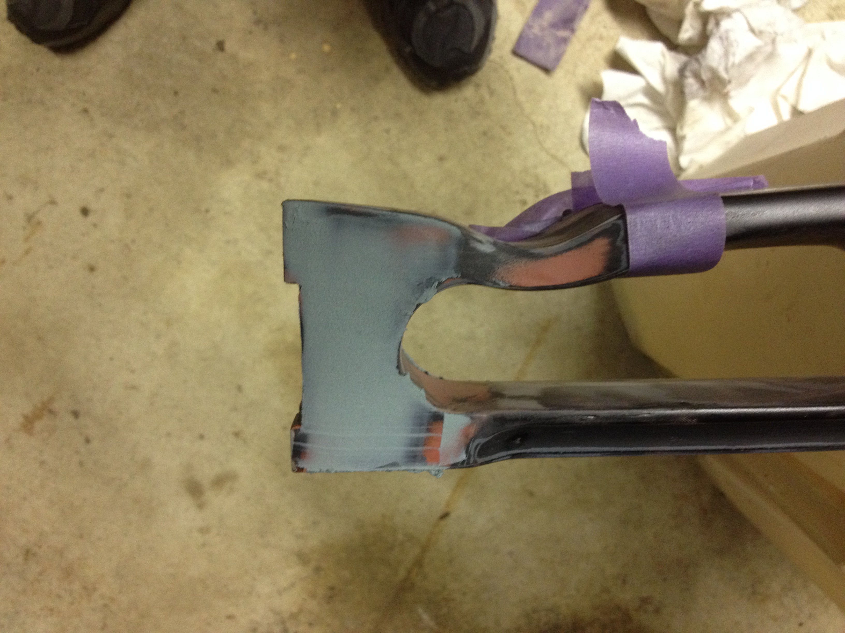

Not sure where to get that done around here. I did spend a few hours wet sanding. Trying something new with the cracks in the filler..... I made the cracks bigger and cut a v into them with a razor. Then sanded and filled with spot putty. Well see how that does.

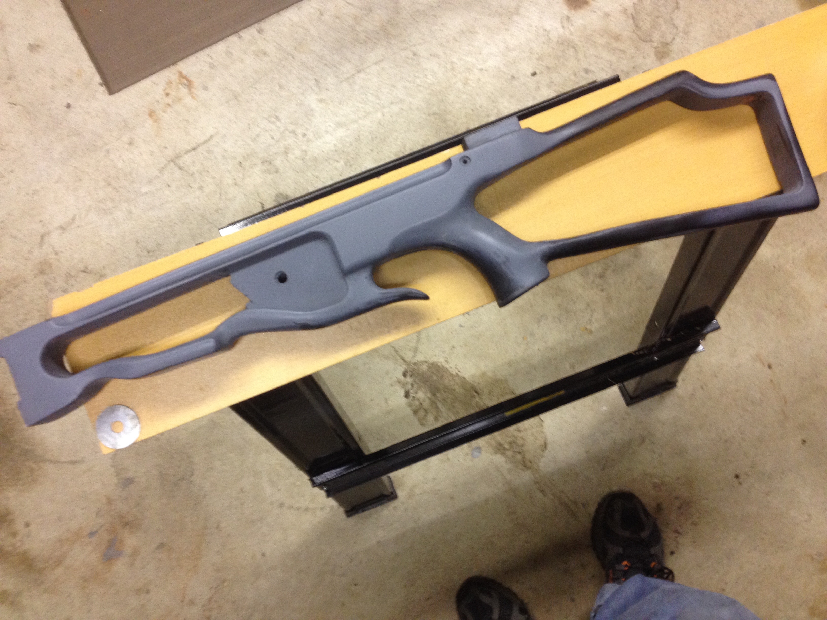

So ive been fixing the cracks in the filler. The cracks are a result of too much being applied. As the filler dries it shrinks a little i think. So I tried opening the cracks a little wider and filling them with glazing putty. I also tried filling them with jb weld. The jb worked really well and sanded very well. I applied glazing putty over thie jb weld and did not wet sand this. This worked much better.

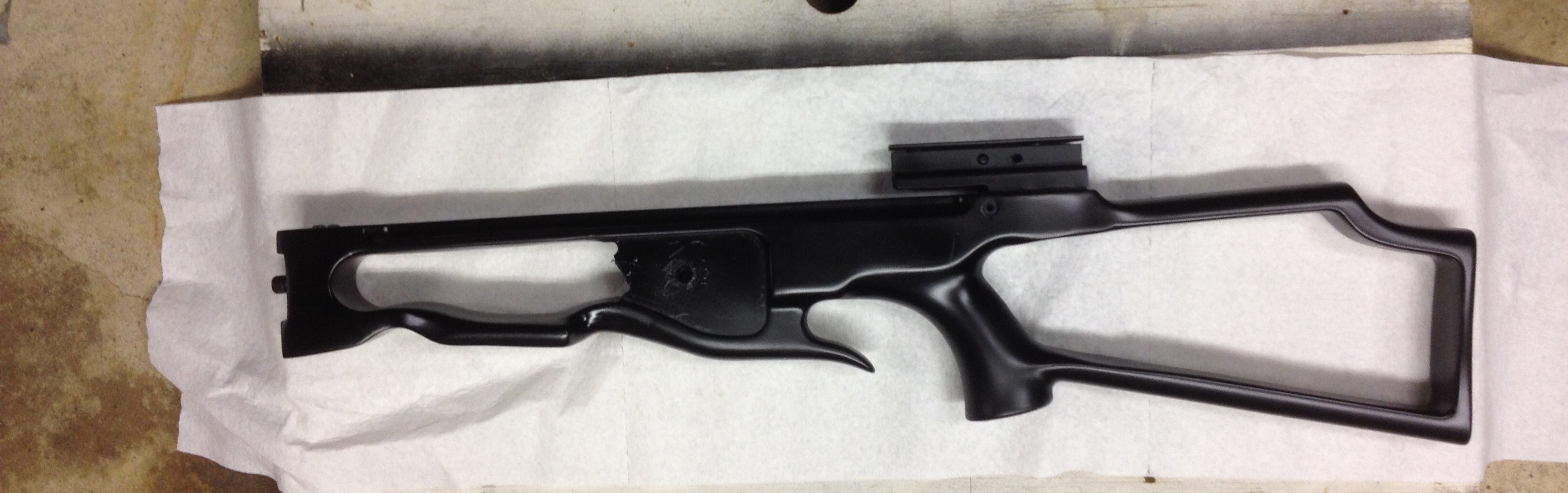

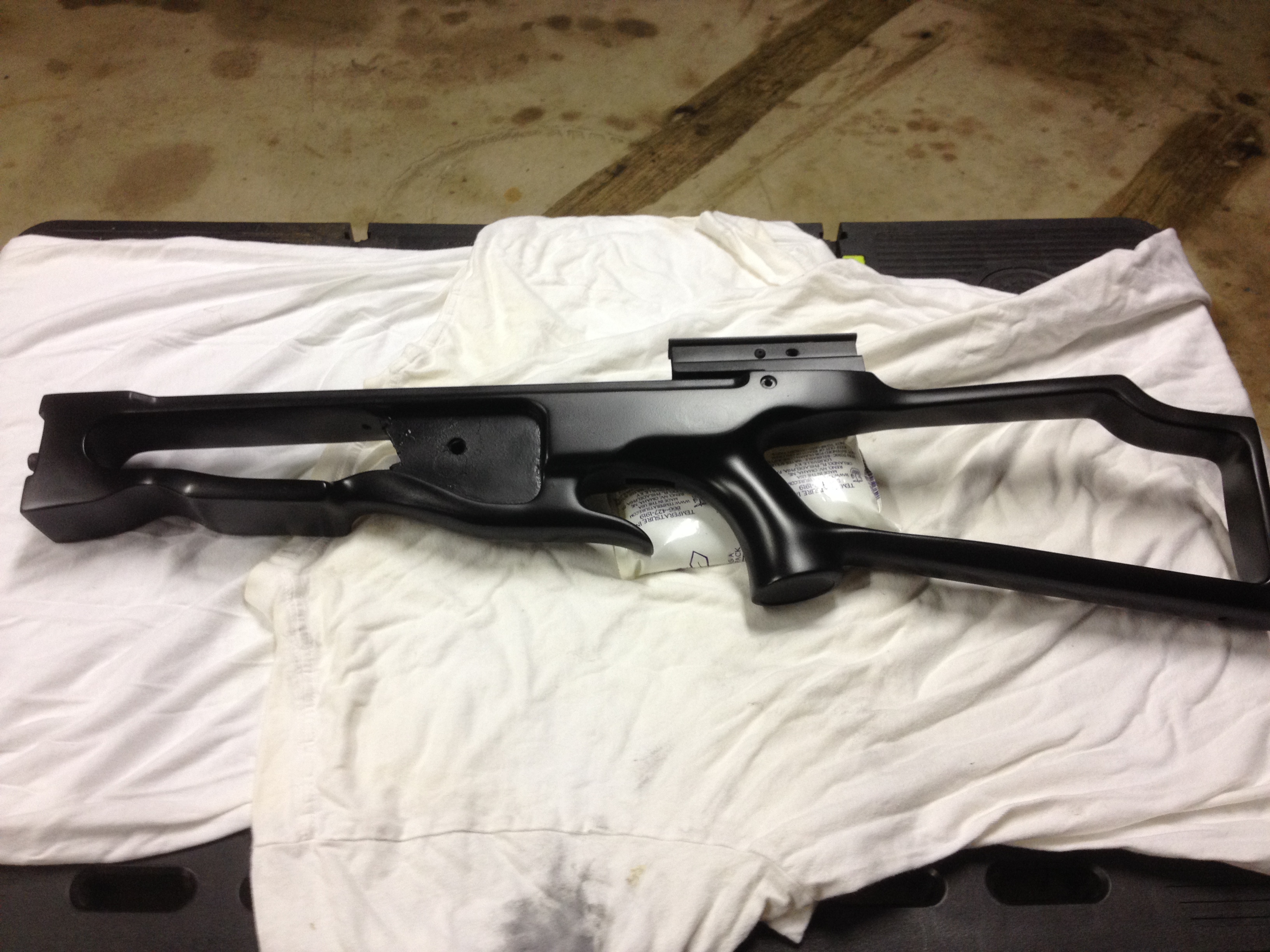

Hi all.
Had off today and spent most of it sanding and priming the bowcaster. Just finished final sanding before painting with satin black. It been a battle to get this thing smooth. Crossing my fingers that this is the last time ill have to paint it. Any imperfections show now calling them battle scars! Lol
Feel like the boy who cried wolf here but I painted the bowcaster satin black. AGAIN! Lol I do not see any areas popping out. (Crosses fingers) just have an issue with the overspray creating a rough surface on certain areas. There are a lot of different angles on this thing and it seems to be hard to keep a smooth paintjob. Once its dry Ill try to polish the rough areas with car wax

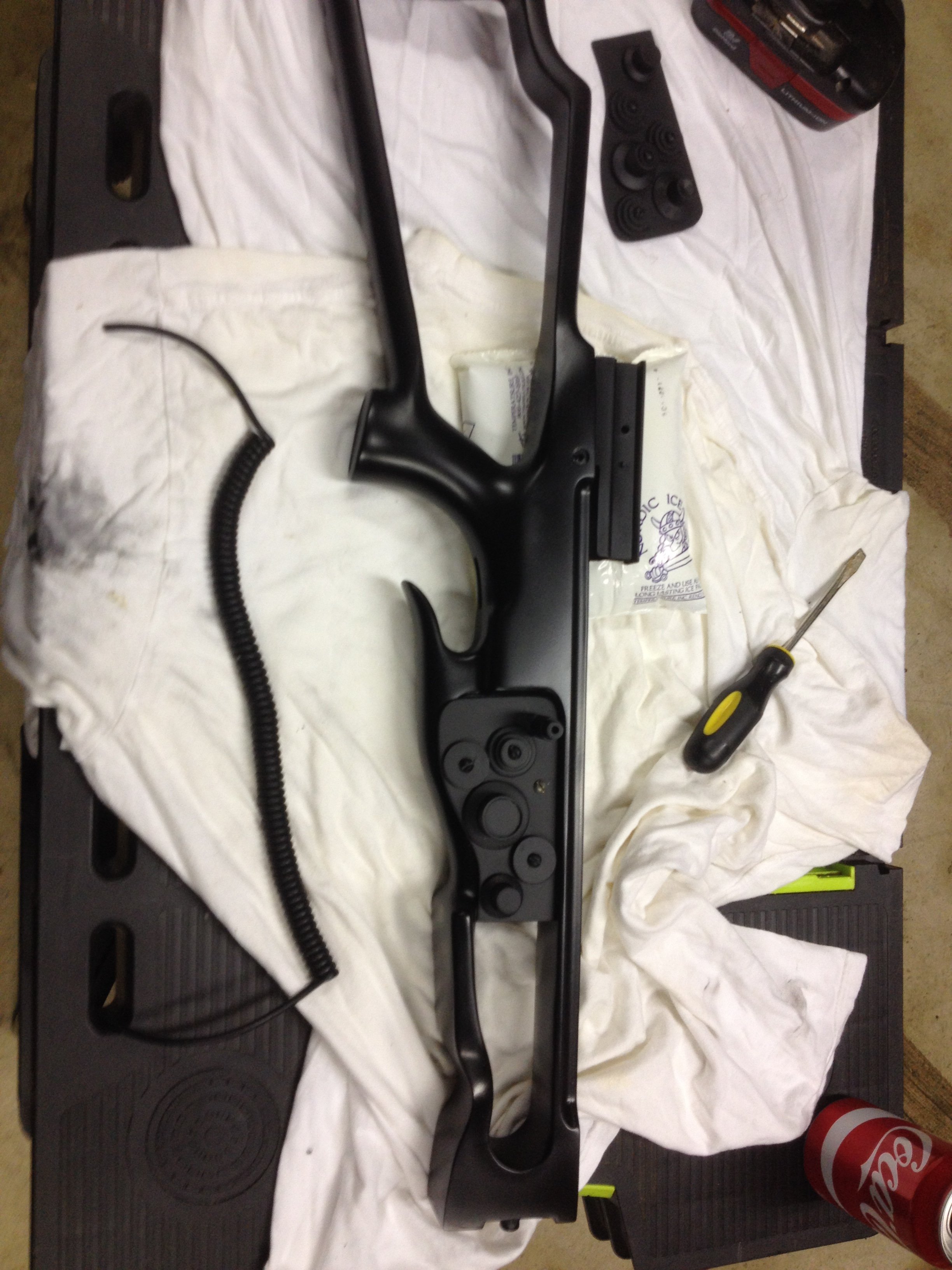

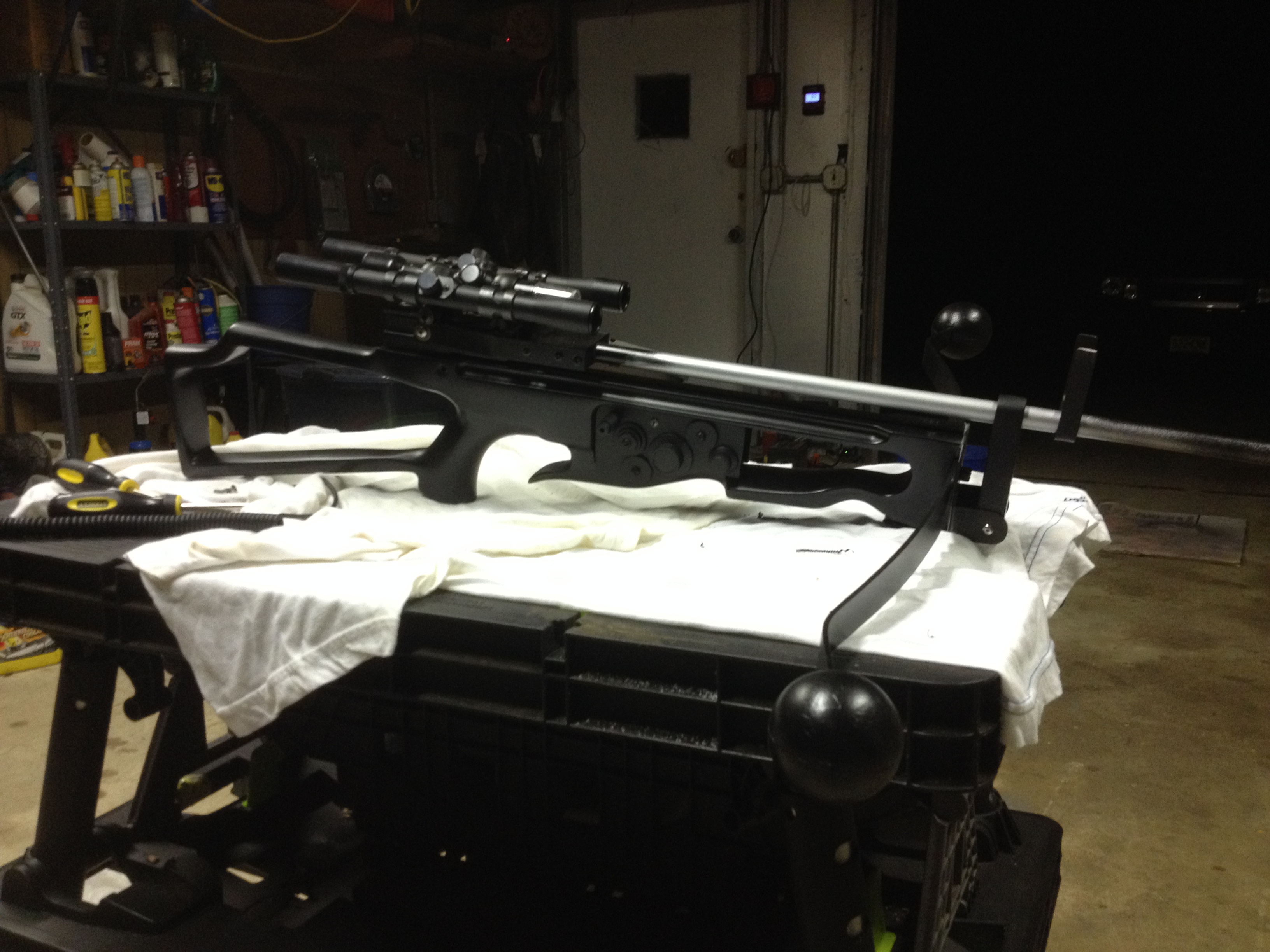

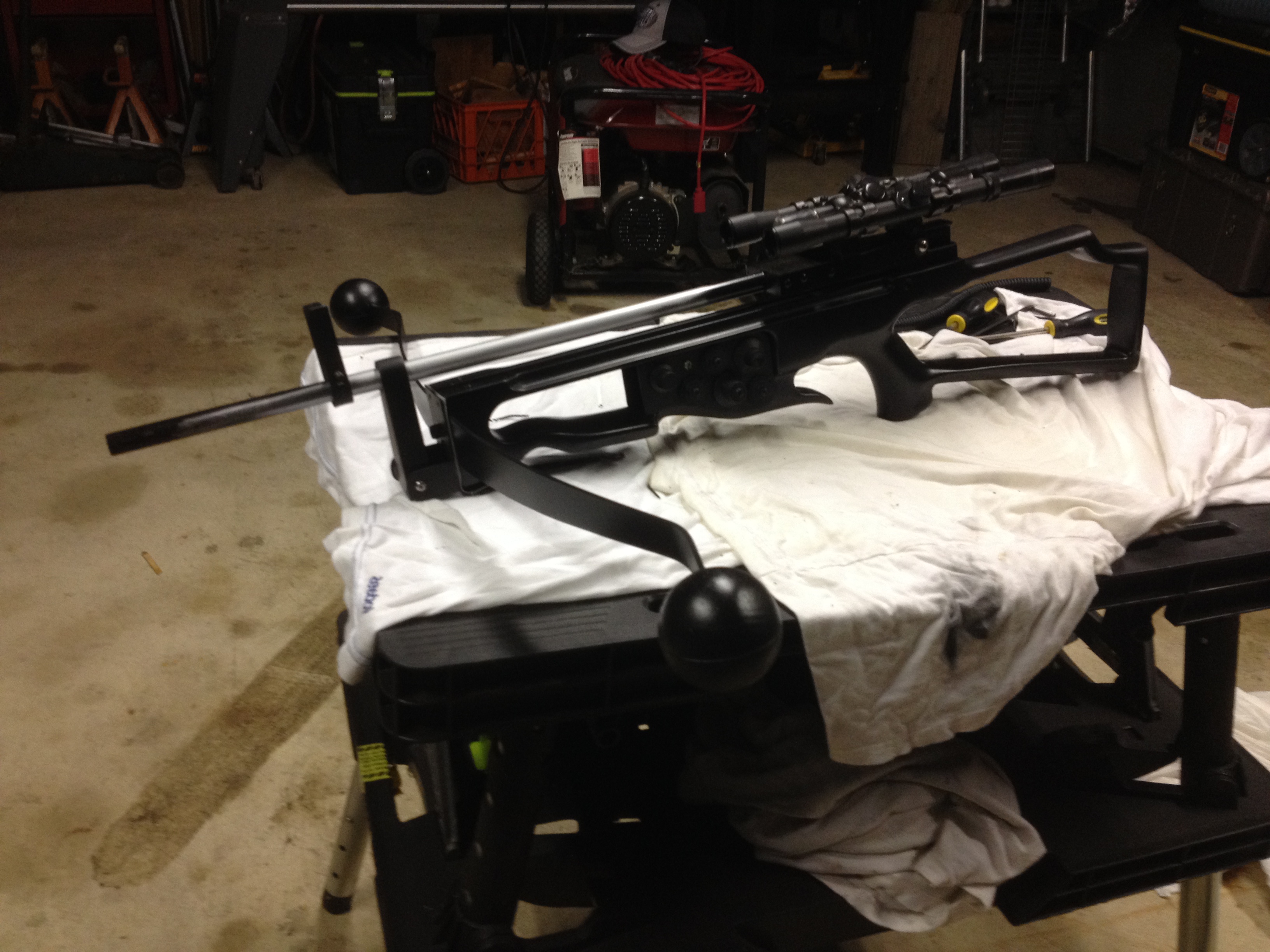

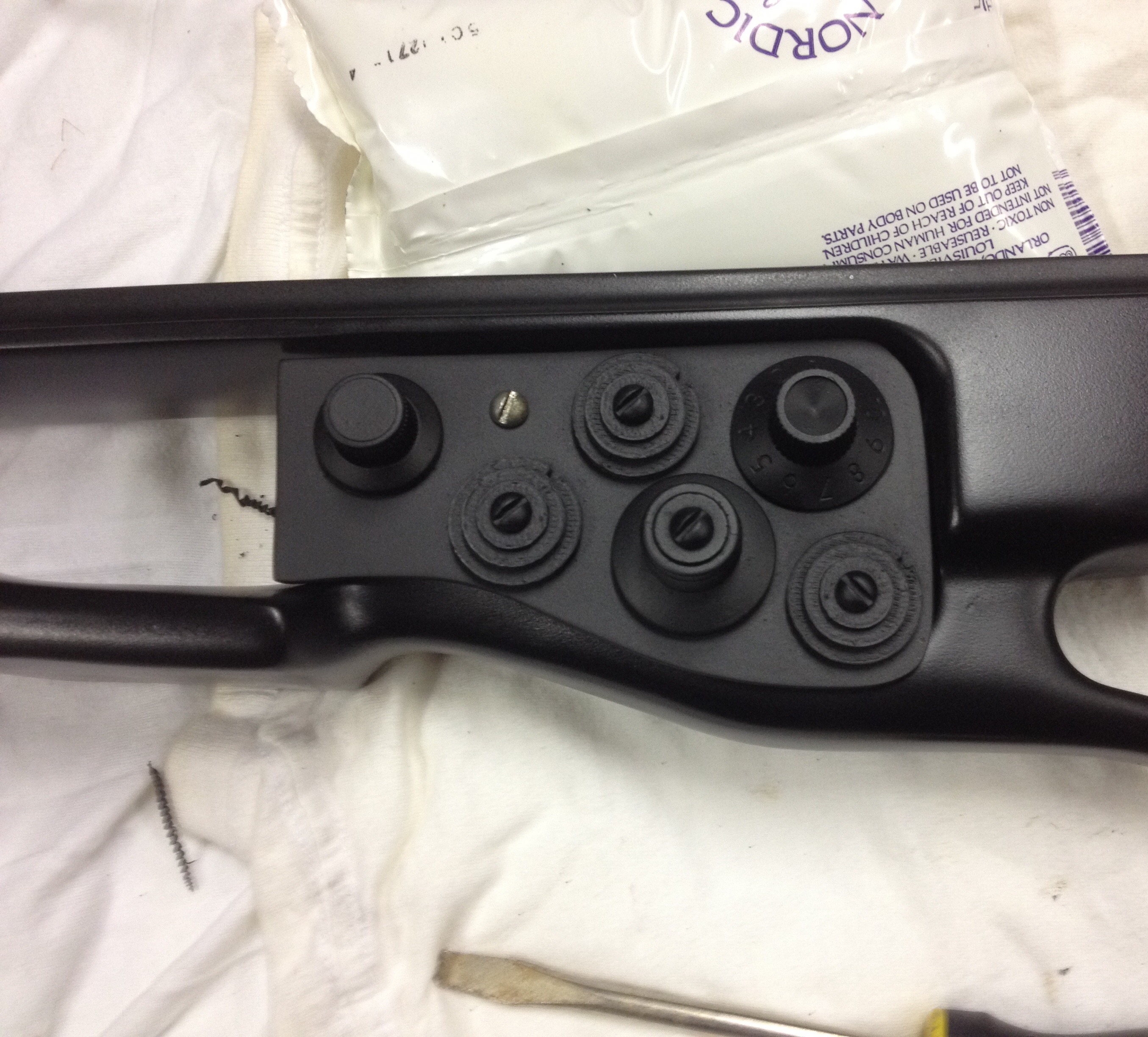

Hello all!
heres some progress pics of the Bowcaster.Im really happy with how this is coming out despite not having the Horton magnum. Ive got allmost everything assembled. Intjink my barrel is a little long and i realized i never drilled the second hole in the barrel support! Lol
No trigger yet. The paint has dried enough for me to handle but im trying not to handle it too much. Some of the black paint on the frame had a sandpapery feel. Used a cleaner/ wax and it smoothed it out. Leg me know what you all think. The pics arent the best. The lighting in my garage is not great and some of the detail is hard to see. Once i finish it tomorrow ill take some pics of it outside. Enjoy!
Looks real nice! Seems like you may want to increase the arc of the bow, though.
Re: Chewbaccas bowcaster build...Almost done!
Thanks! I know from my research that the ANH version didnt have the string on the bow so i tried to simulate the curve of the bow without the tension on it. Ill keep looking for good reference pics and see if i need to curve the bow more. Thanks for the advice.
