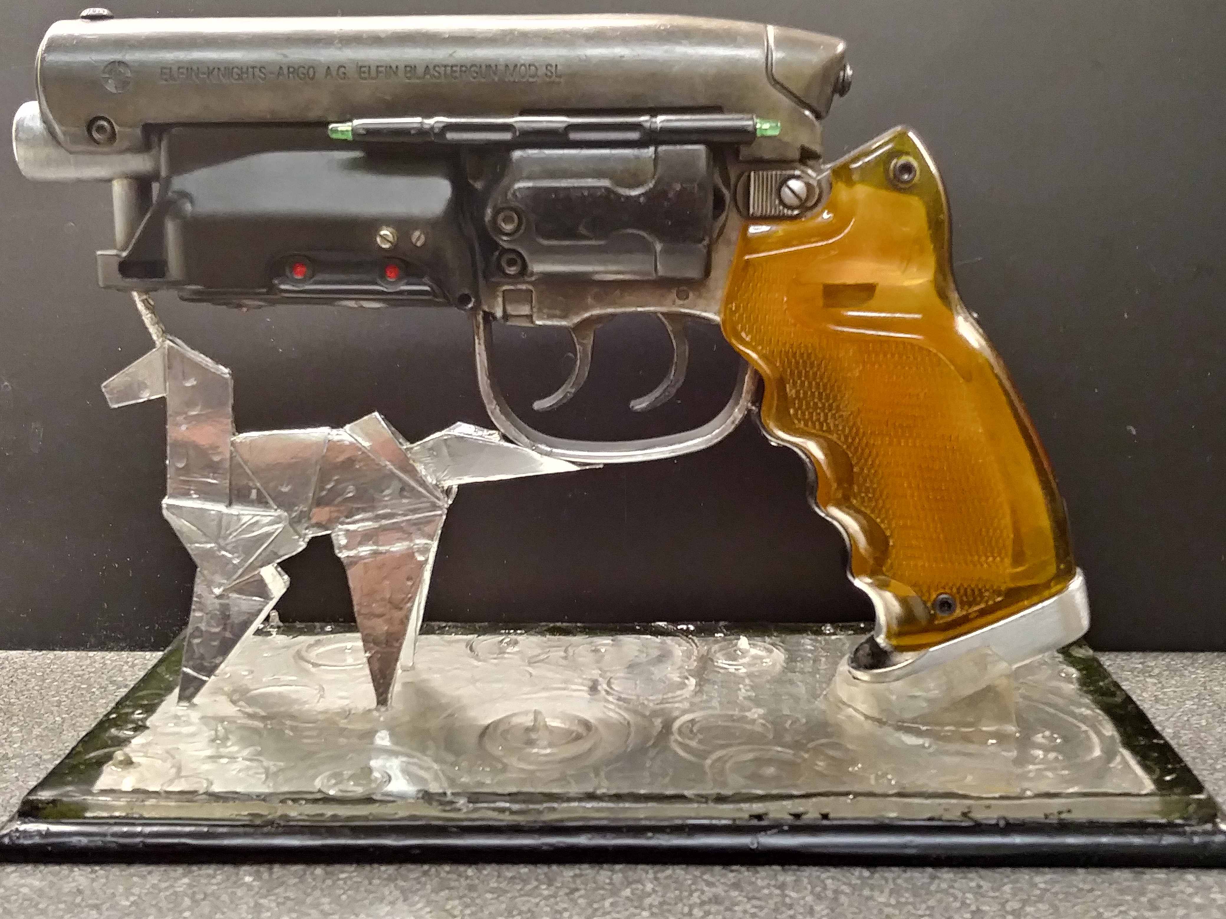

Yeeeaahhhh, ​not quite got the space for that, and the wife nixed the whole "full size Rachel in fur coat" idea as well.
Think I'll model a small version of this guy as a stand with the blaster Resting on his head.

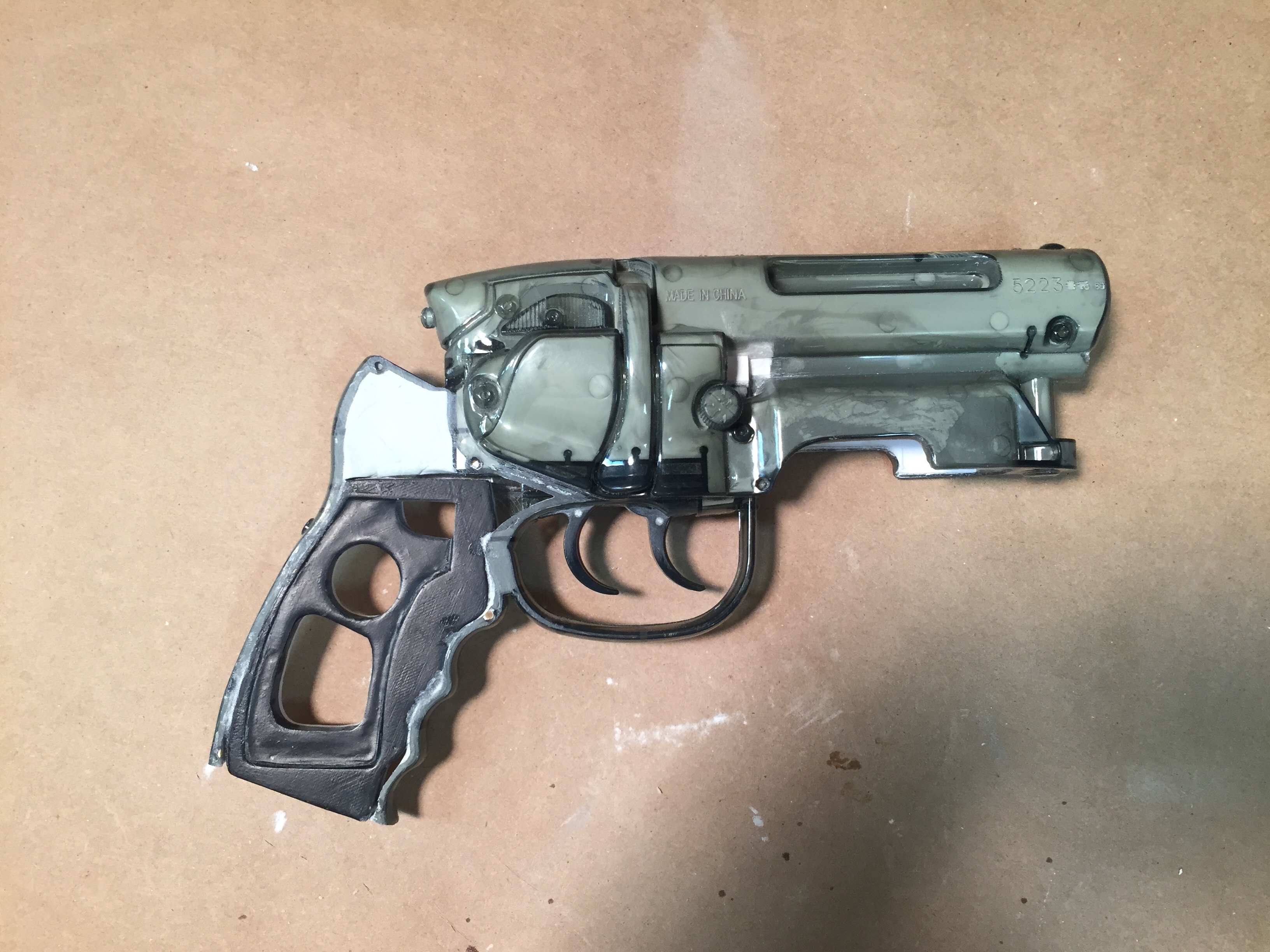

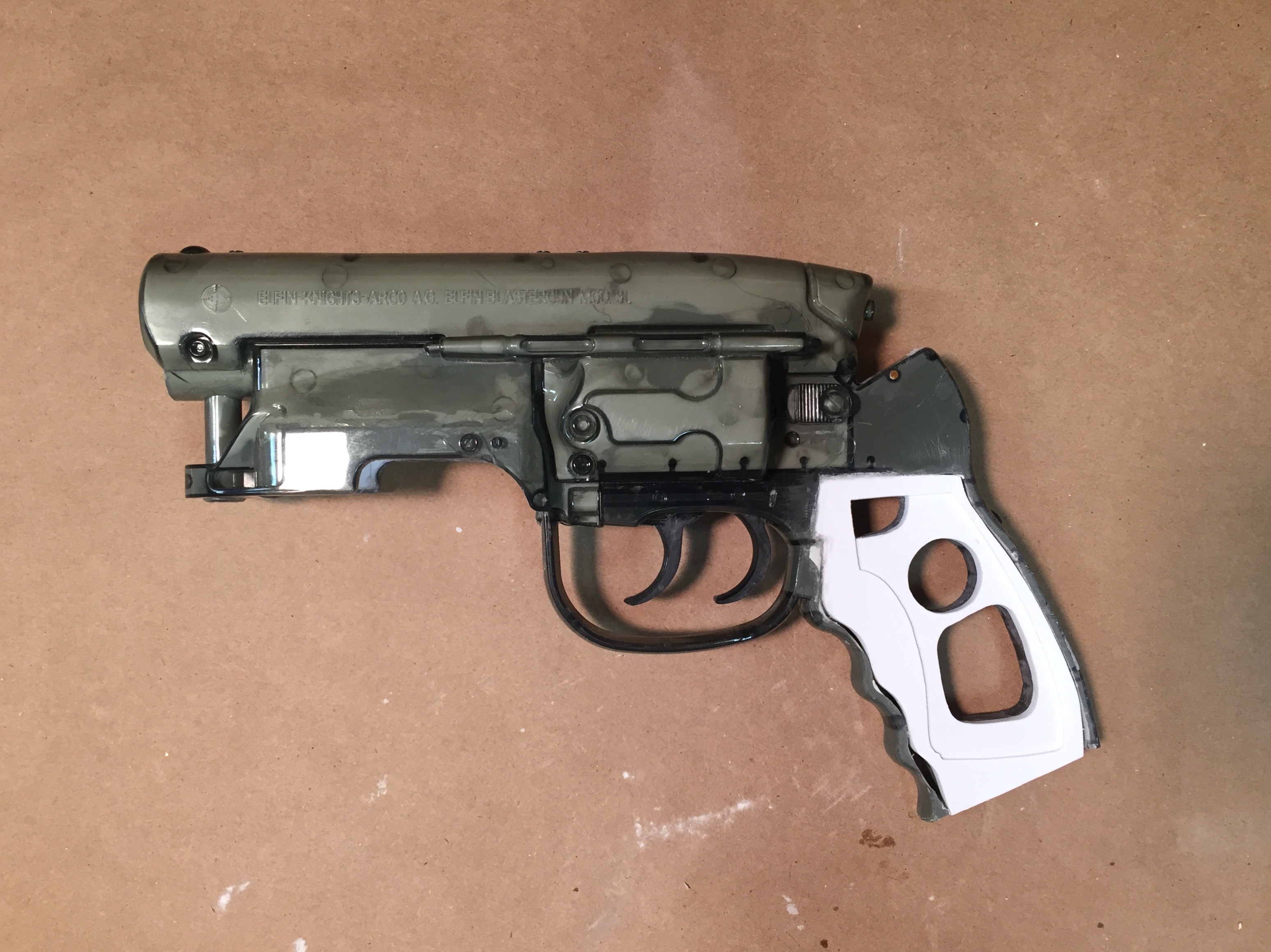

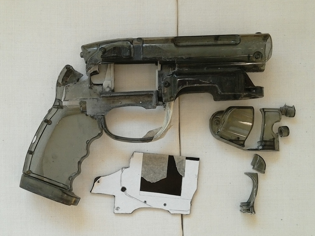

I'm back home on spring break, so naturally I'm spending my time at my workbench. Had a very successful and productive day:

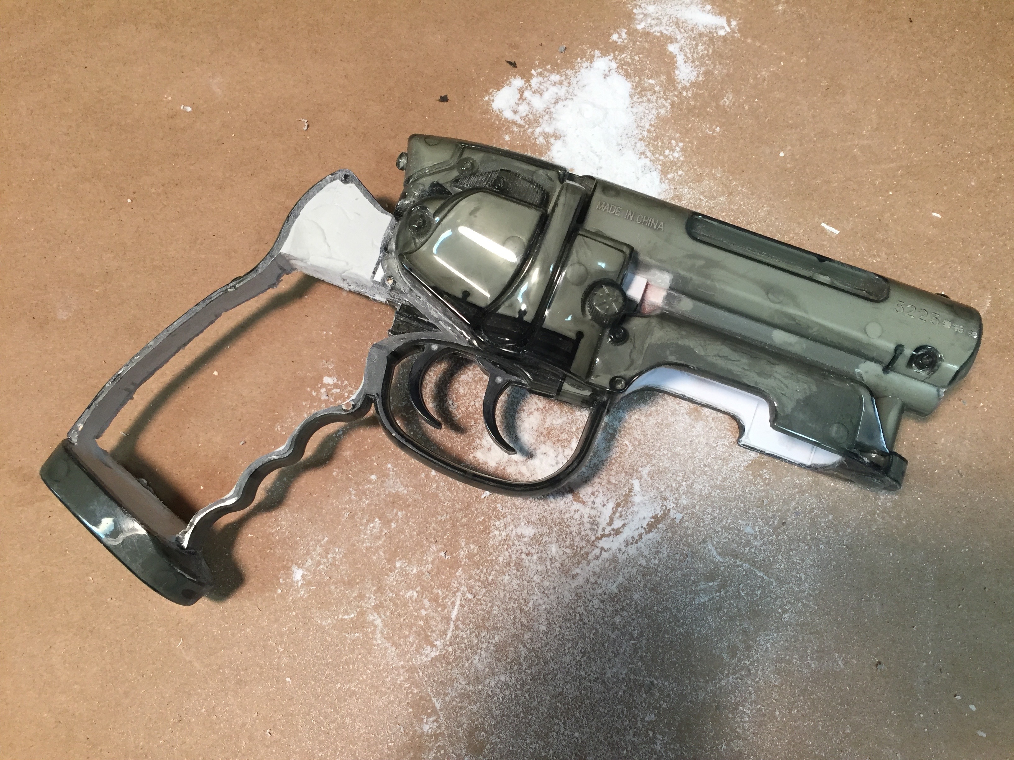

Cut off the other half of the grip, leaving just the frame:

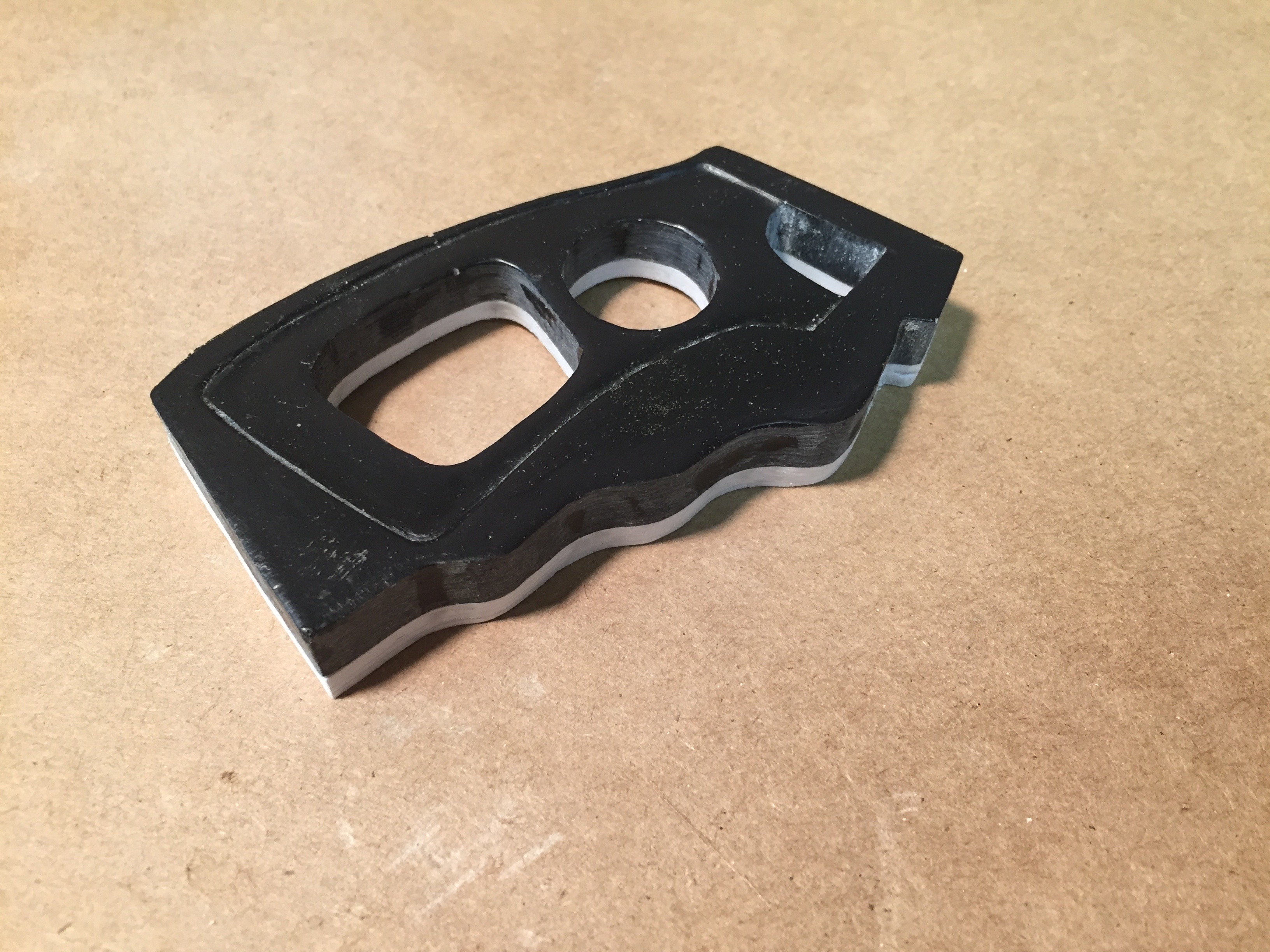

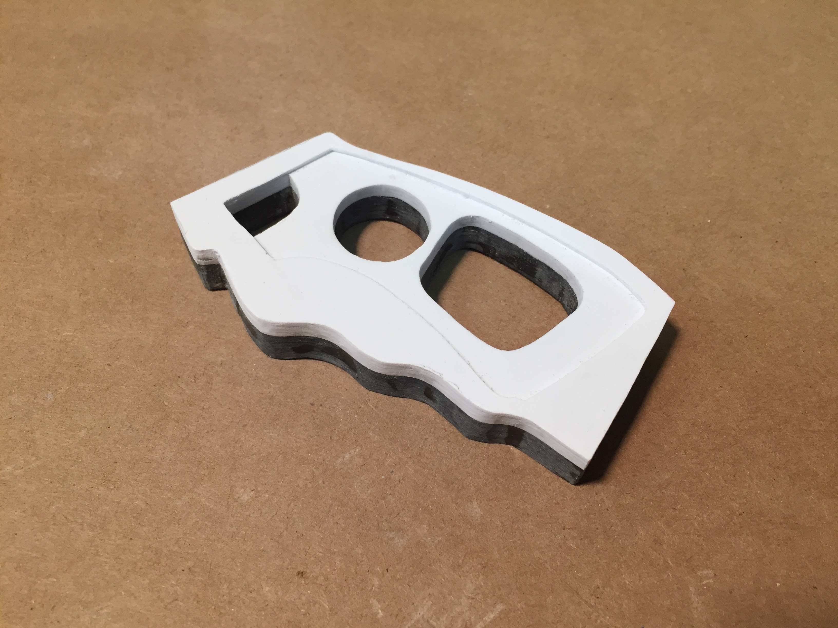

Test fitting the resin Tomen grips, I noticed there was a slight gap. Sooo....

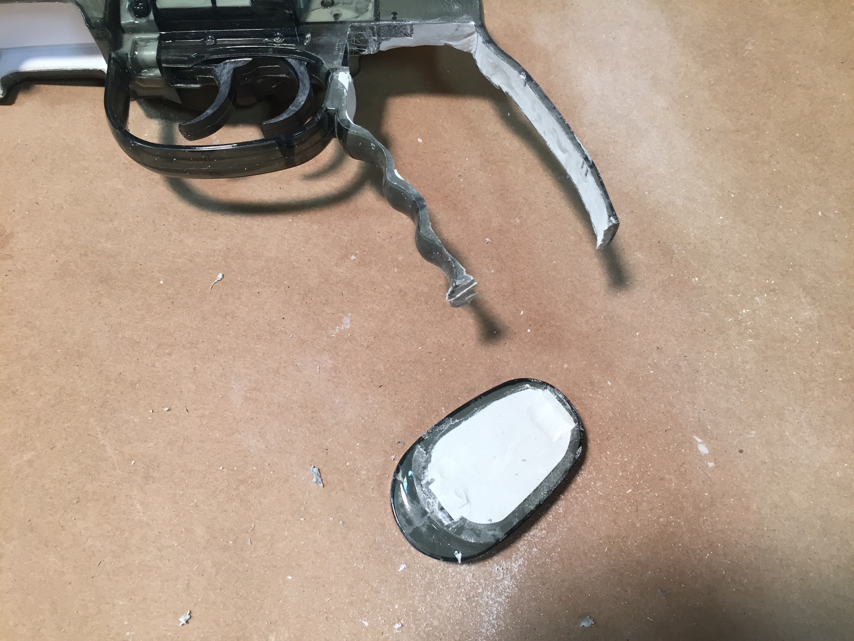

I chopped the butt off.
Then I built the other half of the inner grip with styrene...
And glued it into place!
Tomorrow I'm going to clean up the grips and fill in any gaps. I also plan on gluing the barrel and upper barrel greeblie into place. Then I'll focus on the magazine/battery pack.
View attachment 803806View attachment 803807

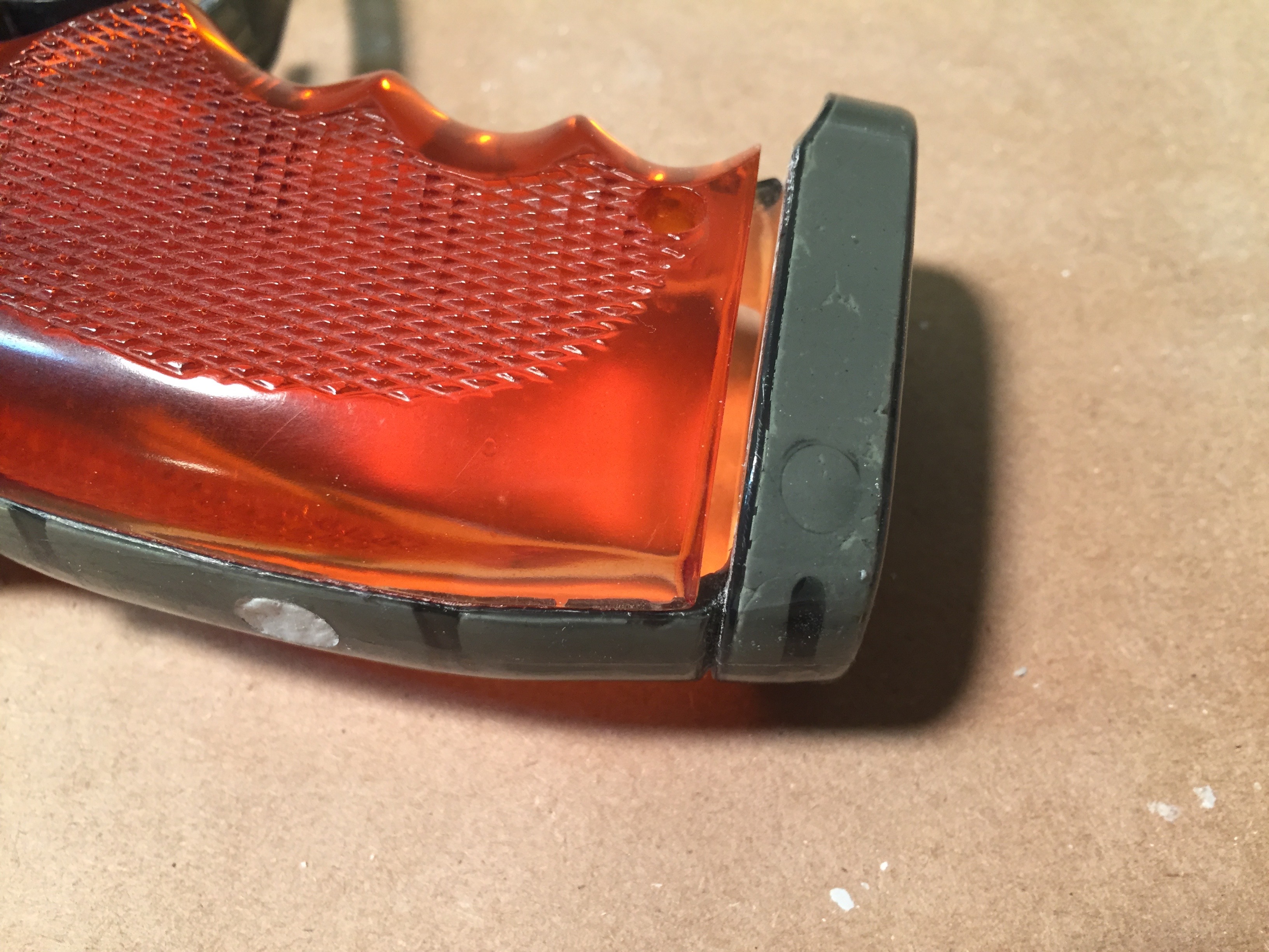

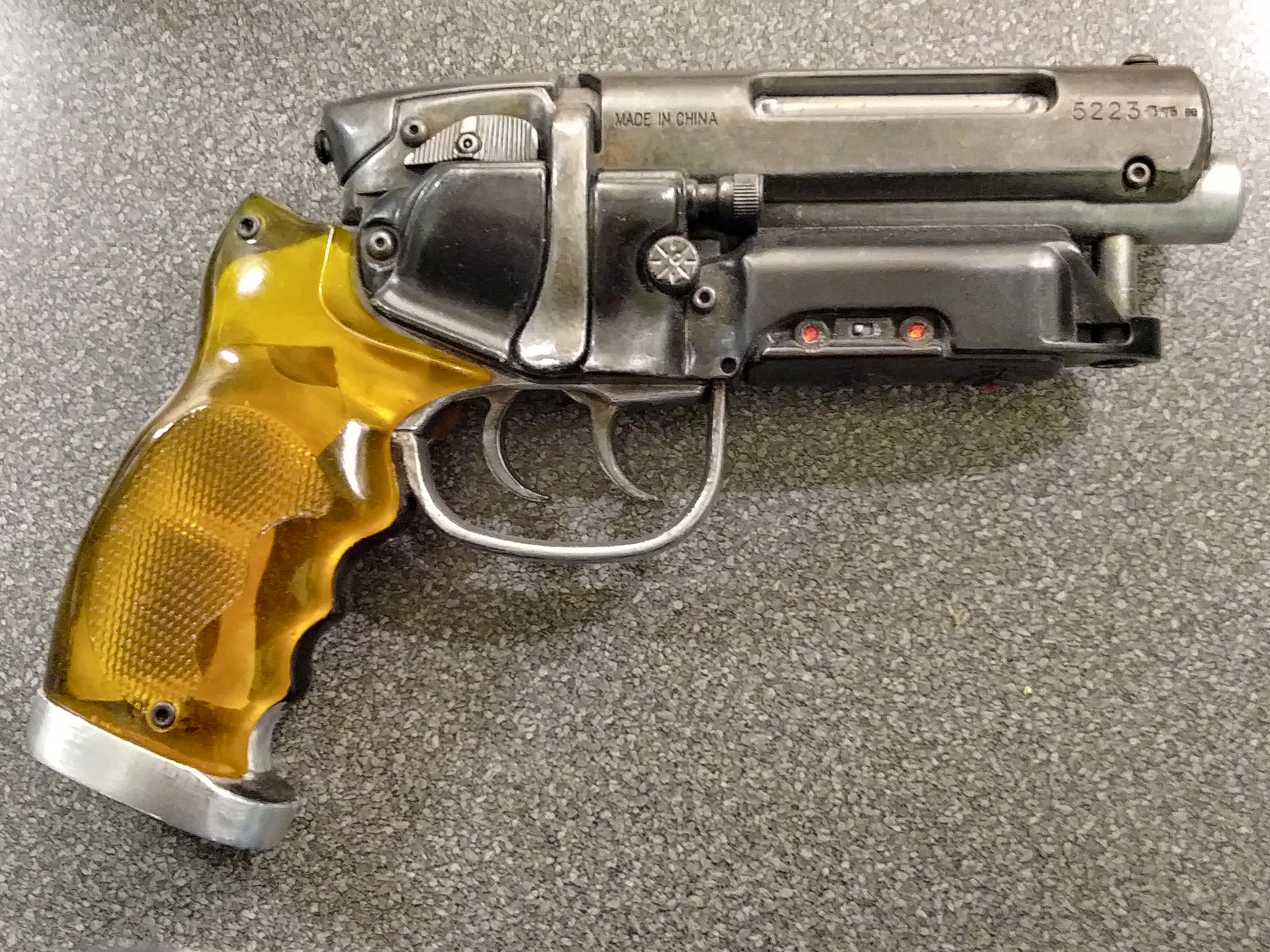

last month I got the Tome blaster and compared it to the water guns, and I would say they are about 99% close in size
The "Butt" on the water gun is a bit shorter in height than on the Tomes'. Reason you have a gap.
when I get some free time I plan to post lots of pics of the water gun and tome. And give the list off all the exact sized screws used
And pics of the instruction booklet and more pics of the gun, to help your guys build
And since I own the Tome, I plan to use it as a reference to upgrade my water guns.
You’re right @Getoninja I was surprised at how close the two actually were.
I know someone had done a comparison pages back but in person I was pretty blown away at how close the Fullcock is.
for the $20 I paid when it came out, this was an excellent replica.
Also, @Thain you’re blaster is looking epic. The grip frame came out awesome :thumbsup

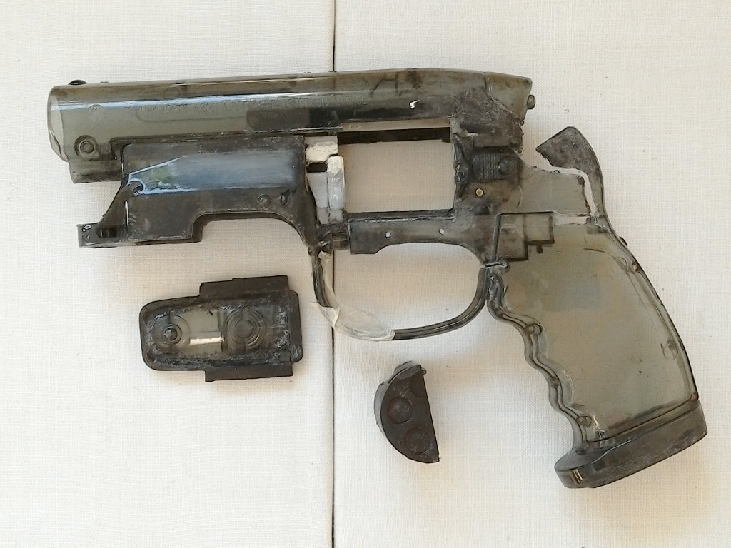

I built up the internal revolver frame which is attached to the Steyr receiver and magwell. It will allow me to cut up all those small gaps that the prop has and add visible details inside them. Left side of frame is thickened, right side of the frame has been cut and fitted but will be installed late — after triggers and grip frame are in place.
I made half a revolver cylinder which fits inside the left side of the frame and which will be visible through some gaps.
The magwell has been cut up, gaps filled and reinforced on four sides. The mag is a bit of a mess.
I thickened the grip butt on the bottom before I knew that the grip was too long. It would have been easier to cover the gap than to fill it, which I will have to do next.
All structural work done with solvent-welded styrene. Putty only on the surface.

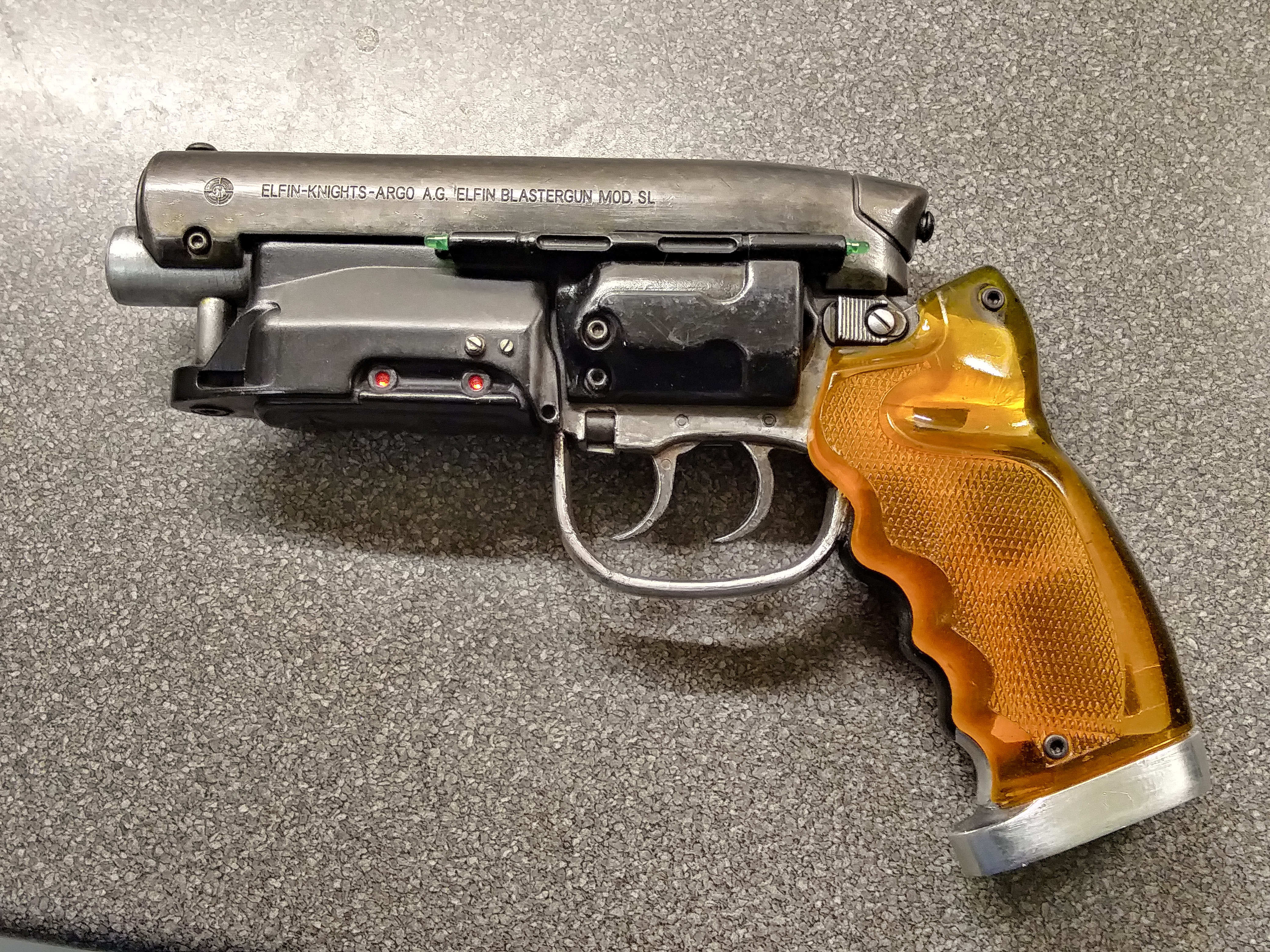

sorry for delay not sure if your done, but hope this helps you and others.
the Tomenosuke butt has a sharper edges versus water gun with soft edges.
measurements are in metric
12mm high and the end tip is 9mm. Get styrene sheets, clay, etc.. and stack till you get the exact size, seems easy.
