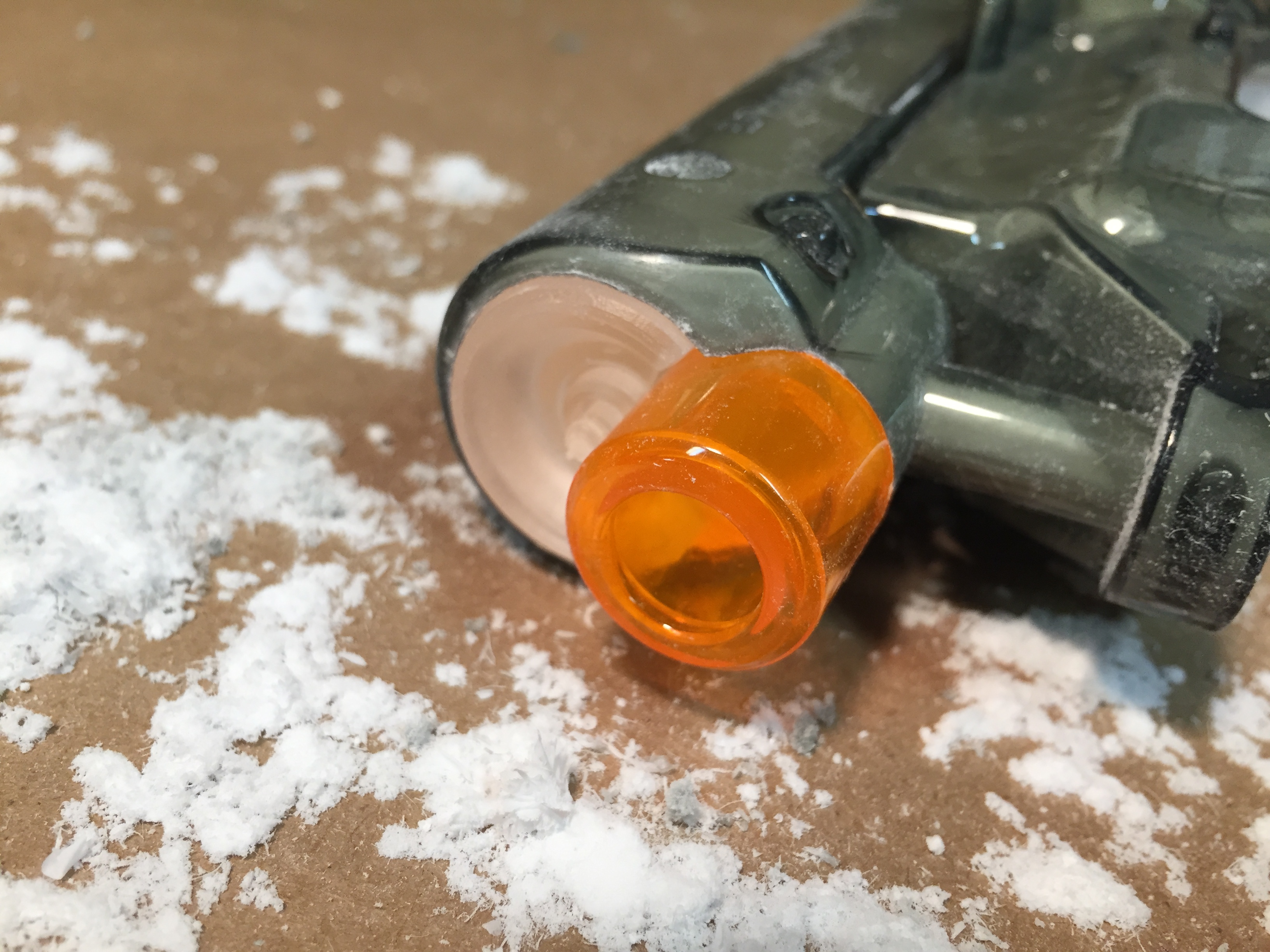

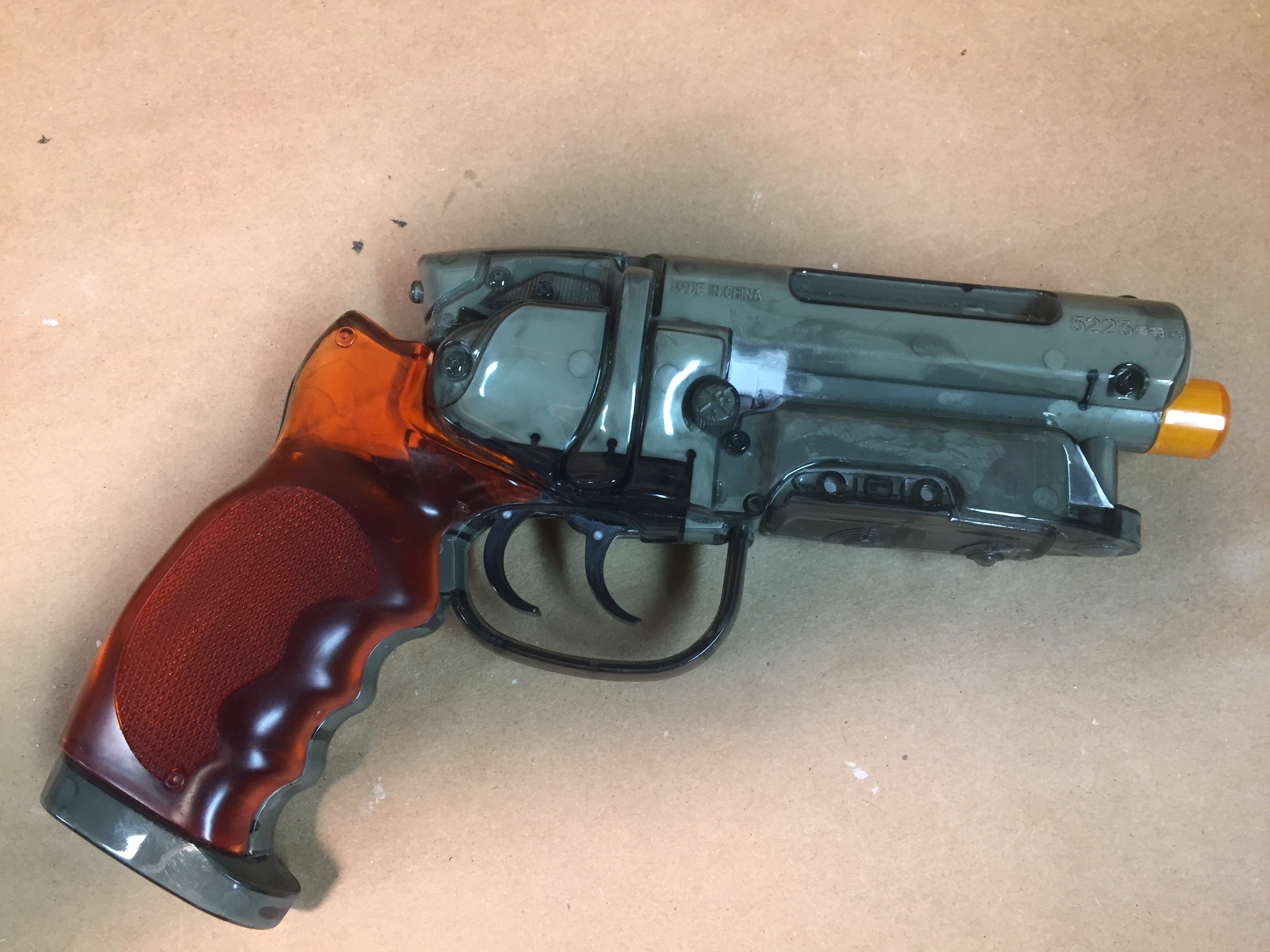

Today's update:

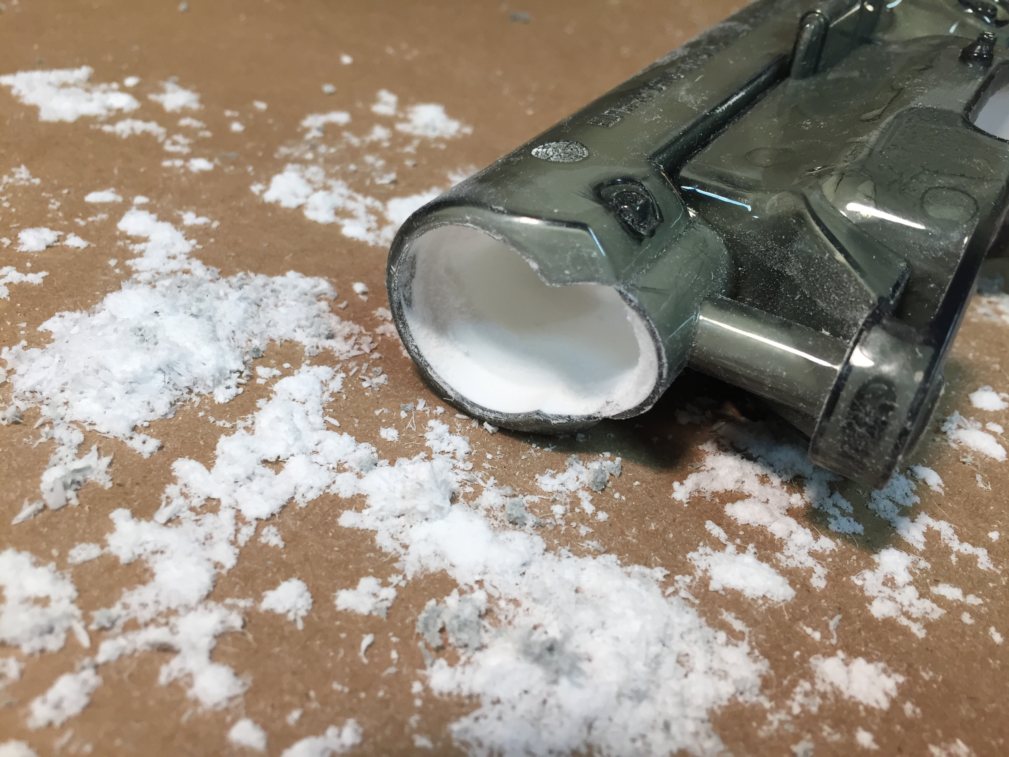

Continued cleaning up where I removed the crappy molded knob so I can replace it with a real metal one. It's really hard to sand in this area because it's just so small and awkward. It's also impossible to see how well I'm doing without some primer haha.
I spent what felt like forever cutting off/hollowing the main barrel and hollowing out the upper barrel section for the more accurate parts.
Some time and a whole lot of cocai-ahem, sanding dust, and the parts finally fit:
I also cut one half of the grip open for a test fit of the inner grip piece. Huge thanks to Soulinertia for supplying the deluxe upgrade kit I'm using for this build!
The front end piece looks like it fits on/in perfect! :thumbsup
Nice work
It does from this angle. I tried my hardest to get them to align perfectly without having to do much work after, but alas there's a slight gap between the barrel extension and the upper barrel greebie that needs to be fixed.

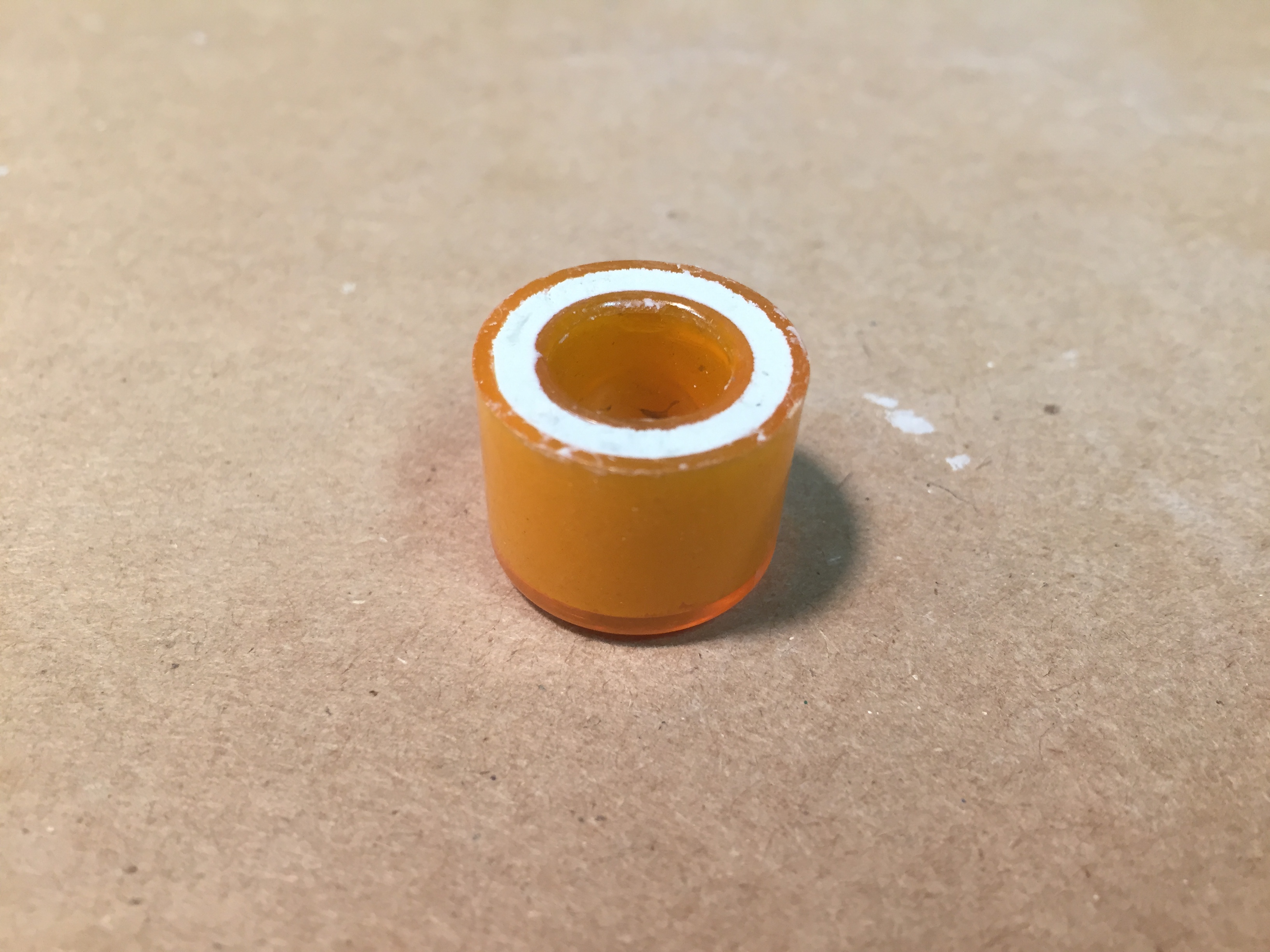

So, is the inside of your barrel just coated with resin? I thought it would be solid in there. If it's just coated inside, that's what I would like to do. I'm thinking of adding some sound and light inside there.
No, the whole thing is solid. I just poured it down the barrel and made sure not to fill it all the way up to the opening, so at the opening it appears hollow. That's probably what confused you.

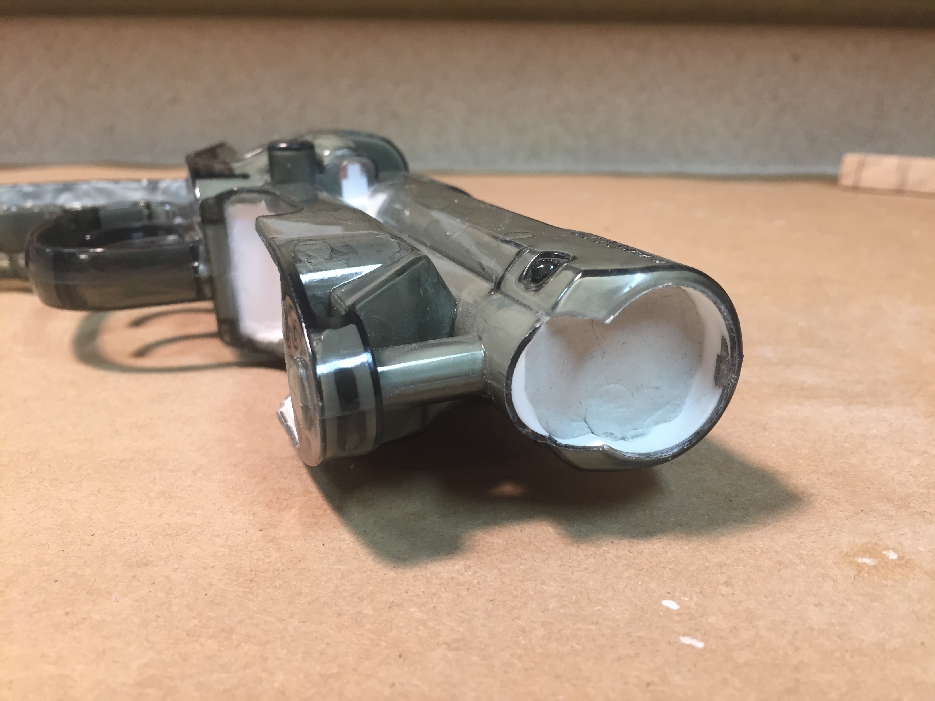

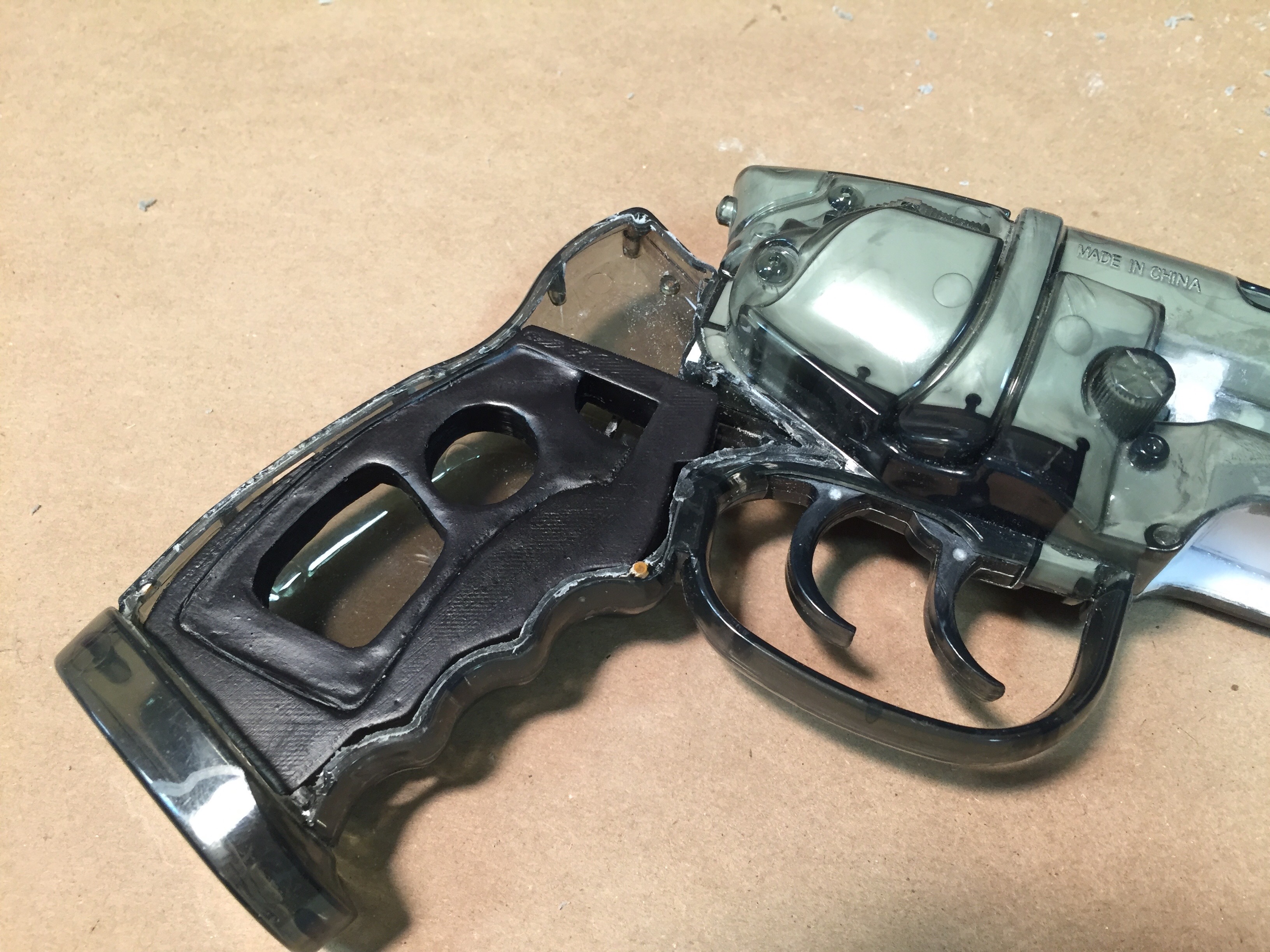

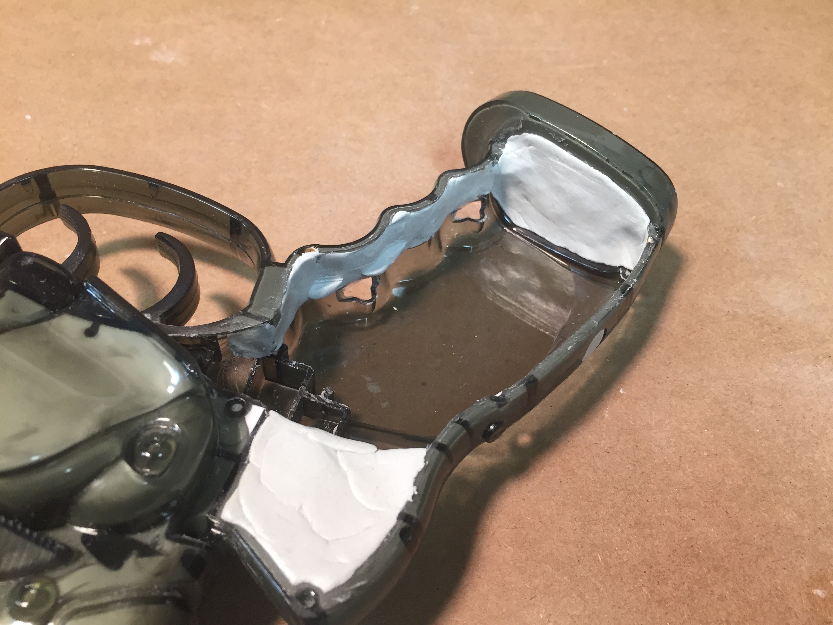

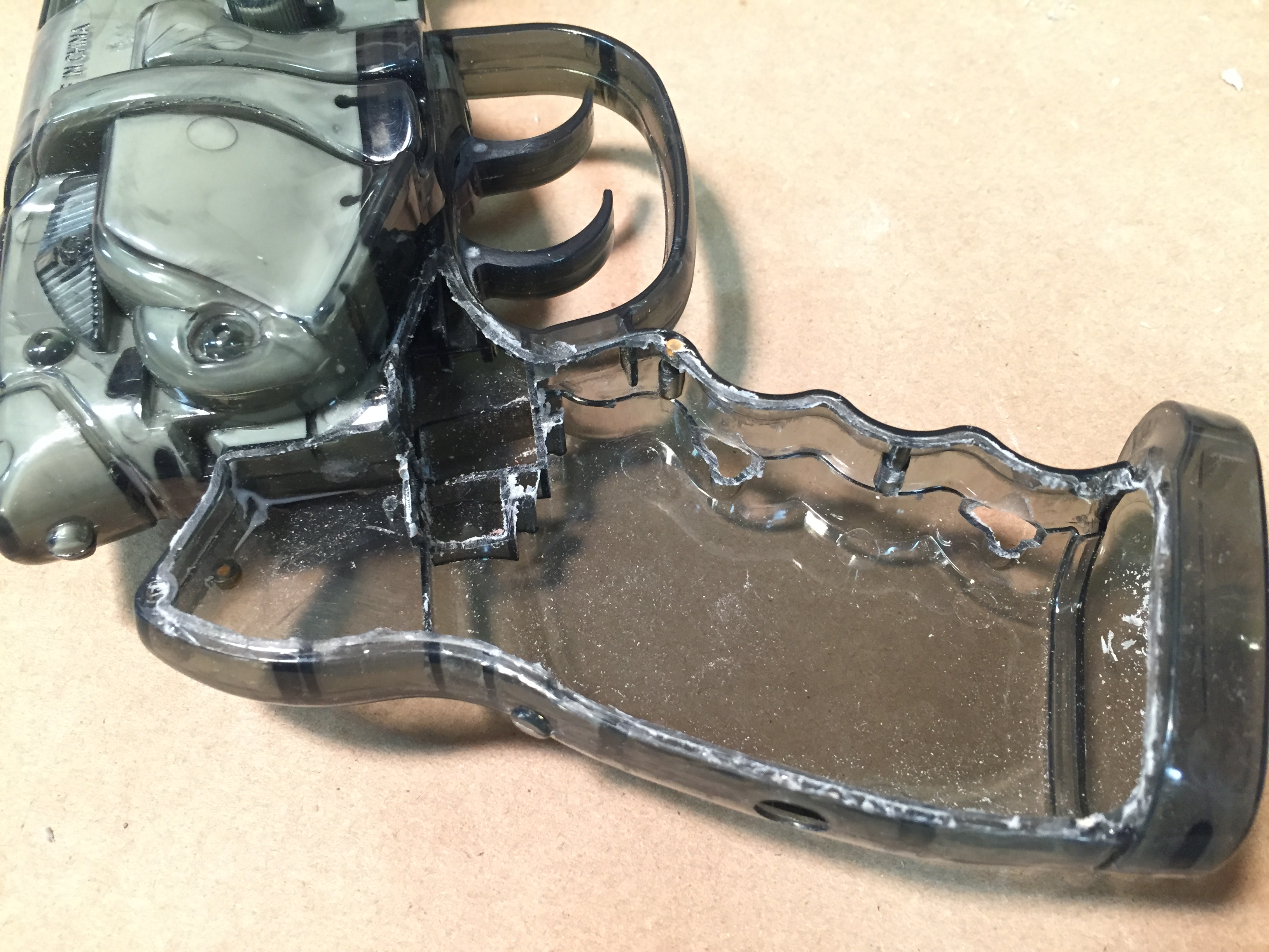

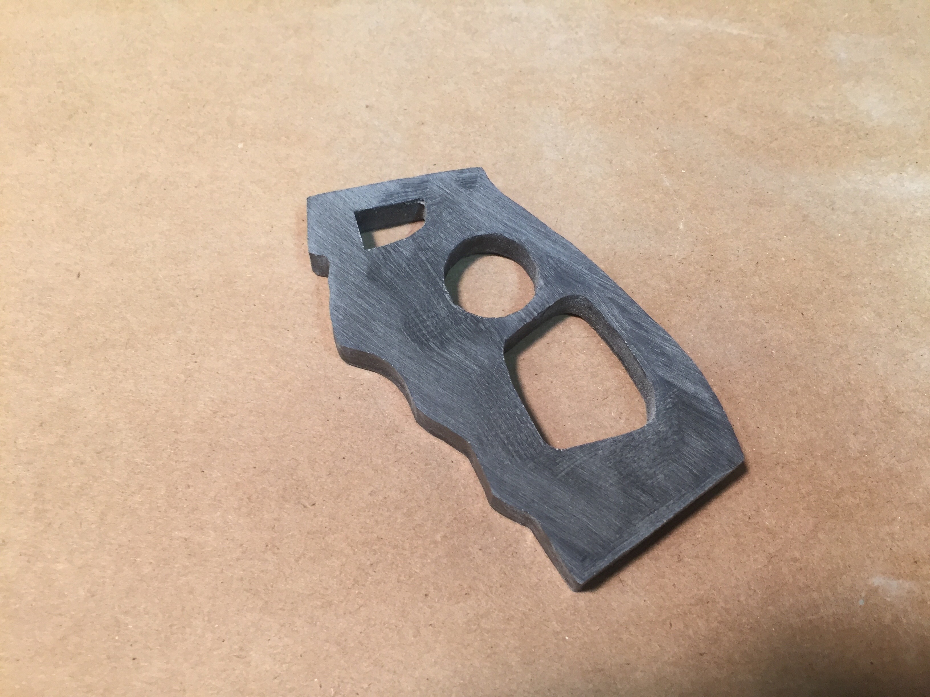

More progress:

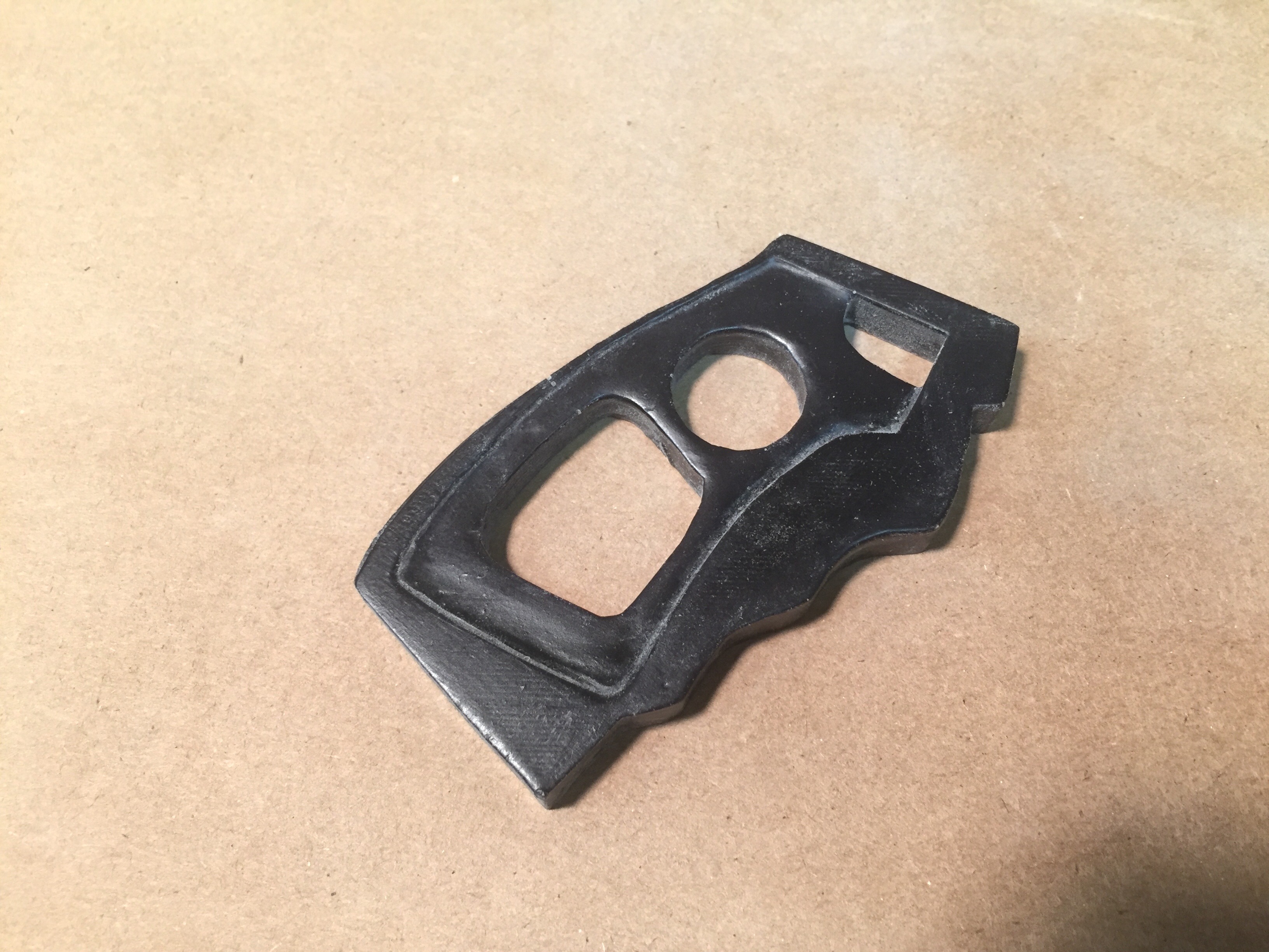

The inner grip was thicker on one end than it was on the other, so I sanded it all down until it was all even. It's still too thin, so I'll need to build up the thickness with styrene, eventually adding the recessed detail that the other side has.
I've also filled the butt and upper grip area and lined the interior of the grip frame with Apoxie Sculpt.
Finally, I filled in the barrel area that I'd hollowed out a bit to create a flat surface for gluing the pieces onto. The empty space in the barrel piece was filled in as well.
Test fit of everything assembled:

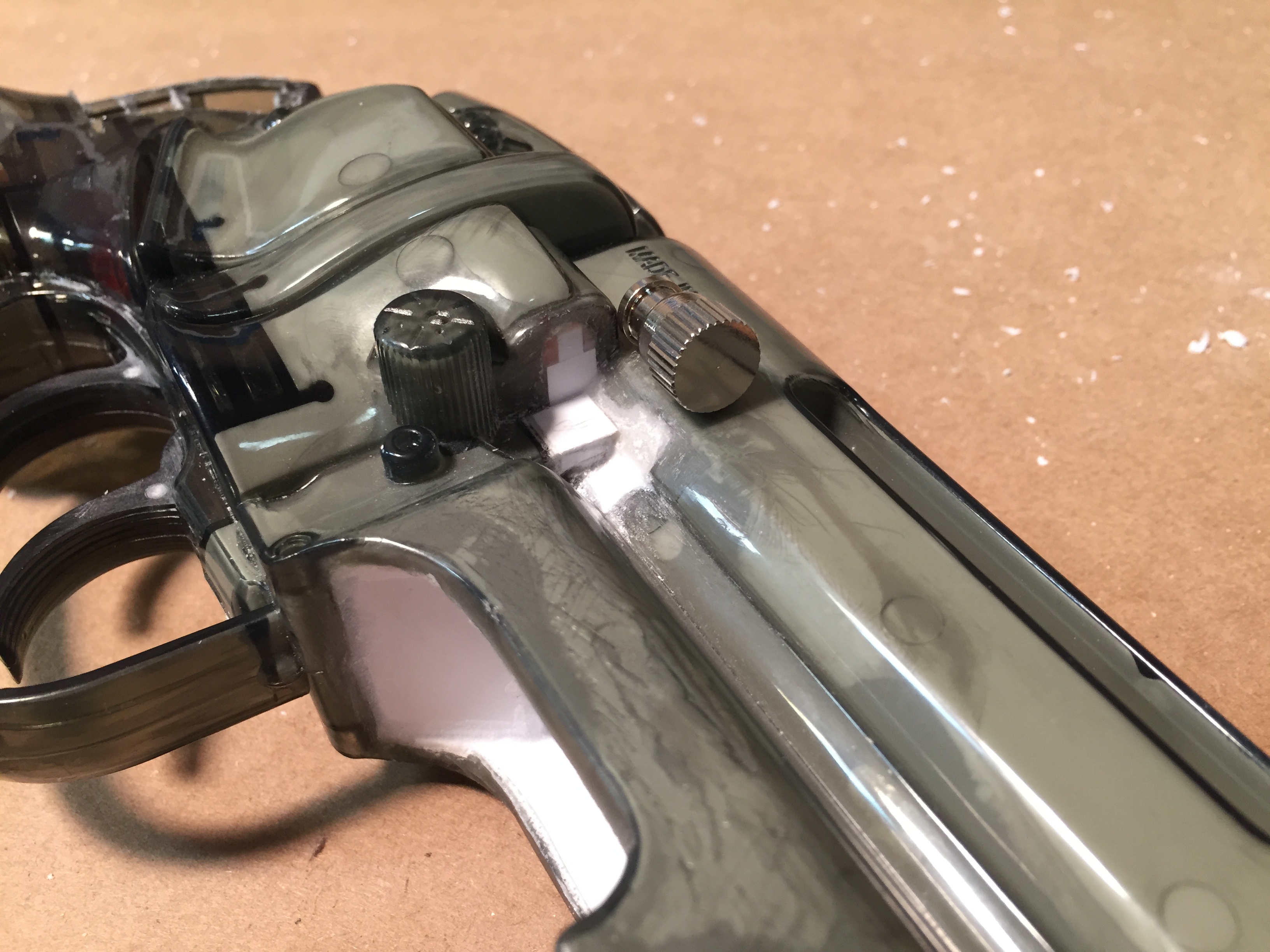

I found another way in: I cut off the right cylinder cover!
I think this mod has some upsides to a full split:
- I can rebuild the right side of the revolver frame as one whole piece of sheet styrene.
- I can paint the right cylinder cover separately from the steel parts.
- I noticed that the cylinder cover is a bit boxier than the original. It looks OK straight on from the side but it is not rounded enough. I can fill it from the inside and then file it down following the existing lines -- which I would not have room for if it was still attached.
It was a bit tricky to cut the Weaver knob off cleanly and it was also easiest to cut the bolt lever in two.
