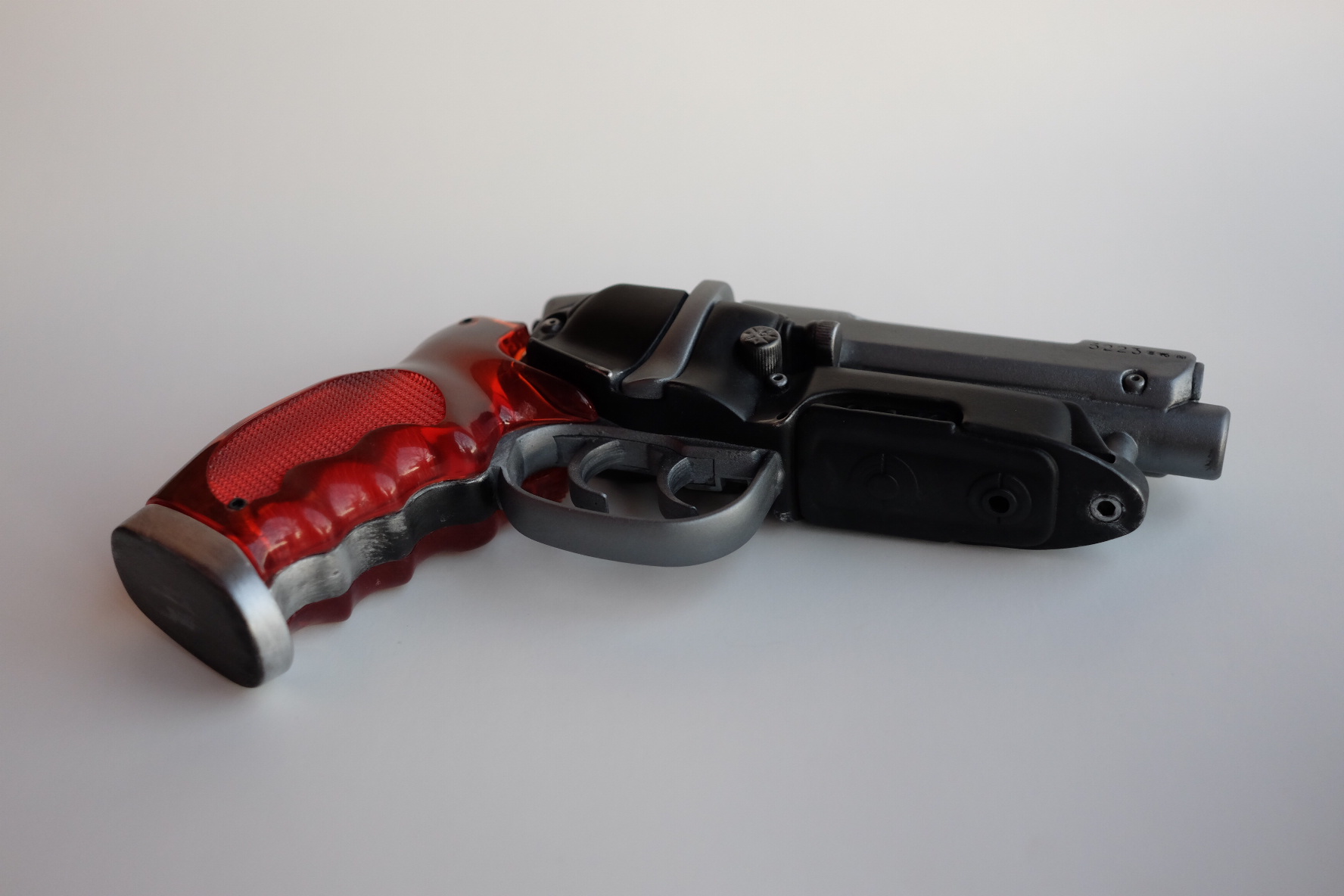

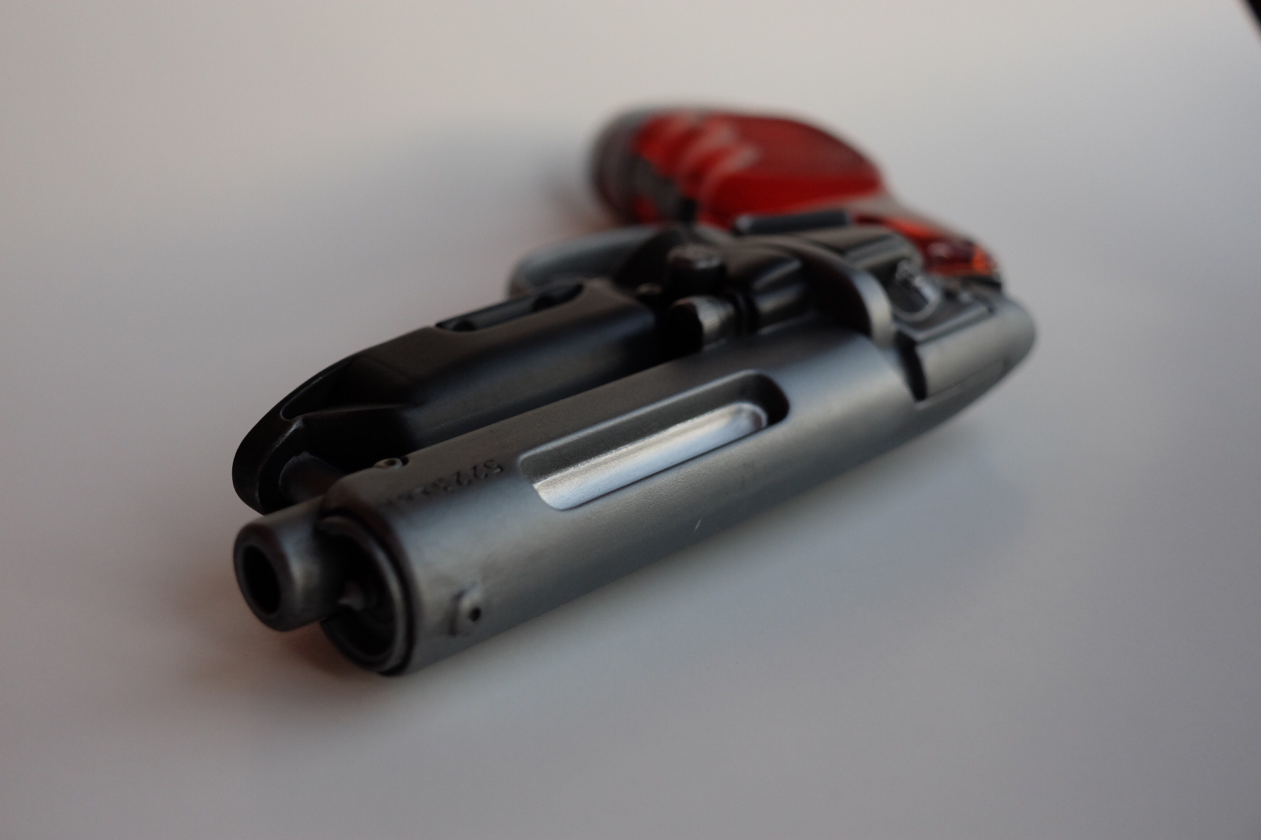

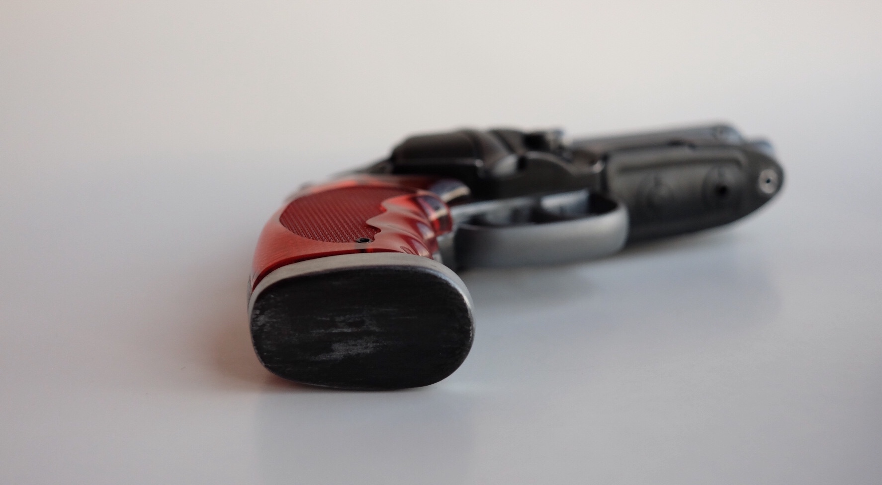

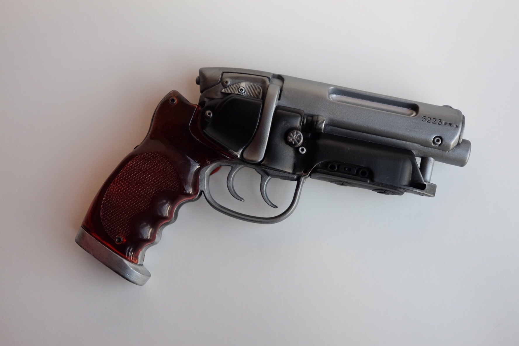

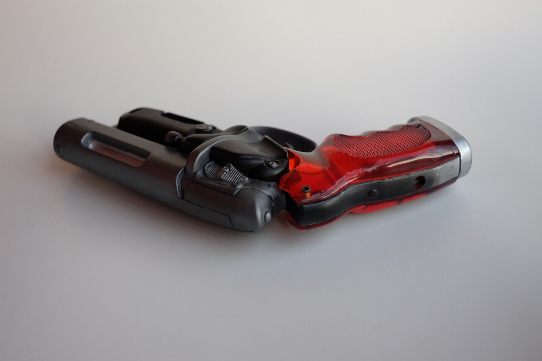

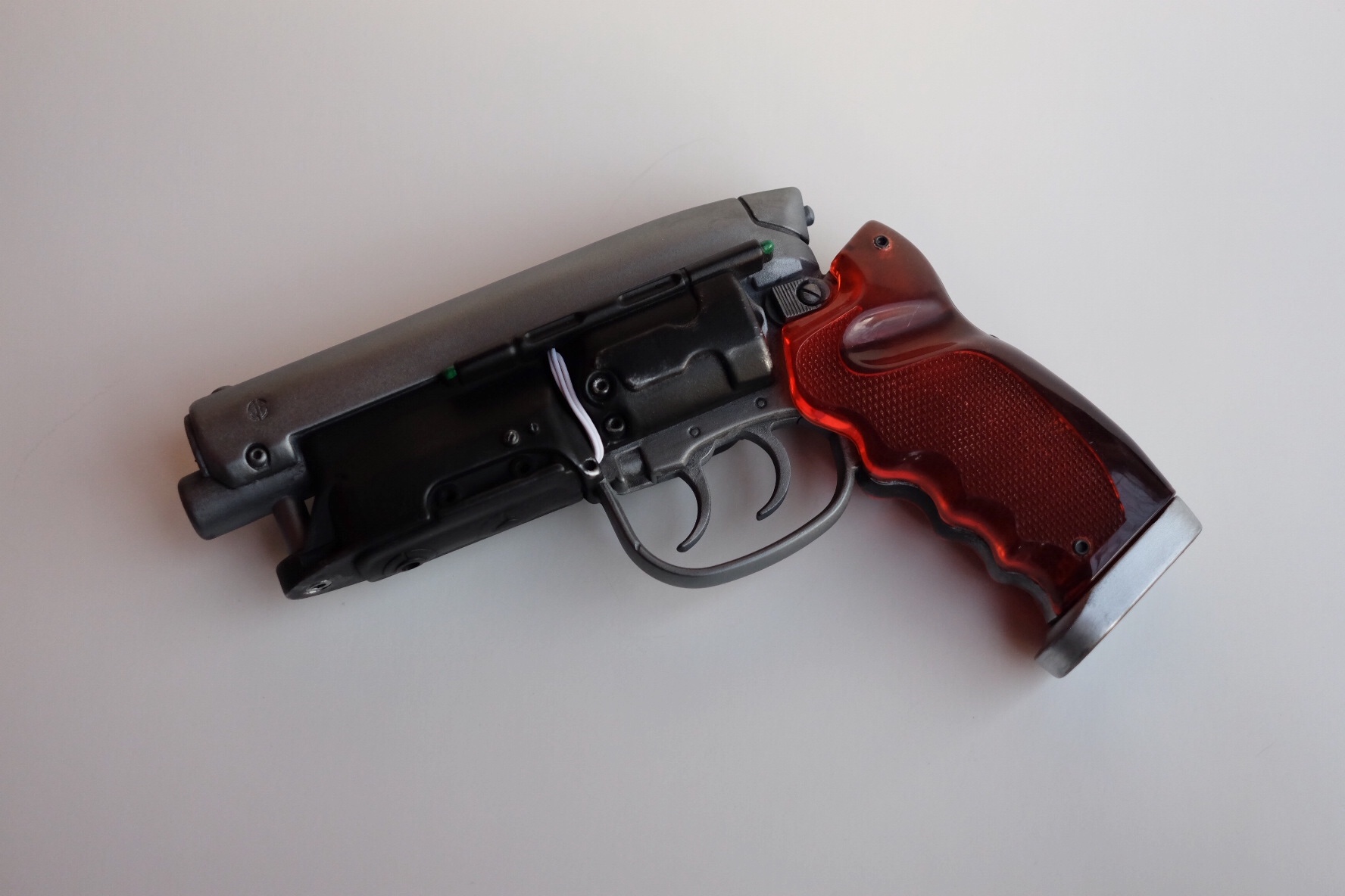

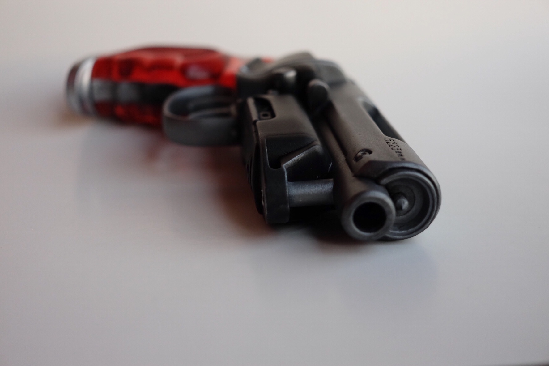

The long awaited and nail bitting part (for me at least) is over. I’m talking ‘bout painting.
Here’s some finished shots minus the nonfunctional LEDs I still need to install. In advance I apologize for the lighting in some of the images.
Anyways, let’s get to the photo dump :thumbsup
Painting is my worst area when it comes to things like this but I like the way this one came out.

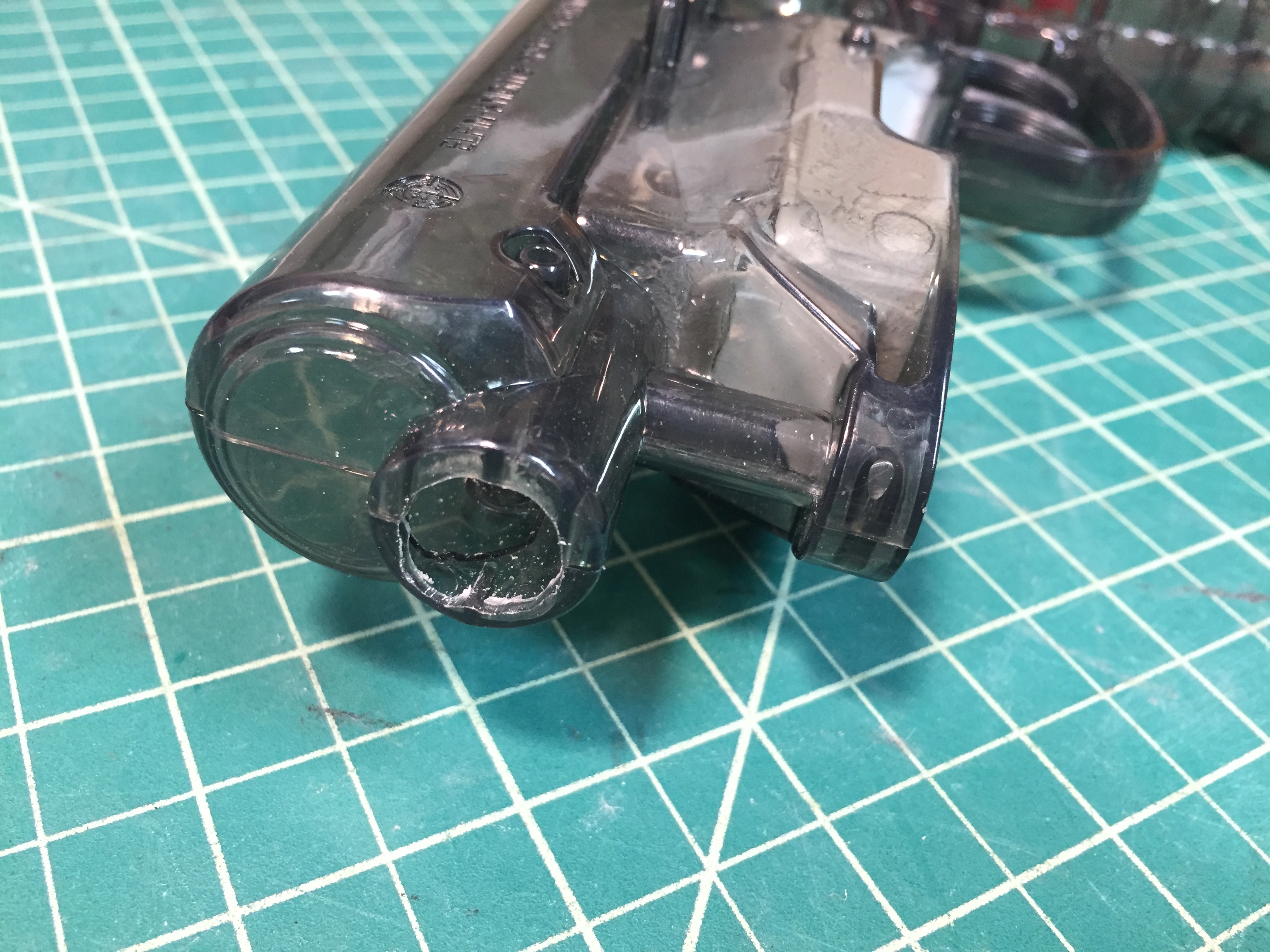

Spent some time today removing one of the knobs and filling the hole in a very sloppy fashion.
I also pulled out the water tube and plugged the hole in the back. Drilled a hole through the barrel for pouring the resin. I think I'm going to do that tomorrow.
For those of you who have poured resin into the gun, are there any places it might come seeping through unexpectedly? Or is the interior all sealed up?

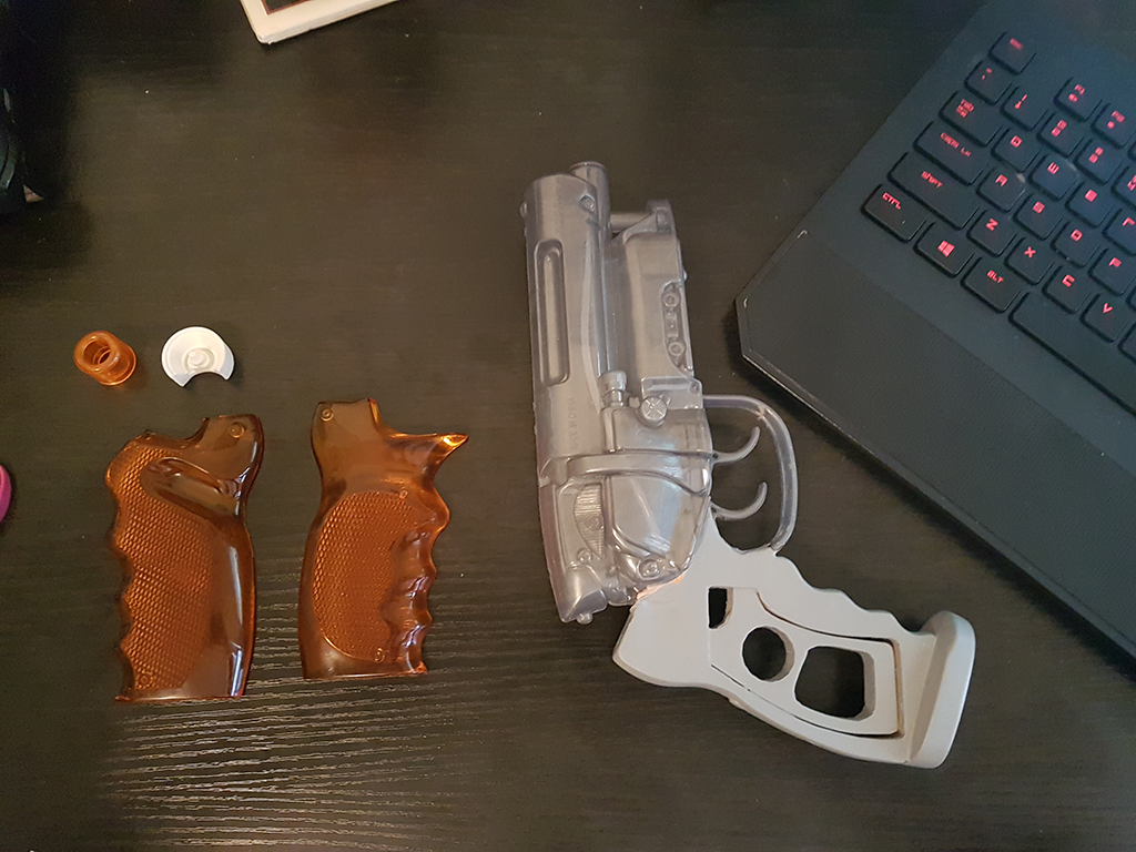

Test fit of my cast Tomen grips on the water gun:
They are a little wider and shorter than the standard cast grips, but the profile is thinner.
They also have sharper features and the bolt holes are cast into the design so they don't have to be drilled out.
Here is a side by side comparison:

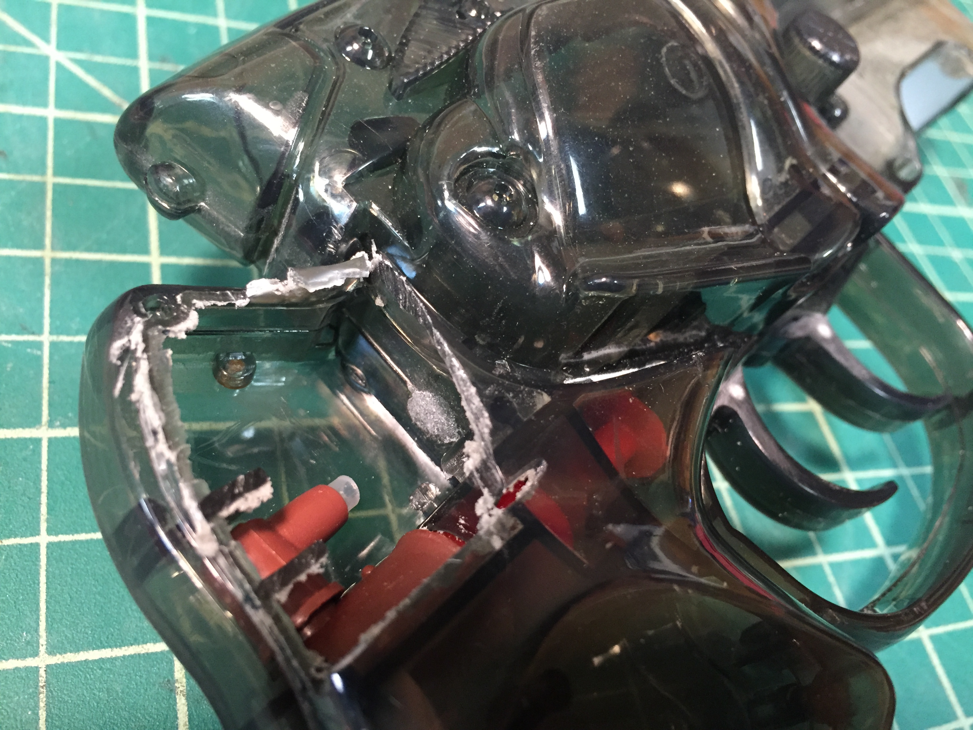

I kind of wish I had done that with mine. The grips add some decent weight but a bit more would’ve been nice.
Watch out if you hollow the grips out, though.
Once that’s done the blaster becomes very flimsy. I’d imagine even more so with the added weight.

Yeah I was afraid of that...I have Soulinertia's deluxe kit ordered so I'll be adding Darko's grip interior to mine. I think filling the gaps with Apoxie Sculpt might work to make it sturdy again?
Could hurt to try.
I noticed that when I would test fit the grips on the blaster it was solid and not as weak. Once the grips are off and there’s only that thin bit of plastic left, watch out :lol

Especially now that it's incredibly top-heavy, I'll need to be suuuper careful! Maybe I should have waited to fill the gun until after I'd filled the grips...Oh well
It’s kind of a make-or-break situation, so when that’s in your head you’re extra diligent. That’s how I was thinking about it.

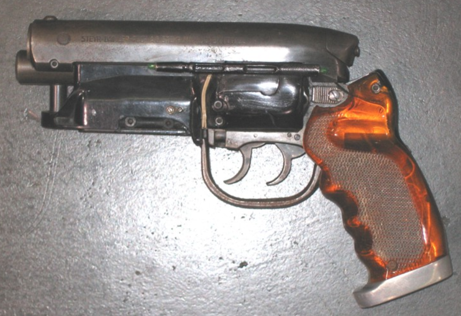

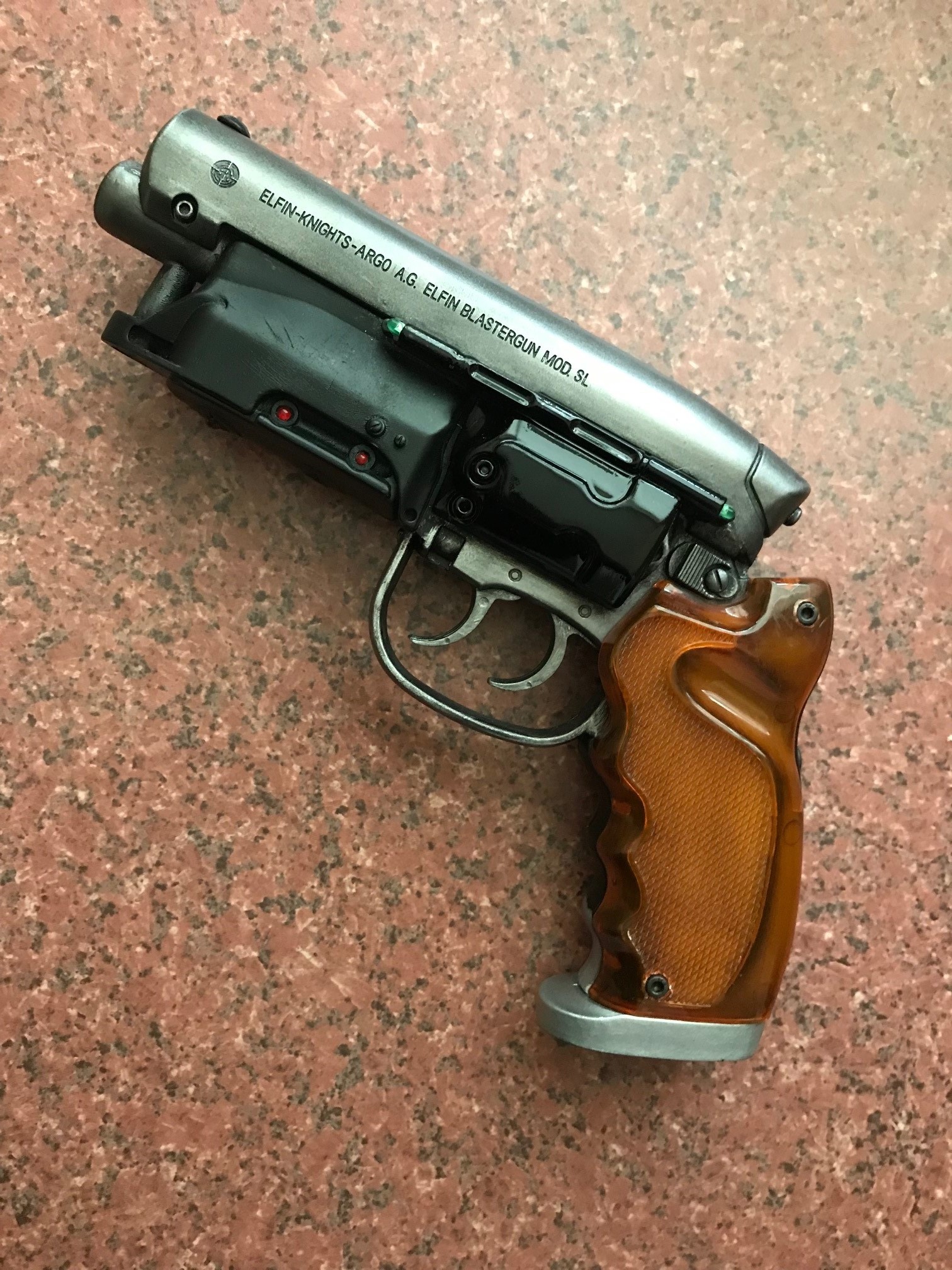

Just wondering what is best way to age the checkered part of the grips of my water gun as in the worldcon version below
I believe that off white material in the checkered grooves on the grips (3rd photo) is a build up of residue from a buffing cream like Brasso
I cut down lead fishing weights and added them into the gaps and then fashioned a fairly good representation of the bulldog grip with apoxie round them in the cavity in the grip. Definitely offsets the weight in the barrel.
Thanks to sla73 I now have these fantastic grips! and a good 2 days to work on the blaster, ill be fitting the front end greeble and barrel, filling the blaster with sand for weight and prepping it for paint (lots of smoothing to do on the grip internals) I will also be adding little details like screws,leds and other fun stuff, stay tuned!.
View attachment 762528View attachment 762529
Also! for those asking about the grip internals and front greeble, here is the STL files. They are to scale and ready to print on your favorite printer, however the grip internals will need some trimming to get them to fit into the blaster grip as it was a pretty quick modelling job, but here you all go.
