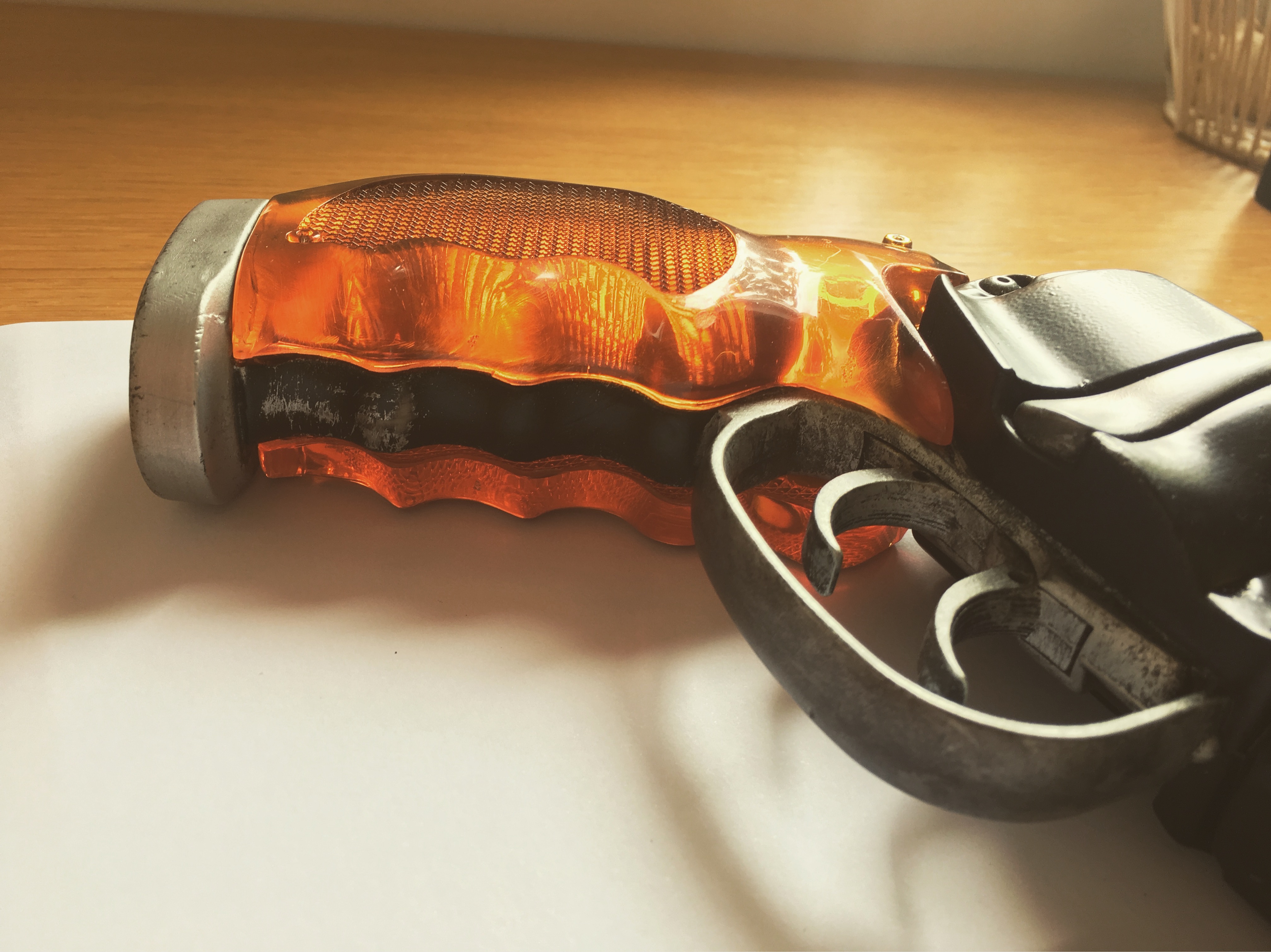

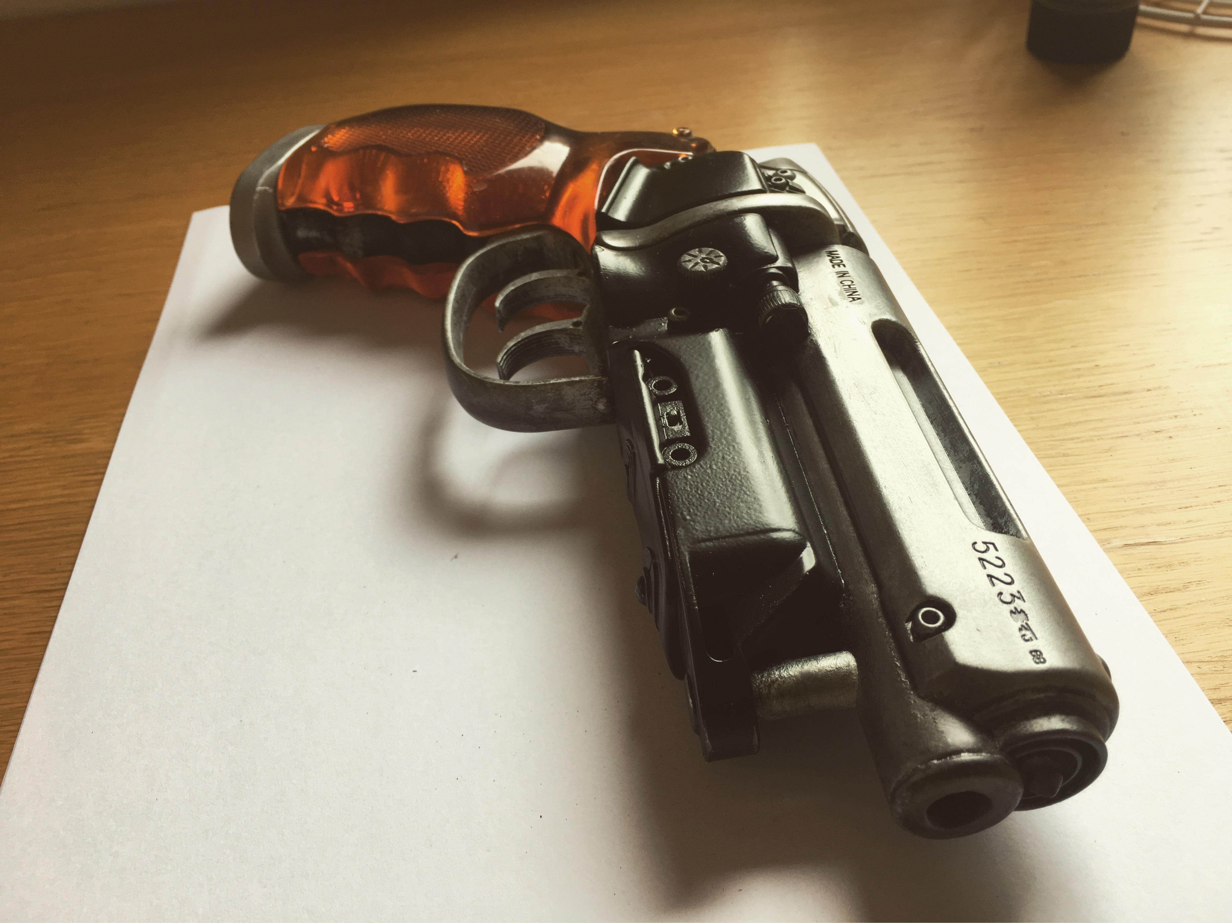

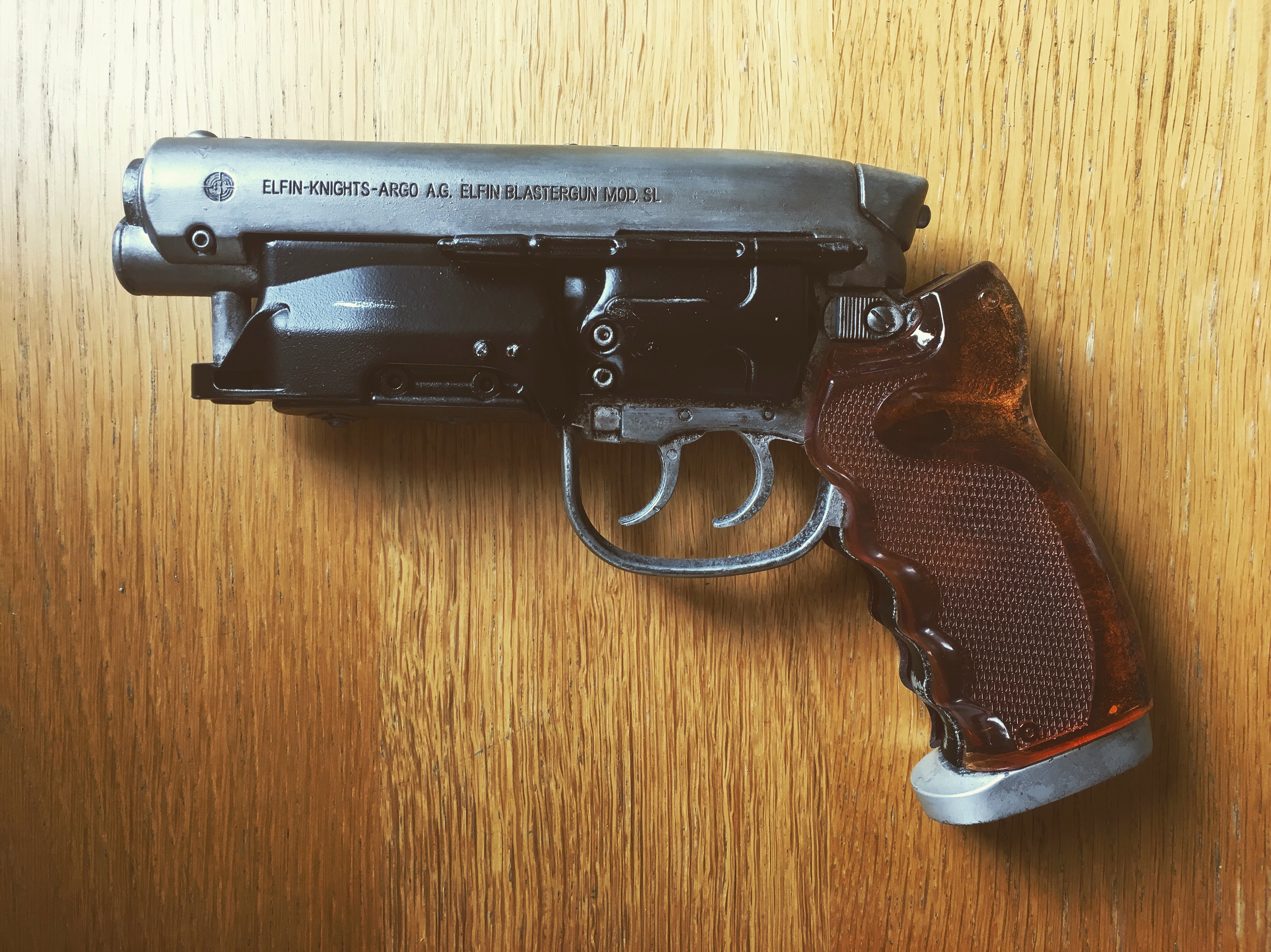

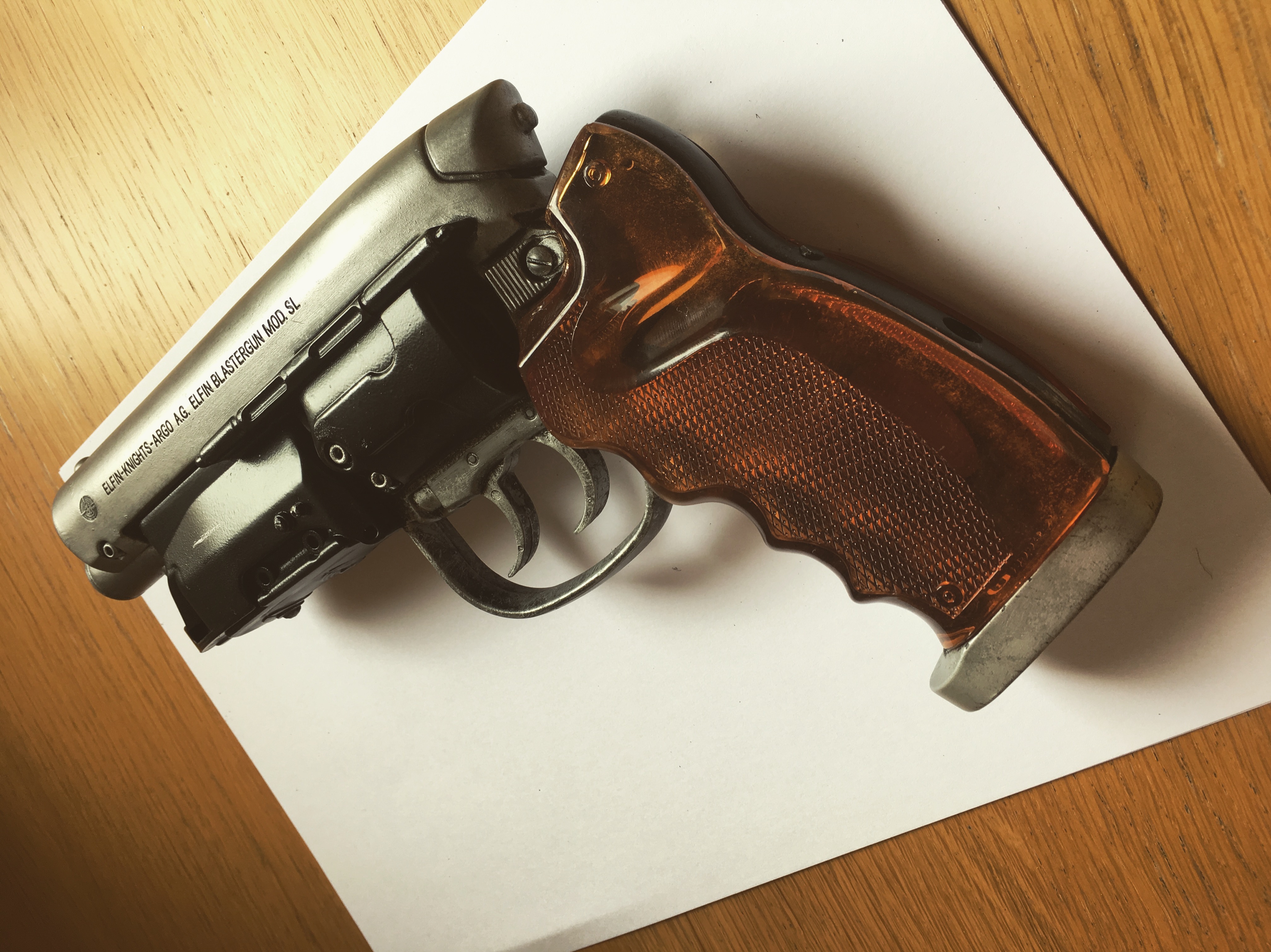

the Tomen butt and grips are a bit slimmer than the water gun.
If you noticed in the pictures, the water gun's butt gets wider from the back all the way to the front.
The Tomen's butt is consistent in the oval long shape. And the widest is 32mm on the Tomen's butt in the mid section.
Also notice Tomen's grips are a bit slimmer than the water guns'
You just need to sand down, but before, fill in the Butt with 2 part clay or plastic sheets. Cause you may have a hole in the butt.
Hope this helps and let me know any more help.

Excellent! Thanks again for these comparison pics. I've already filled the butt with Apoxie Sculpt, so all I need to do is sand it so it's flush with the grips.
I know I posted it in another thread, but I'm excited and wanted to share it with you guys because this thread and all the awesome work people have done with their water guns has been an endless source of inspiration!
Here's my new water gun conversion so far!

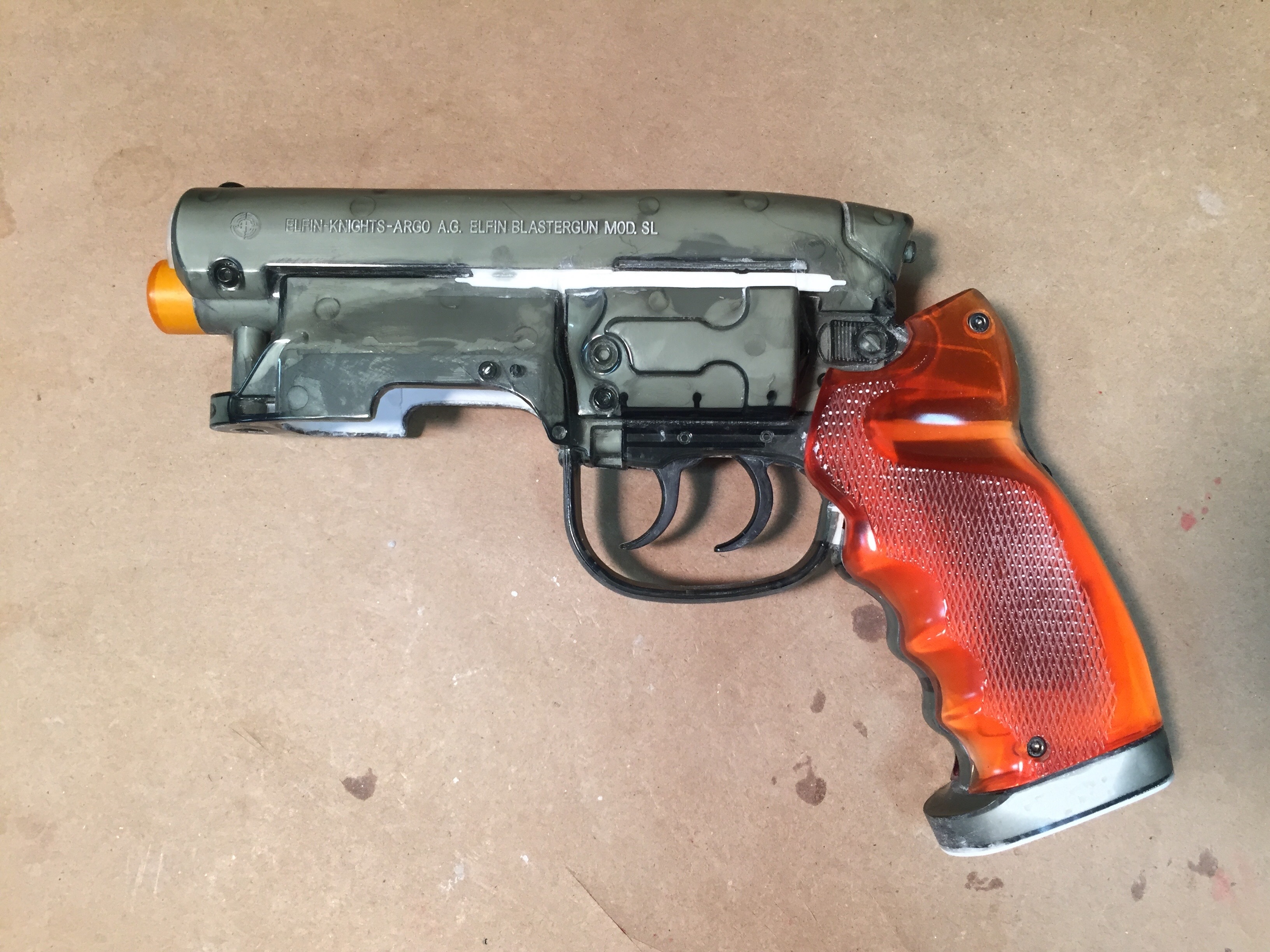

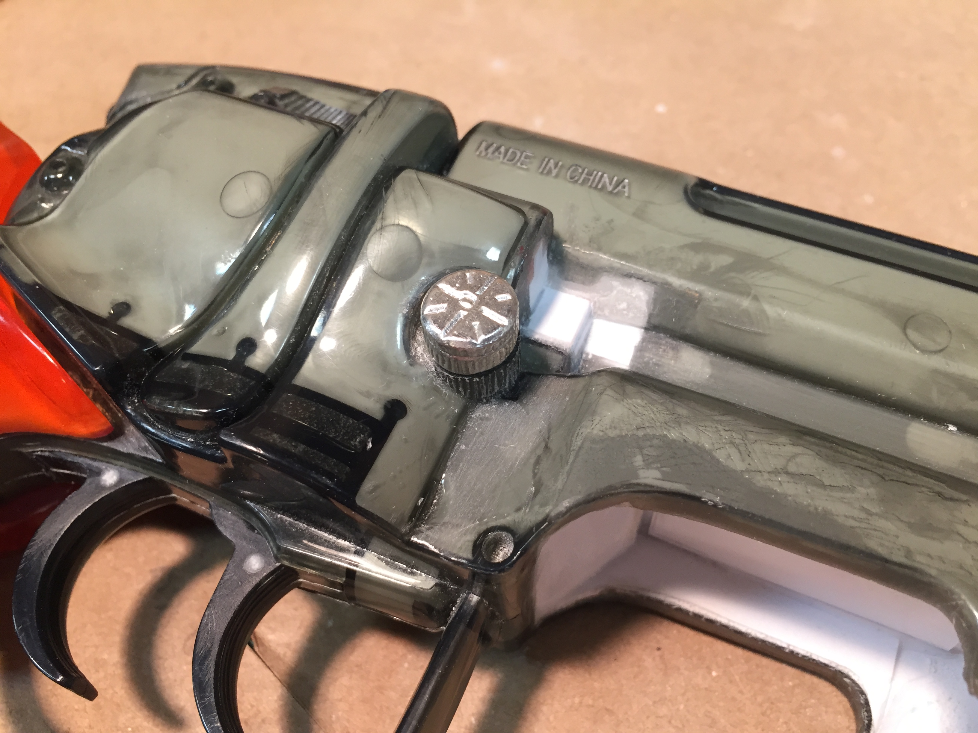

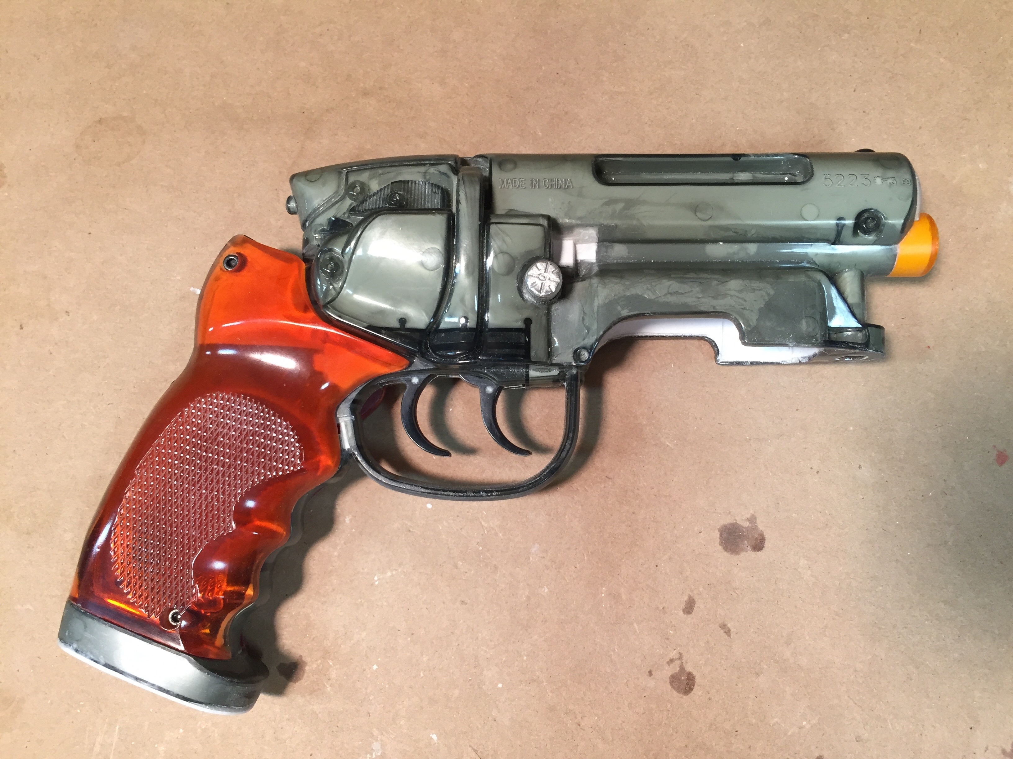

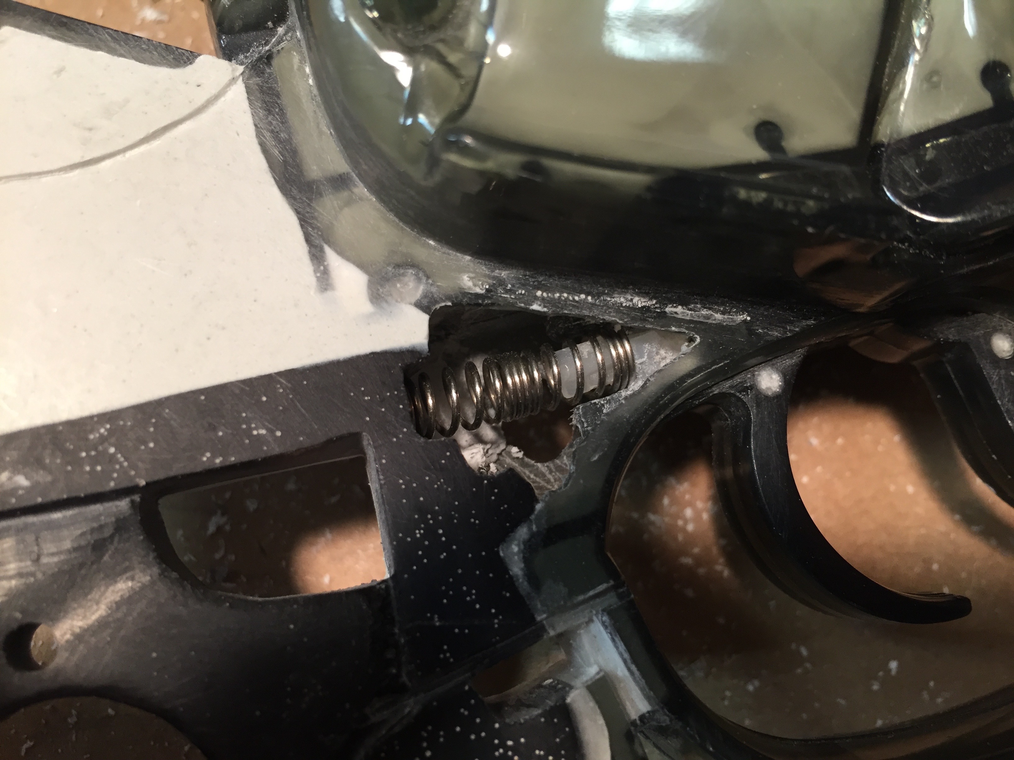

Been busy working on my water gun the past few weeks. Here is some of the progress I've made:

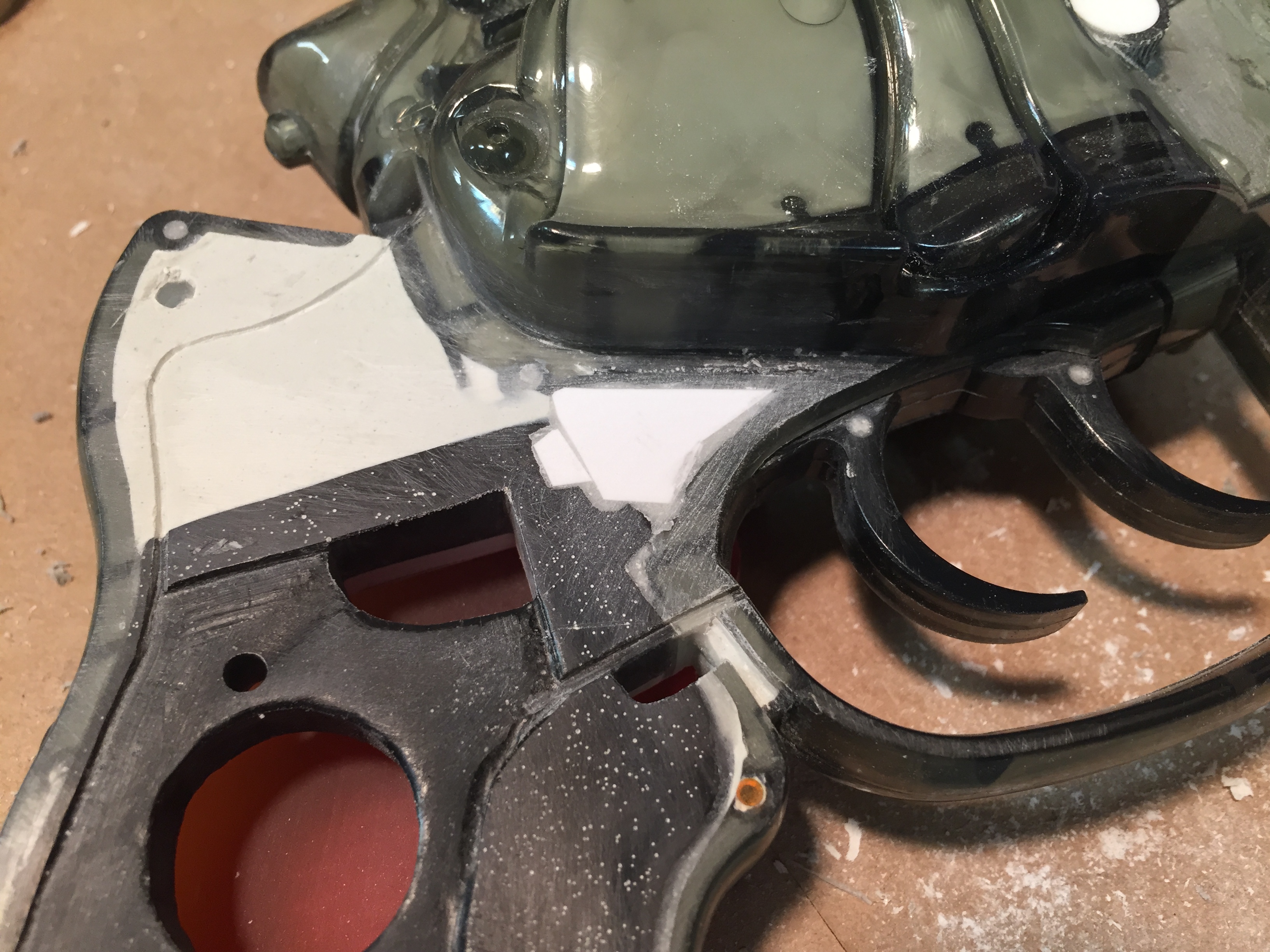

I glued in a spring to allow for trigger movement and then sealed it all up. Hopefully the spring never breaks because I'd have to cut it open to access it.

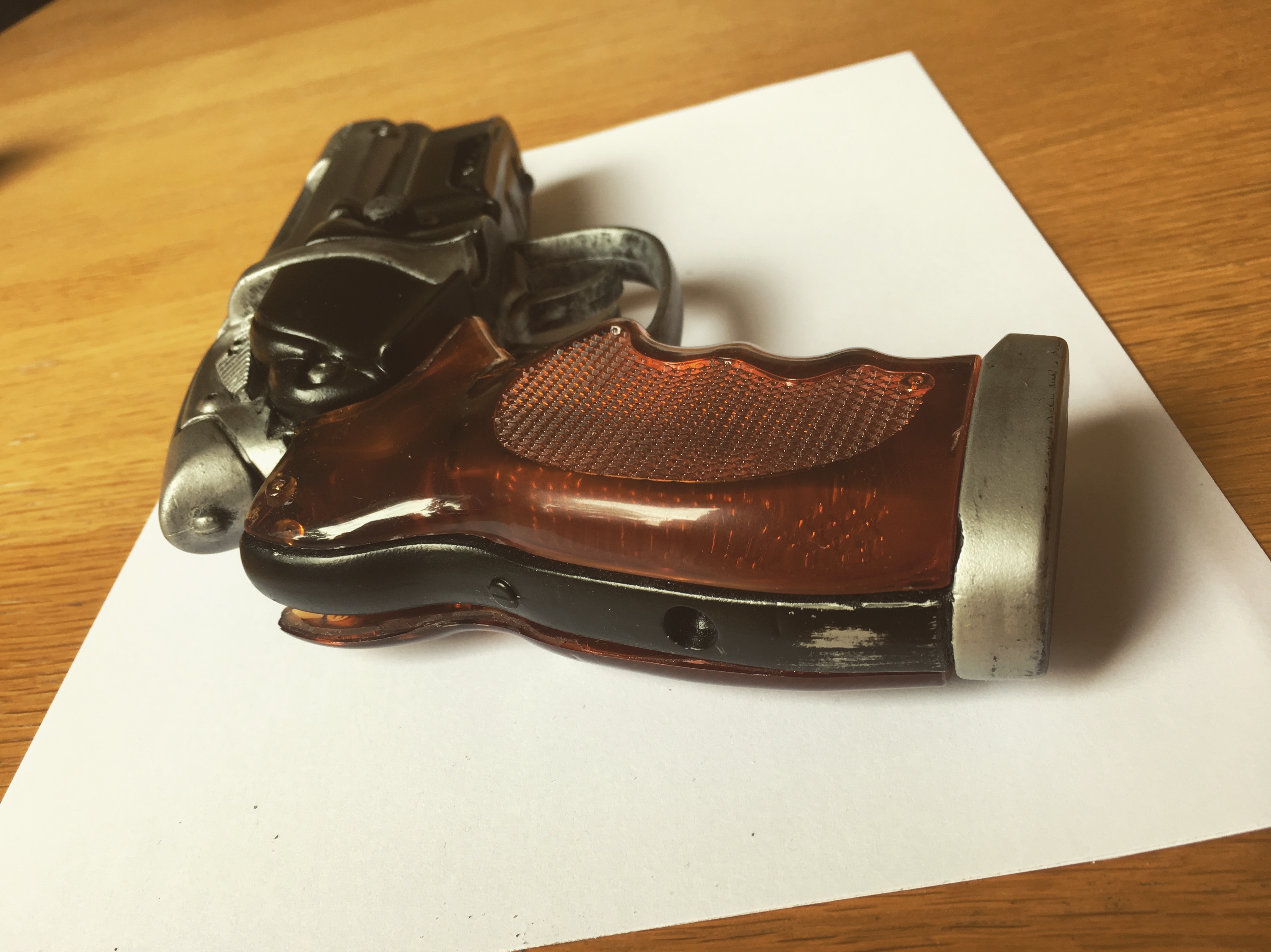

I screwed on the buttplate to the grip, then glued it in place so it won't come off. I also sanded down the sides to make it match up with the Tomen grips.
I recently ordered a pair of cast pewter replicas of the two knobs from Tip Top Workshop to replace the molded ones on the water gun. They came in great shape! I've only drilled the hole for one of them so far, but it's sitting in there with friction until the gun is painted and I can glue it in place.
I finally got around to removing the molded sight rod and am currently cleaning up that section and adding in the missing detail. I've ordered a new sight rod from Shapeways that I'll be using.
As for the Tomen grips, I was having trouble with the Apoxie Sculpt crumbling when I tried to insert the upper screws, so I came up with a solution. I have a bunch of white RC ball link pieces lying around and noticed that the holes in them are the perfect size for the screws. They're made out of a fairly soft plastic that provides a tight hold when the screws are screwed into them. I drilled out a hole in the grip frame large enough for one of the ball links, cut the ball link to size, and glued it into the grip frame. Now I can actually screw the grips in tightly!
Here's what it looks like at the moment with the grips screwed in. It feels great being one solid piece now.
The biggest thing I still need to do is clear out the magazine compartment so it can slide in and out and attach with magnets. Looking forward to giving it a fresh coat of primer so I can start cleaning up the finer details and little mistakes.

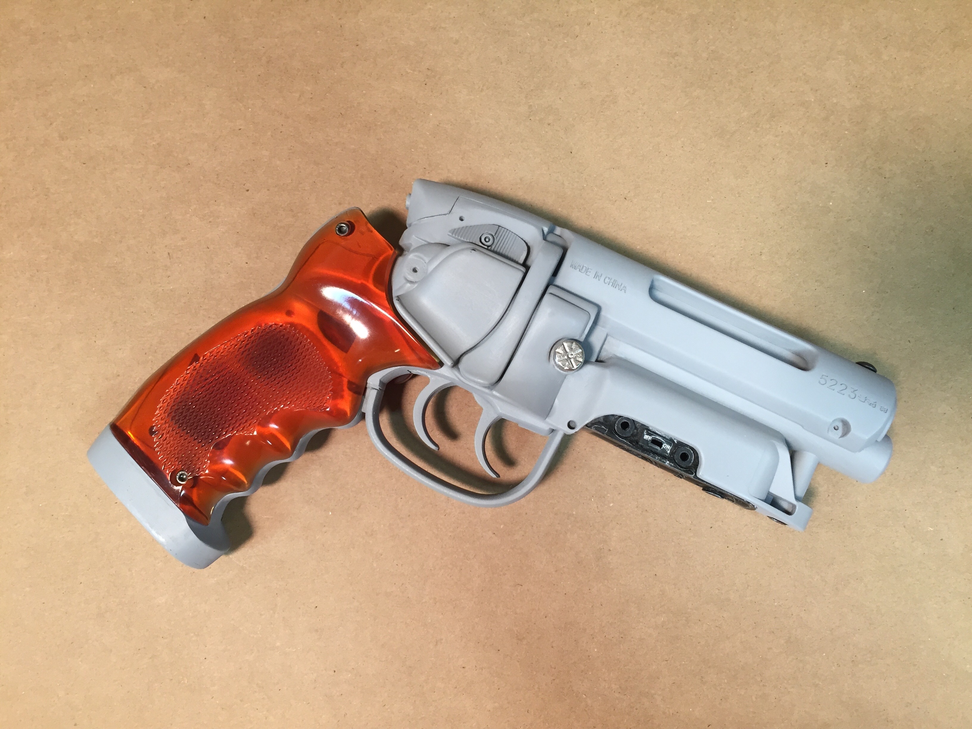

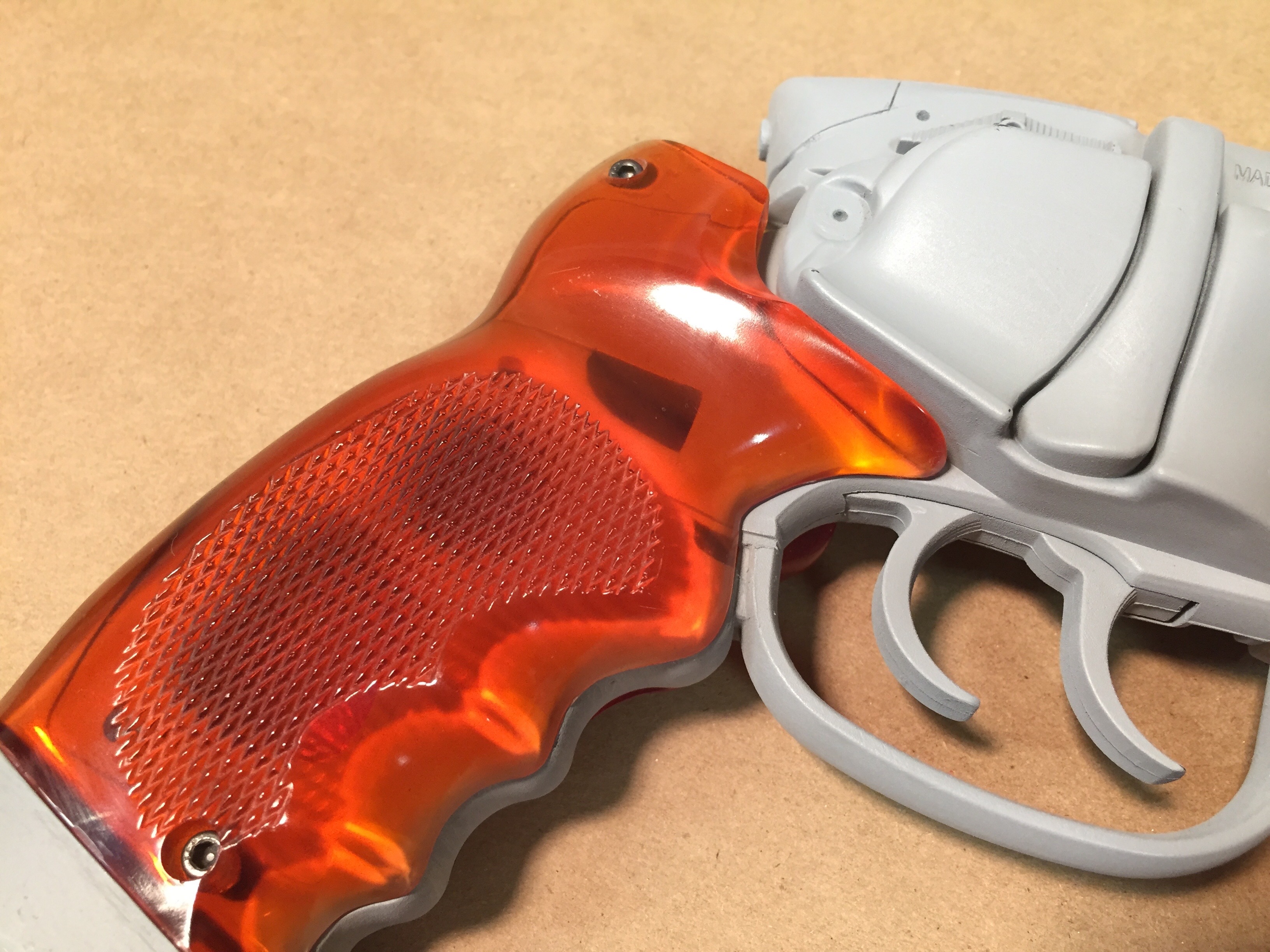

Finally got a coat of primer on my blaster - super pleased with how it's looking so far. It needs some touch up work especially around the fine detailing, but after that it should be ready for paint. I replaced the magazine with a resin cast I ordered from Richard Coyle and the sight rod I ordered from Shapeways - really elevates it to a new level.
I'm in San Francisco for the next 3 months so I won't be able to work on it until I get back home, but I'm excited to get it finished up! I'm having a blast with this project and I'm 100% addicted to the PKD now :lol
