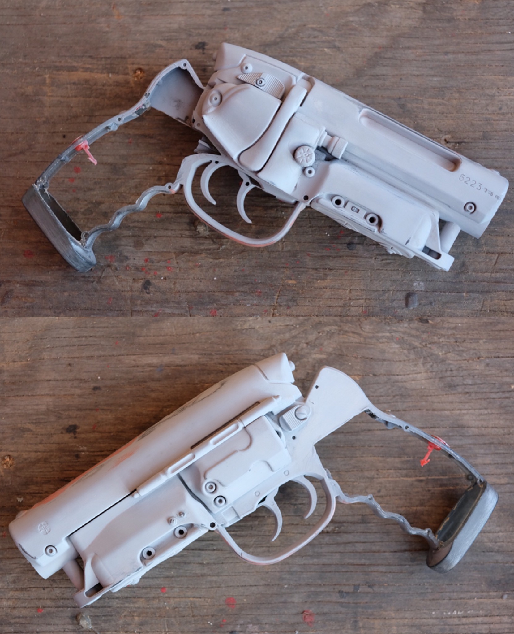

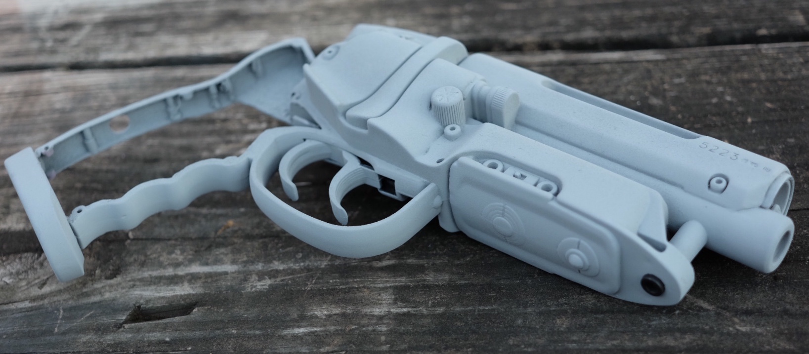

Been making some progress:
Here’s some seam/flash removed
I finally got around to removing the inside guts of the grips. Along with filling in most of the text on both sides
Also, the crack to the right of the bolt action is almost completely gone
And lastly just for fun
@Soulinertia your grips rule :thumbsup
Looks great so far! I got just about that far and then had a super FAIL. I used a dremel to remove most of the water tank, buffed the entire gun with 0 steel wool for paint prep, sprayed 2 coats of primer, and then...dropped the damn thing while sanding down the last bits of plastic around the frame (those little nooks and crannies are pretty tough and the plastic is extremely brittle). The frame literally shattered. Luckily, I ordered 2 guns. Be very careful. You have to get that frame down flush all the way around or the grips wont fit right.
I'm working on a second project. Modding one of those toy guns from Amazon. I'm going to use the parts from my broken water pistol to fill in that gap in the middle. Progess so far...I need to sand down that second trigger and add the parts from the water gun...
Yea I’m being SUPER careful because Ive only got one go at this, lol.
ive been going to everything I’m going with knowing I only have one blaster. So my @$! Is being very careful

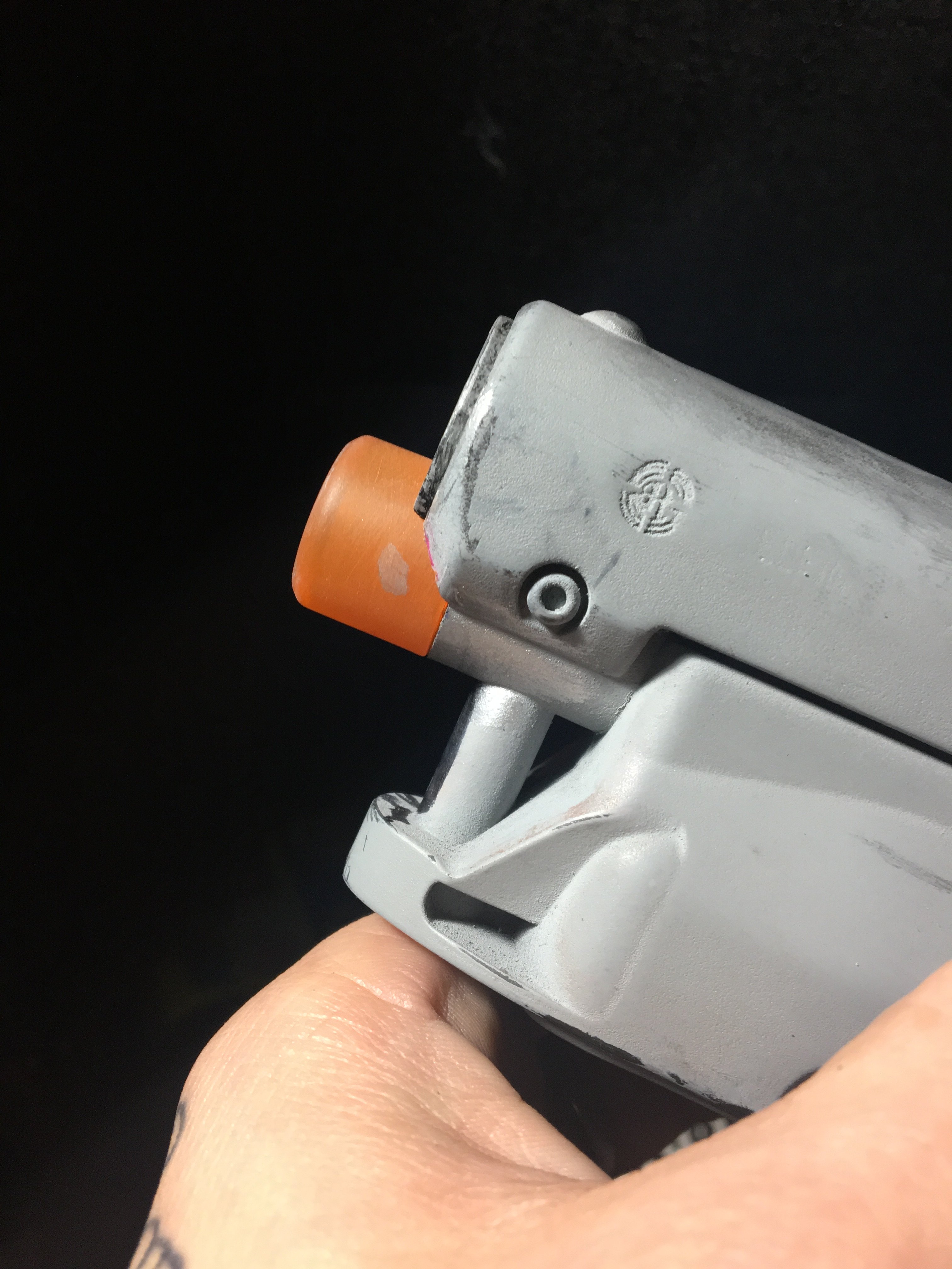

im also working on this thing very slowly.
Only progress is I’ve removed some of the barrel and attached the orange tip. Hahah
This was an order picture. I’ve since removed more of the squirt guns barrel so the orange tip wouldn’t protrude as much.
Thats about it, though.

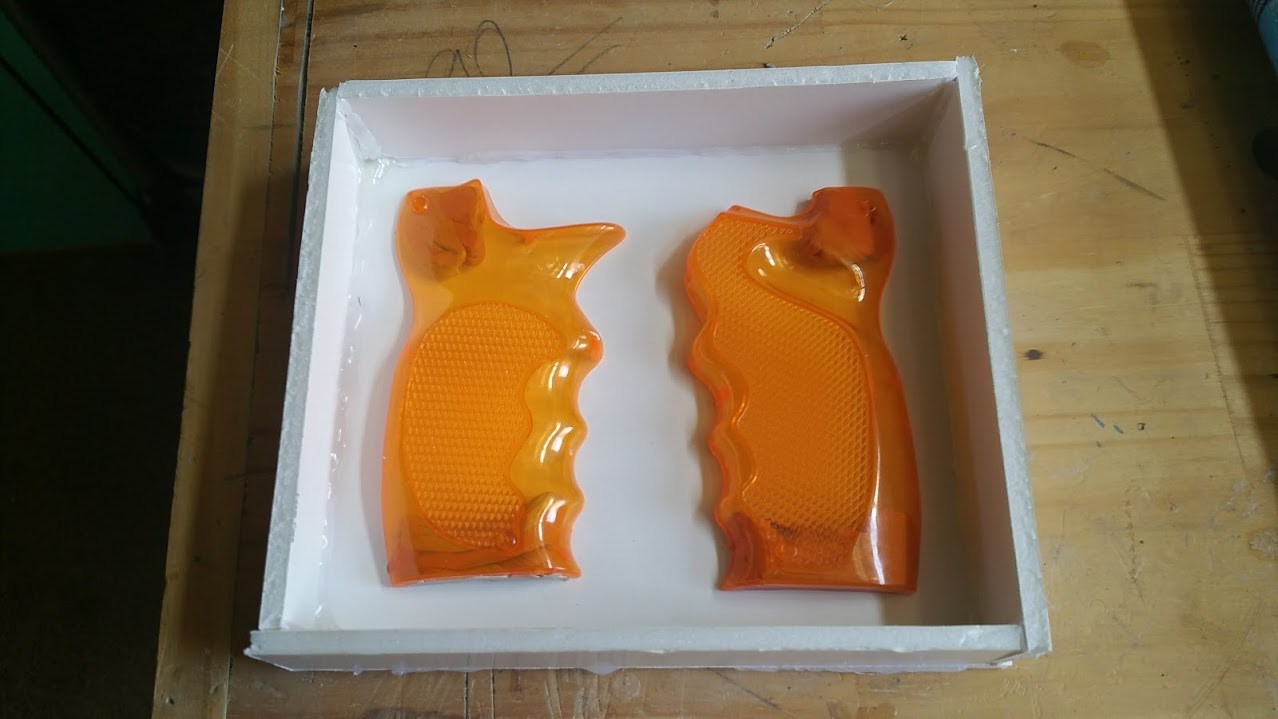

Progress update...
After the failure of my home-made mould using 100% silicone caulking and cornstarch, I popped over to Barnes in Richmond (it's near my work) and picked up some Pinkysil, Epoxyglass and Bright orange translucent pigment. This made for a much easier (and way less sticky) moulding process.
I made a box out of foam core and placed the grips into it, ready for the silicone.

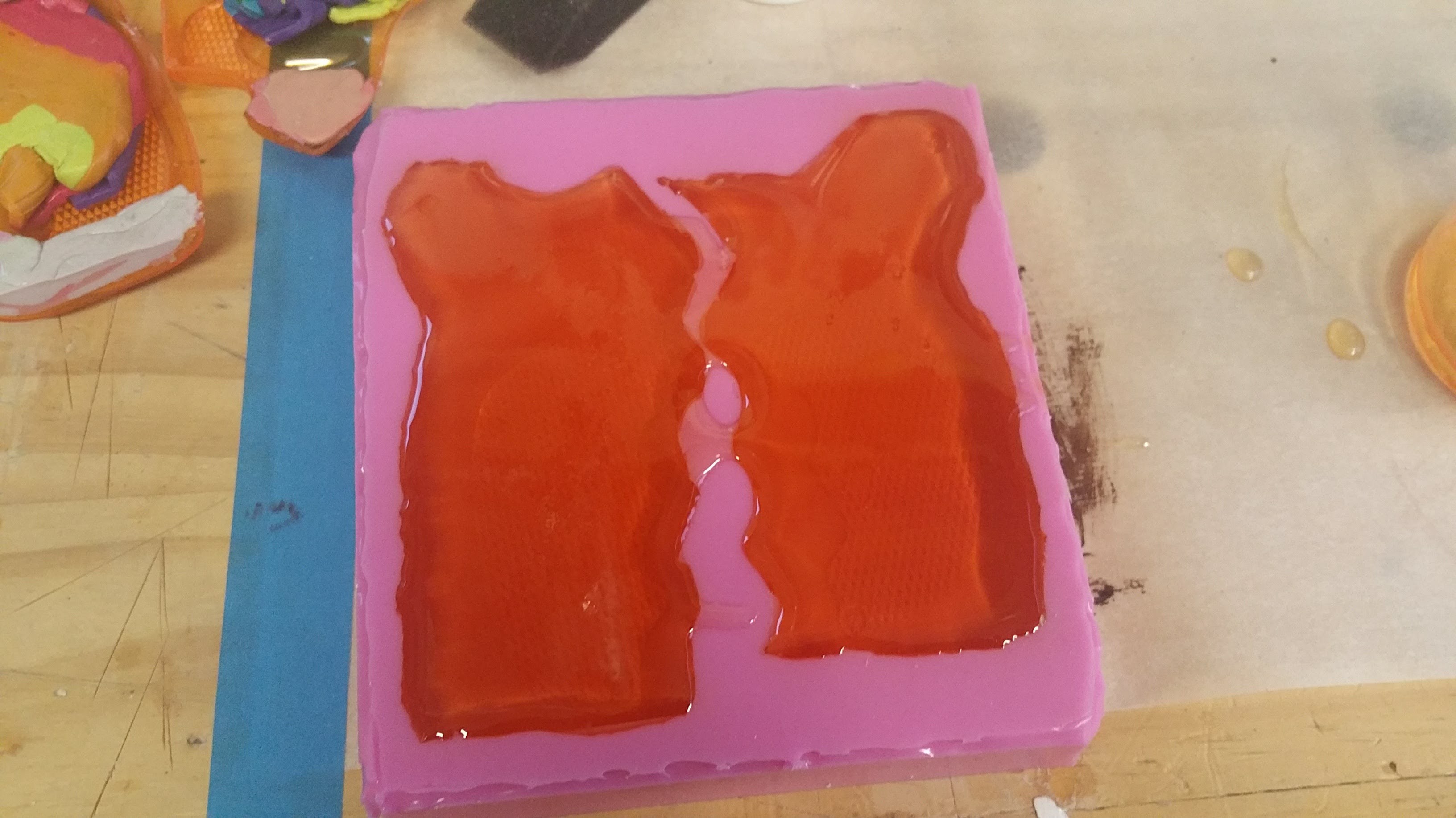

I mixed up a batch of Pinkysil, and in a long thin stream poured it in.
I didn't know at the time, but I made two mistakes.
  1. The grips weren't seated properly, which allowed some of the silicone to leak under.
    Not much but a little.
  2. Probably should have made sure the mould was on a level surface.

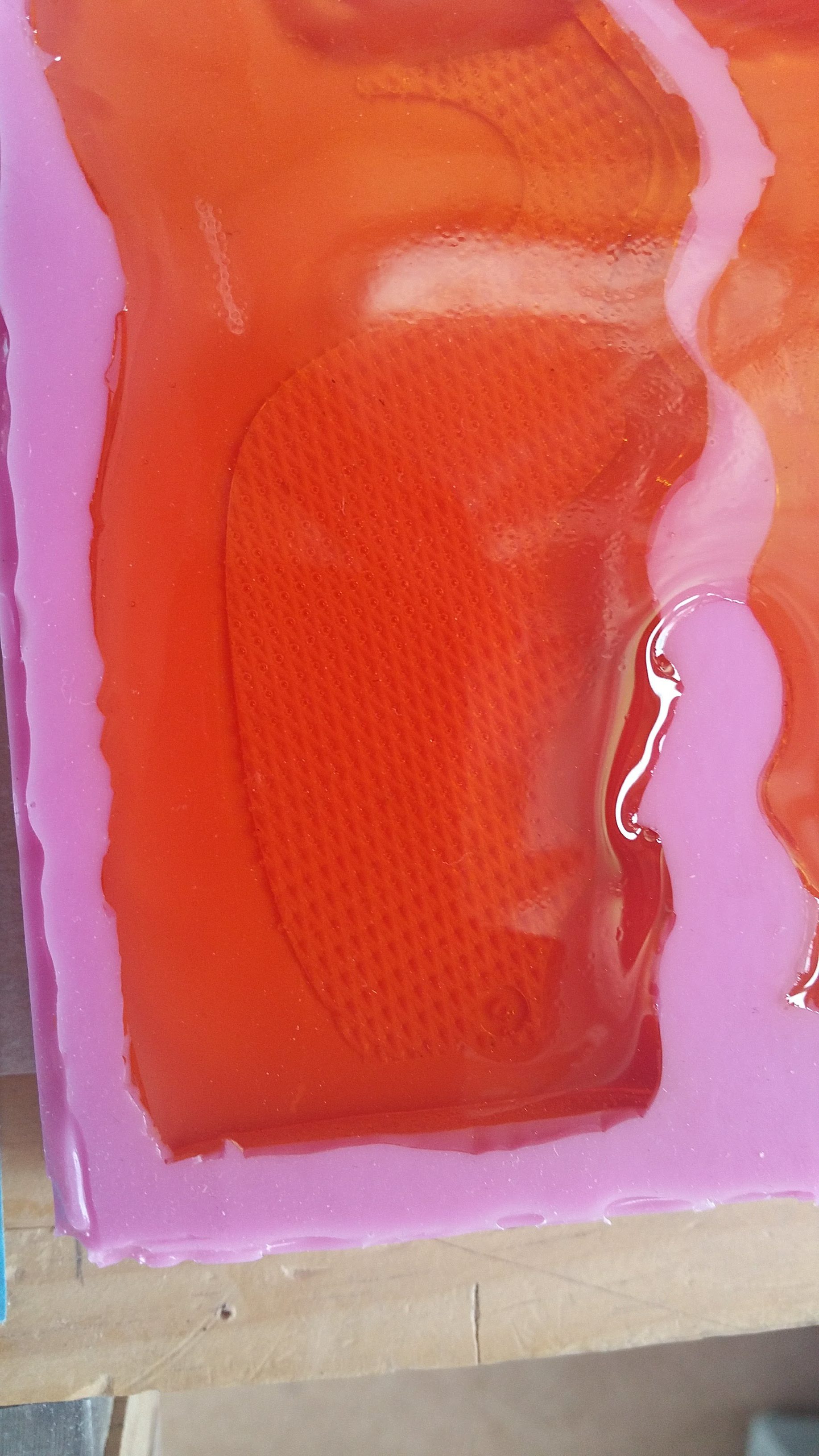

Next, I mixed up the Epoxyglass.
I need to take a minute here and thank the wonderful staff at Barnes in Richmond. They were super friendly and informative and didn't treat me like an idiot when I asked silly questions, like the n00b I am.
Again I poured this from as high as I could in the thinnest stream I could to avoid air bubbles (pro tip from Bill Doran from Punished Props.)
And boy did it work!
Not a bubble to be seen!
Please ignore the spillage it was my first time using this stuff.

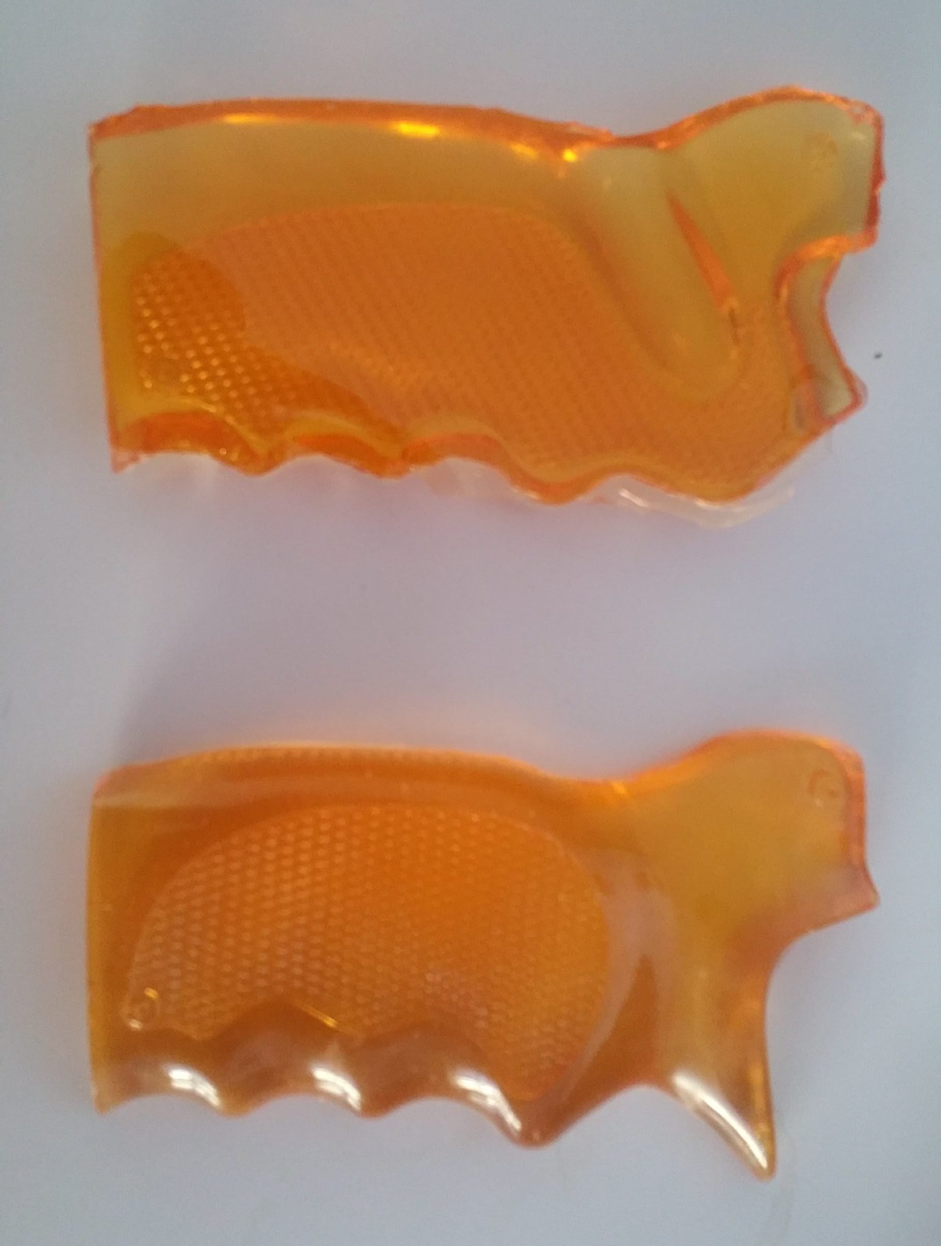

The final result is pretty good but not great. I have heaps of clean up to do.
I'll need to flatten the backs and then re-polish them, but all in all, I'm happy with my first attempt at moulding and casting.
Would it have been cheaper to buy them from Soulinertia? Probably but it's fun to try new things.

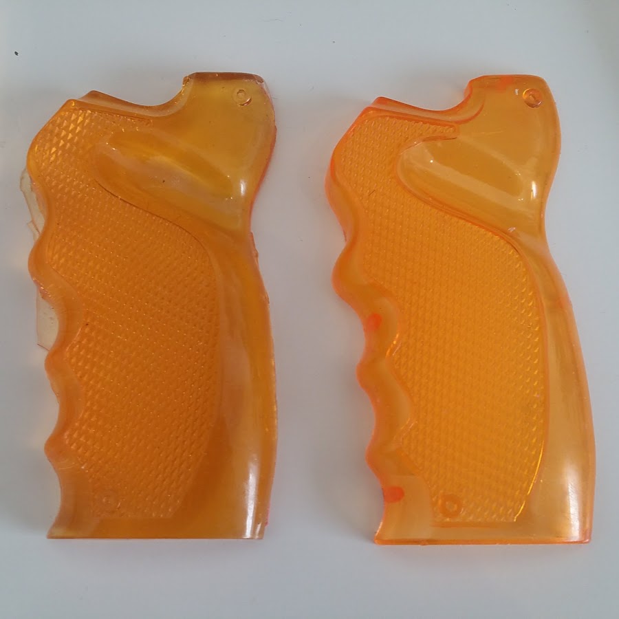

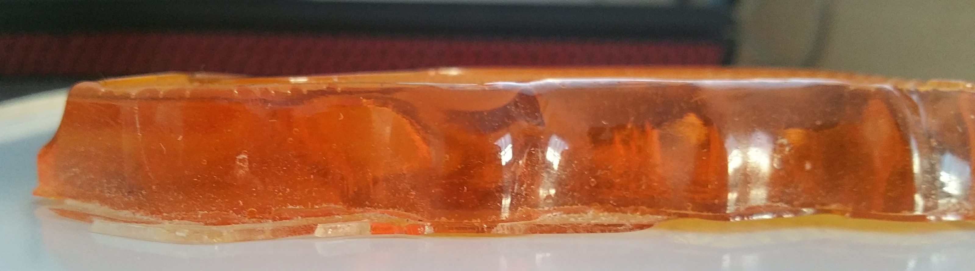

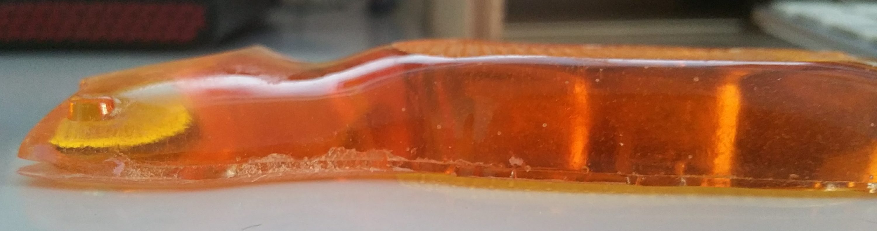

Just a quick one.
Thought I'd show off the colour comparison of the cast.
It is a little darker but I think that is a better match.
The resin is on the left.
I'm quite happy with that. I did this cast the week before Xmas and only just thought to do a colour check :)

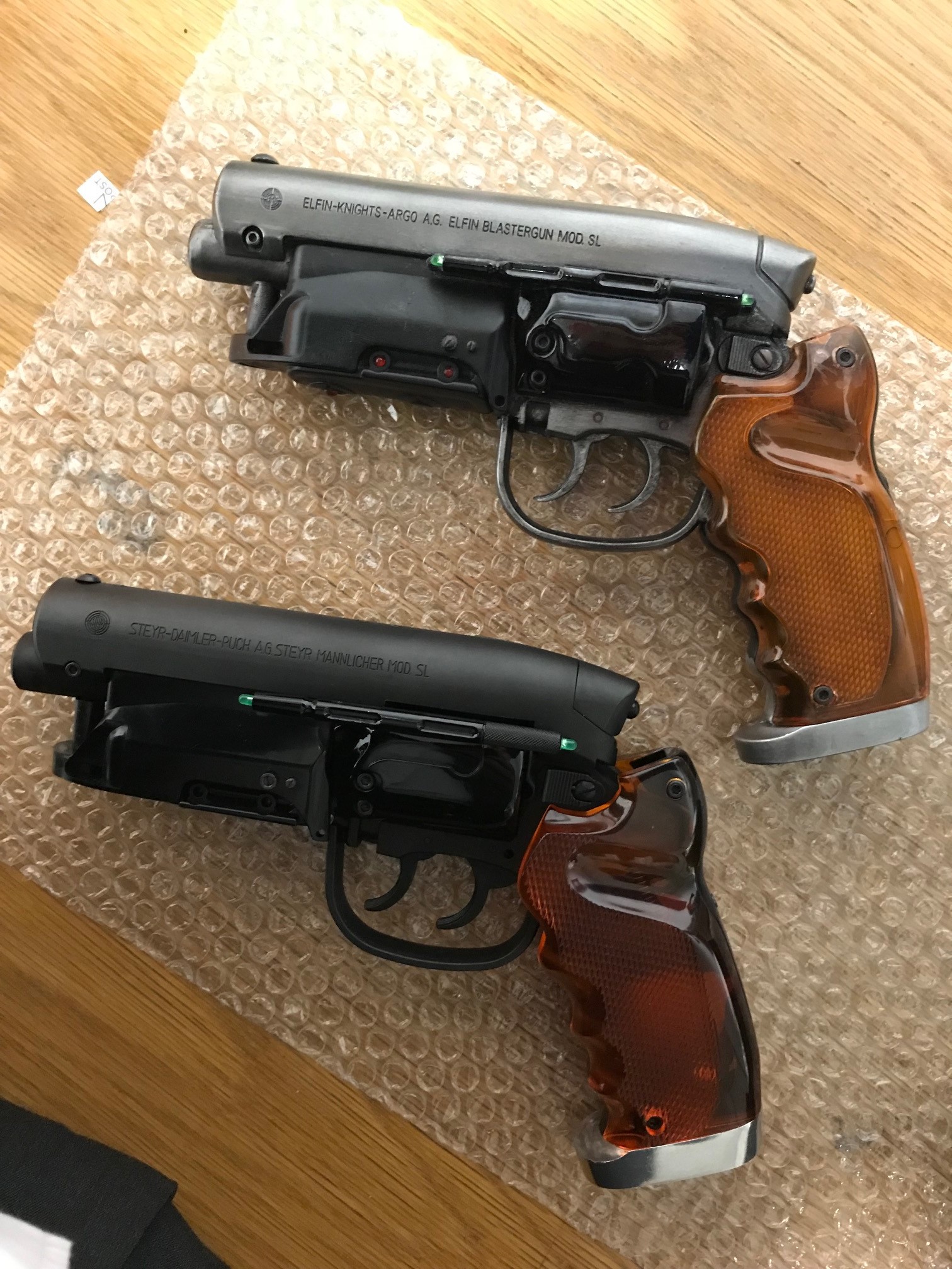

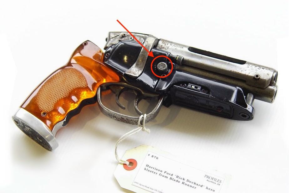

Does anyone have an ID on this knob? I'd like to real-part replacement on my water gun if I can find out what it is.
You're right, that's the one. Also found on the 344 apparently. Seems they're nearly impossible to find online nowadays..know of anyone who offers casts?
Not off the top of my head. If you’re not a member of the Facebook group ‘Blade Runner Blaster Addicts Support Group’ is recommend asking there too.
if anyone would I’d think Richard Coyle. He’s a member in that group also if I’m not mistaken.

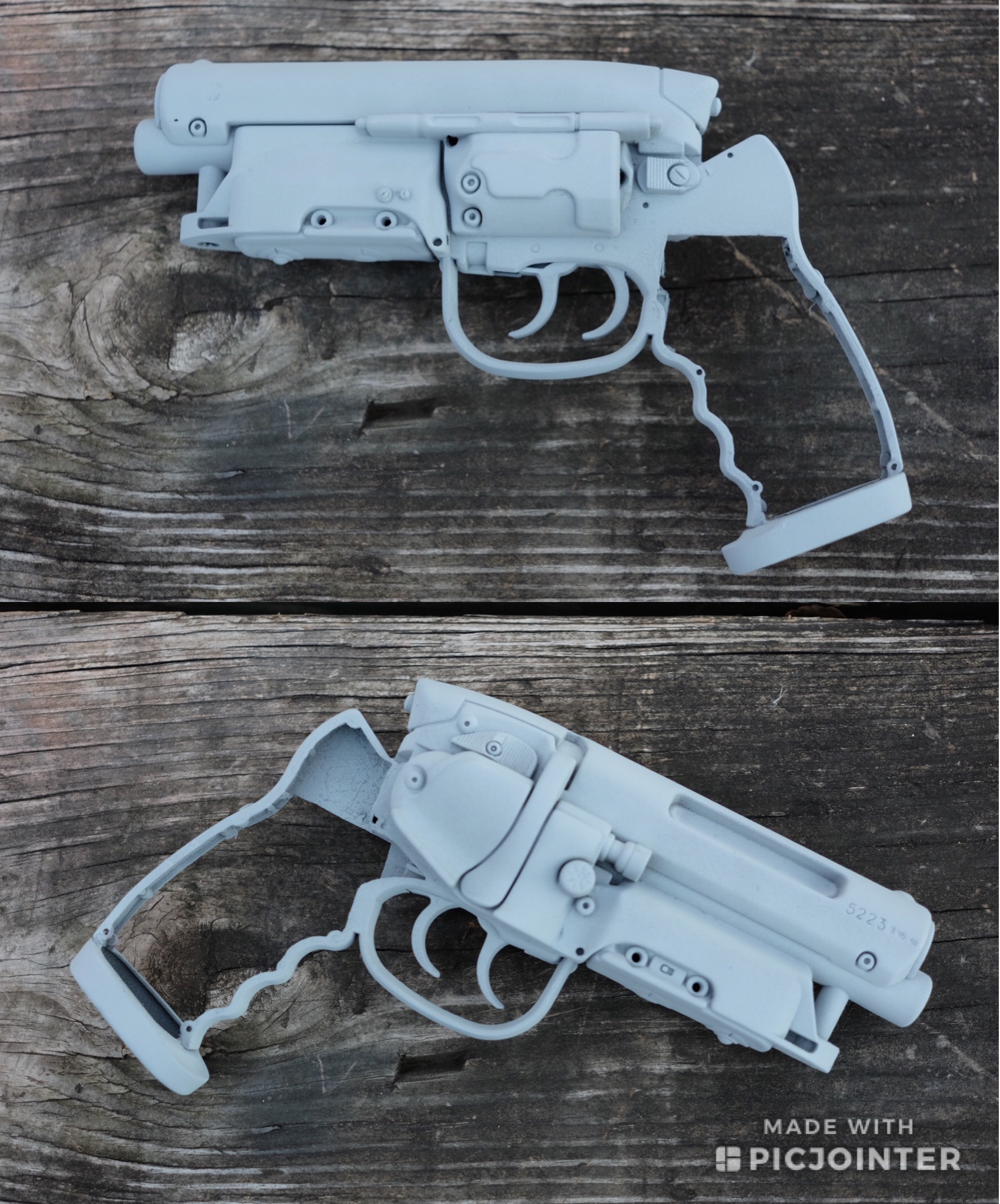

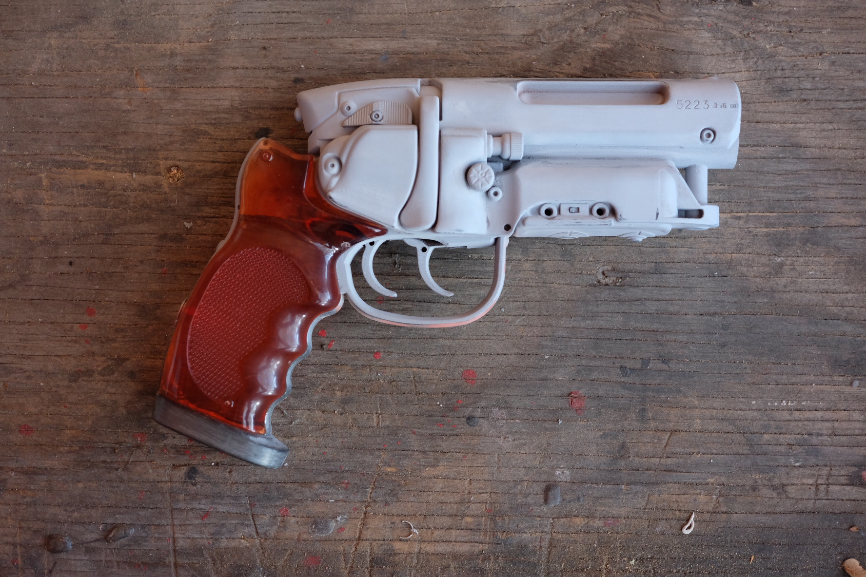

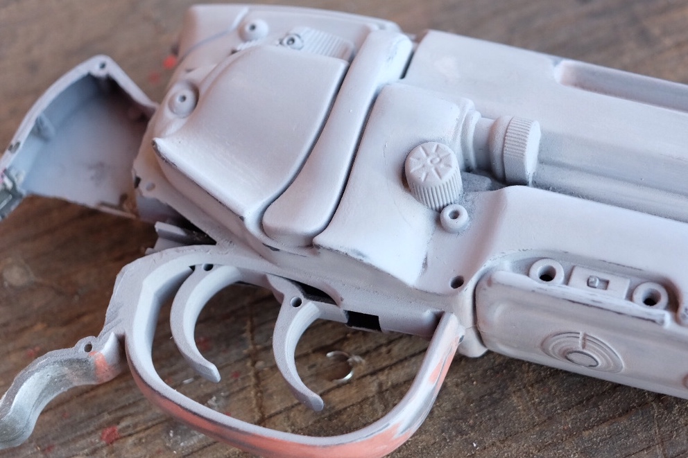

Update time.
Here’s the little work I've done so far. Also, I forgot to sand before taking these shots so the blaster looks a little rough.

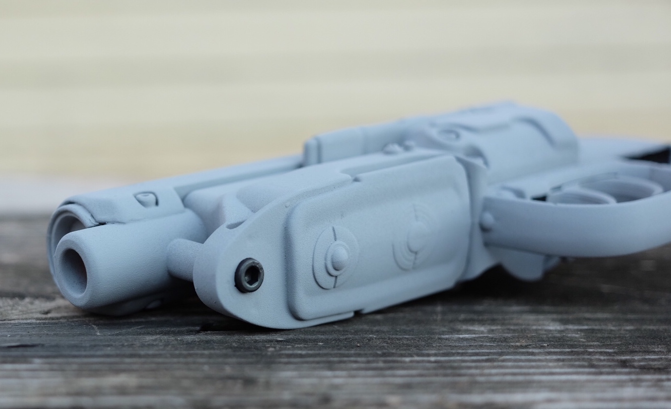

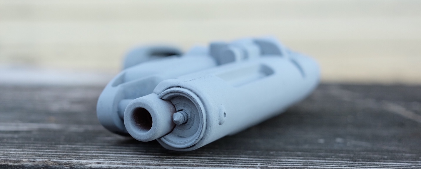

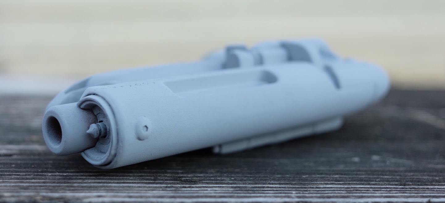

First, the usual shot. Not much really new:
Expect maybe me finishing the barrel!
Also, I’ve added some hardware as you can see:
The one one thing I’m still one the fence about is the front end. See for yourselves:
the one small detail I’m kinda proud of:
Basically I torched an Allen wrench and made an impression on the “screw” to make look a little more realistic.

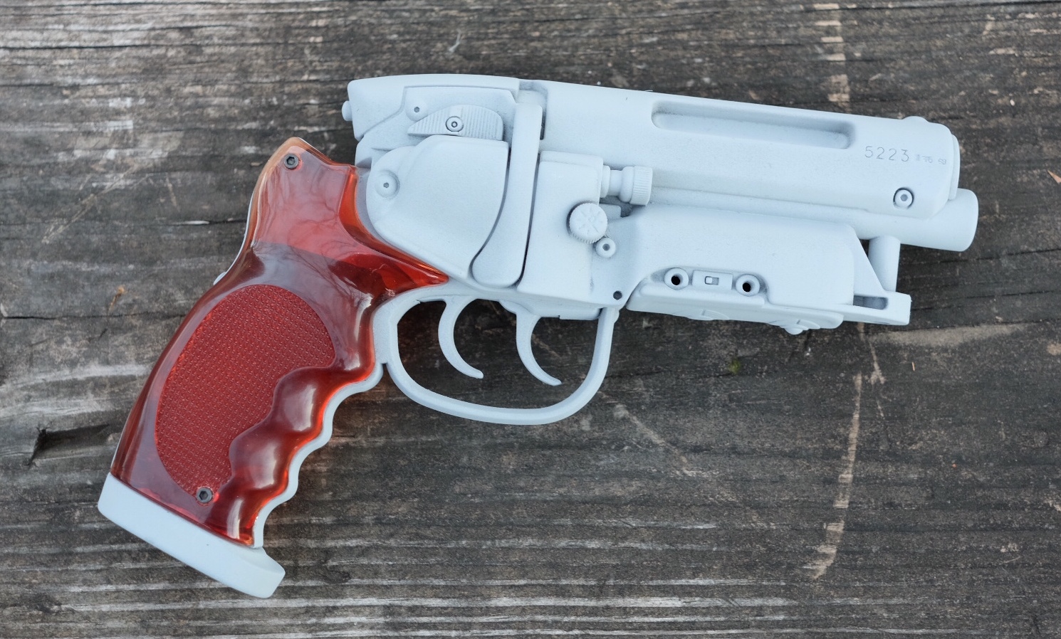

And lastly the grips with some hardware:
with all that said and done, after some sanding it’s time to paint. ‘Bout time if you ask me :)
Update time.

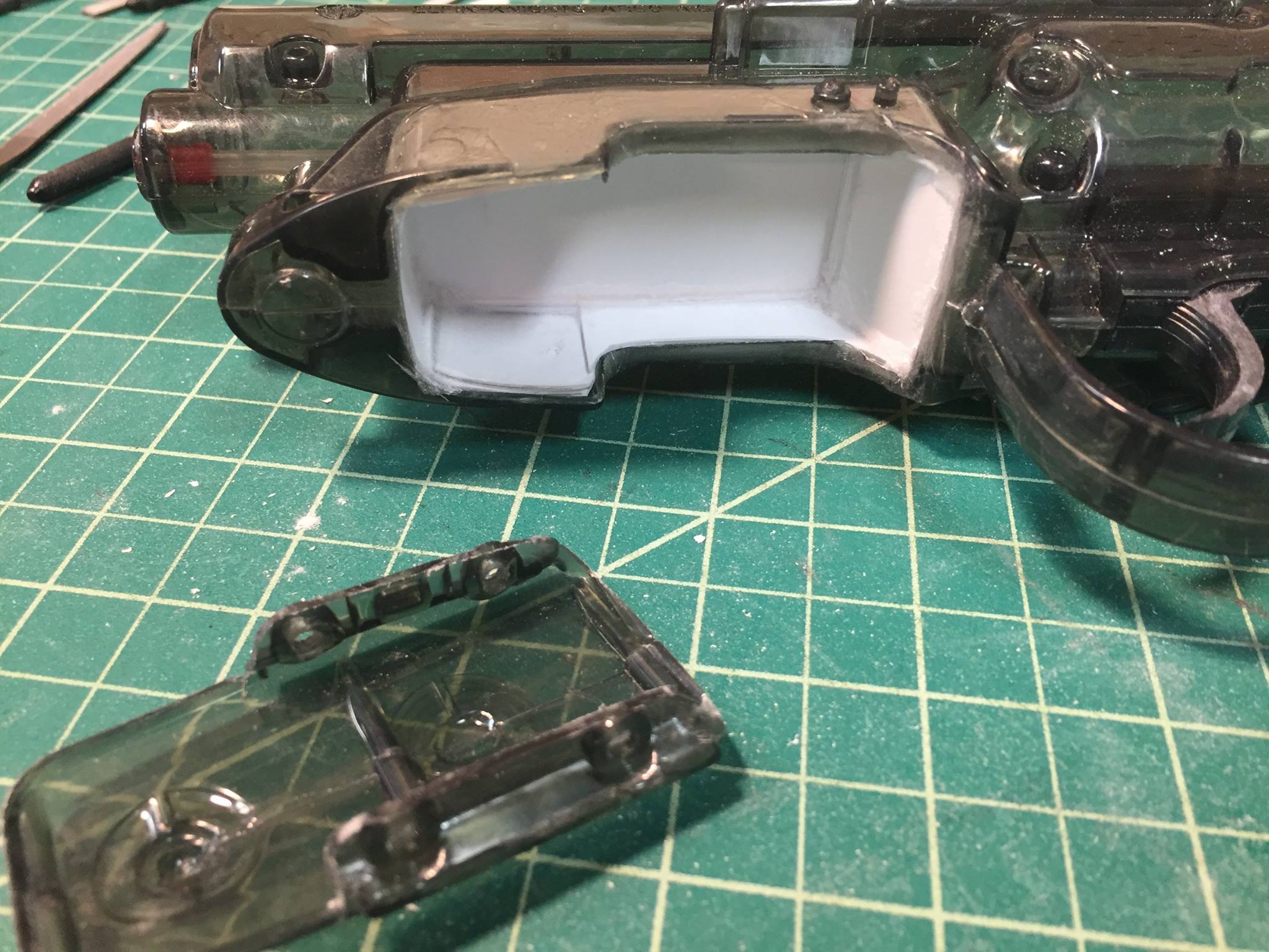

Progress from the last 2 days:
I carefully cut out the magazine (which was really tricky) with Tamiya .01mm craft saws. Mutilated one in the process! Then I built up the walls and created a 'roof' with styrene, effectively making a sealed compartment for the battery/LED housing. Eventually, I'll fill the body of the gun with resin to give it some weight, so now the resin won't come pouring out of that gaping hole!
Great work! Wish I'd done that.
