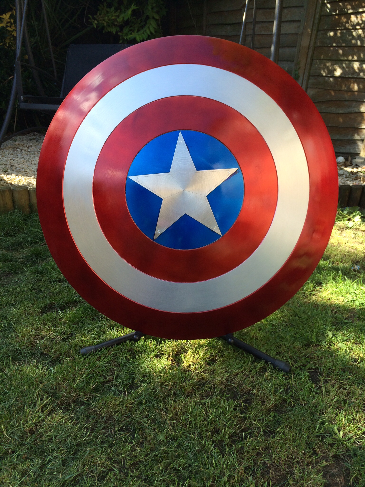

So after several fail attempts this is whwre i am now , overall am quite pleased just a little remedial work on one or two points on the groves , a little dab of accetone to remove a couple of small dots that bleed under the tape and perhaps touch up the edge of the blue with a very fine brush. No clear coat yet obviously but am at work this weekend which is a good thing as it will prevent me from getting impatient and rushing things.
So as this is a UK build i have used the VHT metalized paints , starting with the blue i laid down 3 light coats with a timed 10 mins between each, i then covered the blue and moved on the outer red ring , same process . The following evening i masked up to do the inner red ring but what i did differently was to cover the outer ring with paper so i could lift between coats to check that the paint was matching up , the reason i tried this was with my previous attempts i personally found that i was inadvertanly lifting the can to high when moving from outer to inner ring and consequently would be left with lighter patches or poor finish where the paint would dry before hitting the surface of the shield, is clearly much better this time.
So , it will be clear coated perhaps Monday evening followed by Valors star and brackets/straps later in the week , thanks for looking .

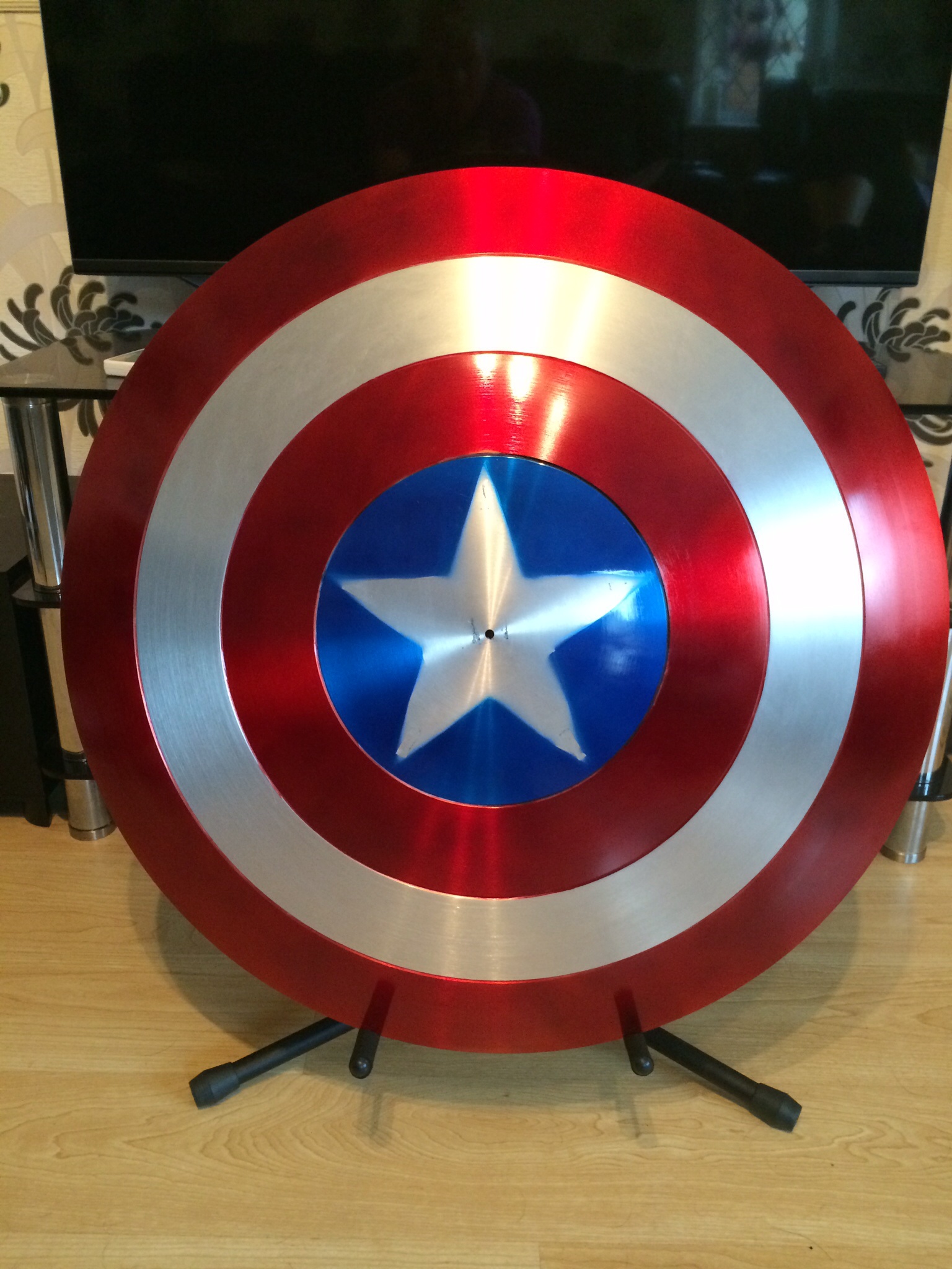

Have just laid down 3 light clear coats and as expected it has dulled the finish a little and if you run the back of your finger over it it has very noticeably roughed up the finish ,will be going shopping shortly for the wet -dry sand paper and turtle wax/polish ,have to let it stand for 7 hours now but hope to have something worth photographing by tomorrow .

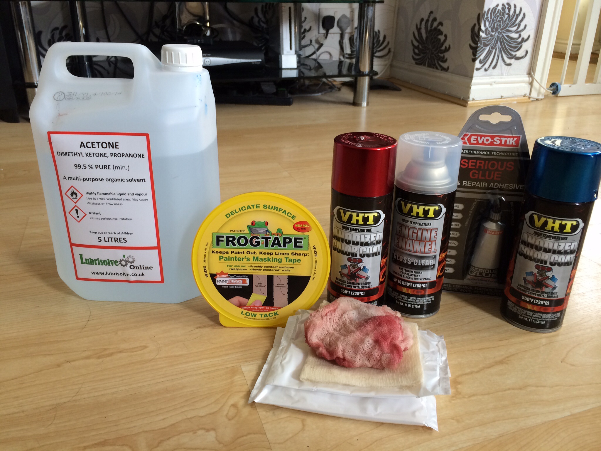

for those of us here in the Uk who maybe about to start on one of these a couple of tips to help
get your self some pure Acetone ( eBay ) don't waste time & effort using the wife's nail polish remover it has a high percentage of acetone but does no where near the same job.
The 3M outdoor tape for attaching the brackets is incredibly hard to find in the Uk , but go go home base , No nails sell the same thing , it's a narrower strip but is rated to hold higher weights , have used this on mine & it seems fine .
The ' data plaque ' you may have seen on the back of some shields ? It's a sort of rubberised plastic ? The Jb weld doesn't hold it to the aluminium , not really an issue as am sure normal super glue or similar will hold it .
hope some of you find this helpful .
Mike

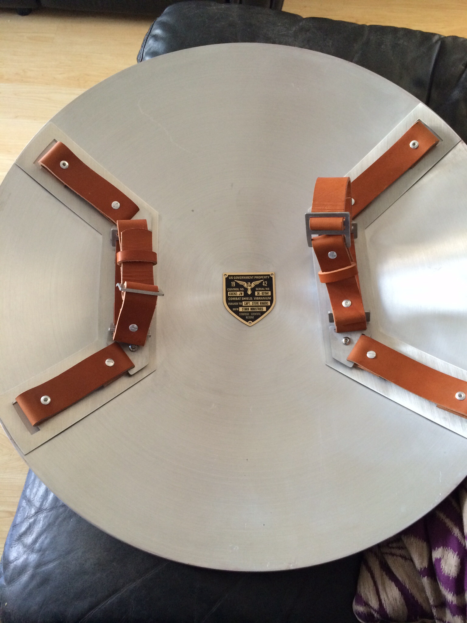

View attachment 365368View attachment 365369View attachment 365370View attachment 365371

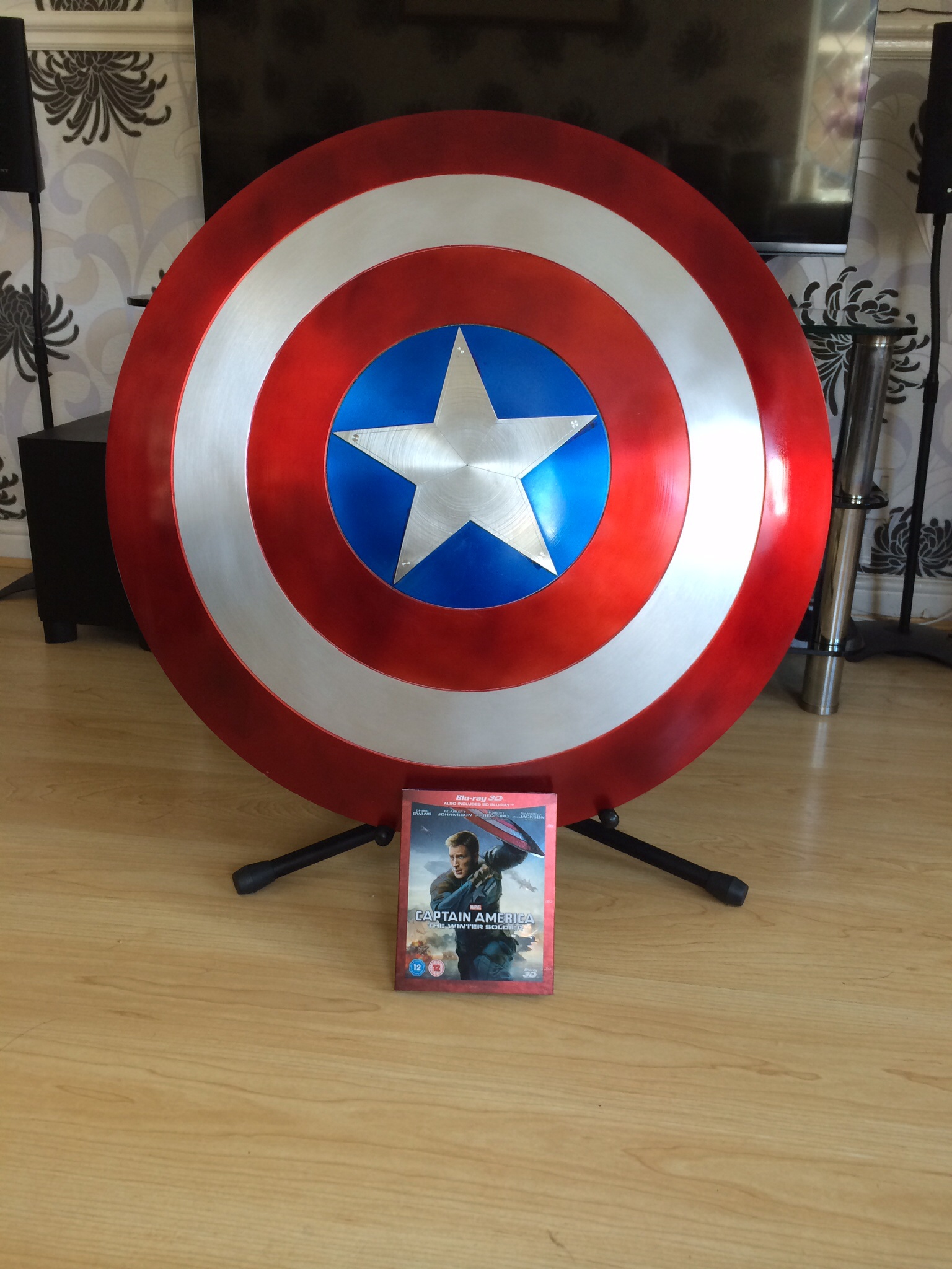

Finally finished ,a little disappointed if im honest as the clear coat/sanding really didn't work our as hoped and. if not for going on holiday Friday I would seriously think about starting over
The vht paint alone leaves a brilliant finish as you can see in my photo from last week,there was no clear coat on that just a rub over with the tack cloth , this step is absolutely essential with this paint the finish it leaves is smooth and polished ! If anybody is starting there shield soon using vht paint I would consider trying it on a piece of scrap metal then wax/polish without a clear coat , this is what I will do if doing this all again.
On the plus side the brackets/handles & star supplied by Valor are top bits of kit and really enhance the prop,as I mentioned previously I used a No Nails version of the 3M tape to attach the brackets and they are very sturdy given the weight of the shield , my star is fixed using the glue you can see in the pic , this is really useful as it will fix to paint, mine is attached quite loosely allowing me to remove it should I start

Ok so hopefully you can see the photos ,
