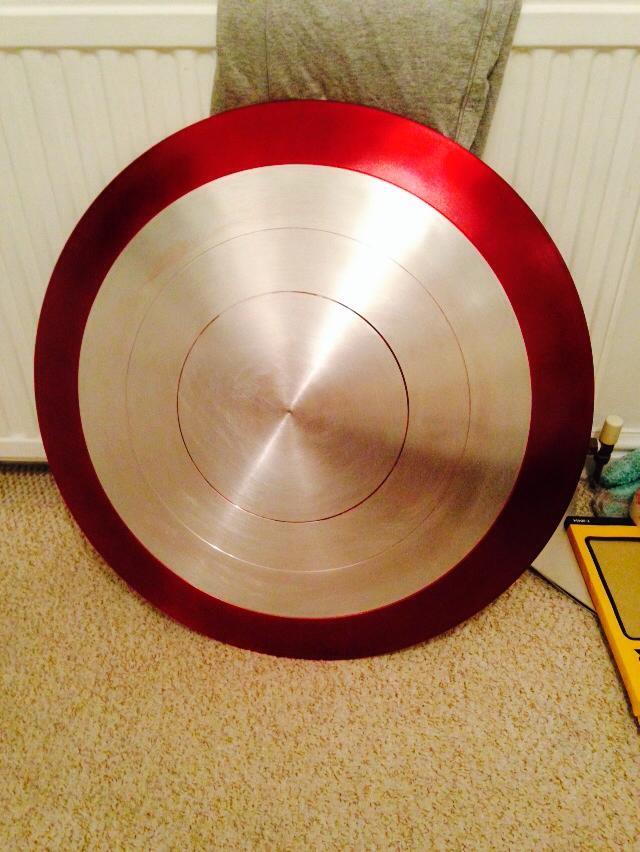

Just got my blanks in the mail the other day. Just wondering where you got the VHT paint from? I'm in the UK too and there's nobody willing to ship the Dupli-colour paints here and I thought VHT is the best shot seeing as it's an off brand of dupli-colour. The red doesn't look that dark to be honest, the paint job came out lovely too :)

I got my paints through ebay nice and easy no problems. I have an uncle who owns a garage and sprays cars so I'm going to get him to hit the shield with a clear lacquer I think although right now I'm in two minds whether to strip the centre red circle and the blue, few bits I'm not happy with it, this could easily drive you nuts!
Yeah, so I bit the bullet and striped both center circles. I wasn't happy with the red coming away on the edges, I tried to touch it up but the result was less than satisfactory. I'm going to use those thin dental brushes you use to clean in between you teeth to get into the groves and take the paint away then the shield will be ready for the new paint job.

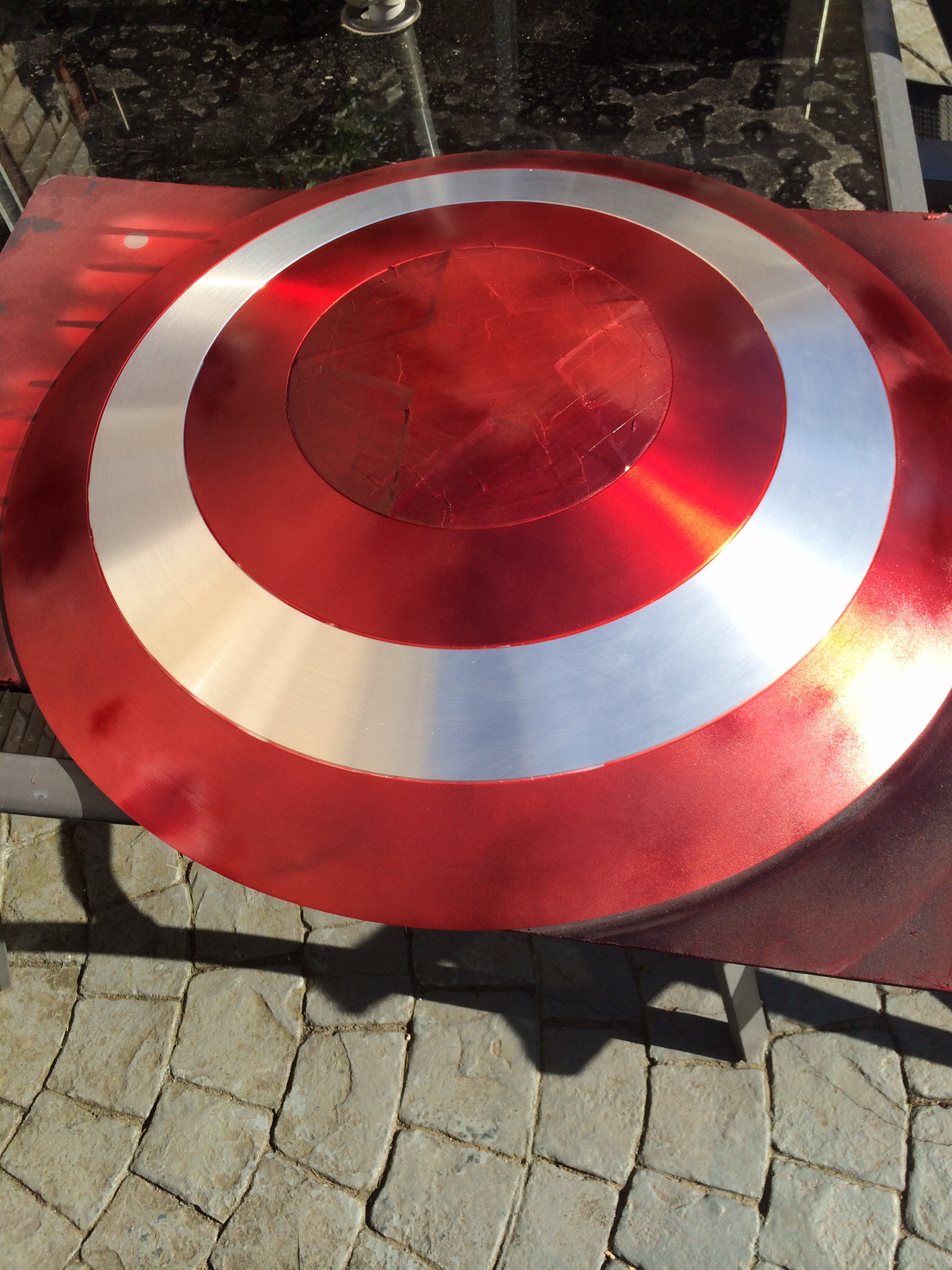

So last weekend I found time to hit the red rings with a couple of coats , painting a dome is tougher than you think , maintaining an equal distance is the prob if your not really on the ball , consequently I had a couple of patches that were darker than the rest , if I'm totally honest I was not massively disappointed for a first effort given the amount of 2nd & 3rd attempts we read about here .

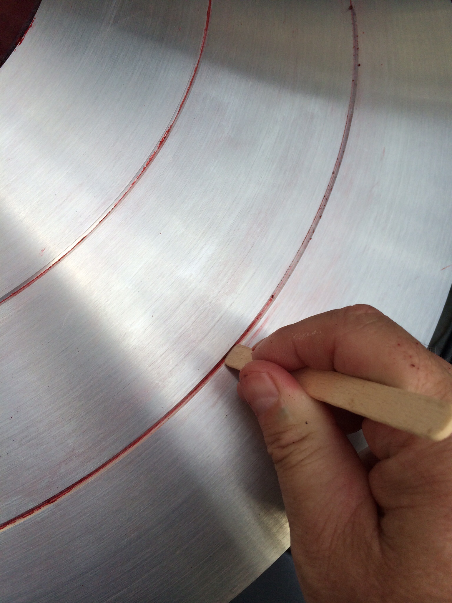

So during this week I've stripped it back to bare metal , I used Pollycell advanced paint stripper active gel , I would highly recommend this as it seems to work quickly on the anodised paint & for cleaning the groves lolly stick sanded in to a wedge shape works really well , one benefit of having kids :)

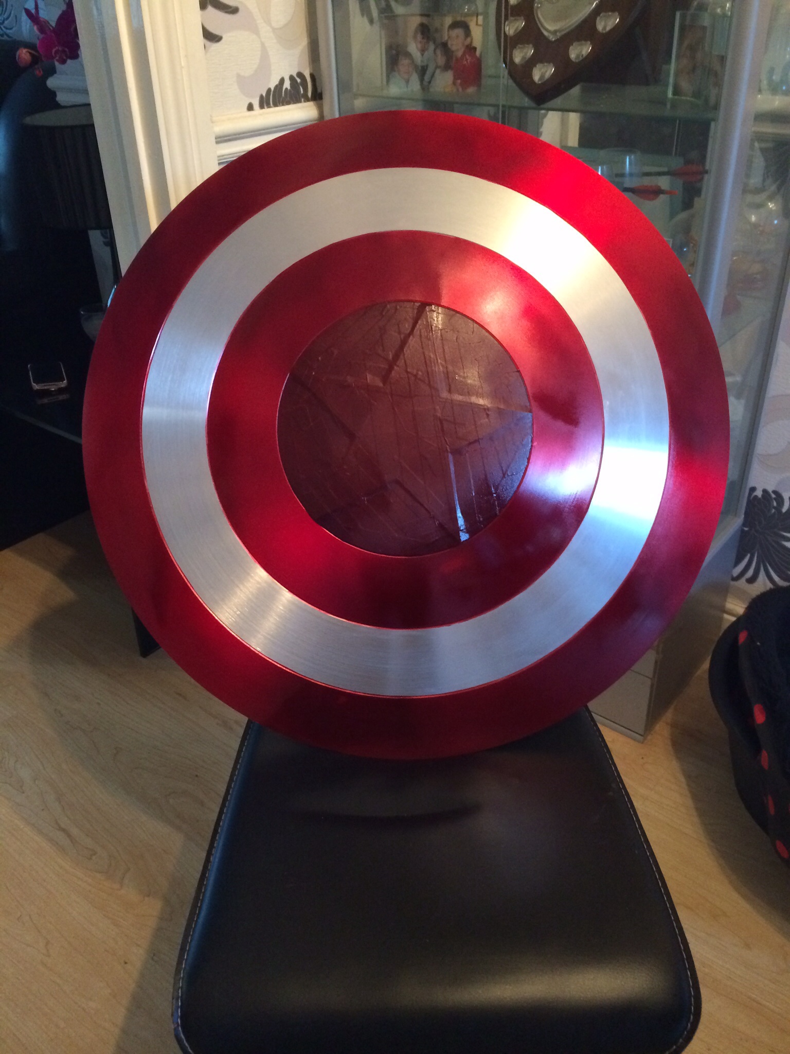

Nice. I should be getting my blank tomorrow, thinking of going for a semi-gloss clear coat myself. How are the VHT paints on your blank? Any pictures to share? :)
Here you go they are not the best photos as taken on my iphone ,next attempt I will try painting having the shield vertical as I found that while it was lying flat you tend to over stretch as well which isn't the best way to get an even coat either, hope these are of some use to you .
