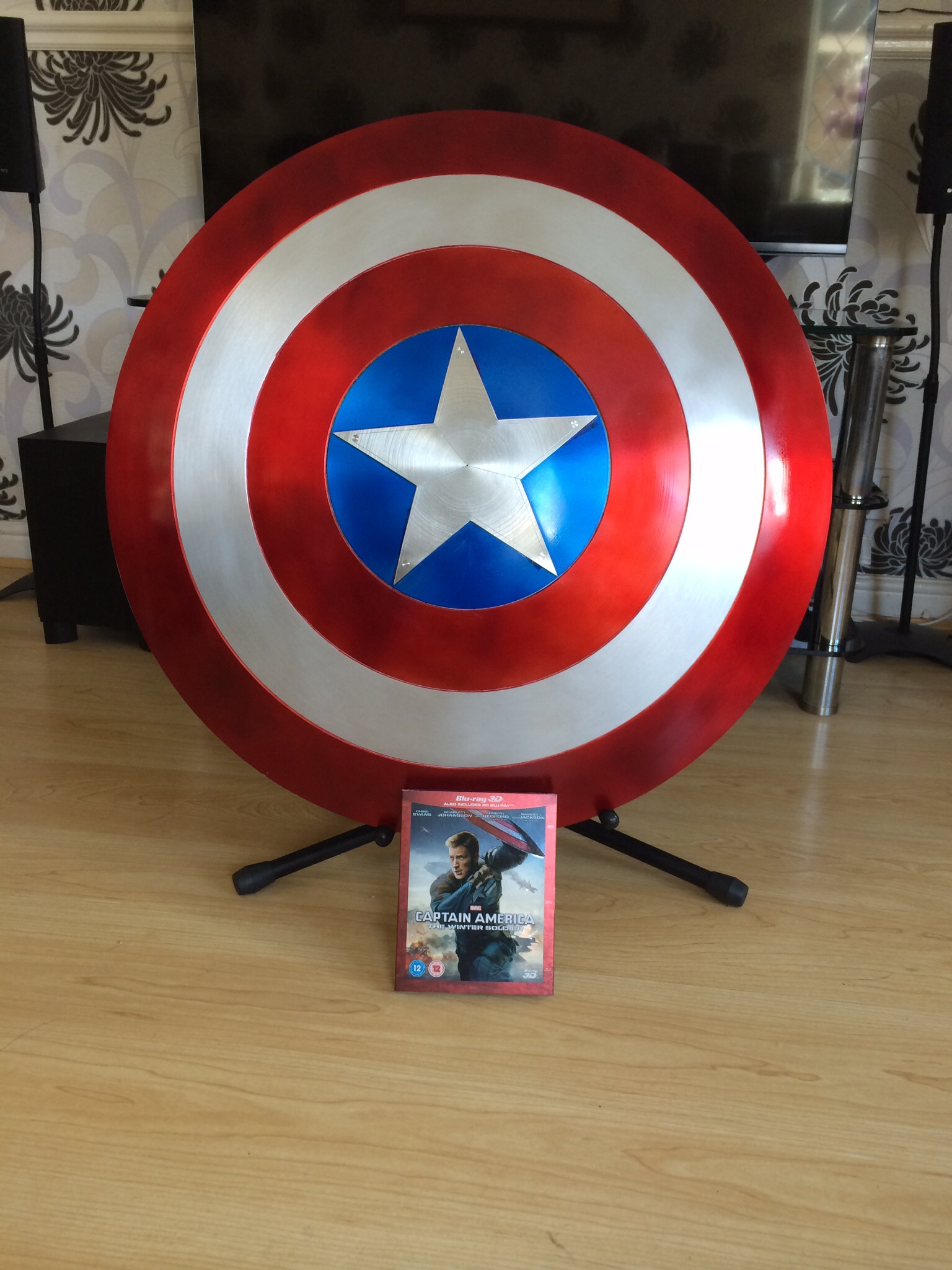

I think it looks boss mate.
Is that just a guitar stand you're using?
Thanks mate , yes it is a guitar stand , bought from Amazon can't remember exact cost but wasn't expensive , I did need to shorten it slightly so the shield sat leaned back a touch , more stable that way .

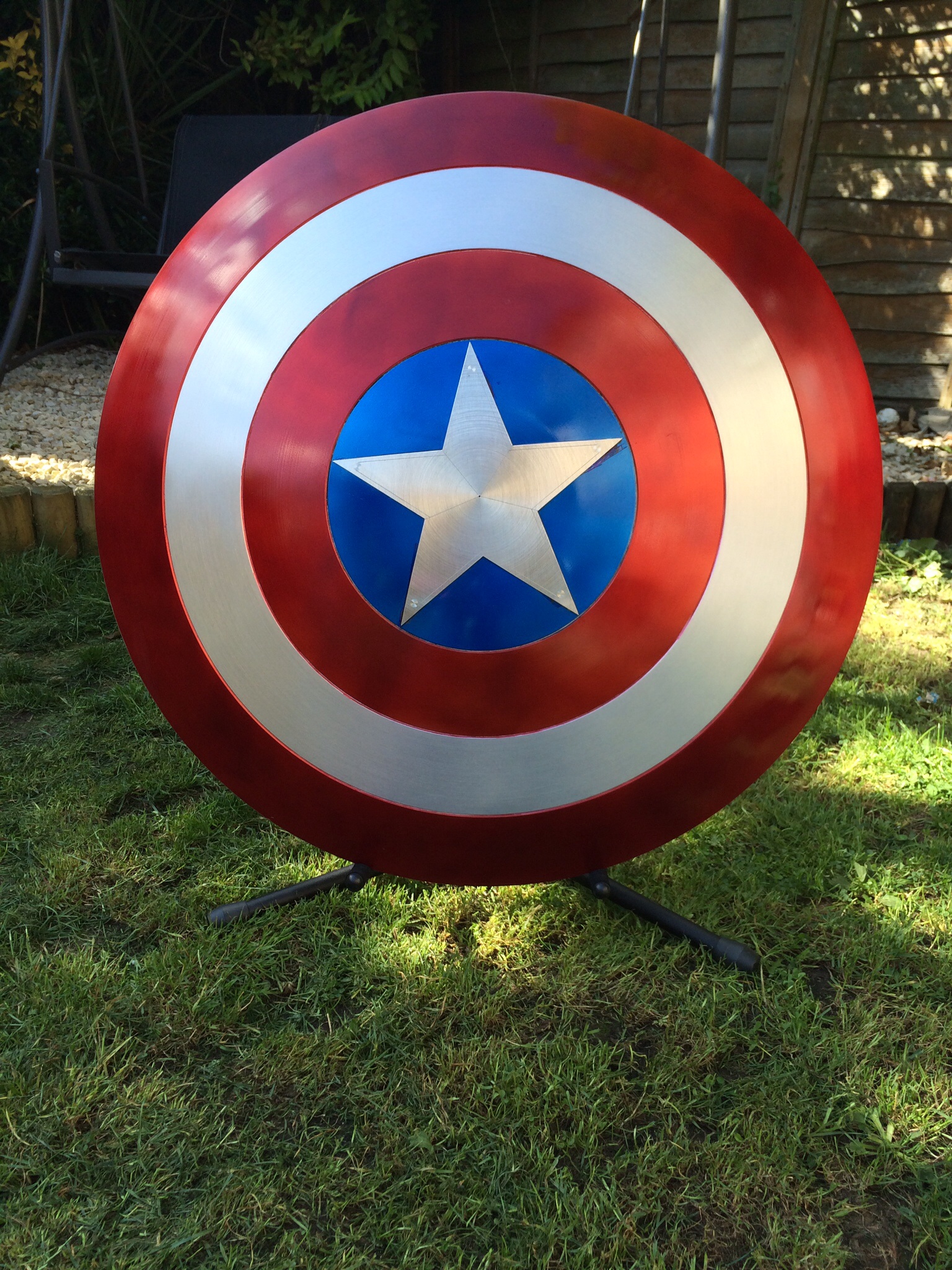

Ok so hopefully you can see the photos ,
In addition to my previous post i would like to add that if you are about to start on one of these shields - dont be afraid of making mistakes , the biggest problem is getting this prop to a standard we are happy with & trust me its not easy :) but at least you can start over if need be , as i said im not happy with aspects of mine (groves & blue circle )and will quite lilely start again after my holiday .
Read through the threads and cherry pick the best ideas/methods /materials that will work for you , it cost nothing to learn from other peoples experience .
good luck & happy painting .

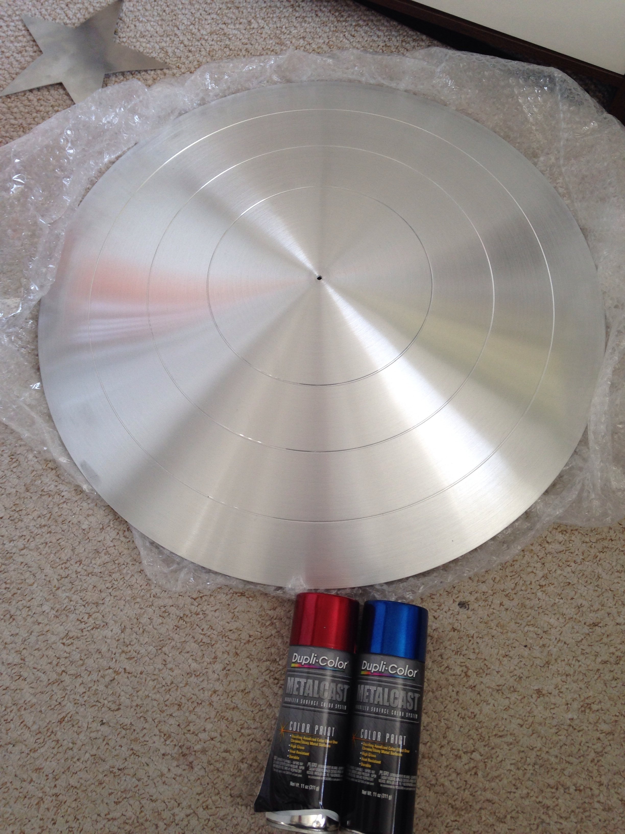

Ready to start shield number 2 this time for my own collection so picked it up from Arnie and I have to say it's better than the original with the back now spun smooth, and for free too so no complaints at all.
To top it off I finally managed to get some Duplicolor Metalcast here in the UK which arrived this morning, time to get taping up again!

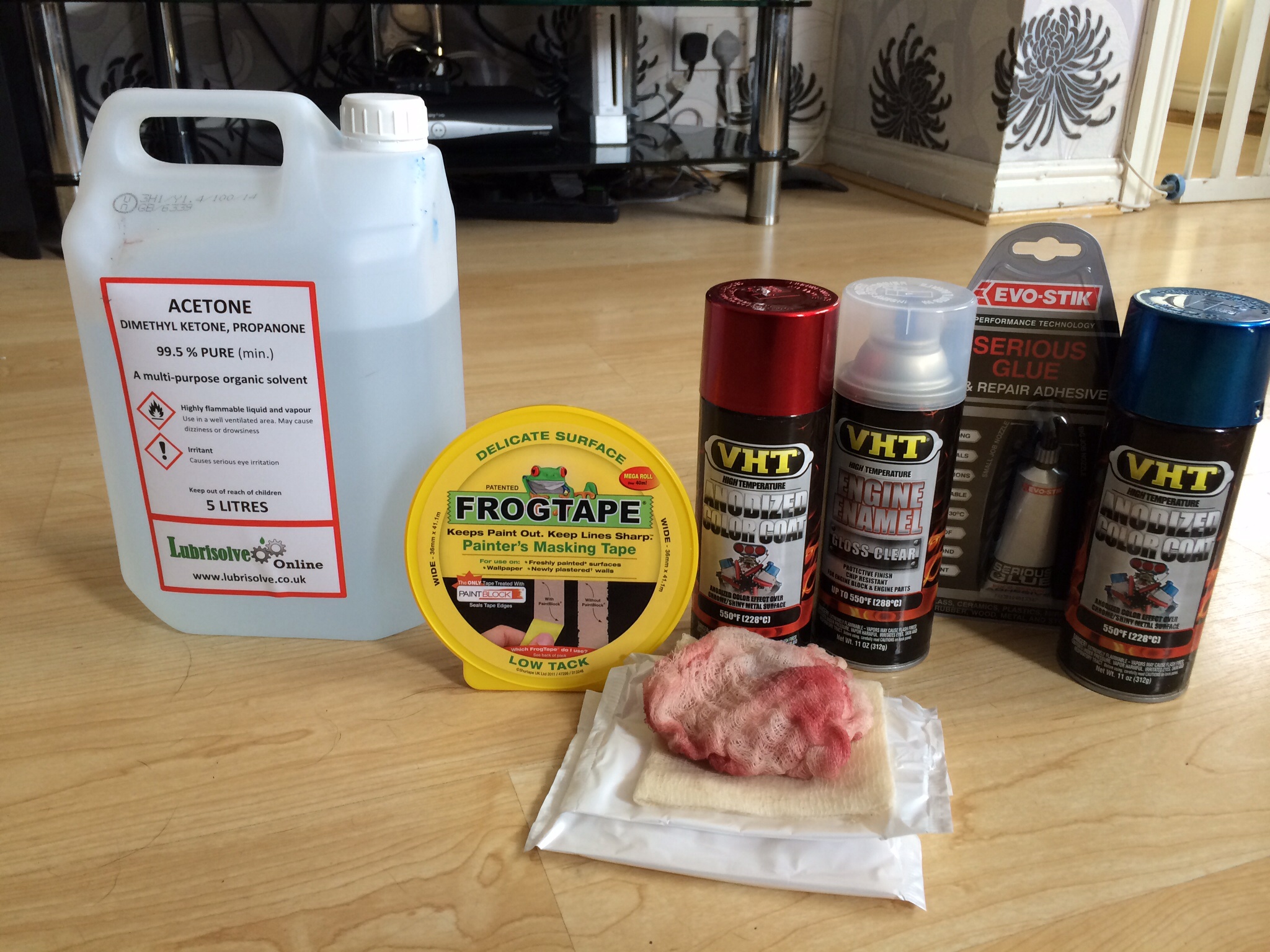

Hello mate & apologies for the late reply, just arrived home from holiday a couple of hours ago .
Am not certain how satin would look as it's not something I've tried & can't recall if anybody else has either , watched Winter soldier on the plane home & the Wife helpfully point out that ' his shield isn't as shiny as yours ' lol . It may be worth trying on a small piece of ally if you have any , my step ladders in my garage have various patches of red & blue on them now .
The glue I used is Evo stick ' serious glue' have used this on all sorts of things over the years and highly recommend it , I tried this as the Jb weld has to be mixed as it comes in two sticks the problem is getting the right amount on to the point of the star , some of mine pushed out and marked the blue paint with a grey residue hence why I will probably redo it at least with the glue I used it's more controllable with a nozzle and will stick to paint which negates the need to mask of a star shape on your blue circle .
hope this helps & if you need any more info please don't hesitate to ask .
