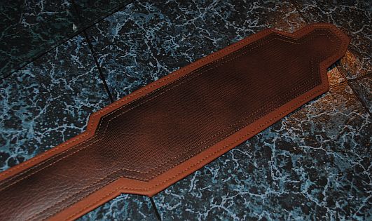

The last of the accessories to tackle was the belt and pouches. Like the gauntlets, I decided to adapt the template from The Foam Cave for these pieces.
The belt itself was made using the same process as the harness. The buckle and front greeblies (not pictured here) were all from Bronze Armory. Since the buckle is not functional, the belt is solid in the front and I decided to utilize nickel snaps in the back to fasten the belt and also allow for some adjustability.

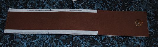

After some messing around with the best way to approach them and a couple of write-off test runs, I finally decided to not overthink them and do them as a foam and faux leather hybrid using the templates. I created the main parts of the pouch with the faux leather and 'texture' painted faux and lining with the same material (adding in the male side of the magnetic clasp at this point. These pieces are all stitched down and finished.
I then cut the sides from 6mm craft foam, faced the foam with the faux leather and glued them into the main piece. Note the area in the picture above where the fabric side of the faux leather is exposed (the lining is trimmed away). This is where the foam is glued down. Hot glue will form a nearly permanent bond to the fabric side of the faux, but will not adhere well at all to the finished side.
