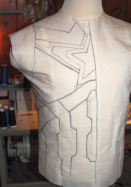

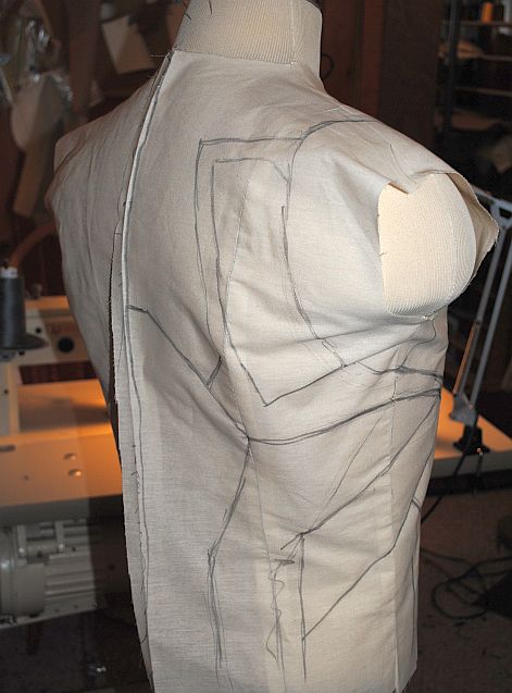

The last Captain America project I drafted, I used a quick-and-easy body mold technique to make a very form-fitted pattern. For this one, I'm taking a more traditional approach and using a basic pattern, called a sloper, to define the shape and then I'll create the specific pattern for the costume from that. I began by creating the basic body of the suit. This will form the chest and torso for the suit. Here are pictures of the assembled sloper on my form and one side marked up for the torso. The other side will be used to create the under shirt that will contain the sleeves and collar (more on the reasons for this design aspect later).

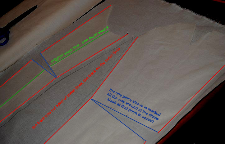

While some people find these sleeves a bit daunting (especially if they have to draft one), there's a quite simple process for turning a one-piece sleeve into a two-piece. I didn't take any pictures until I'd slashed the sleeve apart, but I did try to diagram this picture to explain it (hopefully) clearly.
Here's how it breaks down: Once the one-piece sleeve is sewn (the seam more often than not right at the underarm), the sleeve is cut into two pieces. The first cut is down the back at pretty much the exact back (line the seam up with the center of the piece and press - cut down that line). The second cut is on the front of the sleeve roughly 1/3 of the way from the seam to the center. The red lines above show these cut lines. The new under sleeve piece will be narrower than the new upper sleeve piece. Then, the two pieces are slashed at the elbow point (pre-mark this on your one-piece sleeve before cutting it apart) and spread about 1" - 1.5" at the back edge. Draw out the new pieces (don't forget seam allowance) and you've got a two-piece sleeve pattern!
Once sewn together and added to the sloper, you should have a nice, smooth sleeve that hangs perfectly with the body. If the sleeve pulls at all, it's set too far forward or back. Take it out and rotate it in the armscye until it hangs correctly and mark that position for cutting the finished project.
