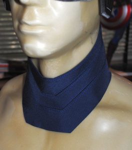

Short update this time. I'm tinkering with a kind of segmented collar piece to bridge the suit and the helmet. Using the pep files for the Iron Man neck, I cut out several of the sections and tested them in 2mm foam.
All four segments were too tall to wear well, so I left off the top.
I spray mounted the remaining foam pieces to the blue cordura and cut the pieces with a 1/2" seam allowance. Using a zipper foot, I stitched each segment together matching the edges of the foam backings. The seam allowances were then folded over to each side and stitched down.
The collar still needs a closure in the back and I'm not sure it's going to make the final cut, but I'll see what it looks like when all the other pieces are assembled.

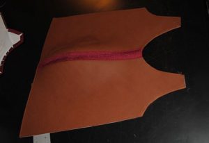

I then turned to the backs. These will work in a similar fashion to the inner parts of the gauntlets - they will form the calf and have elastic in the front. The shin guard will then strap over them to make a complete boot shaft. The backs are made of brown faux leather lined in black for stiffness and accented with a red cordura stripe over the center back seam.

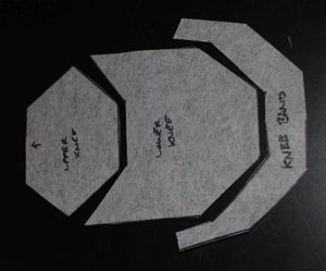

The last major component of the boots to attend to was the knees. I created a template for the knees and constructed them using the same methods as the rest of the boots. The main knee pads were made of foam covered with red cordura. I then added a shaped brown section (also backed with foam) to the bottom of the knees.
The knees were then stitched to the shin guards as well as the straps and buckles (just as they were on the gauntlets). Here are the boots at this point.

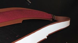

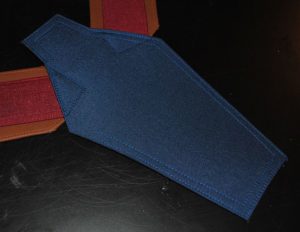

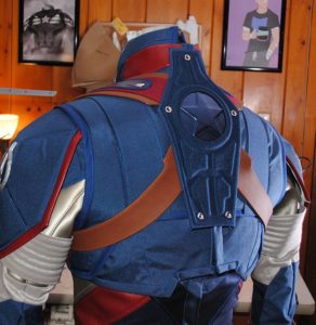

I used my templates for the AoU straps and created the base straps using 2mm EVA foam and covering it with faux leather. I then added a red cordura (also backed with 2mm foam) detail to the upper strap. The two connect under the arms with the same silver side-release buckles that were used on the gauntlets and boots.
I decided to use a back piece that had already been playing around with as the base for the 'back pack' that the straps would attach to. This piece was simply a piece of 2mm foam covered with cordura. The straps were fitted and then sewn down.

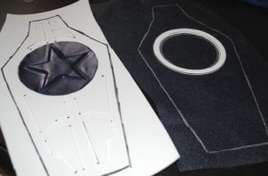

The next step was to create the detail piece that would go over this base. To do this, I traced out the shape and created a template on tracking paper with all the details that I wanted. I used a piece of 2mm foam as the foundation. The first piece to go on was the star.
Cutting the center circle from the metallic blue vinyl, I tacked a 2mm cut out of the star to the center and then mounted them to the foundation. The star detail was stitched in using a teflon zipper foot. I then tacked down all of the other details and made the cover out of cordura with the circle that surrounds the star.
The inside edge of the circle was finished and the cover was mounted to the foundation. All of the detail lines were then sewn down with a zipper foot and the edges turned under and sewn down.

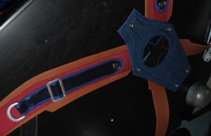

I then added some grommet details and glued the piece to the back of the harness as well as adding some blue details and hardware to the upper straps.

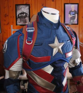

Here's the completed harness on the costume.

Amazing work. I love all the little details you've done, and the harness came out perfect! And looks awesome for your design. Loving the helmet as well, I saw Jordan's post that he was working on this for you and couldn't wait to see it with your suit.
Thanks! I really went round and round on what I wanted to do with that harness. I didn't want to just do a big buckle as I was really trying for a more original design. At the same time, I couldn't reconcile a "back pack" either. So, I just decided to use a piece I'd made earlier and thought I'd discard and just build it up similar to and to match the chest. Basically, I just had to stop over-thinking it. Haha
Jordan's helmet is almost as awesome a Jordan himself. :) I love it! We have a new project coming out soon as well - so updates on that are nigh.
