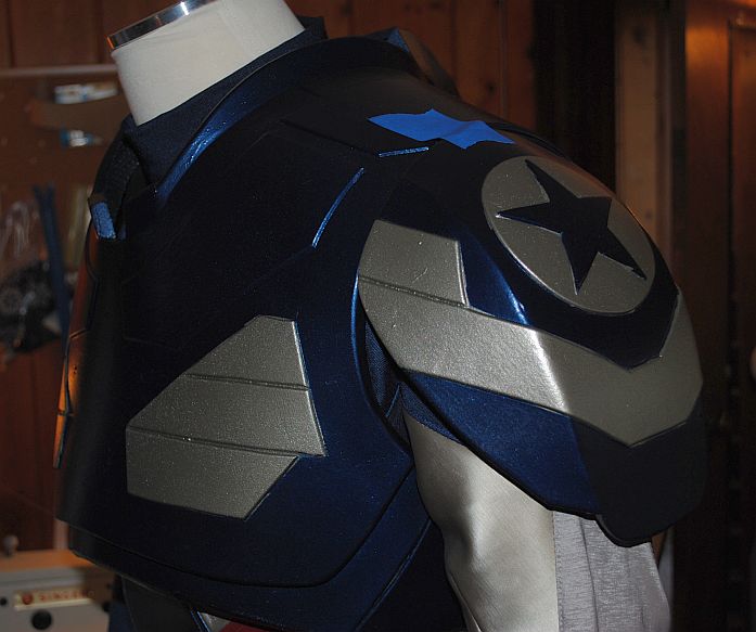

All of the upper body armor pieces are complete! Now it's time to start working on paint. With all of the pieces coated, I began by priming and using the silver accent color for the base coat. The blue I'm using is DupliColor Patriot Blue and is very dark. I wanted to give it a bright base coat.
After a solid silver cover, the pieces were masked off and the blue was sprayed on. Here are pictures of the chest and one shoulder on the form (all I could get out of that one can of blue paint).

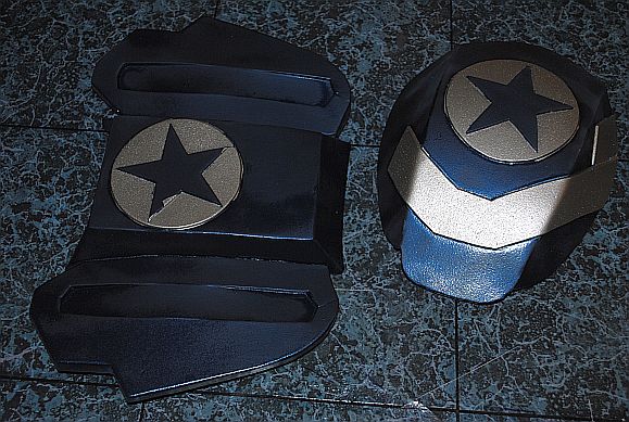

I ordered and received another can of blue for the other shoulder and the backpack. However, in a strange turn of events, the paint did not dry with an even finish. Even though all of the pieces were treated, primed and undercoat with the same products and at the same time, these last two pieces dried with flat patches and don't have the smooth metallic finish of the others.
So, next, I've got to try to figure out how to fix this issue and possibly just repaint all of the pieces at once to get a consistent finish.More to come - stay tuned...
What did you end up doing? I'm also having some issues with metal shine on PD parts...
