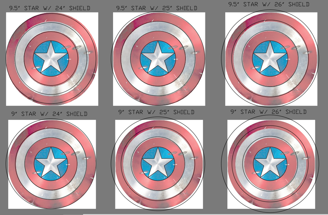

And the 9" star is scaled for a 24" diameter shield.
I disagree there. 24’’ is ONE of the sizes they used- mainly for the molded shield. Some were 26’ etc
I think the 9’’ star is for a 25’ shield- exactly like this one pictured which is the actual TFA prop.
I have it in my head that the star on this version is 9 or 9.25’’. But I don’t remember where I got that from anymore.
I think relic maker doing a 25’ is a great compromise and separates this shield from every other 24’ version out there.

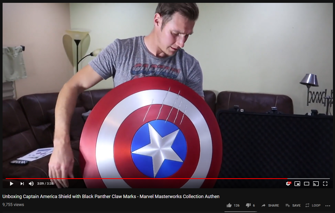

Screenshots from one of the videos on youtube.
I have a Chris Fields shield that's a little over 25" and always felt it was a tad big. Based on how this looks in the videos, the 24" size is my vote.

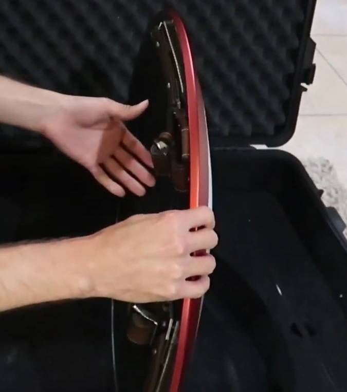

Also note the seamless thickness of the edge. This is another critical detail that I'd like to see hammered out.

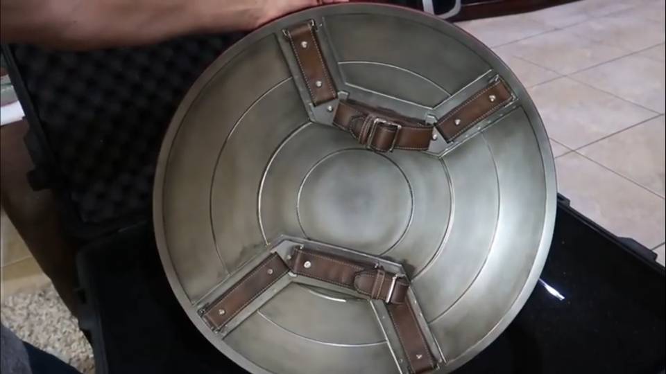

Regarding the backside, the grooves are also specific; the 2nd circle from the center has a wider gap. Also note the rivet indentations running along the brackets. View attachment 1033703View attachment 1033704
Yes to that. Basically the goal should be to get something as close to the Masterworks shield but entirely machined.
Size, paintjob and all minus the scratches.

The problem with the listed measurements from the Disney store or the auction is that they don't state whether they were measured across the back or along the arc on the front of the shield. I was messing around with this in CAD today and here is what I am seeing. I tried to line up the star as best that I could. There is apparently some distortion in this image of the original TFA prop. If anyone has a better picture let me know.
1034045

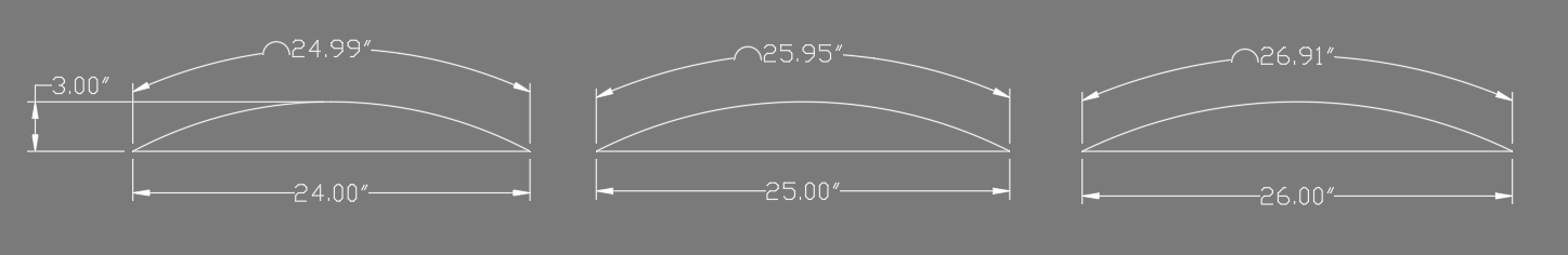

For reference of arc length (front of the shield) vs chord length (back of the shield). This could be causing a discrepancy in size depending on where the measurement was taken.
1034048

the Pawn When you get reference measurements of the Masterworks shield if you could get some pics of it being held in-hand that would be good to add to our knowledge base here!
Edit: Just to add, based on this dude's other youtube videos he doesn't look like a short dude, and the shield looks like a good size in proportion to his torso/height:
