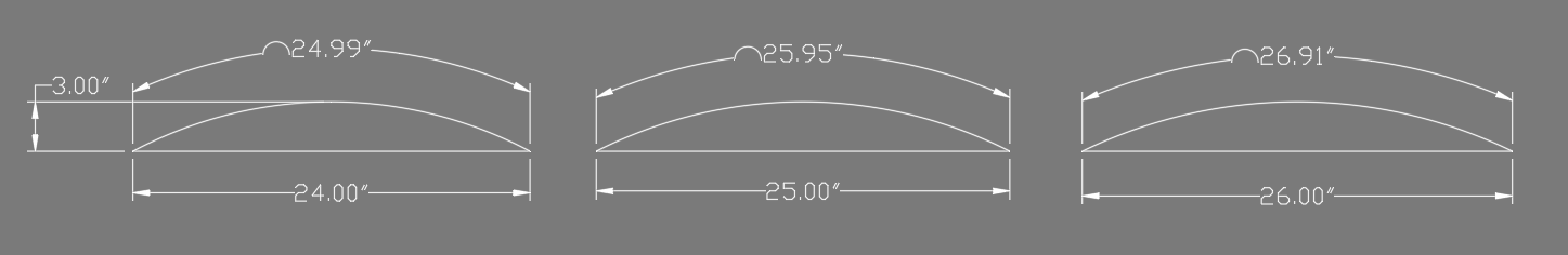

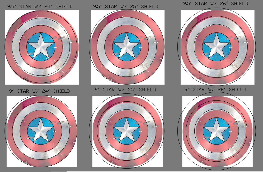

The problem with the listed measurements from the Disney store or the auction is that they don't state whether they were measured across the back or along the arc on the front of the shield. I was messing around with this in CAD today and here is what I am seeing. I tried to line up the star as best that I could. There is apparently some distortion in this image of the original TFA prop. If anyone has a better picture let me know.
For reference of arc length (front of the shield) vs chord length (back of the shield). This could be causing a discrepancy in size depending on where the measurement was taken.
Like I mentioned before, we can't go off photos of the shield, since the star is closer in photo-perspective than the back diameter. Think of it as a 'bug-eye' lens photo shot, where the perspective is distorted, and the center is brought closer. There is about a 3/4" difference in the size of the star compared to the outer diameter of the shield when looking at photos.
