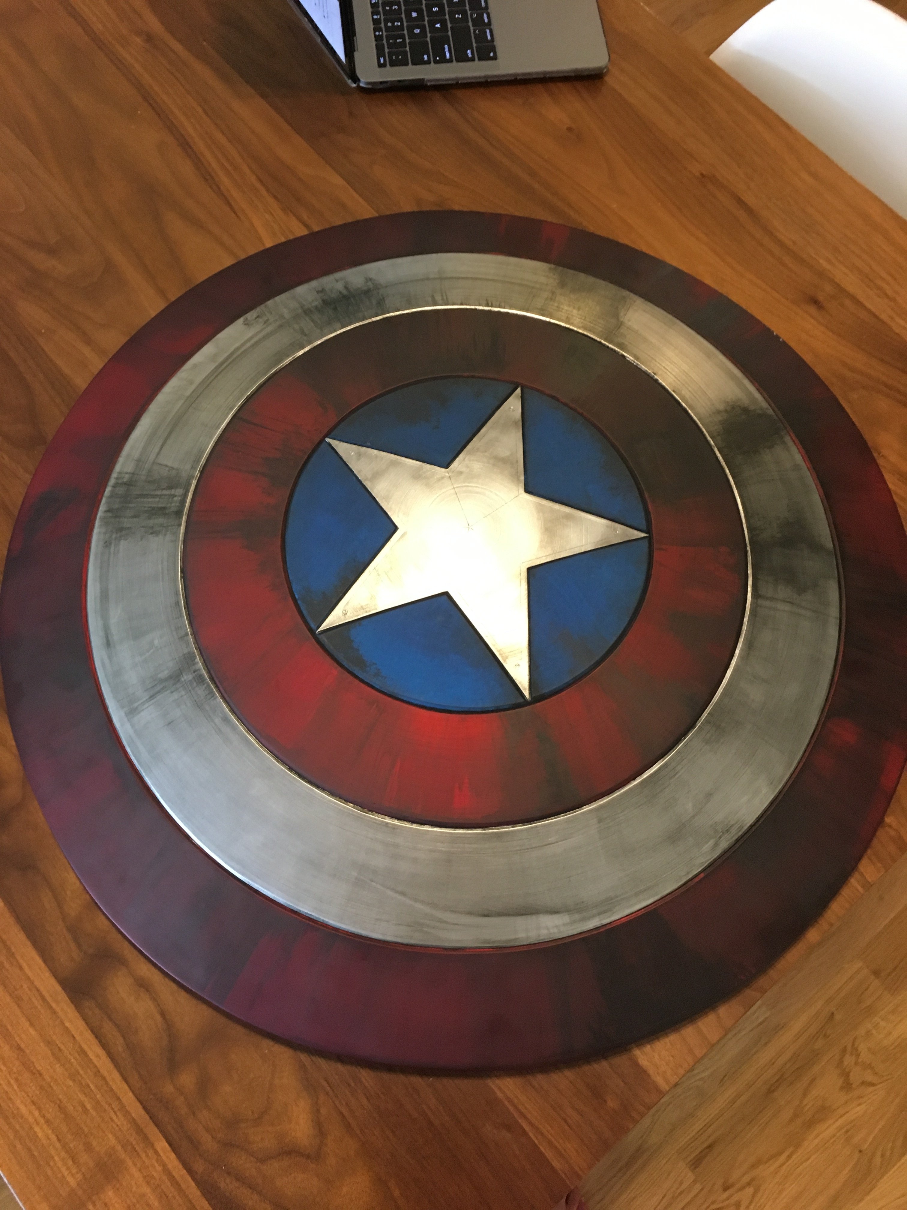

A year ago, I commissioned GeneralFROSTY to re-paint my EFX shield for TWS Highway Battle paint job.
Pictures don't really do justice, the paint looks super realistic in person and looks exactly like on screen.

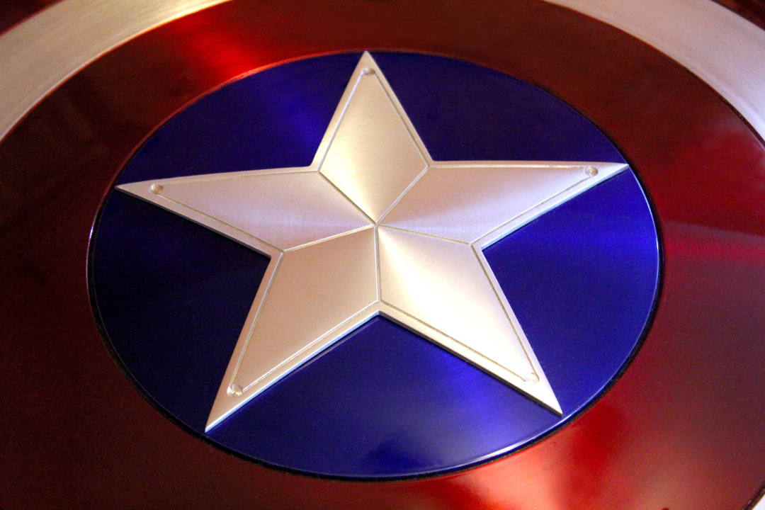

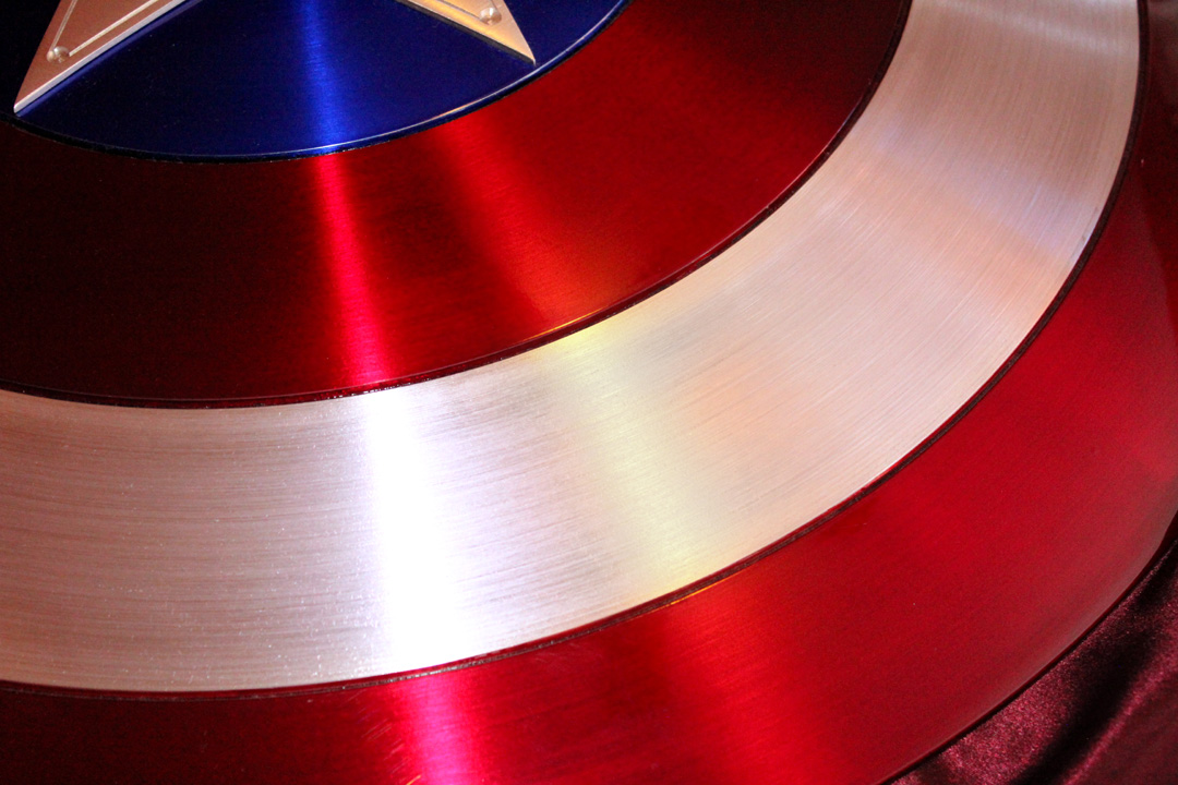

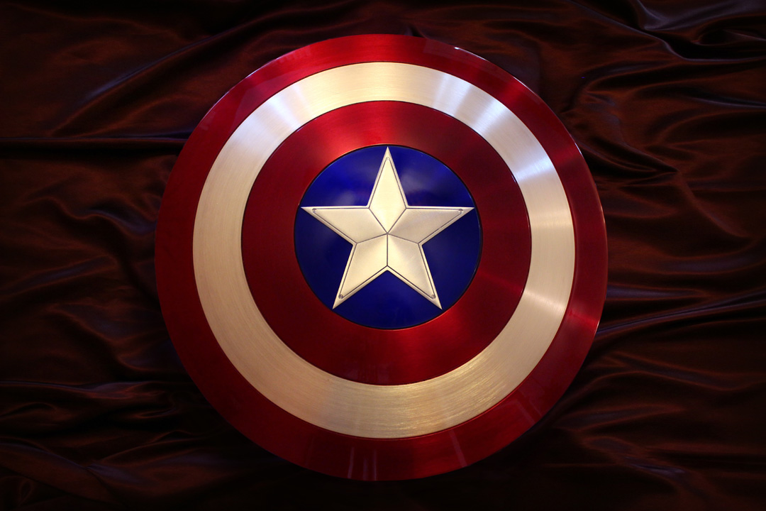

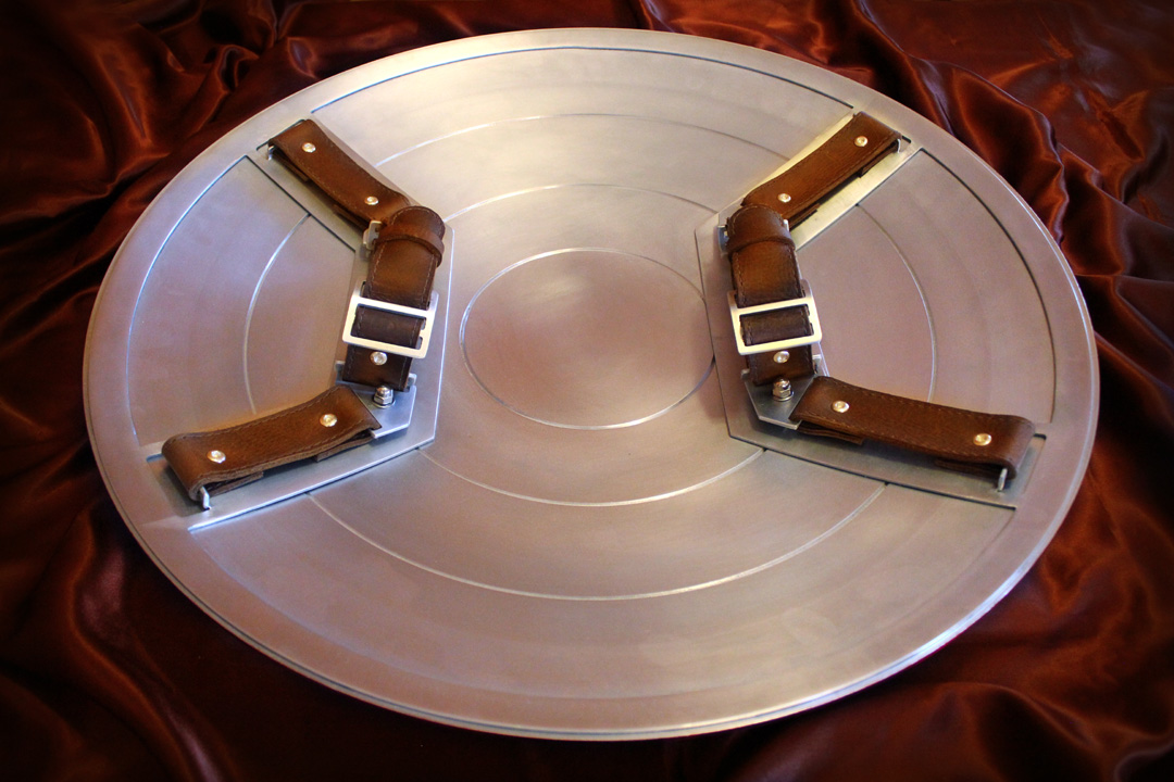

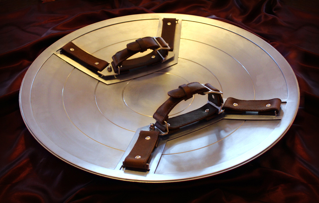

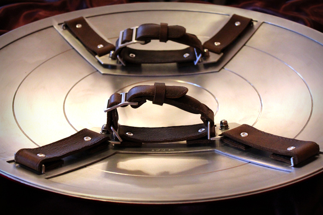

If you guys are cool with a shield like this, but with the star CNC'd into the shield, then it's definitely doable!

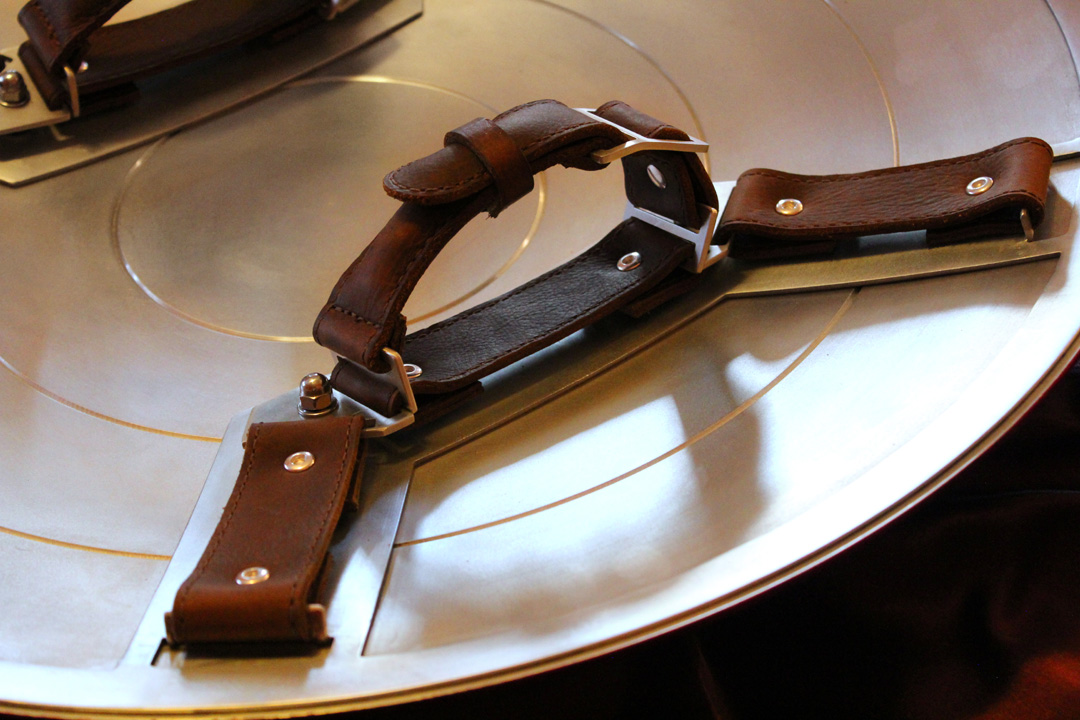

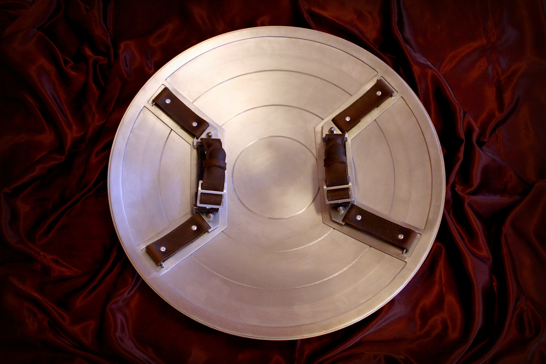

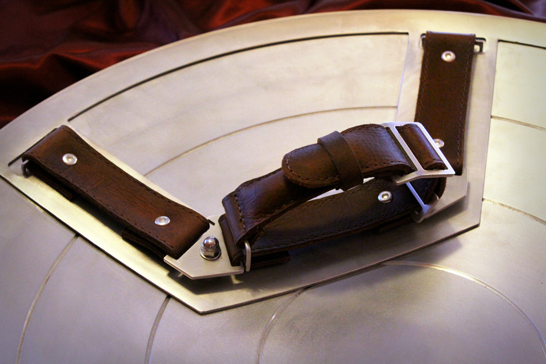

This shield is SOLID METAL all the way through, and 25" wide by 3" high!!!
It is a 1/4" Aluminum Shield, with an 1/8" Bracket attached to the back, making it 3/8" at the edge.
"House of Color" Tinted Clear Coat paint in Candy Apple Red and Cobalt Blue, showing the brushed Aluminum through the paint.
Leather Handles are made from high-quality "Tandy Leather" Kodiak Oil-Tanned Leather, and stitched together by a professional Saddle & Boot maker here in Fort Worth, Texas.
The handles are also padded at the grip, like they should be! ;)(y)

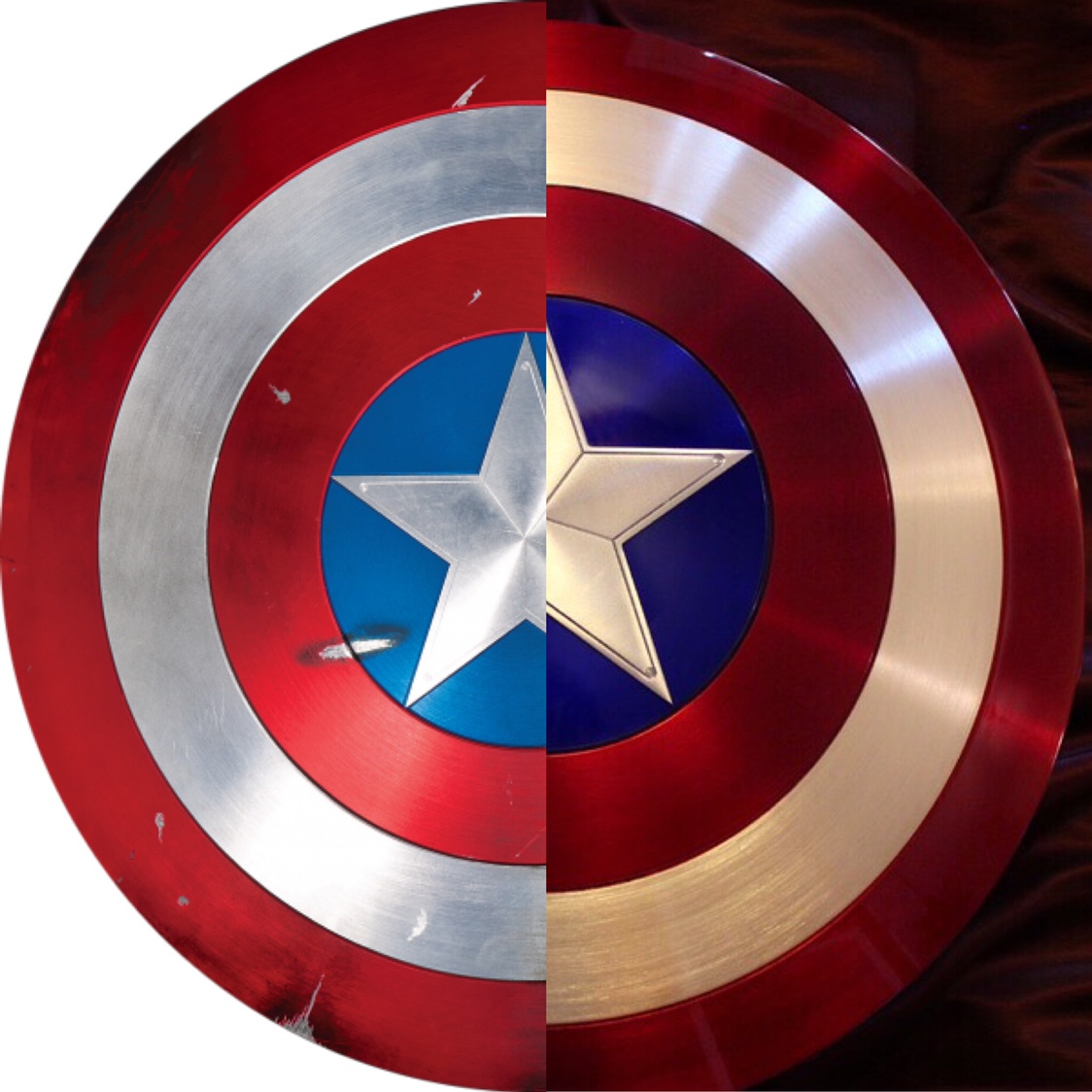

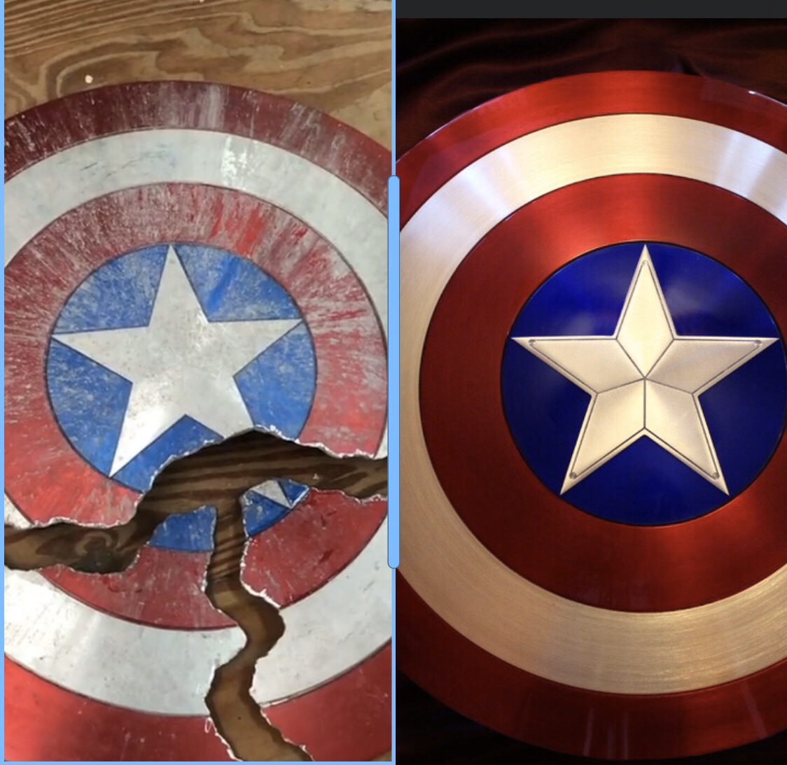

I think the Centre circle is maybe half an inch too big
My shield isn't perfectly centered in the photo. So, it will be hard to get exact measurements from it...
When I measured the original prop before in Photoshop, the center circle came out to be about 9.5" for a 25" shield.
I'll definitely get with all of you and come to a consensus of what the exact measurements are before when and if they go into production.
To my eye you can see it pretty clearly - these angels are similar- the star circle is smaller proportionally on the prop than your last shield
