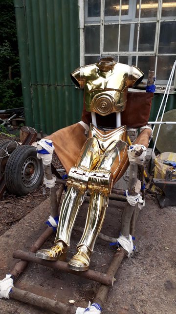

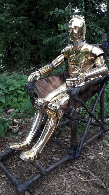

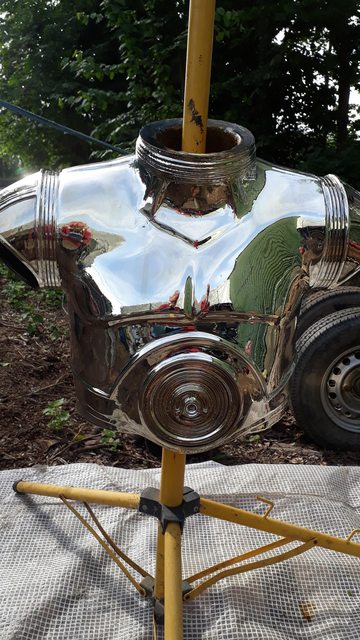

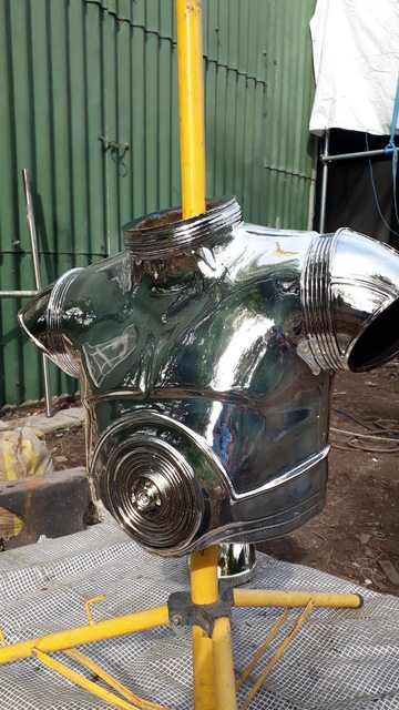

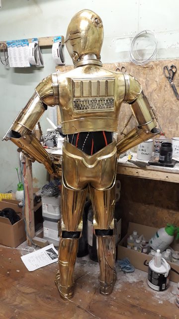

Quite magical this chroming process when it works!

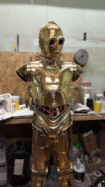

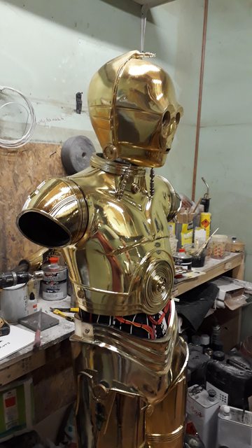

Got the parts all tinted and topcoated so on with the assembly

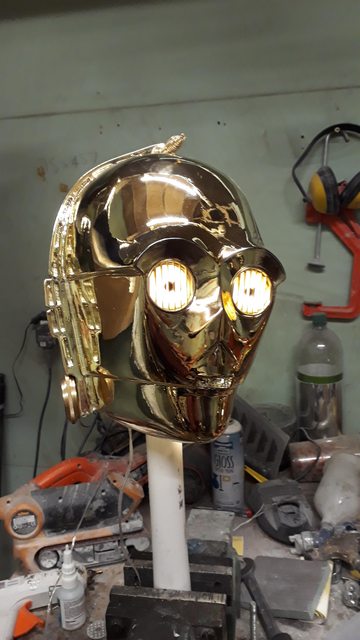

Finished the lights and greeblies on the head
That looks awesome, but what do you mean "when it works"?
I'm currently printing him and I plan on using this method of chroming.
Well it doesn't always go according to plan. U have to get the right chemicals...some suppliers stuff is just unreliable and fiddly to use. The set up needs to be just right...warm chemicals, warm work space, clean labelled; guns, pots, mixers etc etc. Dust free environment. The base coat and top coat are usually different and very specific as to the effect each of them provide. Everything needs to be hung and dried. All very do-able but u just need to have it streamlined and familiar to get perfect results

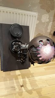

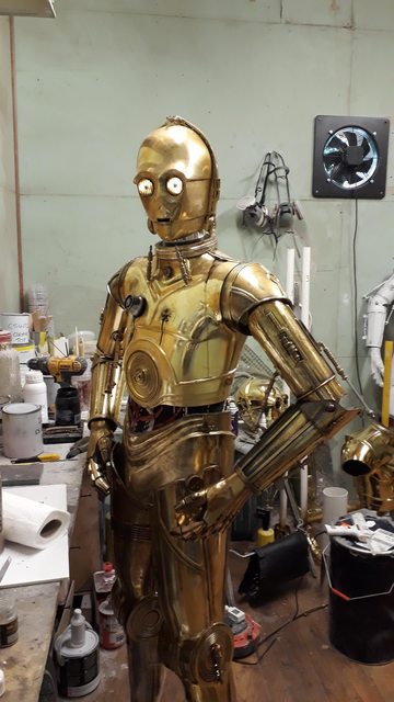

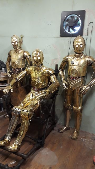

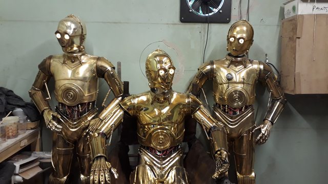

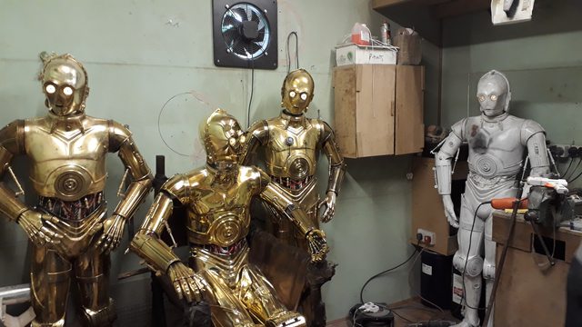

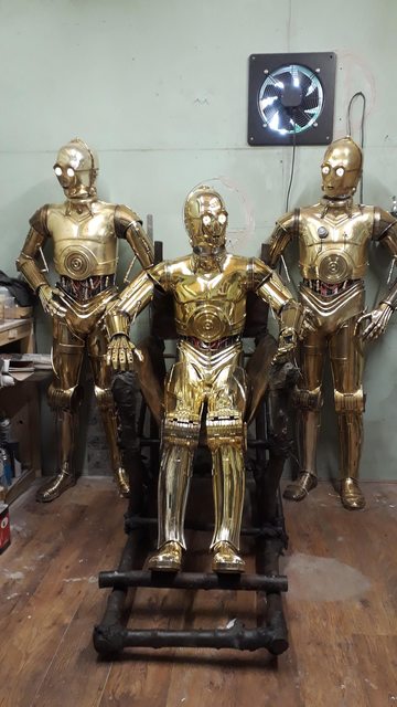

Finished the droid sale threepio...added the restraining bolt, dulled him down with PVA and sand pigments and did a few dark washes
Also started on the next one which will be the Jabba's gate scene

It's this one from my thread; Gatekeeper droid
