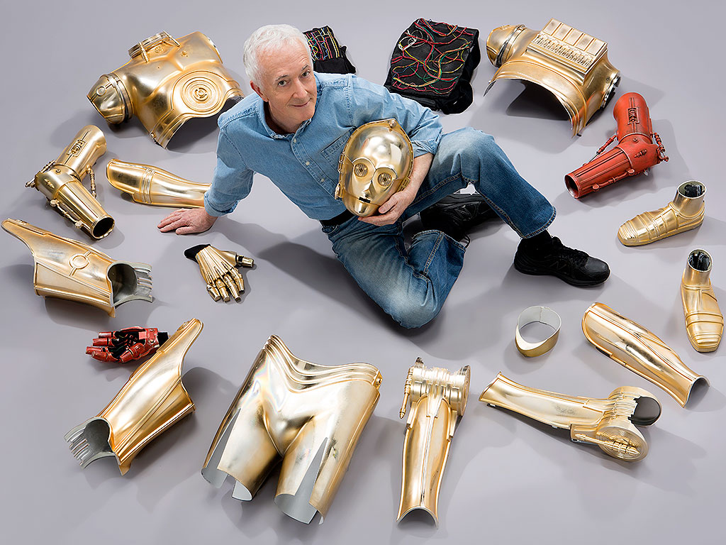

Looks to be gold in all three trilogies. Really hoping someone has an original example in silver though as it does look very cool. As an aside, I believe there are a couple of scenes in new hope where he has silver shoulder rings (the ring part, not the bell) which also looks cool. I think it’s the opening scene.

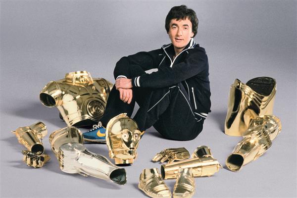

For your next build (c'mon, 4 droids isn't enough ;) ) here's the Tantive V suit with the silver shoulder rings, my personal favourite as I love a bit of contrast (hence my keen interest in silver necks!).

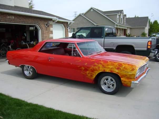

Totally agree about orange peel IF it is sprayed right but even seasoned painters always get it. One trick is to add more reducer than the mixing ratios require. Additional time between coats is required to allow the solvents to flash but it will flatten the clear better. There are also flattening agents but with the garage type setup, there are other things that can ruin the finish (dust, etc).
I did paint this in a garage but I wet sanded and polished the clear. A nice flat, glass-like surface makes everything look better.
