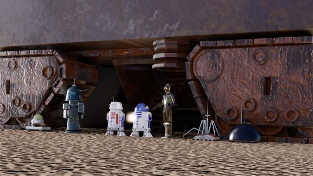

I played around with some renders to show u what I'm going for...

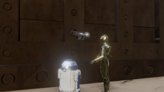

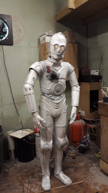

I'm actually going to be building all the droids from this scene except the astromechs
I've already built the eyeball droid for this scene

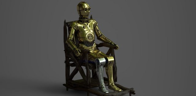

And for this I need to build the log chair as well

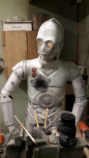

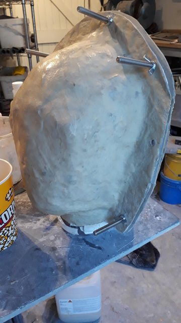

OK update time...got a lot of finishing done to the 'master' suit and started casting the head. Had a coupla bad starts due to lack of de-gassing the PU but it seems to be pretty reliable now

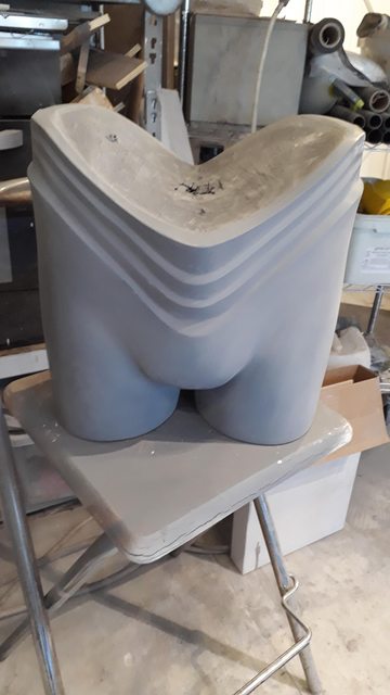

Got all the legs ready for moulding too

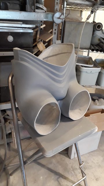

And the standard shorts and the 'sitting' shorts are done

Never seen the sitting shorts. This will make it easier for guys who want to display him in a land speeder or Ewok throne

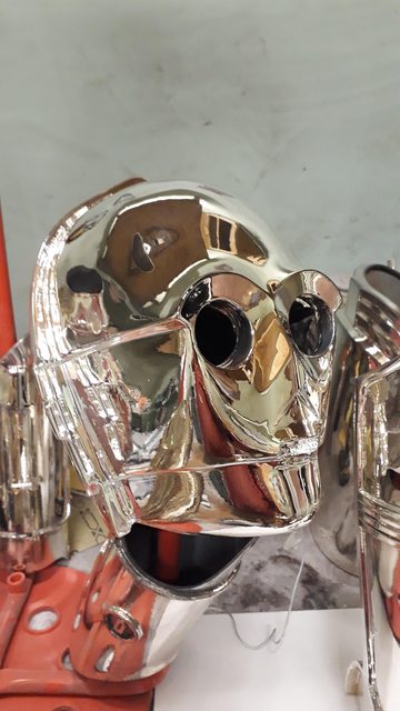

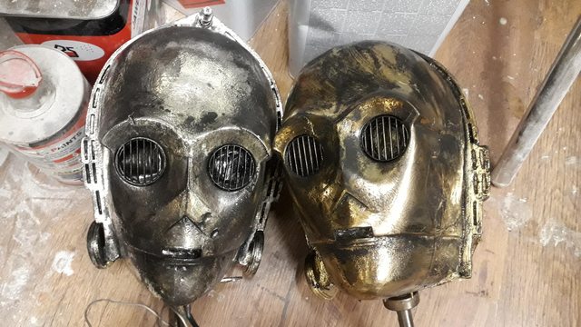

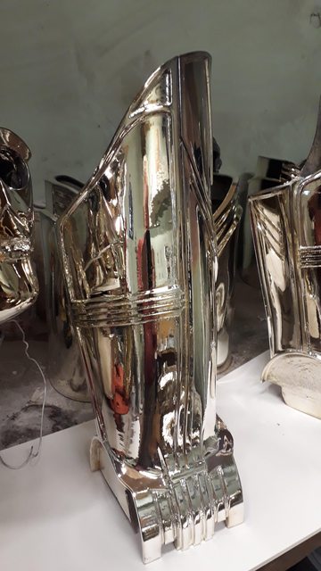

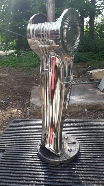

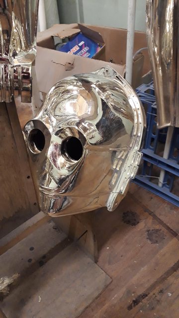

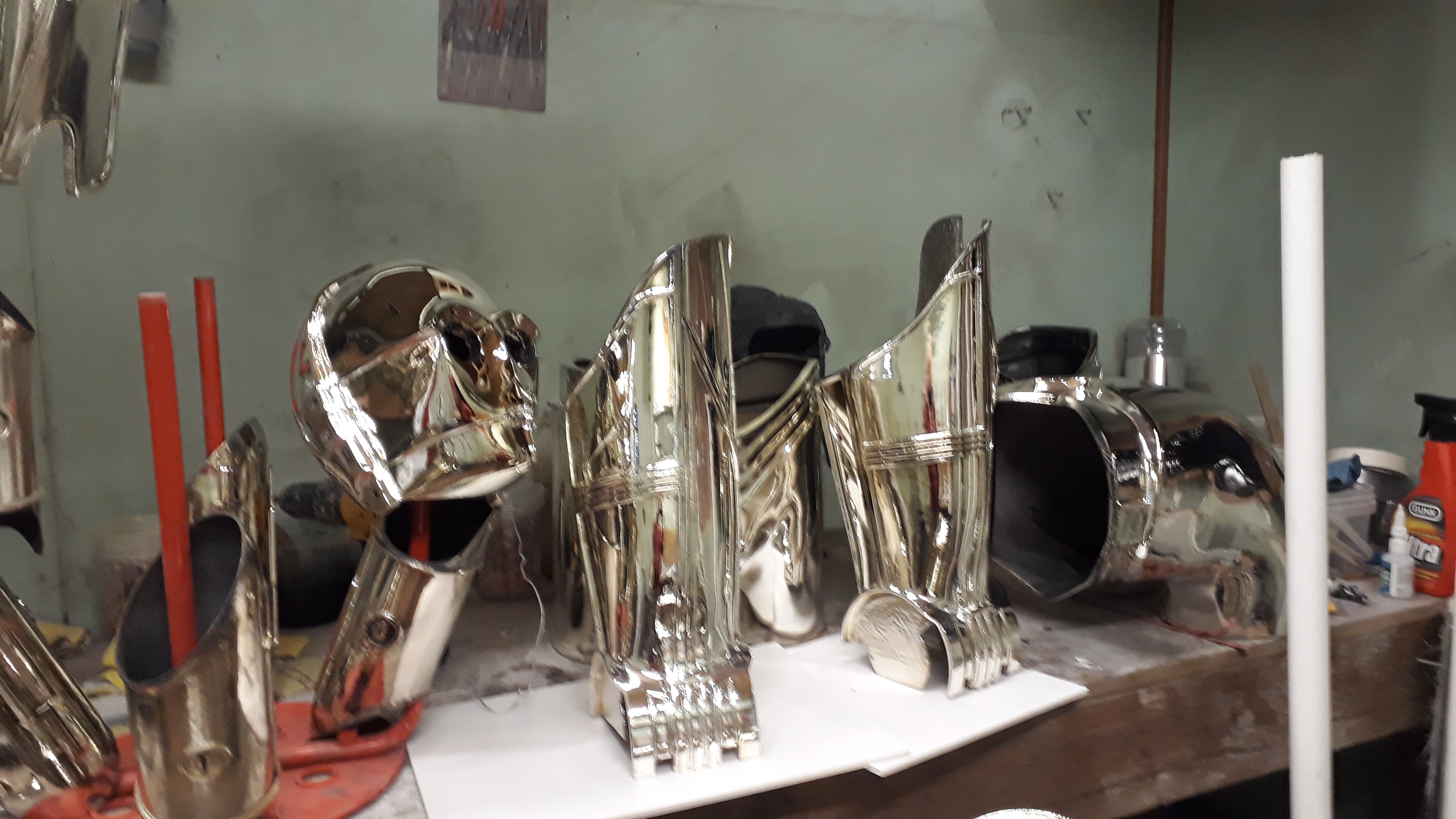

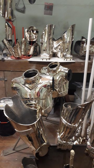

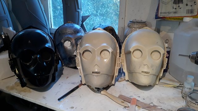

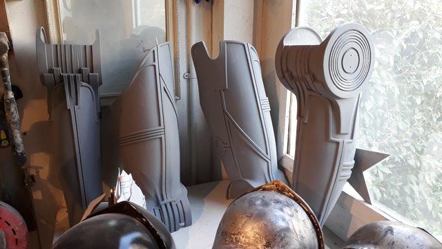

OK I'd forgotten what a melon twister this build is but finally I'm onto the Chroming/tinting side of things. So all the parts are filled/sanded/primed, base coated and ready for chroming. All the greeblies, which are either brass or resin printed, are done and painted.

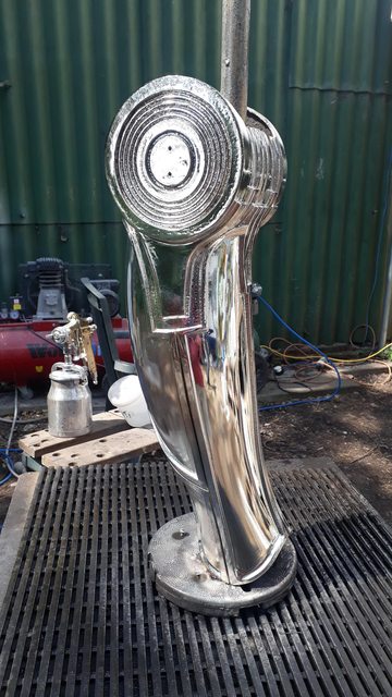

First of many pieces to go...

What kind of chroming did you choose? Metal plating or some painting techniques?
Yeah it's Hydrochrome, Spraychrome, Mirrorchrome or whatever brand u like, silver nitrate system. Works like a charm when everything is set up right but usually causes a good deal of frustration en route. Will post more pix soon
