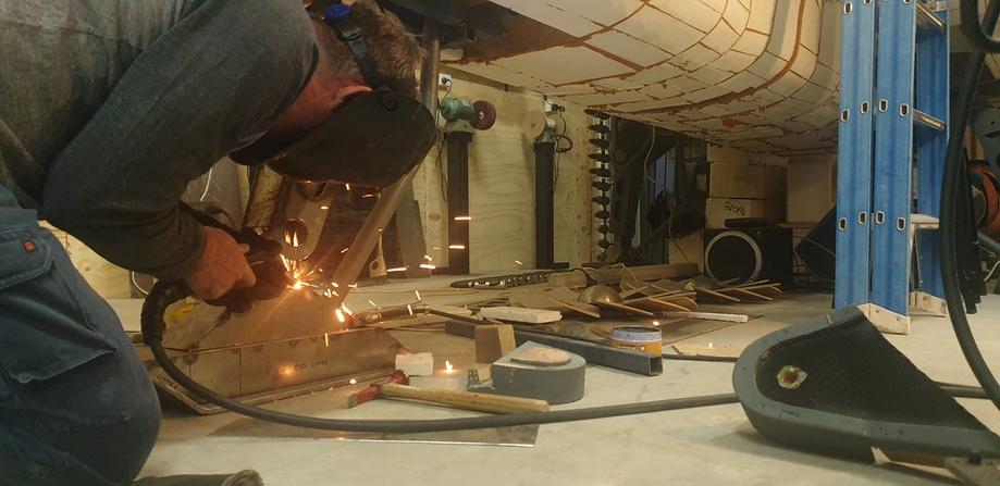

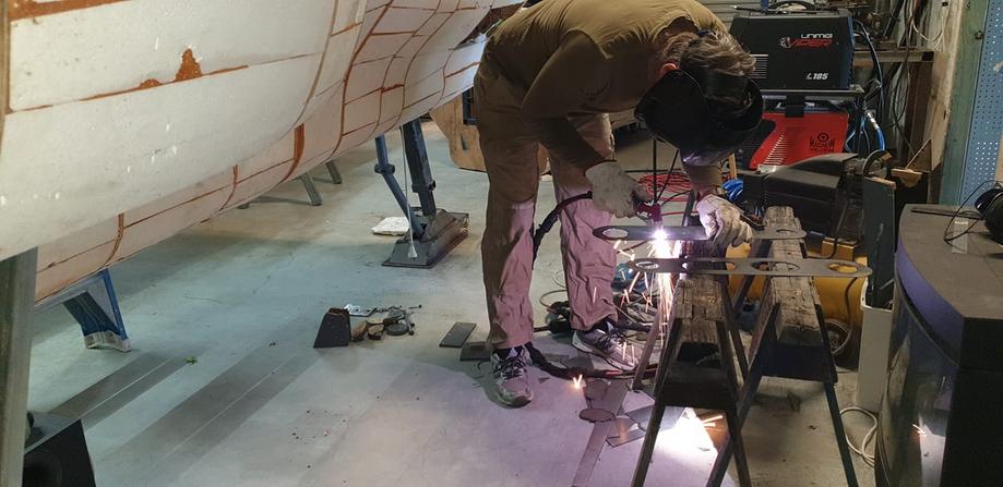

Last night I started by pulling all the plywood cladding off the landing gear and started to replace it with steel. I am also fitting concealed axle mounts in the skids, so I can put temporary wheels on each one, for moving the ship when needed.
As I go, I am repairing all the damaged polystyrene, caused by moving it around the property. I've already spent some time realigning modules that have shifted, so the fit is flush.

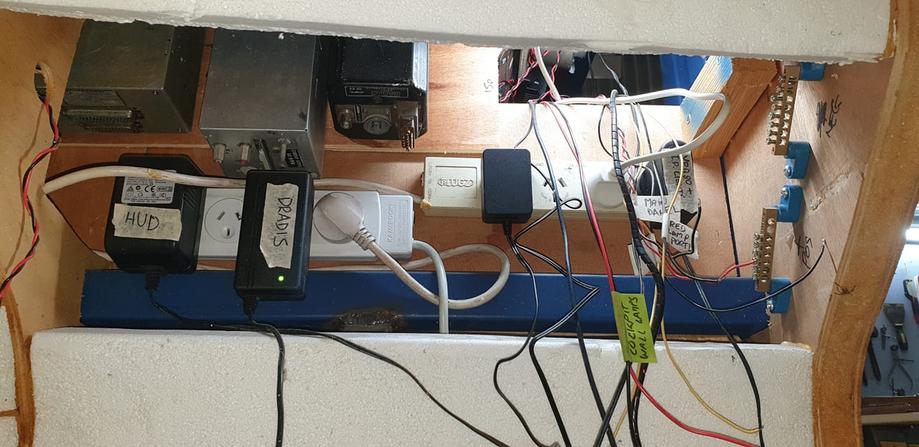

I repaired the wiring of some of the cockpit instruments last night. The sound system needs more work.

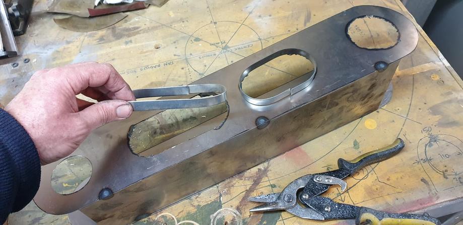

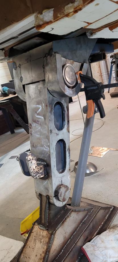

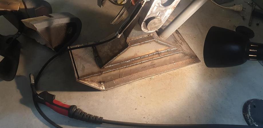

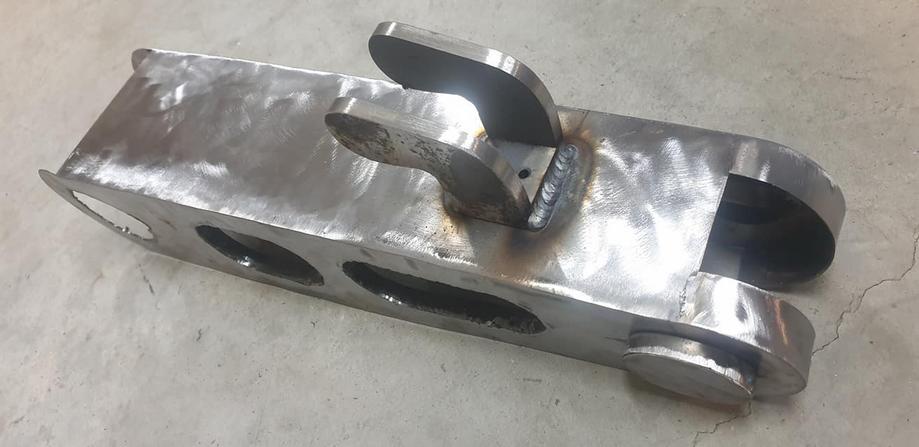

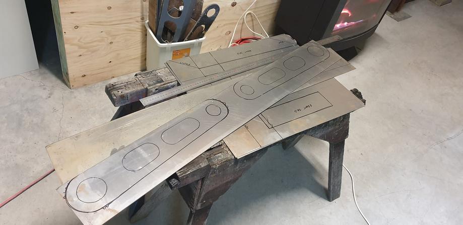

Some stolen time last week, gave me a chance to get a little work done on the front landing gear. I replaced the plywood base plate on the bottom with 10mm thick plate steel, welded solid to the foot and leg. Also added some extra bracing at the top for lateral movement. I plasma-cut the holes in the side panels of the landing strut, then framed them with strips of sheet-metal, welded in.
It needs a quick clean-up with a flap disk, but I must say, even without paint it looks much better. It will certainly last a lot longer than that horrible plywood.

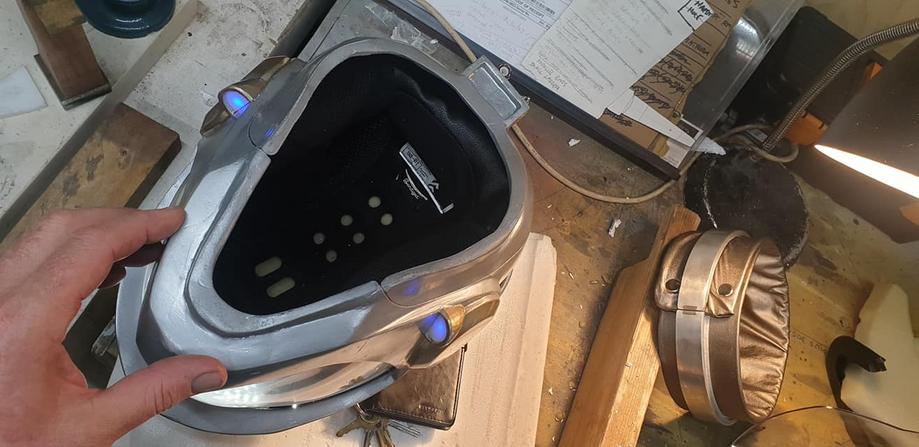

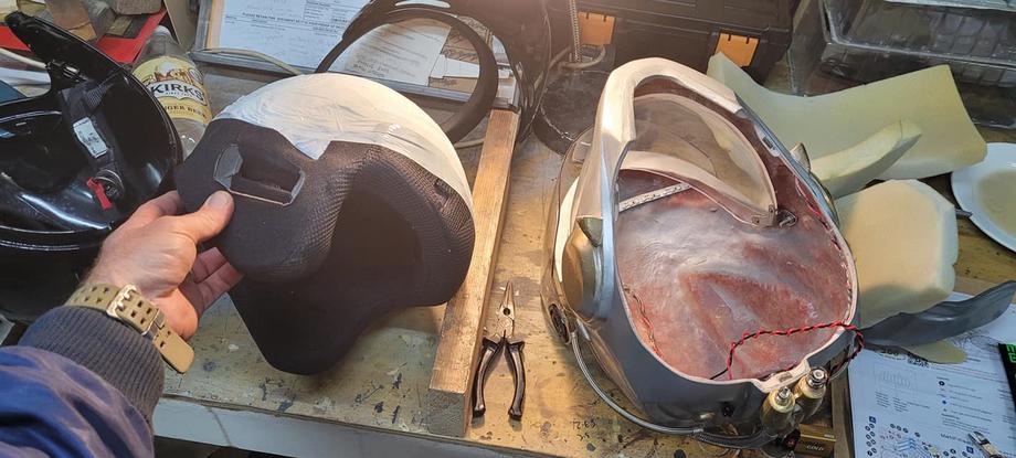

An old army mate dropped in a motorcycle helmet for me to pull apart and use the inner lining for the Viper pilot helmet. After a few mods, it fit in quite well and feels snug and comfortable enough to stay on my head if I was pulling some G's. I may even pull out the old perspex visor I made and re-shape the motorcycle helmet visor to fit. It's thickness and surface are a lot more consistent than the one I moulded with a heat gun. I think I'll put in a de-fogging fan too. I have one in the Iron Man helmet and it is very effective.

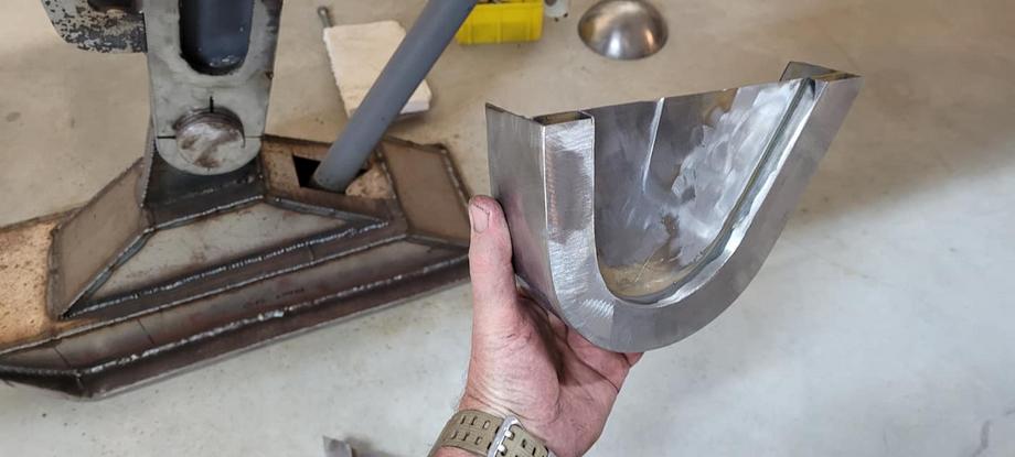

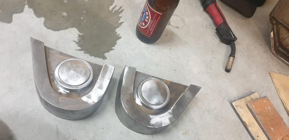

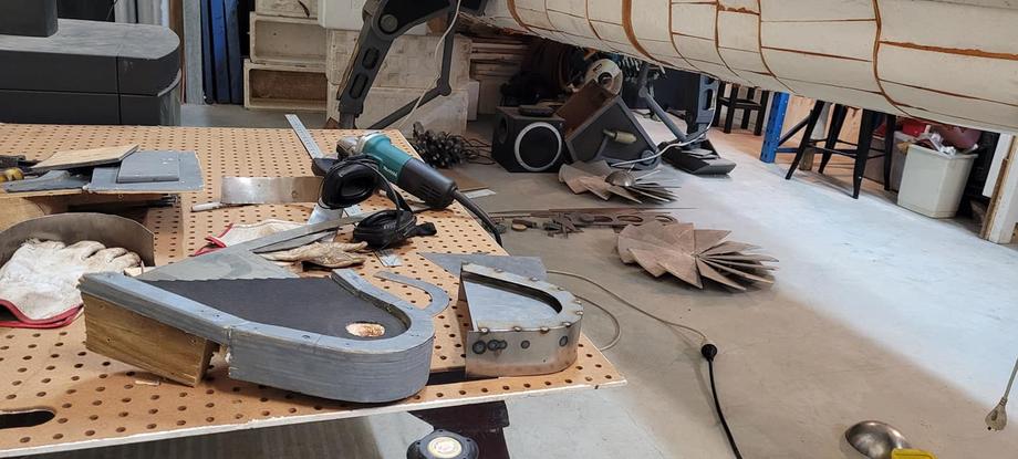

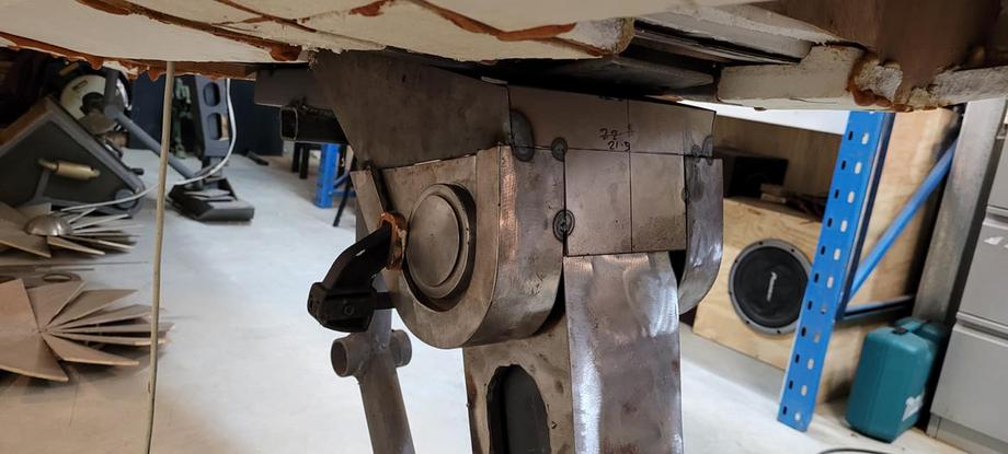

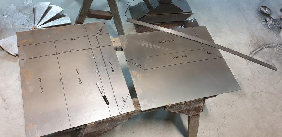

Continuing with the landing gear, the top pivot pin and surround made of plywood is now in the bin, with sheetmetal cladding replacing it. Not only does it look better, but it will last forever. I ran out of welding gas, so the top bit is just nasty spot-welded in position for now until I can afford more gas to finish it.
