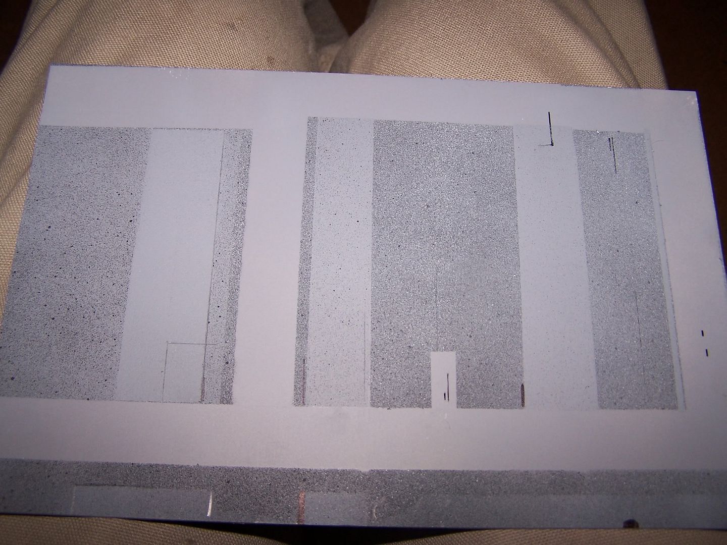

DJ, was that with an airbrush or rattle-cans?
Thanks for the compliments guys.
Rattle-cans. Duplicolor if it helps. They have a nozzle different from other spray paint. Maybe I was able to get more speckles because of it?

I'm using Crown/Ace Hardware's house brand which uses the same nozzle as the Duplicolor cans I have, with the "flap" on top.
Check that, the black I used was a Rustoleum and it too had a nozzle different from normal spray paints. Even different than the Duplicolor etc.
I wish I had kept better track of my methods. I was only curious to see if I could demonstrate the "no darker grey on the panels" theory.

The section I'm working on now may have been base-coated, or just had heavier application of darker colors hard to say. But I'm pretty sure they laid down a base coat on at least some areas of the model.
Clearly,you can see that the speckled pattern is no more dense on the left than it is on the right is this top photo. This indicates that there is some darker paint colour under this speckling.

Here is a quick paint test I did just now.
There is no darker paint for the panels here. Just masked and misted black, white, and basecoat to get it kinda even. Consistancy is extremely hard to achieve and if I actually spent time trying to get it even, I dont know if I could.
I dont envy you.
I see that there looks to be the same effect,but supersize this photo on your home computer,and you'll see that the although the speckling pattern is similar,it's not exact! The stippling effect from the spray paint cans that you're using is different than the ones that Rob is using,even though they are the same type of spray button. Your surface is more uneven,and subdued by the darker hues than the actual Death Star,and Robs' version.
My guess is that it's all in the hand movement,and the speed at which this applied determines the density,and the size of the paint droplets the form the speckling pattern. This also contributes to the hue of the panels to some extent,but to truly appreciate the value of the paint scheme itself,and all the hard work that went into it - you must look past what seems obvious to see what might actually elude our perception of what is truly is. Robs' on the right track with this - go slowly,and carefully,as it only takes one moment of indiscretion to ruin months worth of work!

Would you say you were rather heavy-handed with the cans (kept at it with multiple passes)?
Not really. I either held the styrene at arms length and spray or proped it up so it was still vertical.
Remember that smaller paint specks will travel farther than the larger ones. So I just sprayed in about 4 or 5 short bursts from about a foot and a half away to get the smaller dots and for the larger ones, I held the can well above the panel area so the larger dots would fall and hit it.
I didnt get the tone very even so I just hit it with some of my base color and adding those speckles evened it out.
Also it should be noted that a few of the panels in my picture dont have the white in them. Remember this was super quick and sloppy. No measuring or protractors. Just showing how I think you can get both the lightest and darkest panels with no darker grey.
