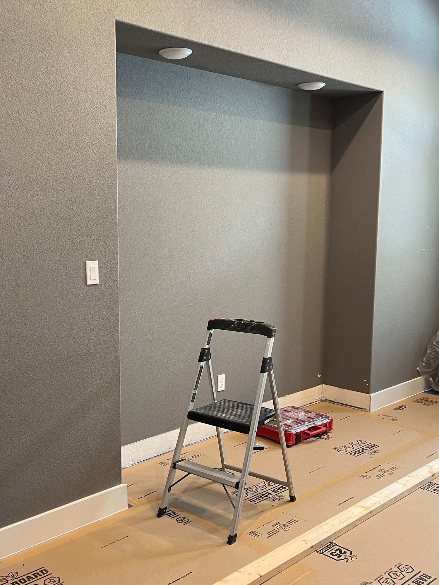

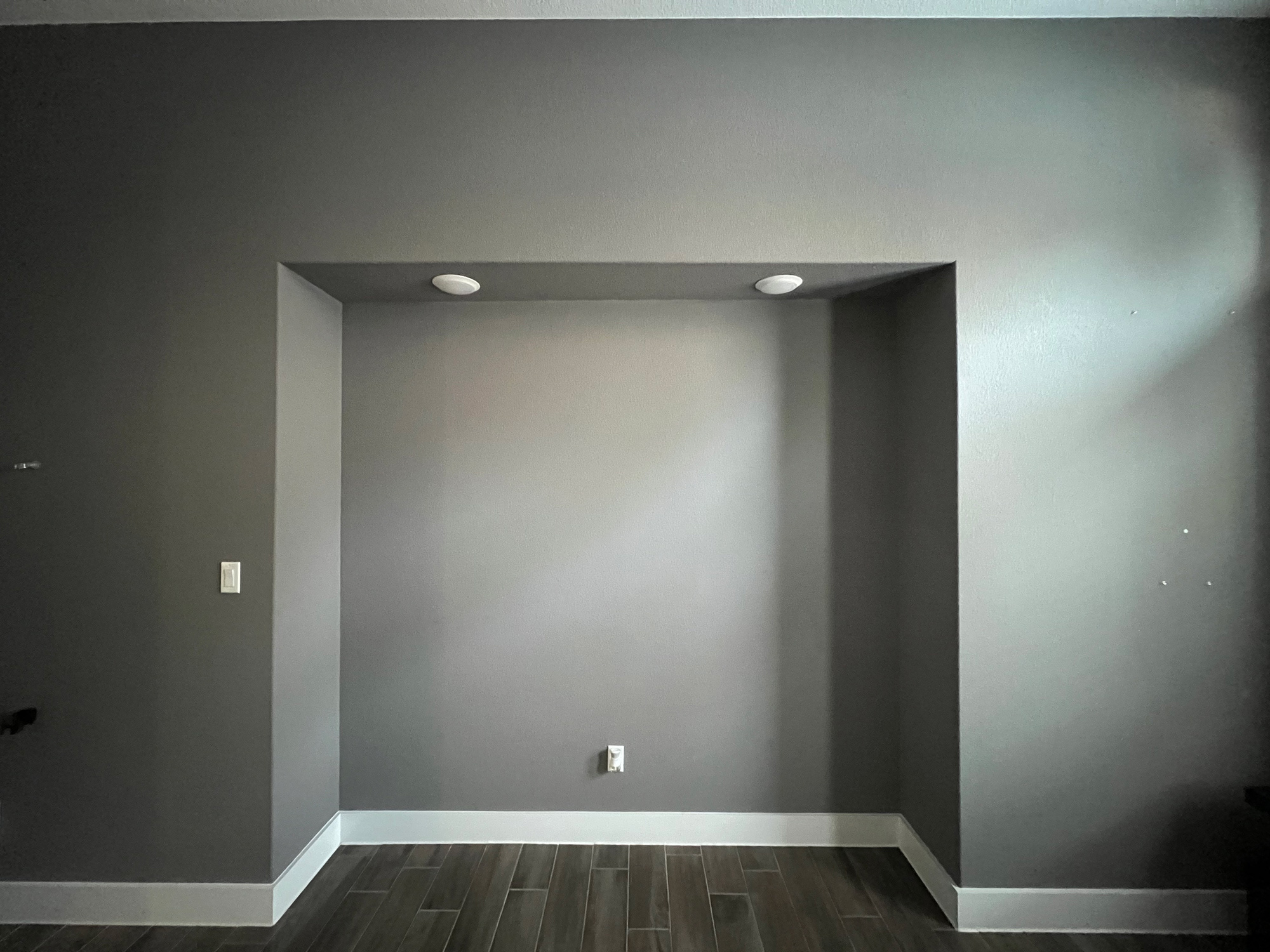

The size of the niche that I build the door around measures 8' tall x 8' wide x 16" deep. Yes, its slightly wider than the standard Death Star hallway door. There are two LED disc lights in the top that are controlled by the wall switch on the left side. I will be rewiring the wall switch to operate a 120V outlet which will power a low voltage transformer for the LED lights. I will keep the separate lower outlet in the door to maintain housing code and also in case I need it in the future. The second image shows the baseboards removed and the protective cardboard over the floor.

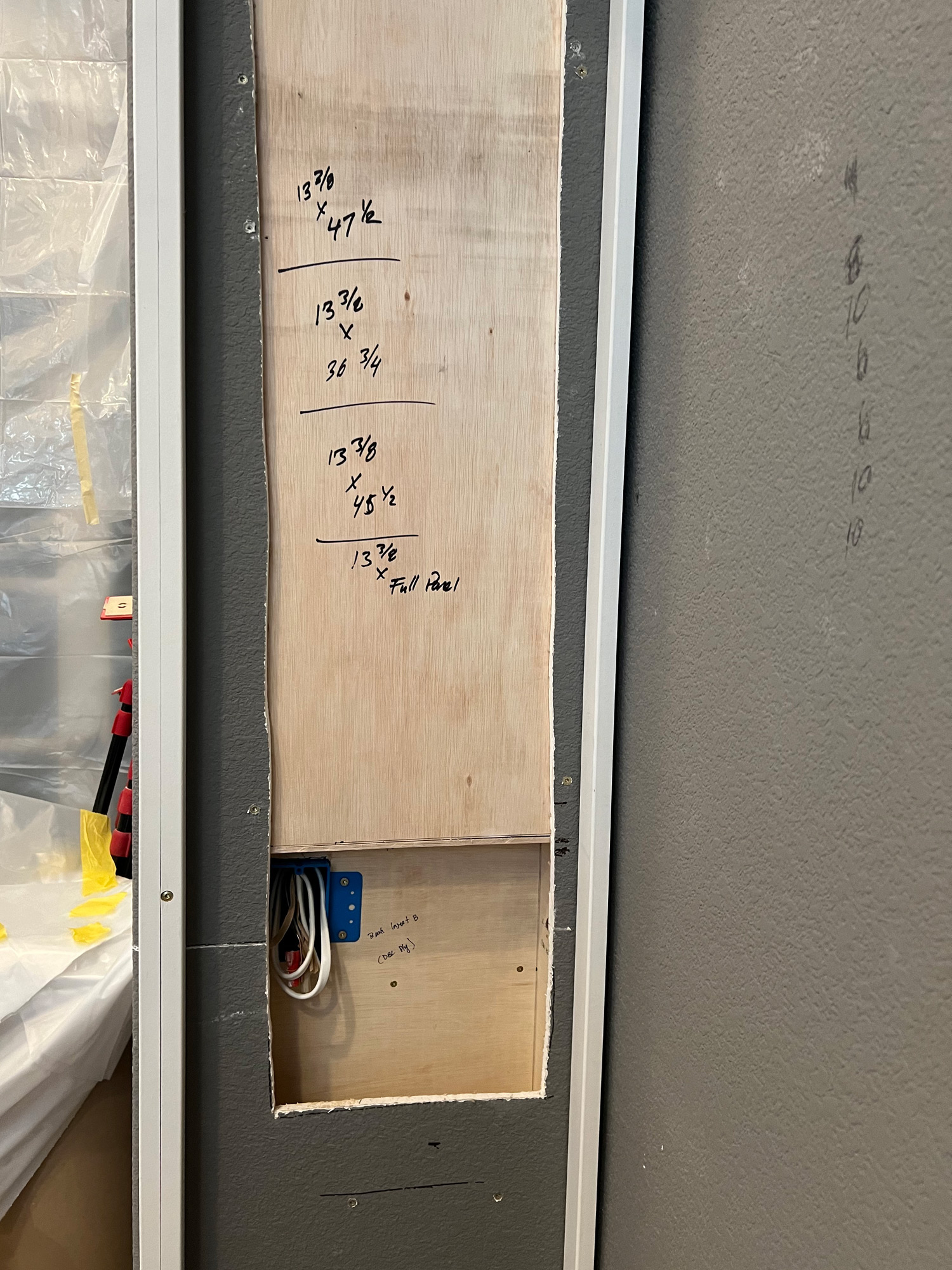

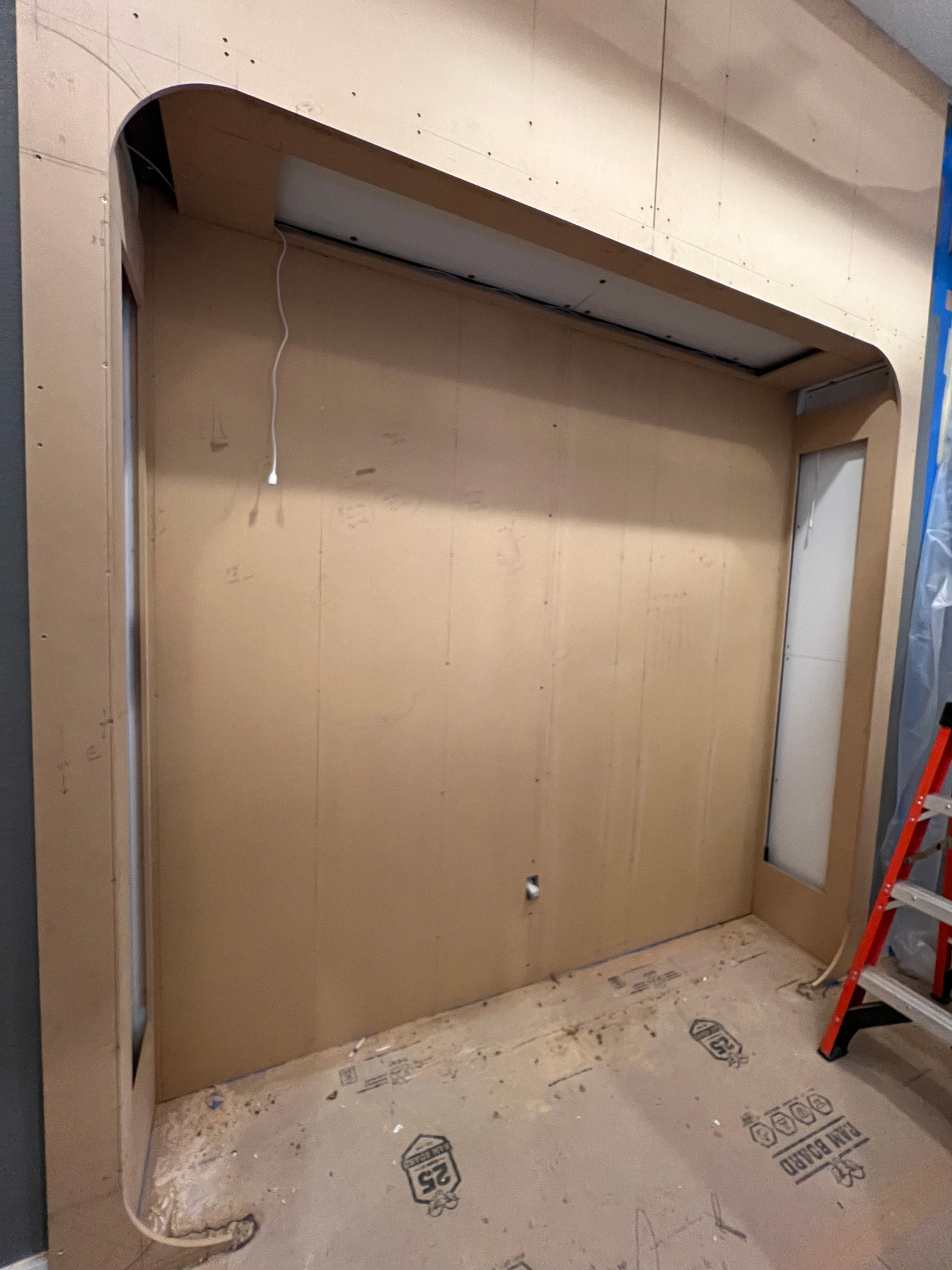

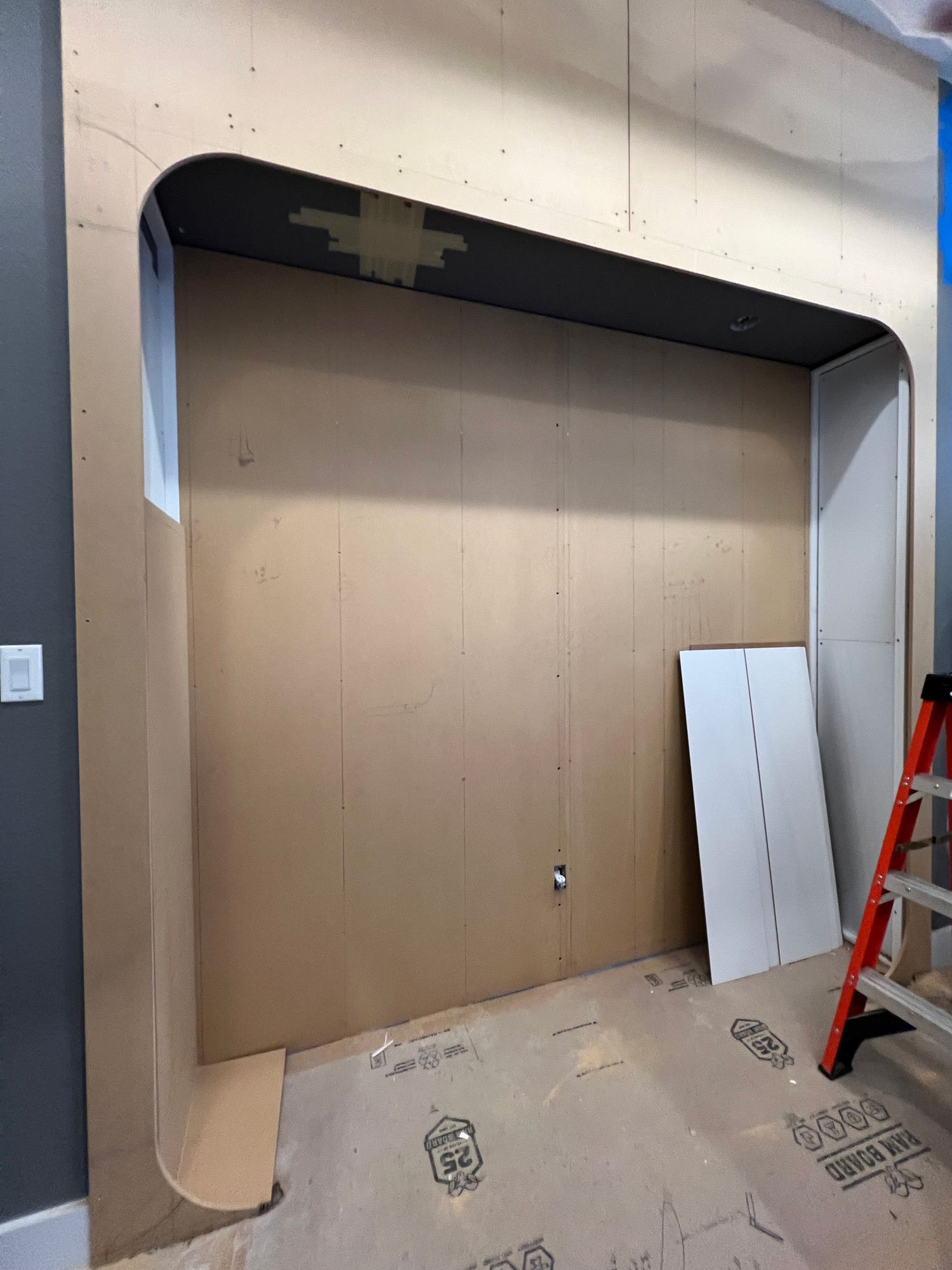

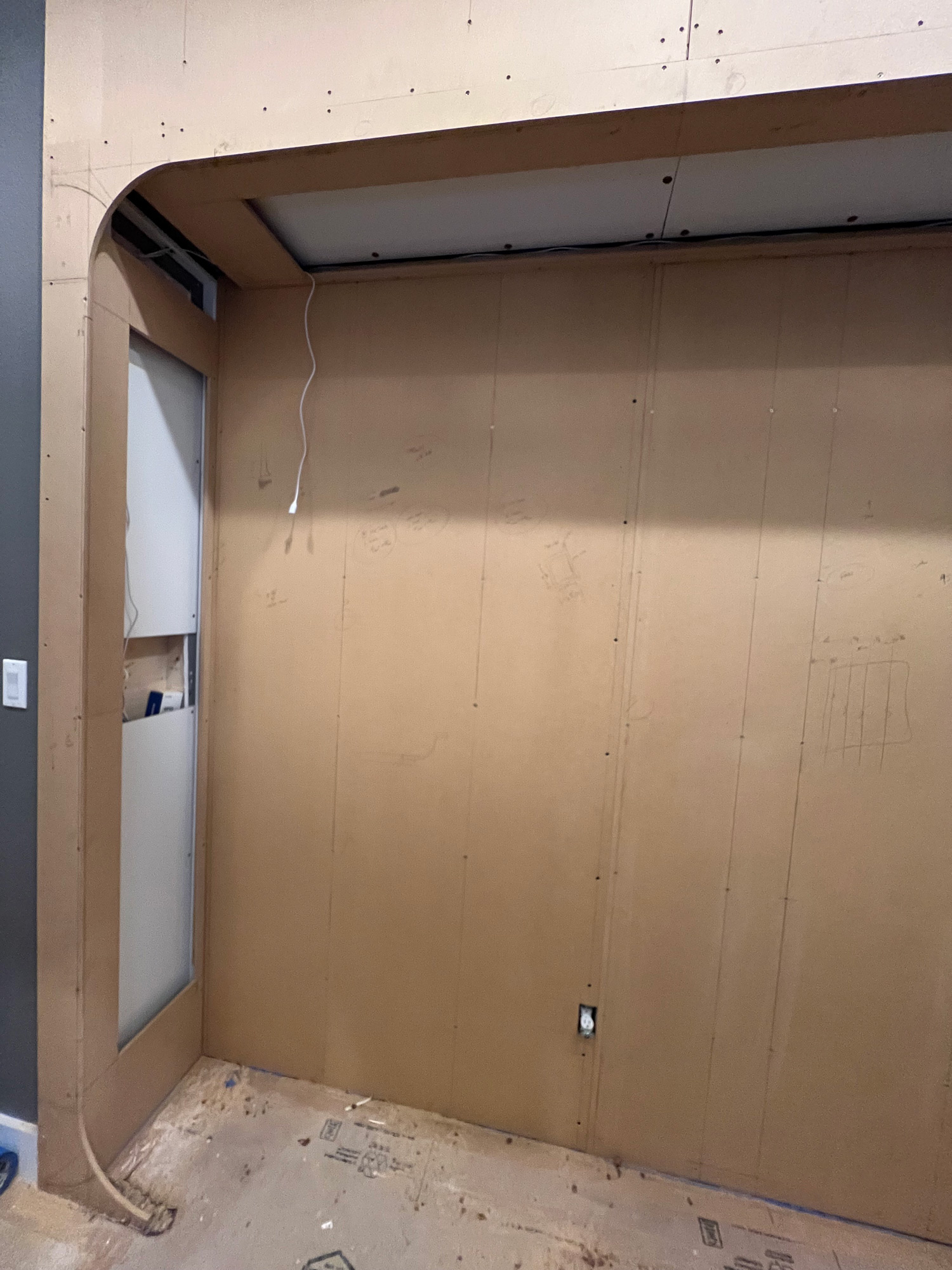

I hired a carpenter to help me with the framing and structural work. We started by removing the LED disc lights and then punching out a hole in the left wall to get to the wall switch wires. The carpenter added a 12"x 12" inset plywood box to allow for mounting the transformer and power outlet. This will also be the location of the light up Death Star door control panel. Then we framed the light boxes on all 3 sides, then adding white gloss marker hardboard panels inside.

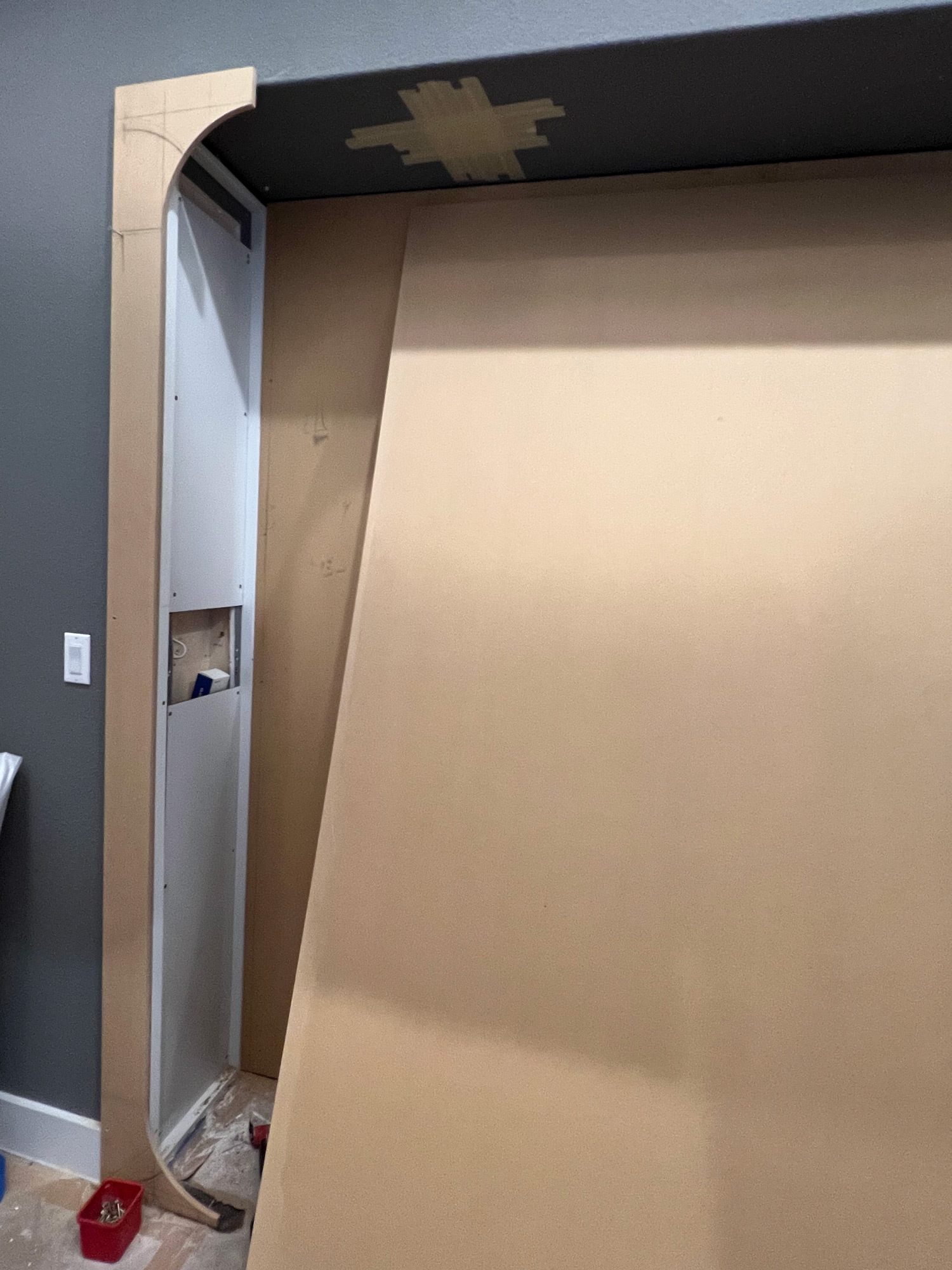

Once that was done, we started adding 3/4" MDF sheets to the back wall surface. For the front frame face and corners, we used 1/2" MDF and brought it proud of the baseboard. Then we skinned the framing for the inner side panels in front of the light boxes.

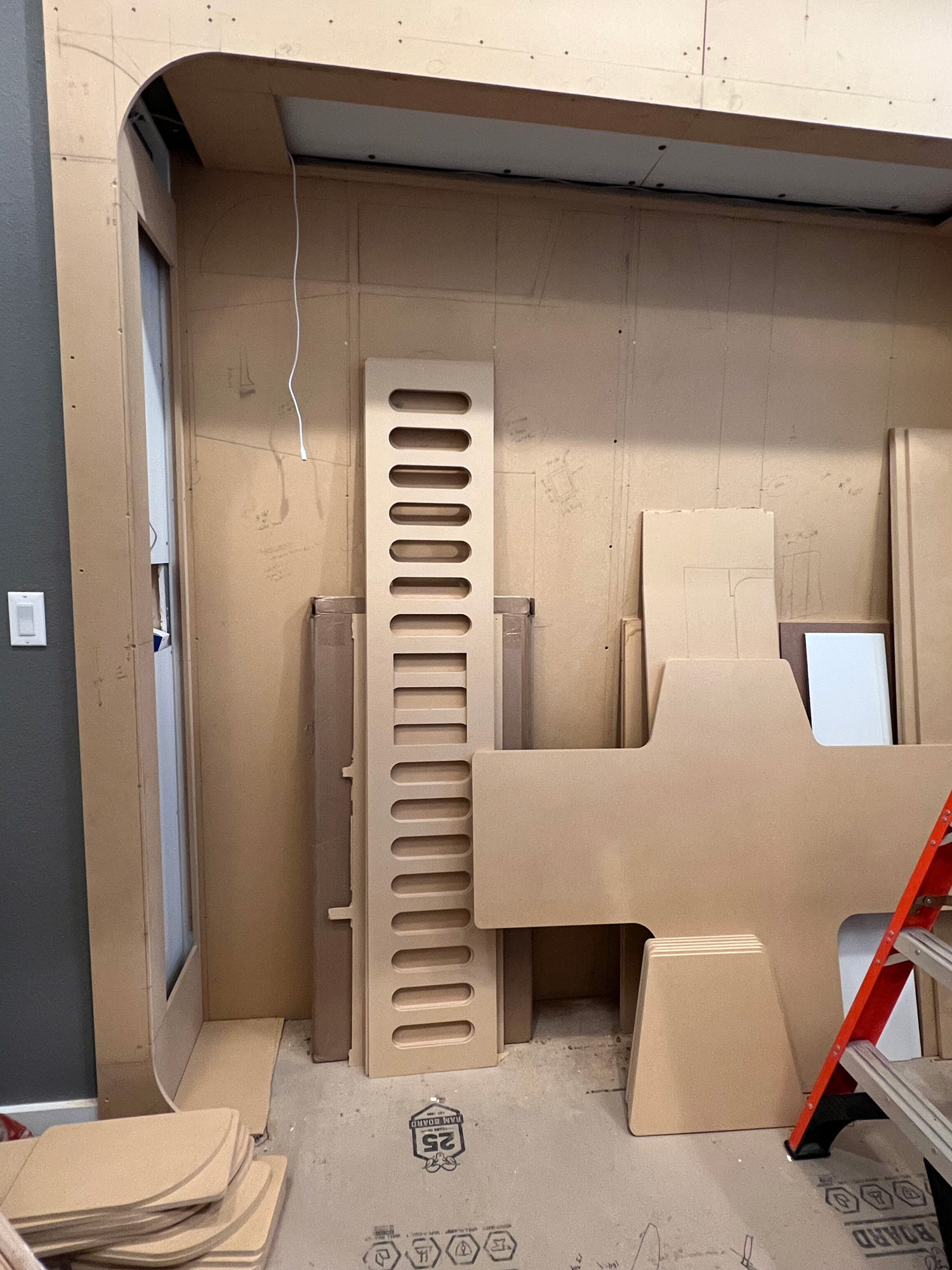

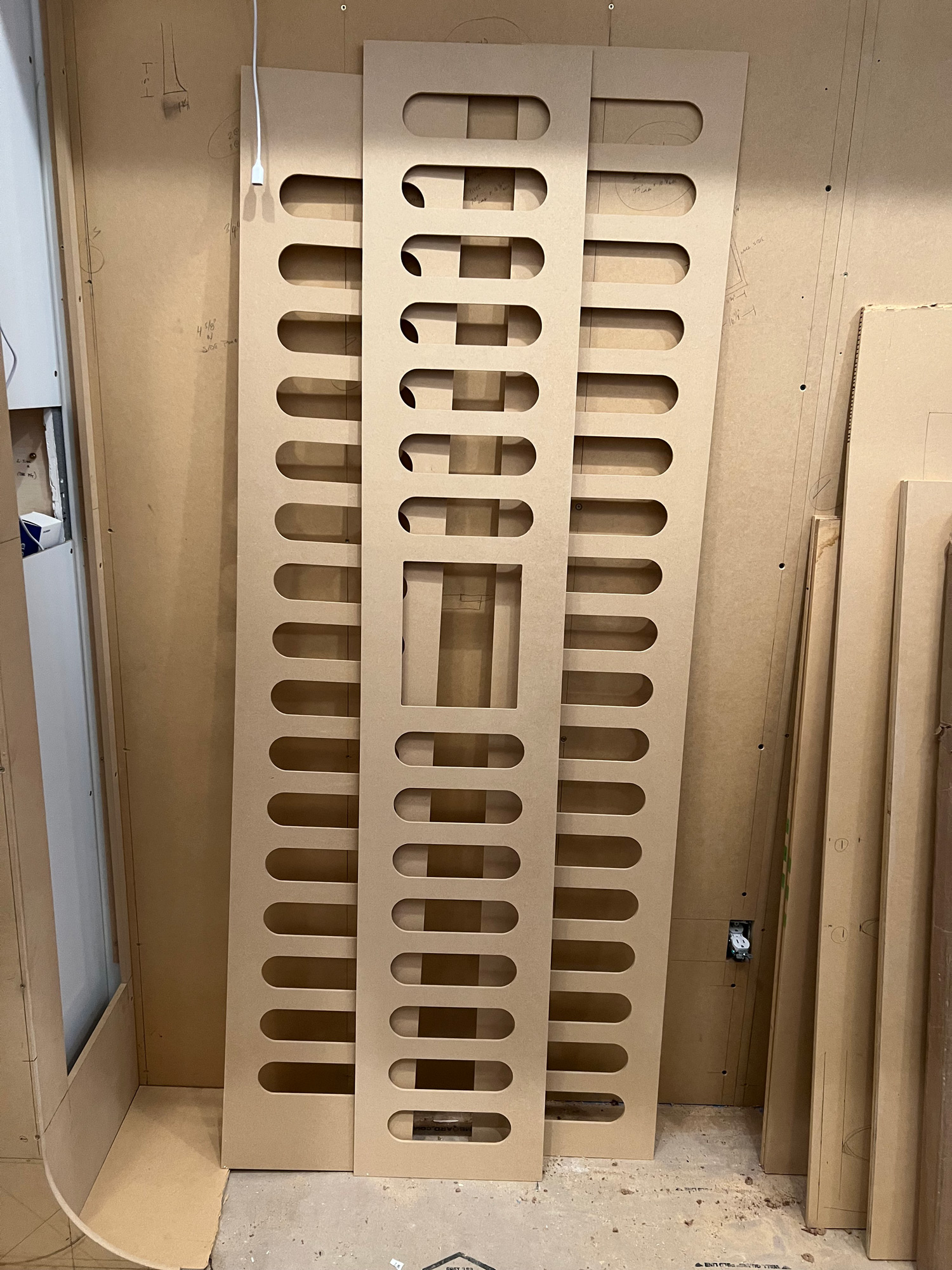

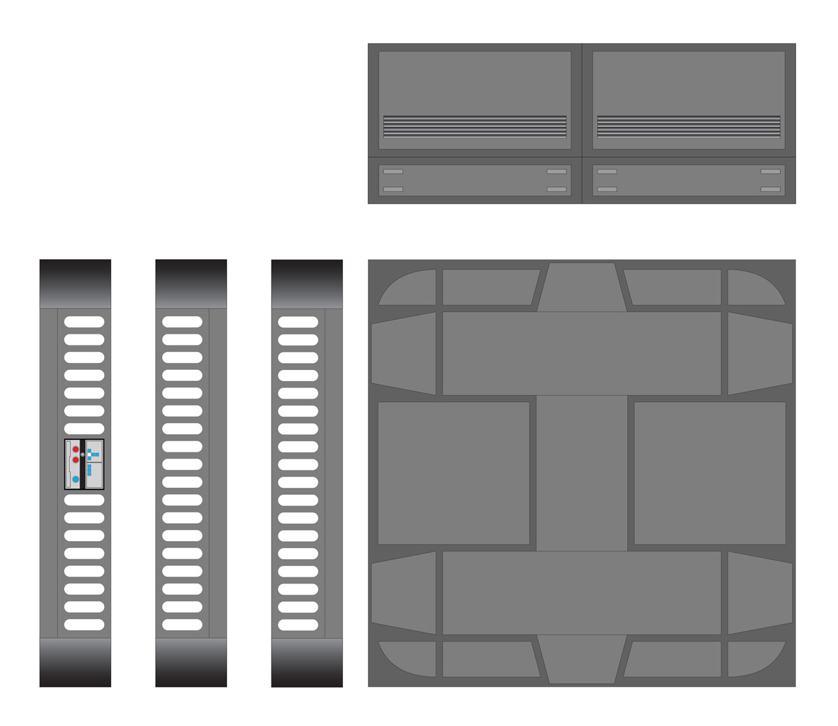

Using the measurements of the current framing, I designed the other surface panel shapes in vector using Adobe Illustrator and sent the artwork to a local CNC wood shop to cut them out. The side oval panels were cut from 1/4" MDF sheets and the back wall trapezoidal door shapes were cut from 1/2" MDF sheets.

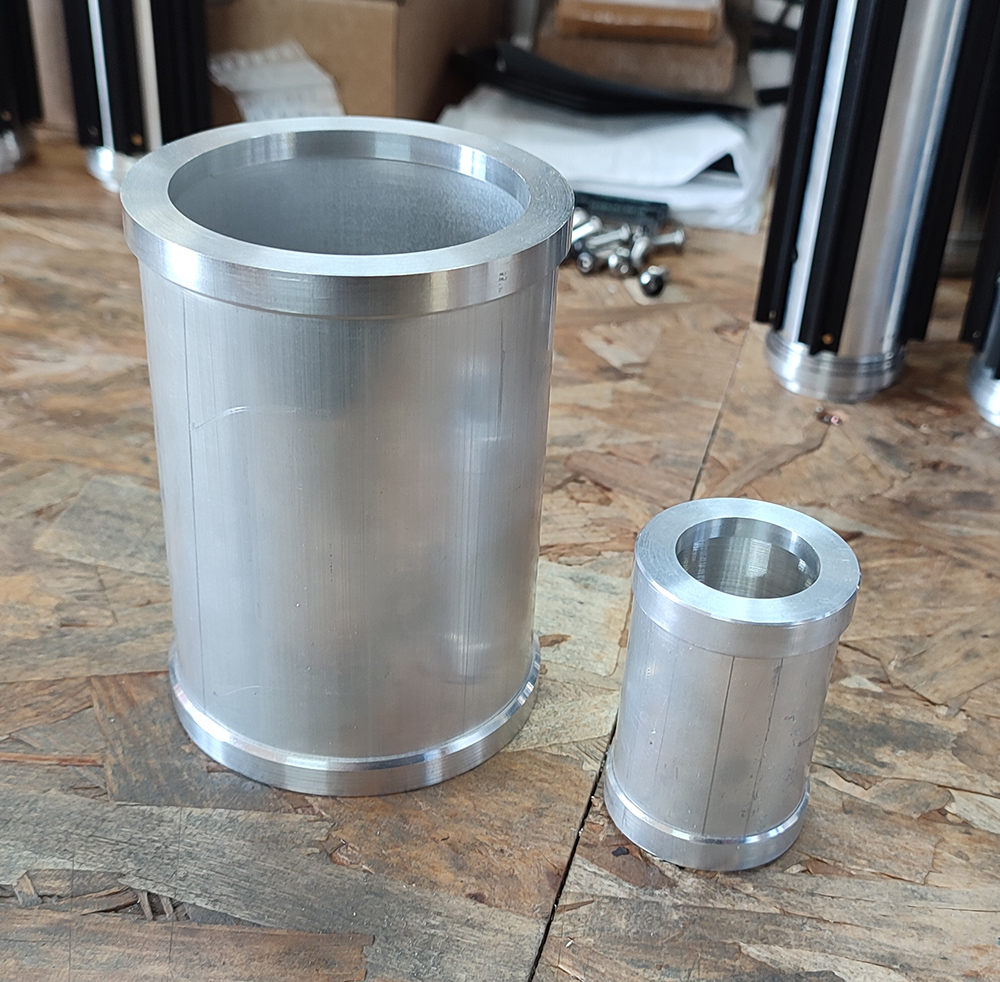

Sorry to derail this thread even more...will you add the "ridges" on the inside of these tubes as well?
Looking great so far Matthieu :)
I'll discuss that on my own thread when I do the interest thread, for now the inside will be resin printed. I have tested an aluminium inside, it's complex and expensive, you need 3m length aluminium rods per part, the price goes crazy very quickly. I think the mix aluminium and resin will be a good compromise.

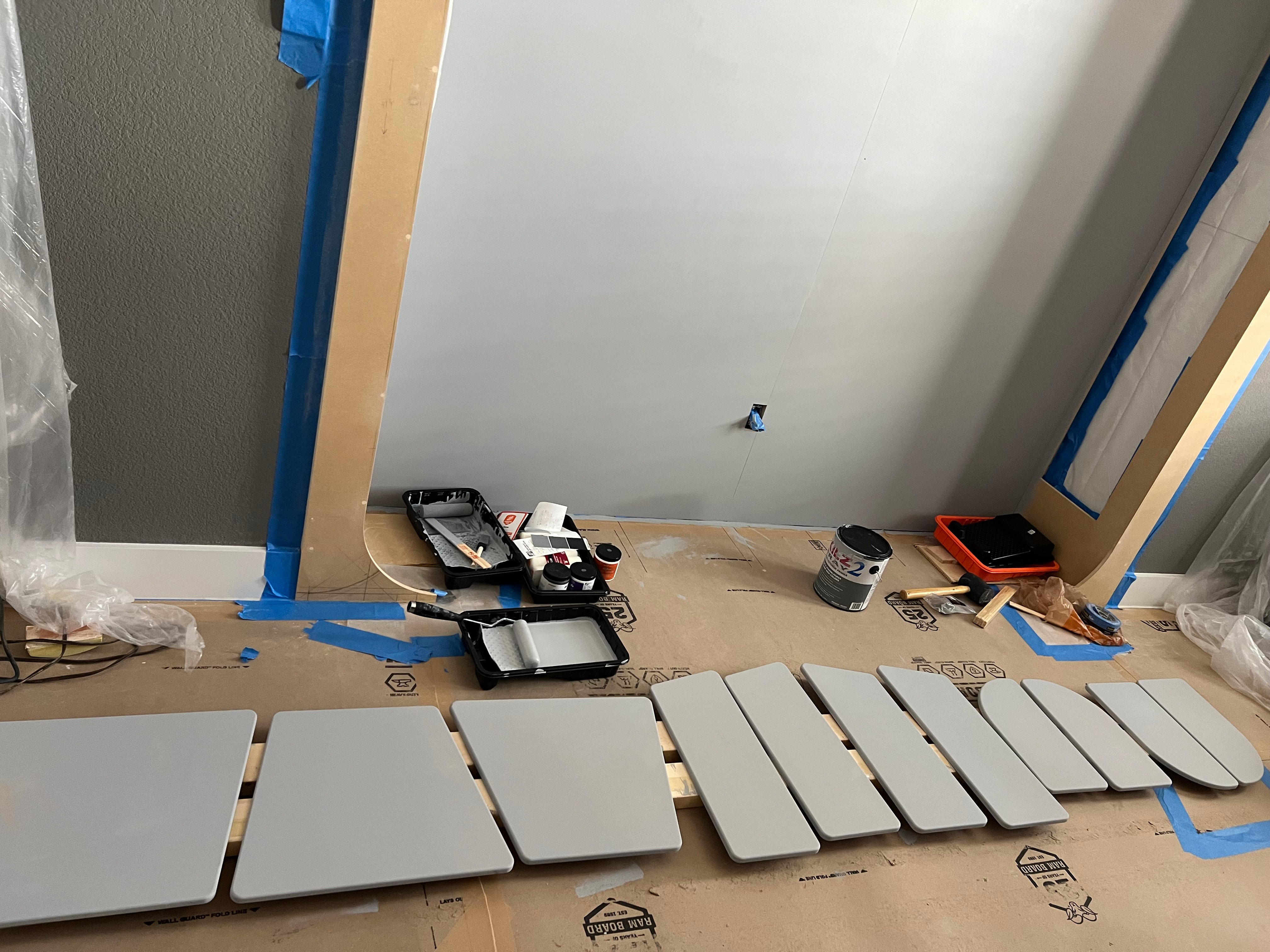

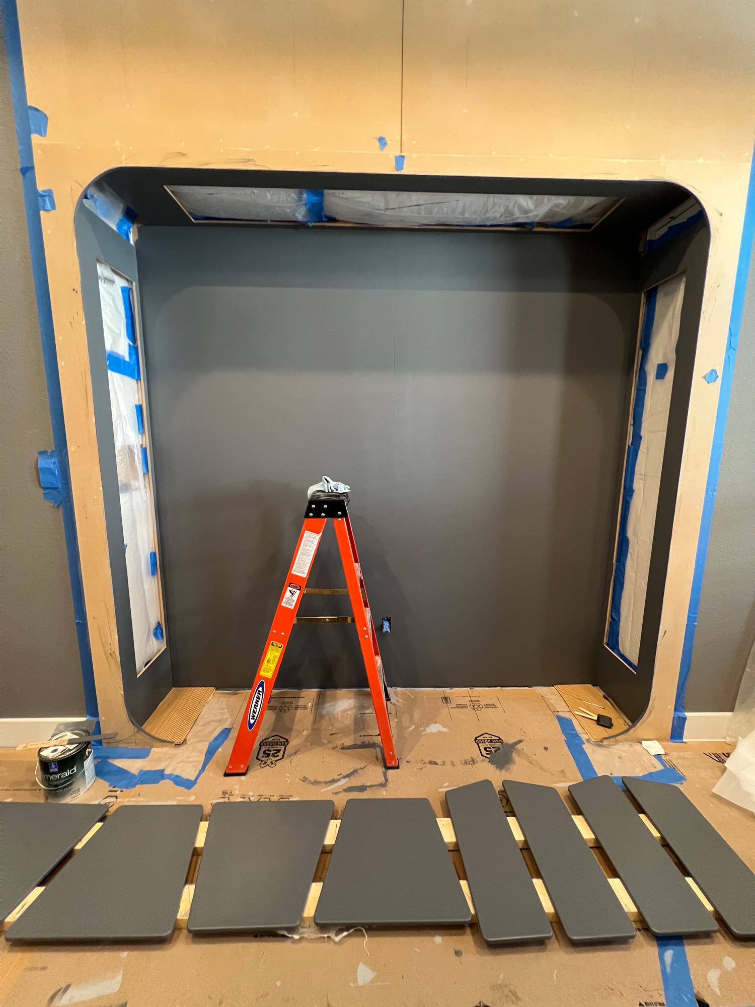

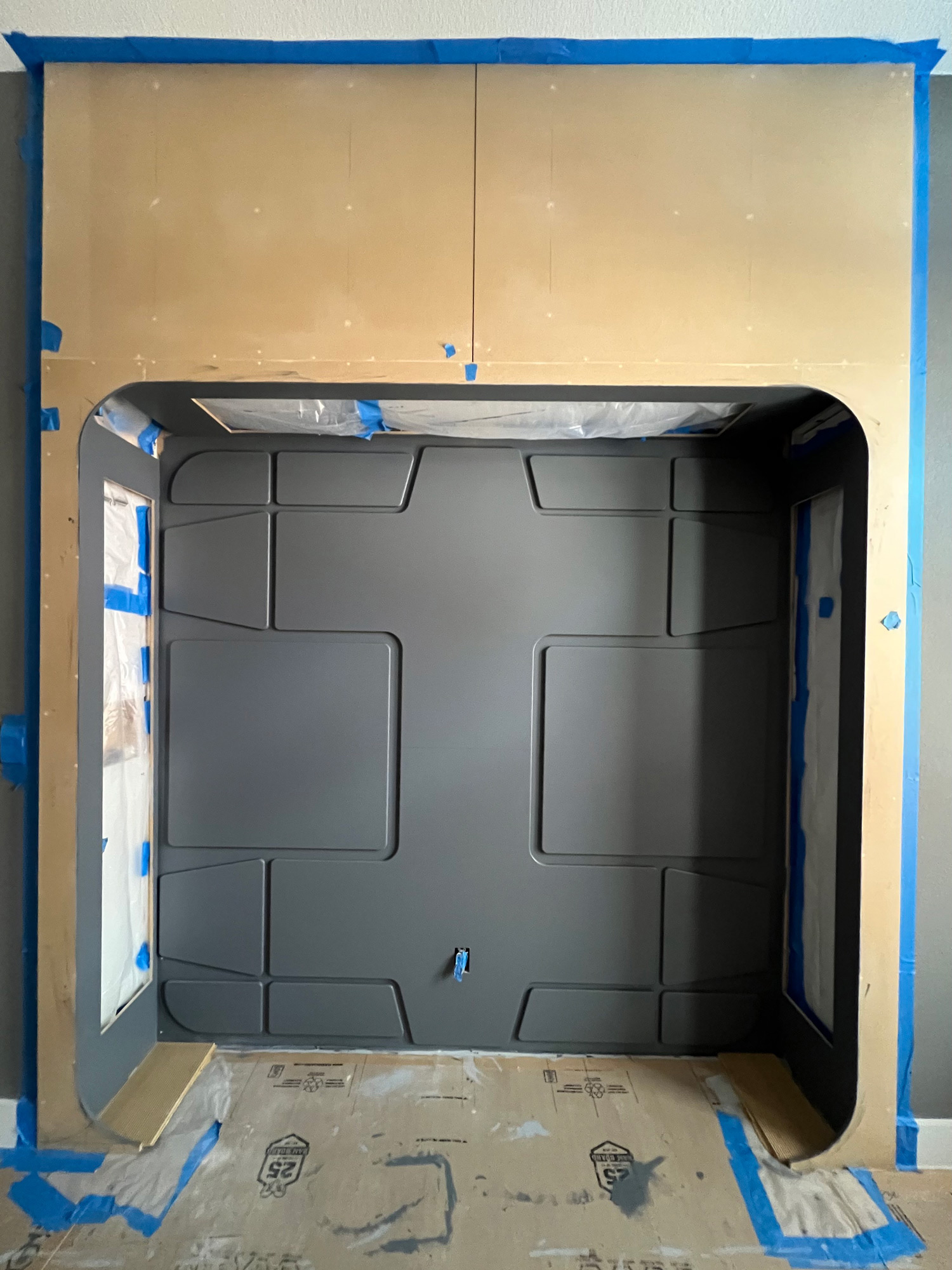

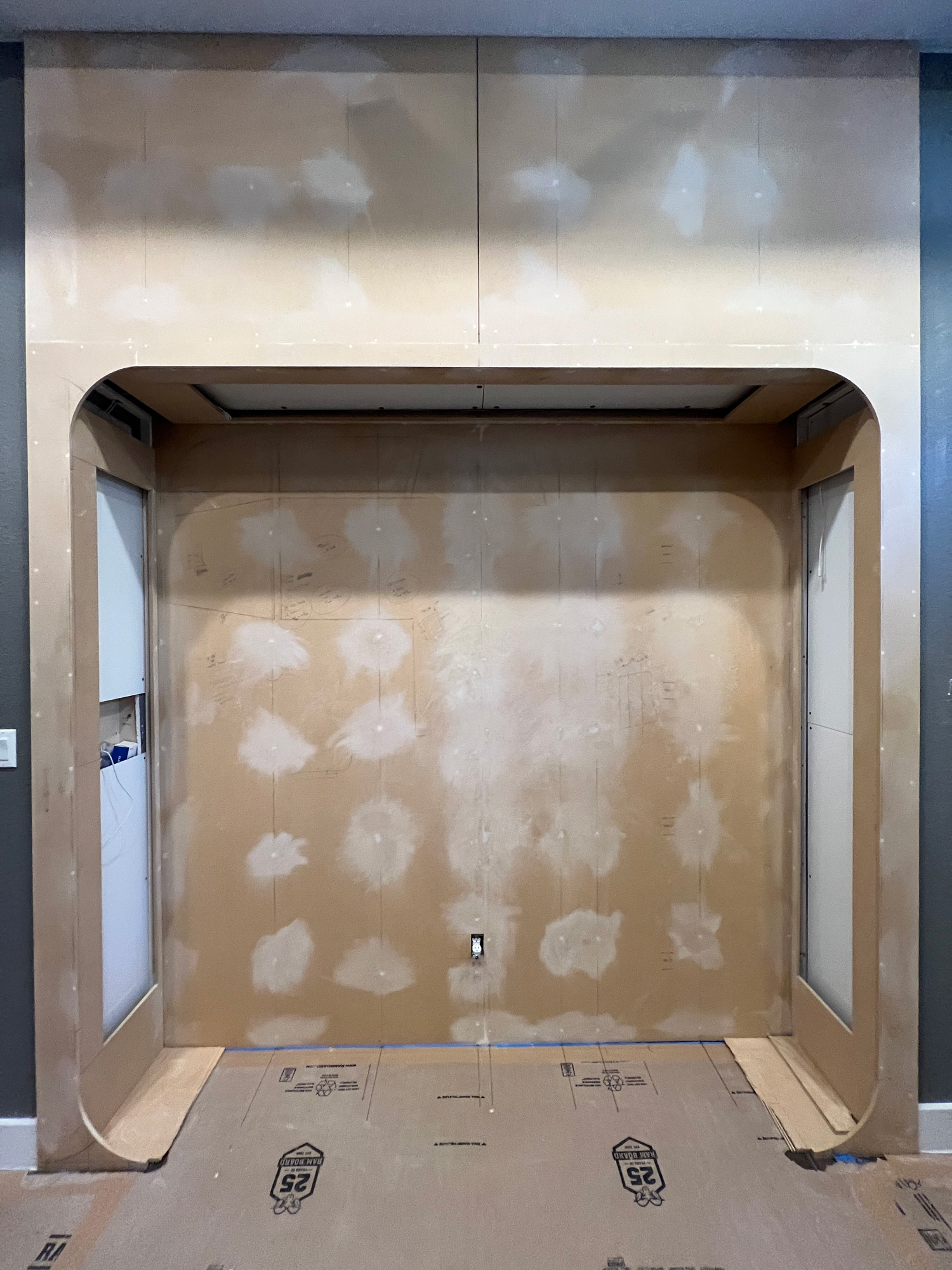

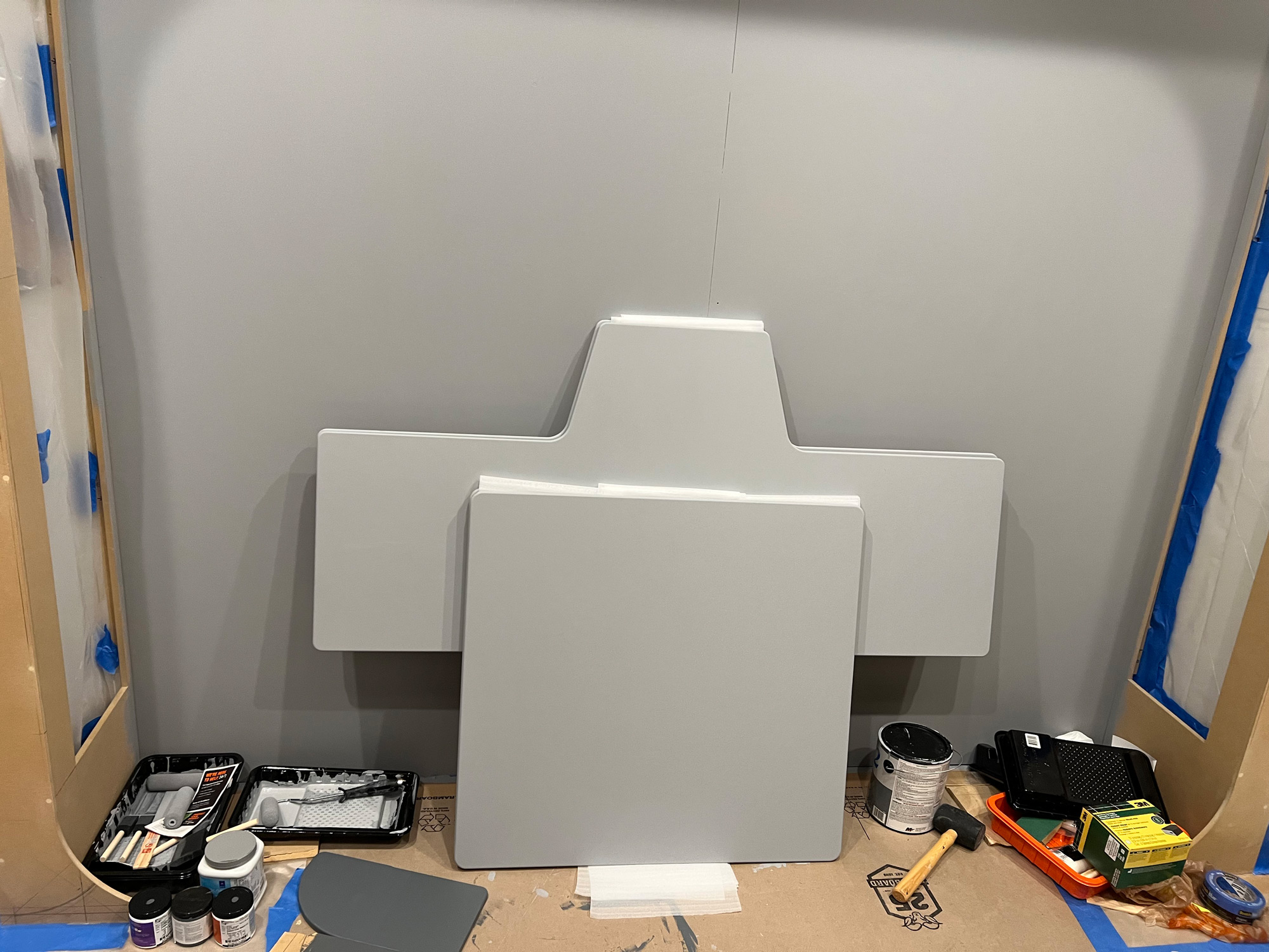

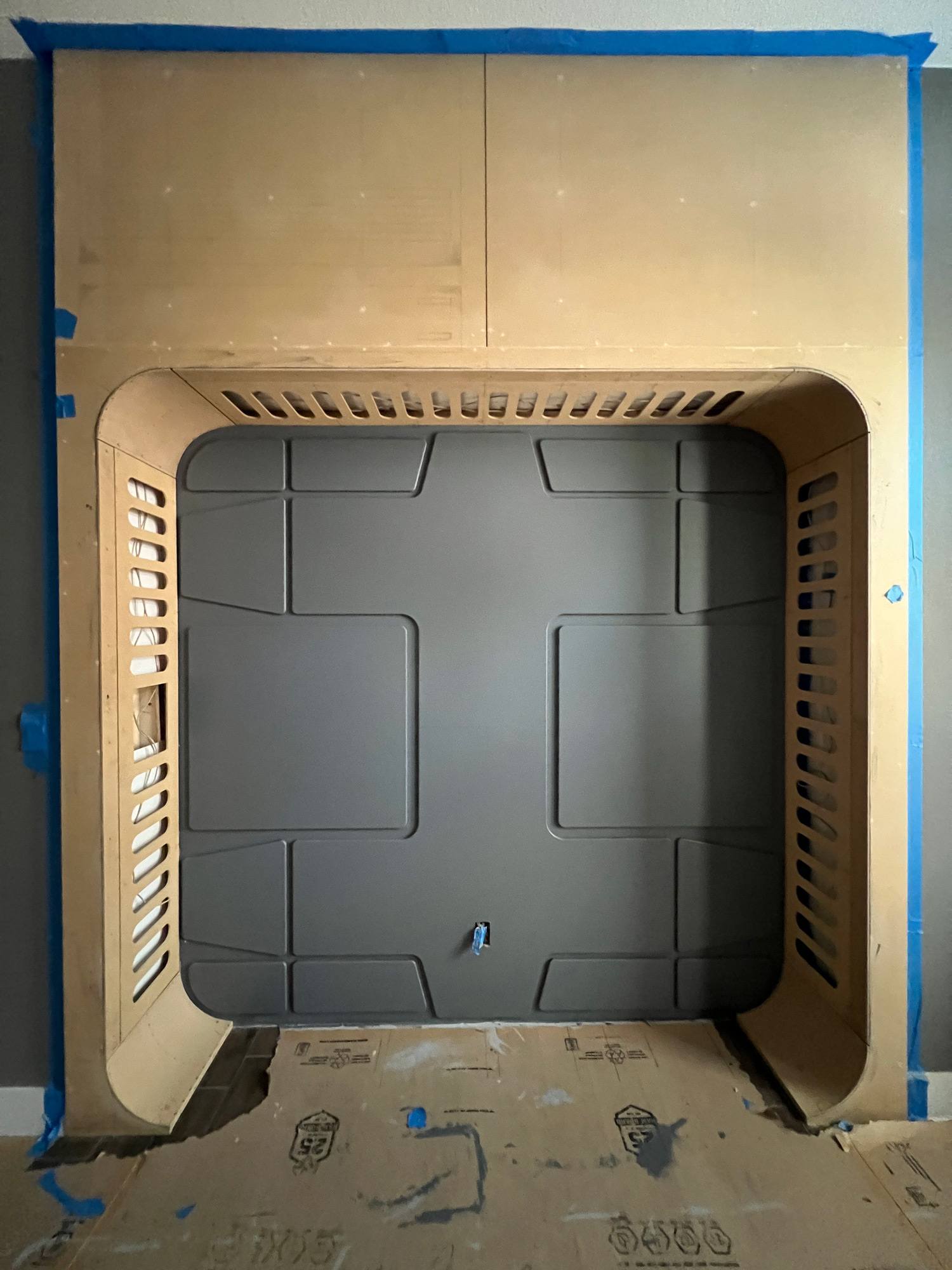

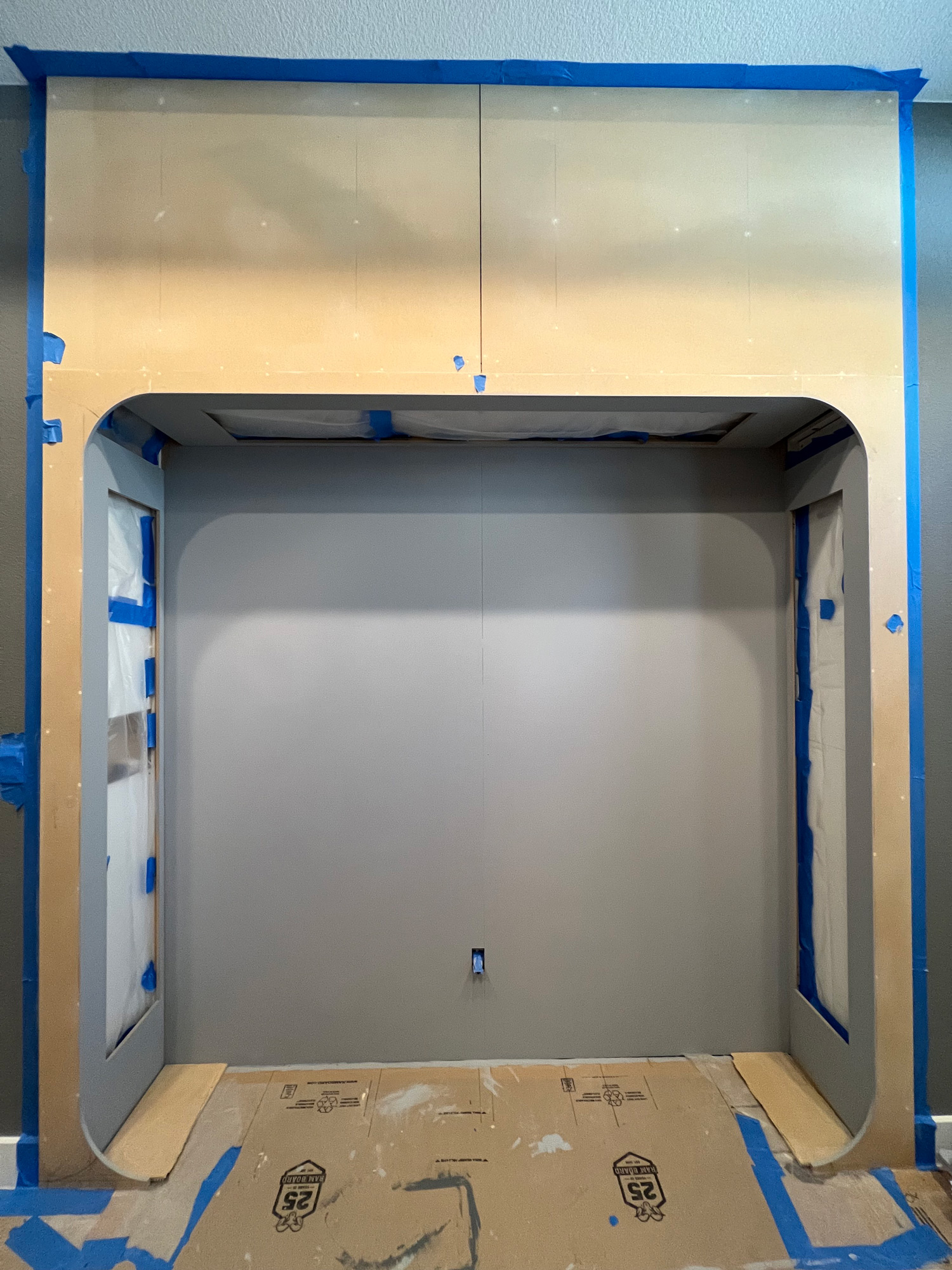

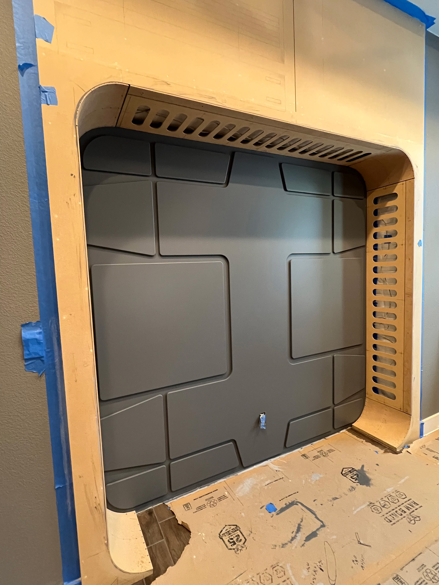

Some more progress… I used wood filler over the screws and sanded them down. I lightly scrubbed the surface with an orbital sander to smooth it flush with the MDF. Then, I cleaned off the excess debris and applied 2 coats of gray primer paint over the interior surfaces and the back wall shapes.
