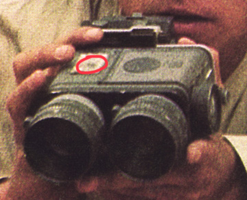

i dont know why you guys seem to think the seagull knob is painted ?
if it were black it would look just like the rest of black parts on the prop.

I think it looks more black in the tusken raider photos like Trents post. But, its 50:50 in my mind on the vaporator photo. You could argue that it looks as black on the vaporator shot as the inner rim of the lenses. They could both just illuminated by the sun?

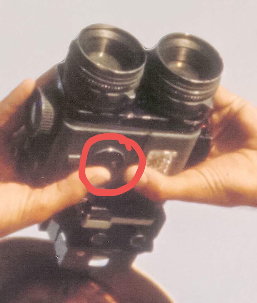

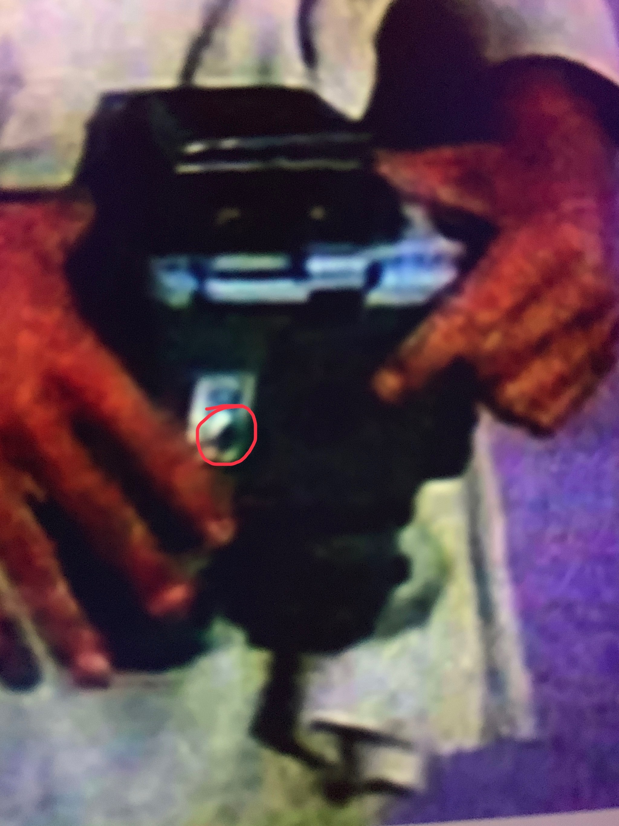

Has anyone identified the larger bubble or element that sits on top of the honeycomb bubblestrip?
In some shots it looks light, in others dark. Not sure if it’s reflective or clear.
I haven’t seen anyone include this.
Pics? Not sure what you’re referring to
Sorry. Was posting from my phone and couldn’t attach pics.View attachment 998451View attachment 998452View attachment 998453
At first I thought it was just the Eumig logo coming through distorted by the bubblestrip, but it doesn’t seem to correspond to any part of the logo plate beneath.
And in the sandpeople scene it seems to protrude above it.
I can imagine if it’s a larger clear bubble it may create this kind of dot (like a cyclops/water droplet) over a date on a watch face.
Weird, I always thought it was the Eumig name plate peeking through the bubbles, now I'm not sure WHAT I'm looking at.
I'd say that yeah, they're black, and that is just some turbo bright Tunisian sun.

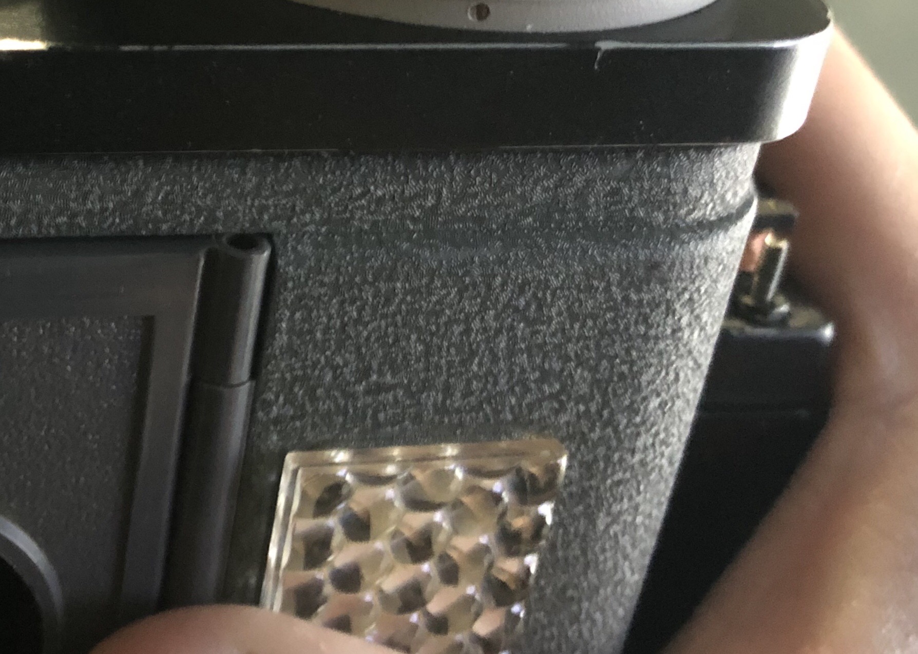

I added the disc on mine. In this photo I can clearly see it, even though it could have fallen off at some point during filming.
I can still see the nubs in this pic if I want to.
But I'll totally agree that the plate could've easily been there at one point, and fell off at some other point.

I’m now convinced that there’s a bigger bubble sitting on top of the bubblestrip. I’ve played with my eumig logo plate and bubbles and I can’t get that big black dot from any angle with those two things alone.
If I am right, I wonder if it’s this lens:
UNLESS:
A very shiny screw to bolt the bubblestrip on. Could have a bright reflection when facing upwards and a dark one when reflecting a Tatooine night sky.

?? I mean I kinda see a darker shadow looking patch on some angles but nothing that indicates another raised part.
Do you see it here on this closeup? to me that's just so clearly the black part of the Eumig plaque that says "servomatic"
I agree, I don't really see another part there, per se, but it does look funky in a couple shots.
I don't see the folks who made this prop sticking something on top of them pretty bubbles.
I convinced myself the other day that I could see it in that shot. Now I’m not so sure.
Another way of explaining the black dot is something other than the logo BENEATH the bubbles. Like a dollop of dark epoxy to hold the bubbles on.
