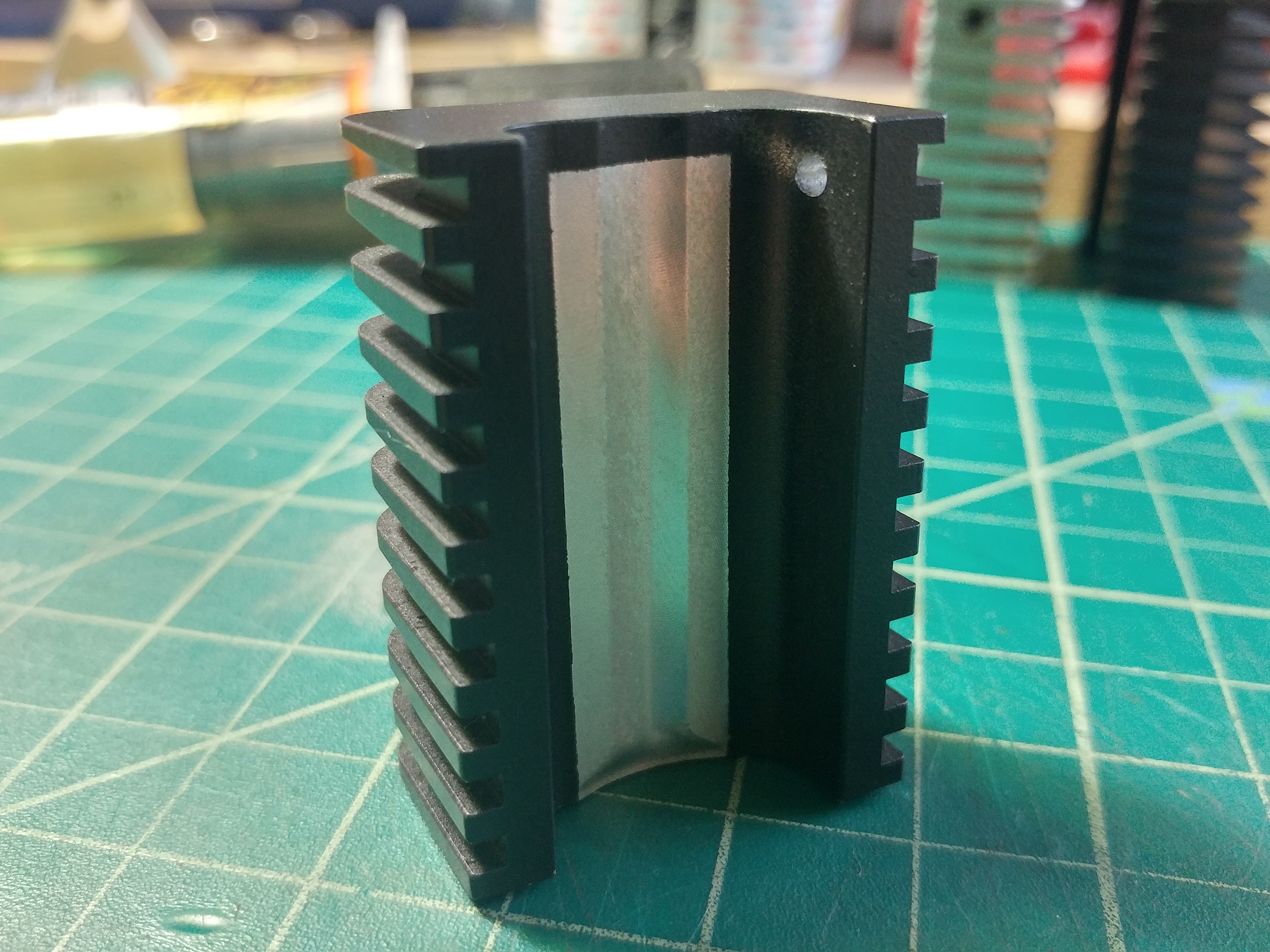

As for those "minor details", I've finally purchased one of Field Marshall's raw aluminum heat sinks ((EDIT: I ended up selling the FM and going with one of Solo's Hold's replica grills). That will replace the Corellian Exports anodized black grill that I've had mounted on this blaster since day 1, which will go up on the Junkyard soon, if anyone is interested in picking up an affordable, metal heat sink for their GK or custom build. I'll paint the new one satin black and mount it once it arrives (should be any day now).

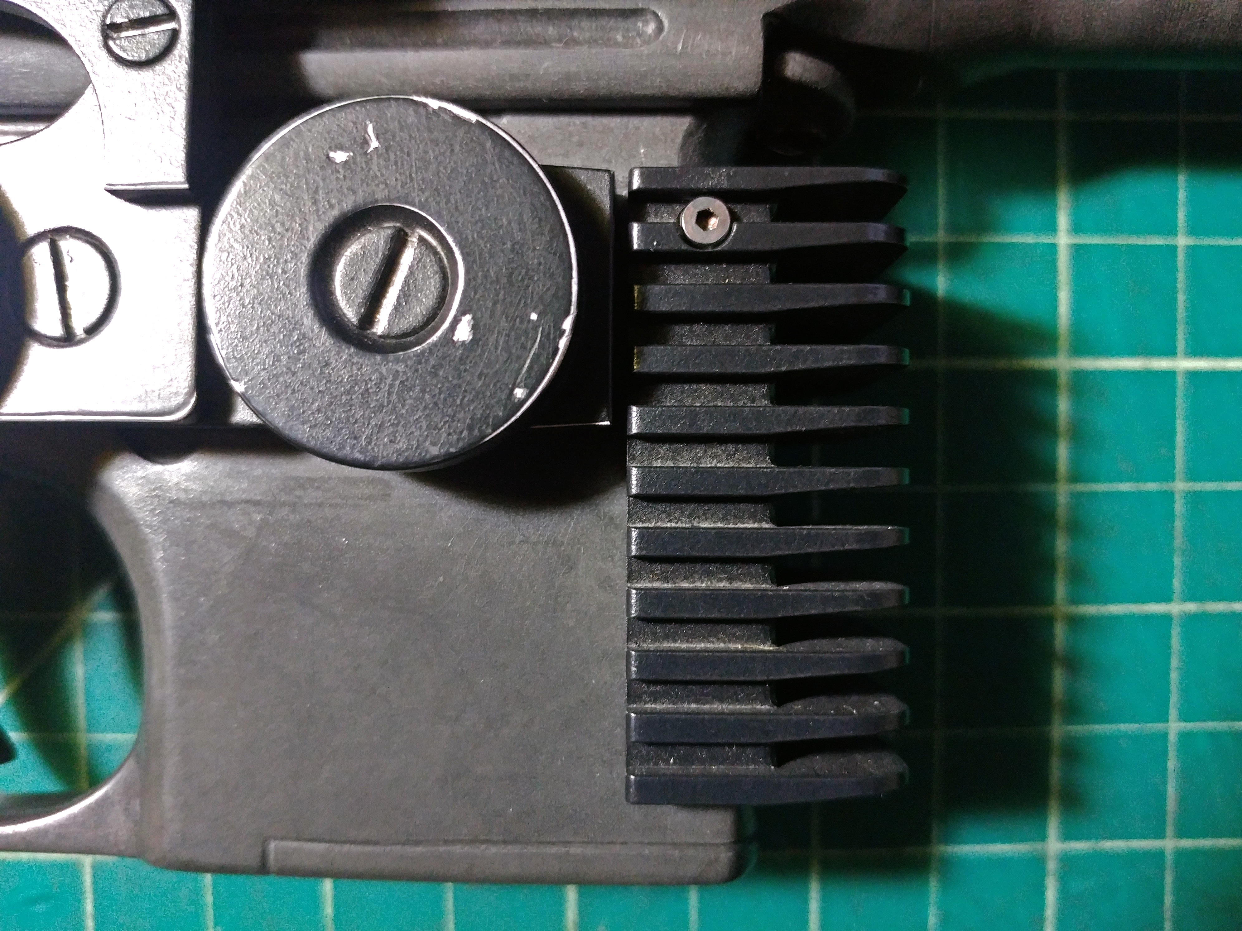

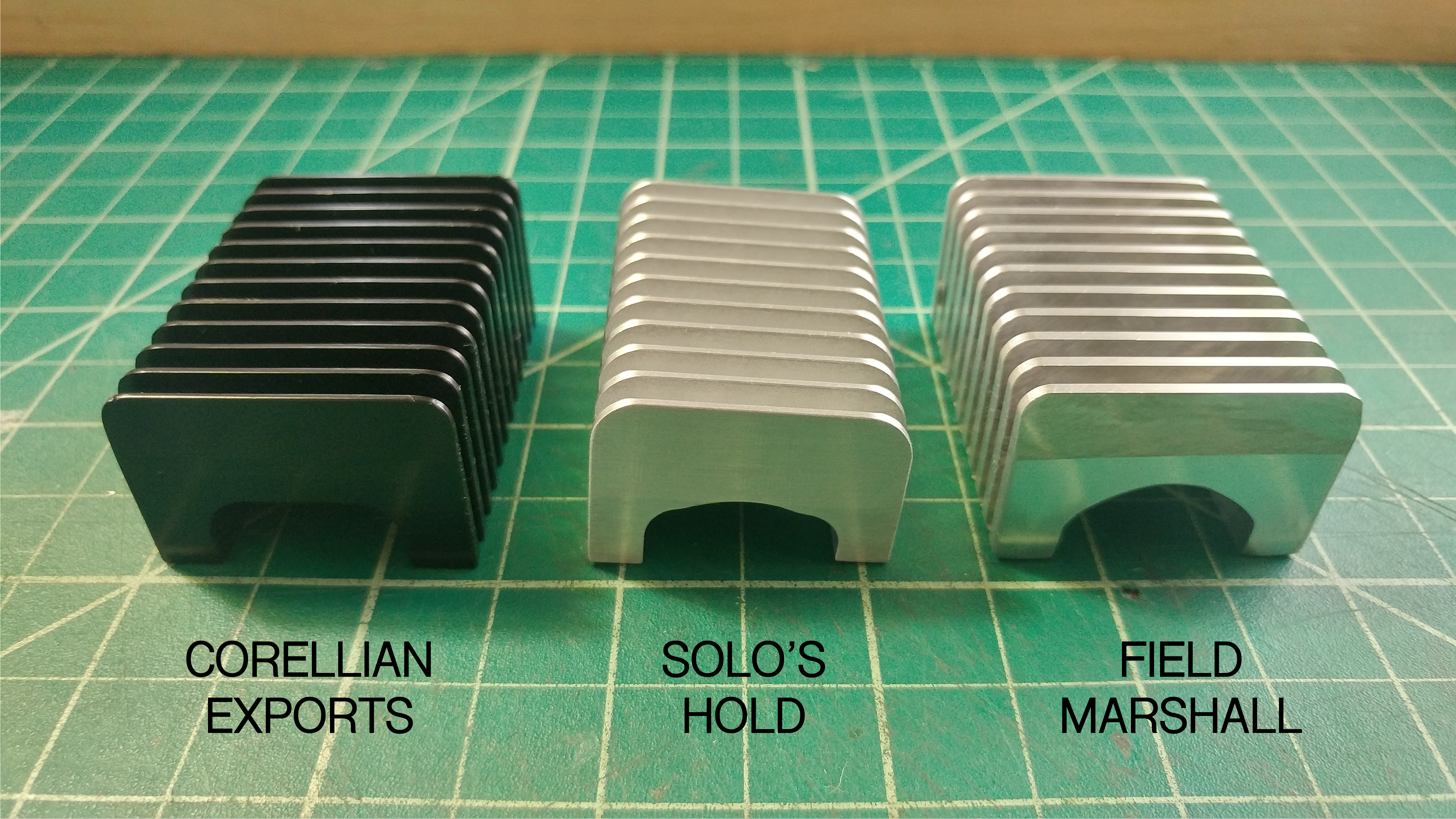

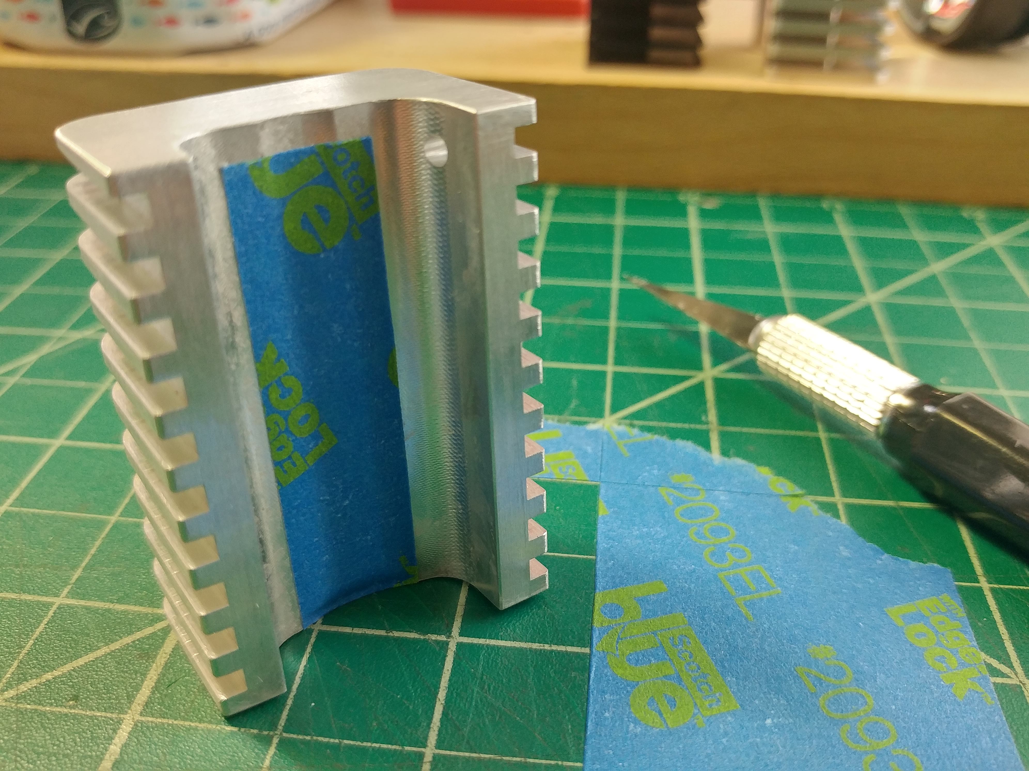

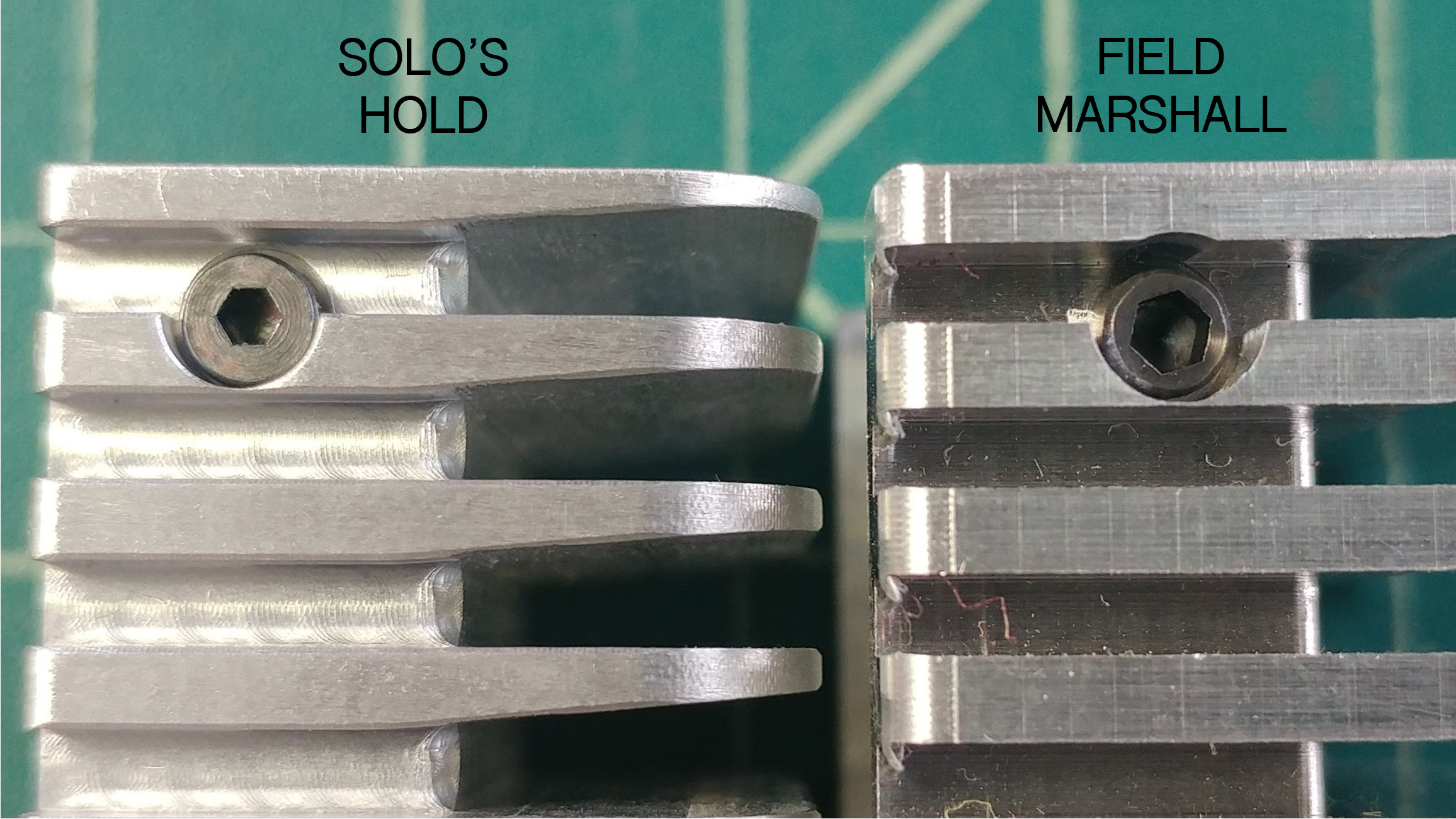

So after some thought, I ended up ordering one of Solo's Hold's GK grills to compare to the Field Marshall grill that arrived this past week. After looking at them side by side with my old Corellian Exports 12-fin, they all have their merits but I've decided to go with the Solo's Hold grill. Here are some comparison shots of the three replicas. The other two will be up in the junkyard soon, if anyone's interested ...
I gave the grill some satin black. Once it's dry I'll weather/mount it according to the promo photos, as I've attempted to do so far. I plan to use epoxy to mount it, as I don't think the provided bolt would get much of a bite on the Denix (hence the lack of paint on the backside). It seems likely the screw was used to mount the heat sink on the actual prop, but my particular Denix just doesn't seem to line up that way. Anyone have input here?

Yeah, I've got the Field Marshall grill on my Greedo Killer grill on my Denix. It definitely needs to be epoxied on. The little screw does nothing.
Agreed! I gave the front of the Denix a couple strokes with a file and a bit of epoxy, and it's mounted! I set the grill's screw with a dab of epoxy as well, as the hole was already too big to be tapped for it:
Stay tuned for another update this week, as I have a part update arriving.

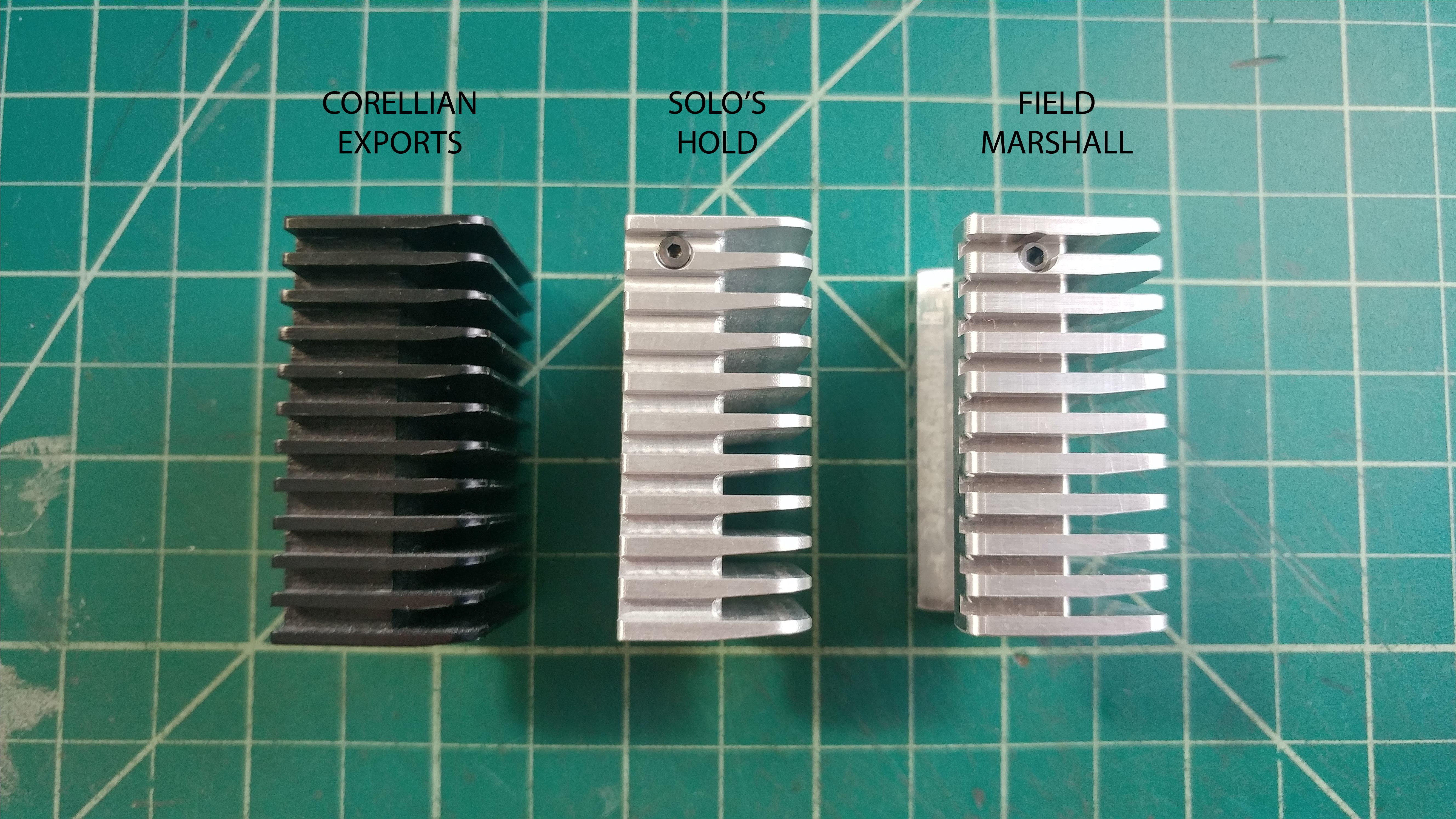

So, which one is which in these pics?
Thanks!!
Dangit, Chris's just HAD to be the one with the FAT fins!! LOL

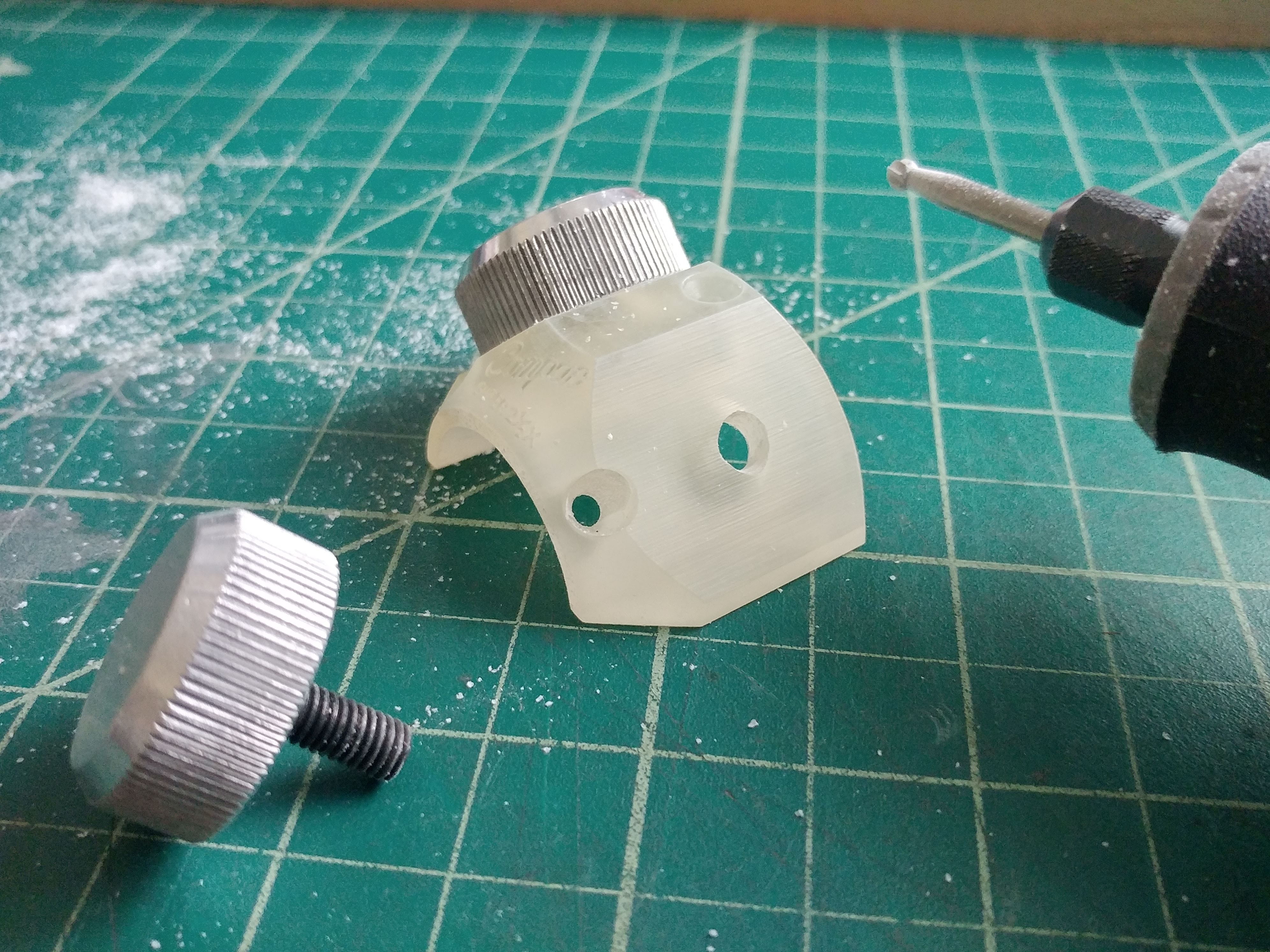

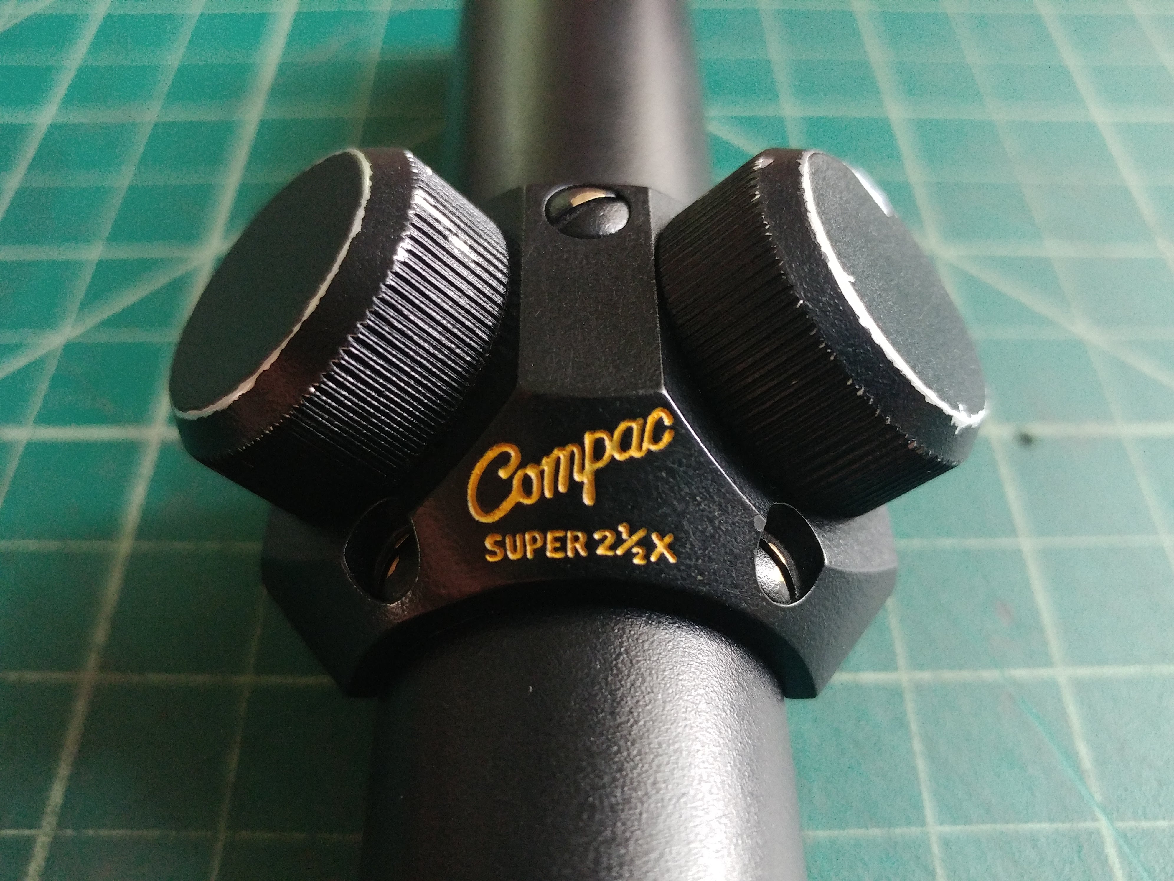

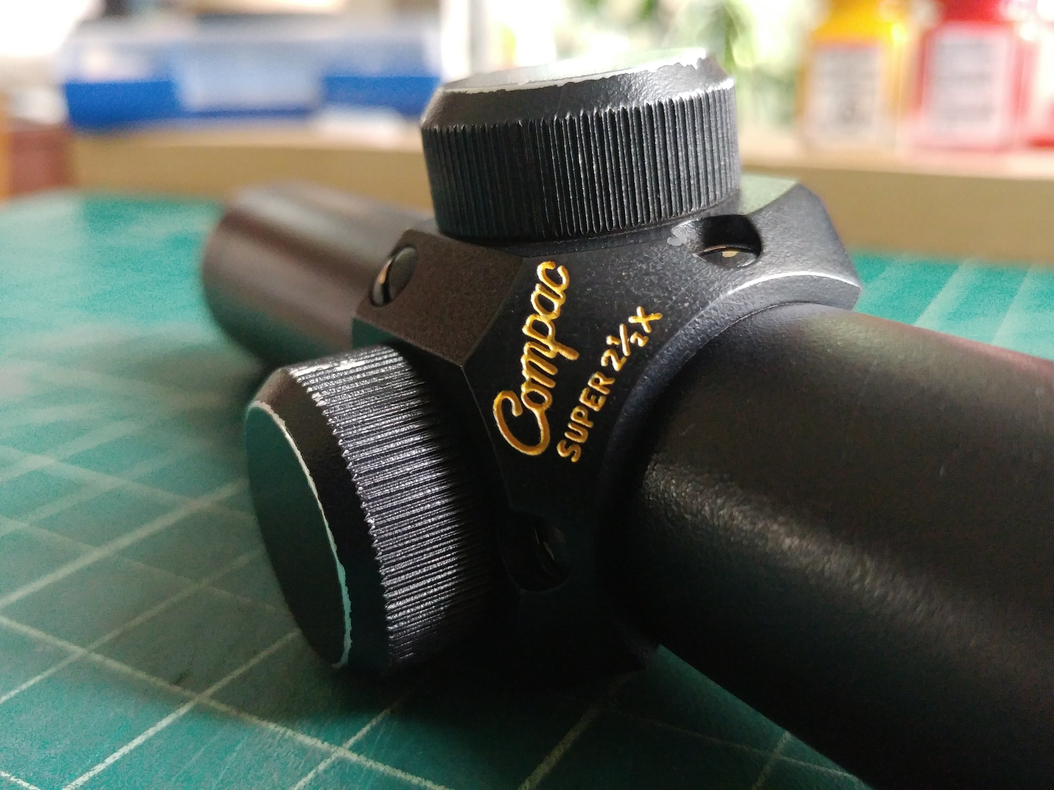

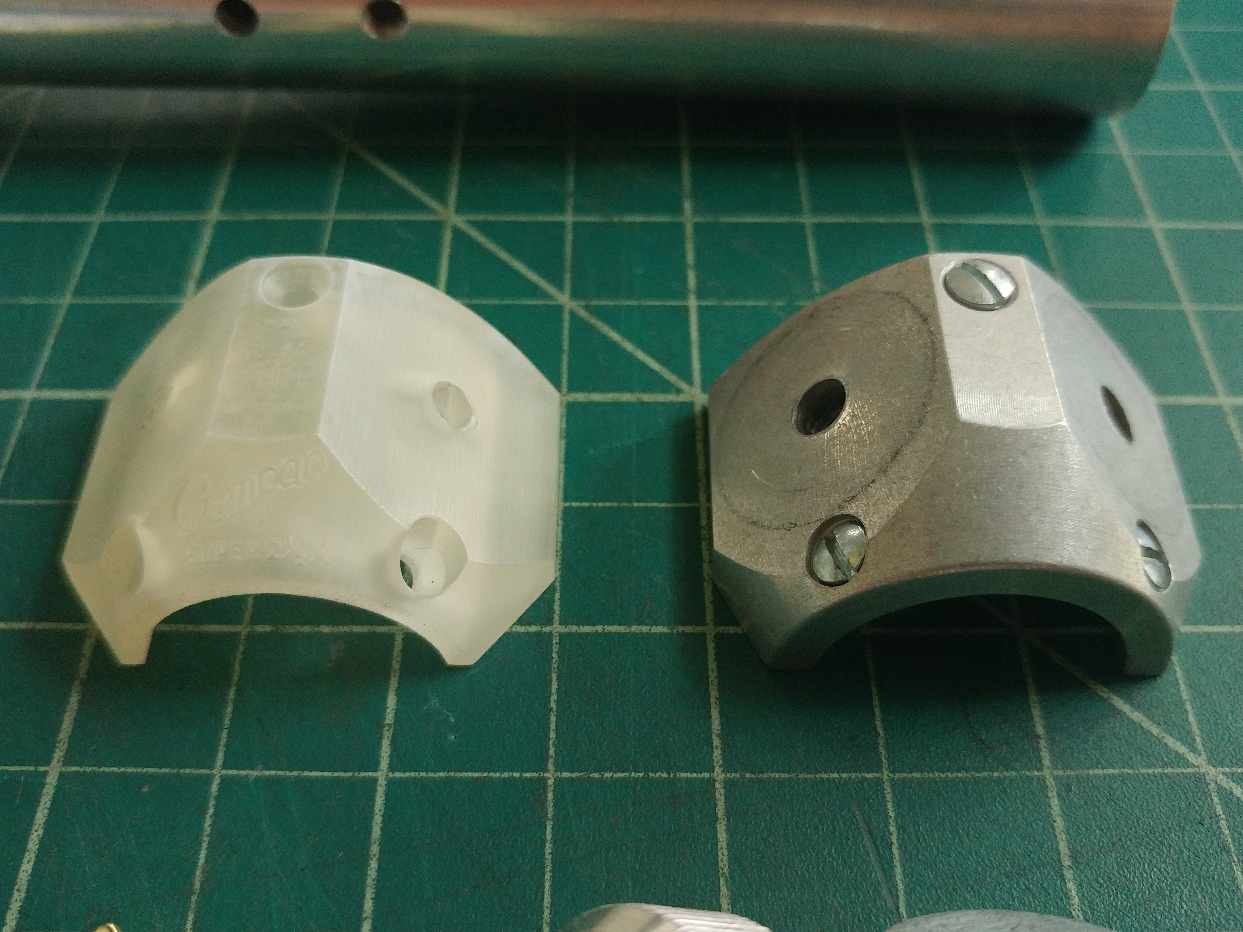

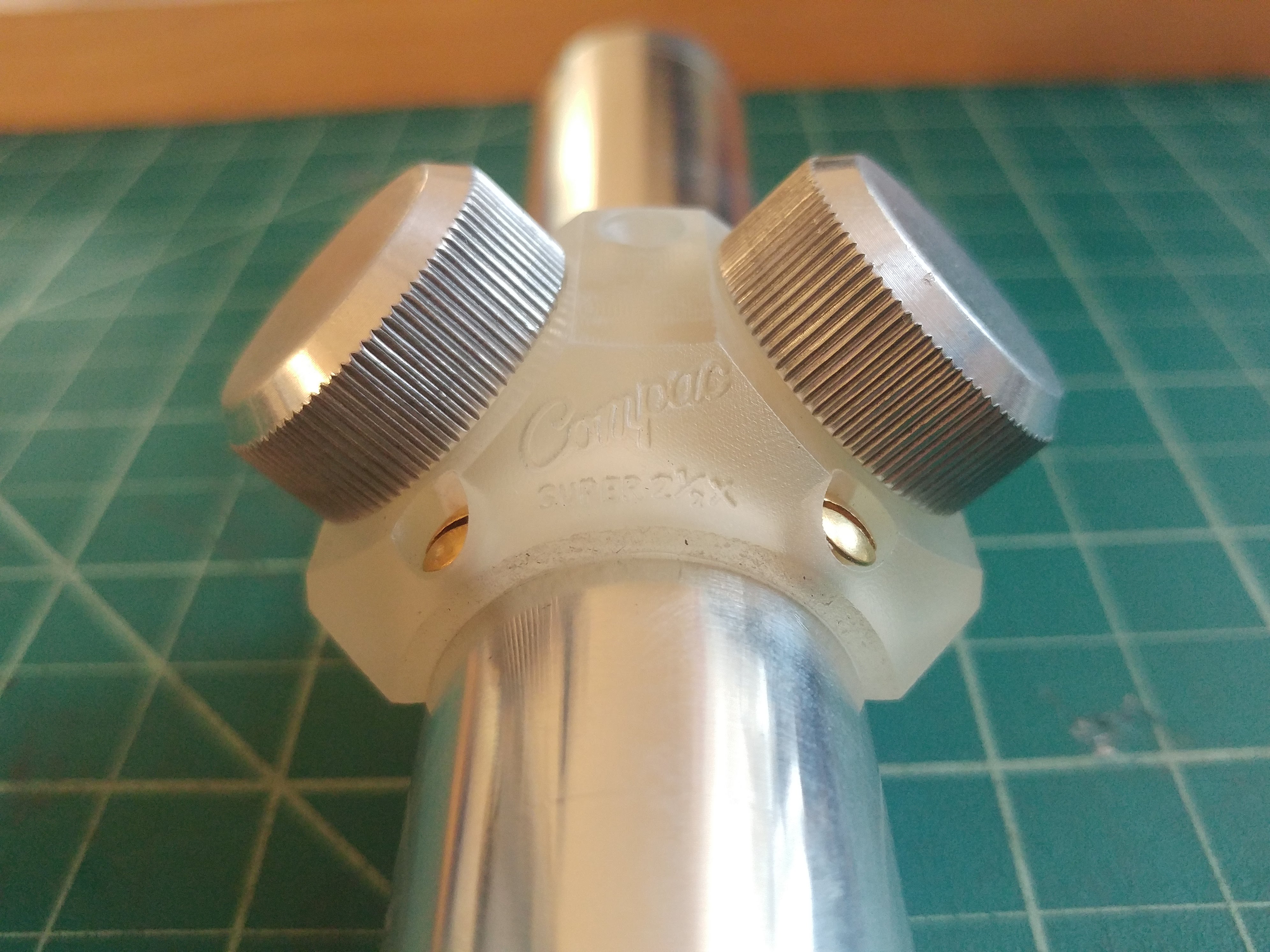

First off, I printed up one of chubsANDdoggers new Compac scope saddle replicas. It's designed to mount on to his printable full Compac scope kit, but I've decided to mod it to fit onto my metal Field Marshall scope. I've never handled a real Compac, but this seems to be the most accurate attempt at the saddle yet. It's the correct model (2 1/2X) and features the logo engraving on top (though unfortunately not the serial number on the side).
It mounts using the same logic as Field Marshall's saddle, so all I had to do was widen the holes for Field Marshall's windage knobs and it fit right on there! I also managed to find some of the proper brass screws. I've been told that these screws are brass on the real deal. Can anyone confirm?

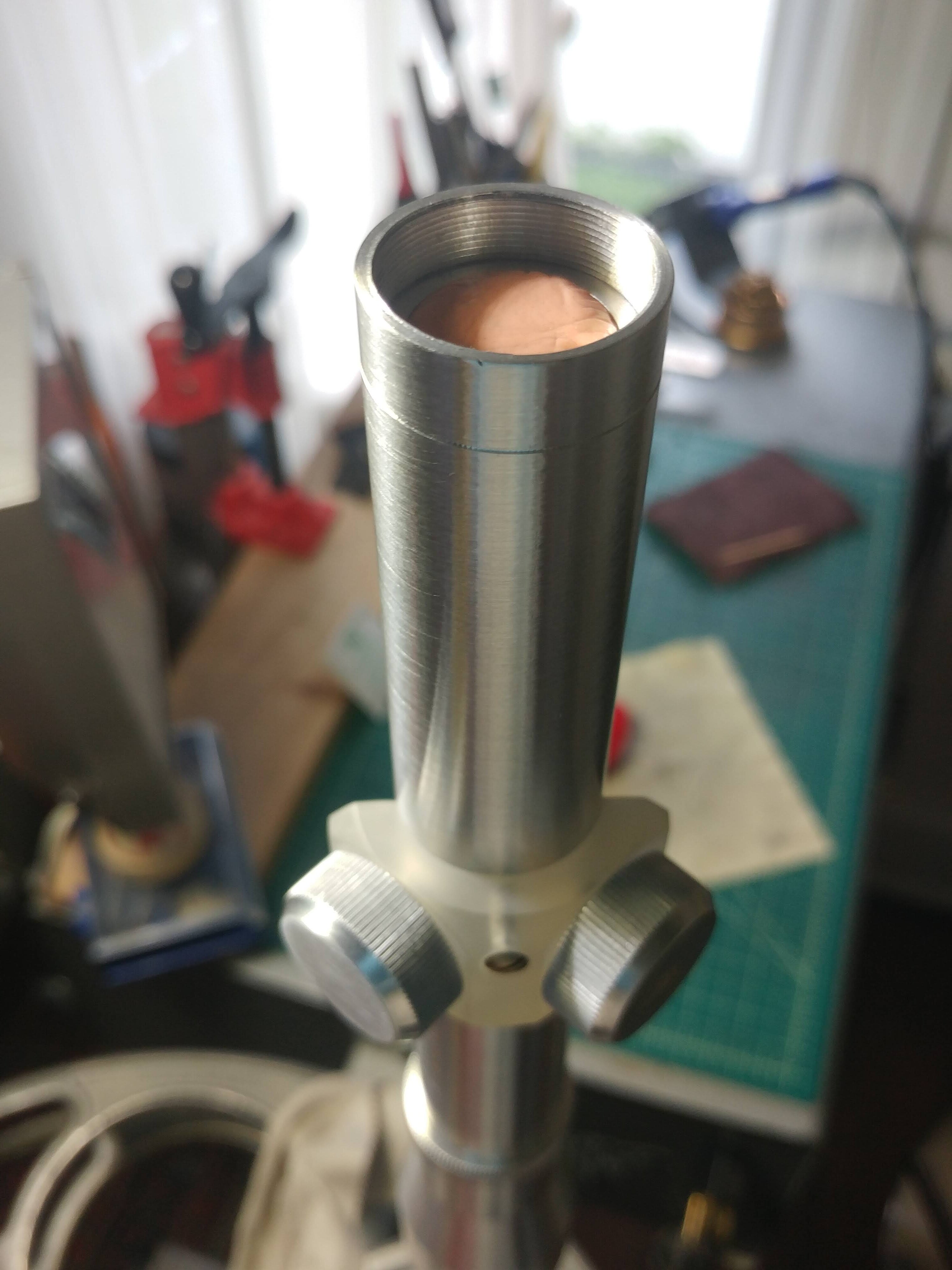

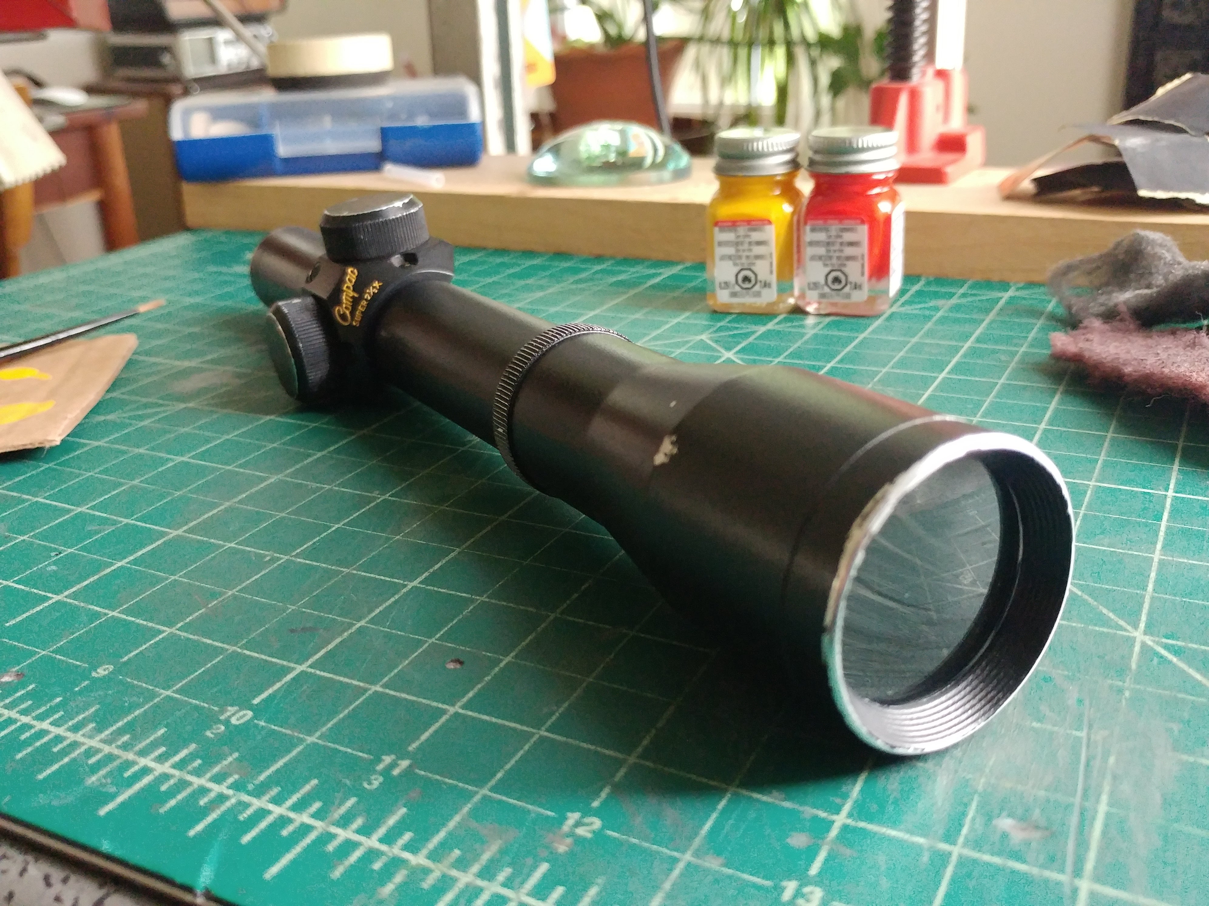

I did purchase a second Field Marshall scope, as I wanted to start from scratch with these updates, but when it arrived I realized that since his design change, it's now far easier to assemble, but it doesn't have the threaded detailing where the small lens mounts. So, after some thought, I decided to set this new scope aside and dismantle my first Field Marshall scope to reassemble with my printed saddle and updated lenses.

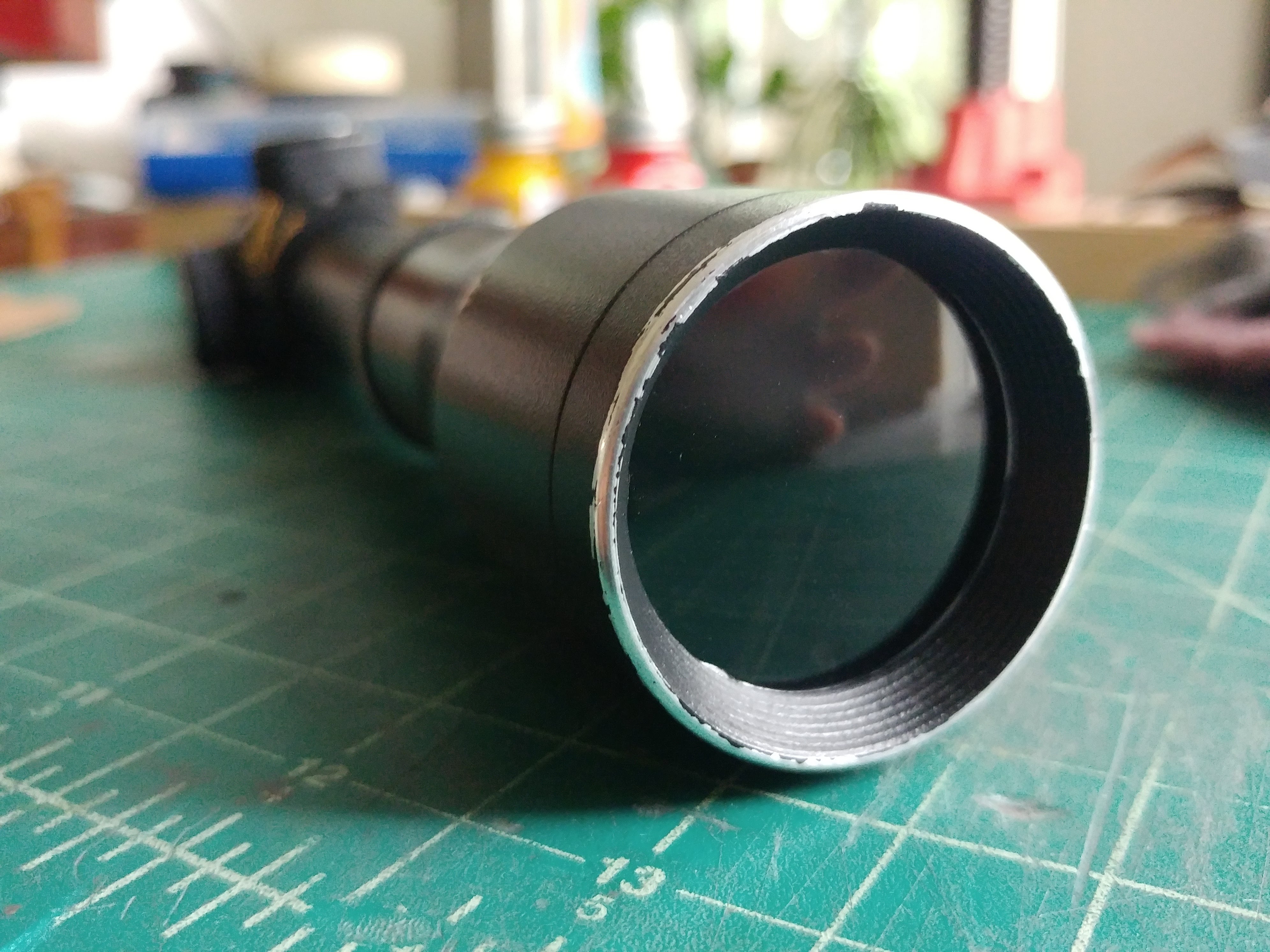

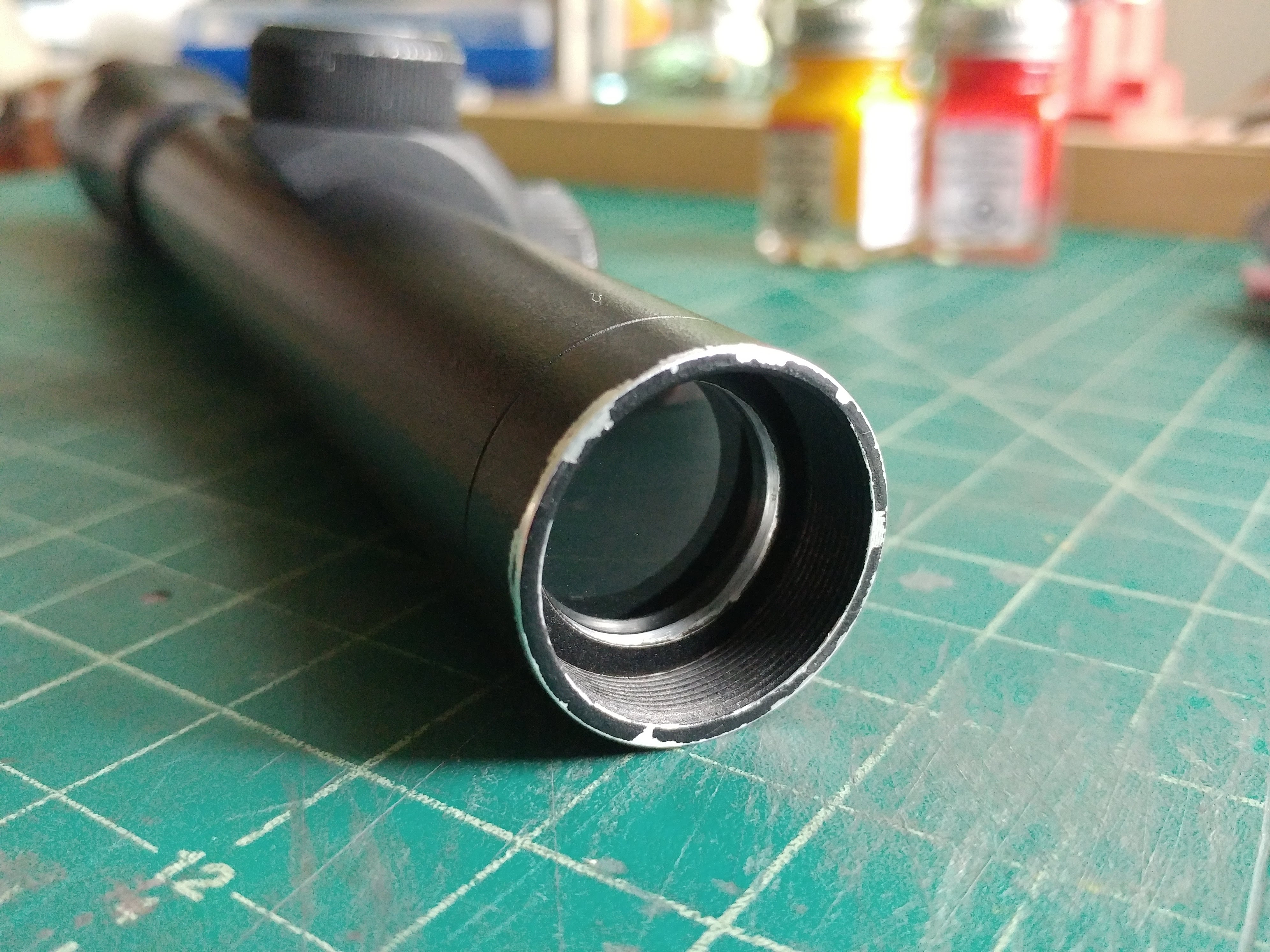

Step one was to remove the lenses. I carefully punched the smaller one out with the butt end of a screwdriver, and the epoxy gave a clean break. The larger lens was more complicated, as its retainer is a separate, pressure-fit piece. The fit was much tighter on these older versions of his replica (I had to pressure-fit this one with a bar clamp) and after trying to pull it out with vice grips, I managed to chew up the retainer ring pretty badly (as well as a bit of the main scope body), but it came out. The lens retainer is toast (good thing I have another one from the new scope) but I was able to repair the gouging on the scope body with a bit of JB weld and some careful sanding.
To strip the paint, I decided to try "Citristrip" after hearing some positive reviews here on the RPF. It's citrus-based (allegedly) and supposed to be less toxic, but it worked great to strip the Krylon from the scope. I got it in a rattle can, which is pretty convenient for application. Would recommend! Once the paint was stripped, the smaller threaded lens retainer screwed out effortlessly.

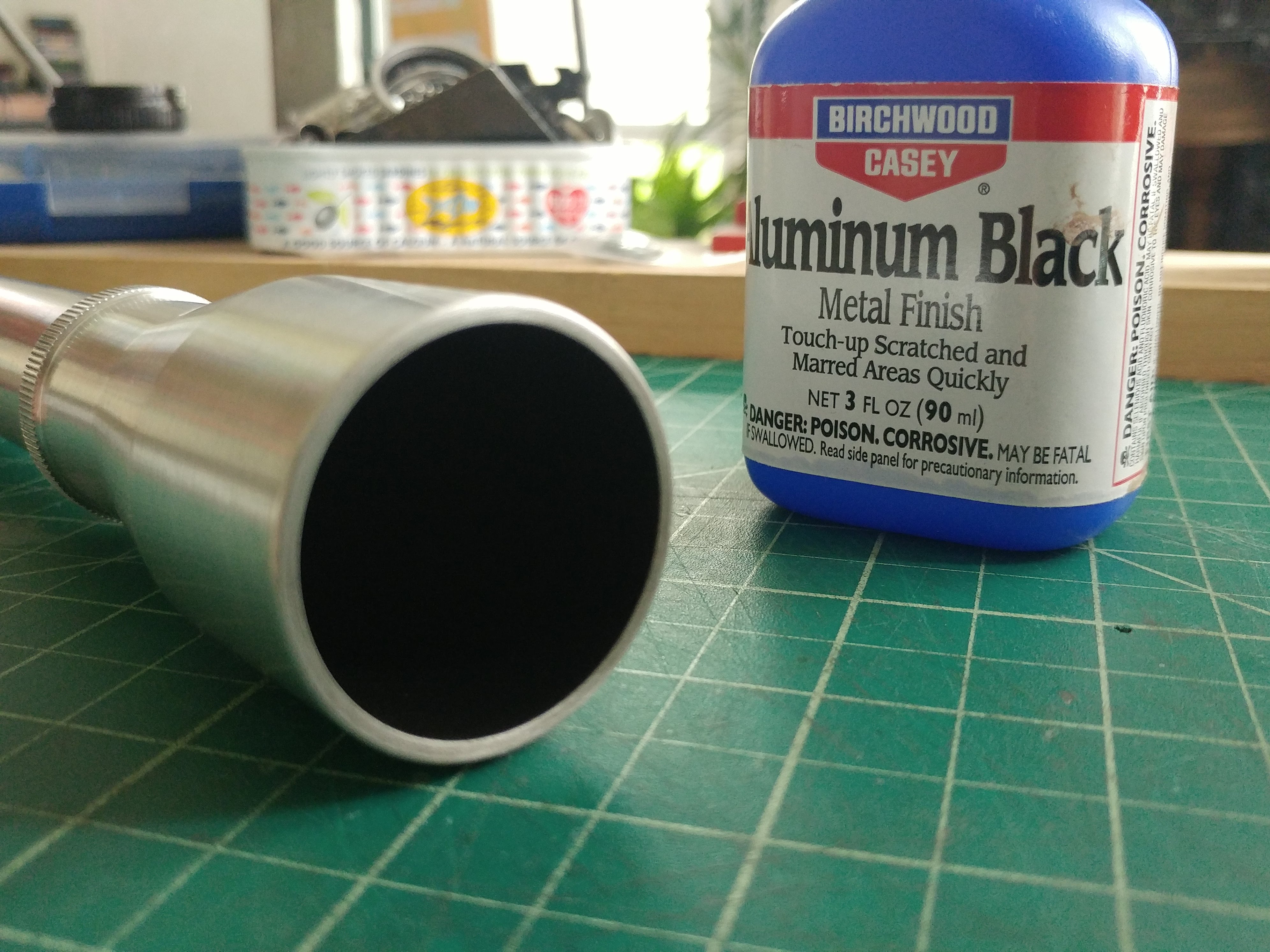

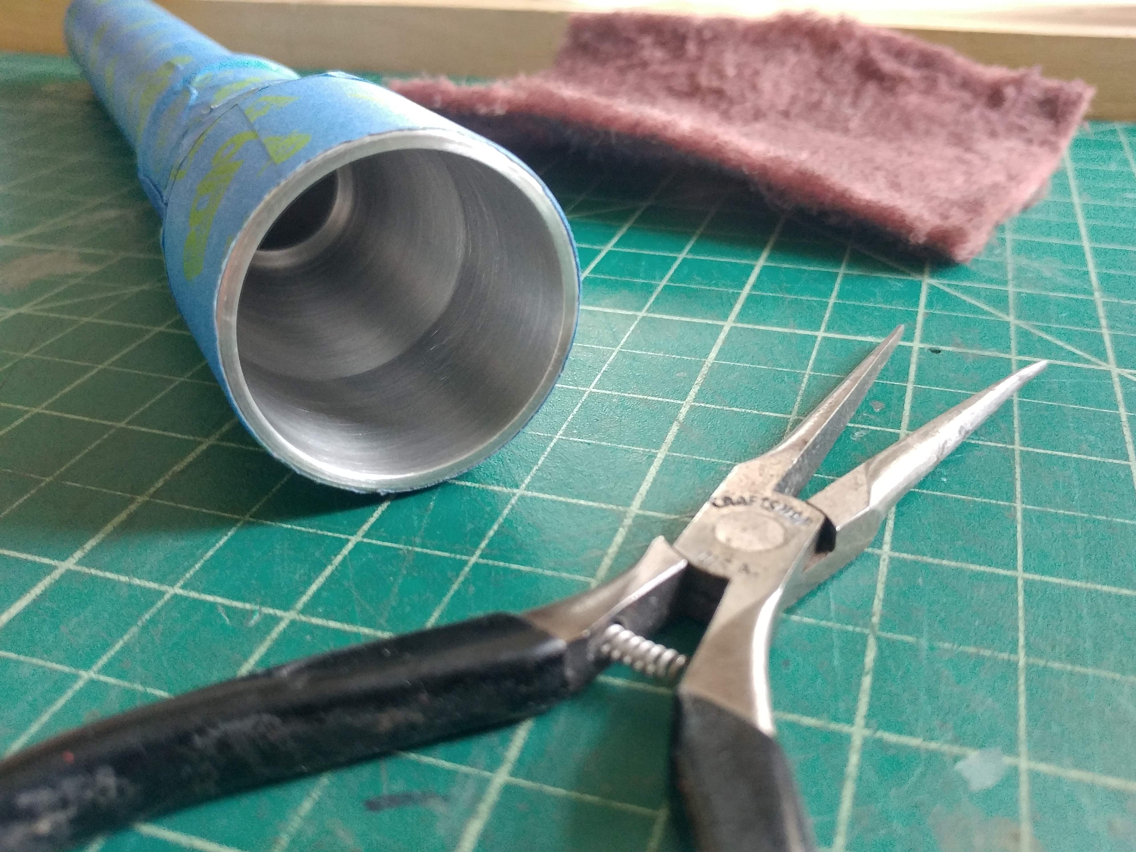

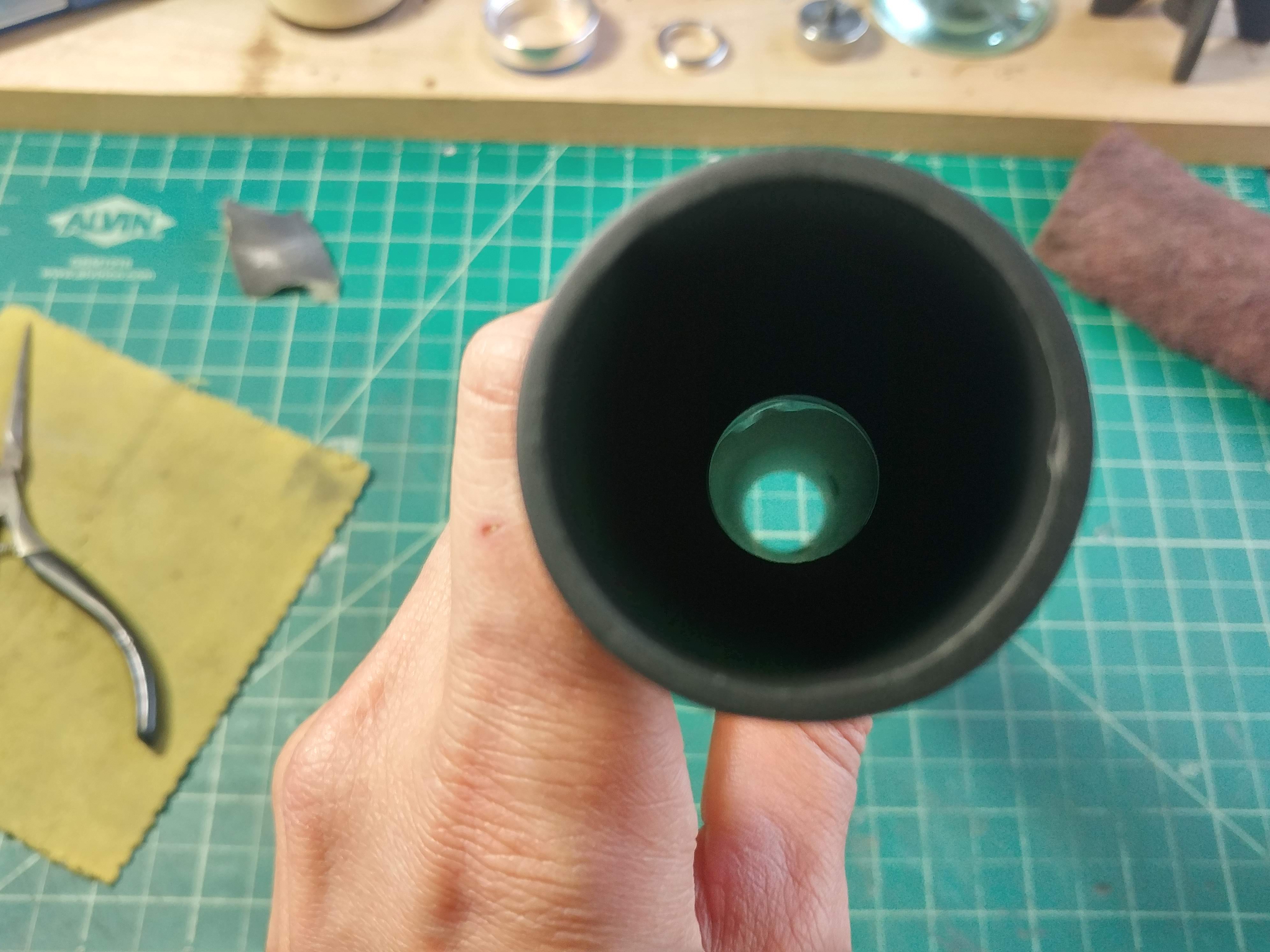

Then, it came time to approach darkening the interior of the scope. I hate looking through the scope to see light bouncing around due to the bright aluminum. On my first 2 scope builds, I played it safe and opted not to attempt to paint all the way through, for fear of the paint accumulating and dripping. I could always notice the aluminum when looking through it, which majorly broke the illusion of a working scope for me. So, this time I decided to try aluminum black to darken the inside. To make a long story short, with careful prep, it worked beautifully, but didn't last long.
After a few hours it started to rust, and the inside lost practically all of its darkness (I didn't get a photo of this). Typically I'd use oil or somthing to prevent this from happening, but I didn't like the idea of anything oil-based inside the tube once it's sealed up. So, having tried that, I've decided to go for flat black paint in a rattle can. I've had some luck experimenting with different processes for this, but this is what has worked best so far:
To prep the inside for paint, I first masked off a 5mm strip at the opening of the wider end so that I'm not putting epoxy on paint when it comes time to mount the retainer. I also masked off the threads at the smaller end so that they wouldn't get gummed up with paint. To prep the surface, I use a rolled-up Scotchbrite pad to buff the inside of the scope. I then mask the outside of the scope to minimize unwanted spray there, and paint the inside using a series of short blasts. I've yet to achieve full internal coverage without getting some drips around the inner rims (see below) ...
Once this dried though, I buffed it more with the scotchbrite pad and was able to get rid of those drips:

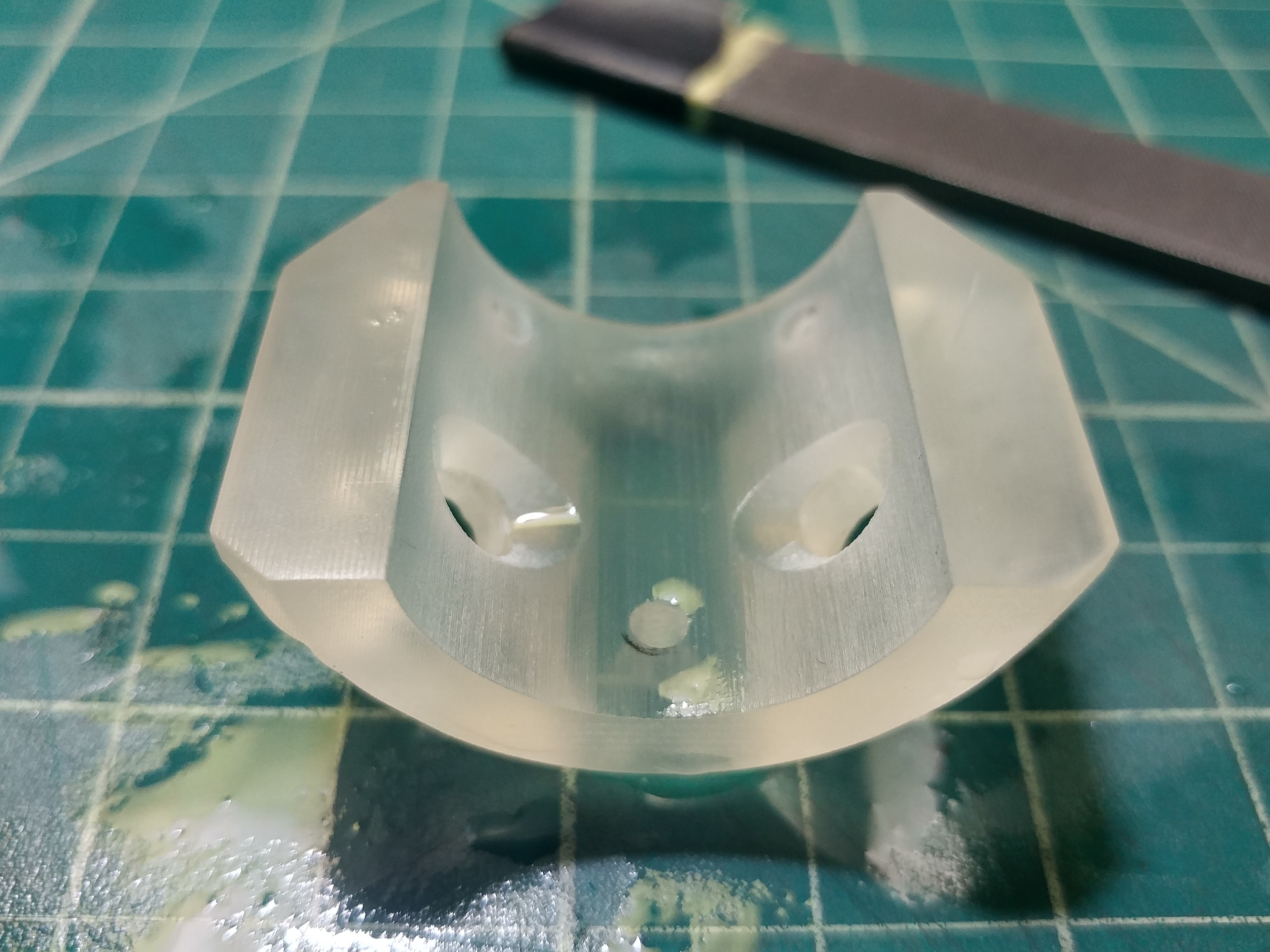

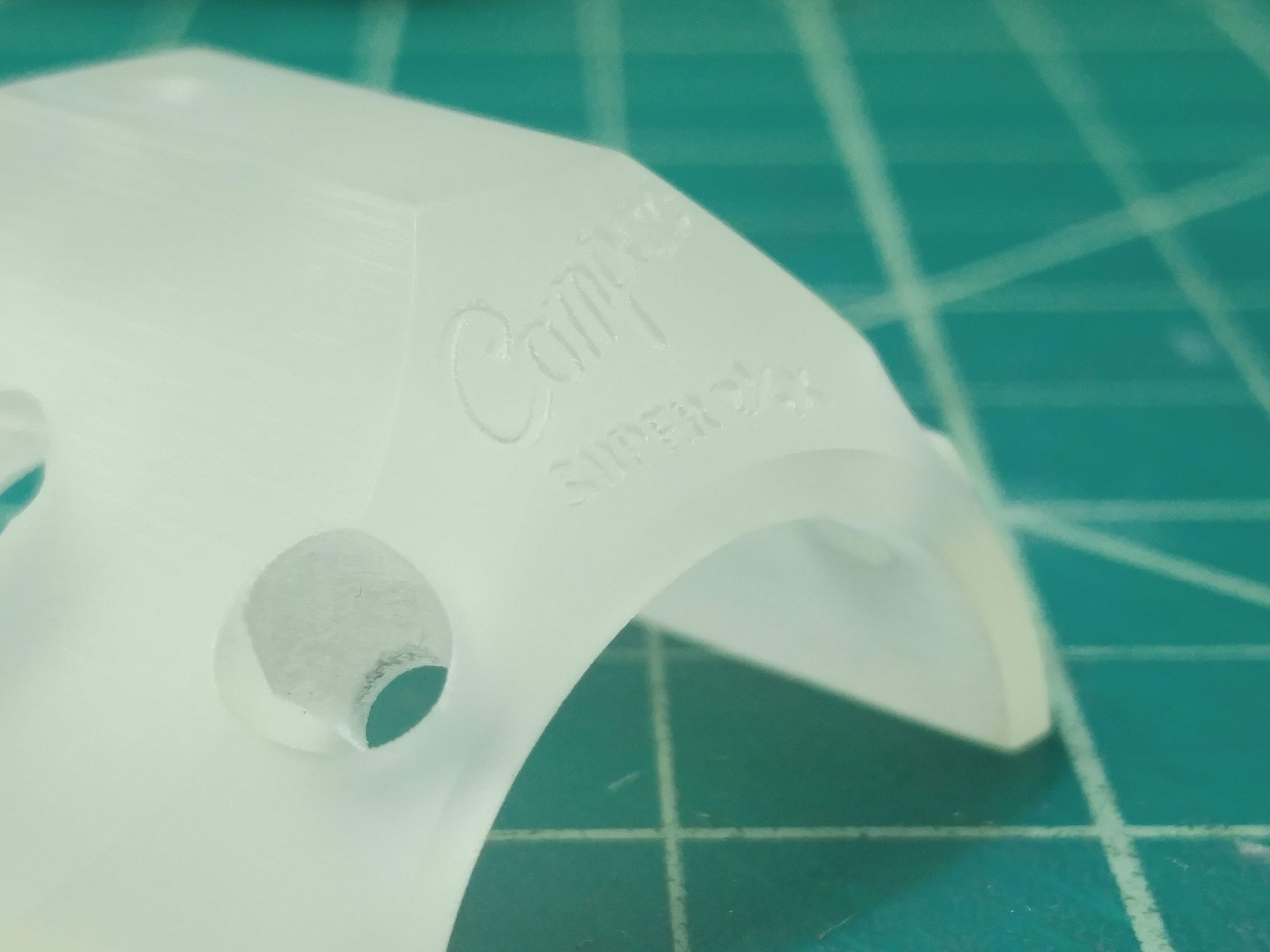

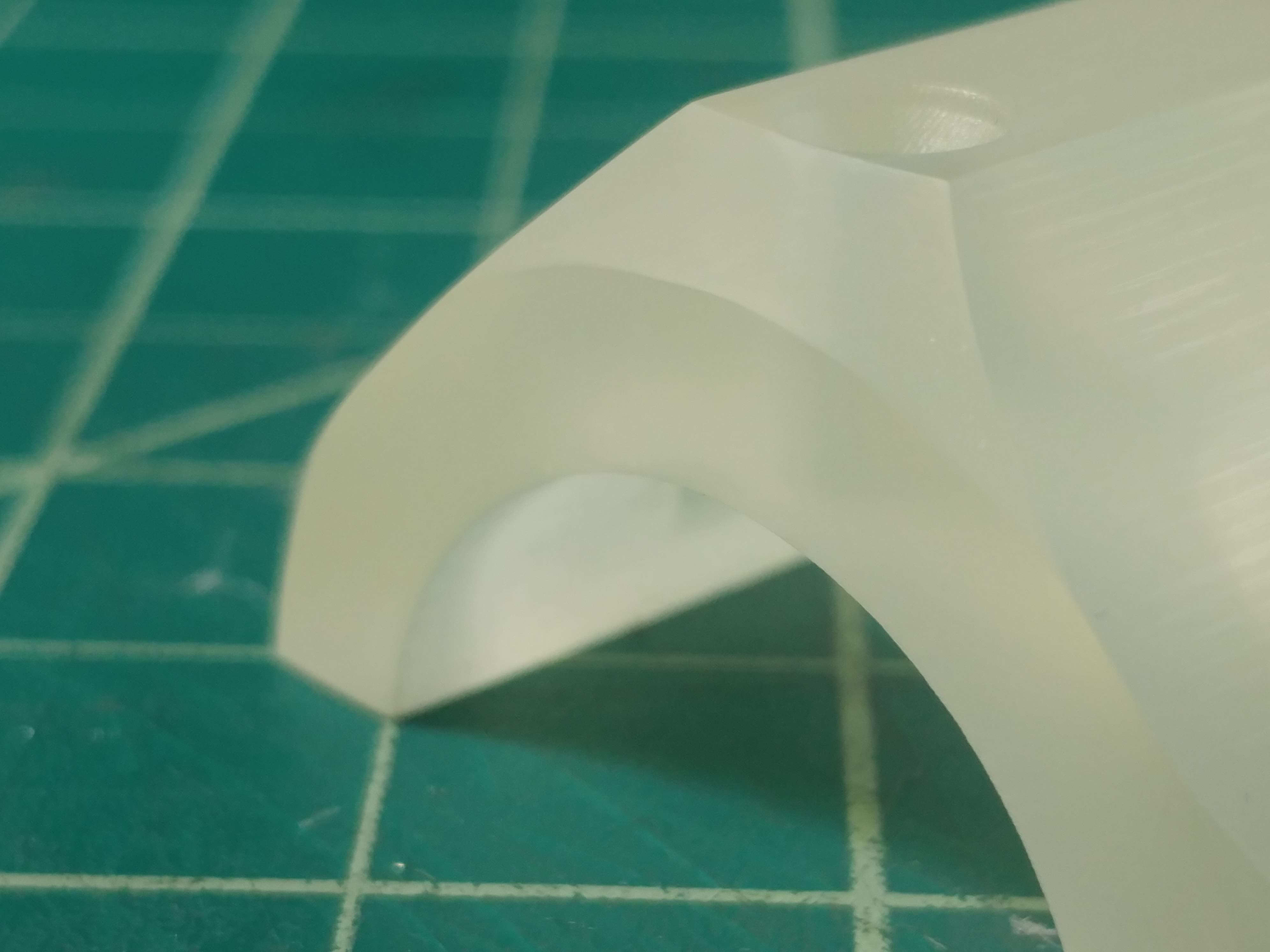

This chubsANDdoggers Compac scope saddle print is of super high quality, but I gave it a light wet-sanding with some 600 grit to make it as smooth as can be. You can see the very mild print lines on the left side, compared to post-sanding on the right:
All prepped for paint:

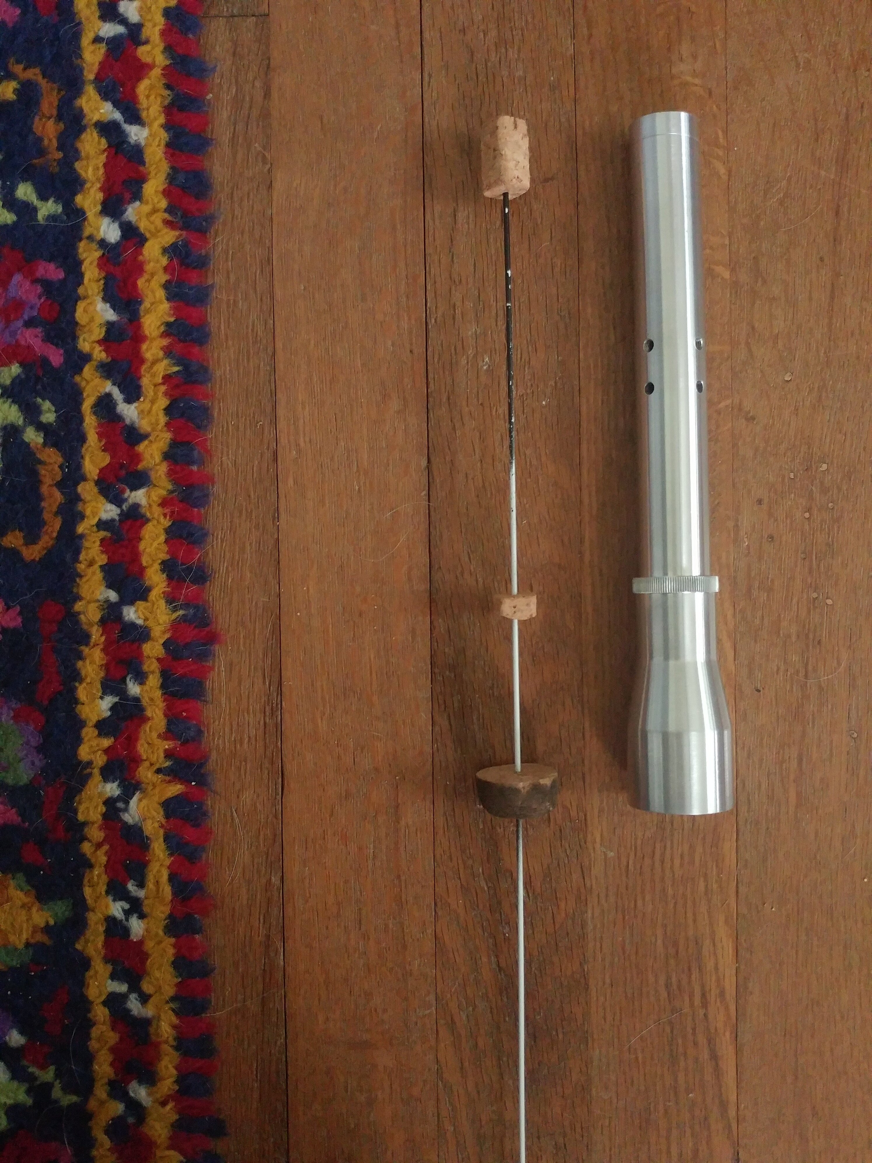

After having done a number of these scopes, I decided to make a simple rig to hold the scope for painting. I trimmed down some corks so that the wire wouldn't make contact anywhere inside of the scope, as it's nice and pristinely painted in there (I ended up re-painting the inside since my last post ... it looks much better now).

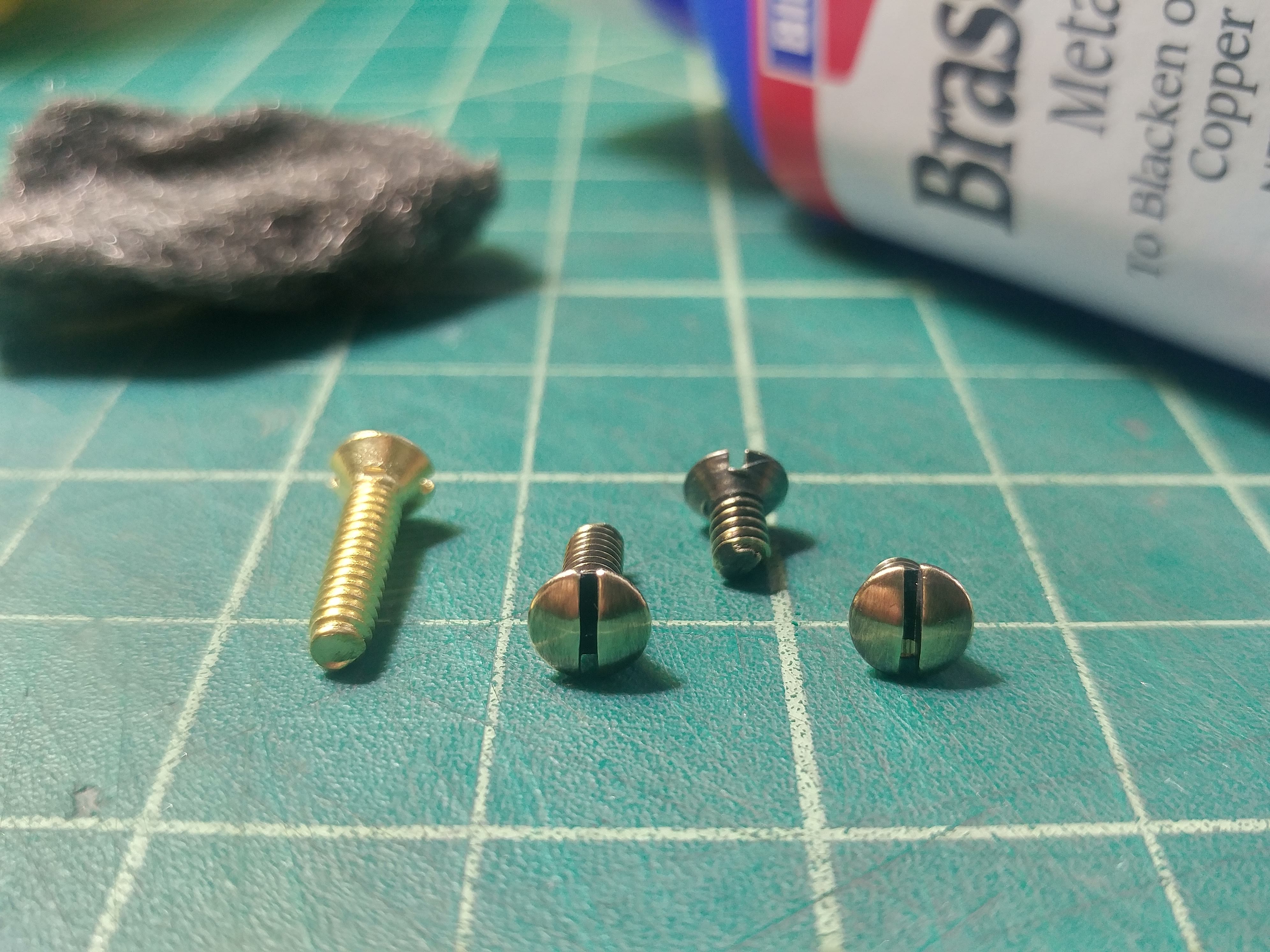

I trimmed and weathered some brass 4-40 screws, then set them into the saddle with a bit of epoxy before painting:
I used silly putty to mask off the smaller lens once I had it threaded back into the scope body. The silly putty came off very cleanly, as opposed to the poster putty I've used in the past:
Finished product, with just the first steps of weathering:

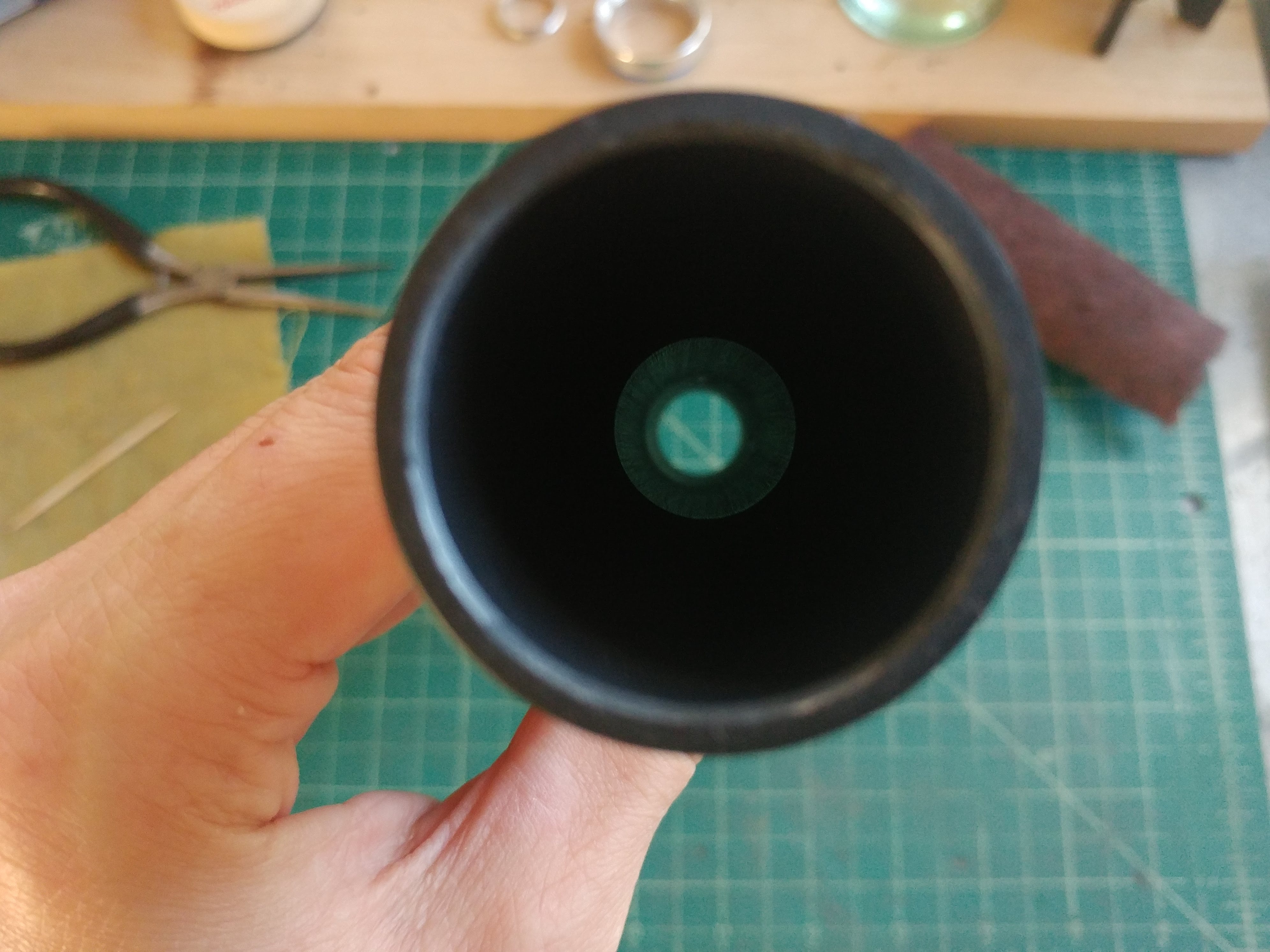

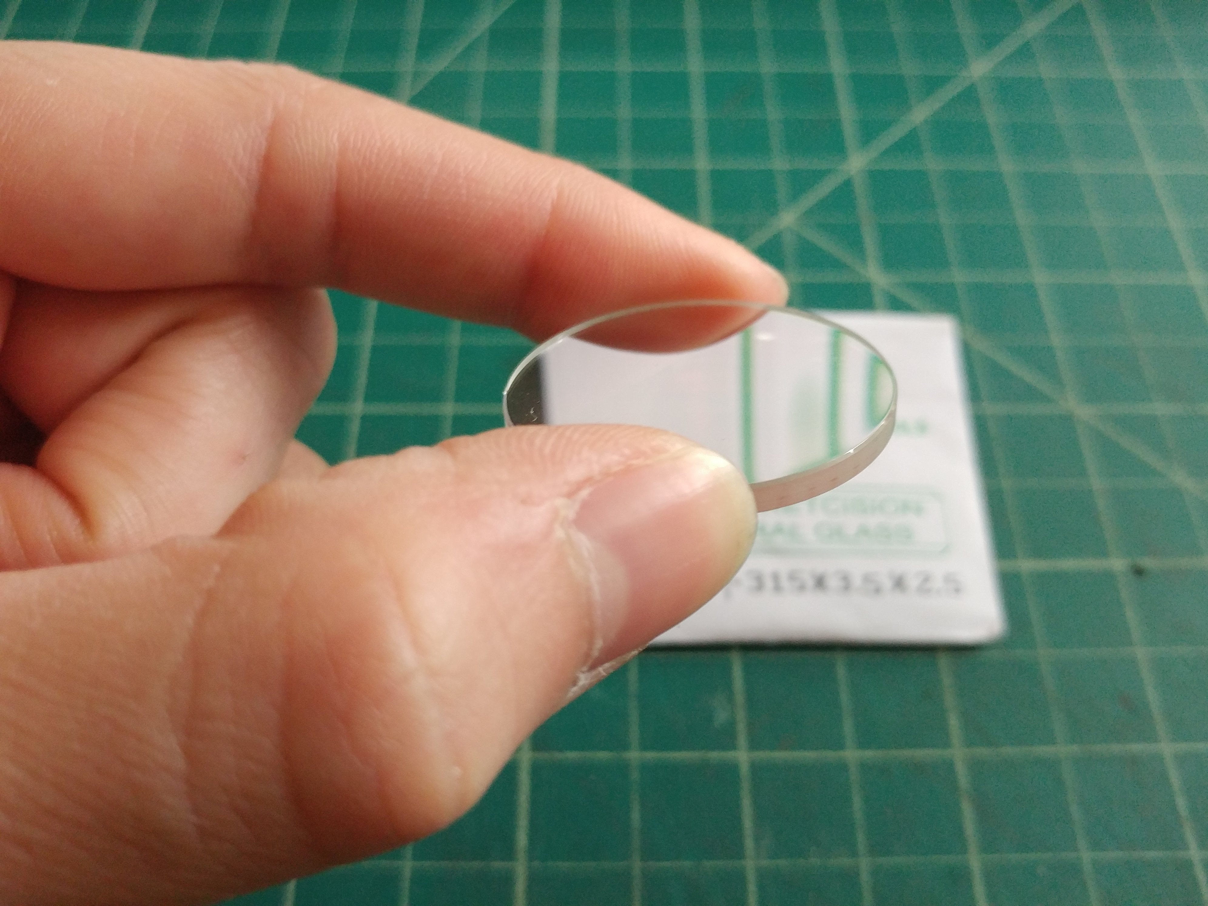

It's hard to get a proper photo looking through the scope, but my lenses finallly arrived from China after being held up for months (inevitably due the pandemic). Both ends have thick, single-dome lenses that give it a great magnifying effect:

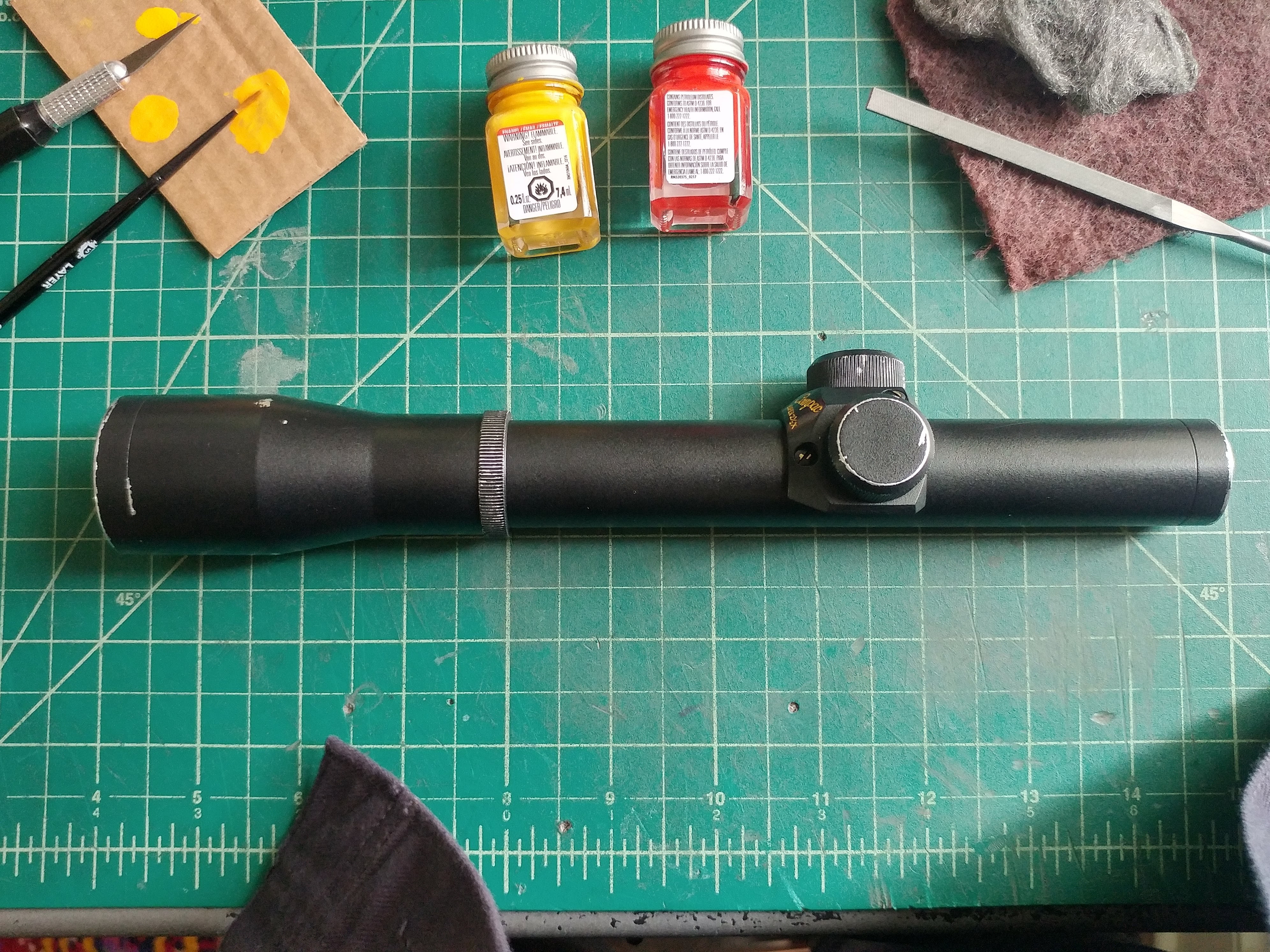

I think the saddle turned out fantastic ... thanks for offering this piece chubsANDdoggers! I mixed up some yellow enamel with a touch of red to match the color of the Compac's logo, then just brushed it on thick and wiped the surface with an alcohol-soaked cloth:

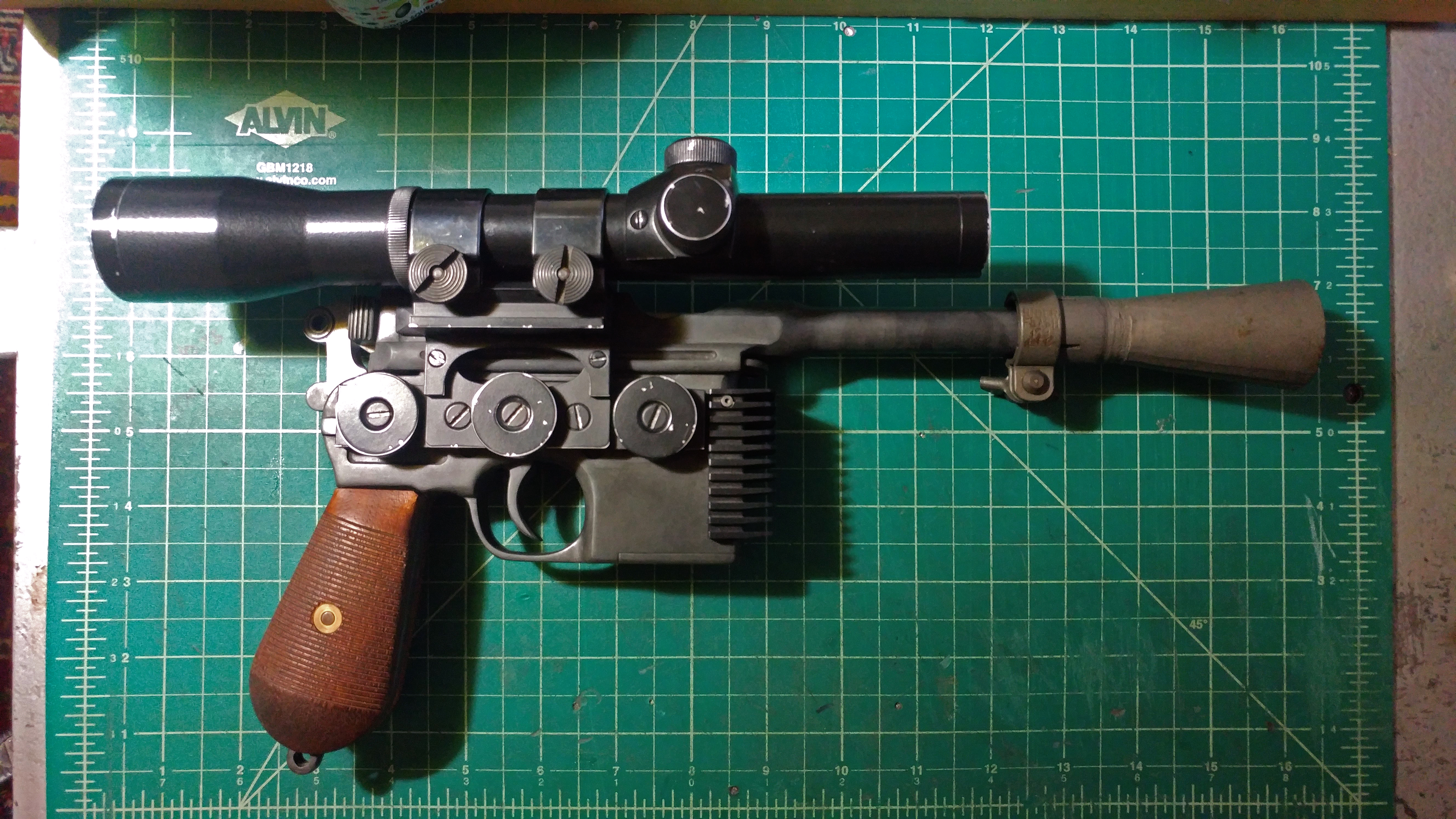

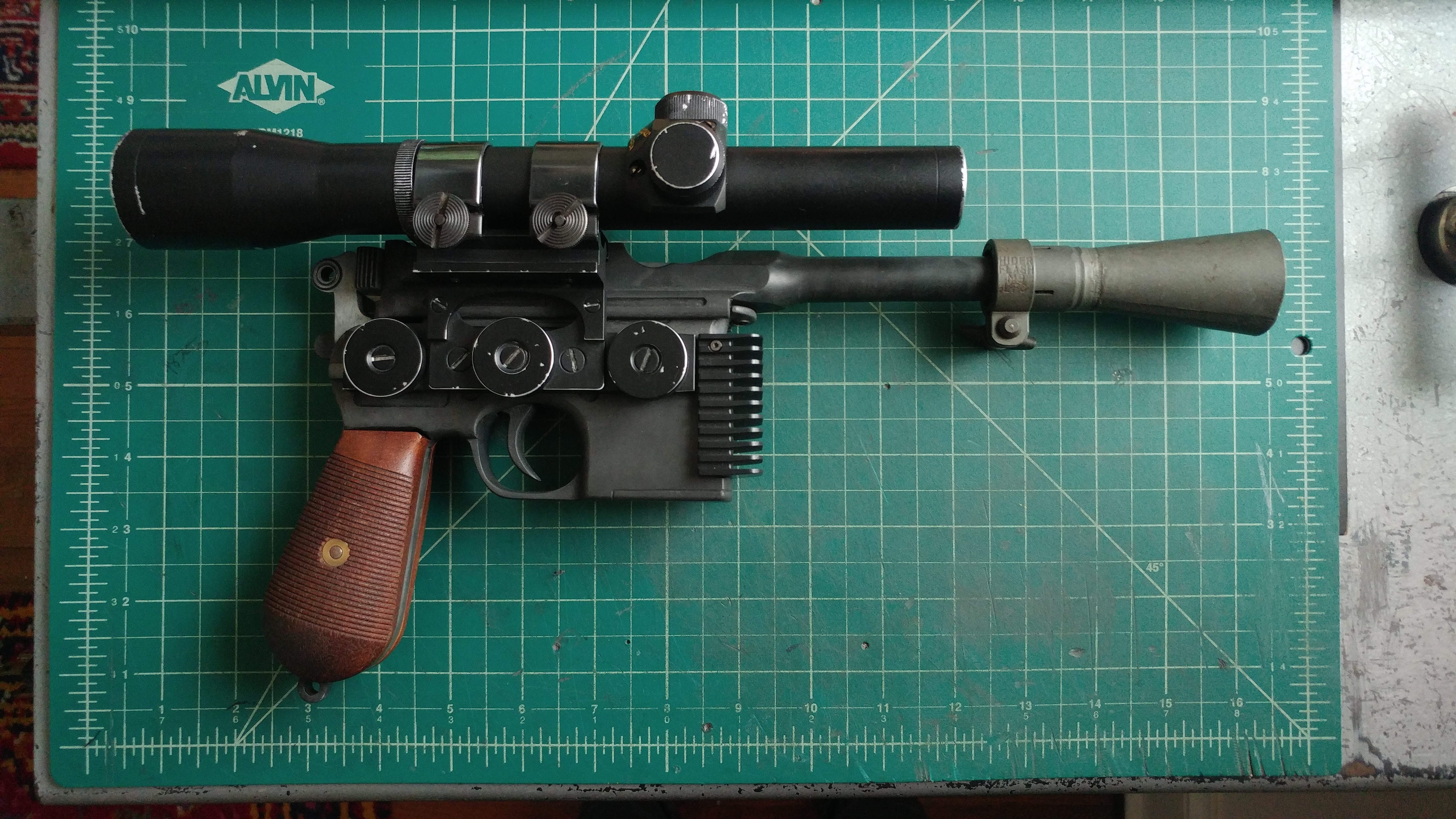

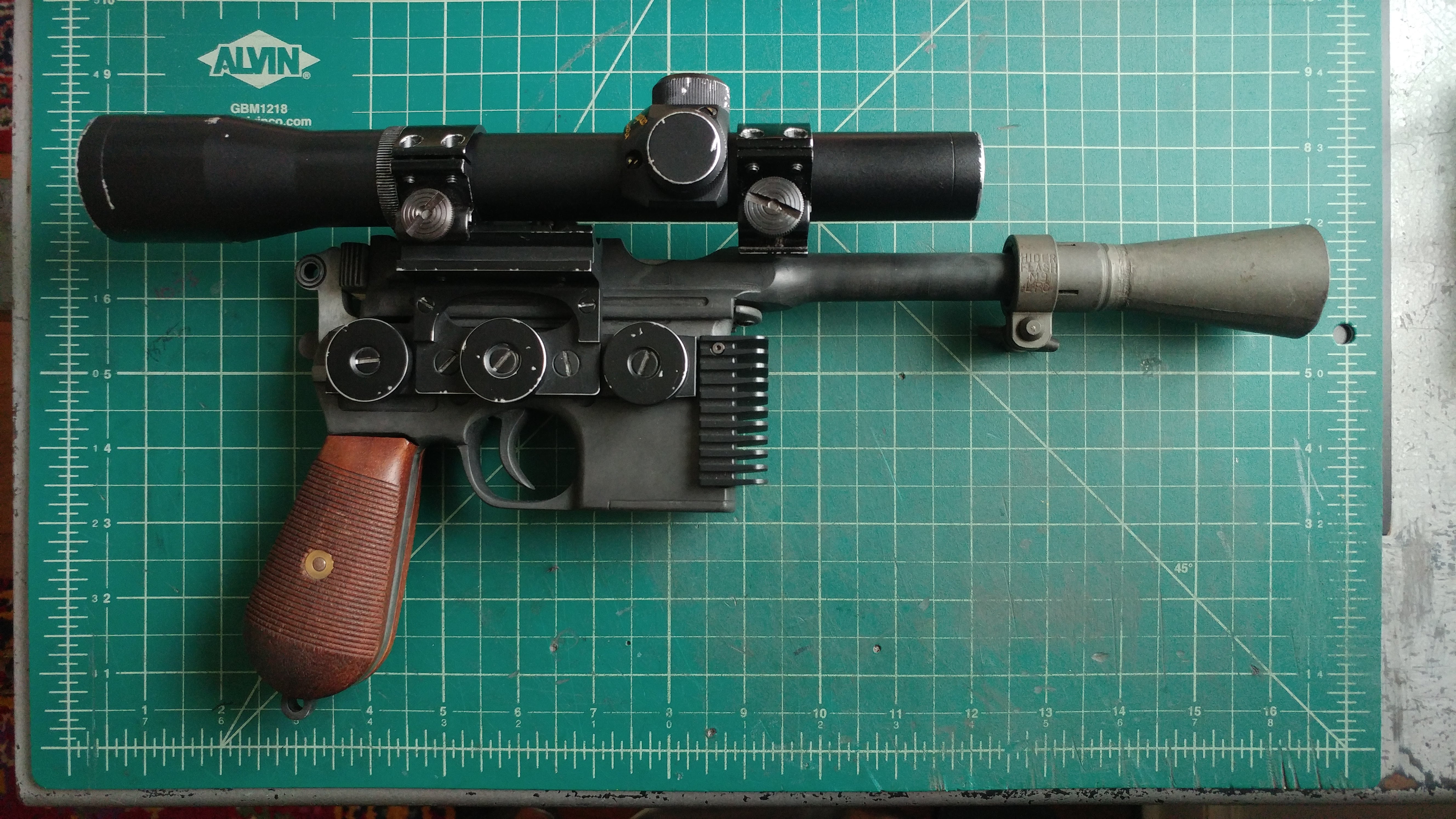

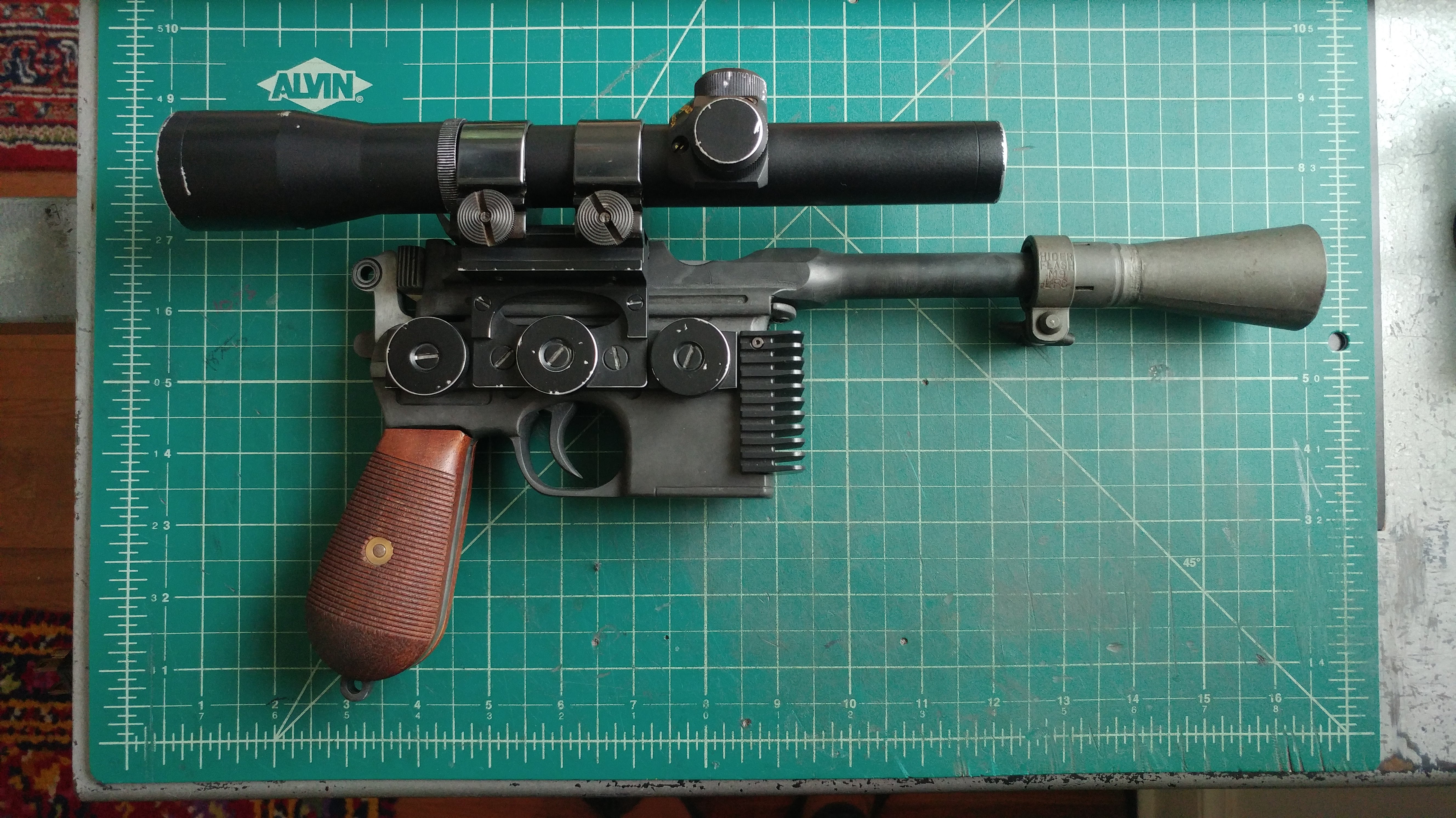

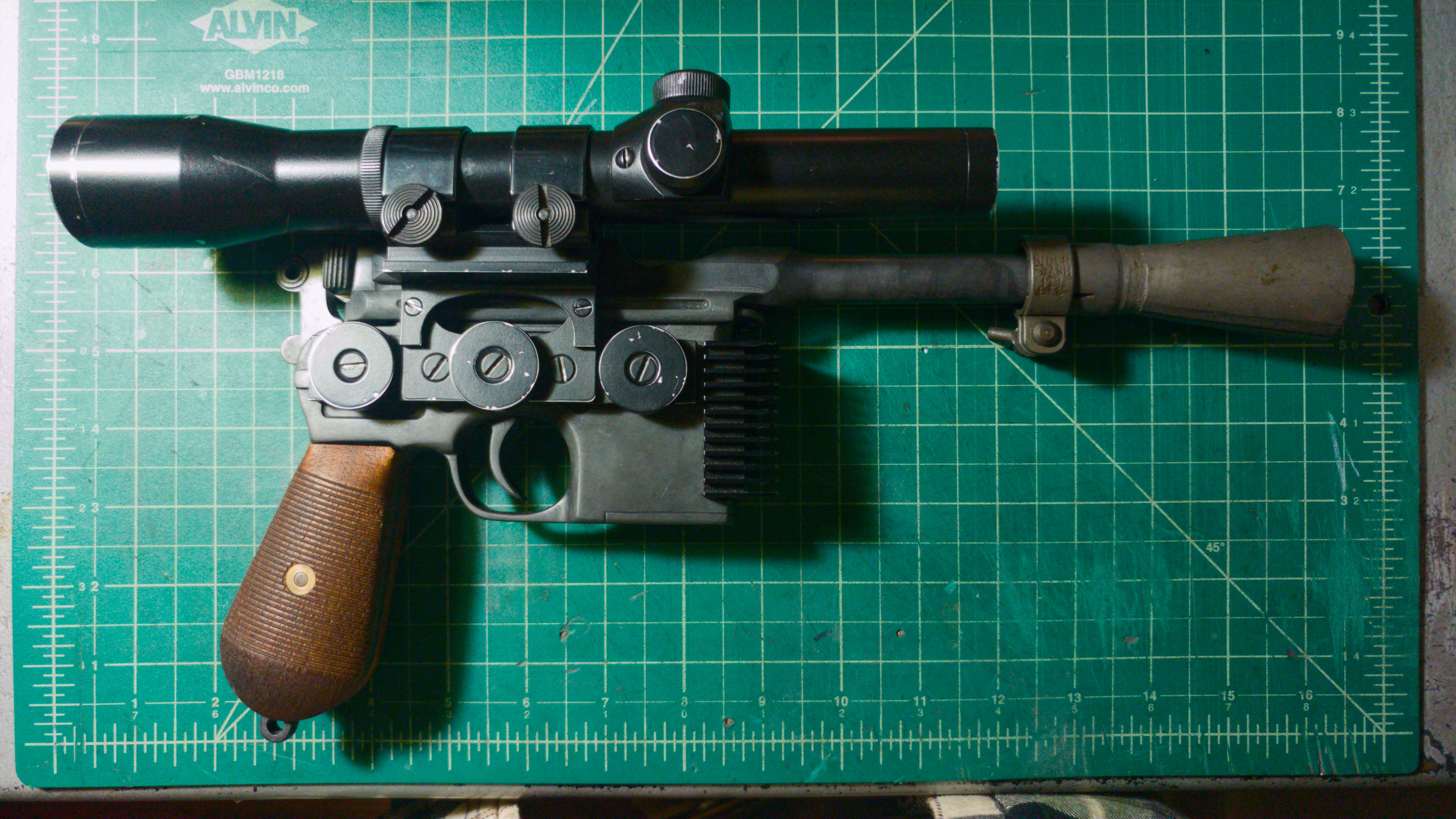

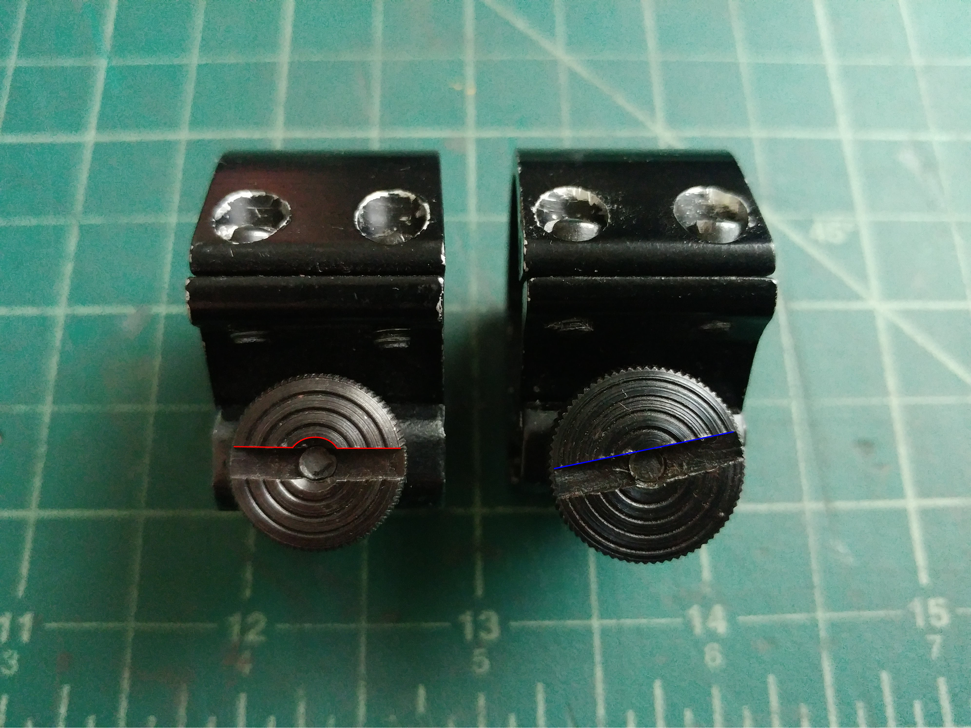

After hunting for some time, I think I've acquired the accurate scope rings used both on screen and in the famous post-production photos. Here's the GK in three different configurations:
Screen-Used Configuration - Featuring the taller Weaver scope rings:
Idealized Configuration - Featuring lower-profile Weaver scope rings:

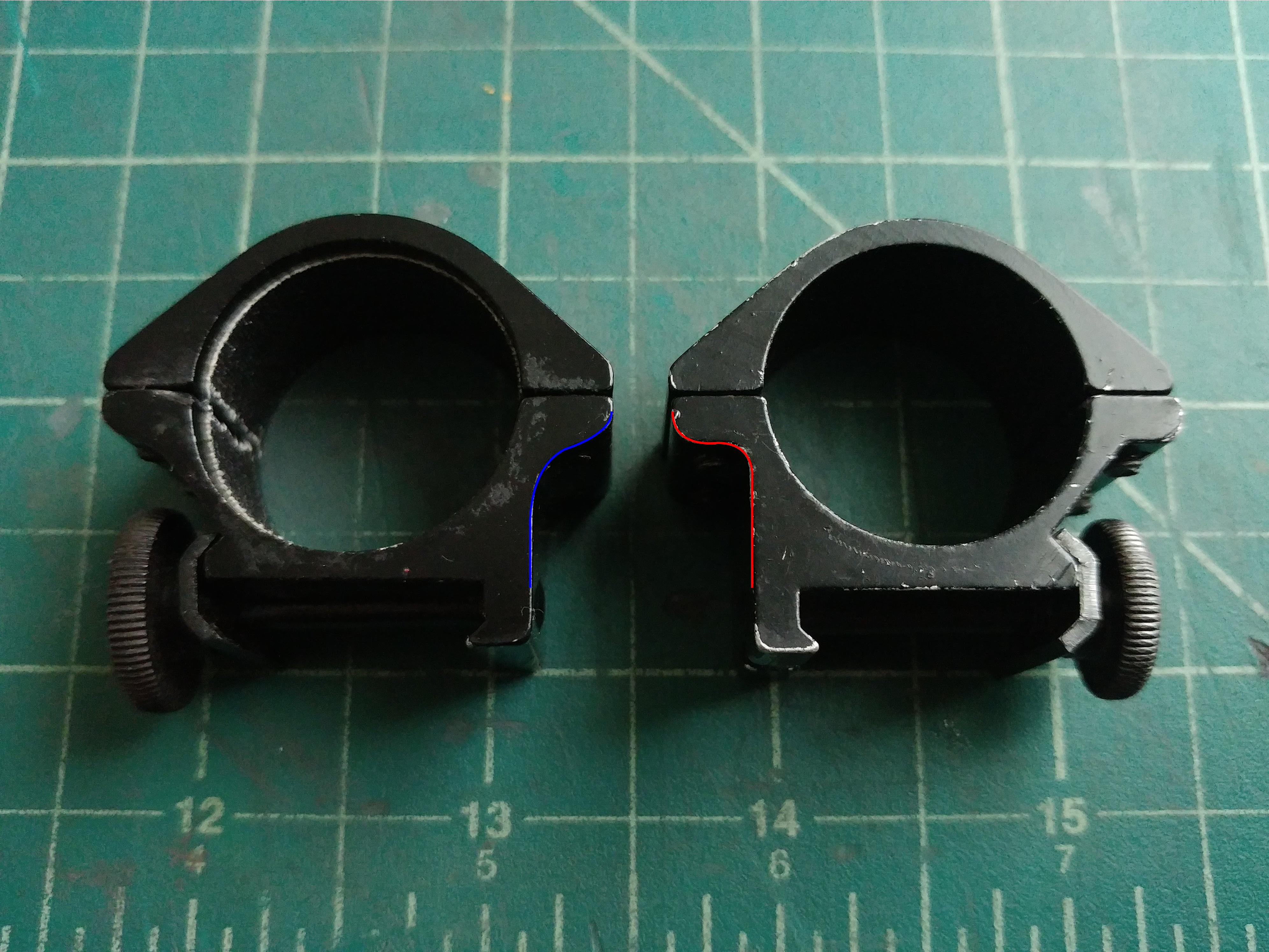

Post-Production Configuration - Featuring mis-matched Tasco/Weaver scope rings:

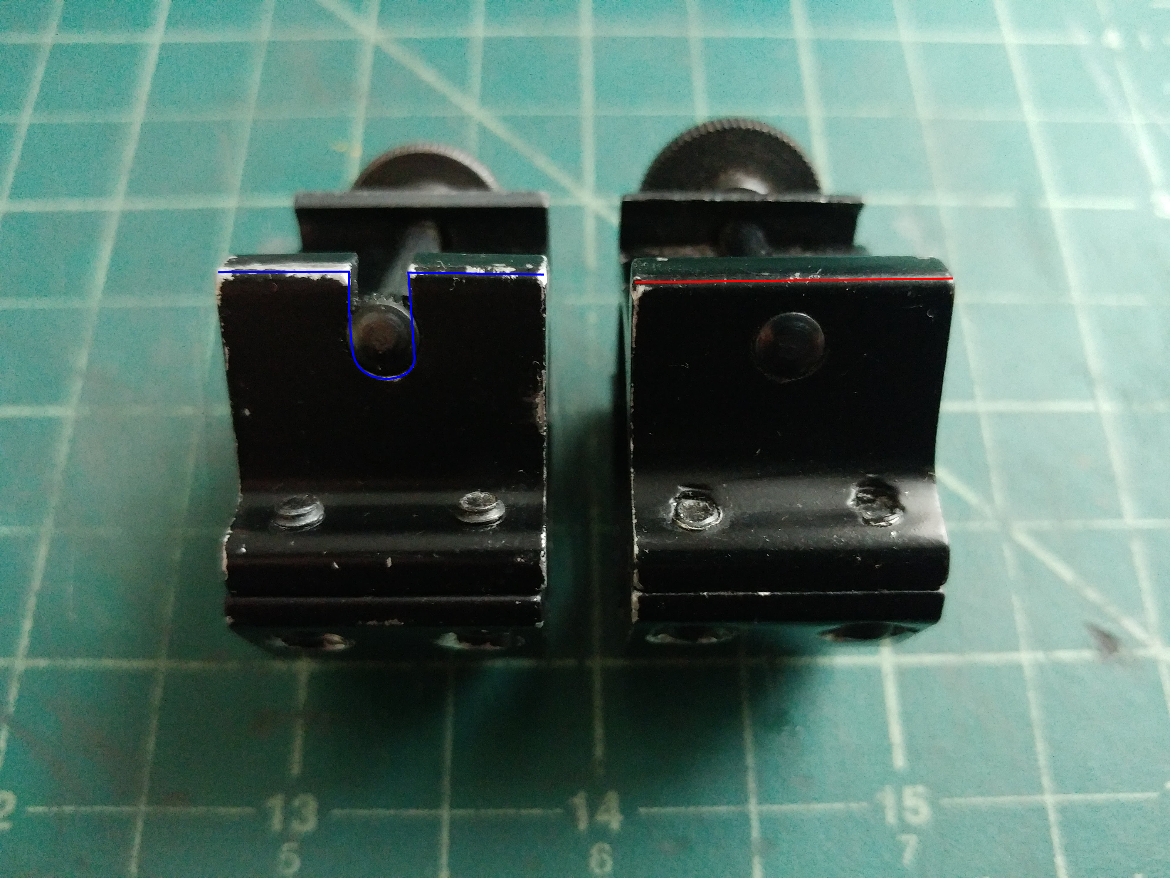

If you look closely, you can see that the two scope rings used in the post-production photos of the GK are mis-matched. They are of a different shape than those used on screen (common "football" shape), and although they are very similar in design to the Weaver rings, I believe these were made by a Japanese company called "Tasco". The wheels are very close to those of the weaver rings, but there are some notable differences (outlined below) and the Weaver wheels' threading doesn't match these.
I'll be keeping it in the "post-production" configuration for now, as I don't see many GK's sporting these style rings!

For me, this confirms that I've got the correct front scope ring for post-production setup I've detailed above. You can see how the profile matches the blue highlight below, as opposed to the more angular profile of the ring on the right:
Pretty cool! It's tough to make out the same profile on the back ring, but I'm still confident that that one has the more angular profile, due to the shape of the thumb knob.
