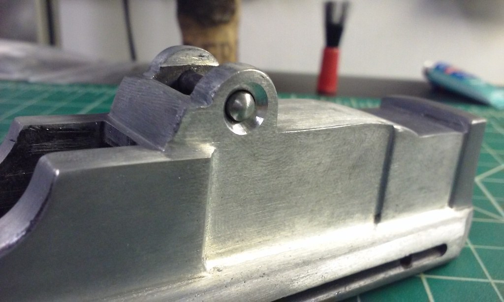

I also popped the sight off and cleaned that up a bit. It was pretty amorphous before ... I started hitting some air bubbles on the bottom of the base so I left that be:

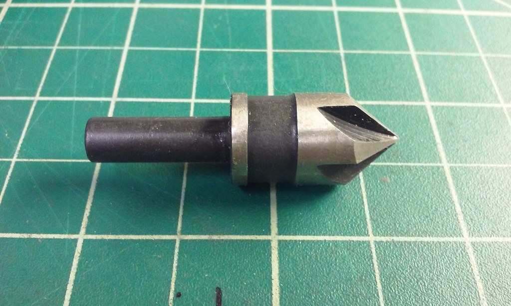

Picked up this countersink bit for my hand drill per Matty Matt and others' request ...
Drilled out the sight pin holes for a more accurate look. I also popped the pin out and put it in the chuck of my hand-drill and used a sanding block to round it out. I'm happy with it.

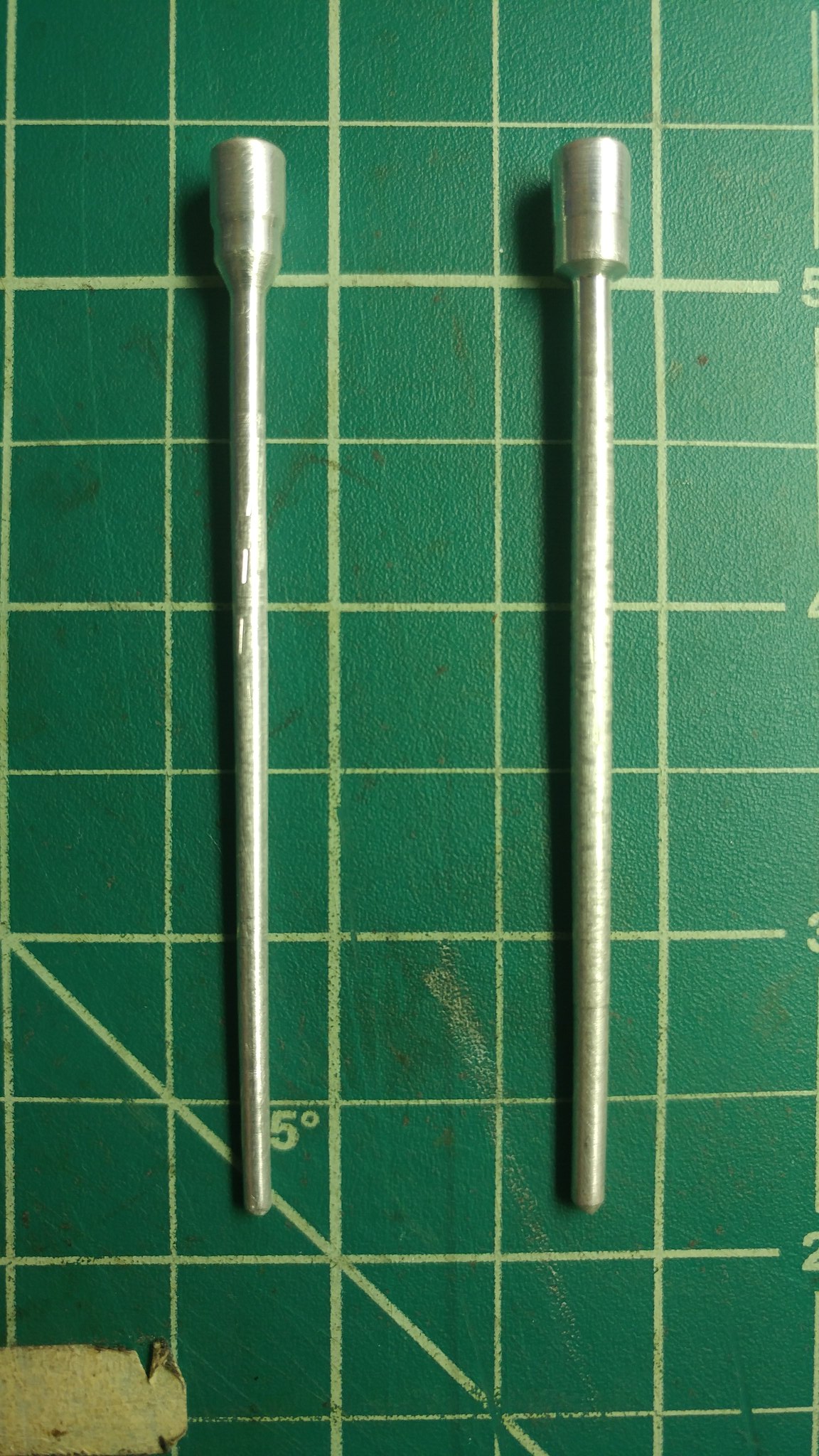

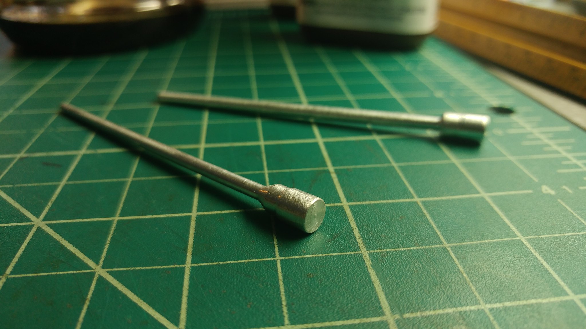

Last year I sent out an SOS for anyone with a spare Denix firing pin, as I managed to ruin mine trying to get rid of air bubbles (see above). User tomm1999 was gracious enough to send me a few of his custom aluminum Denix firing pins that he had made up! So sorry for the delay on giving credit where credits due ... these things are MILES better than the stock firing pin ... THANK YOU, Tom! I think I'm gonna go with the more angled one in the foreground. Just need to do a bit of sanding and it'll be in place:

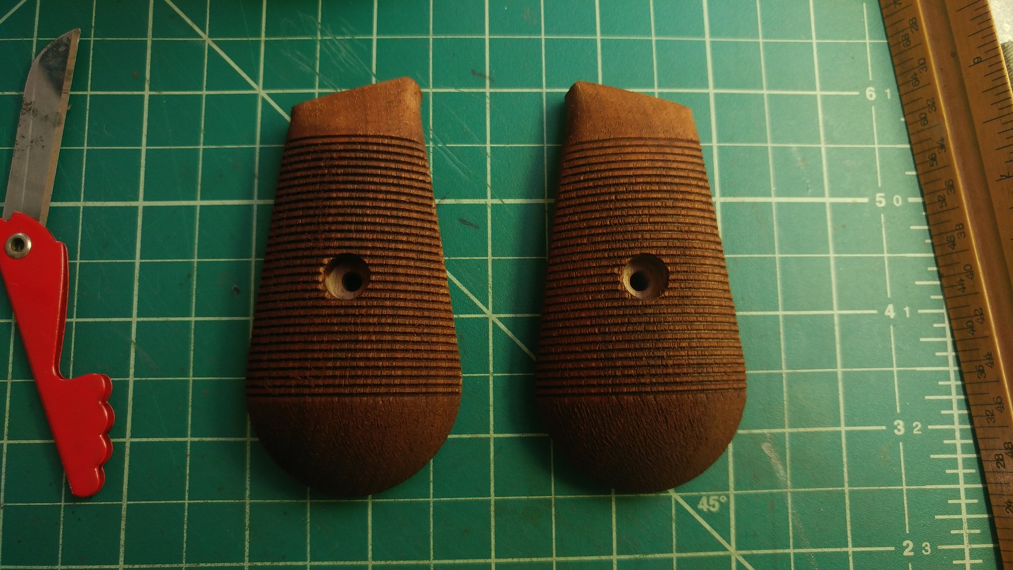

I also found some time to get my DEC walnut grips fitted to the Denix frame. It didn't take much, just a small bit of filing to the outside of the Denix grip frame and a bit of sanding to the back sides of the grips. I hit them with some Birchwood Casey Walnut Stain and am waiting for them to dry. This photo was taken shortly after staining them ... they'll definitely lighten up a bit after they dry. Once they're to my liking I'll hit them with some Tru-Oil.
EDIT: In hindsight, I would have skipped the walnut stain. Just some Tru Oil or equivalent will give the walnut plenty of richness in tone.
