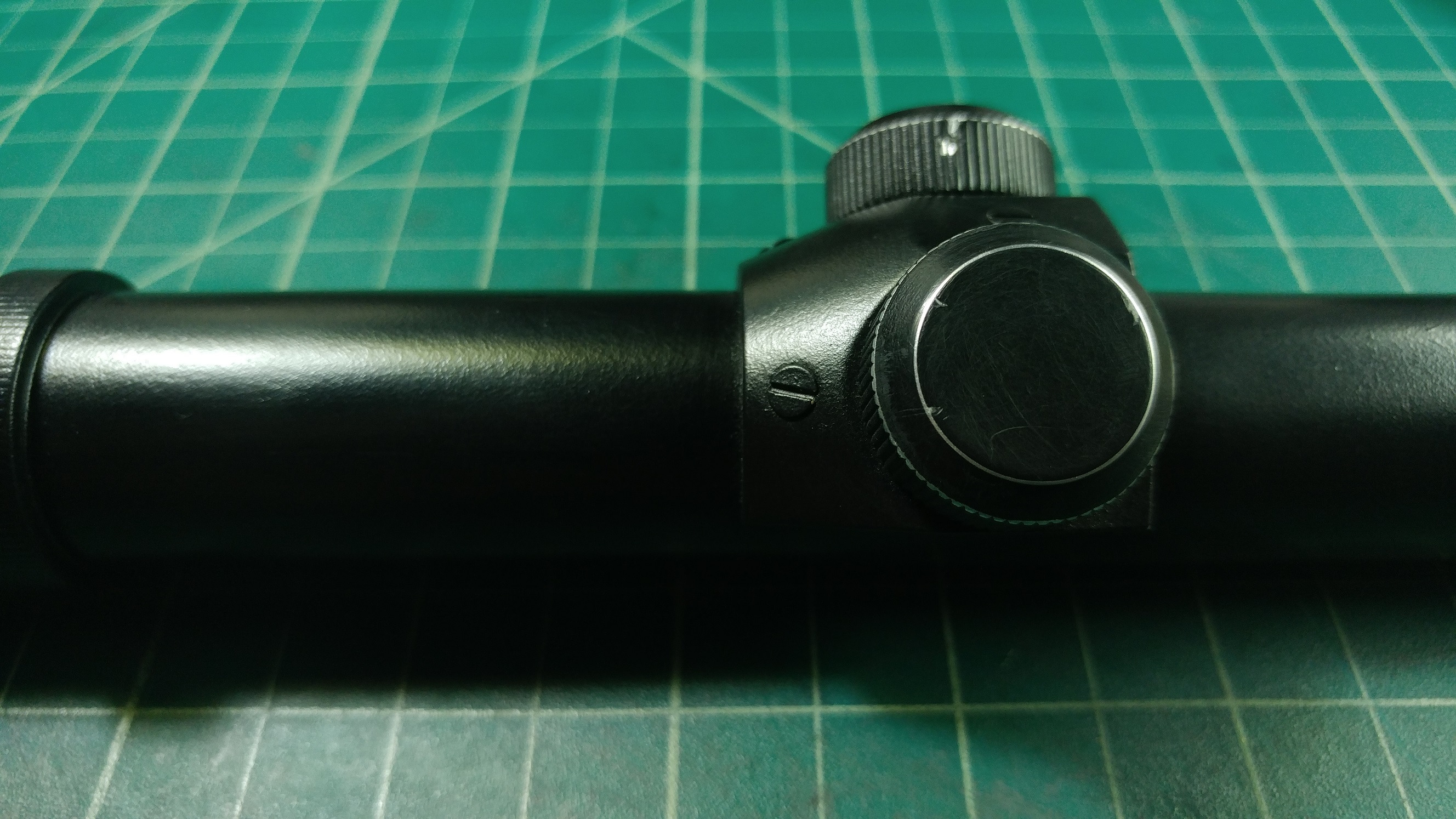

Is this normal? I'm pretty confident that the mount is where it should be ... does this mean that my Weaver rings are the wrong height? I'm pretty sure I've read every Greedo Killer build on the RPF and haven't heard about this clearance issue. Any advice would be greatly appreciated!

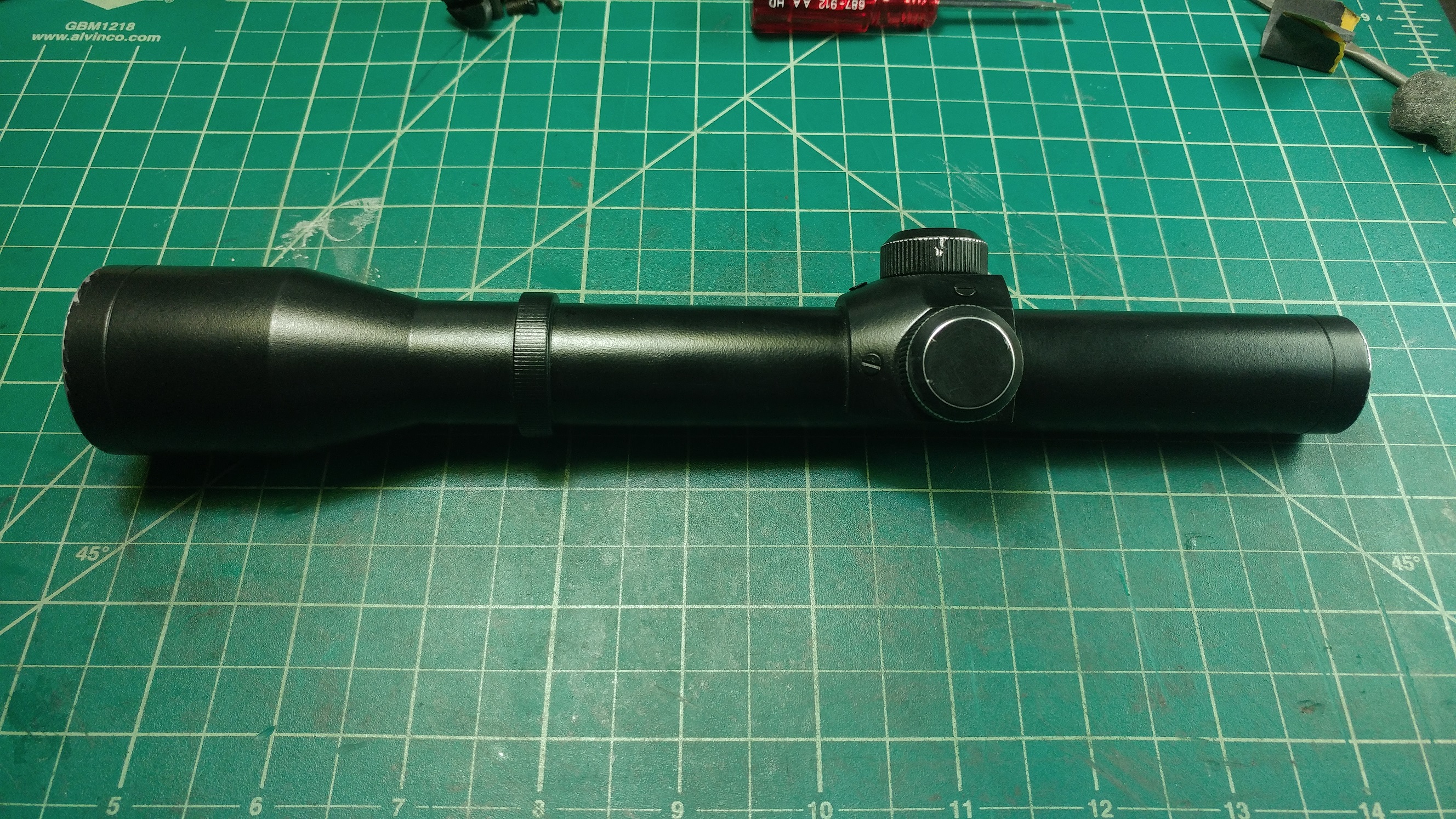

Now for the fun stuff. We finally got one of those 70 degree days I was talking about, and I had a few hours before work so I buffed the scope with some steel wool and hit it with a few coats of satin black. Couldn't think of a better method so I used the old coat hanger. I'll have to touch up the area at the bottom where it was resting on the hanger ...
I'm pretty happy with how it turned out. Way too pristine though! Needs weathering. I'm going to weather everything once all of the components are done. I'd like to see the blaster in a somewhat pristine state first, at least for a few good photos.

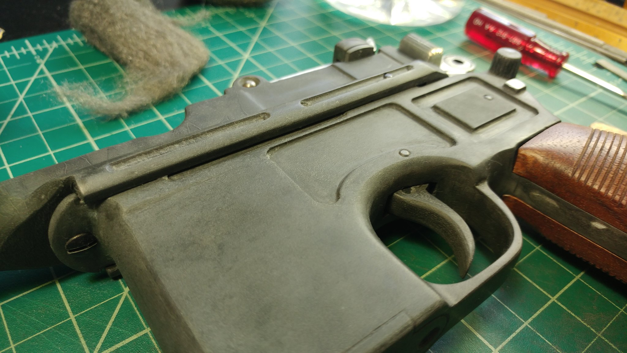

Lastly, I tackled the trigger. I hadn't made up my mind if I was gonna attempt this or not, but recently moved in with my girlfriend, who is also an artist/hoarder and has a ton of tools, including a dremel. Sorry the image is upside down ... I tried everything:
Definitely should have forked out the money for a dremel sooner, as it made quick work of the trigger. Once that was through I said what the heck and went back and even further sharpened up some of the edges on the frame, and further tidied up the trigger guard area:

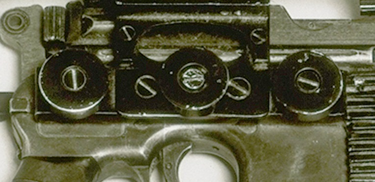

5 slotted sunken bolts are the same kind (but different lengths), and obvisiously 2 are smaller.
His countersinks are a little bit to deep, just a tad - top of the bolts should be more or less flat with the surrounding surface.
A little bit like this:
I think I was asking - can you use the same bit to do all 7 countersinks at different depths?
wonderful detailing! This is going to look nothing like a Denix
are all the countersink bits the same shape?
Thanks for the kind words! As Lichtbringer said, all three of the spacers are do-able with a bit like the one I posted above, but I hadn't bought that until after I had already attempted to counter them with a large drill bit. It would be a piece of cake with the proper bit, I should have waited.
Agreed, they are way too deep. I thought about flipping them over and trying again but didn't want to blow out the centers. It's driving me crazy!

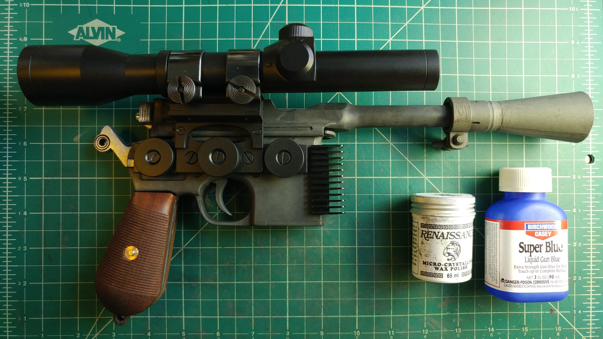

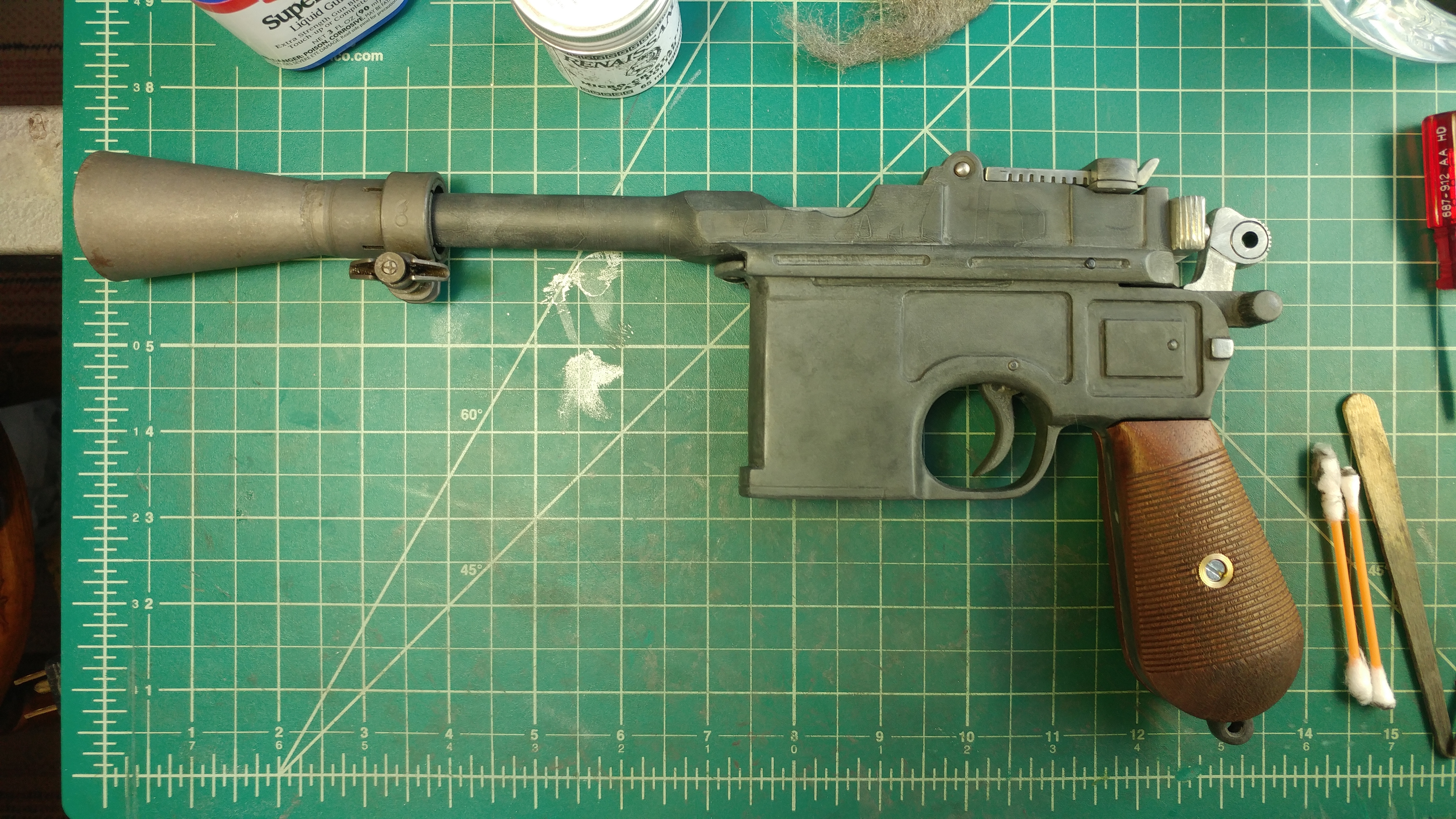

So I've had a little free time lately to FINALLY experiment with bluing the Denix. After trying a few different approaches, I ended up going with Super Blue. Aluminum Black worked great as well (with the proper treatment) but was a little too black for my taste, as I'm trying to mimic the more greyish/blue finish of an MGC.
I put a lot of effort into surface prep beforehand ... re-sanding every surface of each piece with 800 grit paper, then rinsing with cold water, then rubbing down with alcohol (all while wearing gloves to avoid getting my oils on the metal) then directly into the oven for 10 minutes at 300 degrees. I found that when I took the time and went through all of these steps before using either product, I was able to get a very consistent finish, so long as I could submerge the piece fully all at once. I started to run out of super blue when I finally got to the upper, and used a brush to cover the parts that weren't submerged, and it shows. You can see some of the defining drip lines from where it had time to sit before more super blue hit. So It seems that that's the trick, getting the whole piece covered all at once. I'm tempted to re-do the upper, but I've already covered the whole Mauser with a few coats of Renaissance Wax, and I already stripped all of that off of the lower once to re-do the finish, and know how much of a PITA it is. Plus, I'm out of super blue, so ... voila!

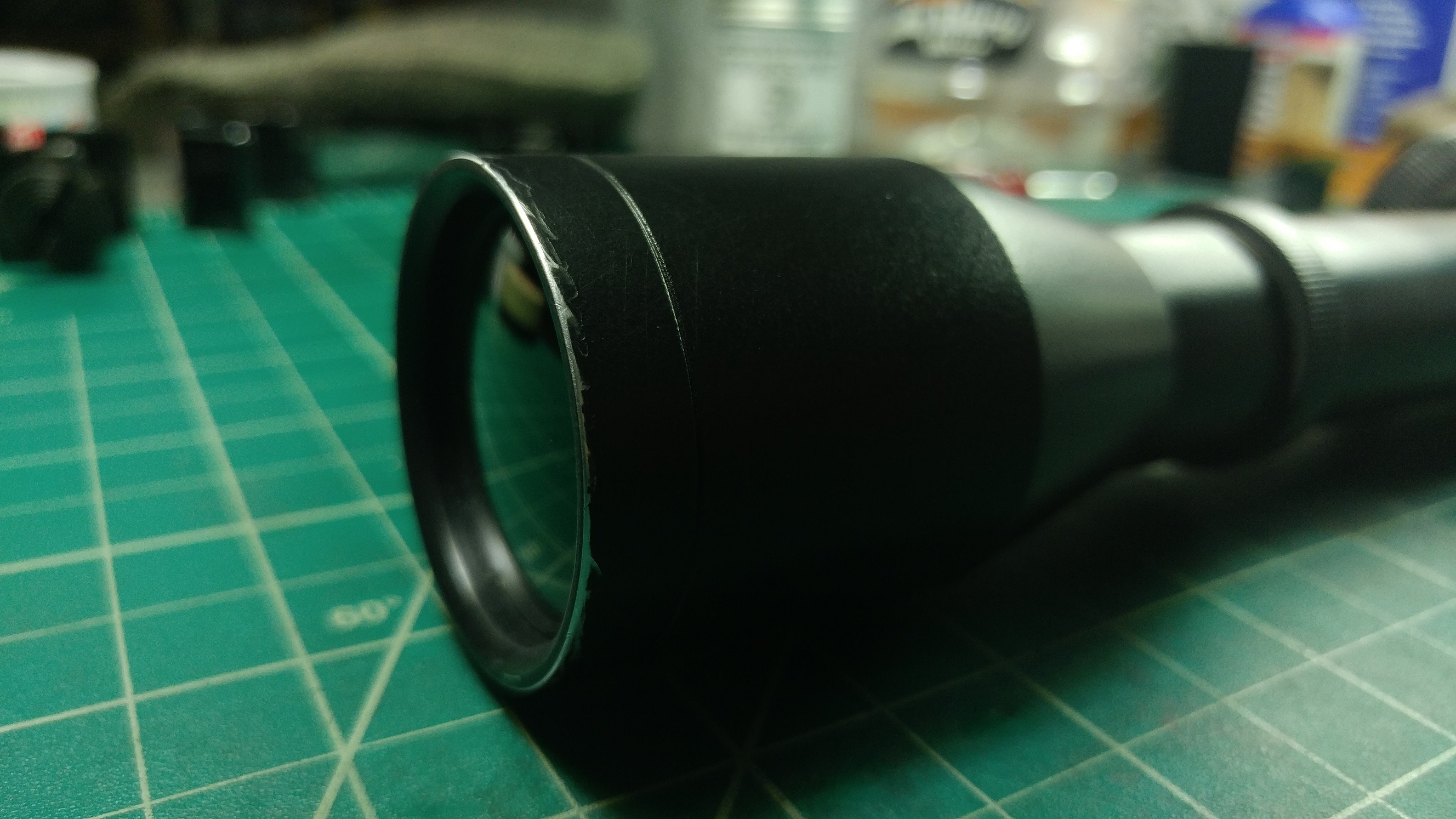

The larger front bell on FM's replica also comes as a separate piece, but this piece isn't threaded, and has to be pressure fit (I'll come back to this in a bit). The machined step in this piece also demands that the lens be pushed in from the back, so this one was also tricky. First, I painted this retainer piece on its own (all surfaces). Once dry, I epoxied in the larger lens:
Once that dried, I attempted to press fit the piece into the scope with just my hands and a rubber mallet. After many attempts, I only managed to get the piece in there about halfway, crooked and stuck. I went to the hardware store and for $40 I got a heavy duty bar clamp that made very fast work of the job:
Edit: Field Marshall has since tweaked his design and the lens elements have a smaller outer diameter, so they no longer need to be pressure fit. They simply drop right in, allowing you to affix them with epoxy etc.
I was a bit worried that being two separate pieces, the seam may not look accurate once fit, but I think it looks pretty spot on!
In all my man-handling of the scope while attempting to hammer in the front bell, I definitely put some scuffs on it. I think I'll hit it with one more coat (doing some masking of course) before weathering it. I'll report back with photos once I've weathered the scope. From there, this thing is on the shelf until Field Marshall's new 11-fin grill comes out in 2018! That being said ... Here's a teaser for my next real-parts build!
