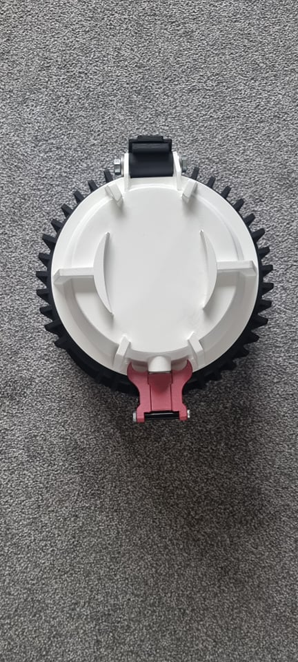

All done. The only part I'm unsure on is the red latch. It secures fine onto the white lid but because the latch itself is secured to the black base, theres no way to move it up and release / open the lid
Mine was quite high on the black base so it had clearance to move, was almost loose. Thats why I embedded magnets, holds it steady in the "locked" position.
Anyway, lets see it!!! Build pics too!
Magnets did the trick! Thank you.

Would you mind letting me know what size screws / bolts you used to secure the Mr fusion to the white lid?
Sorry, I completely missed this post.
I can't remember exactly I'm afraid.
I did use screws though. I flipped the grinder over and put the white lid in place and used the pre printed holes as a guide to slowly drill pilot holes.
Be careful with that as you dont want to chance going right through the base under where the clear coffee protector sits.
I'm sure I just marked the base with the bit and finished the holes when it was in 2 halves again so i could see it.
I pretty much eyeballed the screws for it, when its in half you can put the lid under it and check your screws aren't going to be too long.
