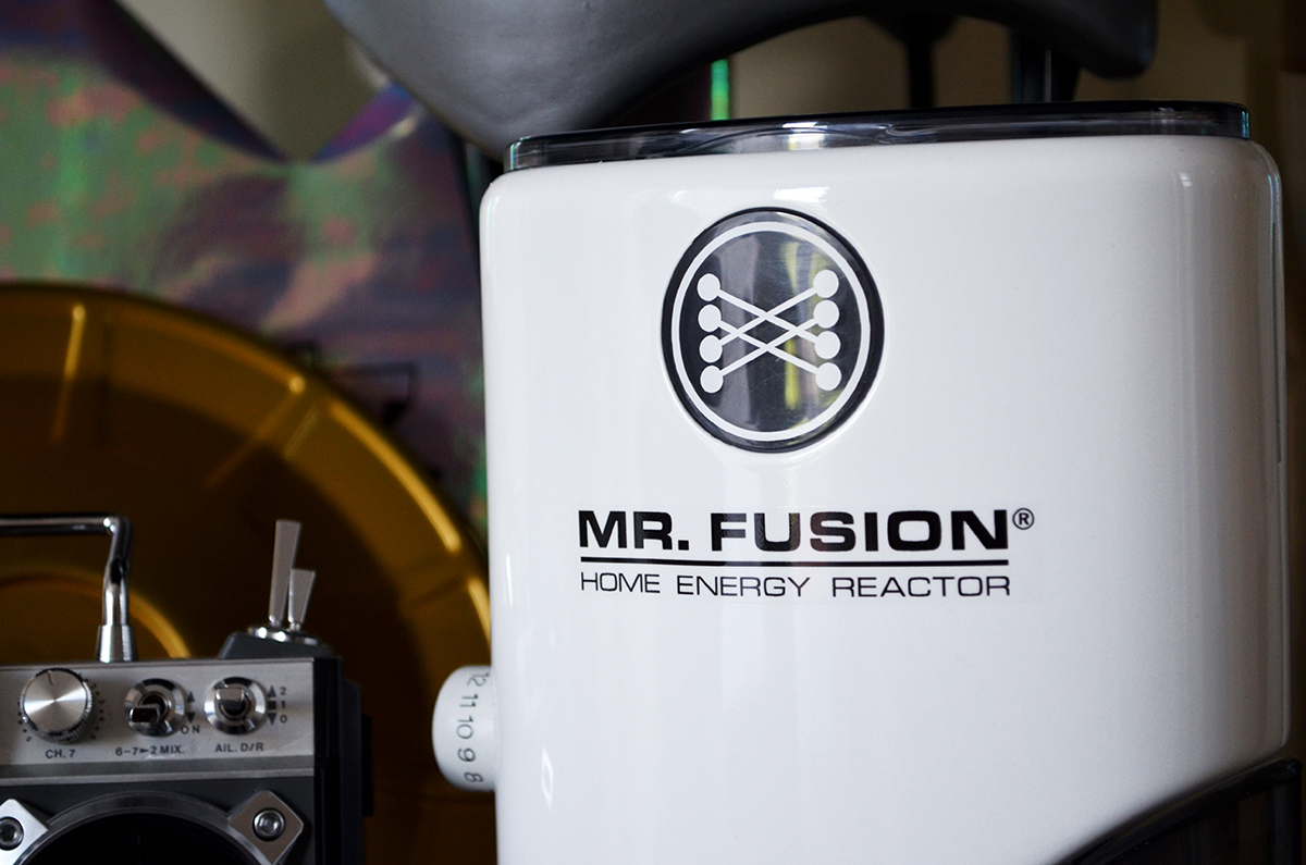

That's another good question, where to source the water slide decals.
I couldn't find anything, I thought Roland had a run but I can't find it
I never had a run of Mr. Fusion stickers. I just posted the file for free. Blank sheets for inkjet and laser printers can be found on eBay. Search for "clear waterslide decal paper sheets".
Right, but wouldn't you need one that prints opaque white? I know Gary Weaver used a printer with that functionality when he made water slide decals many moons ago.
Yes, if you want to make a BTTF 1 version, you would need a printer that prints white color. Simple home or office printer can't do that. If you don't have a cutting plotter and you have a steady hand and very fine scissors, print the logo (the one with the gray background) on a white vinyl sheet and cut it out by hand.
ah! that makes sense now! i forgot who PMed me saying you did a run and to PM you, i didnt a couple of searches before haunting you with another PM. this is great to know!

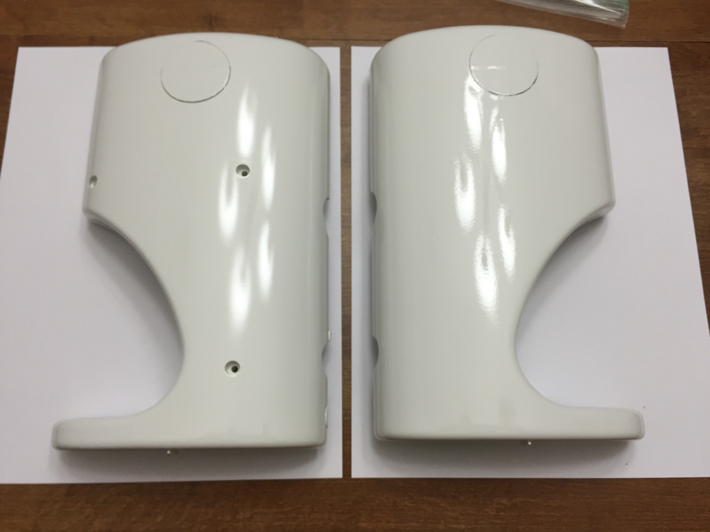

I may get a Krups for making my Mr.Fusion replica, but not the white one, so I think I may have to do some sanding & painting.
I really like how the orange grinder from @Julien1652 ended up in a nice and great white grinder.
My question is: if I have to do the same, can you please tell me what kind of sandpaper is best, and when will I know I've sanded enough? How would I know I have to stop the sanding process?
Also, about the paint, would a common white paint-spray work? Does it need to be glossy or not? Also, I think it's good to add a final clear coat to protect the paint, and give the grinder a nice texture. Does the clear coat need to be glossy, semi-glossy, or flat?

Hi
Sanding First, I used sandpaper with water in p800 and p1200 to finishing.
Sandind without being too abrasive.
then we must be degreased before painting.
f
or painting, it is worth taking the epoxy gloss white paint ( coverage ) no need to varnish. [emoji106]

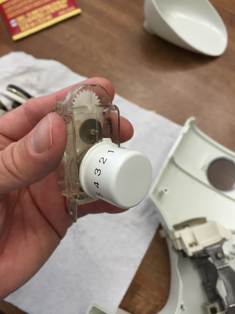

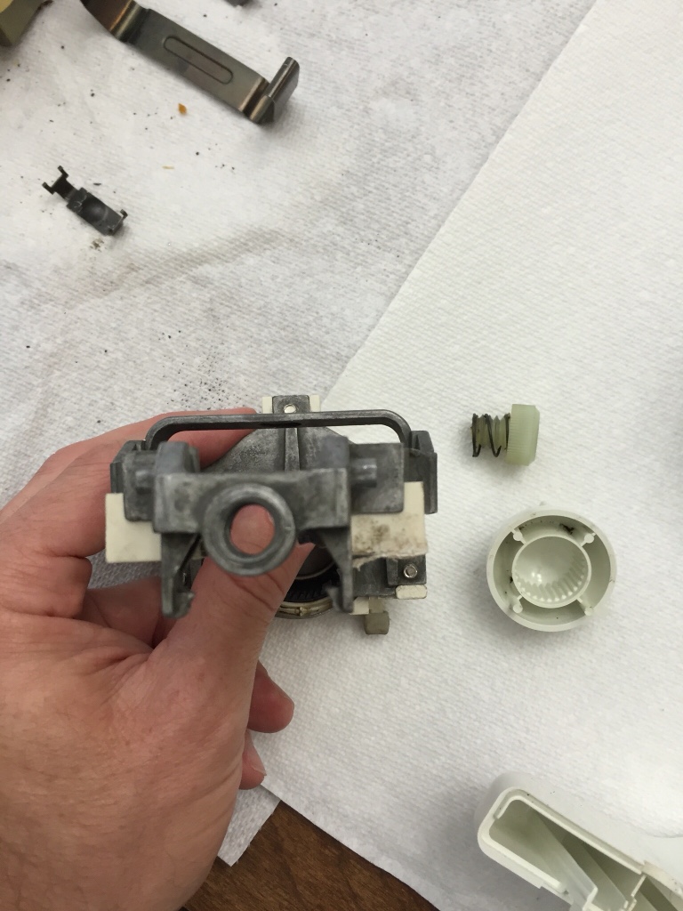

You CAN remove the motor, but only the central wound motor core. I wish I had pictures of the process, but it's not too terribly hard. There are some metal clips you have to undo and I think some screws holding in the grinder on one end. You need to keep the Die Cast motor frame in the unit to support the lower cup and the lower rear knob.
If someone can shoot me some pics of the motor assembly I could photoshop some notes on it to tell you what needs to go and how.

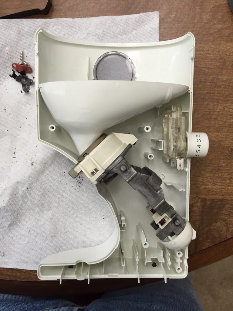

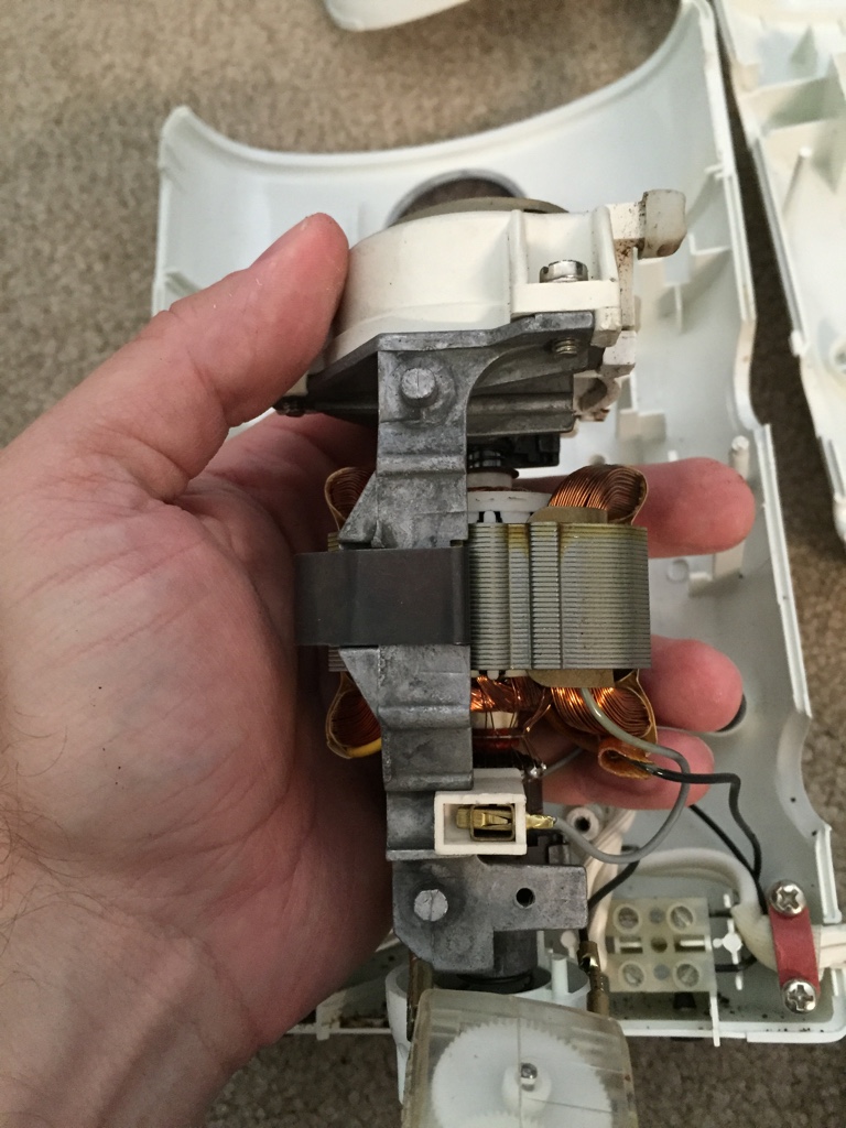

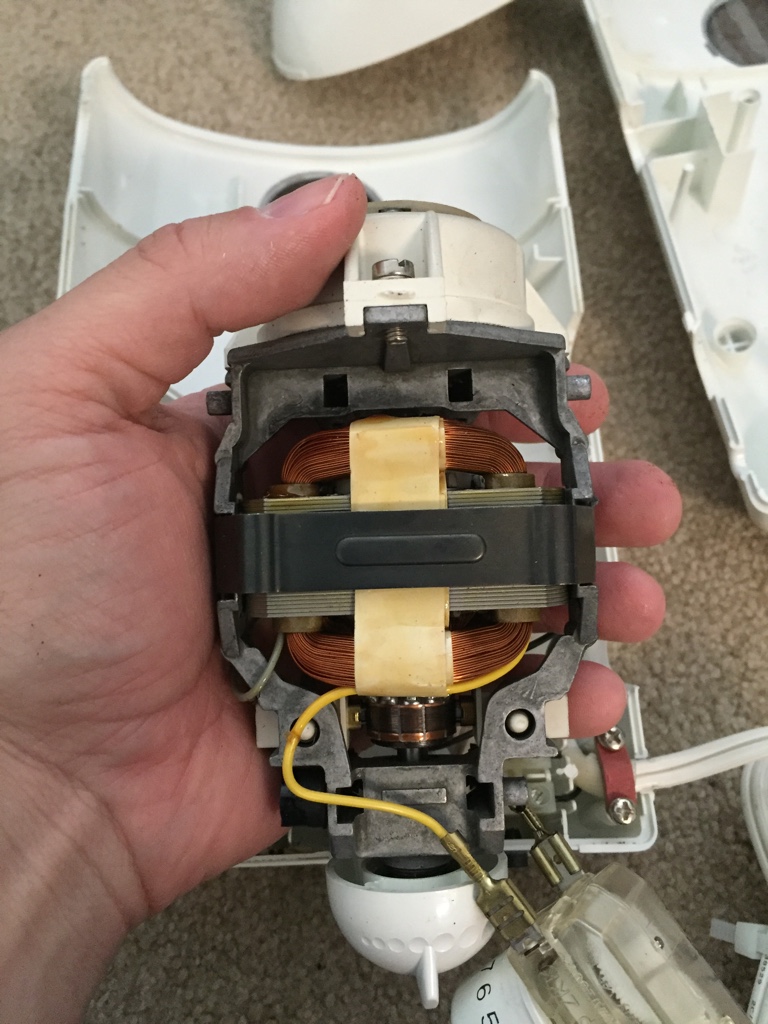

Gary, here are the pics:

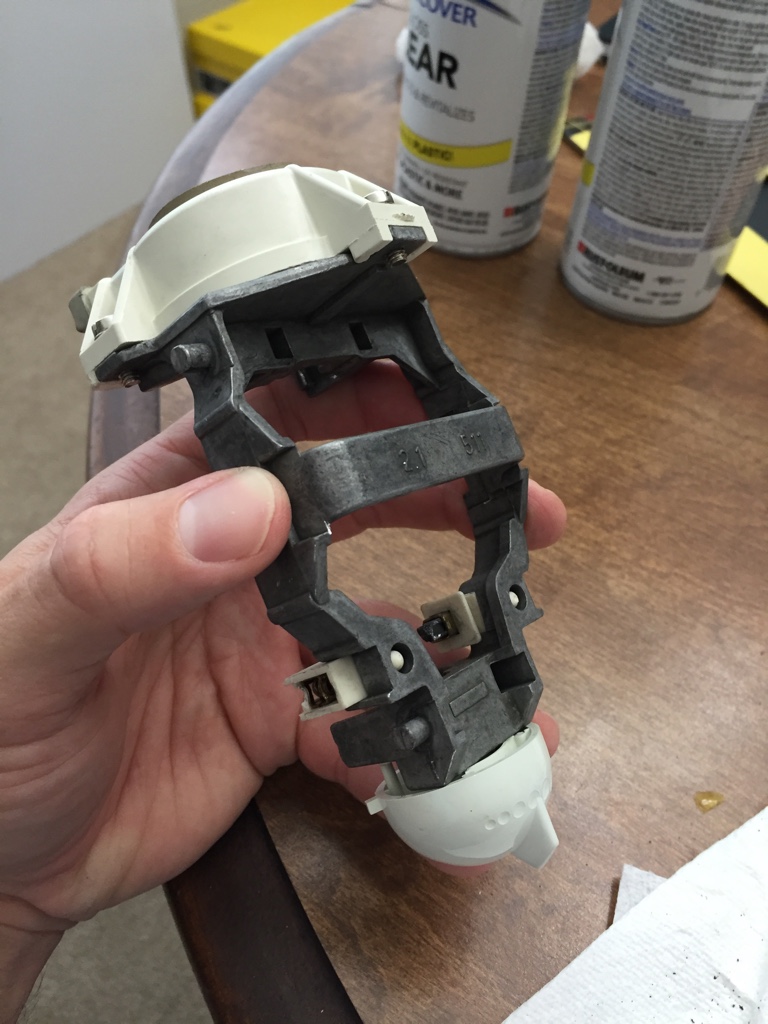

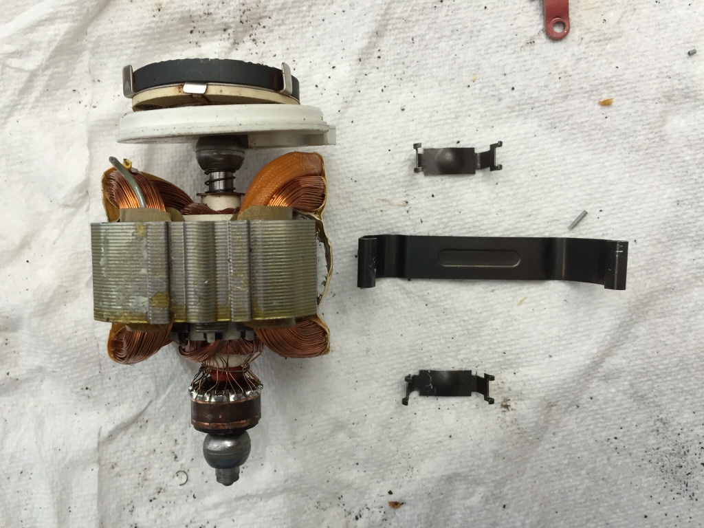

I figured it out on my own. You were correct, it's really not that bad. After unscrewing the plastic piece at the top of the motor assembly (three flatheads), there are three metal clips to remove, one wide one at the center of the motor and then the two smaller ones at the top and bottom. I also took out the wiring, retaining the timer knob at the top and the grind setting knob at the bottom that attaches to the round plastic piece and spring that fits back onto the bottom of the motor frame.
I removed the power cable too, as I would presume you just leave the open hole there where the cord was.
Yup, that's all you have to do. Easy peasy.
-Gary

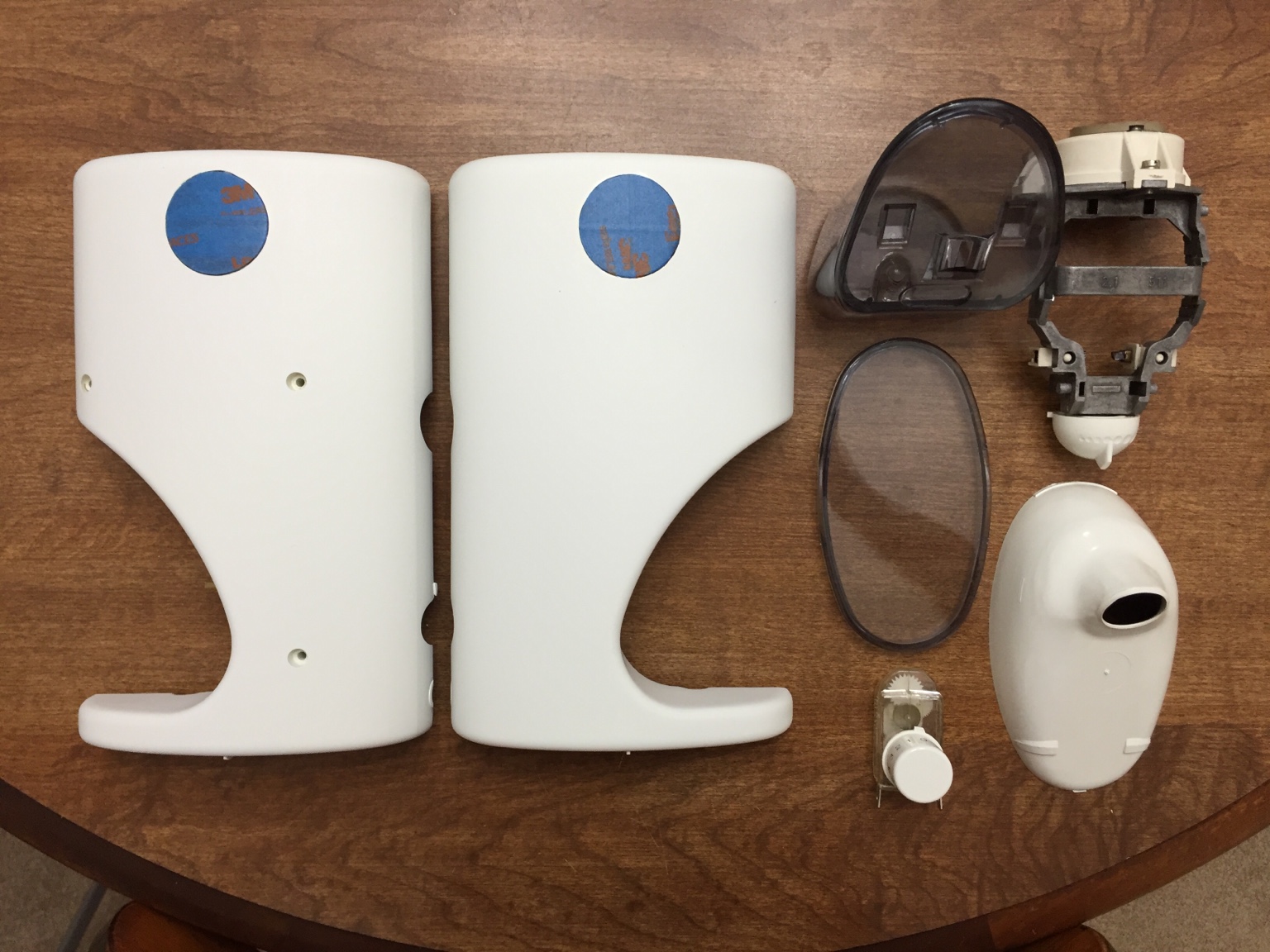

One I finish this one, i plan to do a second with some lighting effects for fun. I was thinking of putting some white EL panels in the clear widows at the top behind the die cut logo, and perhaps an LED of some sort in the front plastic cup. There's plenty of space inside the unit to add the necessary electronics and inverters -- and I could run the power cable out the back where the previous one was.
