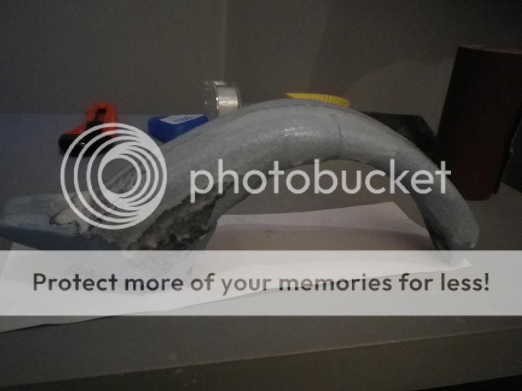

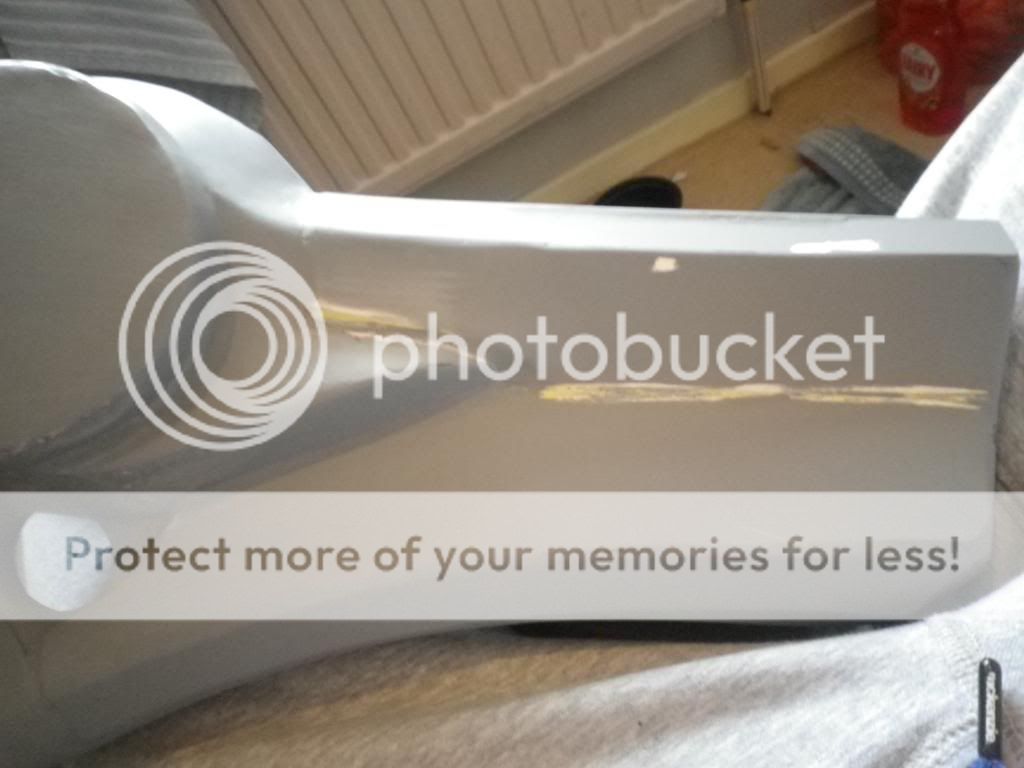

So I have adheded all of the styrene sheets and filled/blended the edges. Once it all cured, I gave it a coat of primer to see gaps, lumps, imperfections in general. what I saw was quite a lot of bumps where the milliput accumilated around the edges when I was filling them, some of the edges weren't flush either so my solution was to file the edges and use the file to remove lumps. (I don't really have a good image that shows filing. I guess this one will do.)

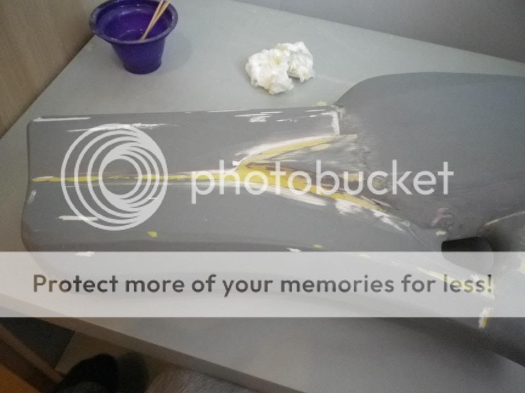

So after the first pass of heavy filing, I gave it a wet sand and re-primed the stock. The edges were flush and there was no excess but there were pits and low spots which need blending/filling. I used very small amounts of milliput to fill them in and watered them down for extra smoothness.
That's basically it for the stock, I'm really happy how it came out and even more happy to know that my idea worked! The edges are super crisp and the stock is super strong and sturdy. I think this is it for a short while, I'm going back to college in a few days and the work I need to do for college is gonna chew my time up. I may fit in the odd hour on the gun but not much more than that. I think the next thing for the gun is the handle.

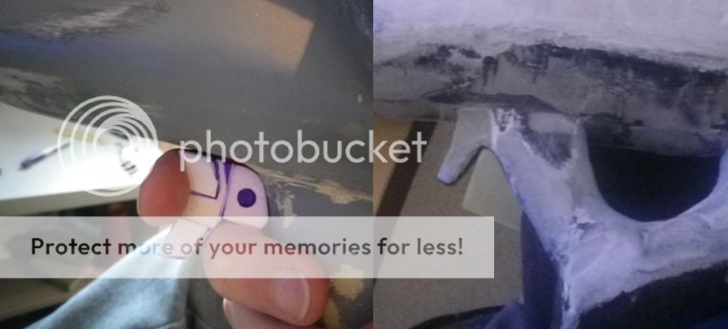

I made the trigger today out of 4mm sintra and 1mm styrene for details, glued together with Seroius glue. I have already glued it to the gun, but this image was taken before that. I'll show it completed in the next update when I upload more stuff. I just wanted to show a "before and after" comparison of the original trigger idea I had, to me, it's quite tragic that I thought the first trigger I made was viable. It also just makes me laugh how much stuff I've changed over this project.
The next update is actually gonna be reworking the mag and butt plate, instead of the handle. (I'm pushing the handle forward to another time when I think of a good solution for it, just bear with me on that one) That's all I had time for today.

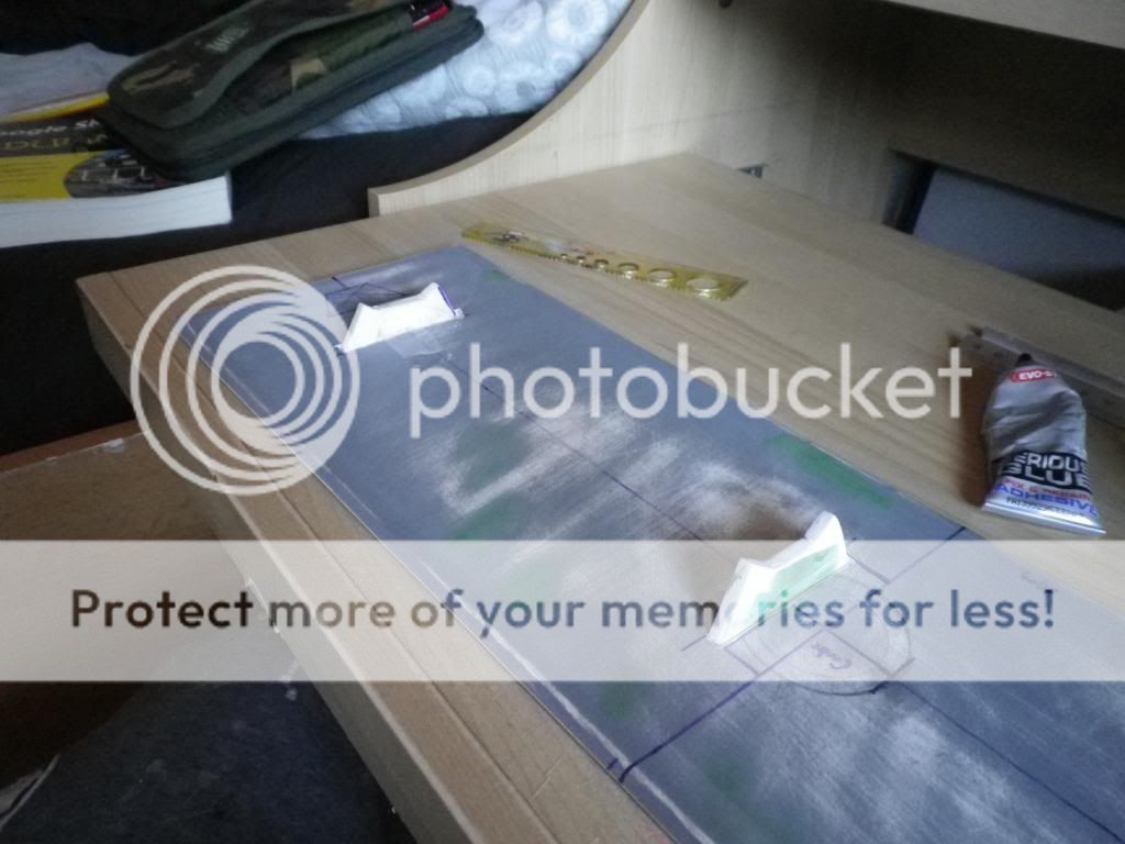

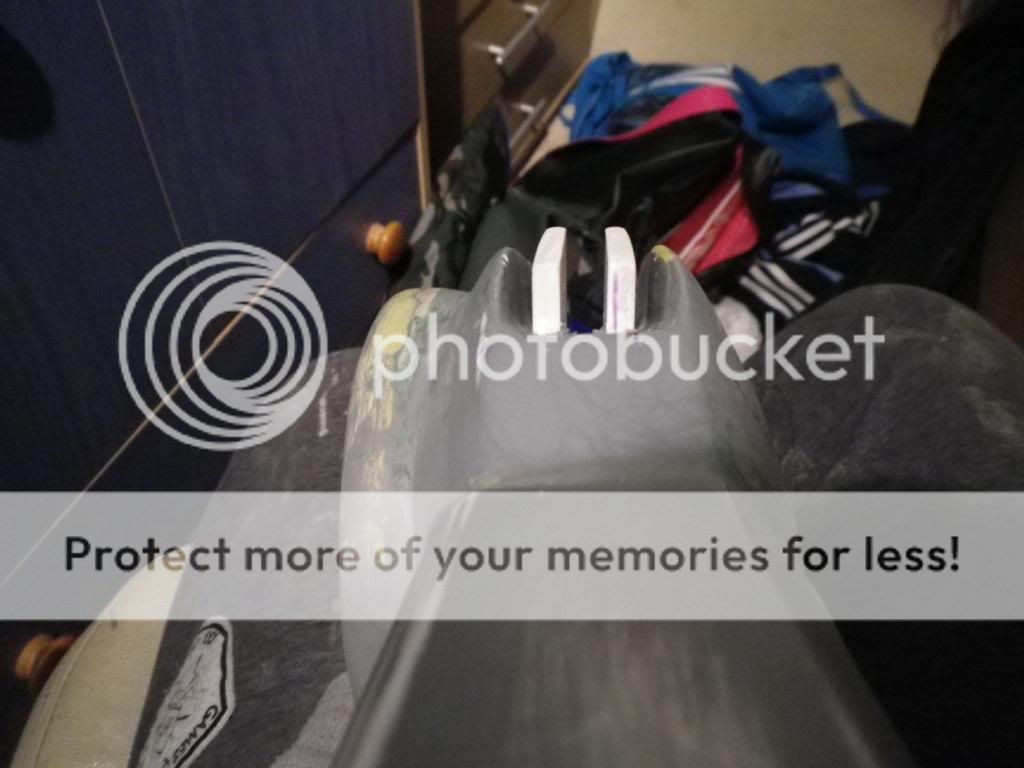

I added some sintra backsights to the gun by carving out a channel, glueing the sights then milliputting around it.
I have also been shaping the handle. I gave it a couple coats of urethane resin.
Another thing I had time for was working on the display stand. Again with the sights, I carved out a channel, glue then milliput around. This is to hold the gun in palce.

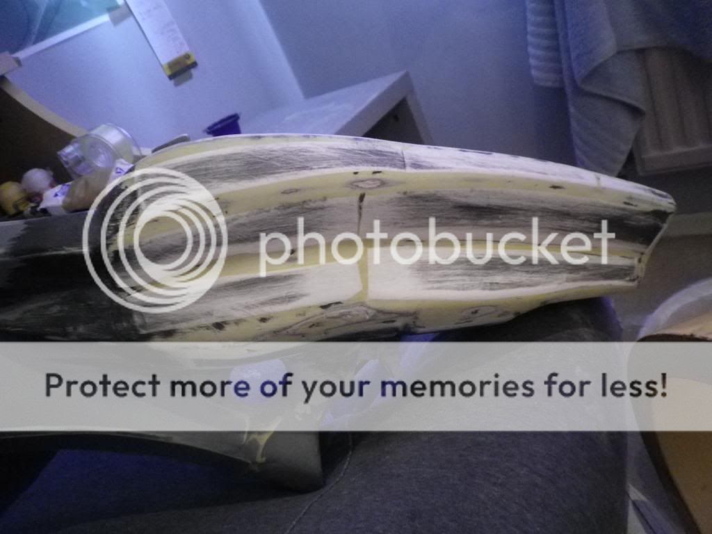

So over last week, I came up with an ambitious plan... Do what I did to my stock... but on the front! The reason I thought of this was the same reason for what I did to the stock, to eliminate weak spots and make it super strong and durable, although the front end was originally tougher than the stock, the underbelly was still poor. The approach was exactly the same but there were so many more angles to work with and a lot more milliput was required to fill the gaps.
So here we are at it's current state...
So every inch of the gun is rock solid, I accidently whacked my door with the gun while turning round and I dented the door this time, instead of the prop! I'll go as far to say you can use it as a blunt weapon. At this moment, I'm still adding bits of milliput to edges and sanding flush, then I'll hit it with primer and that will be it for the base of the gun, no more glueing strips of styrene to the gun!

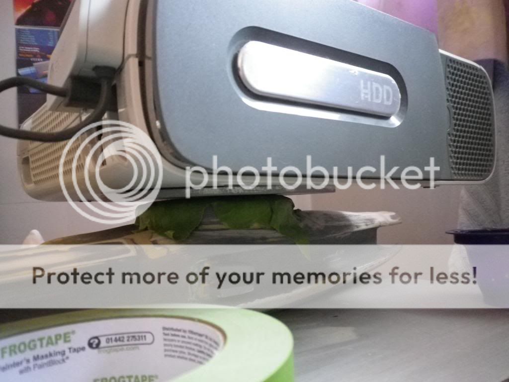

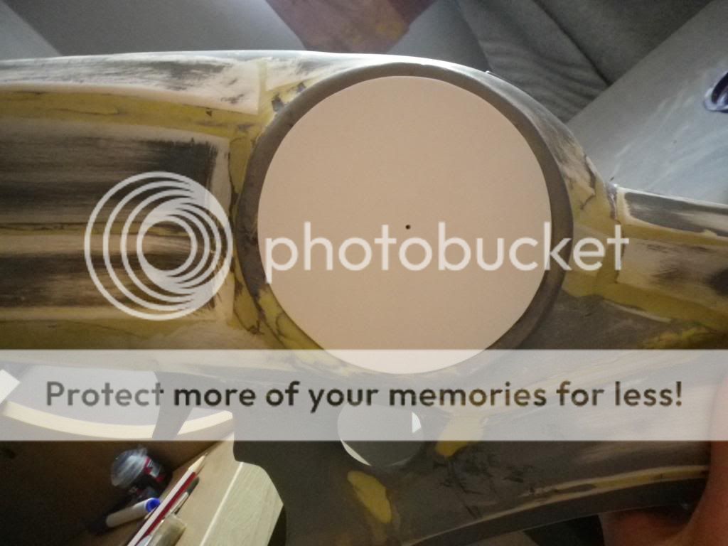

Recently, I've been annoyed at trying to get a flush, clean edge lip around the mag, so I glued on a piece of styrene the shape of a circle. I used a weight to push down the styrene to the surface. For some reason, I used my Xbox.
I will add milliput round the edge in the future. I have also bought some paints for the gun, I got some yellow and orange acrylic citadel paint, and "harbor blue" enamel spray paint. I have white and black paints on the way, in the mean time, I have been testing the paints compatibility between each other. I have also began progress on the rail and barrel, just not enough to really start posting of yet.
