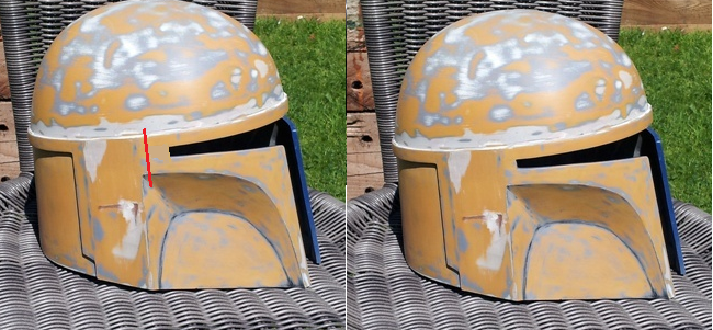

Aww mate cracking job, as much as the navy paintjob was awesome, you cant beat a good old fashioned boba helmet. And yours is looking fantastic. The key slot idea worked out really well.
This is just a little bit of honest crit so I hope you dont mind. I didnt know why but from those shot you posted the helmet looked a little off in the visor area. Then looking at some of the reference shots I have I can see that youve gone a little to far across with the visor. I did a little photoshop of what I mean,
The red line on the first pic is where the visor currently end compared to where I think it should ends. The next pic is the unaltered photo.
I think if you altered this, it would change the whole look of the helmet to a much more accurate looking boba. Plus with the extra room it will allow you to paint the correct sized damage on in the corners. Other than that Its up to you mate, I think you have an amazing looking boba helmet regardless.

Ive not noticed that but that can be easily corrected. Thanks for the heads up. I have been meaning to ask you about the lever/angles and stuff for the area under the ear . Ill just send you a pm. Hope thats okay. Since you have (by fault of your own) become my source of boba fett information.

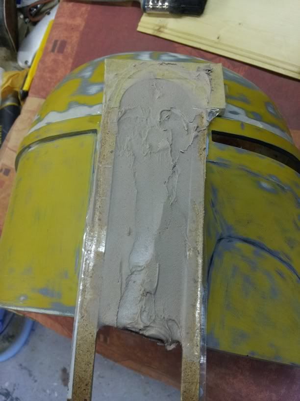

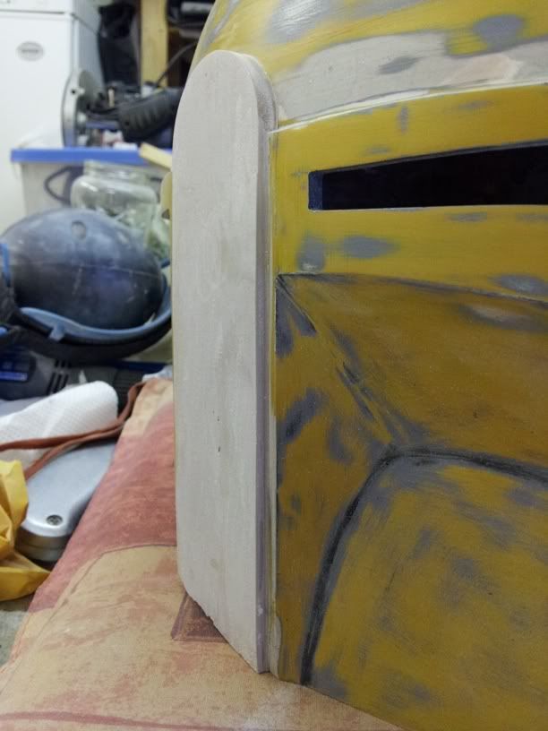

this time i'll post up the picture first (because if you're anything like me you looks at them first then read)
lets see if you follow what im doing.
and a small description, cut the circle out, cut it down the middle, and now i had a lovely semi circle, taped the crap out of it to stop the filler sticking to it.
cut some MDF strips for the sides, taped them up.
fixed them all in place with.. blue tack :unsure, it worked though
applied filler, wait 15 minutes, remove sides, let dry and sand to level/shape.
currently only sanded down the (helmets) left side, still do to the side with the range finder on.
hopefully get it down next weekend.
then make some ears, buy a range finder and hey-presto, done!

Not to intrude on your creative process, but don't you think it would have been easier to do those with styrene, or even some sintra?
You probably have a good reason for doing it that way, just thought I would ask. Great job, can't wait to see it finished!
Re: Boba fett helmet pep build (my first build) WIP still...
The only styrene I've found near me is ridiculously expensive. Seriously, I went to by some 5mm at my local art shop and they wanted £17 !!! Put it straight back lol. Filler is pennies over here compared to it...well that's what I found any ways.
