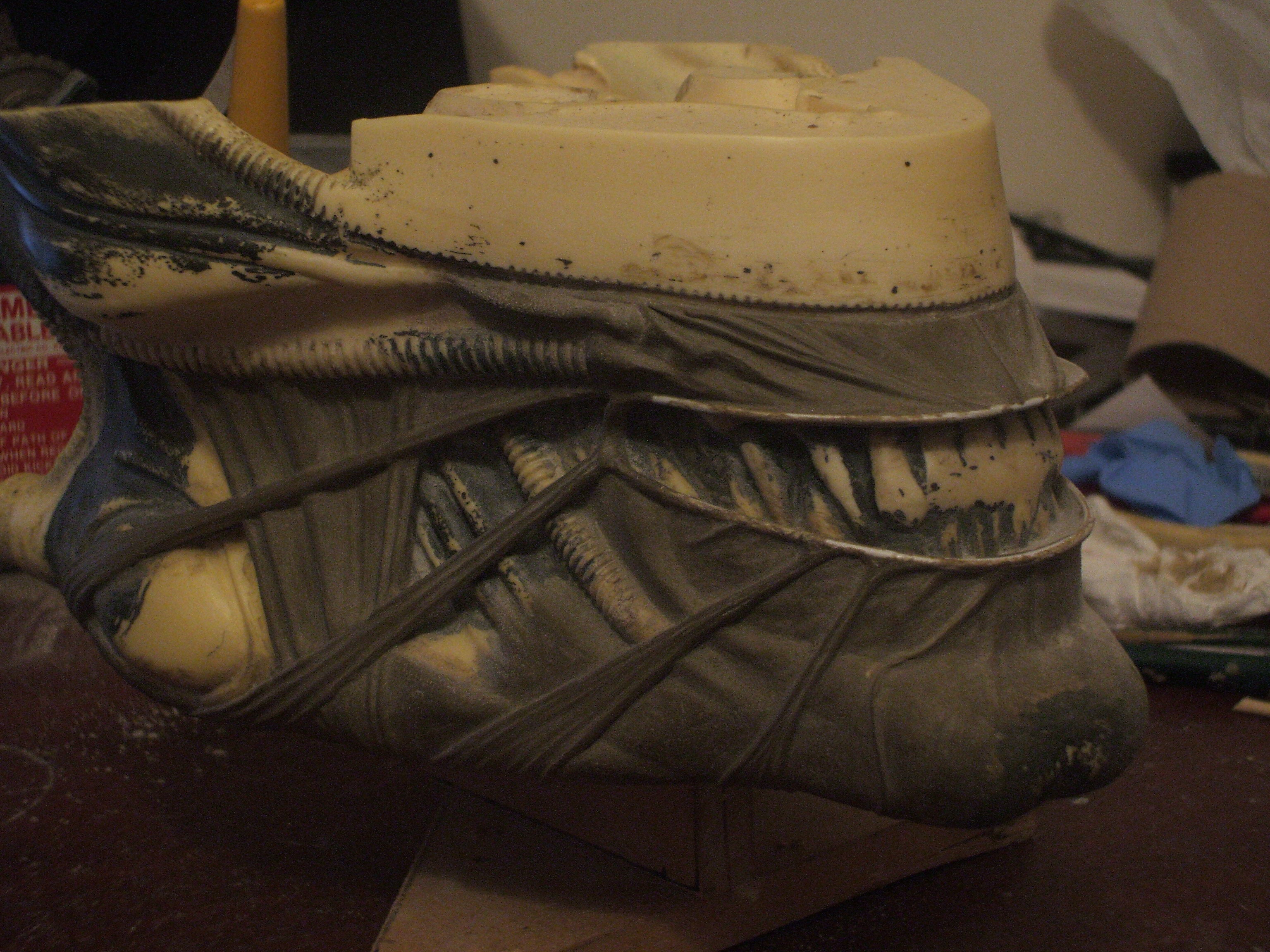

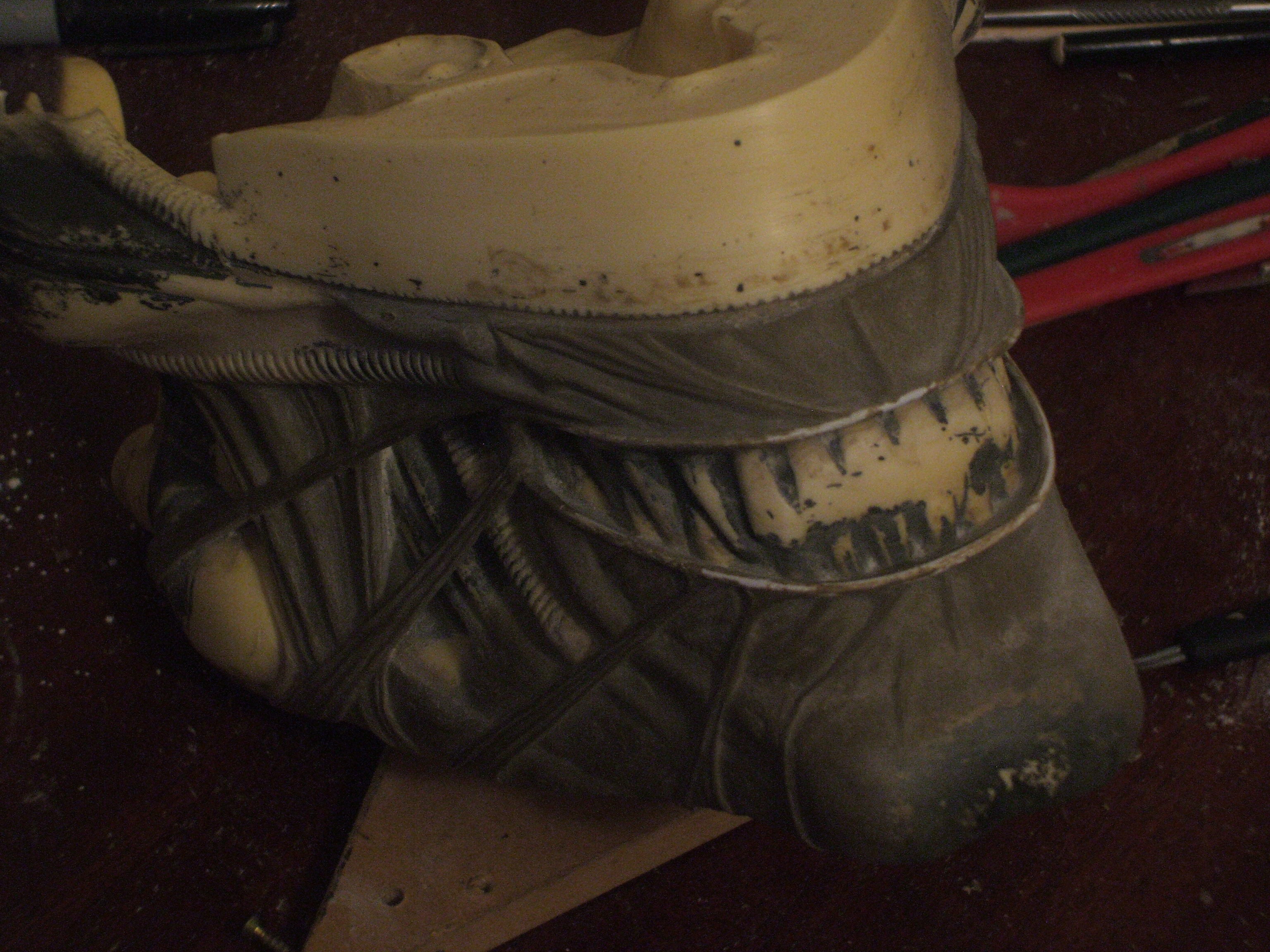

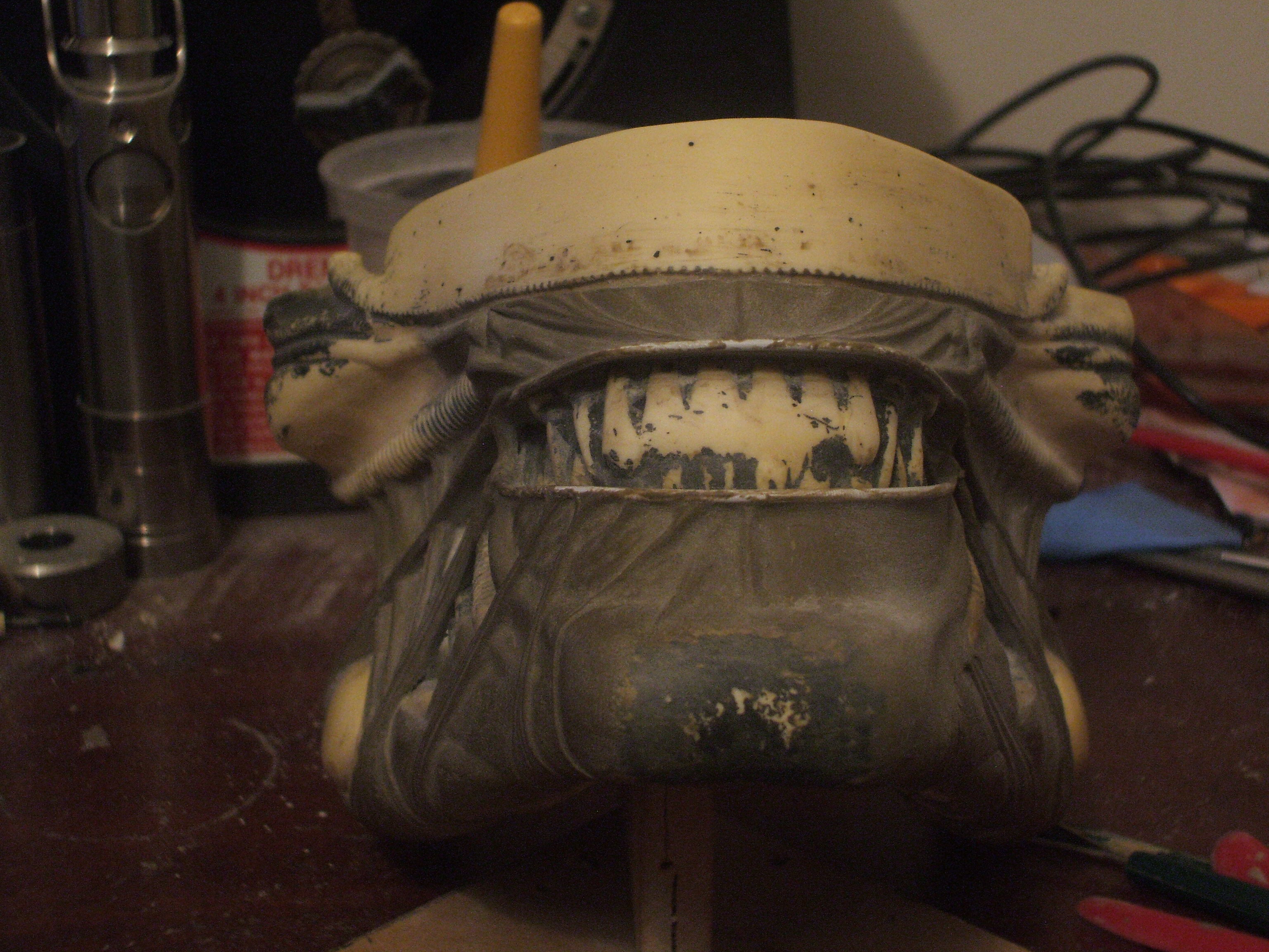

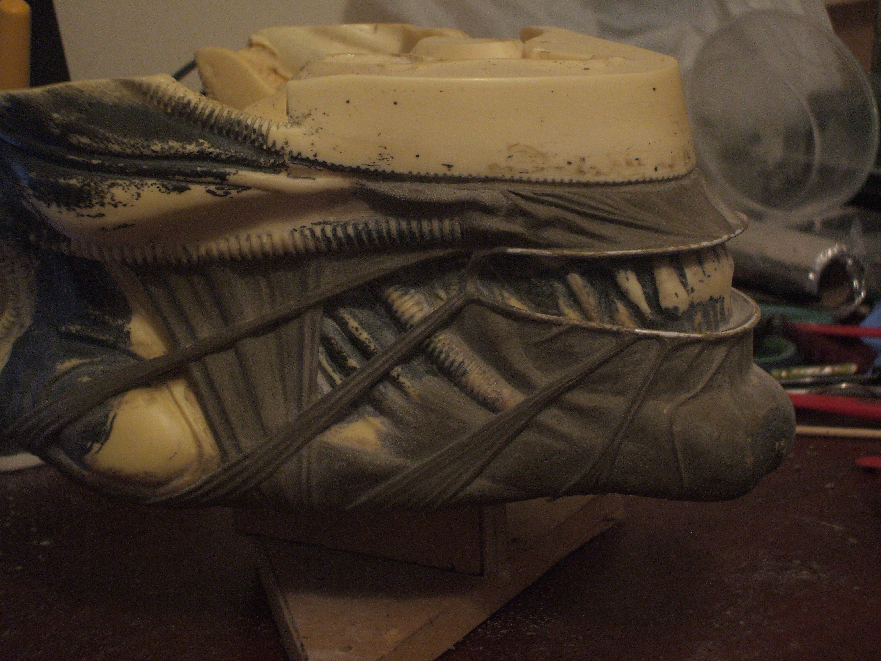

Here's those pic's :)

I like the new changes!
I actually thought your recent work was great as it was, I kind of liked how the lips formed a kind of special grin,
but the added/extended underlip is more accurate - and I also like the added wrinkles/folds in the upper-lip.
The string in the front of both lips also ads to the accuracy.

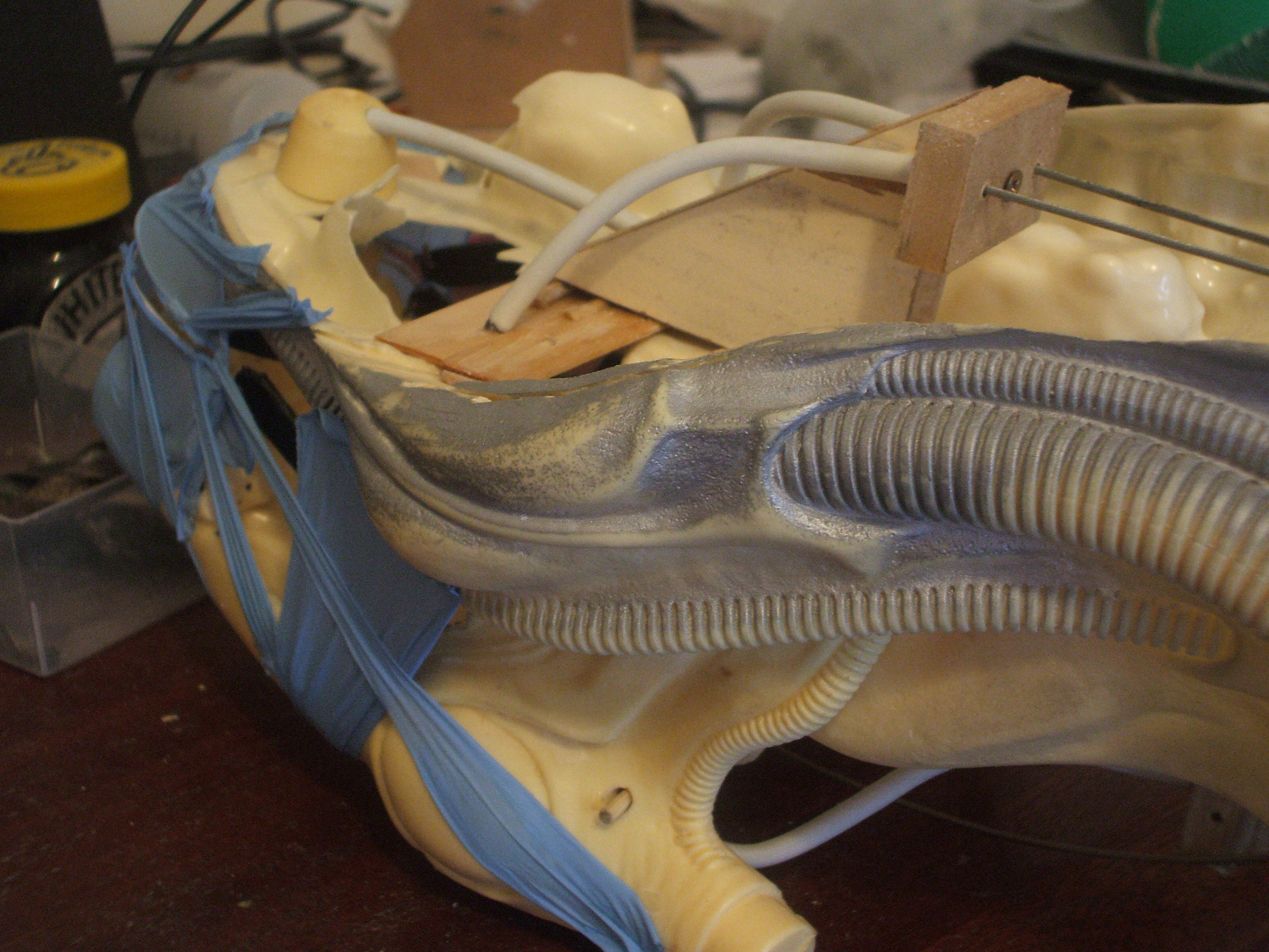

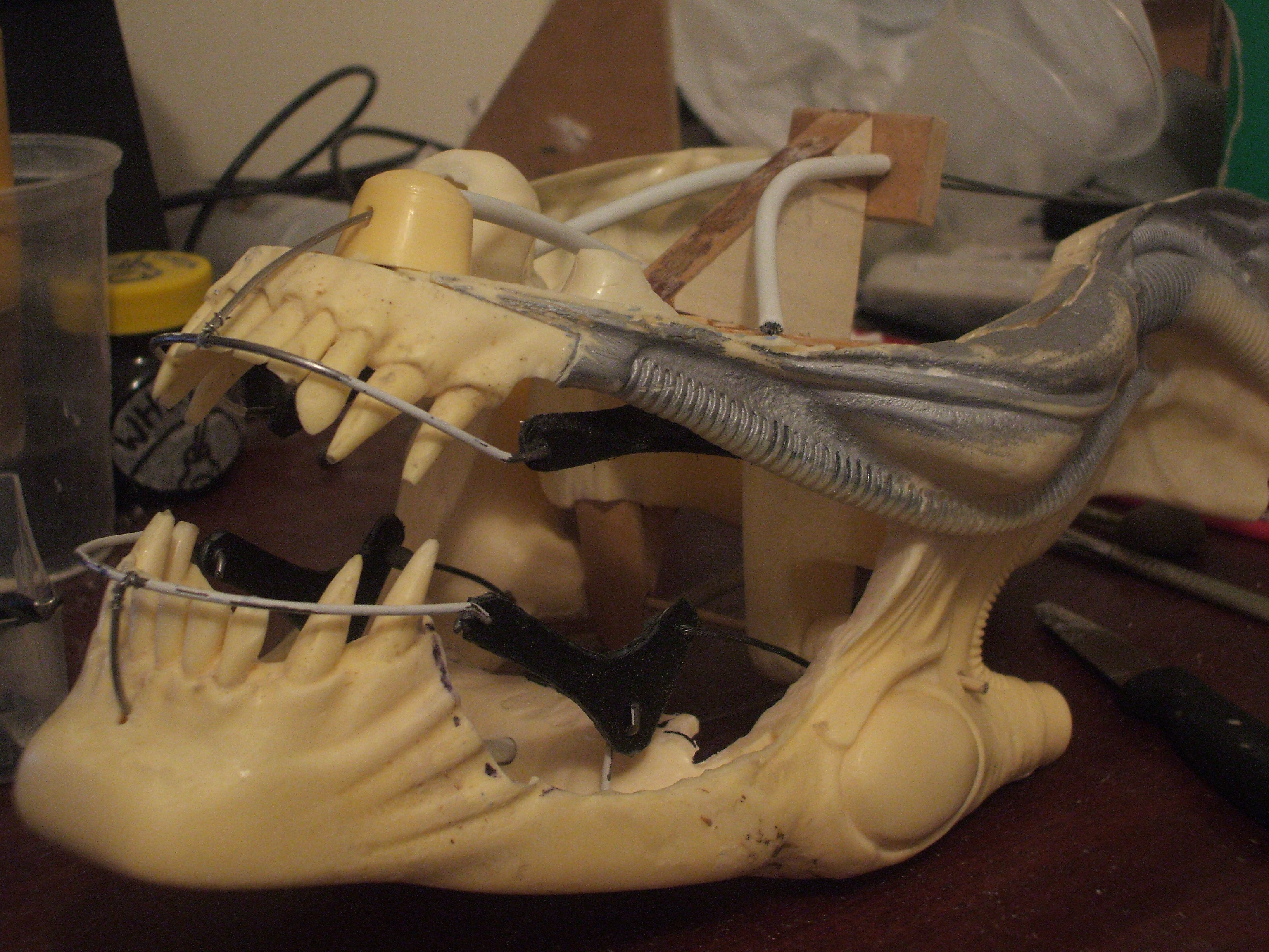

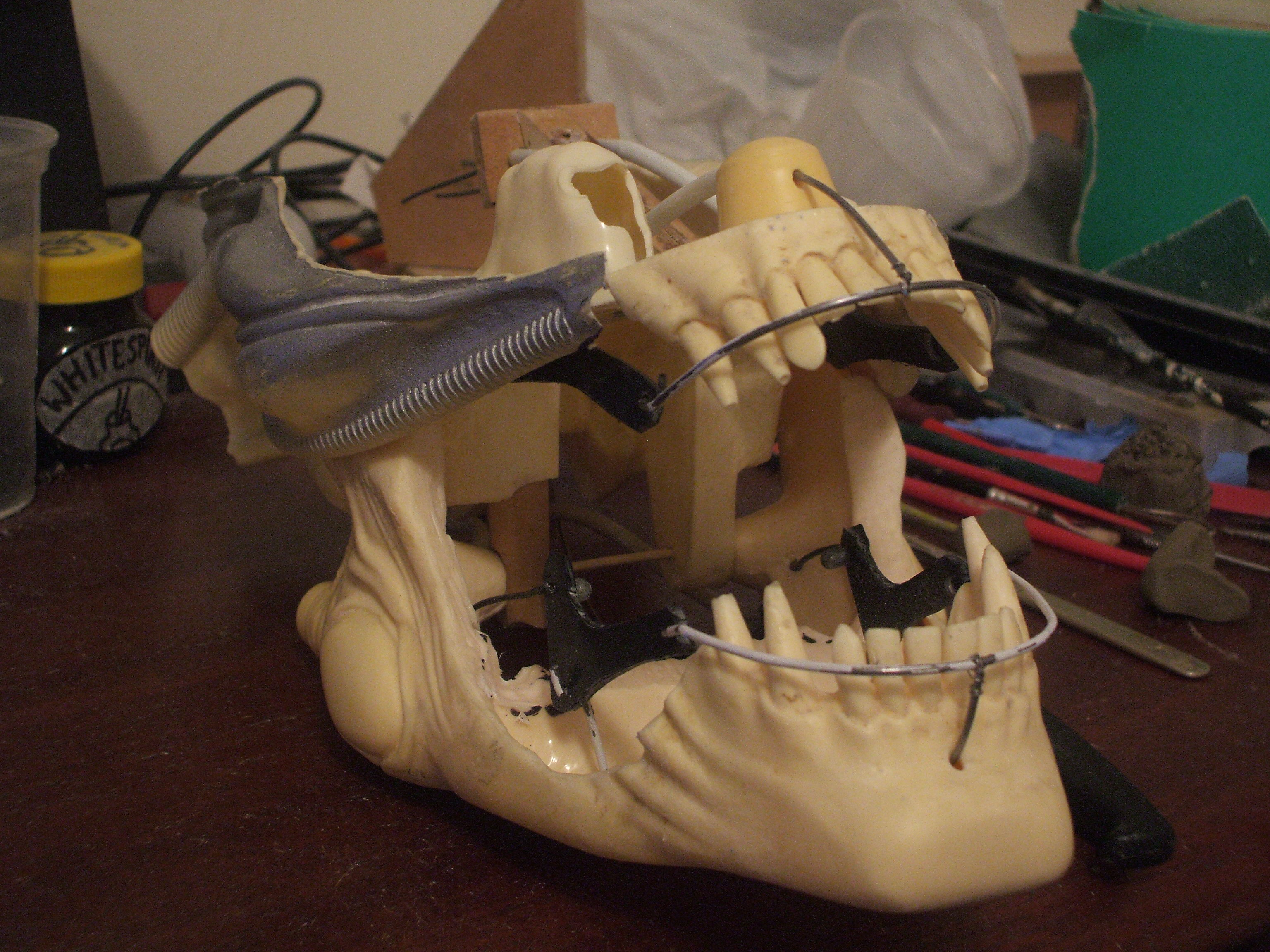

I've been getting a bit frustrated with sculpting the lips & tendons so I've taken a slight detour :)
Its very crudely done using bmx bike cables & broken casts amongst other things. I've never done anything like this before & I'm quite surprised at how quick & relatively easy this was! If I'd used latex rather than nitrile gloves it would move better but it is fully posable, I can even get him to raise his lip Elvis style :D
Having thrown this together I may well do it properly using better materials & metal brackets next time & it may well help me to do a better job of the sculpting.
As far as modding the casts I cut the sides & inner parts of the jaw away & recessed behind the upper rear most fangs, not much cutting really :)

Looking good Leigh.
Don't get those latex gloves near your silicone! It inhibits curing of silicone.
Lol, BMX cables...... Glad your nowhere near my Skyway. :lol

Thanks :) That's why I have nitrile gloves ;)
TA or Streetbeat? The cables were some old no name gyro cables & a pair of Astroglide offcuts :)

Gosh! I thought we'd do something hard. I did not expect mobile lips. I've stunned.:eek :) :thumbsup :thumbsup :thumbsup :thumbsup :thumbsup

:D Thanks DD
I do still want to cast up a set of one piece clear lips for display purposes but I'm beginning to think this may be the way forward for a mechanical head ;)
Here's a couple of pics of him without the blue gloves, you can see most of the mechanisms & you can see how crudely its been thrown together but it proves it's doable :)

Wauw!!! :eek That's Awesome Leigh! Great idea!.. It looks very similar to the way they did the original.
If you at one point are going to make your excellent creation available to us drooling fans, as kits
- it will be quite hard to decide on which version to get. The sculpted tendons and lips look stunning,
but this glove-solution seems to be a perfect alternative to those who want to be able to pose Bob with
the jaws open, tongue extended and so on..
Would love to see this done with a transparent material at one point. :)

This one is just a proof of concept using all discarded parts. I'm pretty confident I can do a better job of this with some refinement, it'll mean making/buying a complete set of parts specifically for the job.
I've realised I don't need to cut away so much of the bottom jaw as I have, I can modify another cast & include mounting points for the lever's & other mechanical parts, then pop it back into the mould & produce some plugs which should allow me to use the one mould to cast a full jaw or a modified one. I need to find a smaller cable to use & I need to remake the levers in something like PCB, I also need to fit springs here & there to improve the movement.
After that I just need to hook up the jaw & the tongue :)
