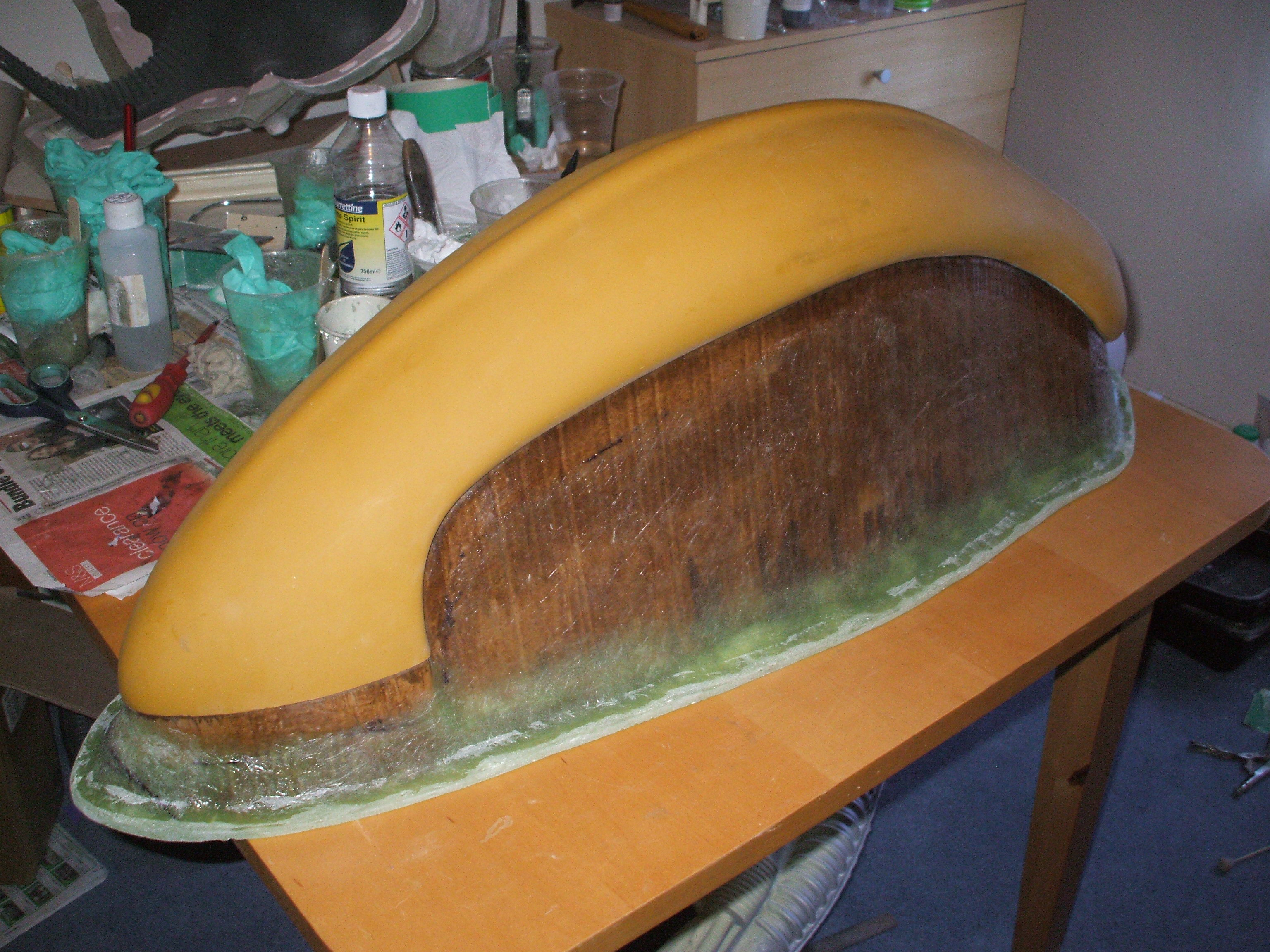

Re: Bob the Alien (Giger inspired Alien) Sculpting finished page 45

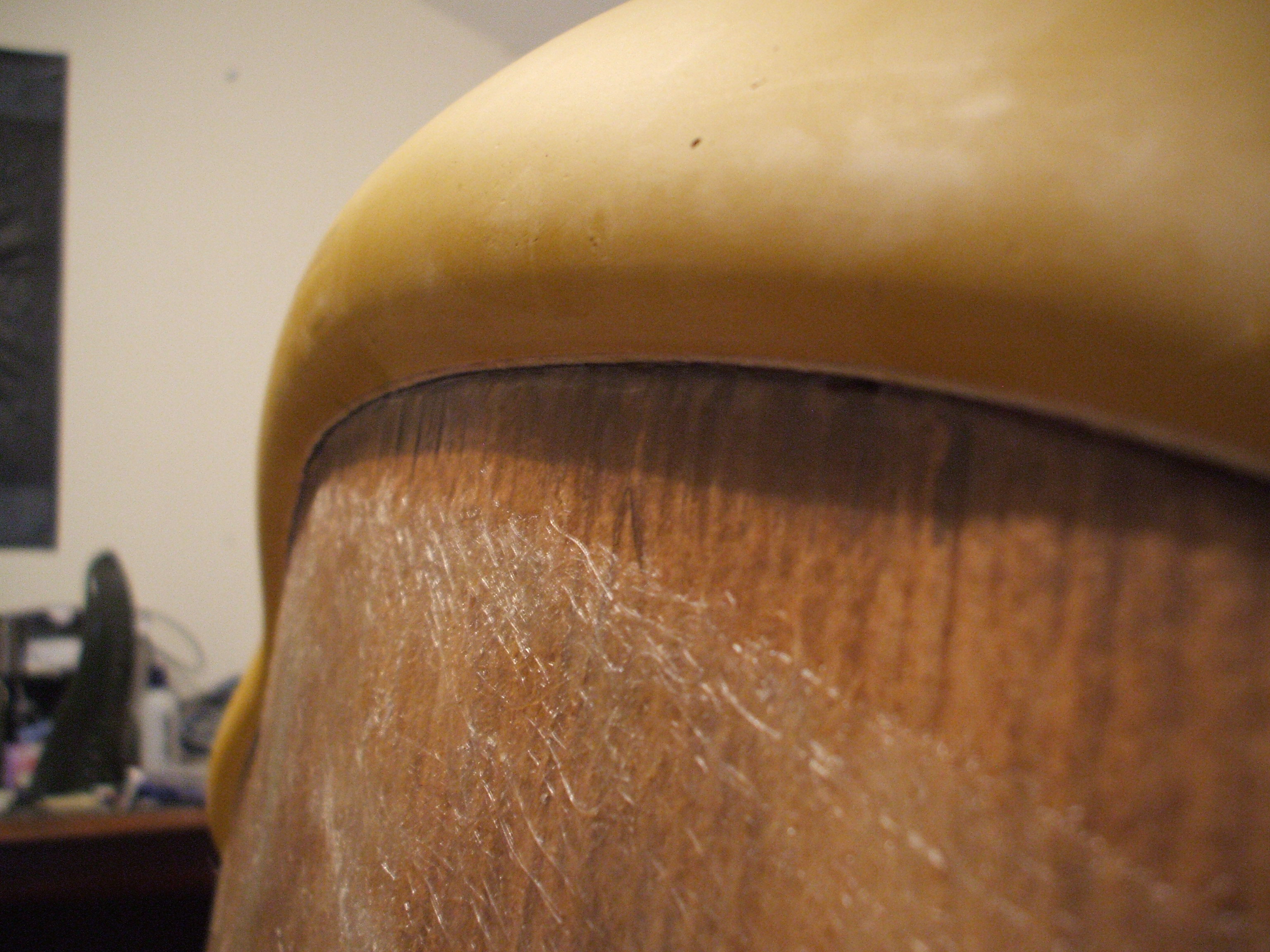

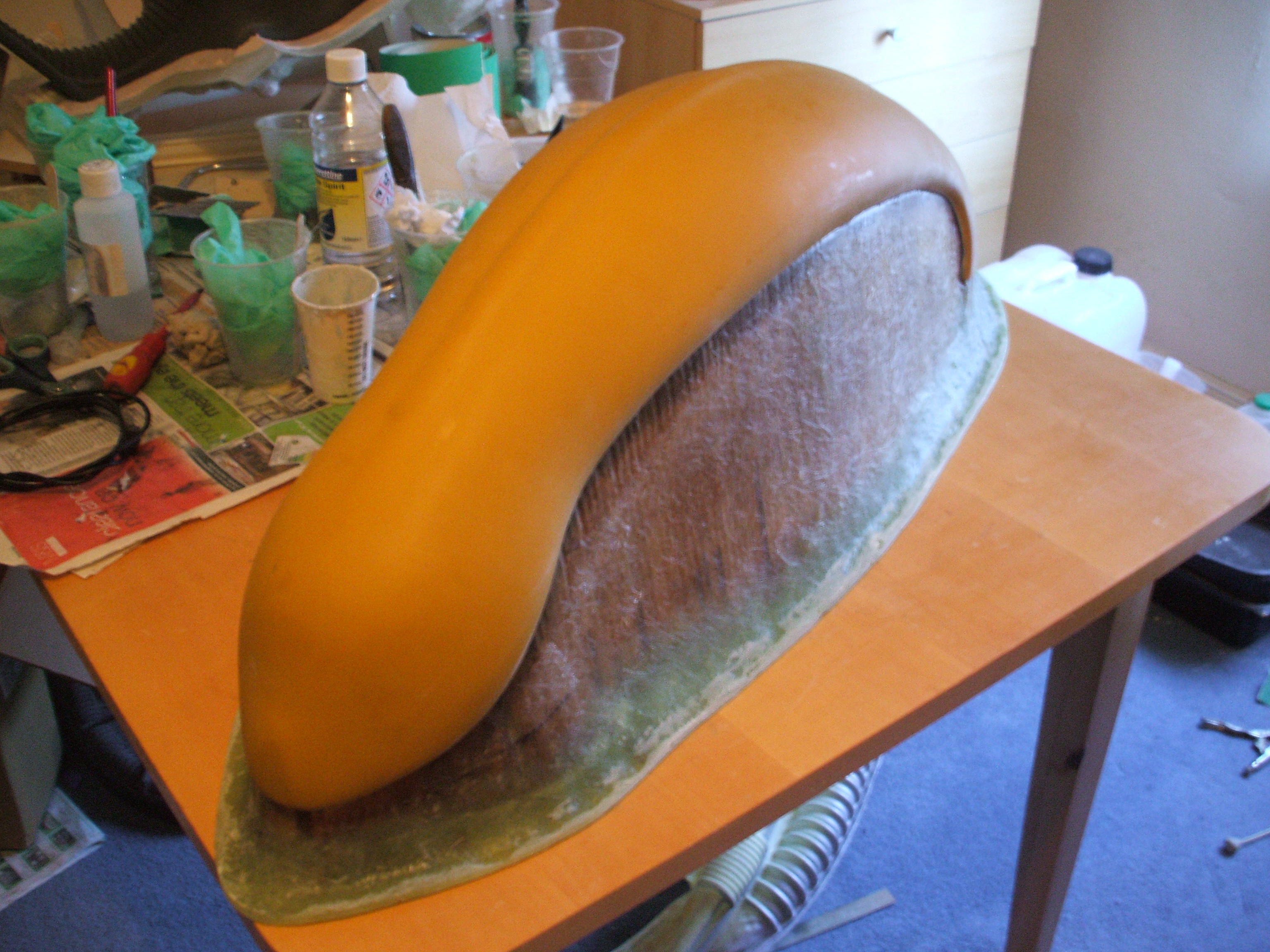

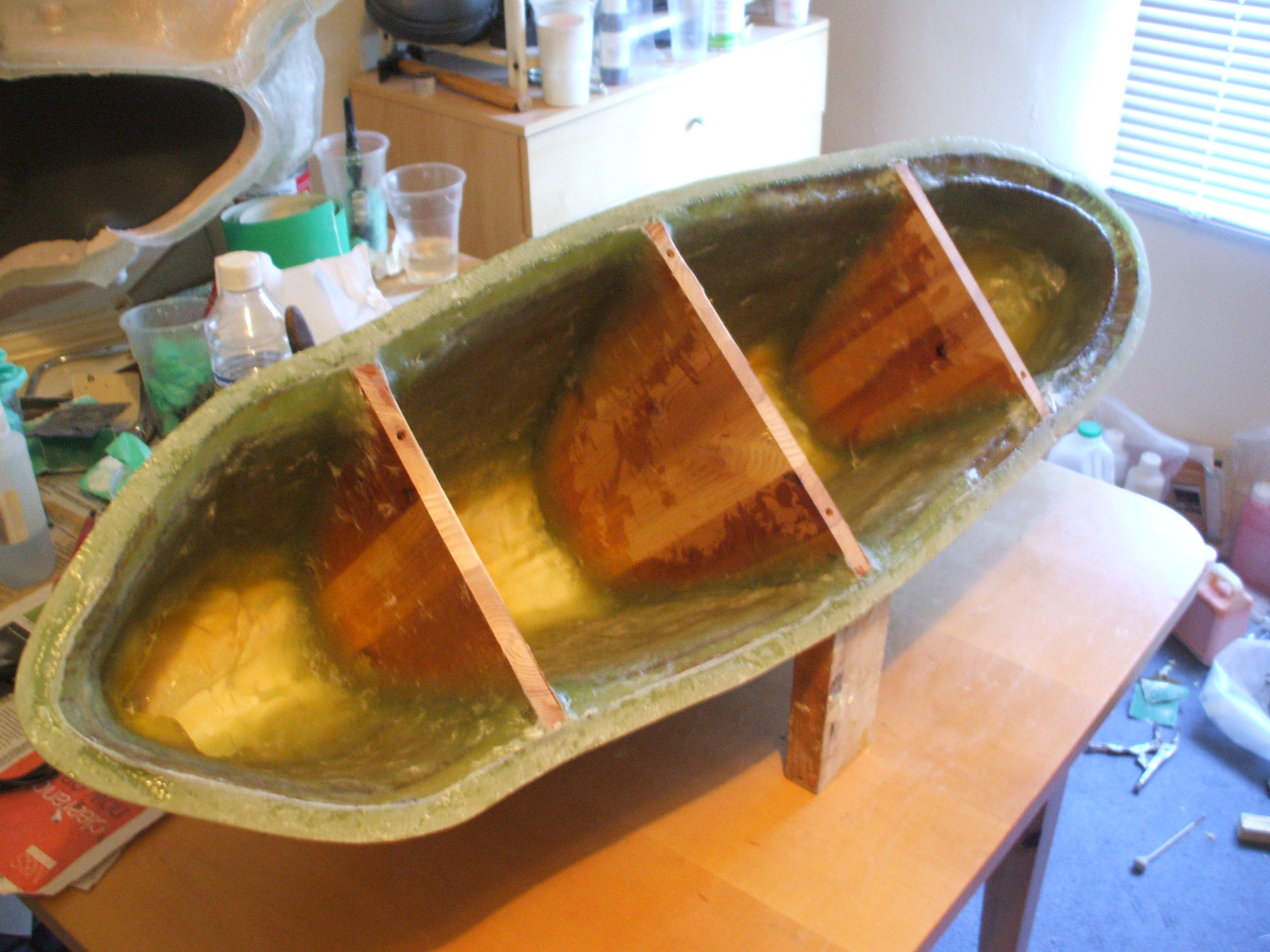

OK, I've pretty much finished the buck.
I've still got to rub the paint off, I've got a row of holes to drill just under the undercuts & a little fettling but the structure is all done. Its not very heavy but its very strong! the walls of the under structure are 1/4" thick as is the lip around the bottom. All of the under structure slopes outward from where it joins the dome edges :)

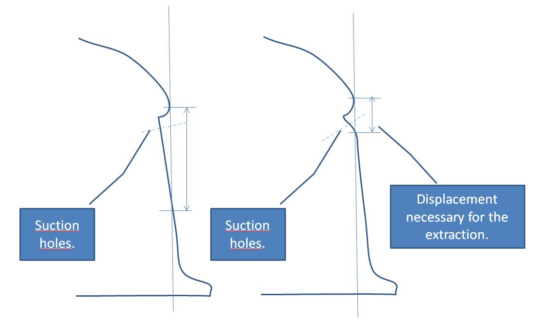

To remove the piece, maybe you will have remove it when it is still a bit 'hot. The operator told me he had done with this method, with mine. Or, if you can, cut it, leaving it on the mold without damaging the mold. The undercut is very pronounced and the outside figure, thence. Will require a considerable shift in the vertical direction, so that the width of the part exceeds that of the mold. You should leave the rear without undercut, only a small furrow to identify the cut. This rear area would help to begin to slip the piece. I'll give you my best wishes. :)
Thanks guy's :)
DD your worries are fully justified :) The buck closest resembles the pic on the left in shape. I have accepted that this wont just pop off of the buck, it'll need a little effort to remove it. Firstly my plan is to use Polycarbonate & at approximately 1mm thick after forming, so maybe 2-2.5mm thick before forming. Anyone who has knowledge of the polycarbonate RC car body's should be familiar with how flexible & tough polycarbonate is. I plan to trim a large part of the waste away prior to removal to ease things a little & then trim to finish after. I'm not expecting it to be easy but it has to have these undercuts otherwise it'll be the wrong shape :)

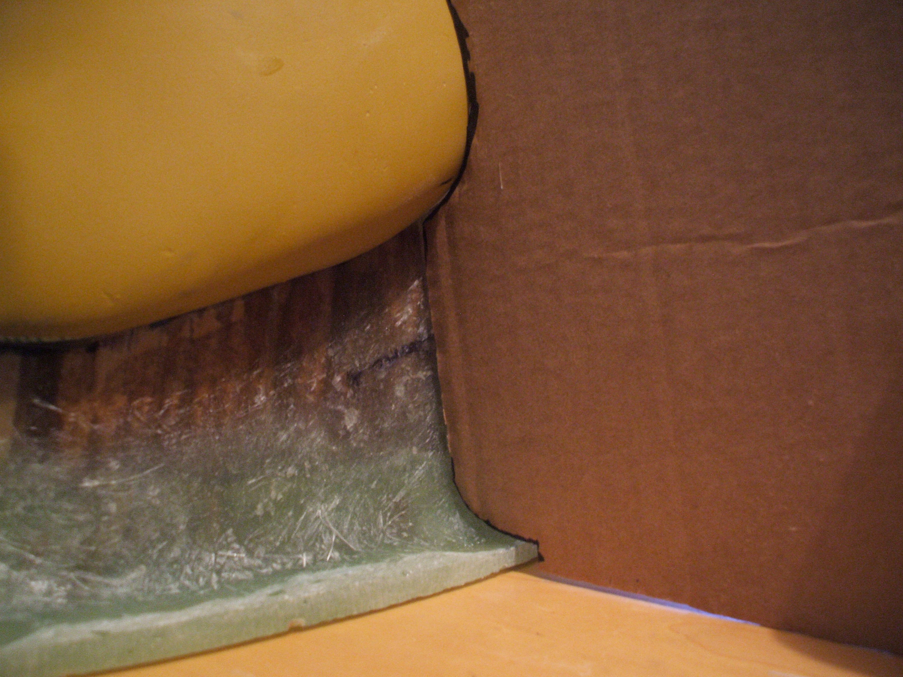

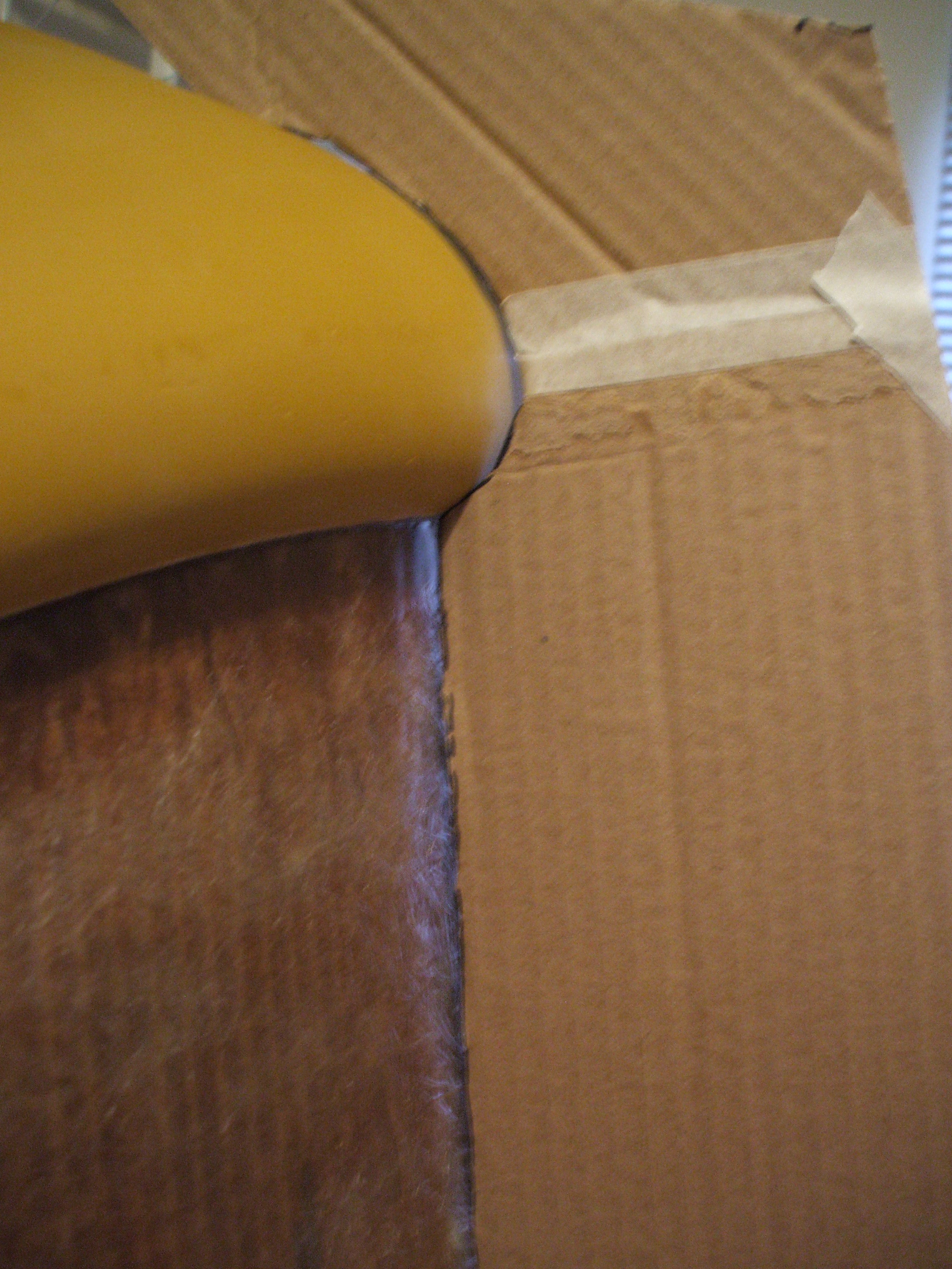

I've made some quick n nasty cardboard templates to show you guy's the shape & size of the undercuts :)
The first pic is about half way along the head & is the biggest & deepest undercut:
This second pic is at the worst undercut of the front area:
This third pic is the cut off line at the back, this is here purely as a cutting guide:

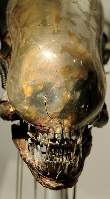

I found some images of the original Alien head as it is now... bit saddening to see the masterpiece turn into dust..
but it's interresting to see the mechanics...

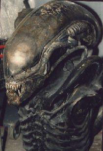

other picture:

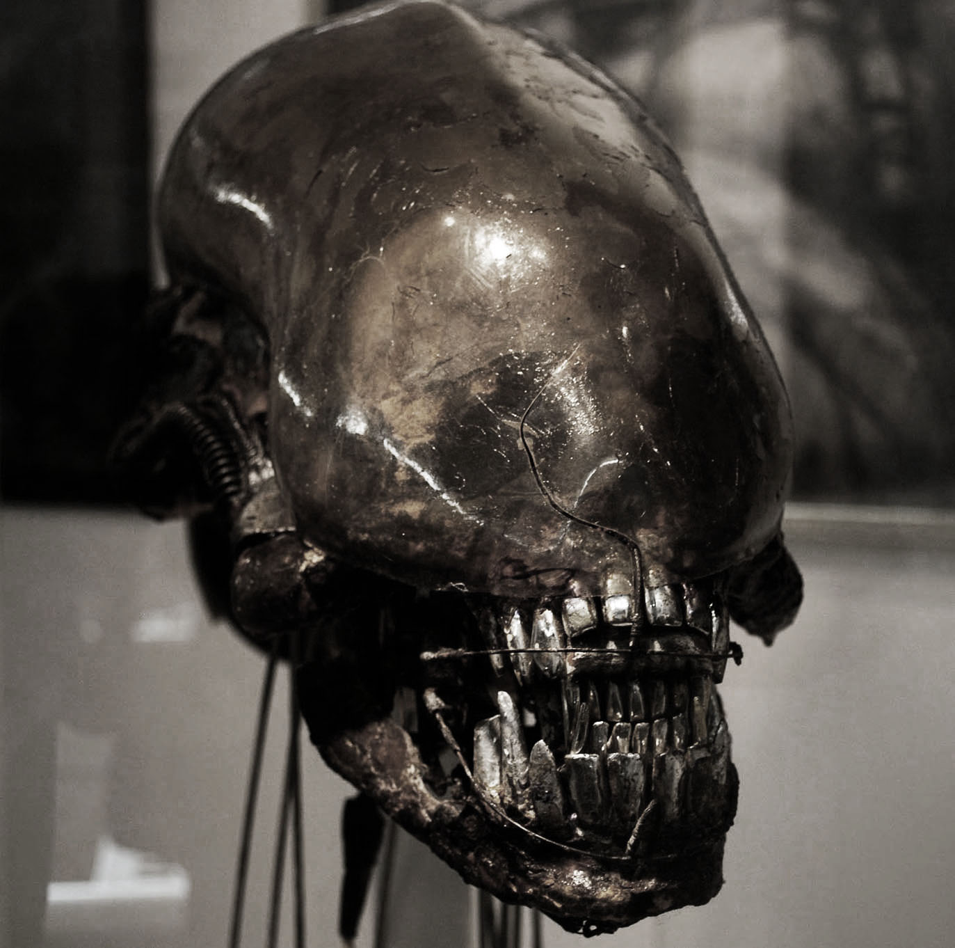

and another one:

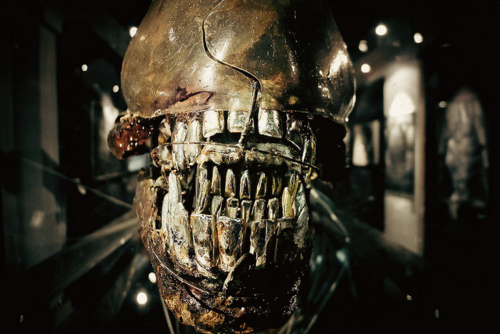

This is from the other suit (non mechanical head I suppose):
