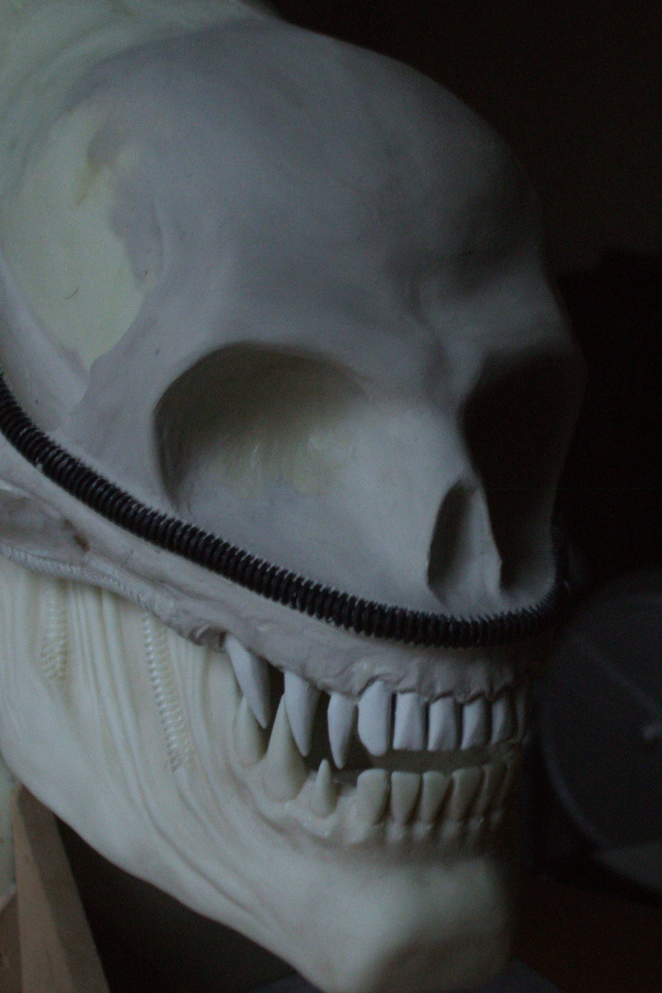

Thanks for the kind words guys :)
I just couldn't leave it alone :rolleyes I've re-shaped the brow & forehead area again.
I didn't like that vee shaped bit on the forehead, it didn't look right, I'm happier with it now :)

Oh yeah. TBH I hadn't even noticed the vee. That does look better. Leigh, I can't get at my refs at the moment because there's a wall of giant Weta boxes in front of them, lol. Does the original skull still have sutures visible? If so, gonna put them in?

I cant see any in my refs & I dont want to put them in tbh, I just wanted to get the overall shape to a stage I'm happy with. By the time its painted & the cowling's fitted & painted you wont be able to see much of it anyway. I'm hoping to paint it the same as the original with the veins etc but for the time being I'm done with the skull part, I need to move on to the rest of the head & get the spines done.
I'm pleased with how it looks atm. It still needs some smoothing & texturing, once I've got the spines & the back of the head shaped up I've got to go over the whole thing & then think about sealing it prior to moulding.

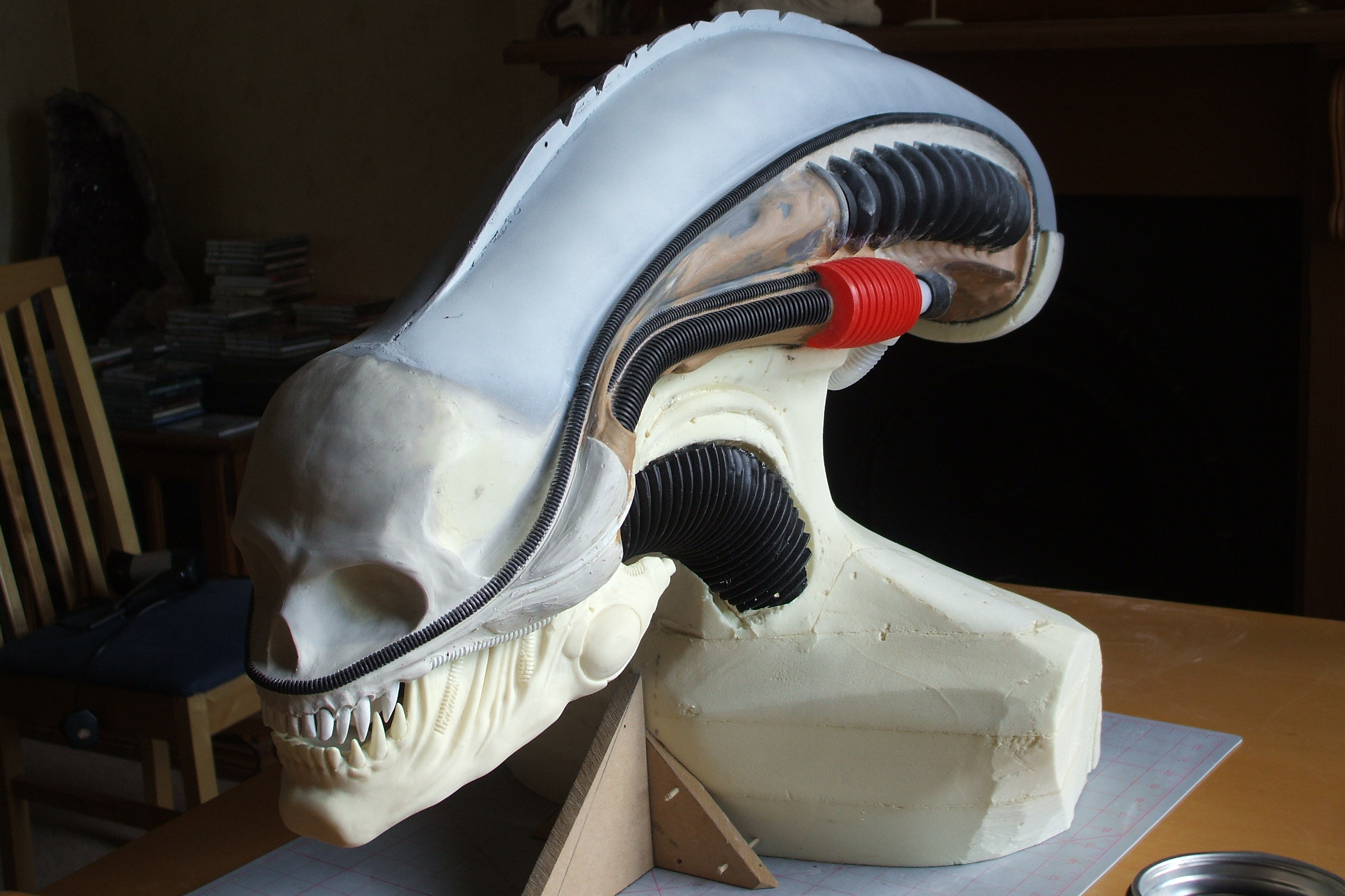

& heres a little update:
I've used car body filler on the sides of the top of the head to give it a hard & smooth finnish & I sprayed some high build acrylic primer over it.
Now I can crack on with the spines & the tubing in that area. Oh & a little blending here n there with the clay :)

thanks for the reply, is the foil easy to peel off or do you need a tool?
also what are these pipes you used here?

Fingernails for the foil. the pipe on the side of his head is Flexible rubber radiator water hose used on cars etc theres some on ebay atm in the uk but its expencive at £30 a meter & the shortest length is a meter. The pipe on his neck is only temporary atm (its actually an Austin Mini heater duct pipe), the closest stuff I can find that looks right is clear flexible dust collection hose.
