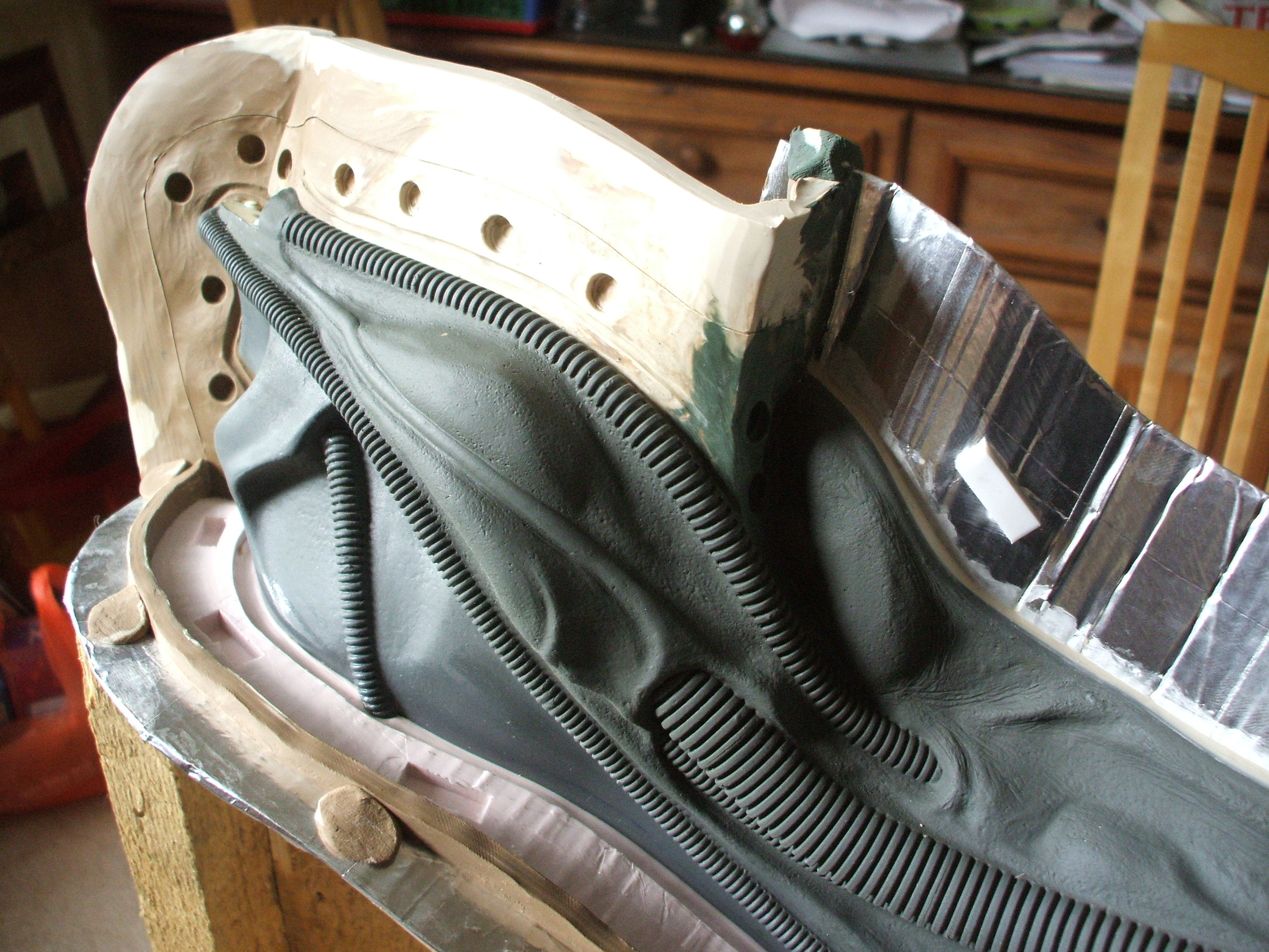

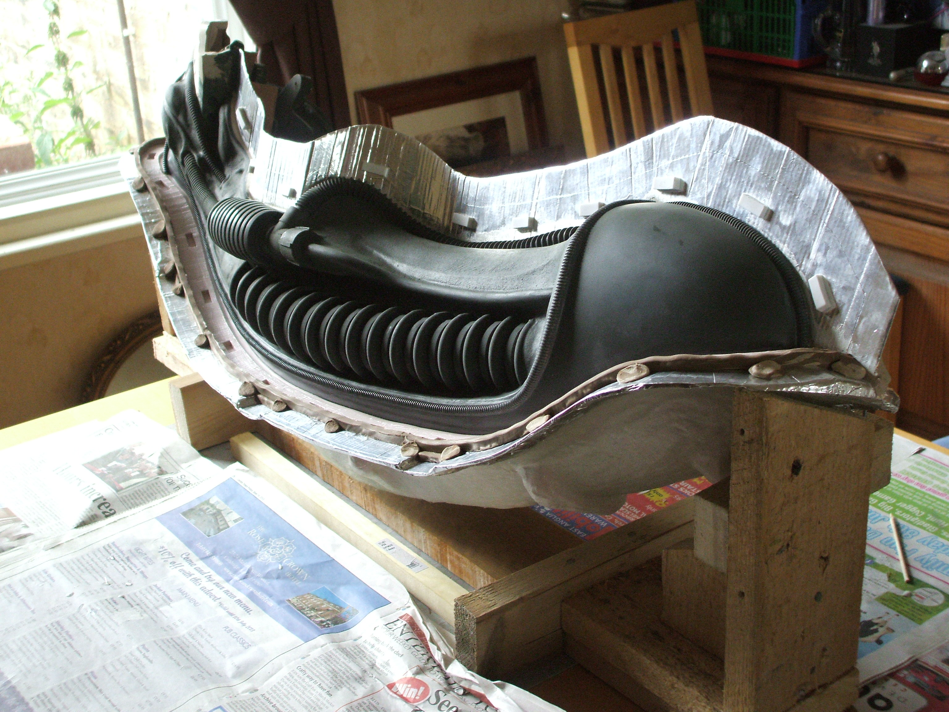

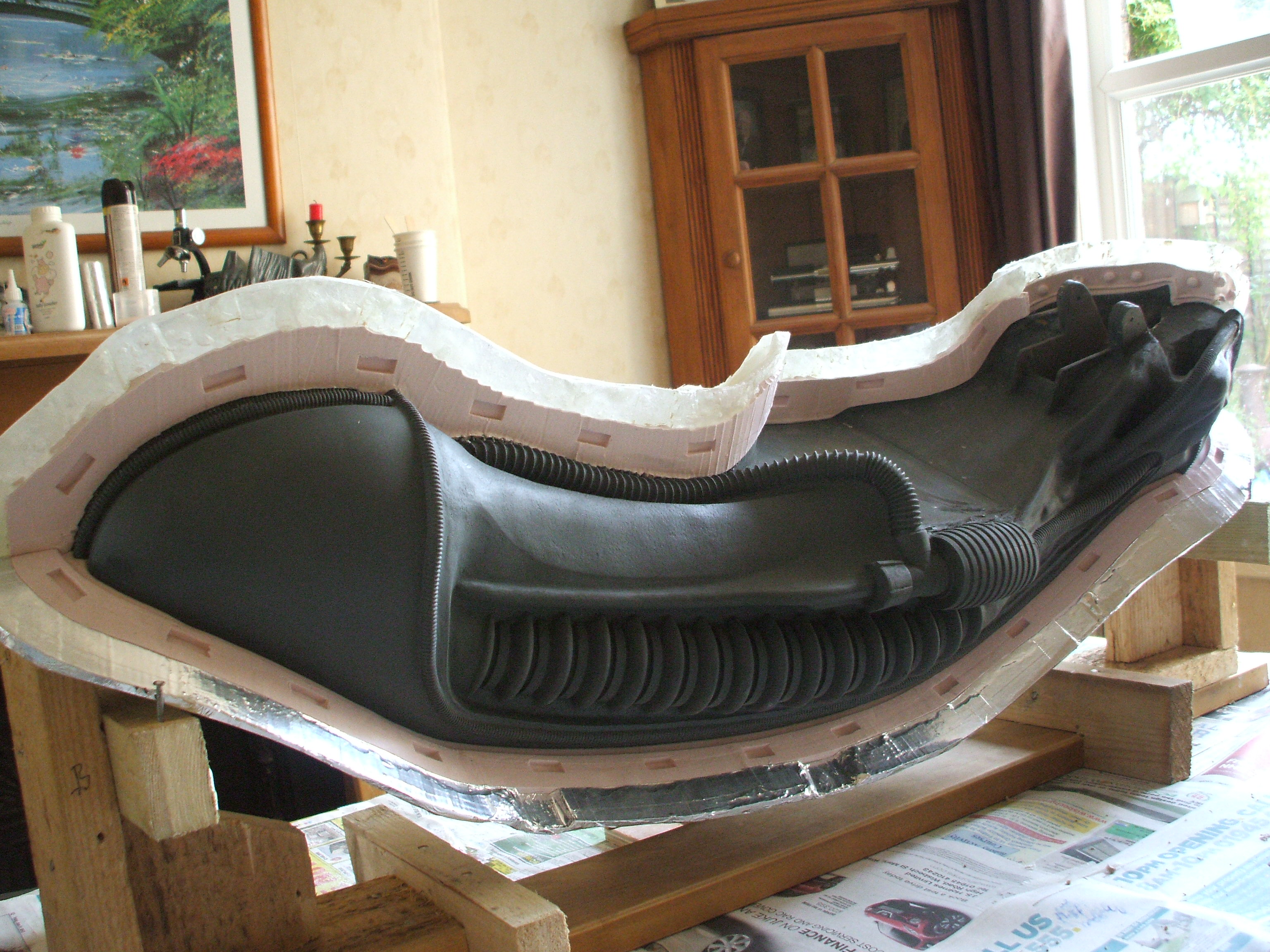

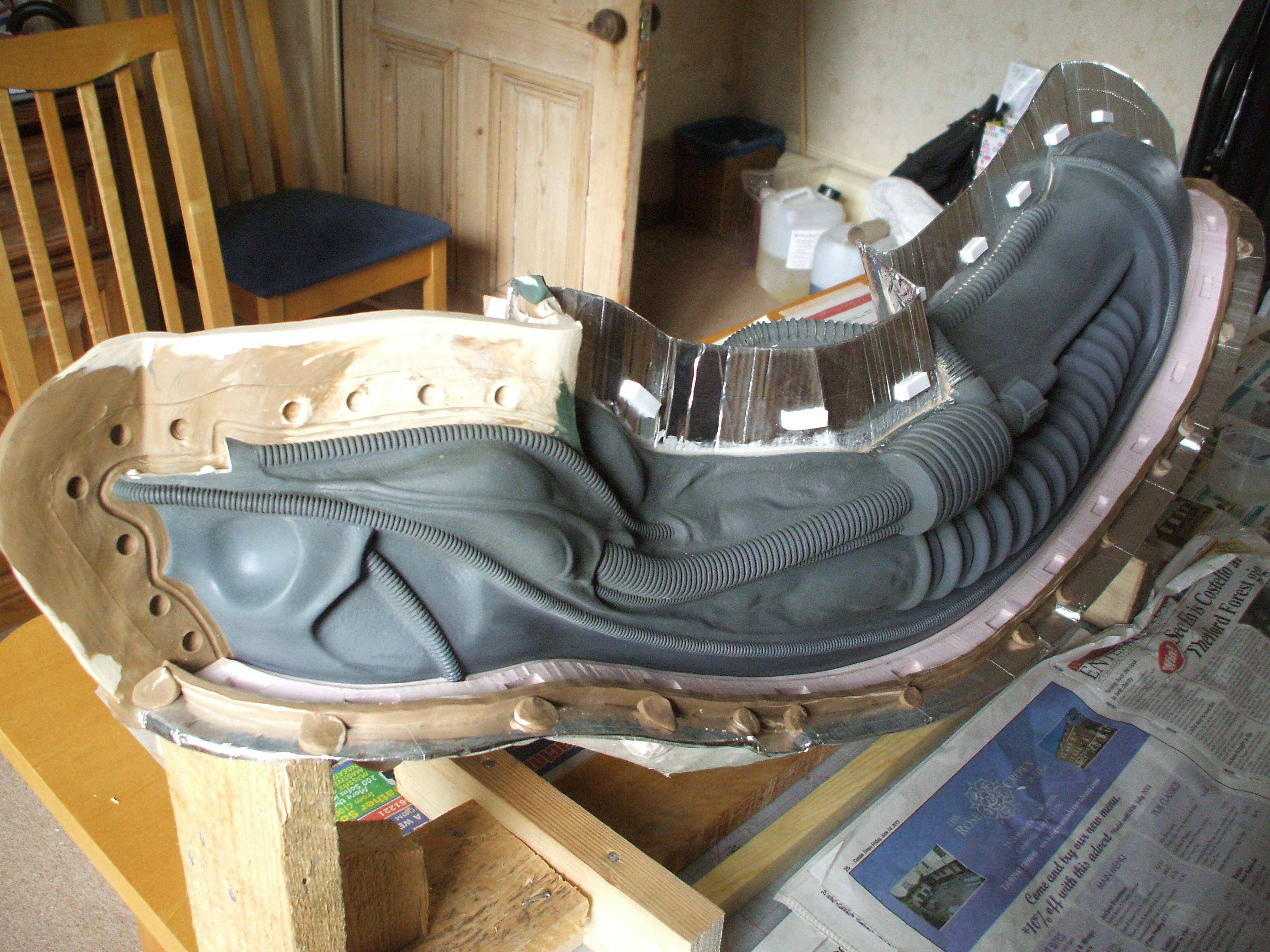

I hardly touched him over the weekend but today I've been preparing for the next mould part.
I was hoping to get the rubber done today but it looks like its going to be tomorrow now or I'll be up all night.
Here's some pic's:
I did quickly knock up that wooden frame to support him on over the weekend though :)

The prep work and detail on the molding process is insane and a masterpiece in of itself. Amazing job! Thanks for sharing all of the details pics as you go along it's a great reference for anyone doing castings ... of course you have set the bar pretty high :lol

I'll be putting the rubber on in the next couple of hours, if anybody spots anything that doesn't look like it'll work... Please let me know! :)
Re: Bob the Alien (Giger inspired Alien) Sculpting finished page 45
It's all looking very practical to me. :thumbsup
I do think you're gonna need that steel frame, though! :lol

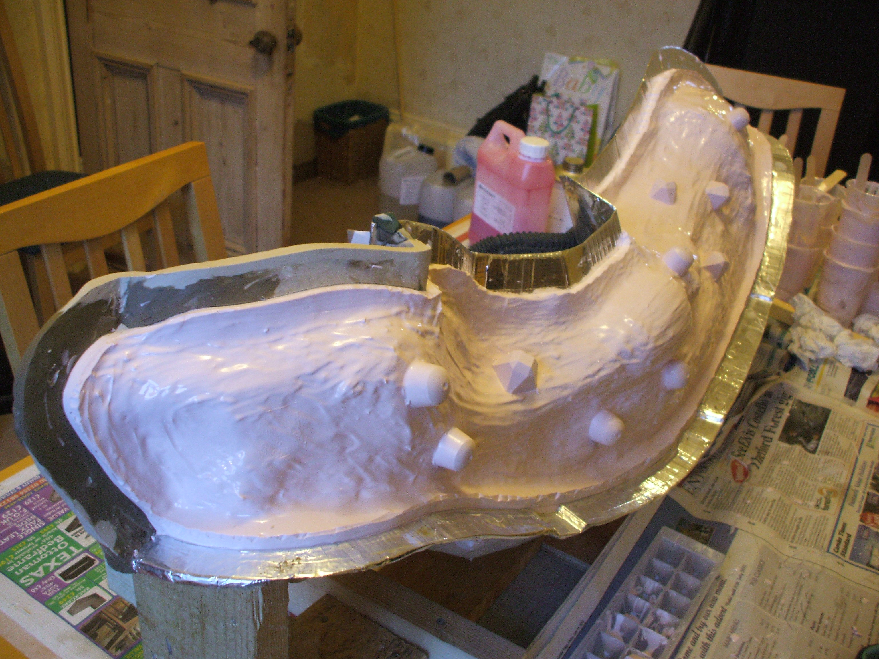

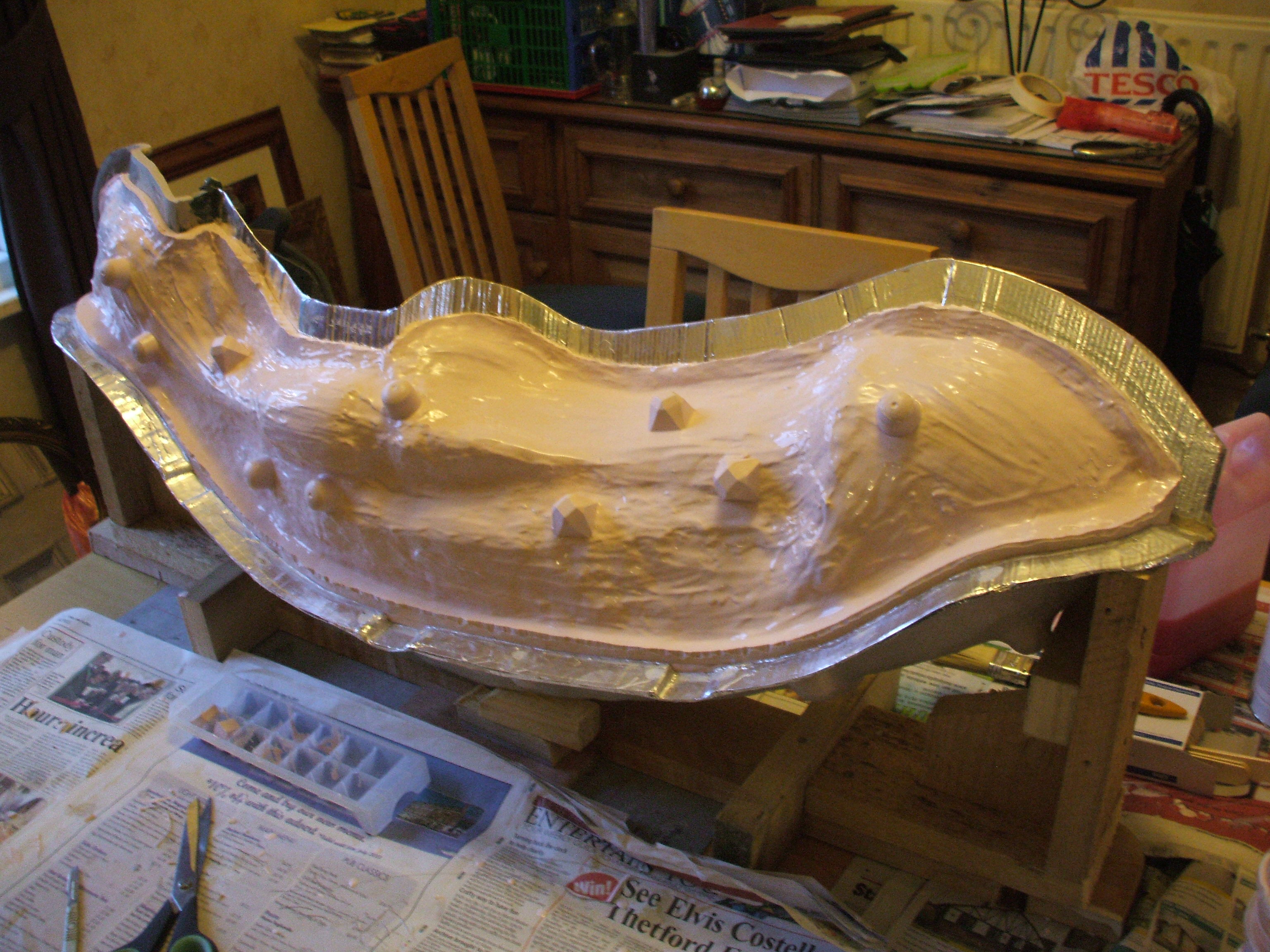

That's the rubber sorted for this side.
14 hours I spent on that! including drying times between coats & it went by so quick :eek

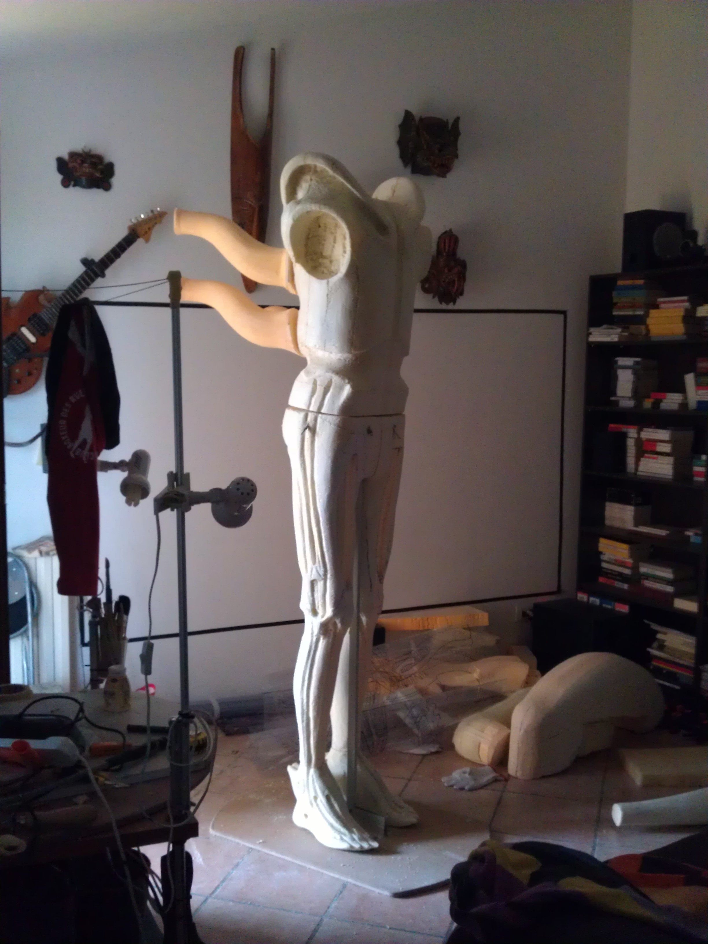

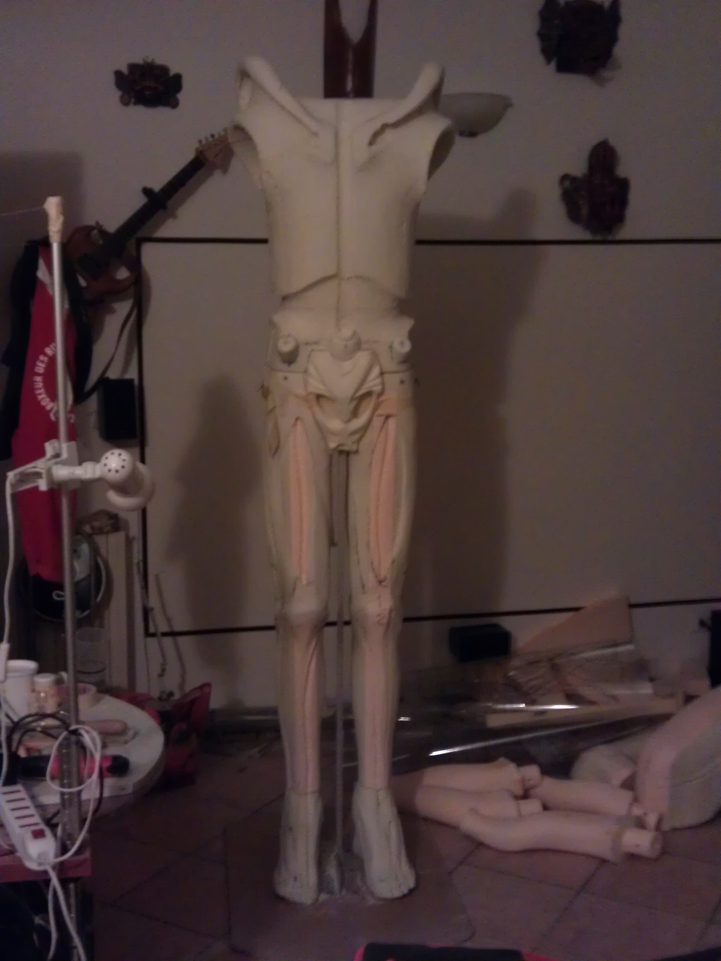

Thanks for the advice. Four small central pieces I made them with the polyurethane which is much more moldable polystyrene. The ribs will make the coating of hollow tubes with DAS. But the difficult parts are the face and the transparent dome. Would you sell me the transparent dome? It is in scale 1? How long is it?:)

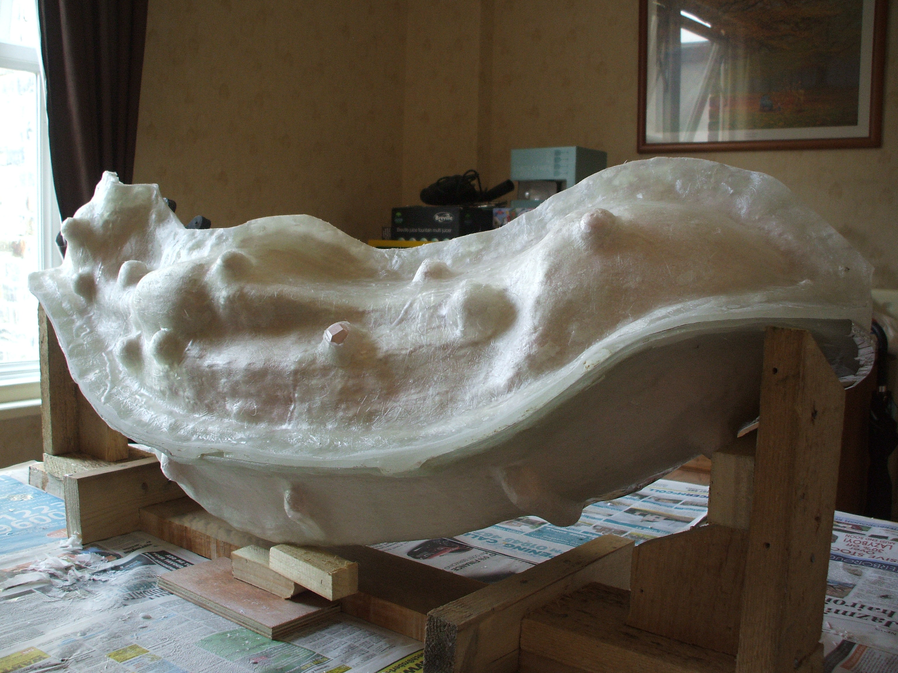

Right, it seems like this is taking ages &... well...it is! :)
I'm letting everything cure properly before moving on.
I've got this part of the Jacket done, I can now start on the next bit:
This has come out nice & strong, real thick on the edges :)
