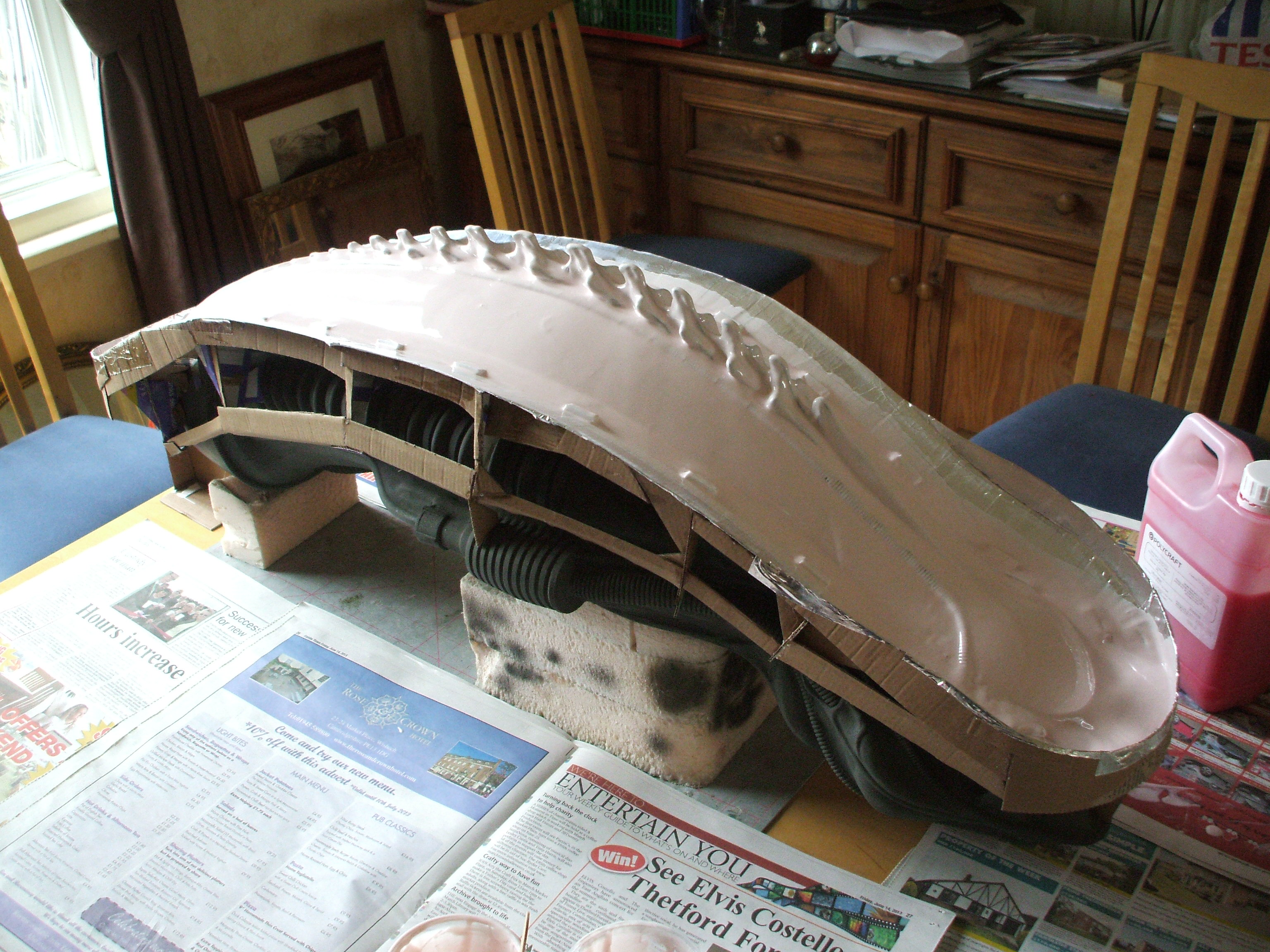

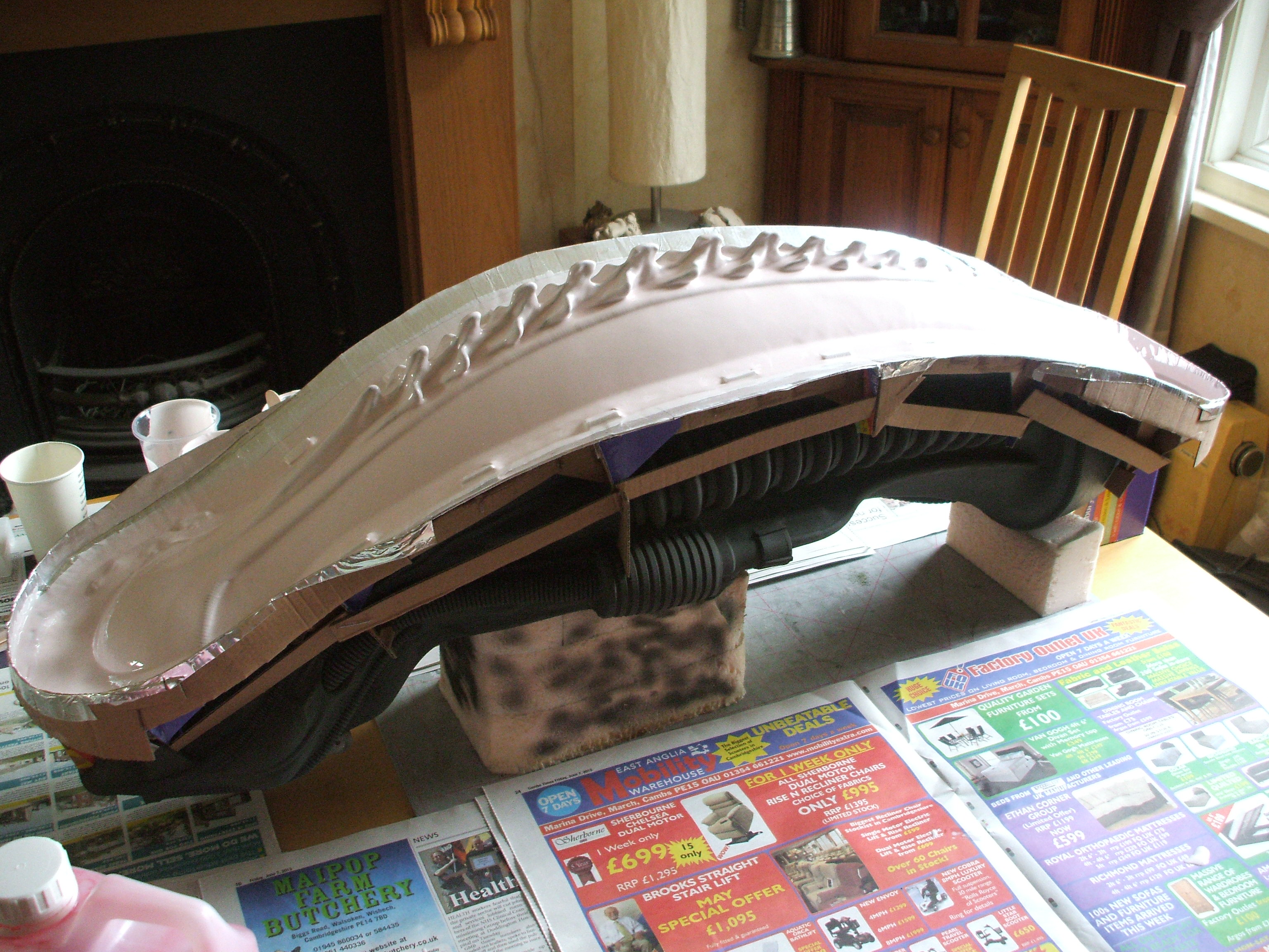

I've chosen to keep to the partitioned mould & made a start:
This is the first two skin coats, no thixo :)

He shouldn't deform or sag, he has a vertical sheet of hardboard running right through the middle of his head, however I have added some small bits of wood under the front since I took those pic's just to be on the safe side :)
I'm about half way through the thixo bit now. All the spines are covered & the flange is built up to thickness. Really I've just got to do the smooth parts either side of his head, smooth it off a bit & then one non-thixo coat & its done.
Its so time consuming! Since I'm mixing up 200g at a time I'm having to keep mixing up as I'm getting through it quickly on something this size.
I don't know what they put in the thixo but its having a strange reaction in me! It does have warning signs all over it, Prehaps I should open a window :lol
I've had Radiohead keeping me company all day & I'm enjoying myself :)

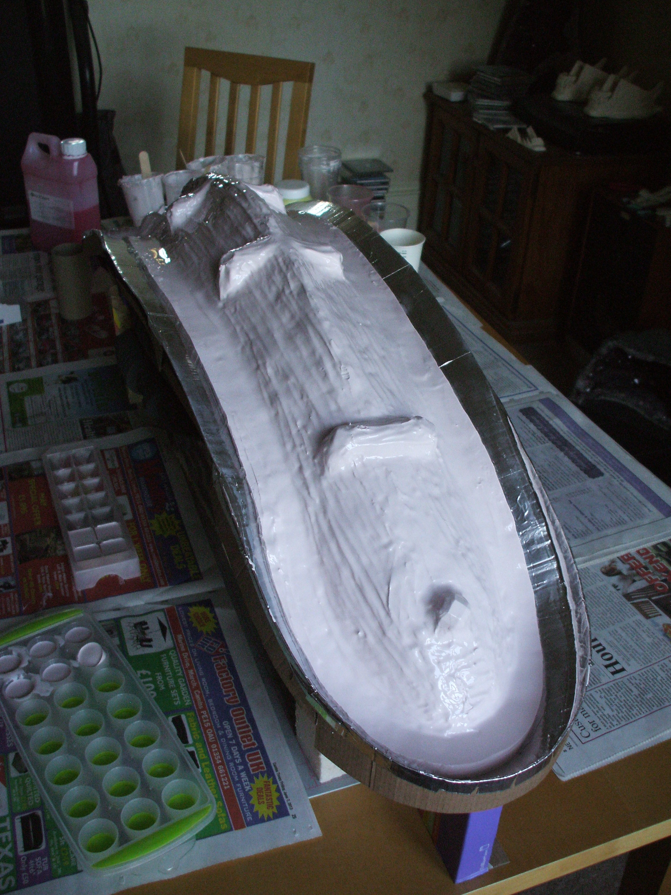

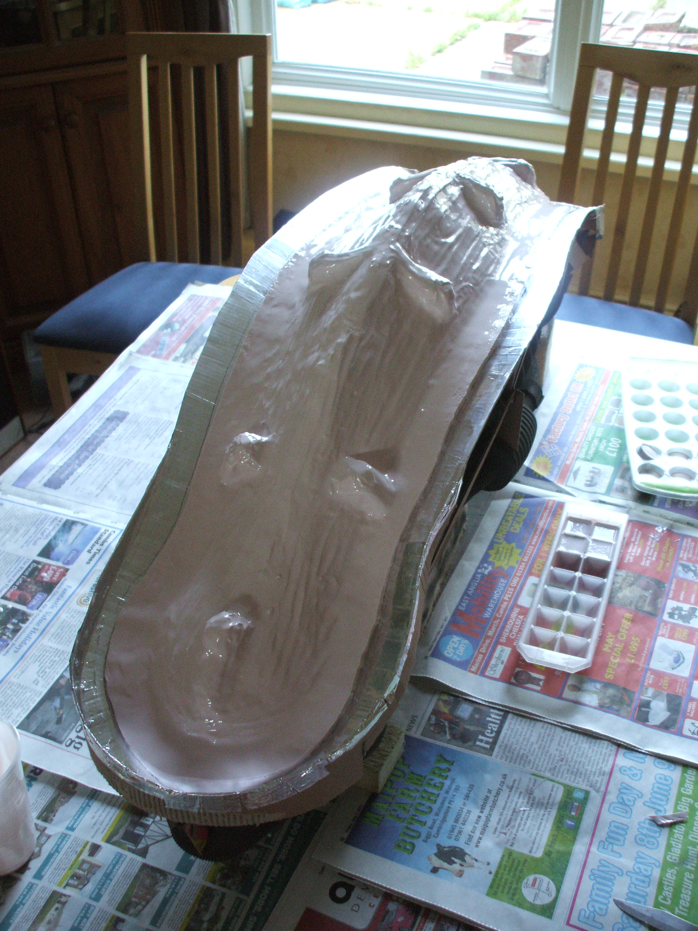

OK, the rubber for this section is done:
Next step will be to cover it in Fiberglass which I might start later on :)

Leigh, is the edge a bit feathered? It looks thin, which might not be any problem at all especially if there is more thickness closer in, but could also be more susceptible to tears than you really want it to be. A lot depends on your silicone, and how you handle it too of course.
Whatever the case...tidy as hell!

Martyn, I had actually thought about using cheese cloth on the flange.
Its about 6mm or 5/16" on average at the cut edge & at least 3/4" thick at the ends, it gets thicker the further in towards the head it goes. I would say that its at least 8mm thick on the thinnest parts over the head, closer to 10mm or 3/8".
I figured it should be thick enough once reinforced by the jacket.
As far as tears go, I'm very careful when I'm de-moulding. The rubber is the most important part to me & very costly as you know to replace. Keep your fingers crossed eh :D

With this one I did two skin coats applied with a regular artists brush, then several thixo coats applied with the lollypop sticks & finally one more non-thixo coat again applied with the brush. I don't use my fingers at all but I have trimmed the edge once its dry. :)
