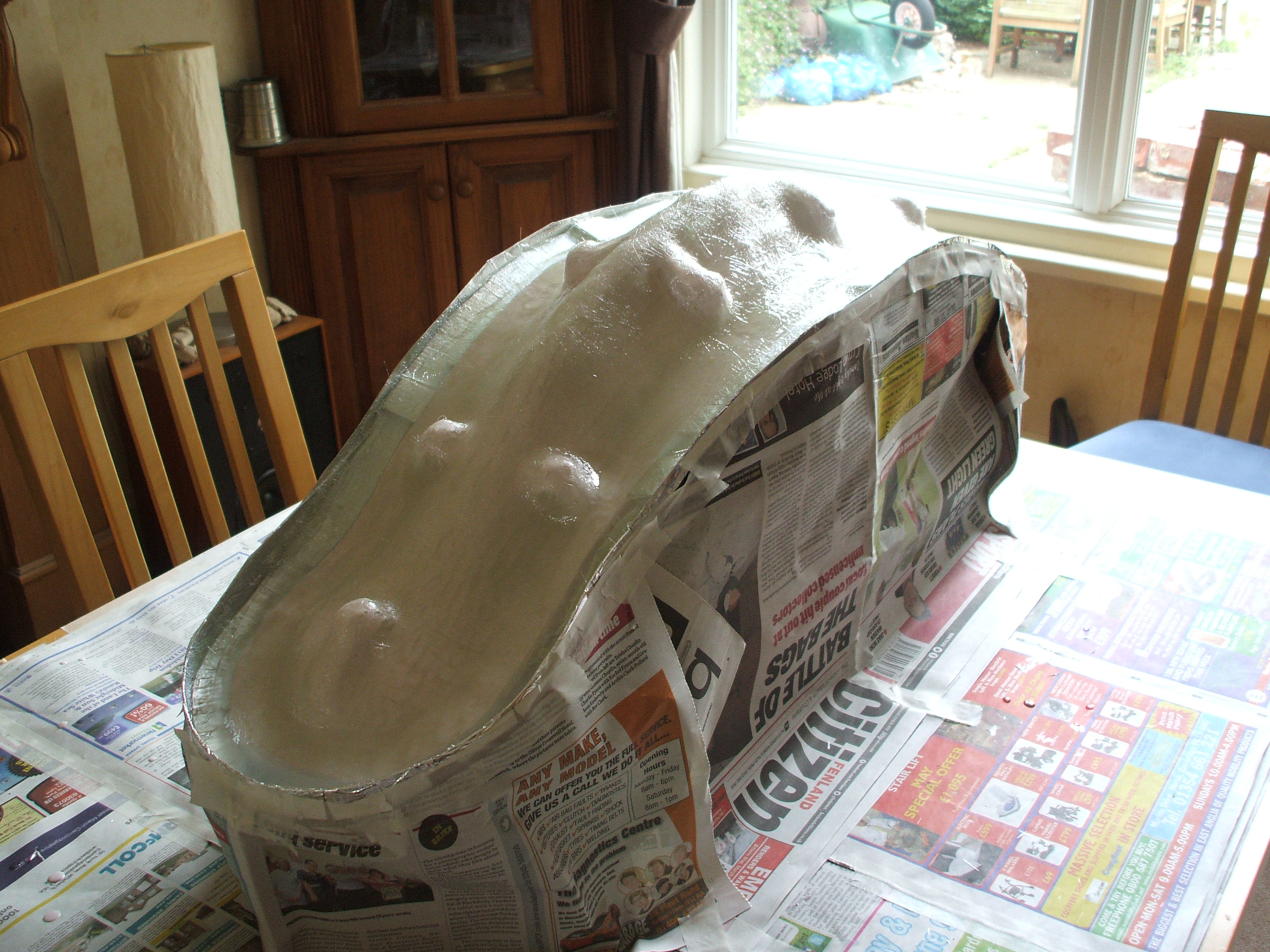

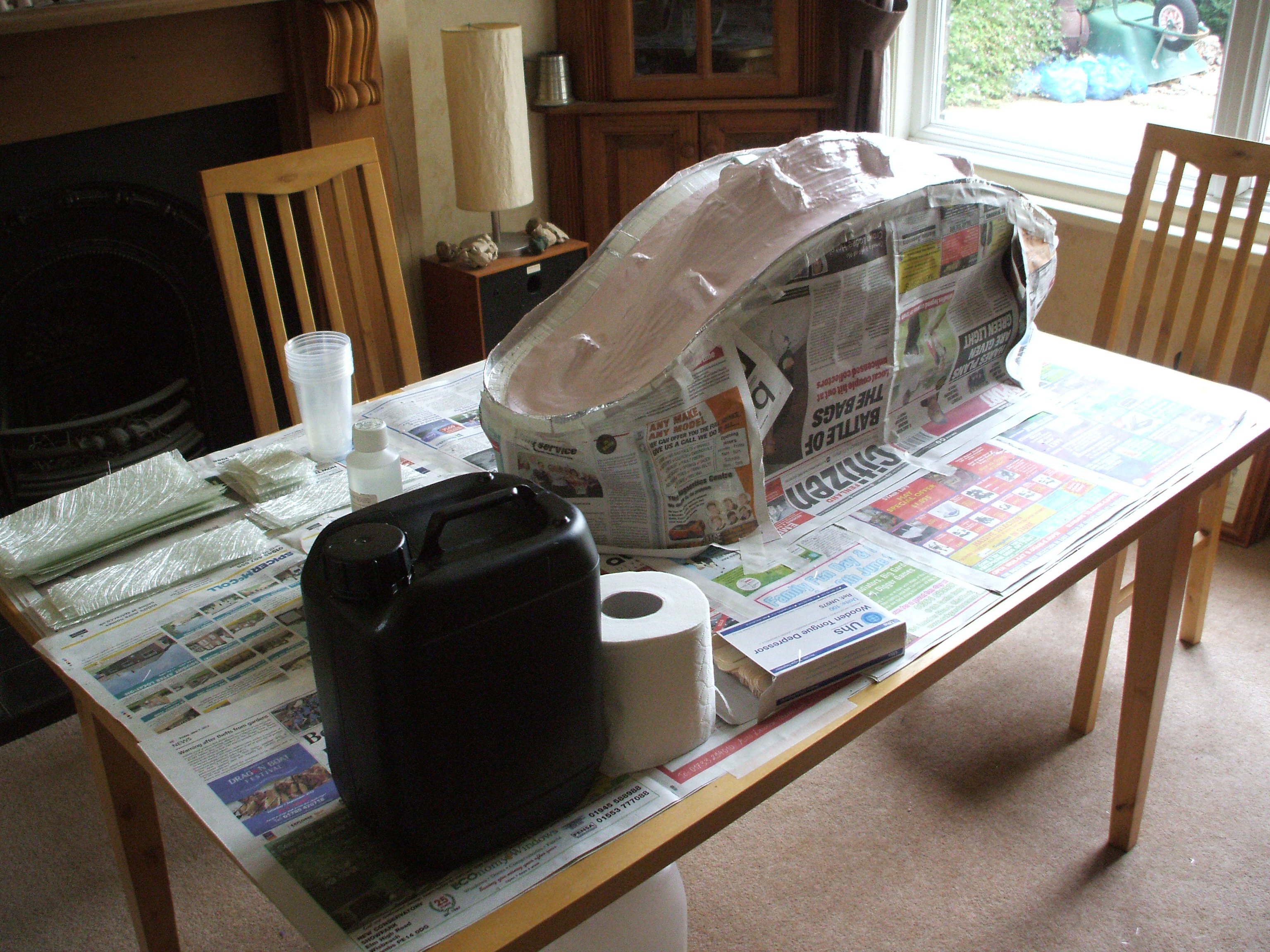

Here's just before, got everything masked up & ready to go:
And here's after:
Pongin stuff!!
Still, that's all done now, so I can rip all that cardboard off in a while & flip it over ready to start on the next bit :)
I decided not to put pieces wood onto it, it would have made it even more difficult to rotate.

How many layers of glass did you put on, Leigh?
Thanks man :) I put quite a lot of glass on there & its pretty thick, but the flange either side in the middle has come out a little too thin. I must have pushed the glass away from the edge while shaping it up, so I may have to thicken those area's up a bit more.
I just hope I can add a bit more glass without distorting the flange due to shrinkage :unsure

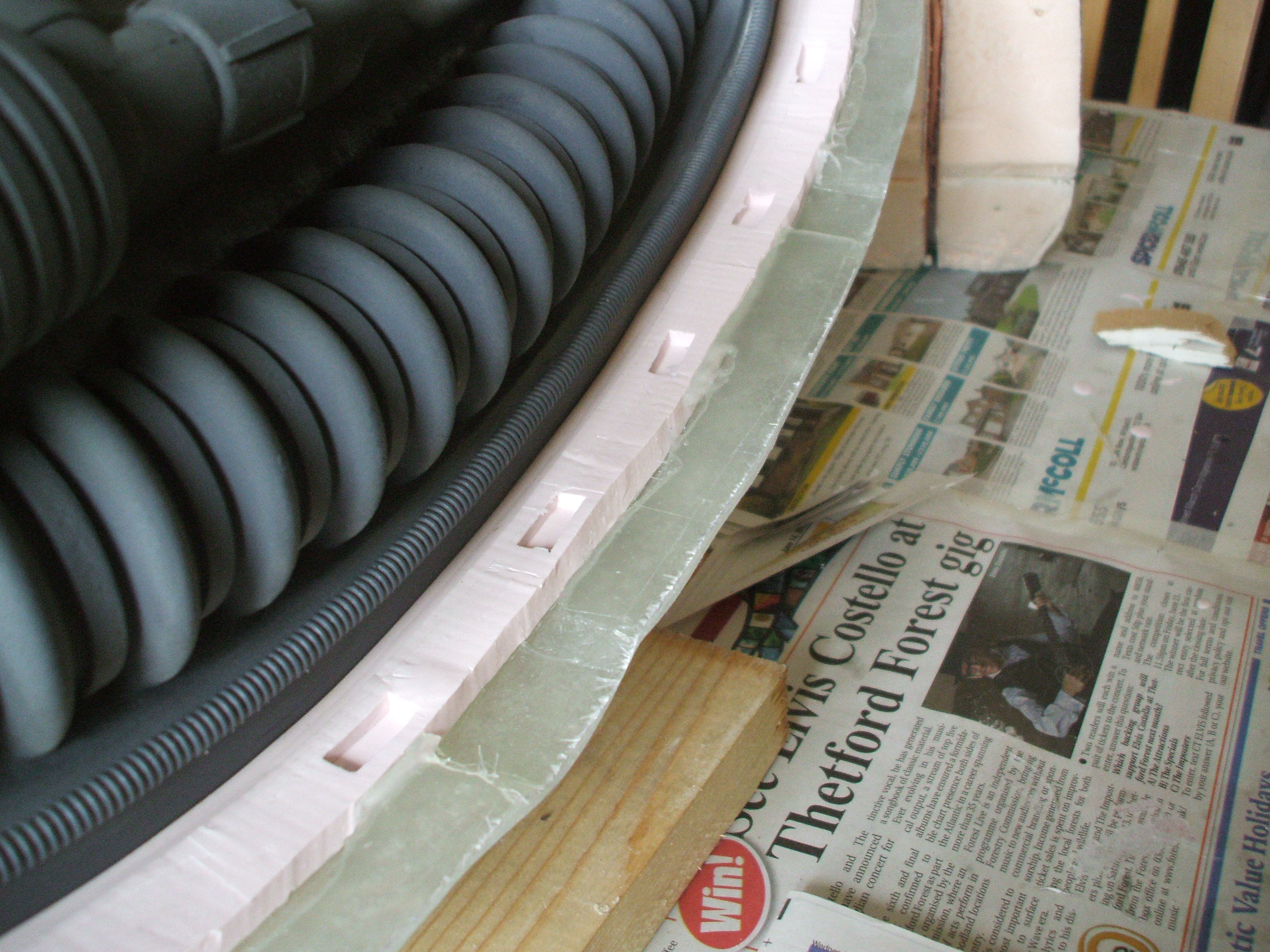

Add that extra glass in the middle before you do anything else, no matter how tempted you might be to press on. Should be fine. You could slightly under-catalyse the resin for a slow setting time, I'm not sure it would retard the ultimate shrinkage but it won't hurt.
Re: Bob the Alien (Giger inspired Alien) Sculpting finished page 45
I bought a bag of chopped glass strand, I think I'll mix that up with some resin to make a paste & spread it on the thinner area's to beef them up & I'll use the minimum required activator. Doing it that way should build the thin area's up nice & quickly & they'll be strong :)
The Jacket has come out very sturdy & strong with virtually no flex which is good, I'd just prefer a little more thickness to the flange in places.
That worked a treat! :)

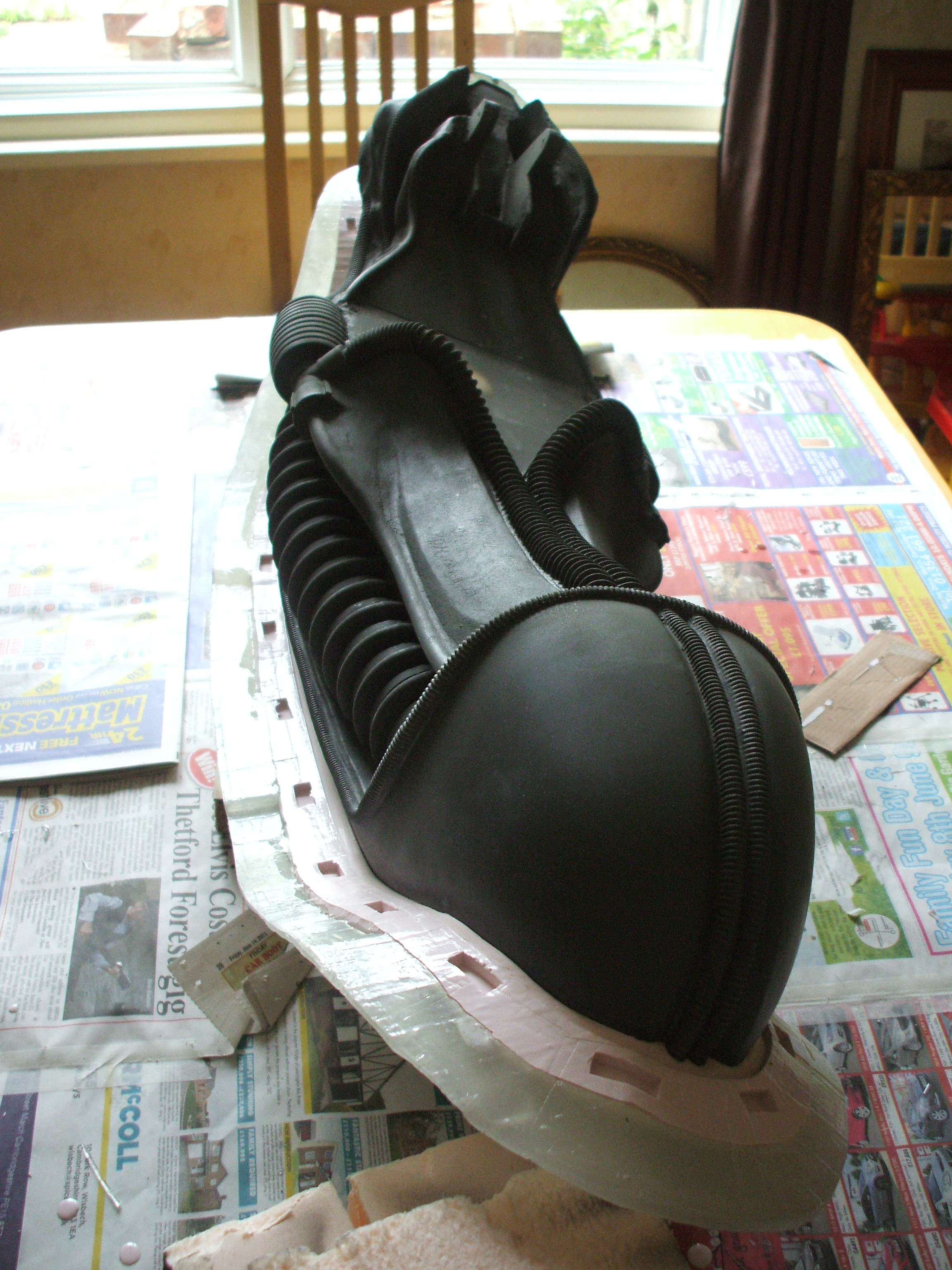

It's all cured now, I've trimmed up the edges, washed it down, put it back on & flipped it over:
I need to fill the bubbles that formed in the jacket flange against the edge of the rubber, otherwise its all good to go for the next part :)

Did you separate the silicone and the sculpt? If so then the 'seal' to the surface is broken. Silicone has an amazingly low surface tension, so despite its high viscosity it wicks into invisibly small gaps. Because it sticks so well to itself, the last thing you want is the next half of the mould invading the first half; it will form thin 'blotches' along the seam line.
If you did remove the sculpt, I'd recommend taking it out again and greasing up not just the joining flange but also inside the sculpt/casting area itself for a couple of inches, just in case. Could save grief later!
Right, I didn't remove it completely but I did break the seal around the edge.
I had the same thing with the Jaw mould & I predicted what could have happened on that one.
To re-seal the jaw mould I brushed some petroleum jelly about 1/2" down between the mould & the master & then gently pushed it closed again, I then wiped away most of the excess that squeezed out. With a brush I then filled any small gaps with the jelly. The jelly also kind of stuck it back down, as a result I didn't get any seepage. I'm hoping this method will work with this mould, although its quite a bit bigger.
What do you think? :)

Yes mate you nailed it. Maybe go a little bit further in this time as it is a much bigger mould, but it is overkill really. Better safe than sorry and all that stuff.

Thanks for mentioning it! It could have been a costly mistake if you hadn't said something & I'd overlooked it, for the benefit of others reading as well :thumbsup
