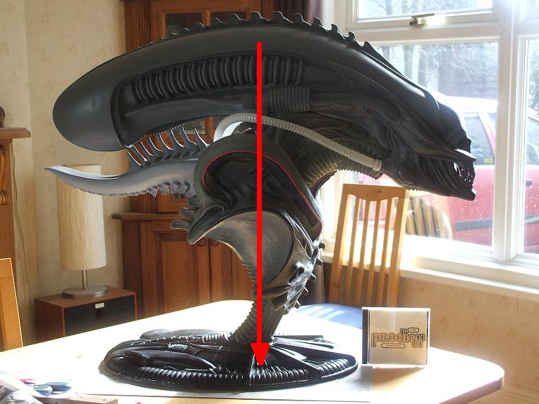

Everytime I visit this excellent thread, I worry about the moulding and casting of this piece. I'm not a moulding expert by any means, but I've a little experience in the art, and the challenges and cost of casting this monster frighten me :D Following on from Guilty Gear's comment about the top heaviness of the piece, I was also thinking about the weight in resin after it has been cast. The thin stem and the fact that it leans forward make it a very weak spot to support all that weight (hollow cast or not) and is going to need some reinforcment. The normal way would be to add one or more rigid steel rods to the resin as it cures. If it's done that way, I would also suggest thickening the base beyond the inch you are planning so that the rod can sink at least 2 or 3 inches into it or the weak spot will be where the stem joins the base.

Regarding the weight distribution concern... at present Bob weigh's 36lbs or just over 16kg inc the base. Hes mostly made of a very fragile foam mostly held together with PVA glue & a few wooden sticks, all that weight is transmitted to the base via 2 lengths of ABS waste pipe slipped inside one another & filled with urethane plastic. The majority of the weight is in the clay & the polyester filler I've used.
The head on its own weighs 14lbs or 6.3kg, the weight of the head slightly biases rearward & with the jaw attached is pretty much bang on in the middle.
A little while ago I did a test to confirm my thoughts, I placed the whole thing complete on a wooden rod to find the balance point & the weight is tranfered right through the middle into the base like this:
Since then A bit more weight has been added towards the rear only.
By its design it does give the impression that if its going to go it'll go forward when in fact its more likely to go backwards.

My current plan is to rotocast him in urethane I'll be aiming for 5-6mm or 1/4" wall thickness. Then I want to make a GRP tube with about the same wall thickness, insert it into the stand inside the casting & pour urethane around it to bond it in.
Where it inserts into the base, my plan is to cast the base a similar thickness as the rest, make a thick 6-8mm or 5/16" GRP plate with a hole in it to surround the location hole & then add more urethane to the inside of the base bonding the plate in place & thickening the base at the same time.
I've used some of this urethane on the jaw & on his face & it is alot lighter than I expected. I can guarantee he will weight a fair bit less as a casting than he does now.
I believe I can get the support from a GRP tube that I need for this. GRP in the thickness I've suggested is very strong & much lighter than mild steel even in tube form.

Your plans sound good and you have obviously been considering all this as you go, which is the best way. The only concern I have is in the base. Urethane is pretty strong, but is still mallable, especially when the weather is warm. This Terminator bust I have is thickly cast, but over time it sinks into the base and I have to warm it with a heat gun and pull it back up (when I can be bothered I'll probably try to put some wooden supports in).
So it might be a good idea, if there is a void inside the base, to put some sort of support in there.

I had heard that urethane can become brittle in extreme cold but it hadn't crossed my mind that it might go soft in heat.
I have an off cut from the jaw casting, after reading your reply I chucked it in the oven at 80 degrees C for 10 mins to see what happened... it did go a little bit softer but not by much, I could only get a bit of movement in the thinest parts & as soon as it started to cool it went rock hard again. Still I think I'll reinforce his upper body & head with some polyester resin soaked rope as well as the GRP tube.
Edit: or I could just foam fill him.
Thanks for the tip Alan :) (y)thumbsup:thumbsup
I'm a fan of foam filling. Even if there are thin areas in the resin, the foam backfilling makes it nice and strong so those areas don't fracture.
