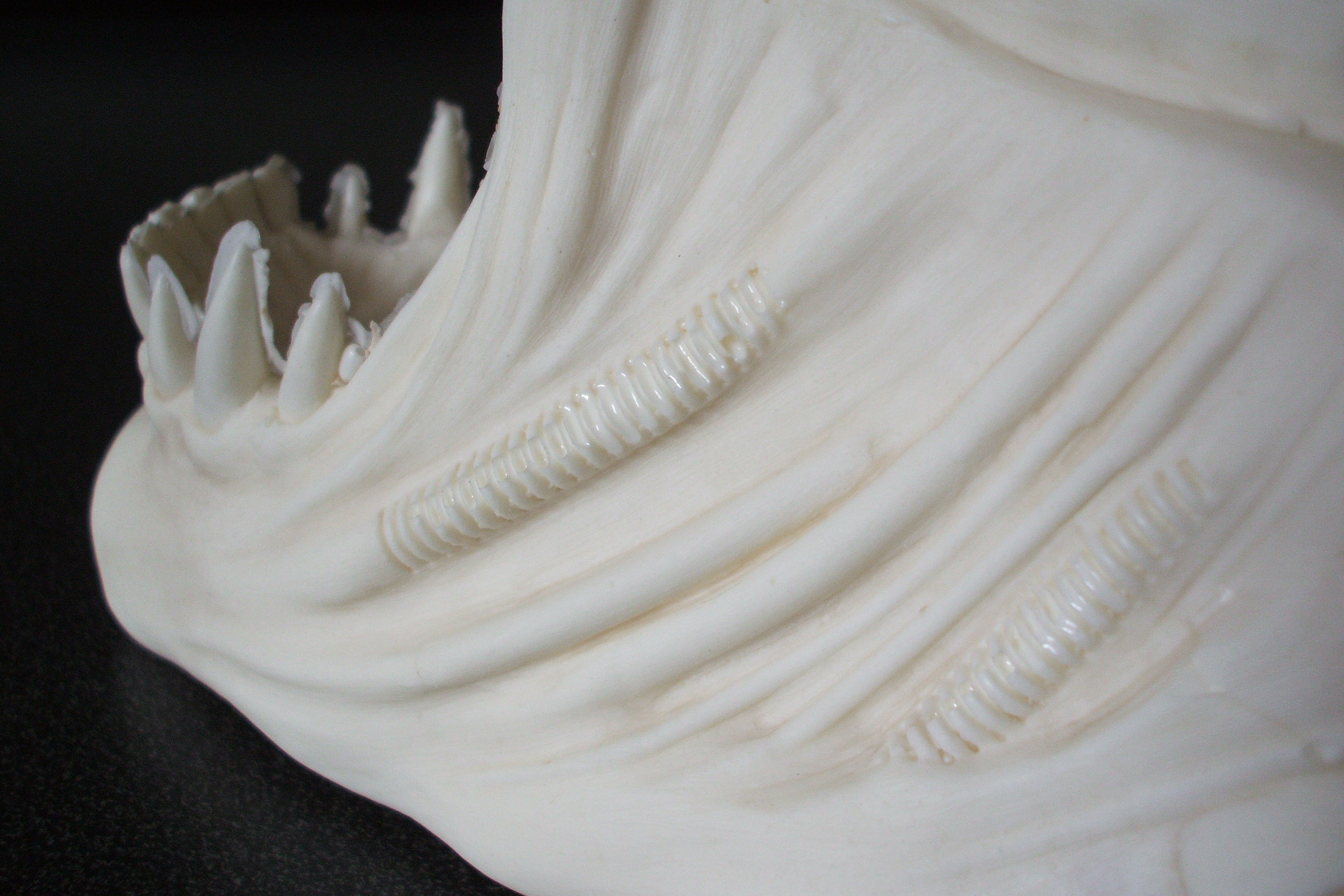

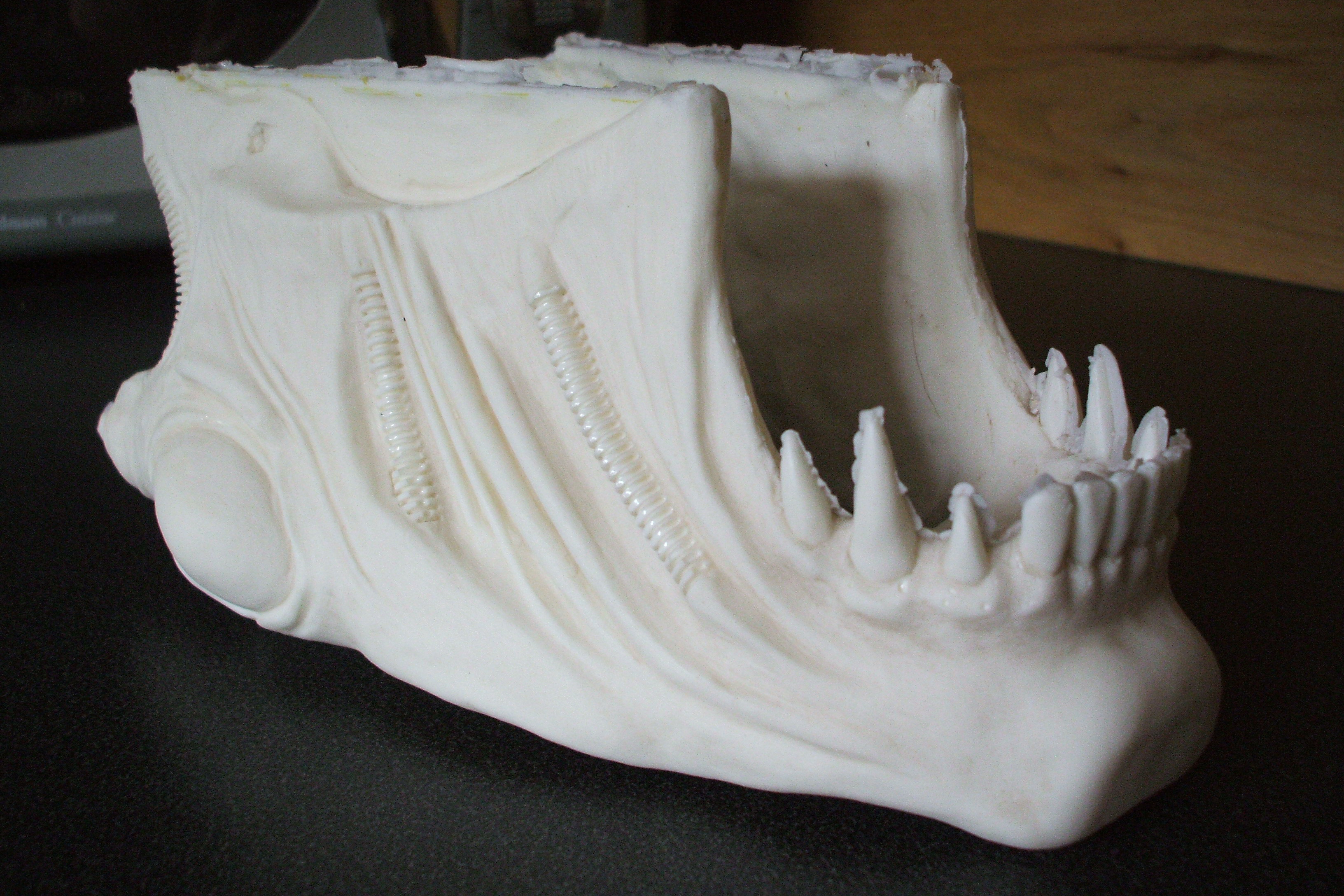

Pulled my very first polyurethane resin cast from the only silicone mould I've made :) :
I'm pleased as punch with this! there are a few bubbles, mostly on the convoluted pipes. The teeth have come out great & the finnish overall is brill. I used talc on the inside of the mould to reduce the bubbles but I guess I'll have to change the way I pour the resin to get the rest of that trapped air out.

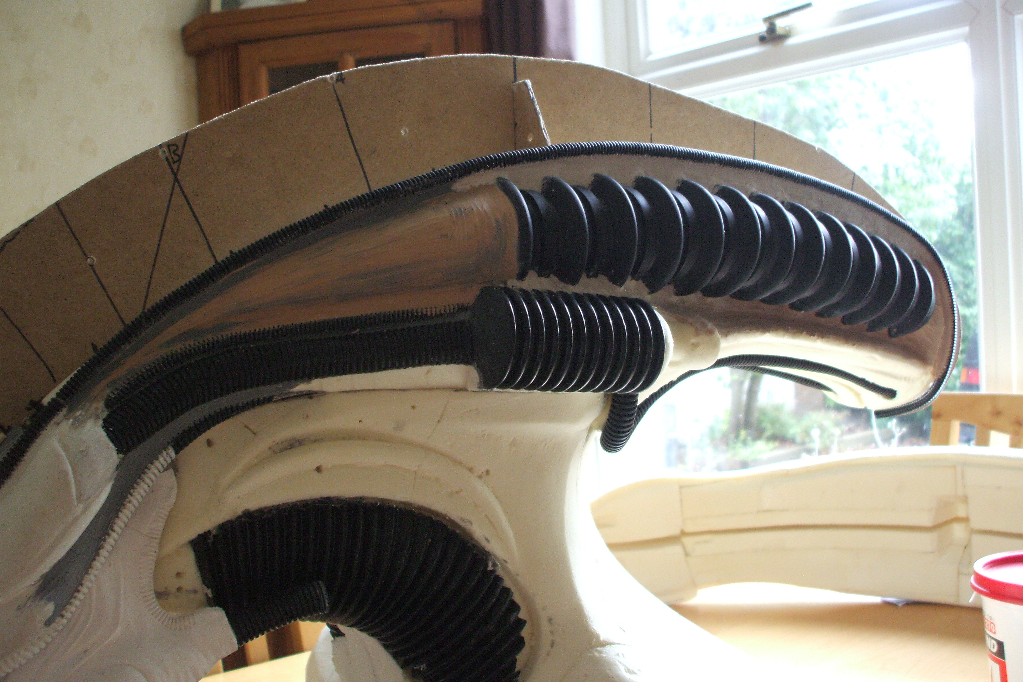

Heres the latest:
I've been busy with the clay on the side of he's head, just need to give it a final smooth & then texture it.
The cowling needs to come down a couple of millimeters more, I'm intending to use a polyester resin with a lightweight cloth & cover the whole of the cowling to give it a hard shell & to get the edges right in relation to the pipe it covers so that it fits the sides of the head perfectly. Then I can use car body filler to build up the sides & a few other area's of the cowling & finnish the shaping up. It'll then be pretty solid so I'll make a wooden structure to support it & raise it up & it should be OK to use for vac forming :confused thats the current plan for the cowling anyway...feel free to criticise on this idea :)

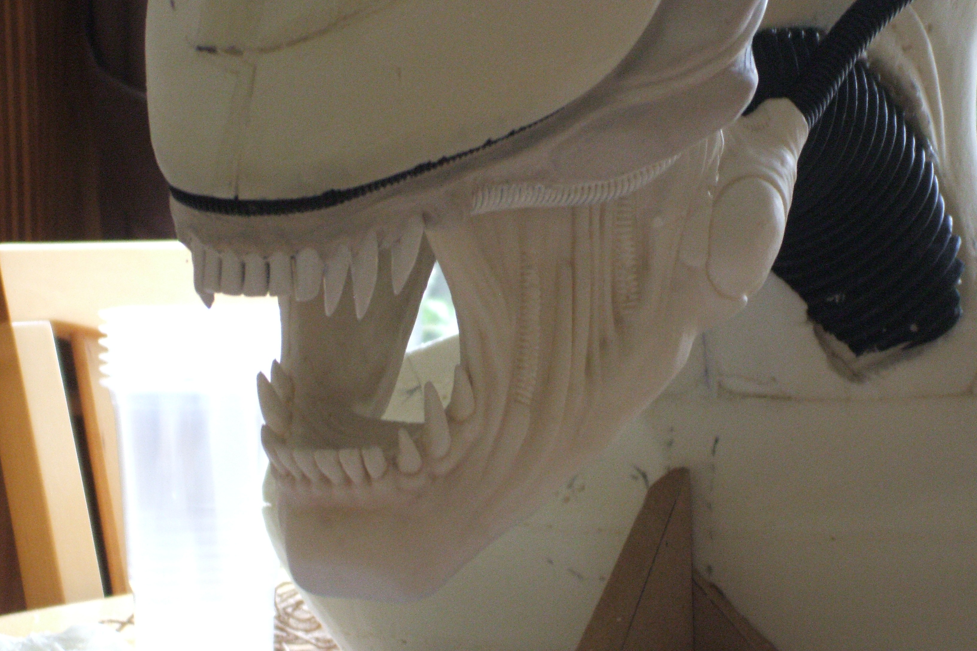

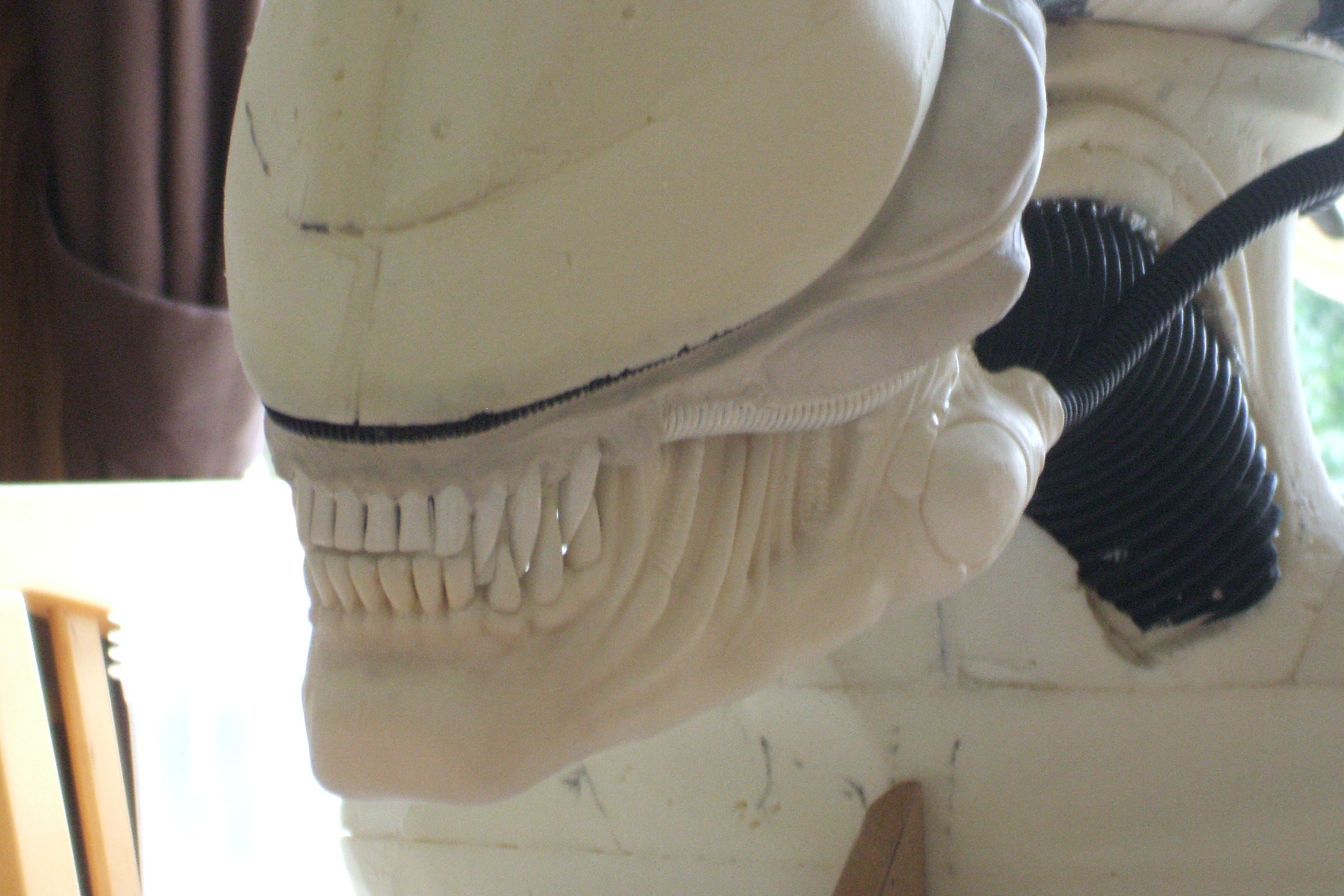

& here's he's new plastic jaw fitted & re-adjusted so the teeth mesh better:
& with he's mouth open:
Re: Bob the Alien (Giger Alien)
Very cool! I'm glad you are giving it a proper throat area behind the lower jaw. Too many reproductions neglect the fact that it actually had a throat.
Yeh, I had originally sculpted the front half of it into the under side of the jaw but I removed it as I was finding it difficult to build the mould arround it. My intention is to build it into the neck as one peice & then bond it into the jaw on assembly.
I'm hoping to cast the neck & throat in a rubber of some sort & then reinforce the neck area with polyurethane so that the throat remains flexable to allow the jaw to be posed open or closed, thats what I'd like to do anyway :confused I've got to do some research into the correct rubber to use.

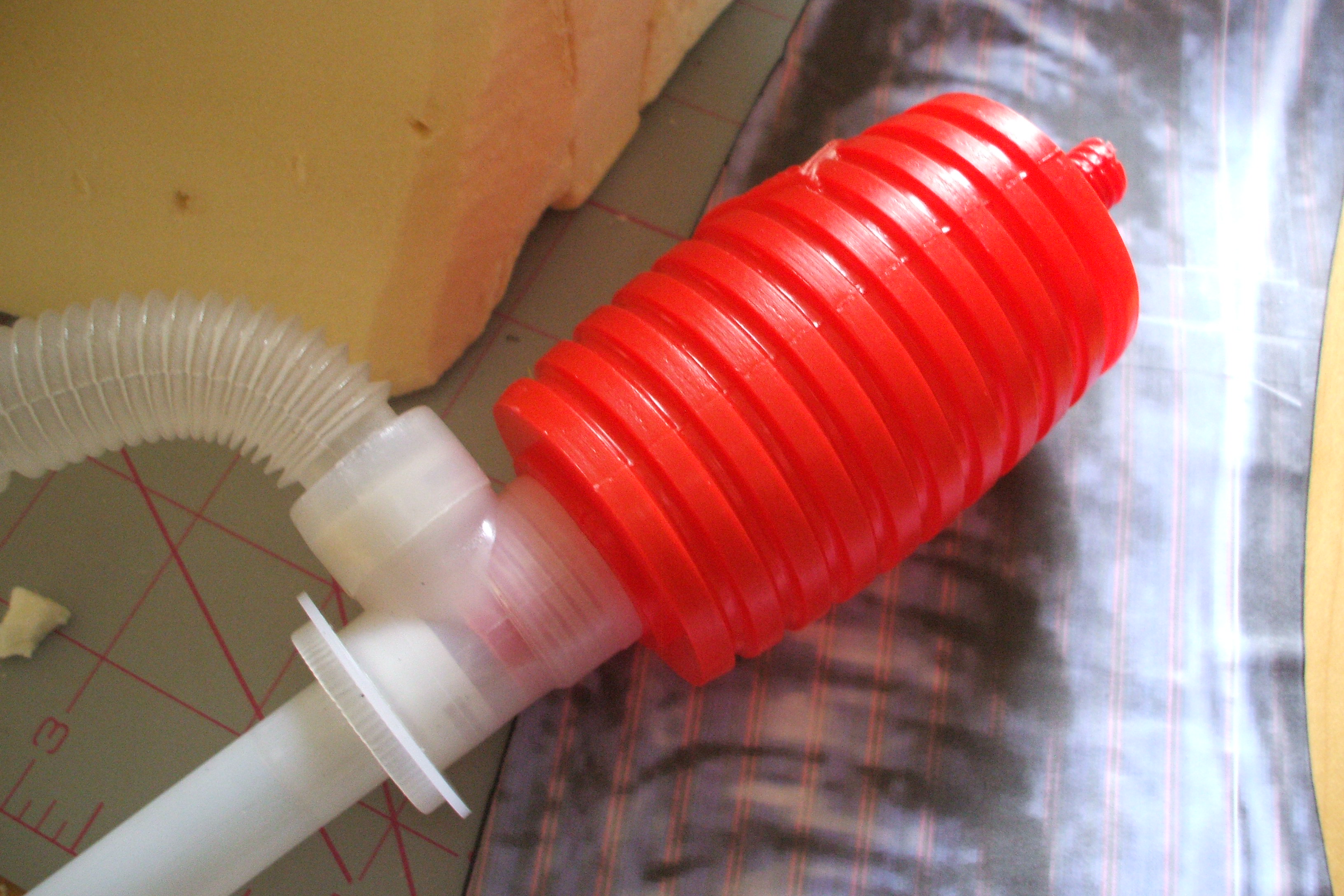

Right! I couldnt resist taking Nwerke's advise & I'm glad I did, thank you Nwerke for enlightening me :)
You know when you fit a part & you just know its right:
Heres a closer look at the jobbie:
I ordered these as a pack of two yesterday morning & their already here :) for the grand sum of £3.98!!!!! :) that included the postage.
Now I just need to identify this part:
& I'm good to go
